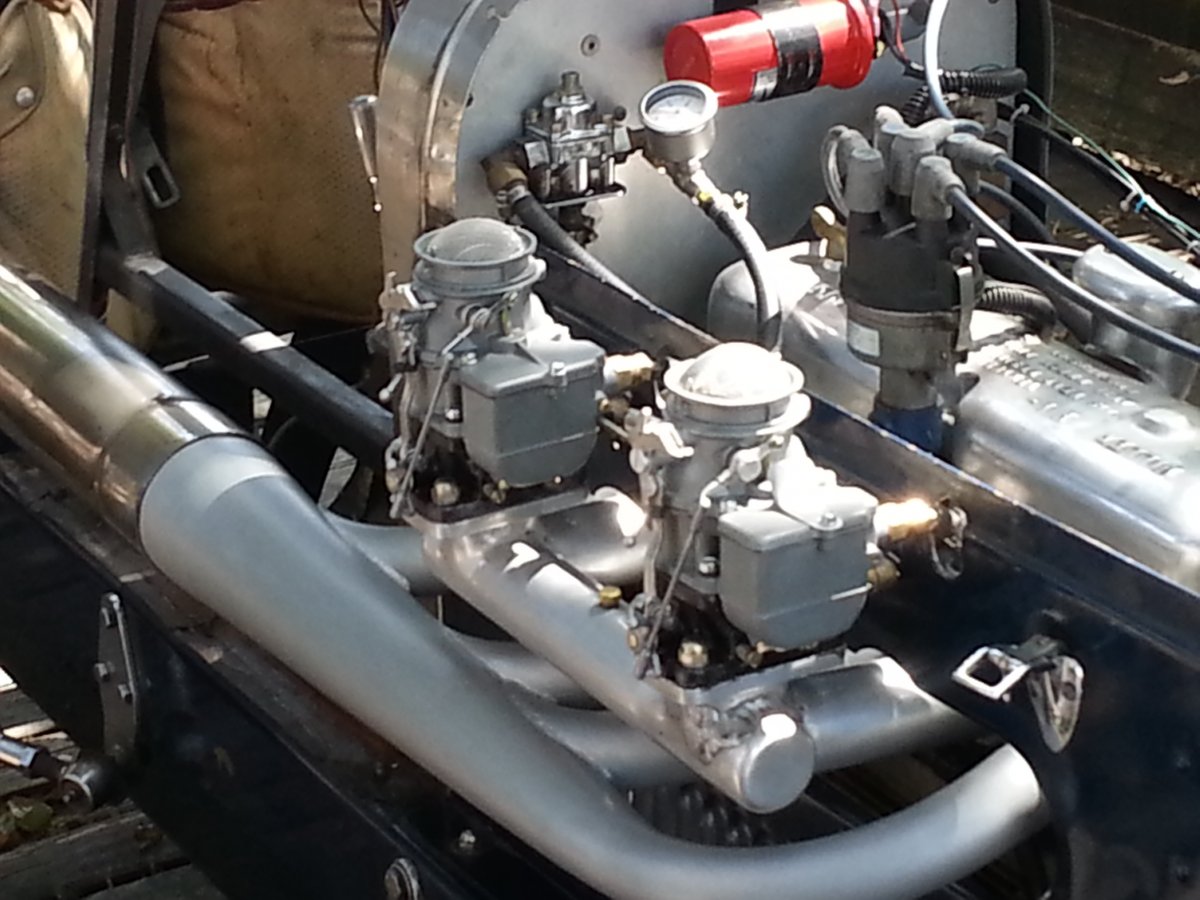

  10. I'm running a "Banger" with sustained speeds of 4000 to 5000 rpm. I've got a cam designed and ground (out of a blank made by Joe Panek) by Dema Elgin. On a recent "Cleanup" Elgin did on my cam he told me that there was evidence of "Valve Float".. We ended up with dual springs with loads considerably higher than you guys are running (open is over 200 lbs.). But, that's what the calculation came to. Also this IS a racing engine! 2014-04-19 14.59.17.jpg

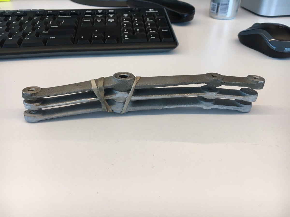

    Look what I talked Dave into making. I sent him my original of my Burns intake and he copied it, and is reproducing them. Darker one is the original.
    Dannerr, 1stGrumpy and colinsmithson like this.

    Oh, Dave would be Fourspd2quad

    Sorry, but what are they?
  19. I want one! How do I go about getting one?
  20. jim1932
    Joined: Jan 26, 2011
    Posts: 1,165
    jim1932

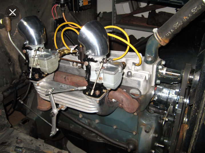

    Throttle linkage for. A down draft intake, pm dave. He has a classified up.

    Joemac they're part of the linkage for the carbs like you see on this Thomas intake. Screenshot_2017-08-14-21-33-19-1.png

    The double springs are a good idea and time you want to rev for extended time @200 open you maybe buying another cam sooner than you need to. Perhaps the ramps are a little Potvinesque o_O Which Winfield master did he choose?..... Not a real question as I know he'll never really tell you. What was the indication of float? Couldn't you hear the engine flutter?
    I once had a customer change all the new valve springs from 55seat to 90. I asked we're all the springs the same?"He said yes 'warn out'!!" Why didn't you call me THAT'S THE WAY I SET THAT UP, YOU IDIOT .... WHY DIDN'T YOU CALL ME FIRST? ..... Some people's children
