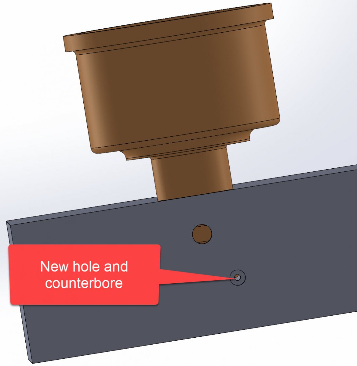

    I have been thinking about this rust and corrosion problem. First I checked the distributor (Mallory) diameter where it fits into the cylinder head and find it about .003" under one inch. It was a very tight fit into the cylinder head so I ran a one inch reamer through the head and now have a very nice fit with some room to move. And some room for the never seize I plan on using. Presently I plan on drilling a hole that meets the bottom chamfer on the distributor housing. Then installing an elbow and vent pipe up to a convenient area so I can add a drop of oil of some sort every now and then. Can anyone see a problem here before I start drilling holes?

    Did I imagine it? I thought somebody mentioned that the model A did not have the best of crankcase ventilation. That's why I ask these questions because after a couple of days that casual remark hit home. I have a couple of Corvairs and this is the setup they used...
    I am going to drill the head I am going to install metering orifice in a line to a vacuum port. Connection will be made with a hose so I can shoot some lube down into the distributor mounting well from time to time as well.
    Thanks for the comments, this may be the answer to all the seized up distribute problems, time will tell.
    Of course I shall have to pull the distributor from time to time and report the results. o_O

    Well OK, but yeas ago, when we first encountered this problem, we solved it quick and easy!.
    Take a triangular file and file a vertical groove about .040-.050" deep down the hole that the distributor fits in the head. Now file a horizontal groove across the face that the distributor stops against, connecting with the vertical one, and about the same size. Just the small amount of blowby escaping up and out that channel was enough to stop the rusting for my buddy and I.
