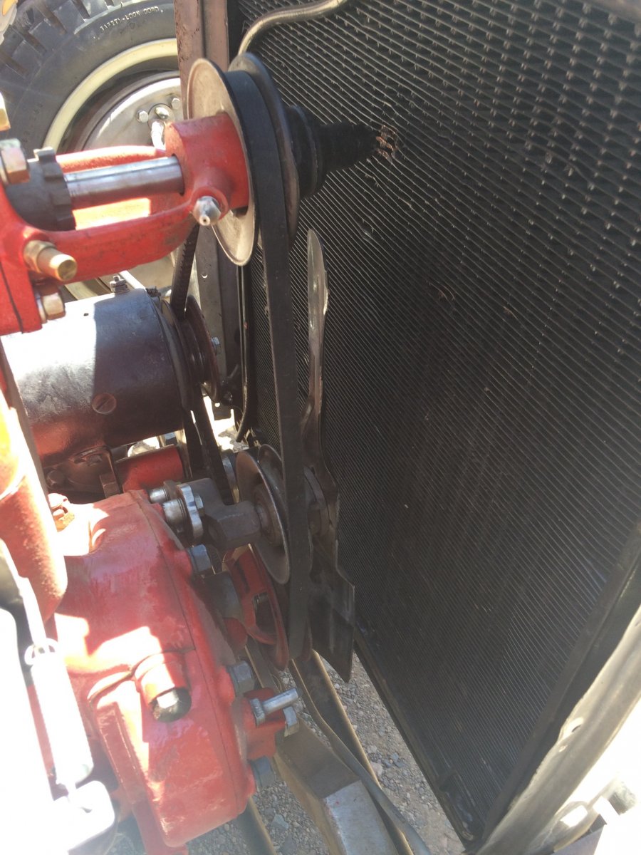

    Does anyone make a way to lower the cooling fan position on a Model A/B engine from the water pump (top of the engine) to somewhere more in the middle of the front of the engine? I'd like to lower my fan 6-7" from its current location.
    GuyW likes this.

    Got a pic? Not sure there’s an easy option except electric.
    Don’t know what you’re working with, but I put a T body on an A frame (A engine) once and thought about this for a while.
    The cowl and radiator lining up is a small problem.
    I bought a radiator that was shortened 1-1/2”, shortened my fan blades just a bit, and raised the body about 1/2”.
    Not 6/7” but, worked well.
    BeaverMatt likes this.

    I saw this fan set up on an idler pulley on a T Speedster with an A motor at the Dirt Drags. Hope the Picture helps.
    Jet96, Dannerr and BeaverMatt like this.

    That's a good example of how little the fan actually does,it basically moves air when the car isn't moving,its all its needed for.Electric fan is the solution,you just have to forgive yourself for not looking 'period correct',its easy to do if you have an alternator..the forgive part that is..

    Thanks for the pic Binger! That's what I'm looking to do so I'll study this pic a lot!! I have a B motor in a T modified T ch***is. I'm needing the fan down in about that position. Anyone else have pics or details to a solution similar to this?
    Walls & railcarmover - I agree, electric would be easier and likely much better. Trying to avoid anything that modern however.

    It would take a little figuring but I bet you could fab up a fan pulley and bracket,cut the snout of a water pump and rig it off the timing cover bolts like the cat in the picture does..
