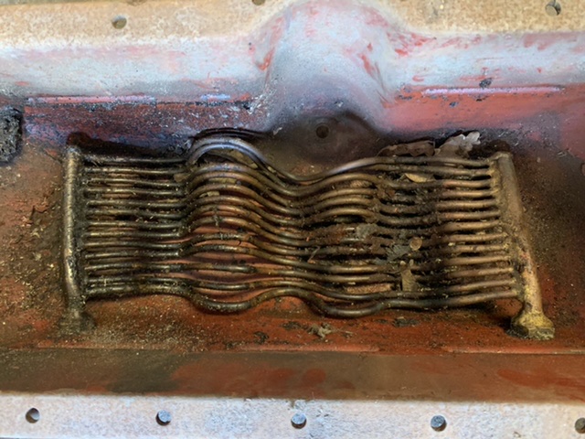

    Posted by Flatred53 8758BE81-1EFB-4993-9734-5295920E22C2.jpeg DD403FD4-3B9F-406B-9257-332278DCD0BA.jpeg

    no offense , but is all that a cooling system for oil ?
  5. Jet96
    Joined: Dec 24, 2012
    Posts: 1,431
    Jet96
    from WY
    Cooling or heating I really have no idea
  6. V4F
    Joined: Aug 8, 2008
    Posts: 4,391
    V4F
    from middle ca.
    someone put in alot of work ........
  7. Probably for not much result. I cut one up lately, yuck a mess..........
  8. V4F
    Joined: Aug 8, 2008
    Posts: 4,391
    V4F
    from middle ca.
    looks to be small tubing probably not much flow if any

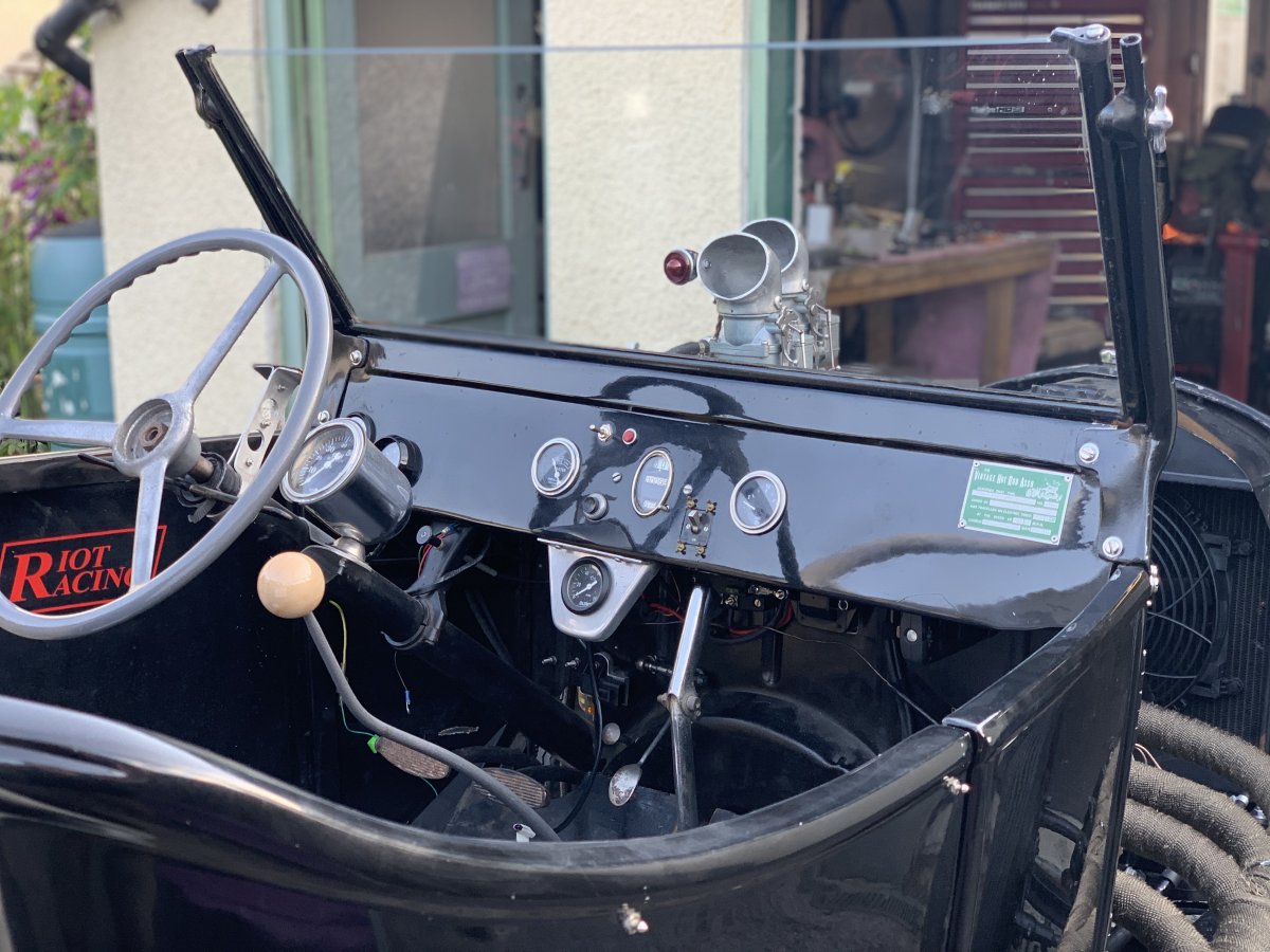

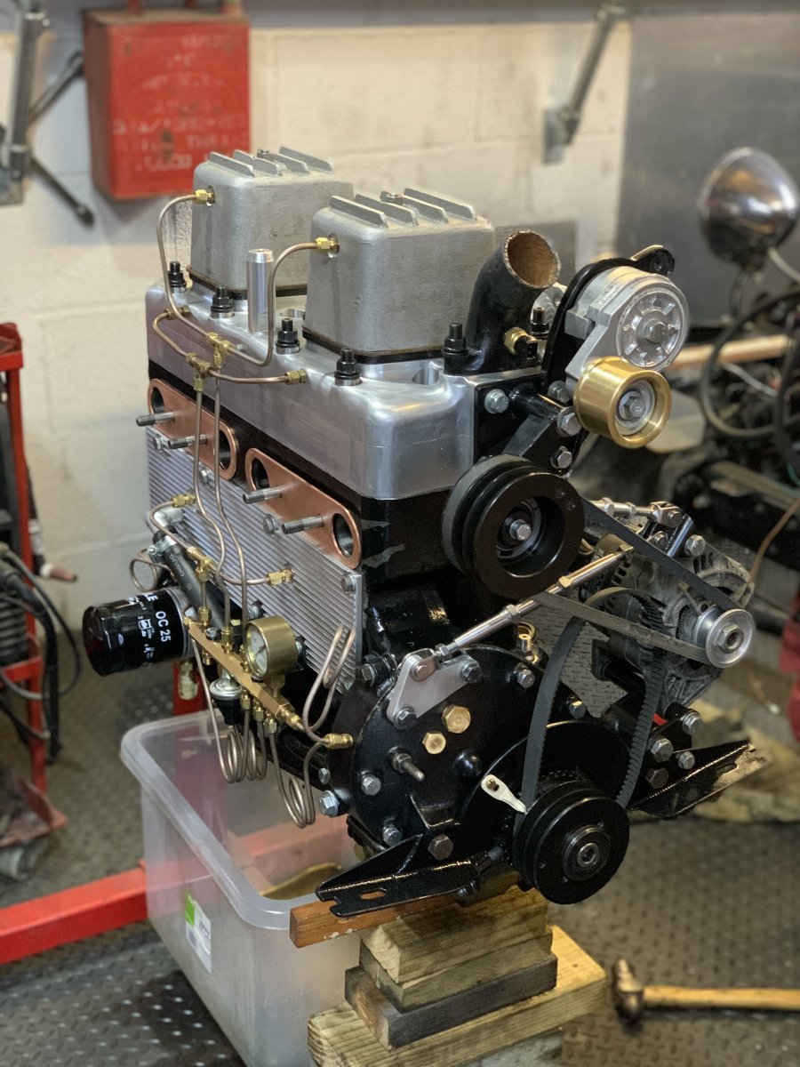

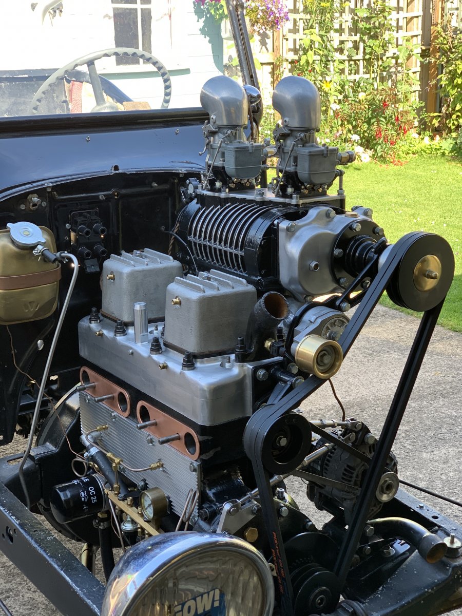

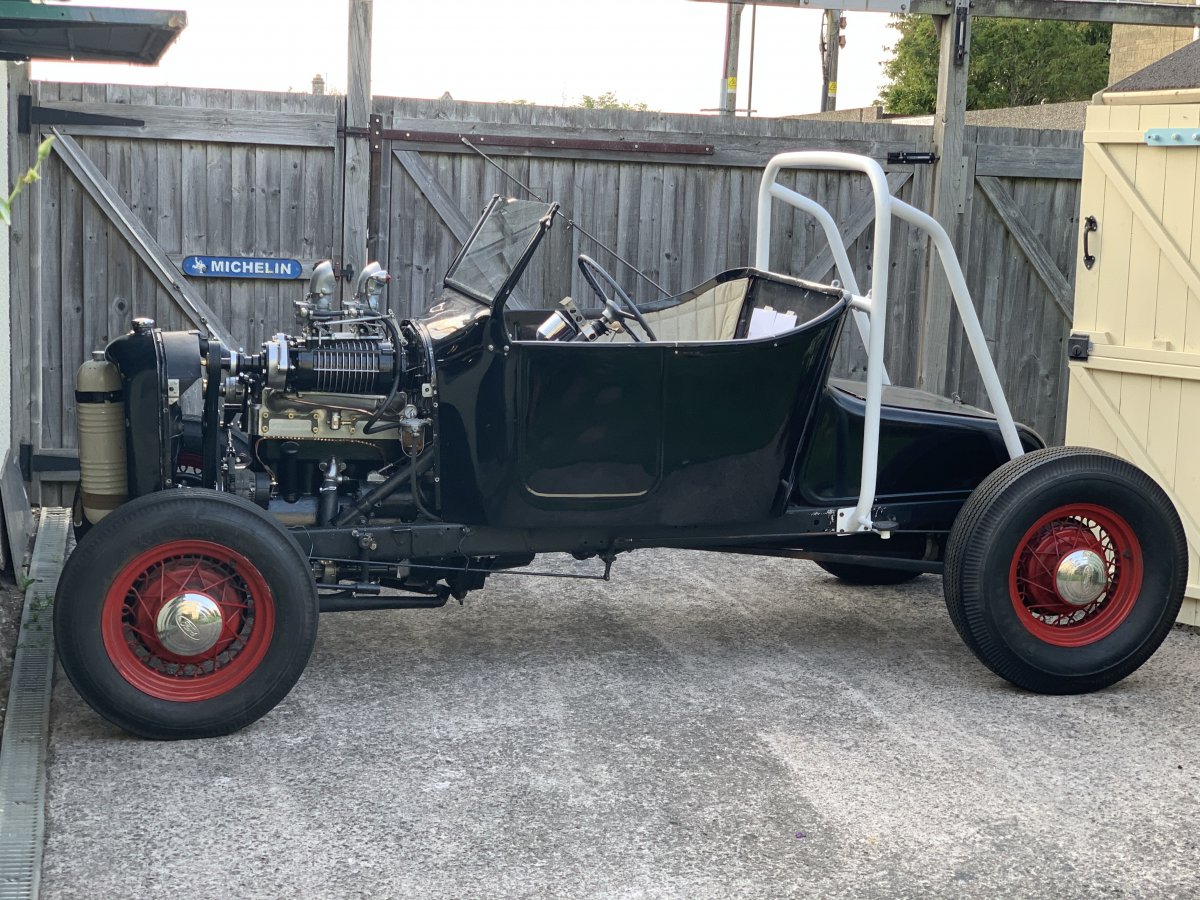

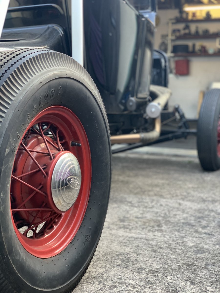

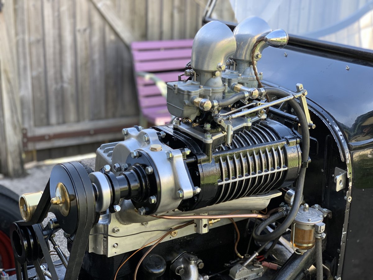

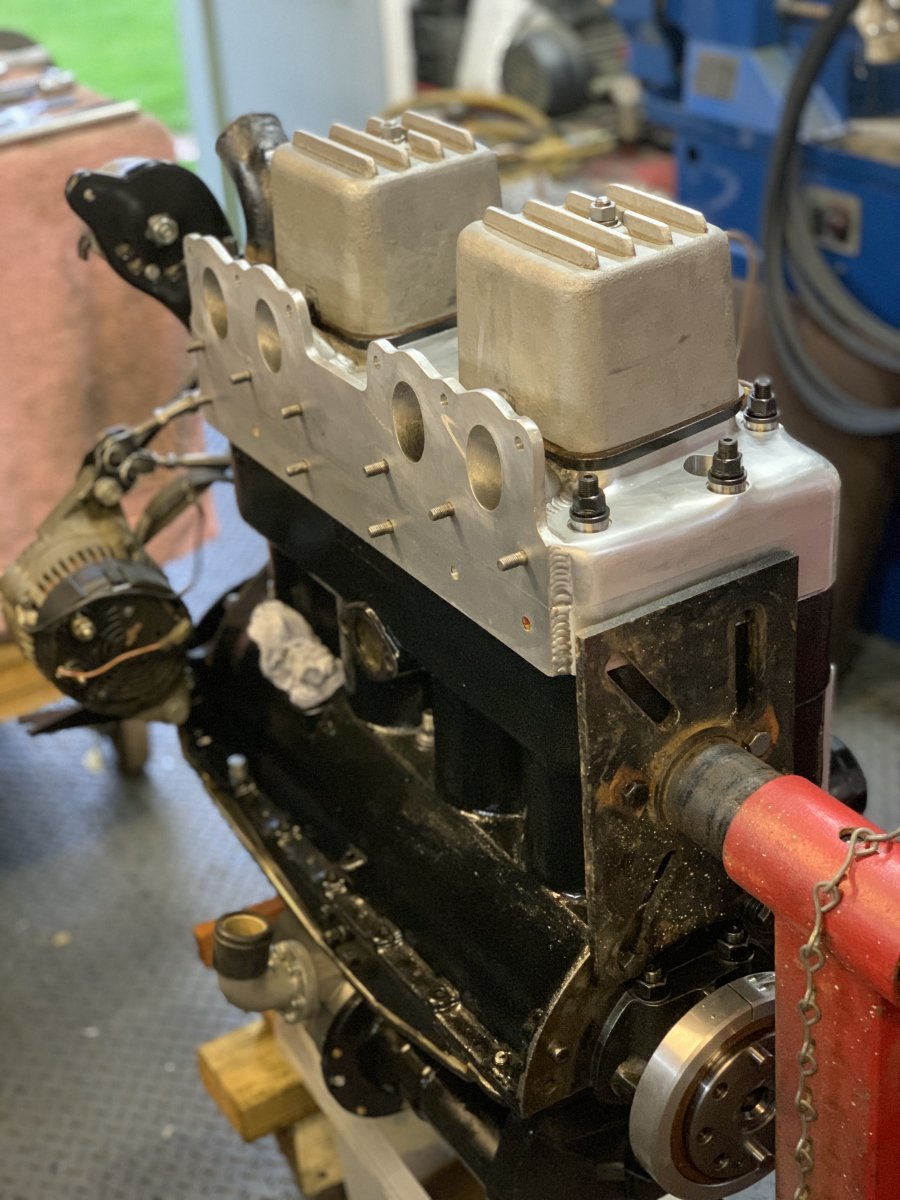

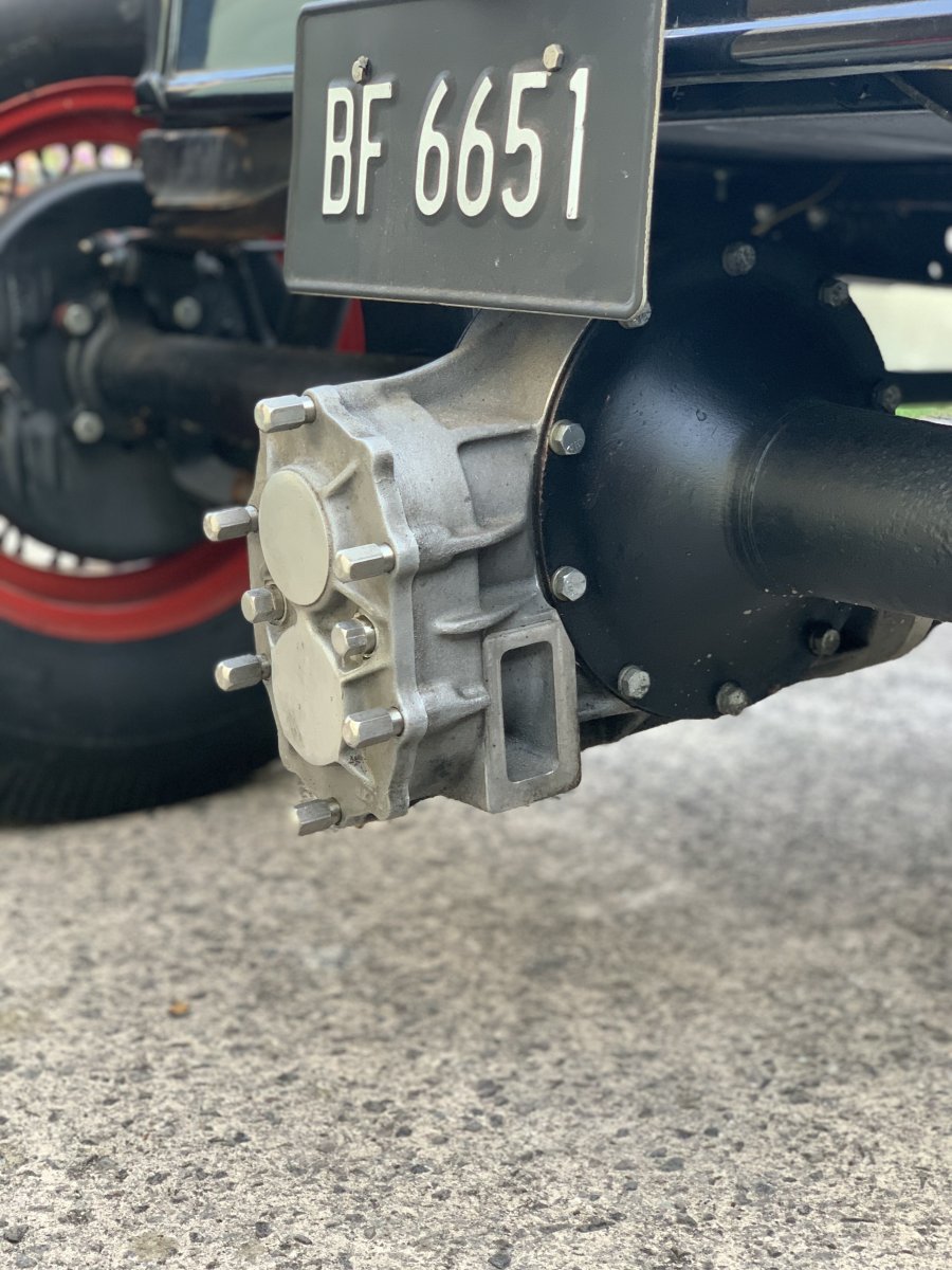

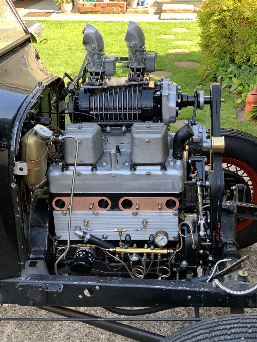

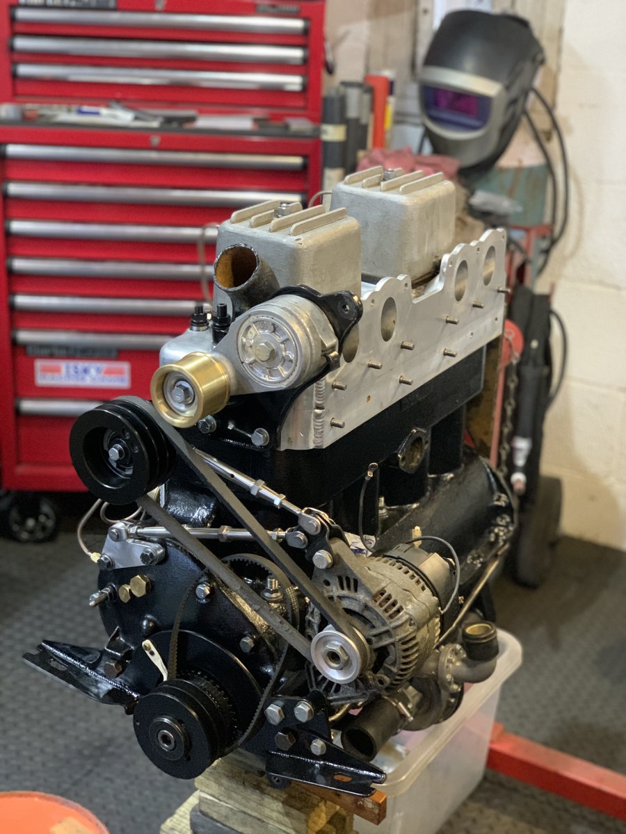

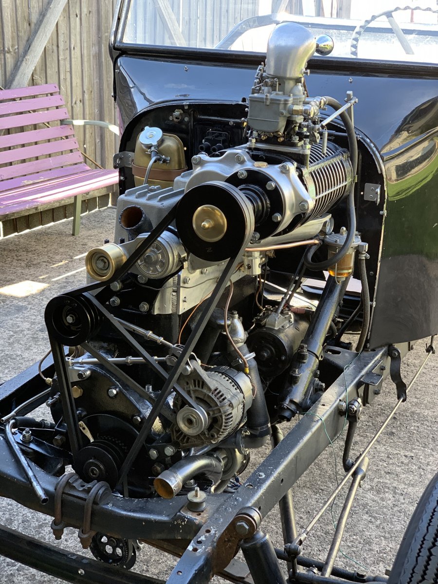

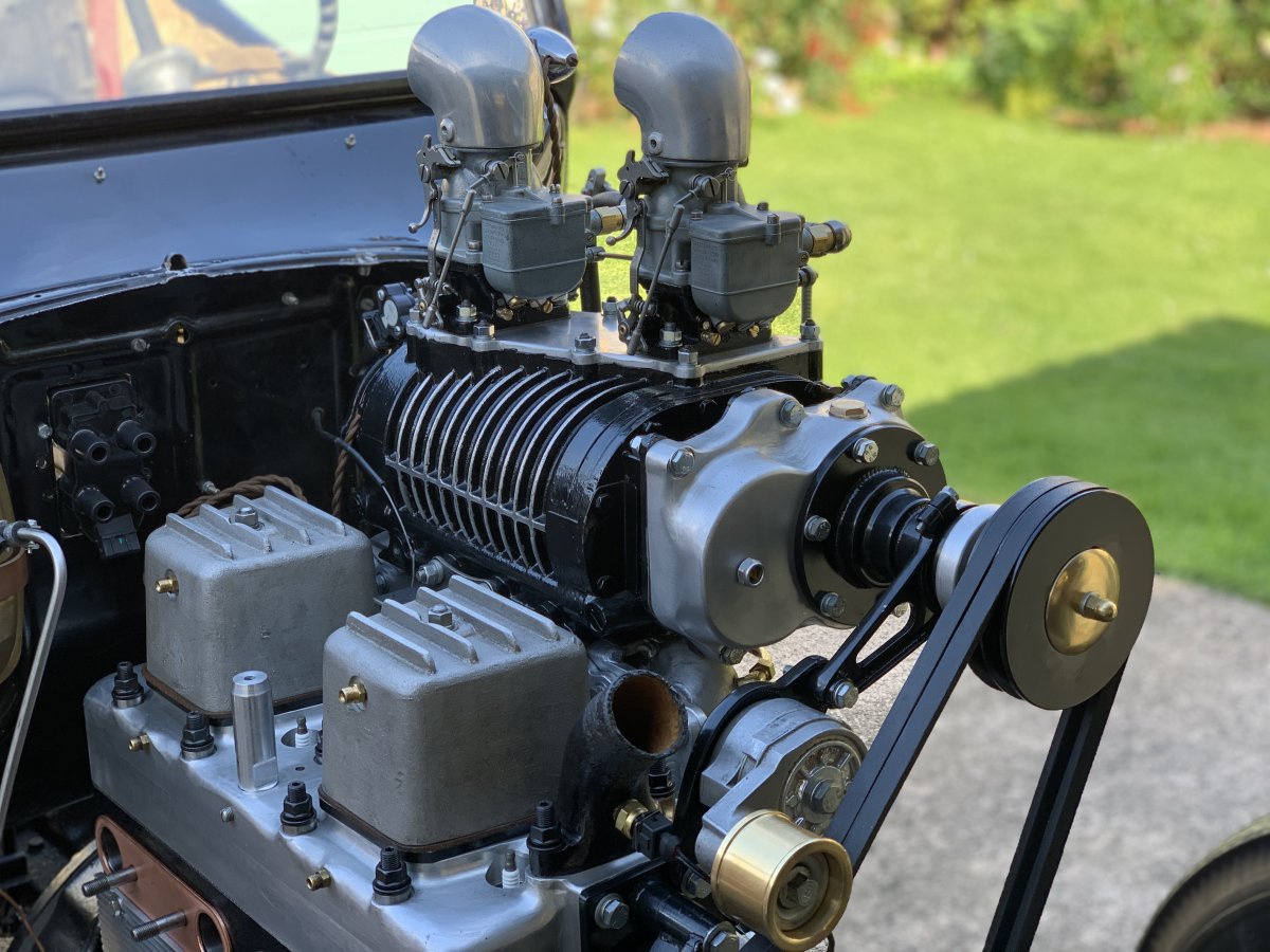

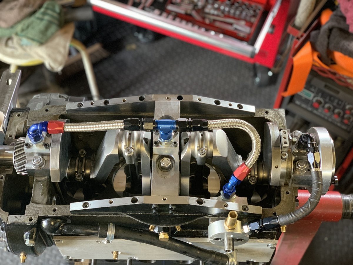

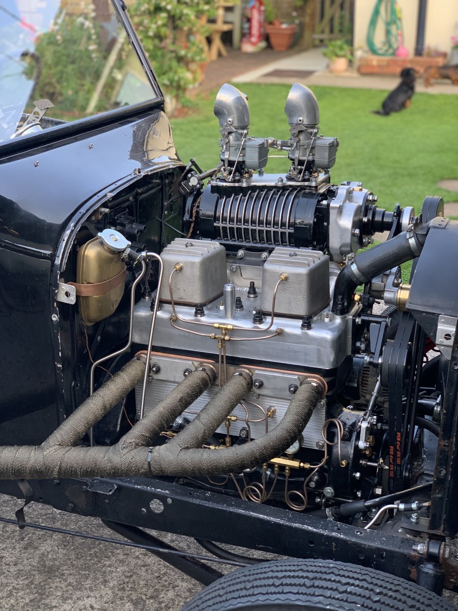

    Finally got the motor back together after a long wait for the custom cam due to COVID.
    Still got a bit of work before fire up time but it’s getting close.
    The roll bar is only there so I can compete at VHRA Pendine Sands a bit later in the year. 5DF57E38-0645-46E9-A094-E974C9C5724C.jpeg 51103B5A-7A24-4422-B94F-5123BDF1B92D.jpeg 1F3E387A-D992-42DE-9EEC-A60C9ED19DB5.jpeg 48053D17-2E9C-424D-9F9D-2817812AB394.jpeg 8BF47F7D-D120-4BF1-8A71-34A001383287.jpeg 84E75780-C4EE-4C09-96F3-FEB0BC2C44FF.jpeg E5CA621D-077C-4612-B778-4A04D0D3A4A7.jpeg 422A6CBD-DED1-4B26-85D9-CF5172BBA270.jpeg 08A21208-28DD-4F31-ACD3-87FD78C4D889.jpeg 77C5EC4E-01DF-4B4E-909A-59E4C88327FE.jpeg 1B8B75A1-A992-4E08-8572-62CACC38B681.jpeg 90E067DE-6A63-474A-B234-B3947D3AC700.jpeg 2551D5F8-99BE-4F09-9B25-4C723DA877FB.jpeg 8156279B-AB15-406C-881F-EB5AE970574A.jpeg 52053375-18B6-441E-8747-137C88BA6FEB.jpeg

    Holy smokes @nutrocker my eyes hurt now . Just scanning all the pictures trying to take it all in as there sure is a lot going on and all very nicely detailed as well.
    You are going to have a blast driving that little T for sure.

    Damn, that's a lot of plumbing for oil lines. Why is there oil going to the head and rocker covers ?
    kb9jlo and barrnone50 like this.
  14. nutrocker
    Joined: Jan 12, 2007
    Posts: 444
    nutrocker
    the ones going to the head oil the rocker shafts and the ones in the rocker covers oil mist jets. This gives a mist of oil onto the valve stem and rocker tip.

  17. The Wade looks like it was made for that use Nutrocker,
    Is that an oil pressure light hanging on the carb inlet?
    Pendine certainly draws some wonderful machinery.
    Love the plumbing.

    Wow, now I understand all the pulleys!

    Yes, that’s an oil warning light hanging off the carb scoop. Reason being is if I have the full tonneau cover on while driving I can’t see any of the gauges. Oil pressure is a must see item on this engine.

    What is the tank in front of radiator?
    J
  23. nutrocker
    Posts: 444
    nutrocker
    Thank you.
    It’s an oil tank as it’s dry sump. I’m not overly happy with it out front like that. Makes the car look a bit weird.
    Once the motor is all sorted and it’s done a fair few miles I’ll look at making the whole car look better.

  25. WHOA! that'll be a REAL runner! Ya! Leave that oil tank right up front: It'll keep it cooler & it's tall so it'll allow the oil to rid itself of frothy air bubbles How stout is the bottom end? (you'll need it running it hard!)
  26. nutrocker
    Posts: 444
    nutrocker
    Bottom end is pretty tough. I think the weak areas are the head gaskets at 12:1 cr and the lower section of the block.

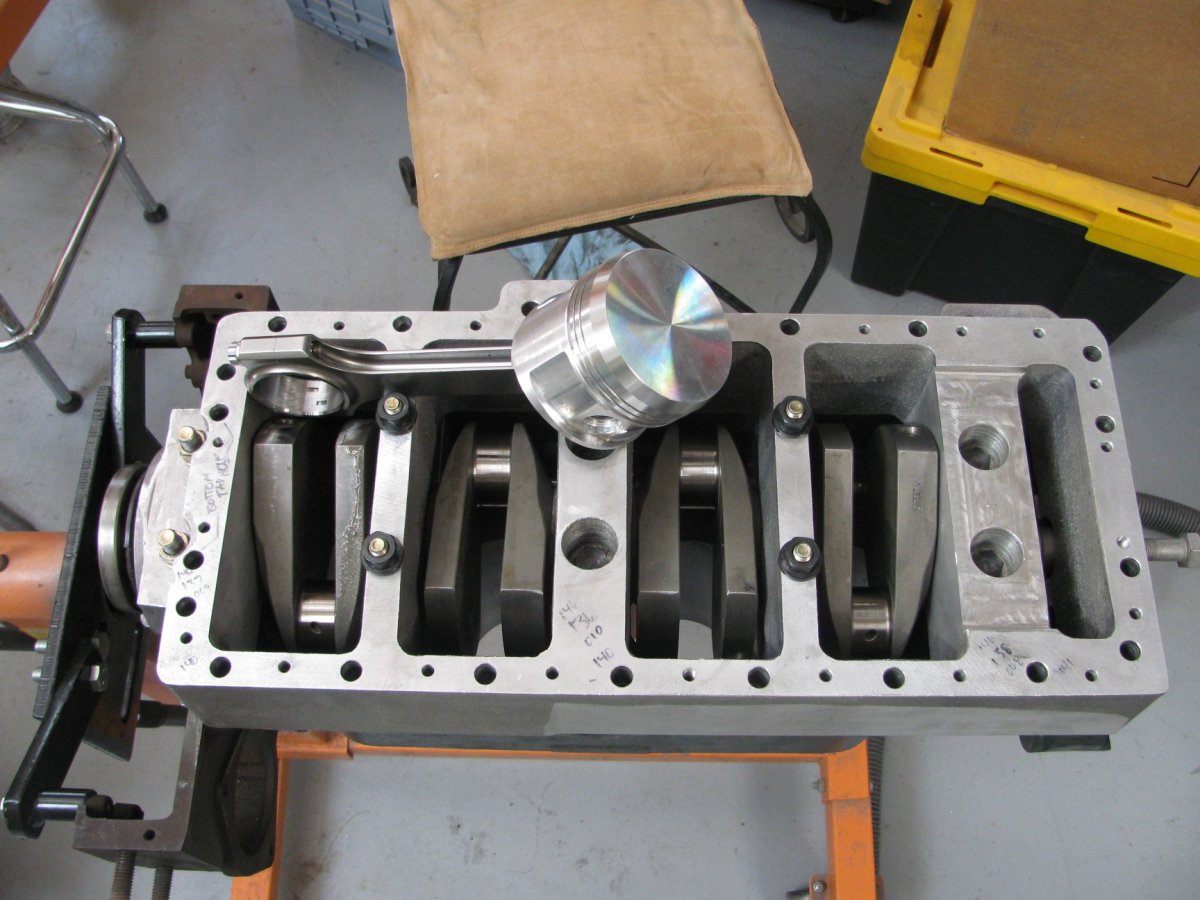

  27. nutrocker,
    if that bottom end lets go, shoot me a call, I might have the solution.
    John
    kb9jlo, Outback, ottoman and 5 others like this.
  28. nutrocker
    Posts: 444
    nutrocker
    Is that the new block or a girdle with the extra mains. I can’t run the new block as it takes me out of Vintage class, but I can run the crank with a girdle.
    Outback, kb9jlo and poshdbs like this.
  29. Nut rocker
    It is girdle on original block
    I am in same place no new blocks allowed
