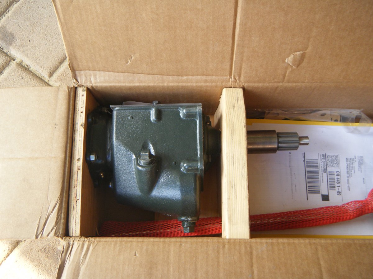

    Yep I had the Mitchell synchro gearbox and Mitchell over-drive in the "A" pickup that I sold. Loved them both. They made for a good combination. DSCF2029.jpeg Image 19-08-2016 at 7.25 pm (1).jpeg

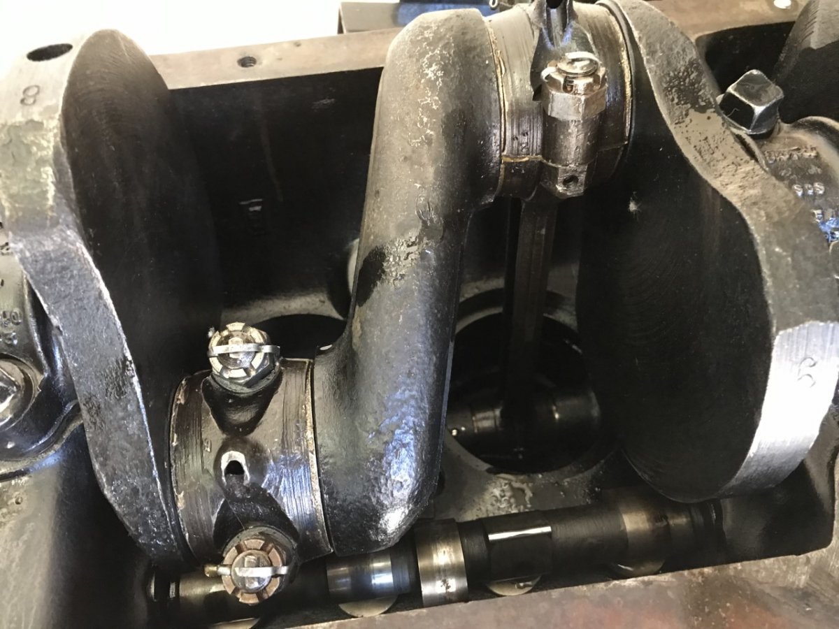

    In the bird's eye view, the dipper looks nubbed off and it made me think of the rods in my roadster. The dippers were all short, one was maybe only 1/4" long. No idea why. I couldn't find a measurement for just the dippers. In pictures of new rods, they appear substantially longer. Does anyone have an unmolested one to measure?

    I have the Mitchell transmission in the Cabriolet behind a Flathead A engine and the Mitchell OD.
    It has syncro second and third. I got the one with the longer split between 1st and 2nd than stock.
    I put a V8 clutch assy at the same time.
    There is a lot that I like about it but some, not so much. I've not had any issues with the OD assy
    The transmission pops out of gear under deceleration
    You can feel the gear slack in the shifter....you know, moves it back and forth, forward and backwards as you change the thrust direction moving the right pedal.
    I got the box straight from Mitchell. You send them the housing, front bearing retainer and shift tower, less the shifter.
    I picked a primo one to send to them.
    I am sure I got someones worn one back. I am sure that the movement has to do with internal wear that was overlooked or dismissed.
    I complained and I was told that the reason that it pops out of gear is that they install bushings in the tower for the shift rail and they will have a flashing on them and to take the shifter out and clean that up.
    Well if that is a known problem, for the coin these cost, don't allow it to be a customer problem. Correct it while you have it.
    About 8 months after I get the transmission, I get a demand letter from them stating they never received my core and I needed to square up with them.
    I will not purchase another. I hope your experience is different.
    You asked....can you say T-5
    Jet96, Binger and railcarmover like this.

  13. Could the dipper length difference be related to the diameter of the journal?
    If dip tray is X from pan rail the shorter dipper on B motor is due to increased diameter of bearing
    J
    Jet96 likes this.
  14. winduptoy
    Joined: Feb 19, 2013
    Posts: 4,101
    winduptoy
    Yes I got thinking about that after I posted the A rod. Not much gets past John, lucky to have him here.

    Thanks you guys, I appreciate the different looks. It's an "A". I probably wouldn't have thought much about it except #2 was noticeably shorter. The babitt didn't show any sign of lack of oil and I didn't feel comfortable heating the cap enough to build it up with braze so I just keep it full and run it. I don't buzz the hell out of it EVERY shift, so...
