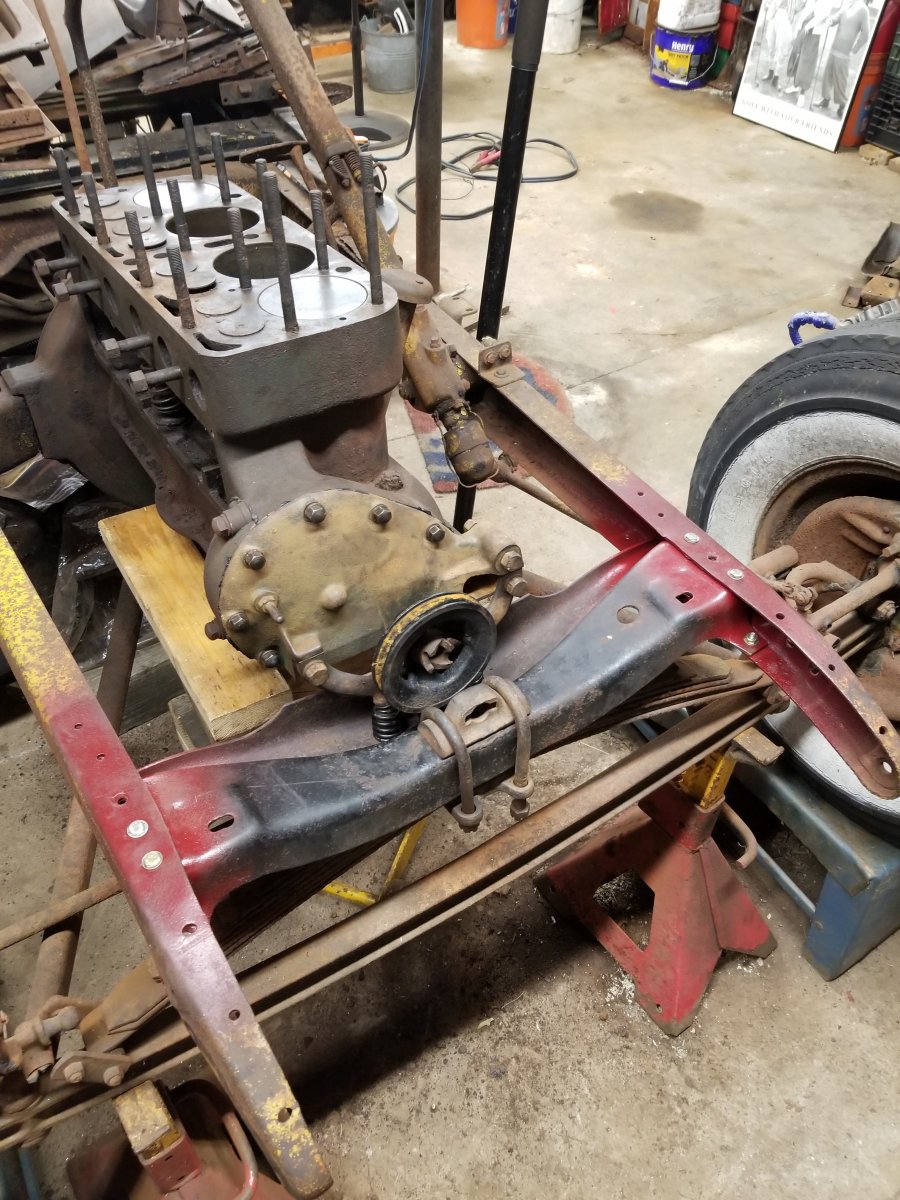

    I am in the process of putting my A motor back together. I took it apart last year and was careful to clean, label, and bag all the parts (my first banger) and I do not remember a spring or plunger behind the timing cover, am I missing something? 20200811_195049.jpg
    Note: I did not pull out cam or crank gears.
    Man, I hope I didn't mess up. . . .

    On the inside of that little round "bump" (center of timing cover) there should be a little spring and plunger.
    I bought a new spring and plunger from Snyder since mine were missing.
    winduptoy and wheeldog57 like this.

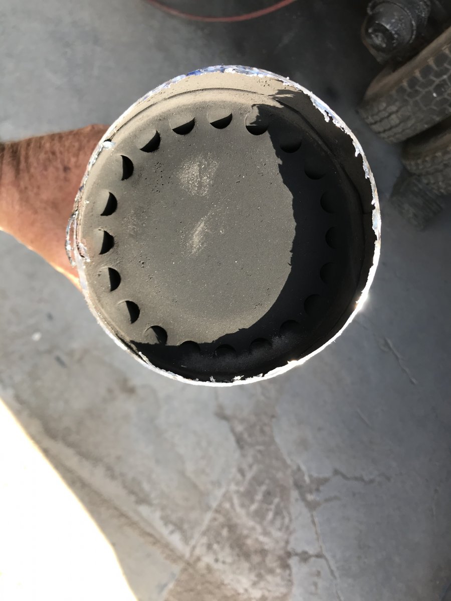

    E94CDBAC-9F24-4BDA-AE8E-17849E2EDB08.jpeg The shadows make the holes look bigger- they were punched in maybe 1/8"...small end had six 1/4" holes. Loud as these things are with a straight pipe I was surprised it wasn't a lot louder. Rewarding little project for sure...

    I went over to see Ricky at Rayco Machine this morning. He said "yes, you definitely need that spring and plunger. If not your cam will move out and break stuff" of course he had these in stock. Ricky is straight out with work now because he does Babbitt work on anything you bring him. He took the time to answer my stupid questions and locate the parts I needed in his vast collection of goodies. Thanks Rayco
    waxhead, winduptoy and Jet96 like this.

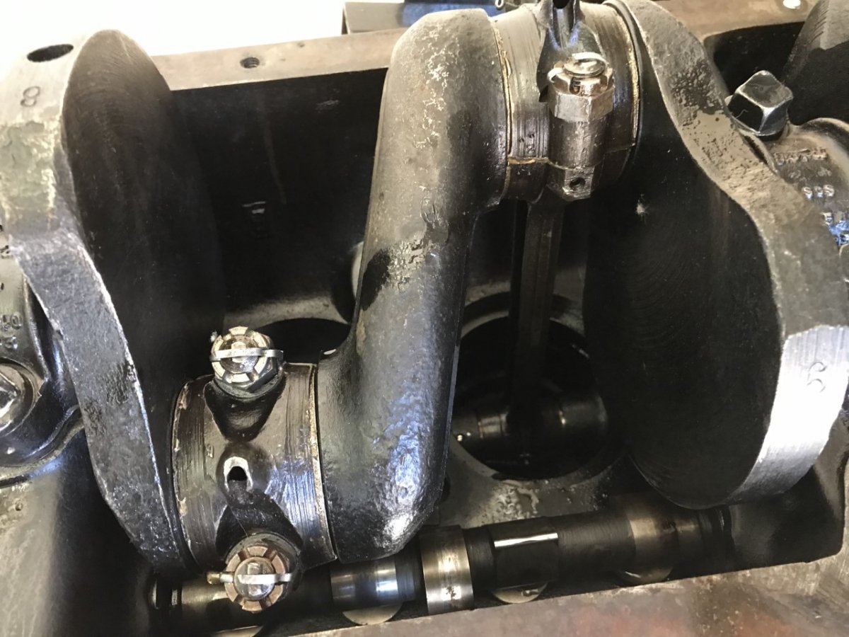

    GuyW, 1949*john, kb9jlo and 5 others like this.

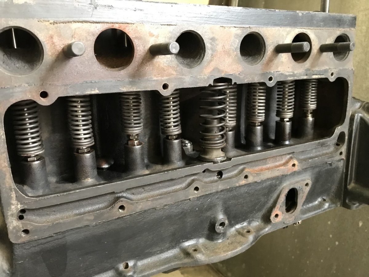

    Valve springs are in, as is the drive mechanism for the distributor and oil pump.
    Looking more and more like an engine.
    The threaded hole that is seen in the center of the block (to the left of the fuel pump mount), what is it for?
    Oil pressure sender?
  29. V4F

    Why does the 2nd spring from the left look like it is bent in a curve?
