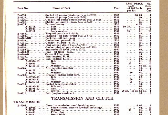

    So, I picked up the oil pump for my B-engine.
    According to the guy I bought the engine and car from the B's didn't have the spring between the oil pan and pump to hold it in place, just a locking screw from the side of the block.
    Is this information correct?
    I don't wanna end up with a pump that falls down in to the pan :rolleyes:
  14. Mikko,
    I have never seen a "B" motor with retaining screw holding pump in.
    That said, I could be wrong, there are so many different option available today.
    But, in the 1932 parts list, it shows the pump retaining spring.....
    Show us your pump, it may not be stock.
    John
    GuyW, winduptoy and Mikko_ like this.
  15. hardtimesainit
    Joined: Jan 24, 2009
    Posts: 626
    hardtimesainit
    No !
    Not correct, IMO and experience.
    In fact for decades, a hole has been made and tapped for a fastener which holds the pump up to the blk. I put red loctite on bolt because of vibrations of these A/B engines and other reasons.
    Additionally, if possible, i use the original spring ...sometimes modified to fit...insurance/ peace of mind control vibrations. But others may have a better way.
    Jet96, winduptoy and Mikko_ like this.

  19. Mikko_
    Joined: Aug 3, 2018
    Posts: 653
    Mikko_
    from Sweden
    That's what I thought, I'll put a spring in there so I don't have to worry.
  20. railcarmover
    Joined: Apr 30, 2017
    Posts: 778
    railcarmover
    that spring saves the cam drive gear.
    Mikko_ likes this.
  21. Railcar,
    can you expand on this?
  22. jim1932
    Joined: Jan 26, 2011
    Posts: 1,165
    jim1932
    To my knowledge, Ford put the hole and set screw in, I was told you use it to hold the pump in, till you get the pan on them back the set screw off so it rides on the spring.
  23. railcarmover
    Posts: 778
    railcarmover
    If the pump or the distributor gets momentarily jammed the springs on the distributor drive or the oil pump allows it to drive away from the center cam gear..
    Why did ford spring load the oil pump,distributor drive and camshaft thrust if not to allow movement to counteract load and shock?
  24. That is an interesting view of the springs used in the assemblies.
    You could be right, or it could have just been a simple way to assemble the said parts and not require tight tolerances in the manufacturing process.
    John
    Posts: 778
    railcarmover
    You could very well be right. Power sent from the center of the camshaft already under valve spring load and imperfect applied load from the crankshaft sends power 90 degrees to the varying load of the oil pump and the light constant load of the distributor.Gears tend to drive away from load,the oil pump alone must float up and down from differences in viscosity..my engine has a steel lube line from the pump to center main and my cam thrust is held by a thrust button..been thinking about the cause and effect of eliminating the travel of the oil pump and cam...Ive found ford engineering to be right way more than wrong :)
