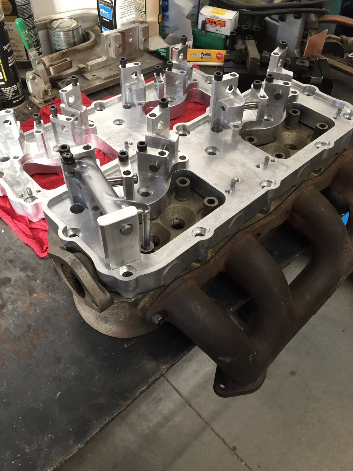

  1. Part of the problem putting the valves in the head same as the Ardun is the pushrod locations.
    The intake side is easy as a long rocker can be used, not so easy for the ex.
    Now, if you make a SOHC or DOHC, it is possibly easier but the drive mechanism may not be so...

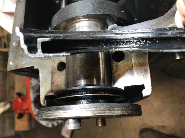

    Finally had a chance to take my cutdown banger project out to an event last weekend. Went to the #estranged_cc drags up in Toutle, WA at Riverdale Raceway. It ran really surprisingly strong for a warmed up B engine - 63 mph in the 1/8!
    I'm having problem with a heavy and pretty constant drip of oil coming out the bottom of the "bell housing"/oil pan hole where the bent over cotter pin lives - what I'd call a rear main leak. Any suggestions on how to fix or at least slow it down? I've pulled the pan and flywheel off. The drain back tube is not plugged. The slinger looks to be in good shape. I don't think it was leaking down from the rear of the cam shaft. I do have a lot of blow by as the engine has seen a lot of miles/hours (came out of an old farm truck). I am not dis-***embling the engine any time soon - so the grinding the slinger down and adding a one or two piece seal is not an option at this time. Any tricks or suggestions? I'm intending to get it back together and head to the RPM Nationals with it in a few weeks.

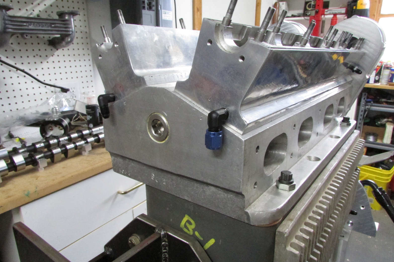

  8. Dan,
    I started and abandoned this using the mod motor roller rocker arms, I like the bucket design better.
    Especially if I can get some radius top Offy ones!!
    Old Dawg, Jet96 and Crazydaddyo like this.

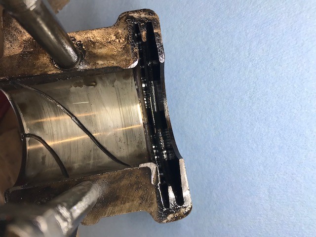

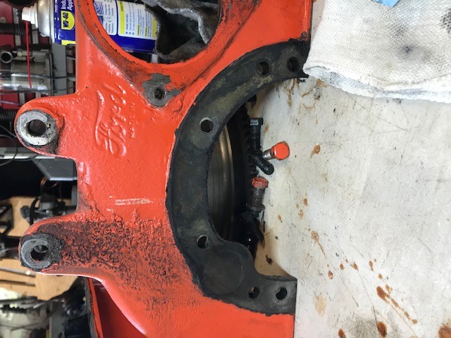

  14. BeaverMatt
    Joined: Jun 17, 2013
    Posts: 61
    BeaverMatt
    Here is a pic of the flywheel cover. Gasket is there. Quite thin and stained, but there. There was not any wet leakage on the back of the block from this area.
    I'm also providing a few images of the rear main "seal" and oil slinger area. Is there supposed to be a gasket or seal of any kind here?
  15. Kevin Pharis
    Joined: Aug 22, 2020
    Posts: 829
    Kevin Pharis
    from Califunny
    Did you check clearance on the rear main bearing...? You might find that it only takes a few tho of bearing clearance to overwhelm the slinger...
    Old Dawg, railcarmover and BeaverMatt like this.
  16. You may be on to something , the crank looks like riding only last 1/4" or so on the babbitt.
    Also, there should be some sealant on the cap back edges. I took one apart last year that did not leak a drop, the last person to ***emble JB Welded the shims in place and the rear of the cap. What a bear to seperate...
    J
    Old Dawg and BeaverMatt like this.

  19. hardtimesainit
    Joined: Jan 24, 2009
    Posts: 626
    hardtimesainit
    Well, if you know that it was sealing… well. But, it doesnt look right to me. Look ragged where “dirty” colored (oil stain?) area above gasket.
    Do you have high pressured oil …. that can come past that gasket… such as it is ?
    I’m just getting a B back near running. It had a bad leak right at that gasket. I put new gasket with smear of non- hardening permetex.. on gasket.
  20. BeaverMatt
    Posts: 61
    BeaverMatt
    @hardtimesainit that dirty area above the gasket is caked on dirty/grease from over the years that this was in a farm truck. I hadn't previously had the cover off before this. When installing the engine I s****ed and wire brushed most of the exterior of the engine prior to painting, but couldn't reach behind the cover.
    The oiling system is not high pressure, its as Ford made it in 1932. It looked to me like the gasket was sealing, but its an area I'll definitely pay attention to - and use a bit of sealer on.
    @Kevin Pharis & @johnneilson - I like what you are saying about bearing clearance and sealing the main cap. I'll check clearance and then the cap seal during re-***embly. The cap had just one shim.

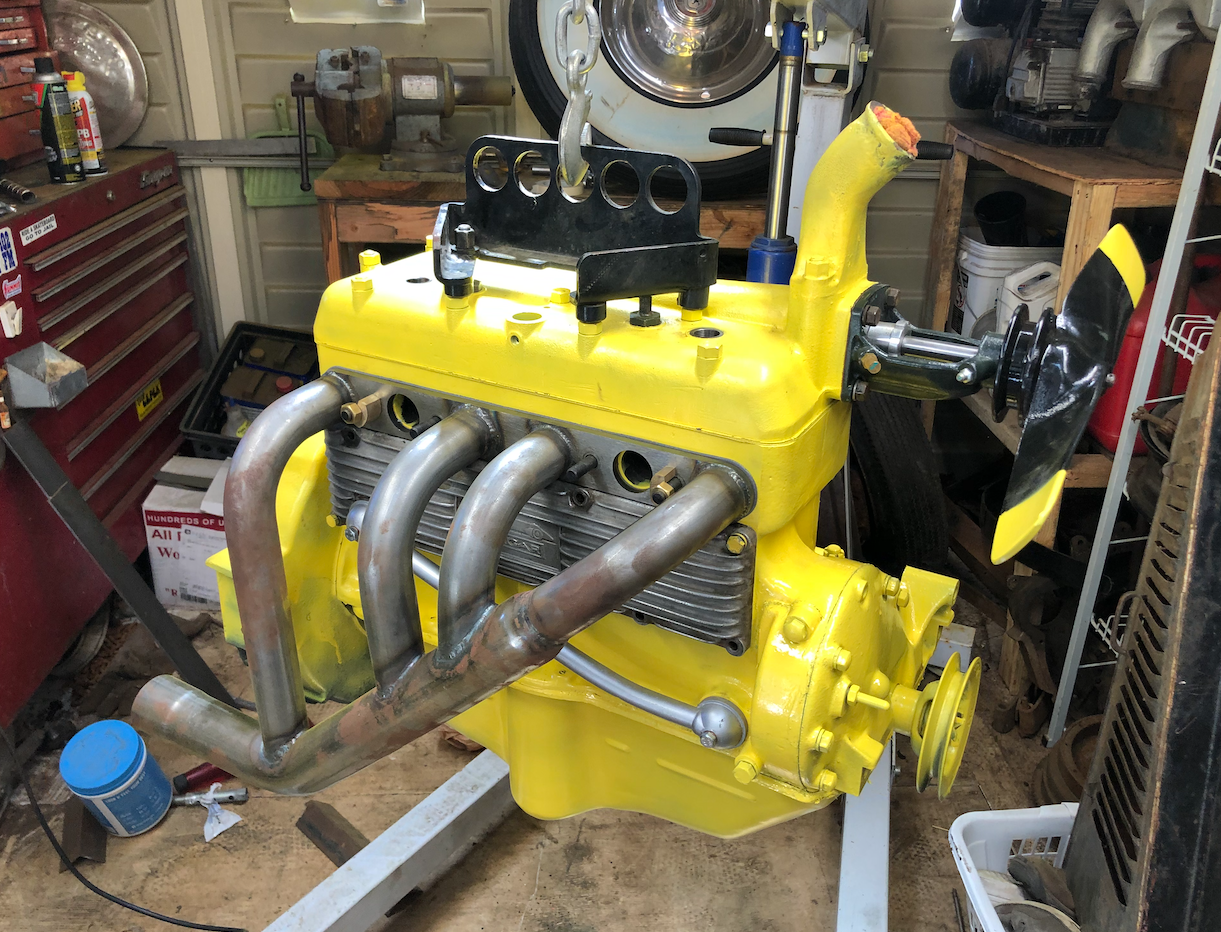

  25. Welp, got the engine closer to running! Still need to get safety wire for the flywheel, and to paint a few more things. Is the yellow TOO bright? Screen Shot 2021-08-30 at 9.14.17 AM.png Screen Shot 2021-08-30 at 9.14.24 AM.png

    noboD
    You better get permission from Rich Fox. That's his patented shade, but I doubt he would ever work on a Ford.
    fur biscuit and Jet96 like this.
  27. My banger isn't even 1/10th of the power of his builds! I'm a big fan of his plymouth banger

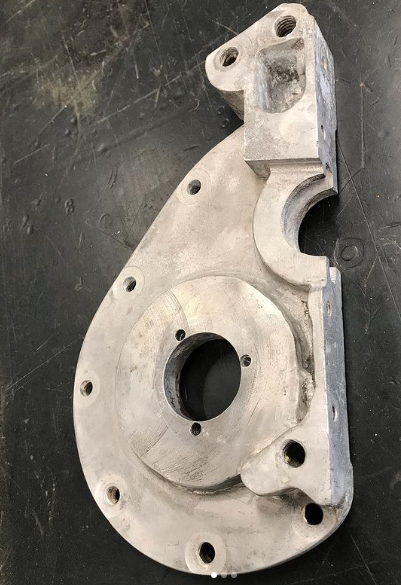

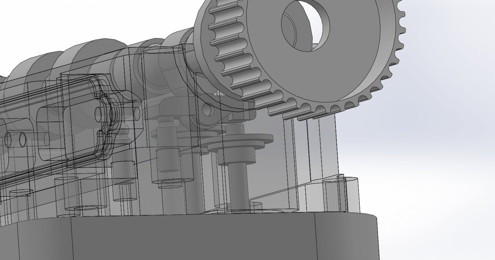

  28. Side note, I'm looking at this front timing cover, and trying to understand how someone would run a mag or water/oil pump off the cam. Anyone have any input on this?
  29. Maybe like this?
    Jet96, Dustyp489 and Old Dawg like this.
  30. That's what I'm thinking. Are you running a coupler on the cam gear?
