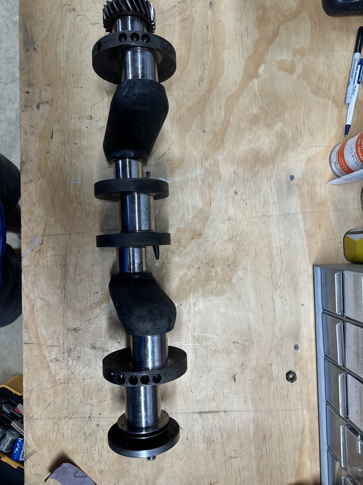

    Ford dynamically balanced their crankshafts prior to counterbalancing them in late ‘32.Dynamic balance means the crankshaft is balanced as a rotating unit, Counterbalance is adding weight to counter the impulse from the power stroke.Find a good book on the four cycle gas engine function, it will help you understand how things work. Please don’t take this as an insult, reviewing the basics helps all of us, master mechanic, journeyman or apprentice

  8. I would really like to see the book that claims the crank counterweights are to compensate for power stroke impulse.
    Sorry, that B crank does not have counterweights on it
    It is an example of the first cranks made for a model B motor
    Those holes do not appear to compromise the unit
    As long as not cracked it is serviceable
    J

    Never said the crank in the picture is counterbalanced. The counterbalance offsets the inertia weight of the piston/ rod, which does dampen some combustion stroke impulse..but hey, I defer to you, you are clearly the engine builder, I’m just an old mechanic.

  10. Railcar
    That sounds better, spell check must have erased the inertia part
    Not that you id’d the crank as counterweighted, it is easy to mistake those for cw’s if you have nothing to compare to
    This is all learning for everyone alike new and old
    All good, J

    I’m sorry I referred to the portions of the crank that are drilled as counterbalances. They are clearly not counterbalanced. I do not know what those portions of the crank are called that are drilled.
    Thanks for the term dynamically balanced as I didn’t give it thought either.

  12. Asking questions is how we learn
    No harm in your questions
    J

    Ford dynamically balanced, meaning the the crank was spin balanced prior to ***embly.. Ford began counterbalancing 4 cylinders in late ‘32..in actuality only achieving a 40% counterbalance.. The Burtz is counterbalanced 100%…According to those smarter than me..

    They just keep multiplying. Picked up a complete B engine, a B transmission and a counterbalanced crank. The block the crank is in, is no good. If I’m lucky the block from the complete engine will be good. It also has a counterbalanced crank.
