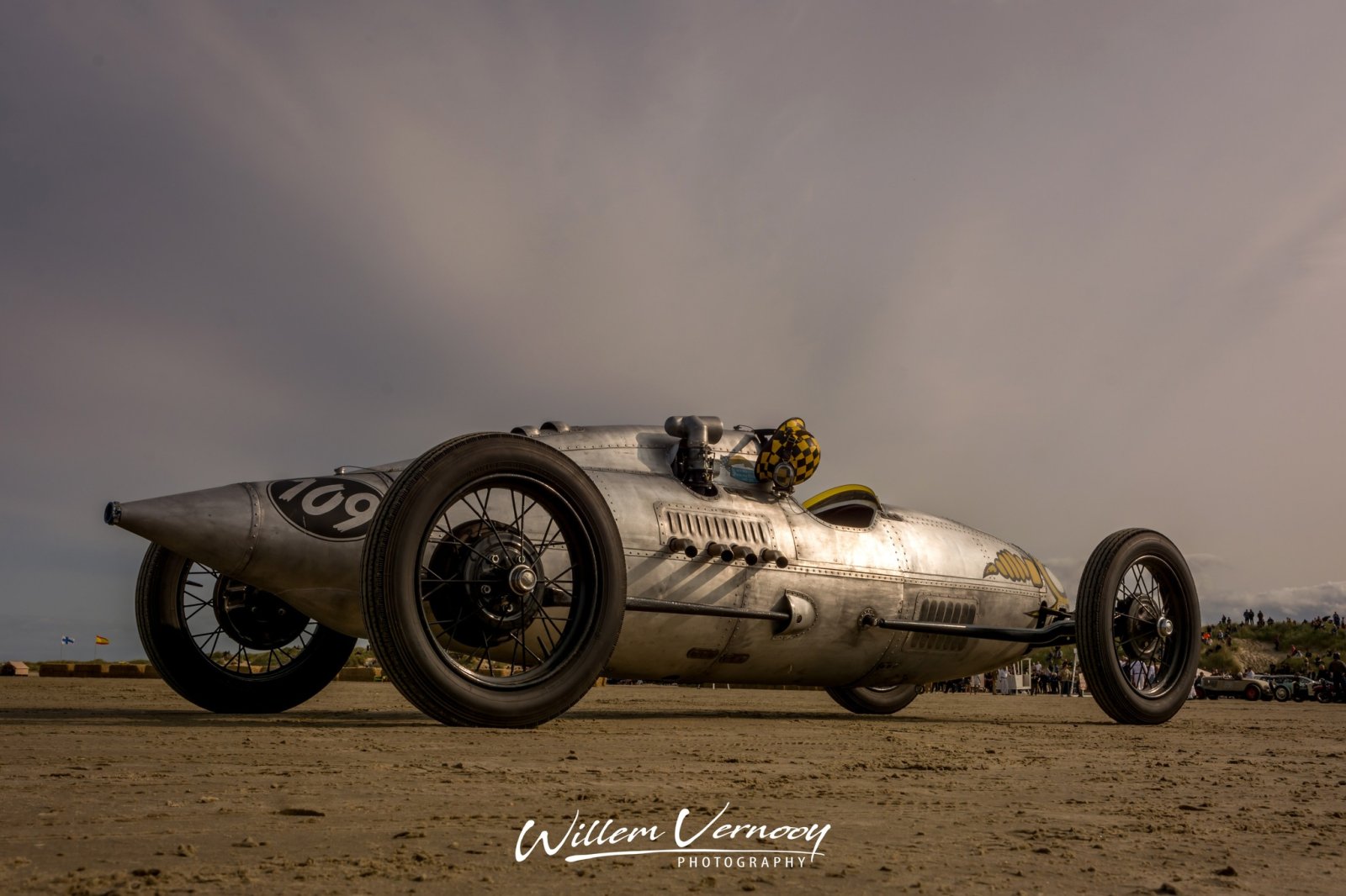

    456070477_8186673654746048_5080841138708407801_n.jpg i was racing with the fourbanger belly tank on romo beach.
  2. It was a beautiful thing too.

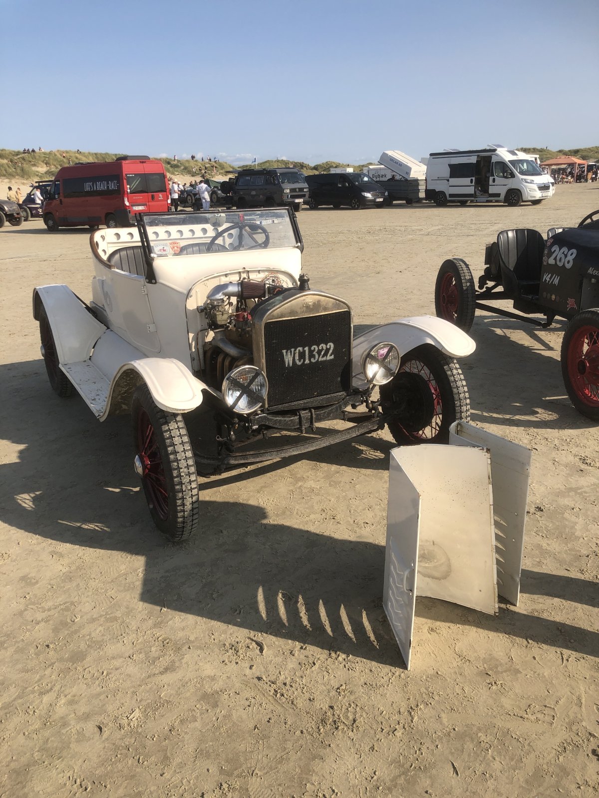

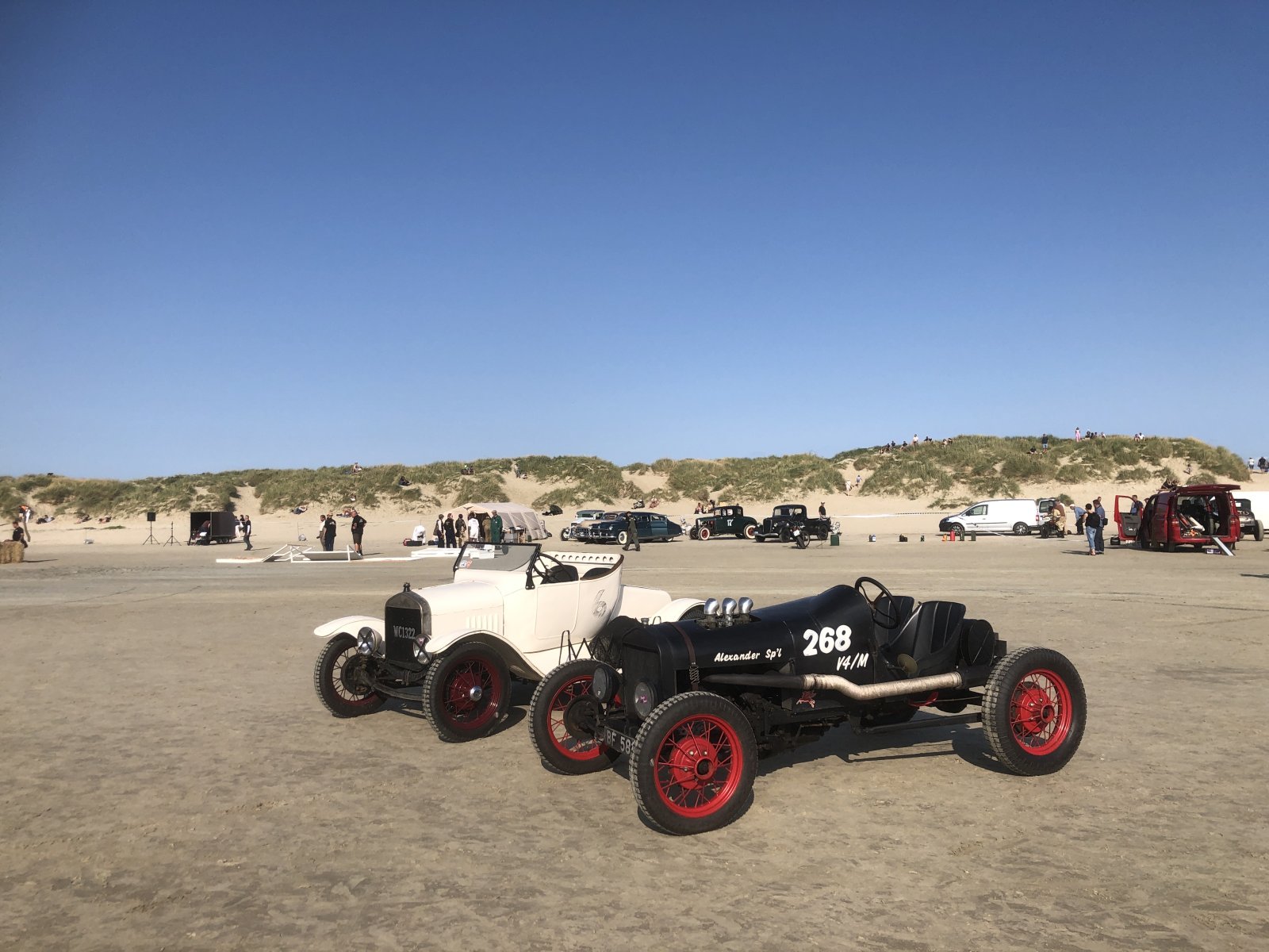

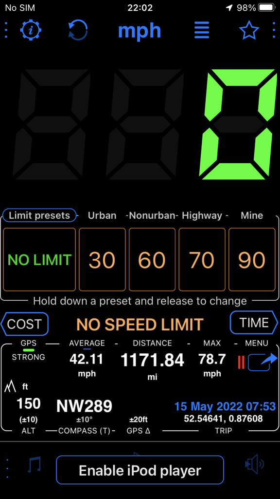

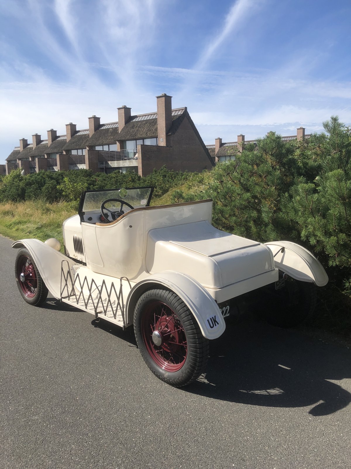

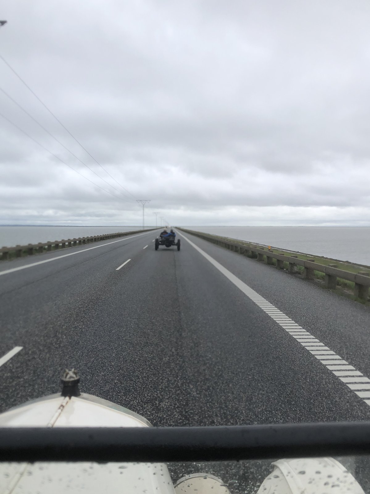

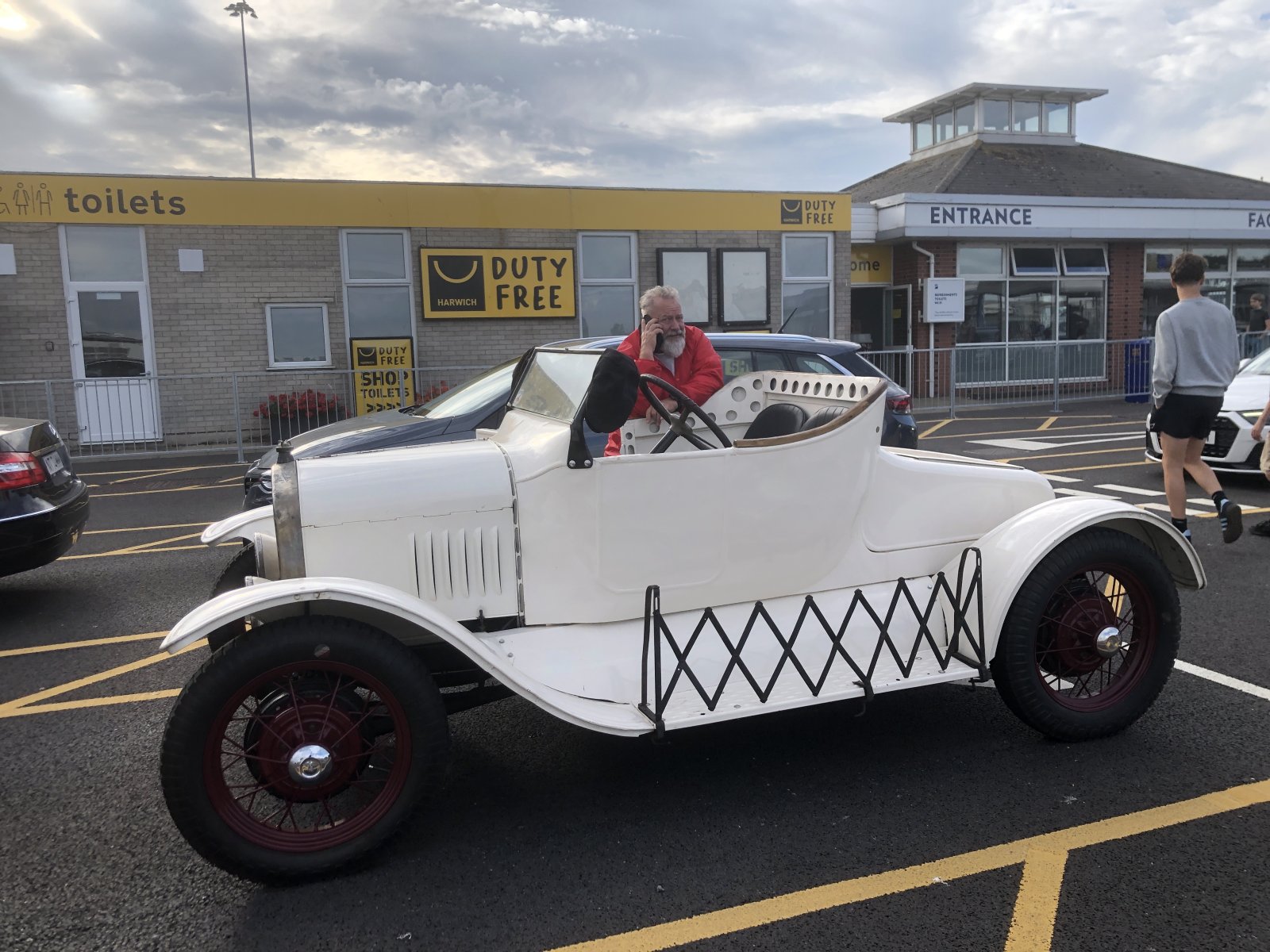

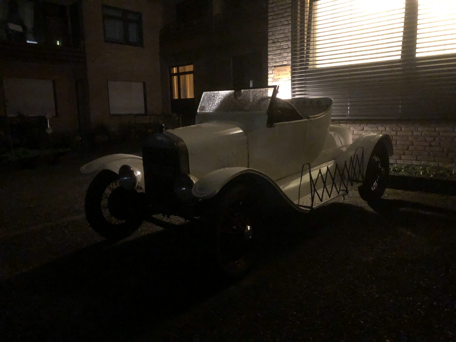

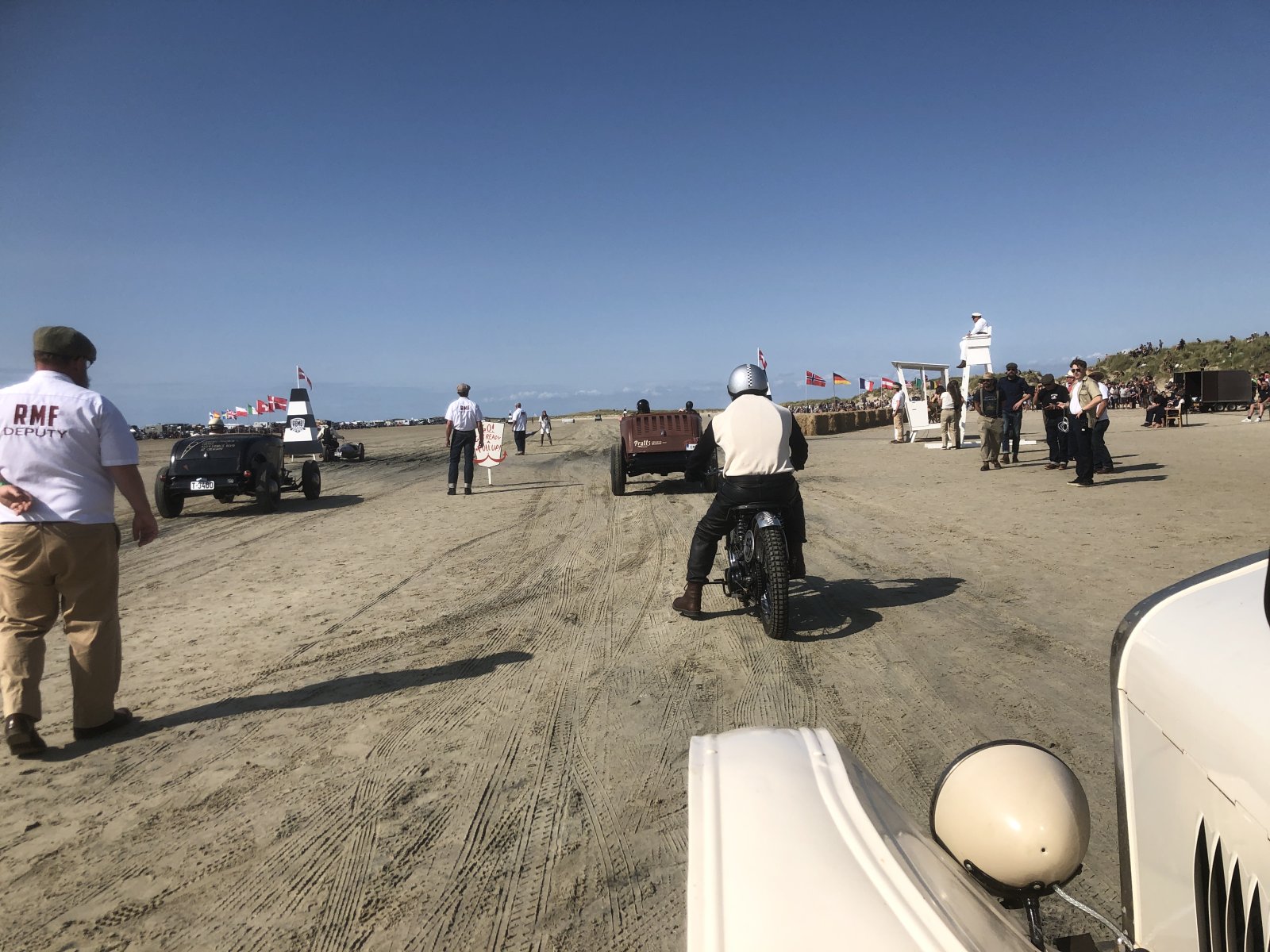

  3. So the little Cream T did me proud at Romo.
    Drove there through four countries, raced all day on the Saturday, and drove home.
    IMG_5436.jpeg IMG_5446.jpeg IMG_5448.jpeg IMG_5450.jpeg IMG_5462.jpeg IMG_5522.jpeg IMG_5543.jpeg IMG_5559.jpeg IMG_5561.jpeg

    Good job there Fil...you should be proud and looks like the place was full of fun

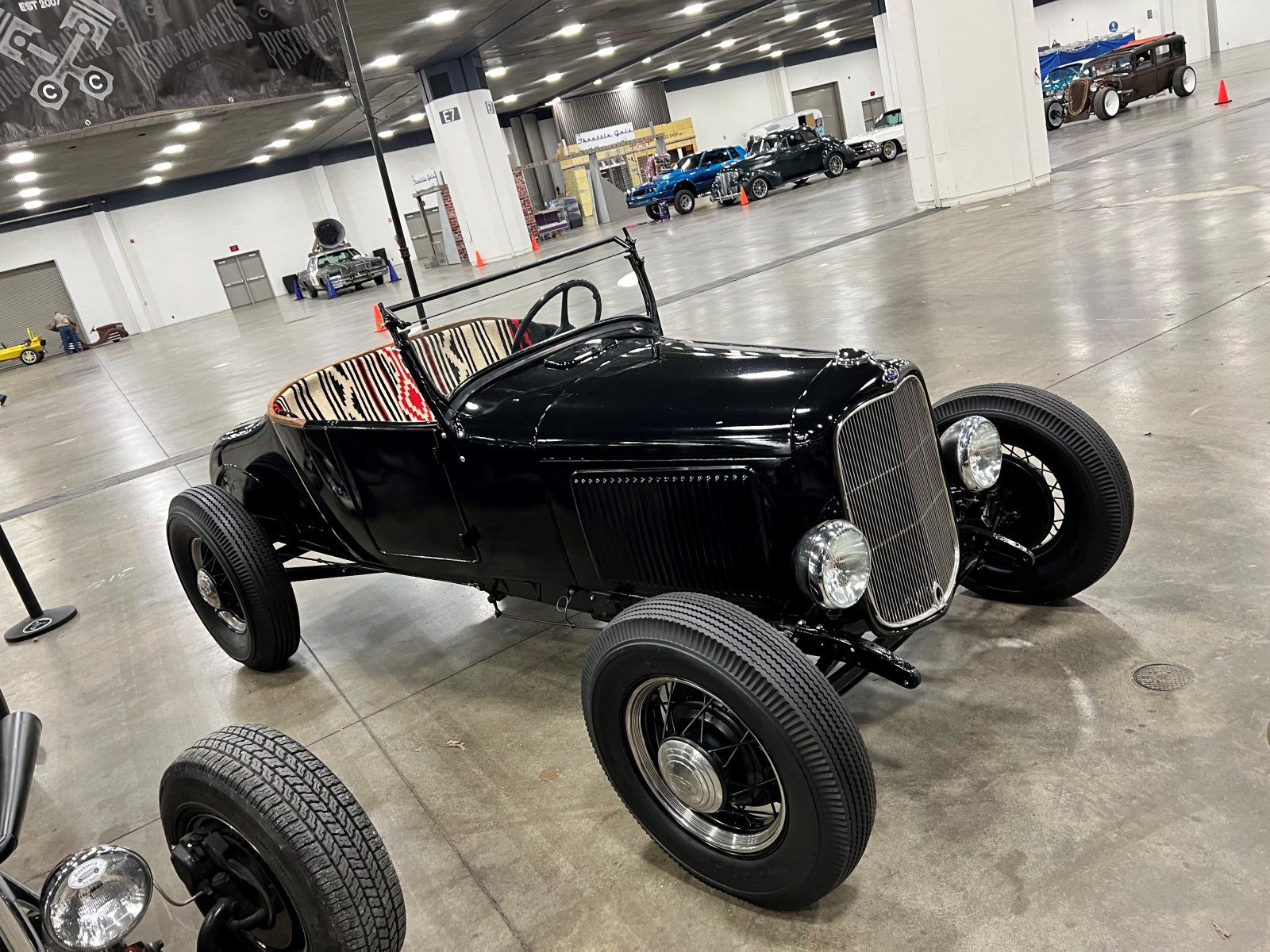

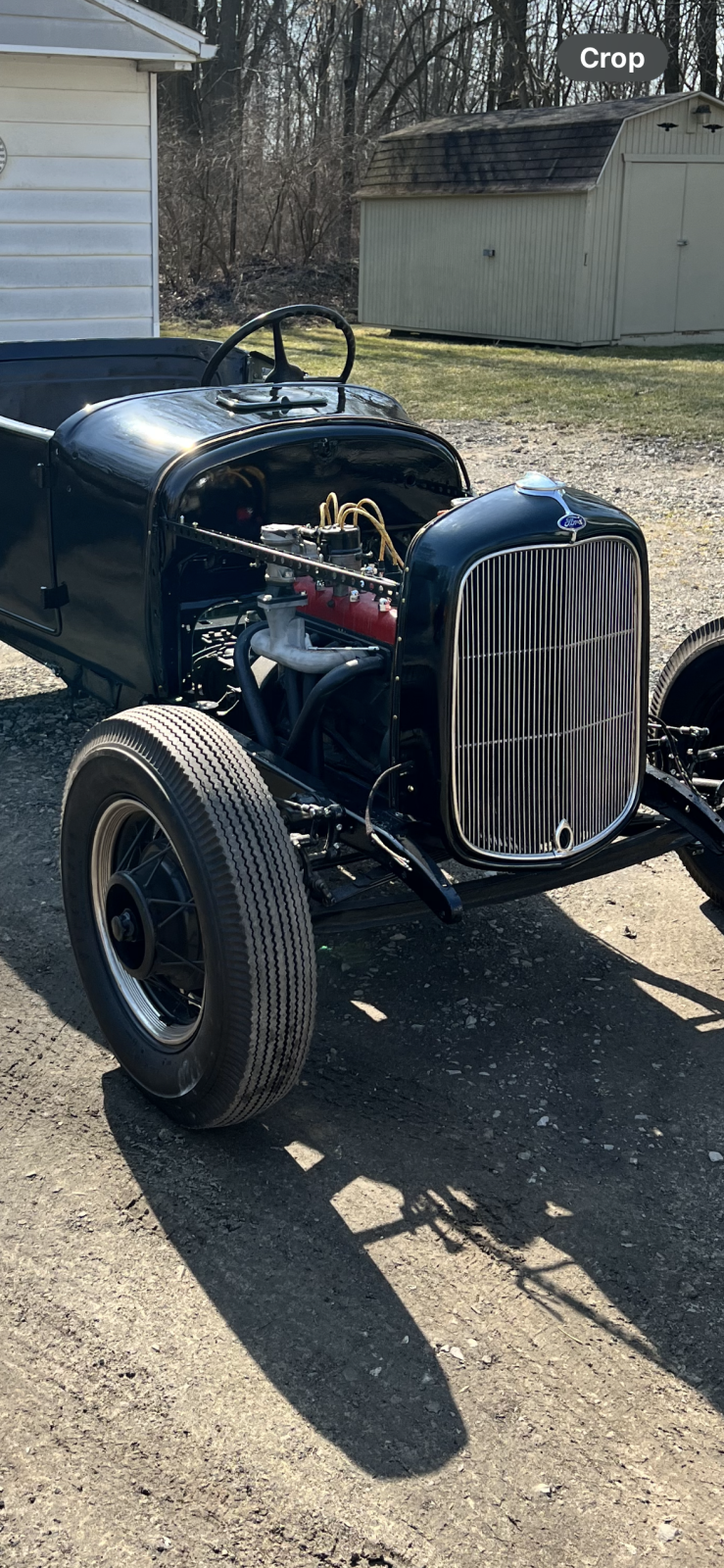

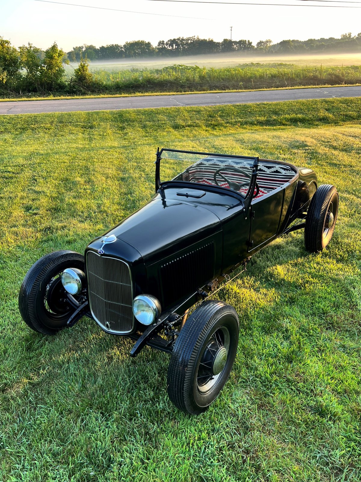

    Here's a roadster i've been working the bugs out of. roadster.3.jpg roadster.png roadster1.jpg

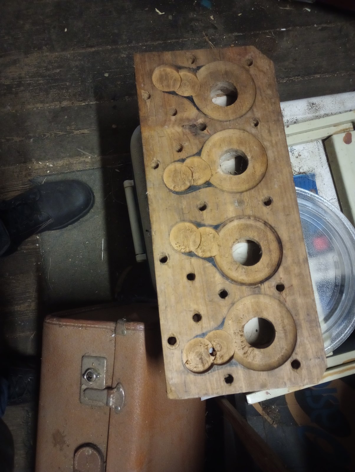

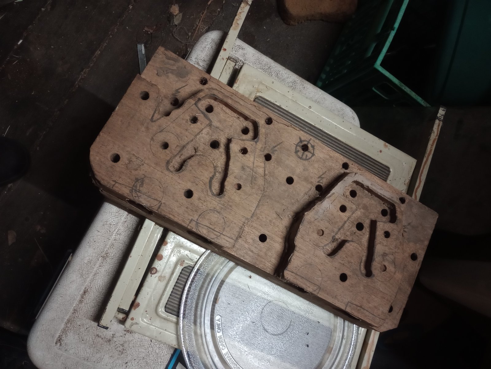

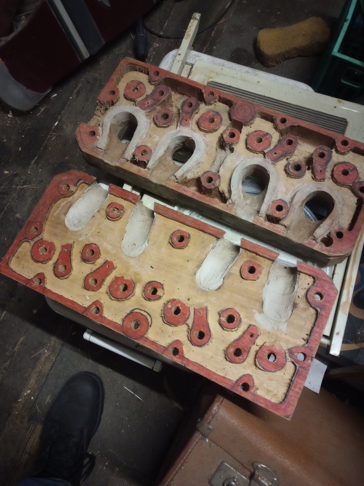

    6b62e228-9179-4667-91e6-b355df3a9ef2 (1).jpg a8ebaf68-5e5e-4e67-9928-d687bbb7ad97 (1).jpg d8523496-343b-4baa-8eae-60962dbad5c5 (1).jpg This is something I thought you lot may be interested in.
    These are some half finished F-Head (Inlet over Exhaust) patterns that have been kicking around in my collection for 20 years. I bought them in a job lot of banger Engine parts.
    I have been amazed at what has been made in Aussie backyard's over the years & no doubt other countries.
    As you can see it has been made as a 2 piece head, & a single inlet valve, I don't know what the plan was for valve gear, but we'll work that out in due time. Of the other F-Heads out there, how many were a single inlet valve?
    I would love to be able to run a head I have had a hand in, but that won't be happening for some time I expect.

  11. It is very satisfying to have a hand in the construction of any component especially cylinder heads
    That chamber is reminiscent of the Art Sparks design that if I remember went to Indy500
    Now I will have to go look it over closely again
    Keep going on this project and keep on the updates
    J

    That is some encouragement @johnneilson if you happen to have some pearls of wisdom or insight on what to try & aim for I'd love to hear

  13. I don’t know about wisdom, maybe some realism
    It will cost you more than you expected
    You will not make a profit or don’t expect to make a profit
    Material should never be conserved in casting
    Especially in aluminum thicker is better you get no points for light weight components that leak or crack
    Enjoy your build J

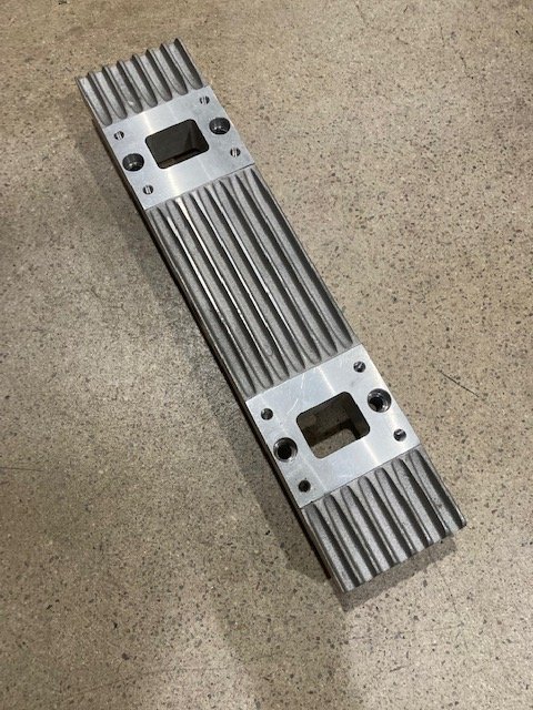

    Have you seen the adapter plate Neil Jern offered? it just extended the distributor vertically and dressed up the right side of the engine. Extending or making a new Model A/B distributor shaft is incredibly simple.

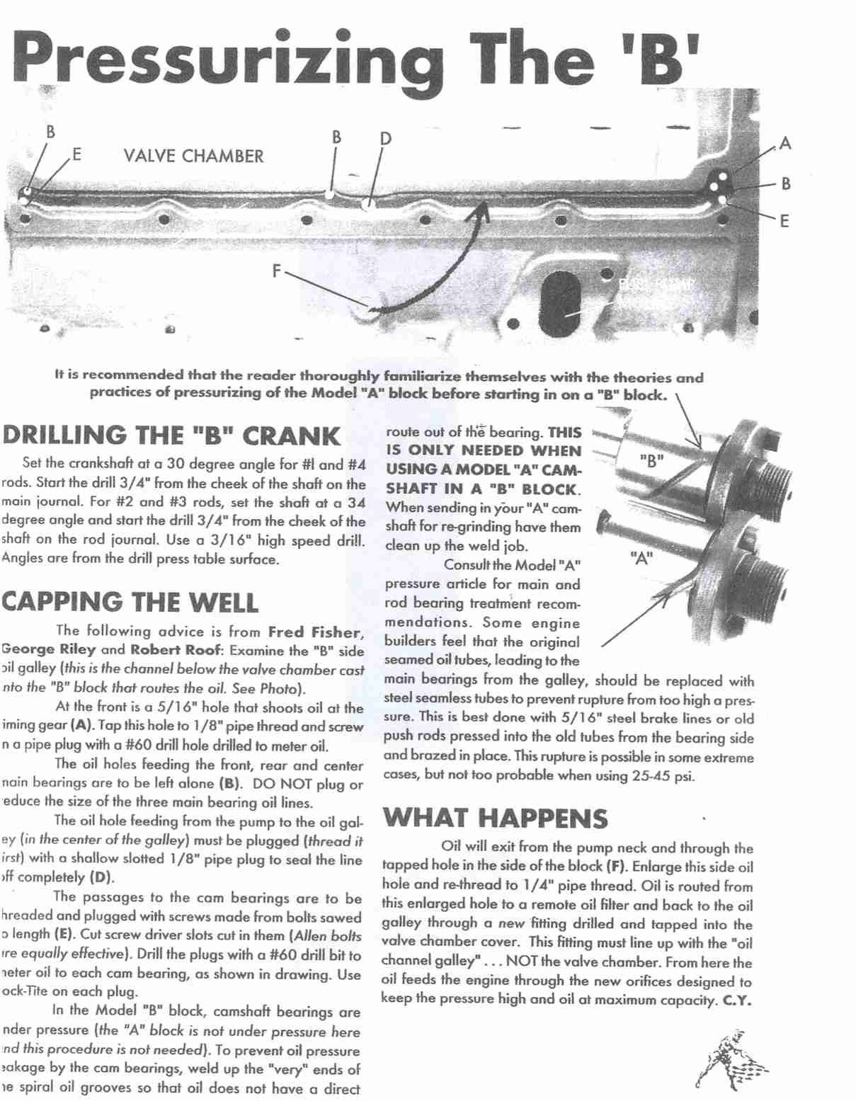

    I have hopped up A's B's and a Burtz....
    From my experience...it depends...
    If you have a good B engine with a counterbalanced crank modern main babbitt material is good ...great... even for a 7.1 to 1 CR head
    I 'cap the well' with the Riley guidance and modify an A/B pump for pressure oiling the block and mains
    Dipper inserted rods are an upgrade below an extended 4000 RPM engine speed....is the guidance I have followed with success.....but that is with a modified oil pump and the relief to 'keep the dipper tray full' for oiling the rods.
    Rods with modern inserts are available from Antique Engine Rebuilding....as are modern inserted mains. Modern mains require align boring and fitting the block for thrust surfaces
    I turn the slinger down and install a 'modern' Bertz rear main seal...I have a process and they stay leak free with careful ***embly and additional sealant.
    So, does your A/B block have good modern main babbitt material? Is the deck sound and no cracks?
    The Bertz I built is OK and "they" have different ***embly guidance now from when I first ***embled mine.
    It vibrates no less than my carefully ***embled A/B engines
    It does have 5 main bearings to put up with the 90 degree power stroke and a modern GM rear main seal.
    It also is full pressure oiling...to the rods with larger journals.
    It requires a higher volume oil pump and I used a modified A/B oil pump that I installed V-8 oil pump gears in.
    I drive my B powered flathead powered Cabriolet more than any other car I have
    so, it depends...you might want to talk to the 'Model A Medic in Kansas or Antique engine rebuilding....they have done quite a few of both and some of all of the above...

    Also I’m unfamiliar with the Riley guidance of capping the well. Where can I find this info?

    Wow, thank you for those detailed photos! I only have the adapter plate for the block, so having to cobble the rest of the ***embly together. That is a cool piece. It's a shame he's no longer with us.
