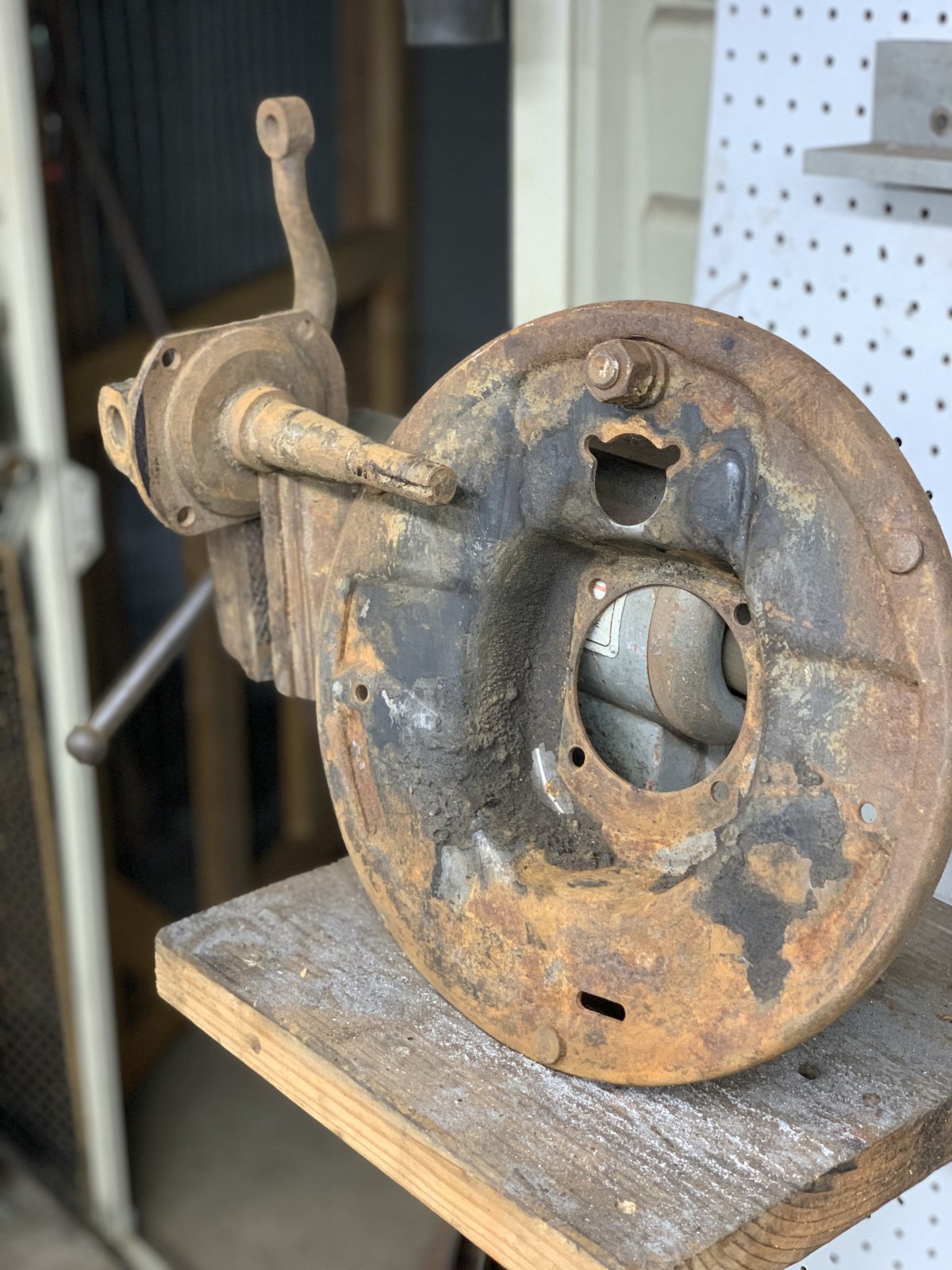

  10. With this being my first week back to work after recovering from a broken arm and wrist, I decided to celebrate with a little wrench turning. Still babying my wrist, but it felt good to get out and work a little.
    Should be firing this up in the next few days, now stopping? That’s a whole other story…
