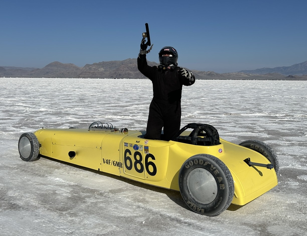

    The week started off with a single run to qualify and a backup run to set the record in V4F/GMR, simple, right?
    Then we became greedy and reentered as a FMR fuel, you know nitro and all that stuff
    Oh well, we will go looking for the lost #2 cylinder later this weekend.

    congratulations!!!!....and for #2 son Rodney leaving the scene...you aren't so much a back of the envelope guy ...more of a push the envelope....

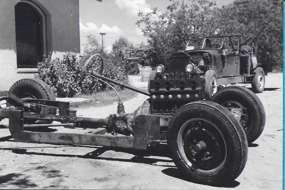

    Looks like a bonafide hot rod to me! McDowell…?

    Looks like Ford trans also, etc, but what's with that frame? Dropped axle yea, but a dropped frame??? Steering column laid back pretty far so...........

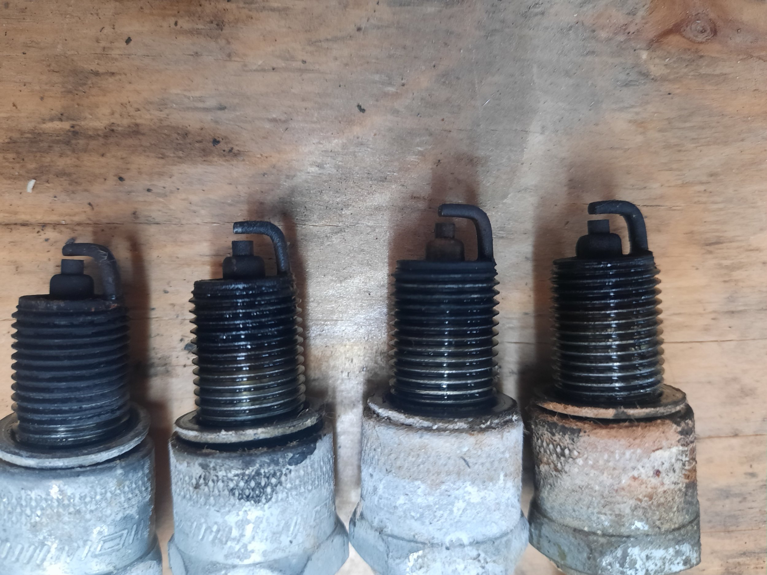

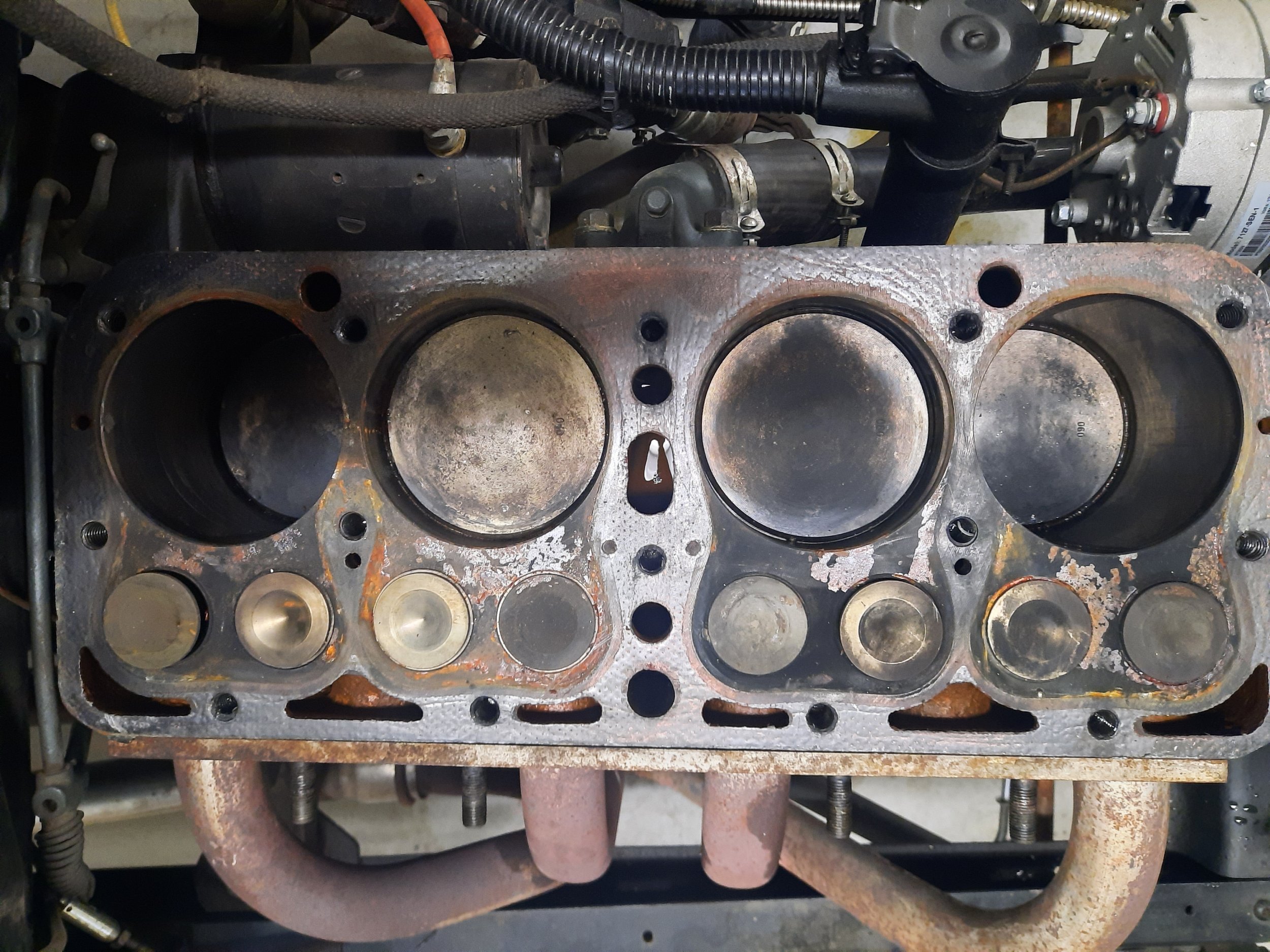

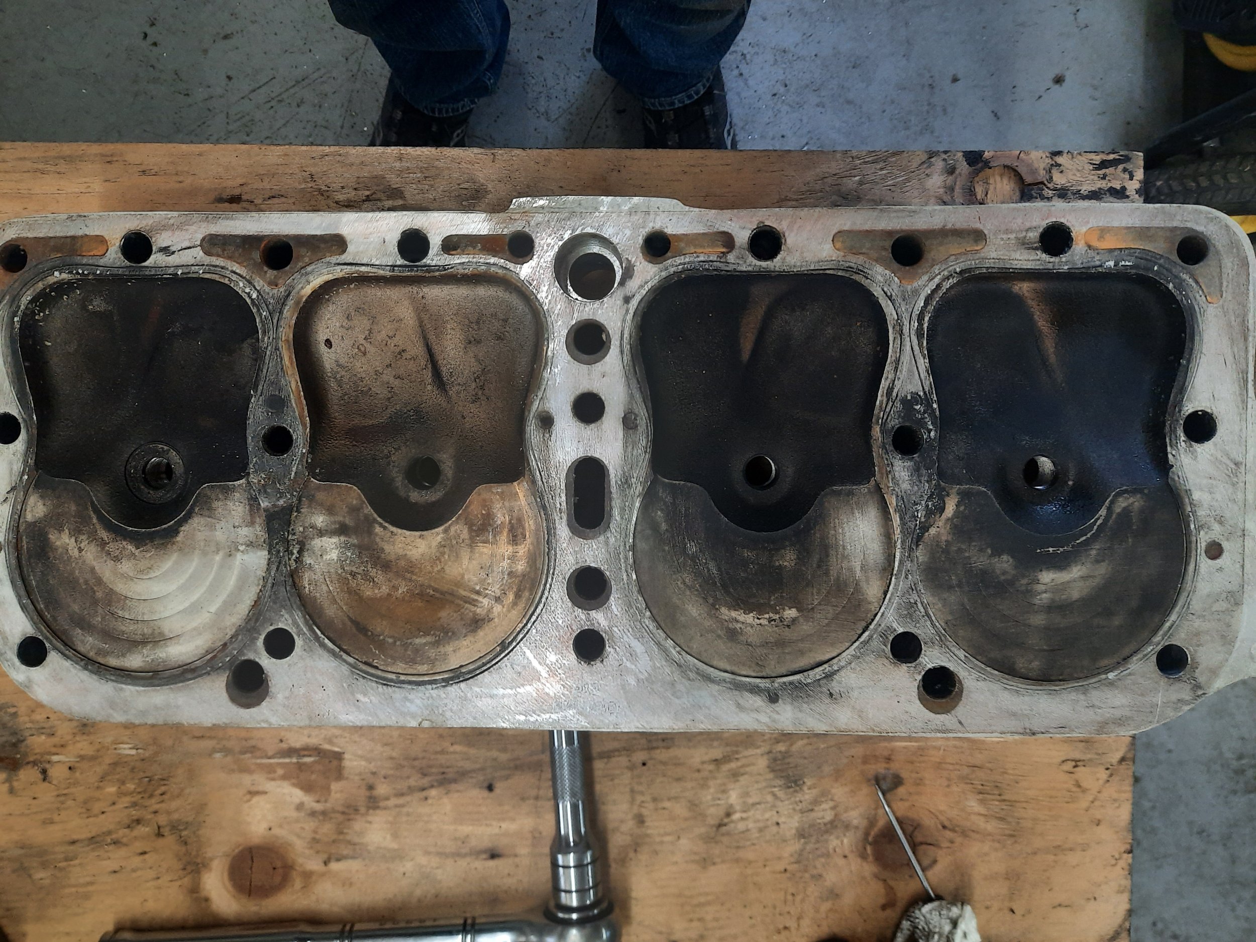

    Late in 2023, I acquired a Jim Brierly 7:1 head and a Yapp Equalizer dual intake. They were installed and ran well all through 2024 and into early 2025. A while back the car started to run poorly and idle at 2000. Earlier this summer in talking to Jim Brierly, he mentioned that I should be running the 18 degree FSI and not the 28 degree which was in engine. I installed an 18, but perhaps too late. This past weekend on a hot rod tour, the engine suddenly overheated and stopped. I could not restart it. Today I tore the engine down and this is what I found.
    The BEST gasket was burnt out between 3&4 and starting to destruct between 1&2
    Cylinder 3 was clean (left to right 4,3,2,1)
    Combustion chamber 3 was clean (left to right 4,3,2,1)
    The plugs looked a little carboned but the gap was correct. (left to right 1,2,3,4)
    The engine was built by Bert’s some years ago, but only came to life in the past four years. It only has about 1200 miles on it. The new head was torque to 65lbs and the surfaces appear to be flat. I’m not really smart on engines and was wondering if anyone had insight.
    Warren

    I can't tell for sure, but the mating/coverage of the fire ring on the gasket to the head looks suspect. Do you have a new head gasket to lay on the head to look at that way? Does Brierley say to use an A or a B head gasket with his head? If there is any fire ring not covered by the head, that is suspect in my mind.
    65 ft lbs is more than I go, you don't want to draw the threads out of the block. I don't know what you have for head studs. Chrome/moly at a minimum
    I always torque to 55 ft lbs and start the engine without any coolant in it and let it idle until the head gets too hot to touch.
    Then I re-torque it hot to 55
    let it cool and re-check it to 55
    fill the cooling system with water, then drive it and drain and re-torque when it is cold
    Fill it with coolant and worry about other stuff

    That is a Best 573 gasket for a model B. The Best 509 is the 28-31 gasket but Snyder's say to use the 573 on Hi-Comp heads. I just ordered a new gasket set from Olson's and I don't know which copper head gasket it contains. It was Jim Brierly who advised me to go to 65lbs.
    What is the difference between the A and the B gasket? Should I use the 509 A gasket if it comes?
    I am using ARP studs, washers and nuts. I like your sequence and will use it when putting the head back on. I think with this sequence I will also only go to 55lbs. There will be updaates.
    Thanks Larry
    Warren
