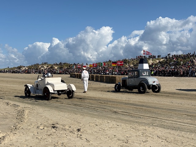

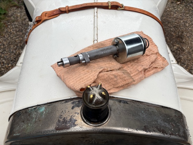

  3. 1200 miles to Denmark and back in a Model T roadster. Why not make dicing on the autobahns and racing on a beach a tad more intense by trying out a prototype oil pump in my Burtz engine? Wire cut gears with bronze bushes in a 3d printed aluminum body (the final product will be die cast I think) with an internal pressure relief valve set at 35psi. Pump testing finished… Rock solid pressure to whole way. Swapped it out yesterday for my original Rotoshim pump, drove to town and… the electric fuel pump died.

    A wonderful event, there was so much to see.
    It's great that your long test drive was successful. Best regards, Harald
