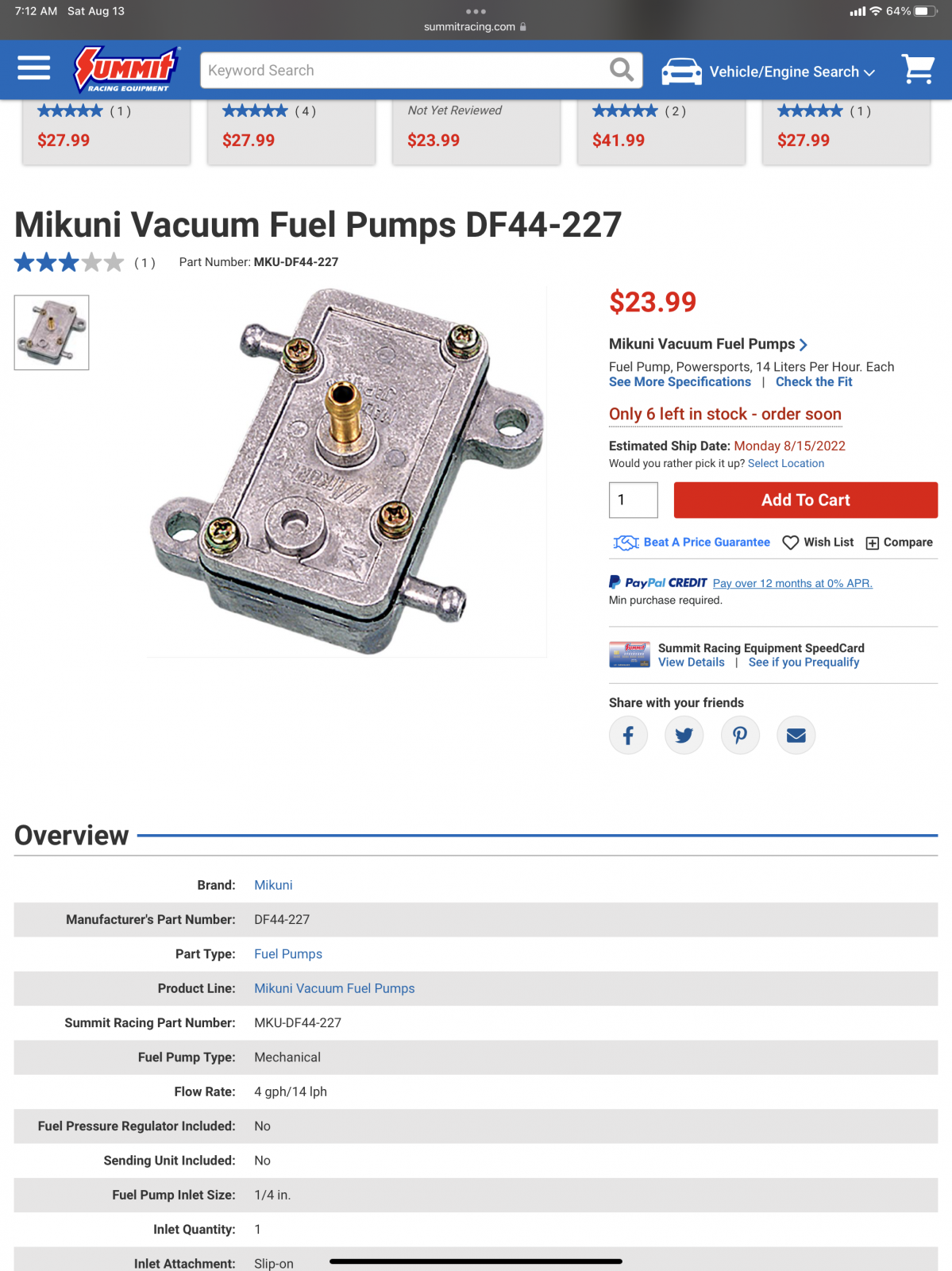

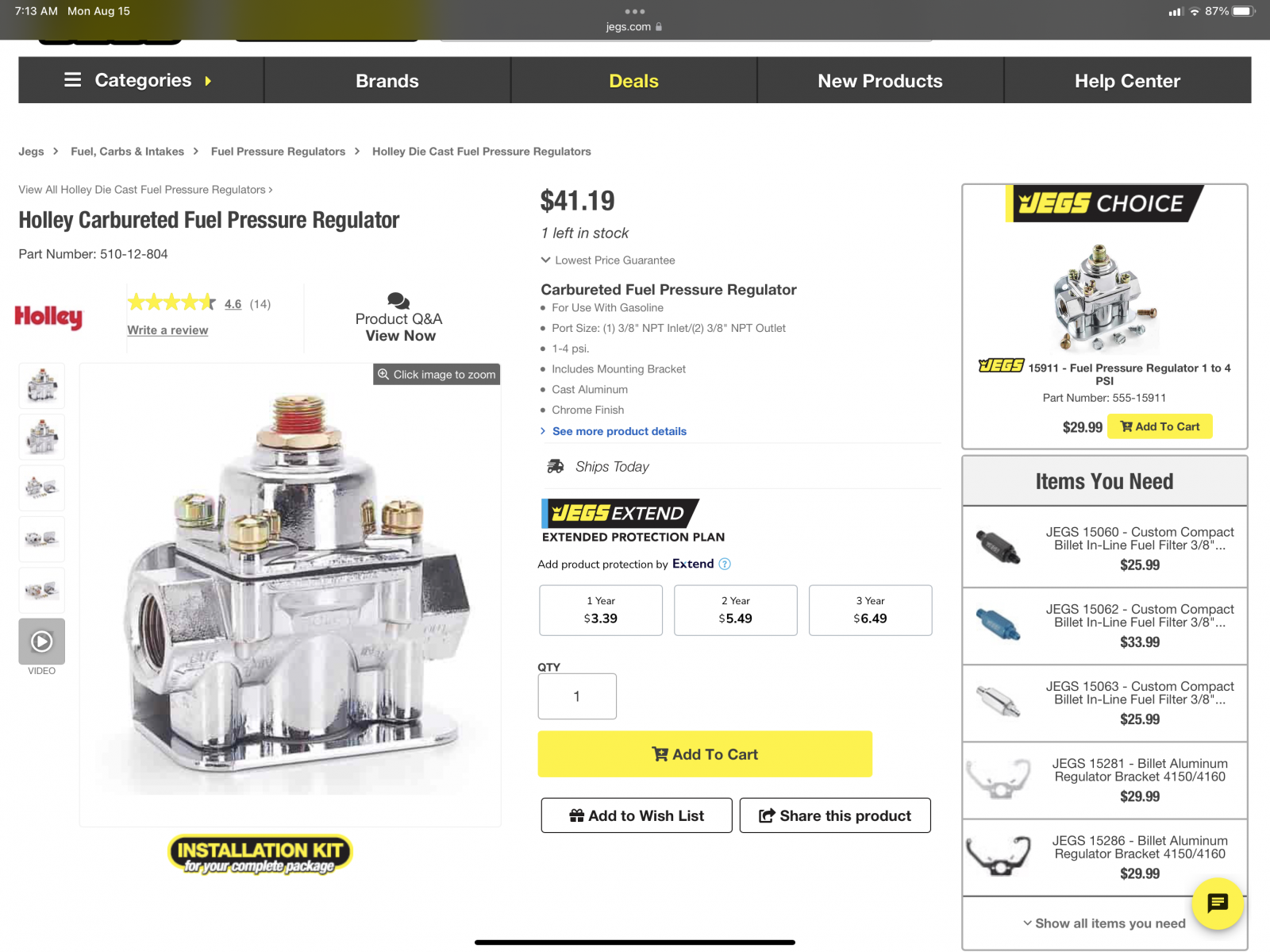

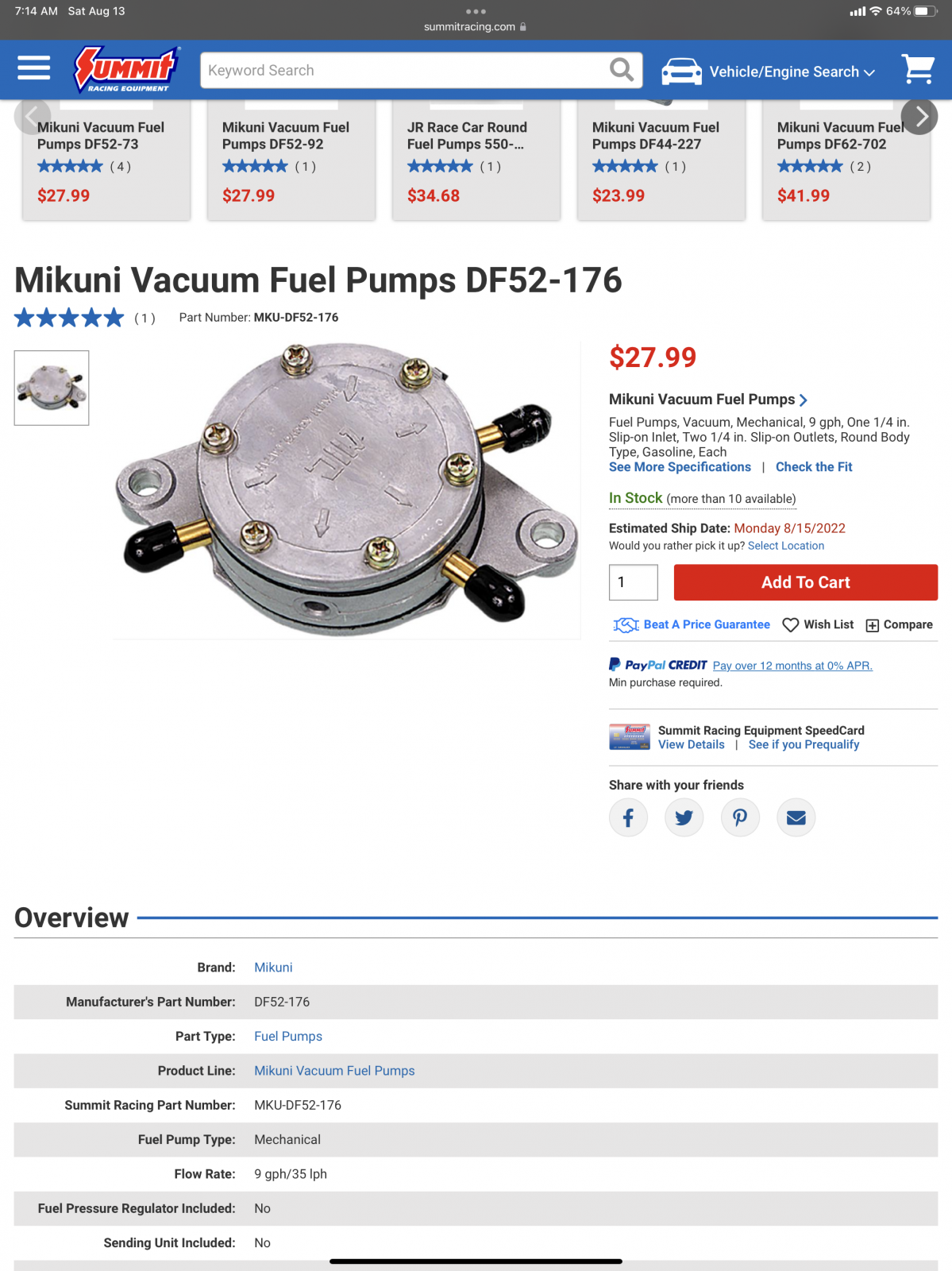

    Probably best to avoid wasting my time and just wire the electric pump.
    I ran an electric inline pump and Holley 1-4psi regulator mounted on the frame rail on a different car in the past.
    I just wired it to a switch in the cab.
    Any better ideas than that?
    8B989DFA-4D3F-4242-BFDD-6D9BD555A8C9.png 90549754-2F6D-444A-BCB2-D7B9612F1F30.png
  12. winduptoy
    Joined: Feb 19, 2013
    Posts: 4,153
    winduptoy
    I've been using the Holley 12-426 fuel pump without an inline regulator. It does not overwhelm the float/needle seat.
    If you have 12V I've added a fuel pump relay that makes the ground to the relay with the ignition switch. Mounting the pump on the frame rail puts it out of sight but requires a line down to it and then another to the carb.
    If you decide to run a regulator, I suggest a Malp***i brand regulator. It is old school in appearance and works at the lower pressure flawlessly ....I've got one on a 6V set up and it made me throw all the Holley ones in a box for the swap meet
    Good luck
    97 and Jet96 like this.
  13. brjnelson
    Joined: Oct 13, 2002
    Posts: 632
    brjnelson
    Walls
    My experience with that vac pump is on two stroke engines, that they are designed for, the two stroke engine makes negative pressure "pulses" from the crankcase. A 4 stroke will only have vac from a manifold or carb port, that is a constant source that will go up and down in pressure, but will never pulse to move the pump diaphragm in and out.
    Jet96 and winduptoy like this.
  14. Kevin Pharis
    Joined: Aug 22, 2020
    Posts: 711
    Kevin Pharis
    from Califunny
    If you wind up installing a Winfield carb... you will likely want a regulator. The factory Winfield needle and seat design is sensitive to excess fuel pressure (greater than 2 psi). I have statically tested them to 15 psi and they don’t leak... my su****ion is that vibrations cause the float and needle to bounce, resulting in leakage. He higher the pressure, the bigger the leak!
    I have had good luck with my spring loaded needles, running a 2-5 psi pump without a regulator doesn’t seem to affect the float level anymore...
    winduptoy, Jet96 and Old Dawg like this.

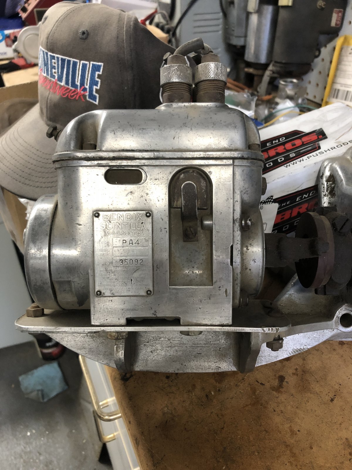

  19. When using a side mount to drive a Magneto it appears a crank gear is used in these adaptors, question is, wouldn’t this drive the Magneto at crank revs?
    Crank gear to cam gear to crank gear, am I missing something?
    I would of thought the Mag should be driven at half crank speed like a distributor?
    Just been reading this, could someone possibly explain if and how this works?
    “Consider running the mag at twice the speed. That may get it past it's impulse speed and it would then generate a waste spark during the exhaust stroke.
    As mentioned without the impulse it may not be spinning fast enough to generate a spark as it is.”
  20. These type mags have a 2:1 internal gear reduction, no wasted spark.
    I have heard of a few trying to use a dist without much success.
    John
    winduptoy and Barrelnose pickup like this.
  21. panhead_pete
    Joined: Feb 22, 2006
    Posts: 3,718
    panhead_pete
    Cheers mate, if I dont have any luck will reach out.
    winduptoy and stubbsrodandcustom like this.
  22. I was under the impression that the Model X Wico magneto was used on As driven off the cam side mount using a crank gear? They don’t have a 2:1 reduction.
  23. You may be correct
    I am not aware of all the Wico models available
    These are X models and not intended for side drives
    this Bendix is side drive
    Dustyp489 and stubbsrodandcustom like this.
  24. Not a good shot but this is the Model X I have, your furthest away one is a JEM 1509 model I’m thinking.
    Hope someone chimes in that is running this set up. 0C2805E1-8523-46DB-B94D-E27F19F92CA8.jpeg

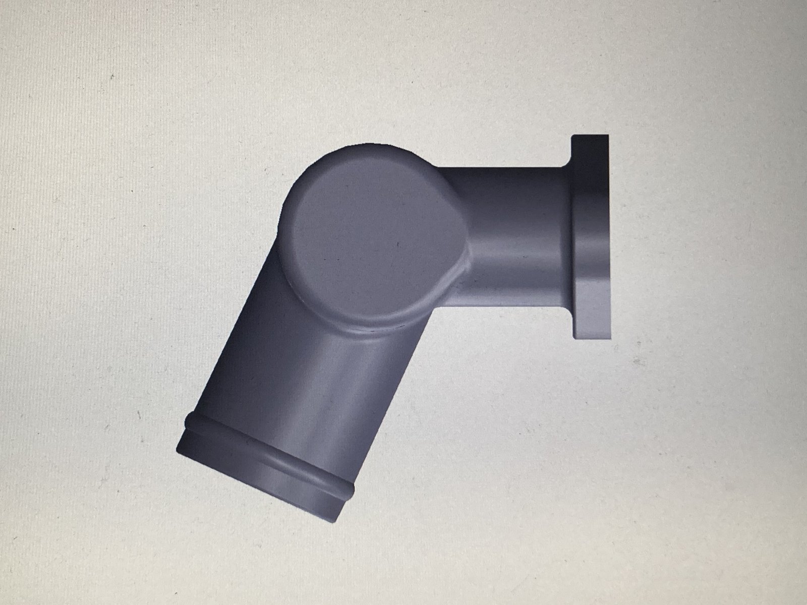

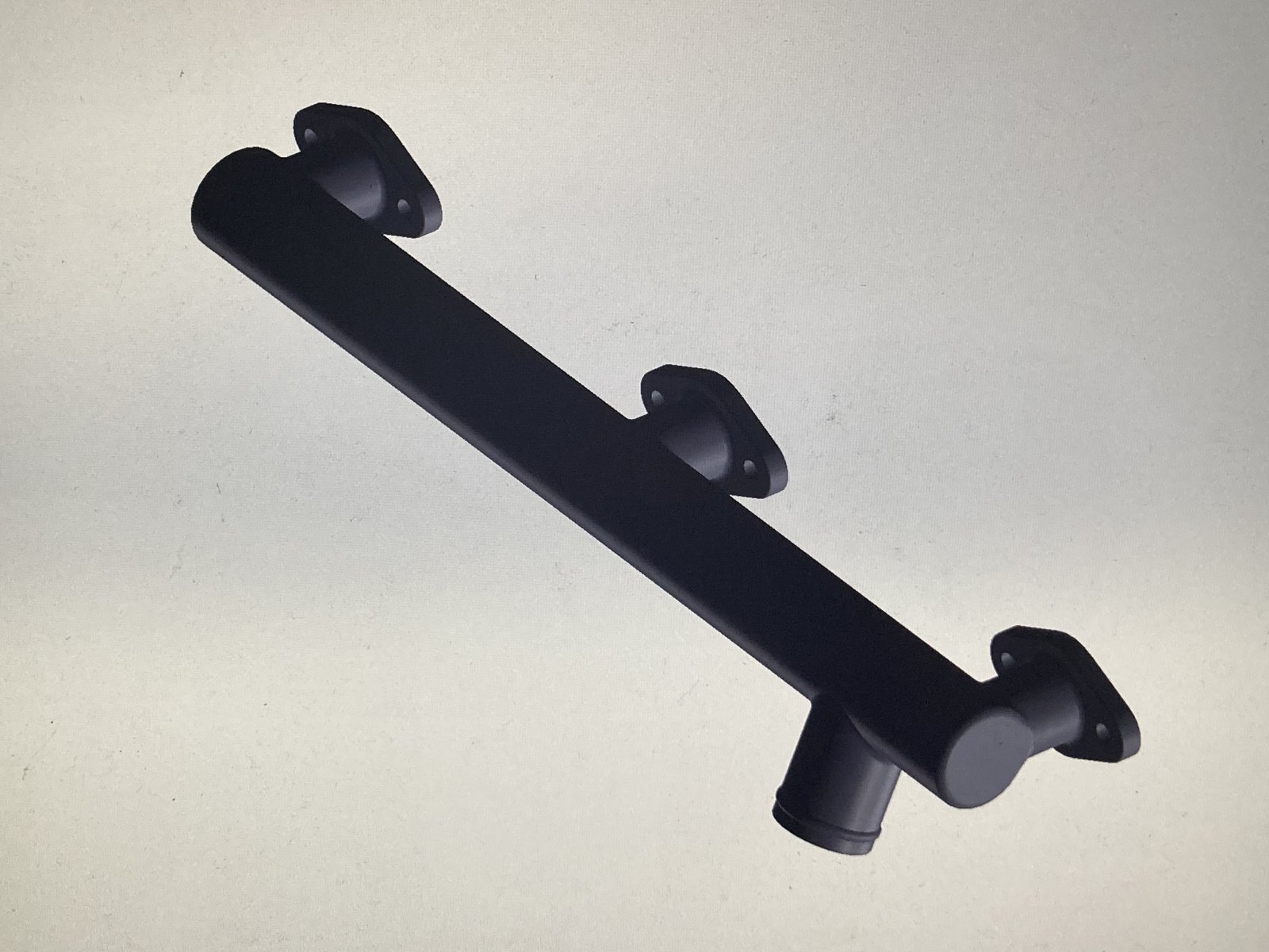

  28. Kevin Pharis
    Posts: 711
    Kevin Pharis
    from Califunny
    I received a number of pics from various people, and even was sent an original as a sample! Thank you to all!
    There was also a small number of people that inquired about manifolds, and so I have compiled a list and requested cost from the foundry.
    The numbers are back... price $600 ea. I will machine the castings, supply dimensions for block mods, and possibly supply gaskets if I can pull in a favor.
    I revised the design to match the typical Fronty water manifold for several reasons, here are a couple pics. I will be placing an order with the foundry the beginning of next week, so this is last call! If you are interested in one of these water manifolds, please let me know
    C8556246-6751-479B-AB13-B3B6786281D0.jpeg 6B5523D4-B50D-4DEB-A681-46906ADB8DEA.jpeg
    winduptoy likes this.
