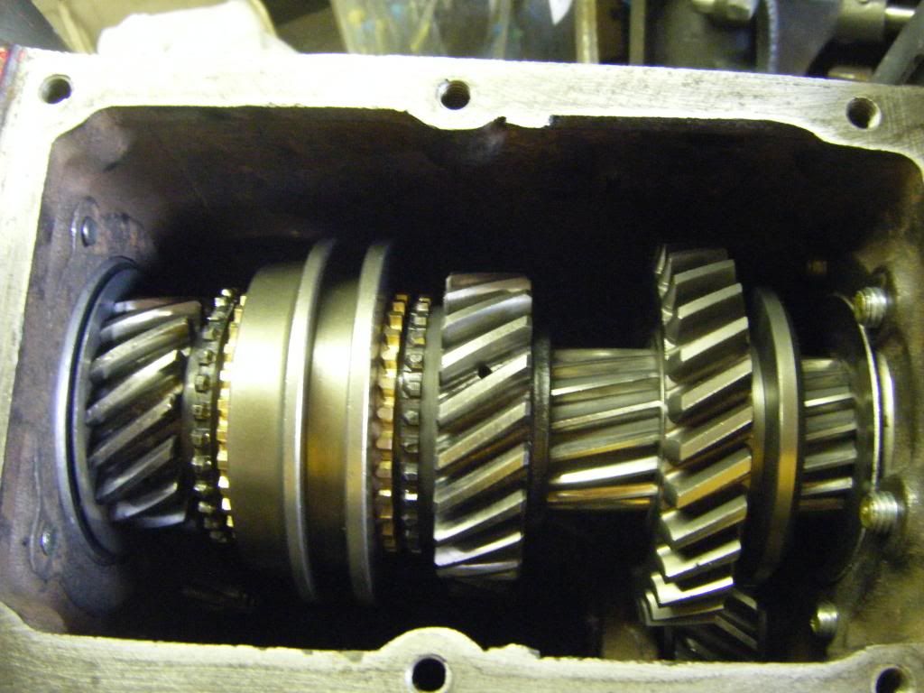

  24. Anyway back to the repairs of the coupe, I had a 48 gearbox a home so I stripped it to put the gear set into the 39 box all the gears except the first/reverse slider gear were in good condition.
    I purchased a new first/reverse slider gear, new syncro assembly and all new bearings thrust washers etc, from US suppier who specializes in early Ford gearbox's and was very happy with the parts he supplied no issues.
    Here I have the gearbox with the 48 gear set all cleaned up ready for assembly.
  25. Gearbox all assembled ready to be installed, no issues with assembly this time everything fitted as it should, arr the pleasure of using good original Henry Ford parts.

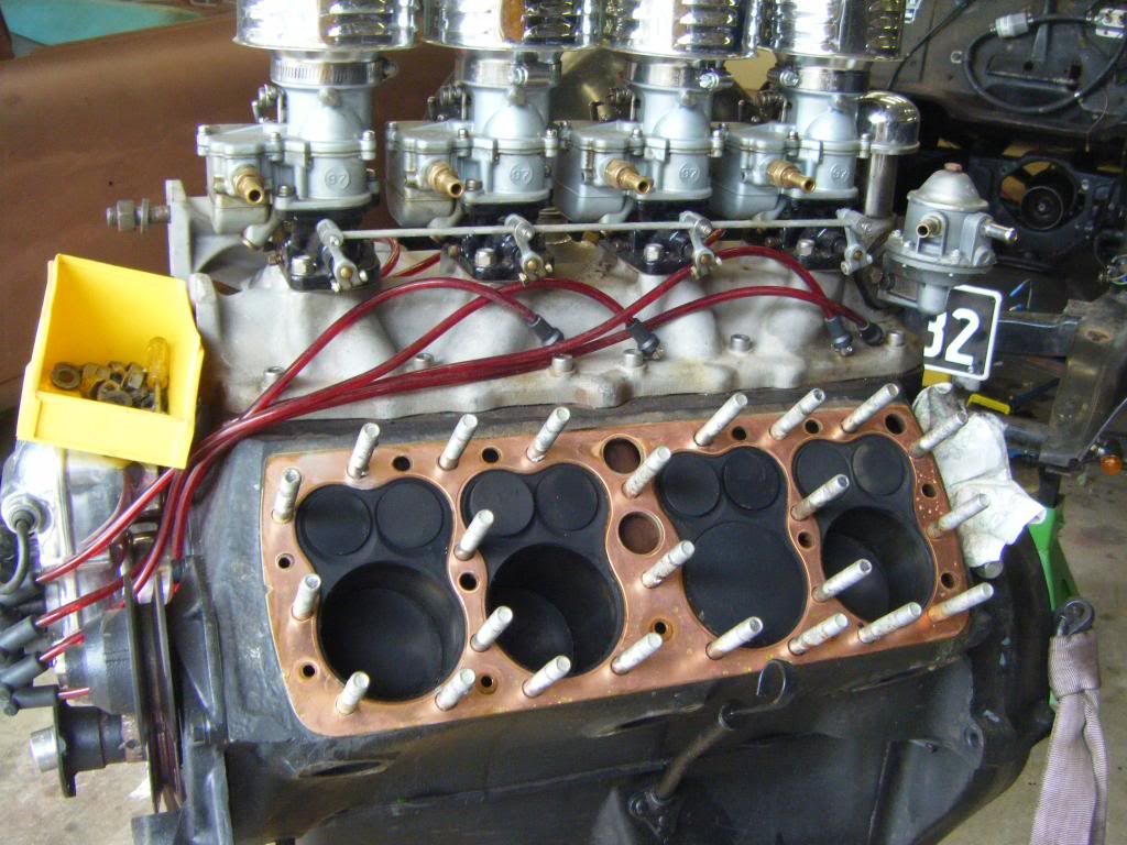

  26. As you all know engine lost a couple of spark plug firing tips on the trip so I decided to pull both heads and check for any damage, R/H head had no damage plug tip must have gone straight out the exhaust, L/H head had a few pop marks were the plug tip bounced around a bit before exiting out the exhaust, nothing to worry about, just gave them a quick clean up and put them back on, used the same head gaskets.
