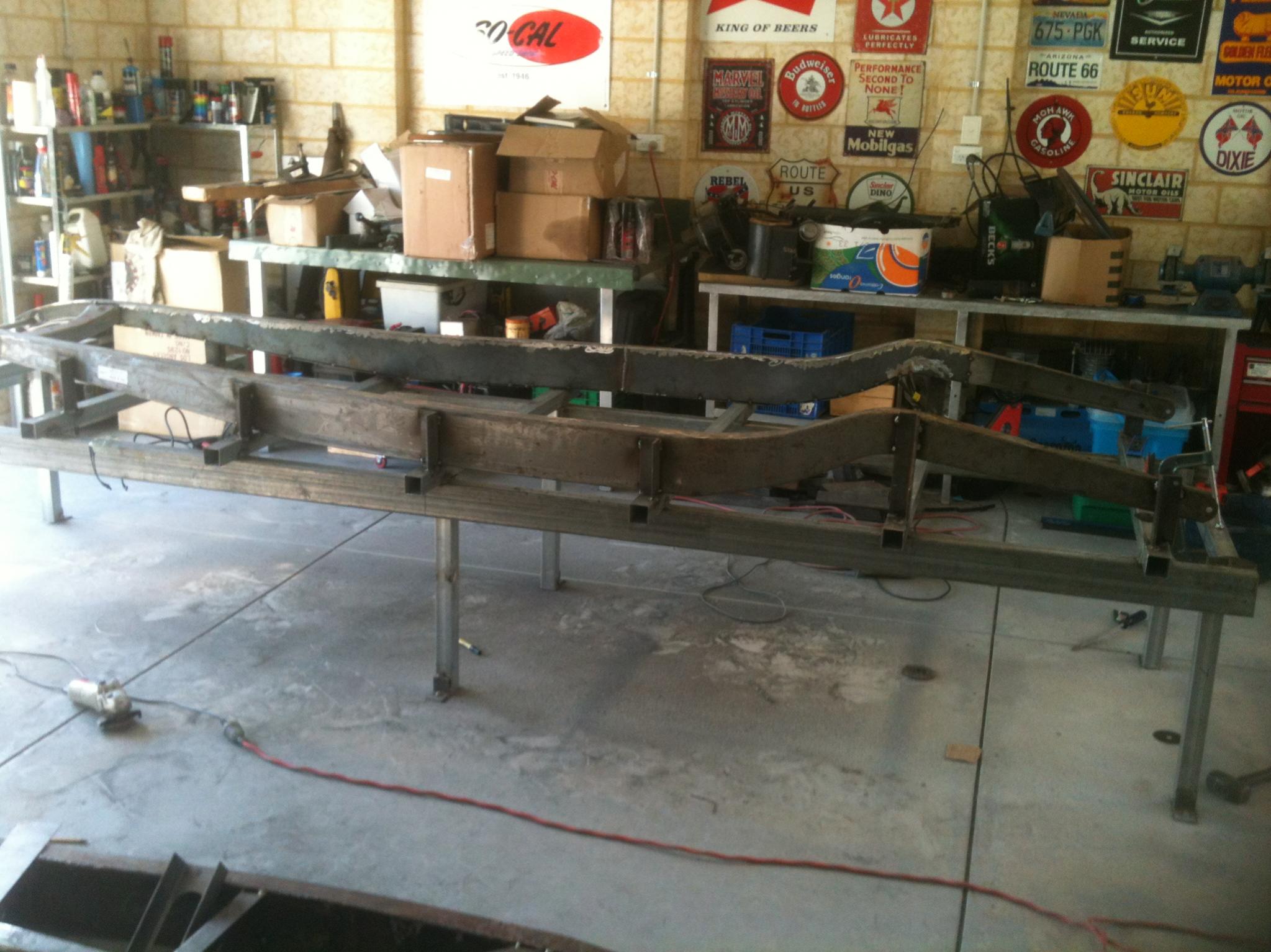

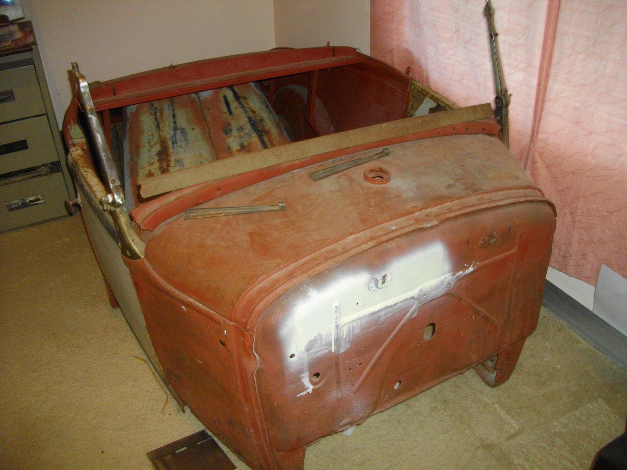

  1. Here is what I started with about 18 months ago. Bought the body from a local guy who had decided to get a Brookville body imported.

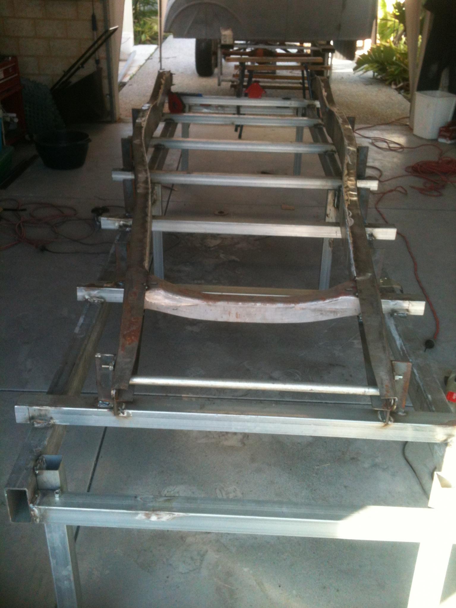

    I ordered a So Cal front end, 32 rails and boxing plates. They seemed to take forever to arrive. Found out later that for some reason most of the suppliers order was left on the dock in LA. The paperwork managed to get loaded though.
    A mate of mine had also ordered the same parts as me and was making a jig to build the ch***is. So once his was completed it was my turn.
    Doing pretty good for first timers.

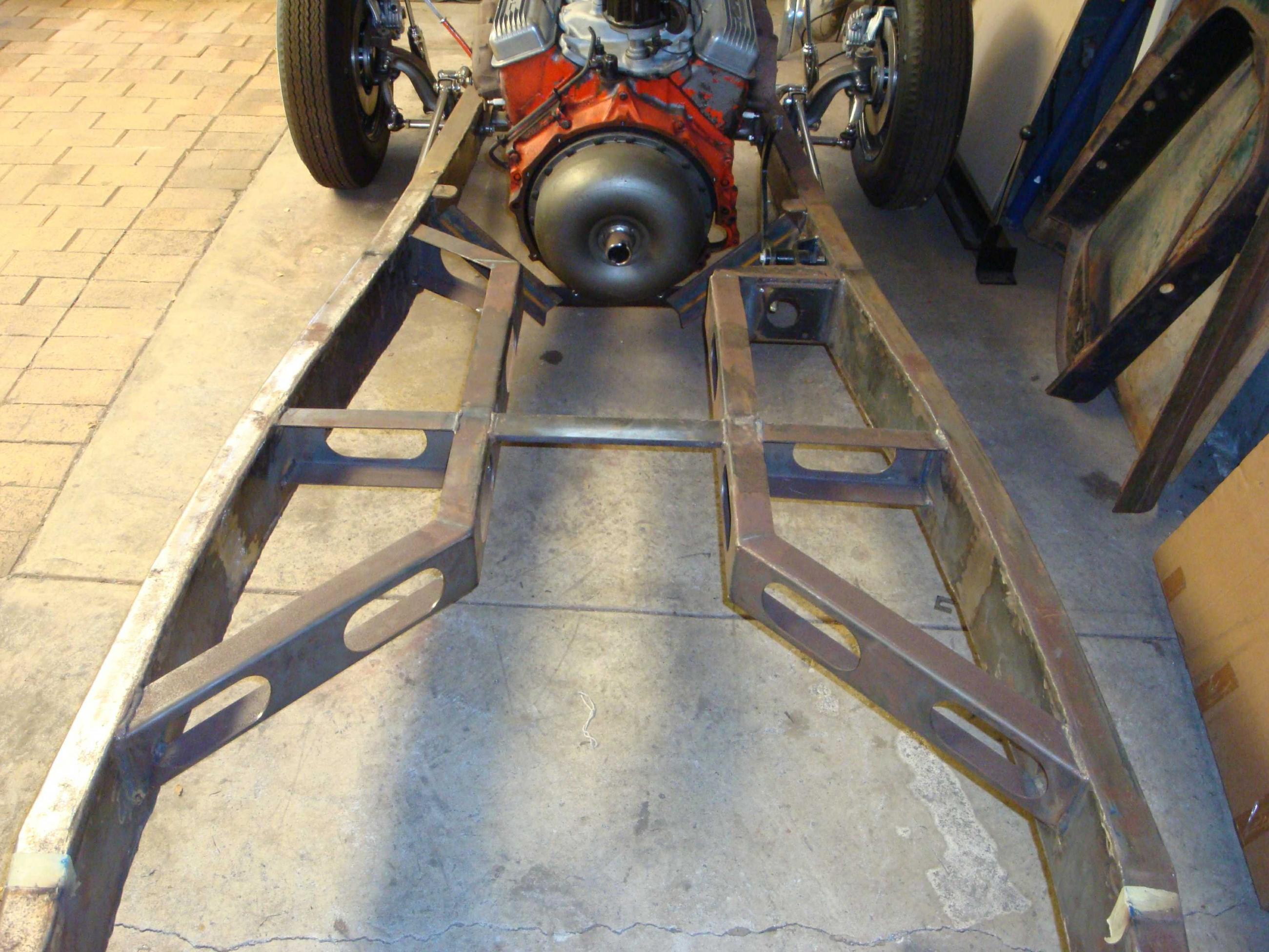

    Long way to go yet. Had the body on and off what seems like a thousand times. Trying to get the some room between the firewall and distributor. Decided to reverse the firewall and channel her about 1".
    Here's how she looks.

    Looks reallygood so far! Did you make those sub rails your self? What gage steel are they? Oh yeah suubscribed
  14. Yeah, lots of pie cutting & welding. Steel is 1.6mm not sure how that converts to gage, I think it's 0.0061".
  15. Ok it's 14 gage.
