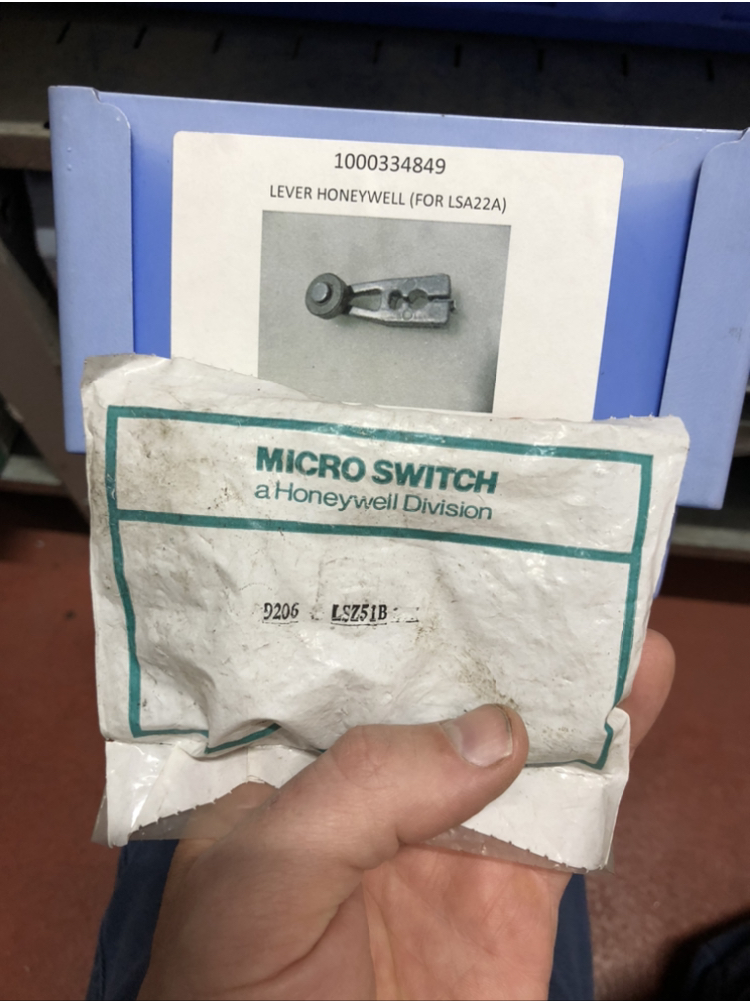

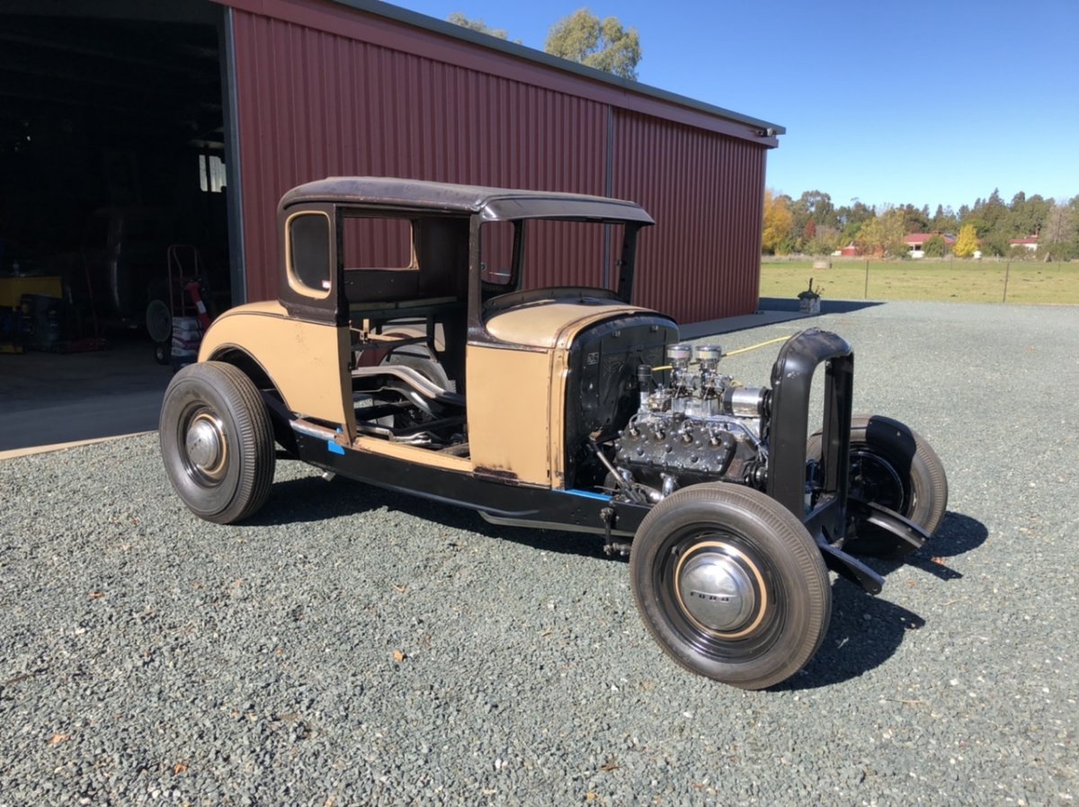

    This is how it looks now.
  2. Wardog
    Joined: Jan 12, 2010
    Posts: 2,463
    Wardog
    I hope this helps.

  4. Dick Stevens
    Joined: Aug 7, 2012
    Posts: 4,178
    Dick Stevens
    You should be able to buy them from Allied Electronics
    chryslerfan55, Stogy and Tim_with_a_T like this.

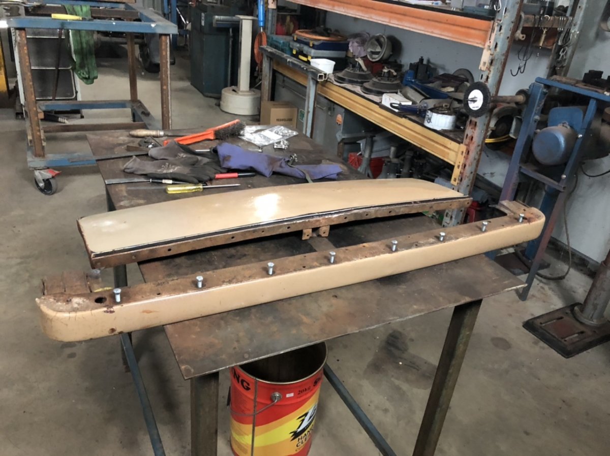

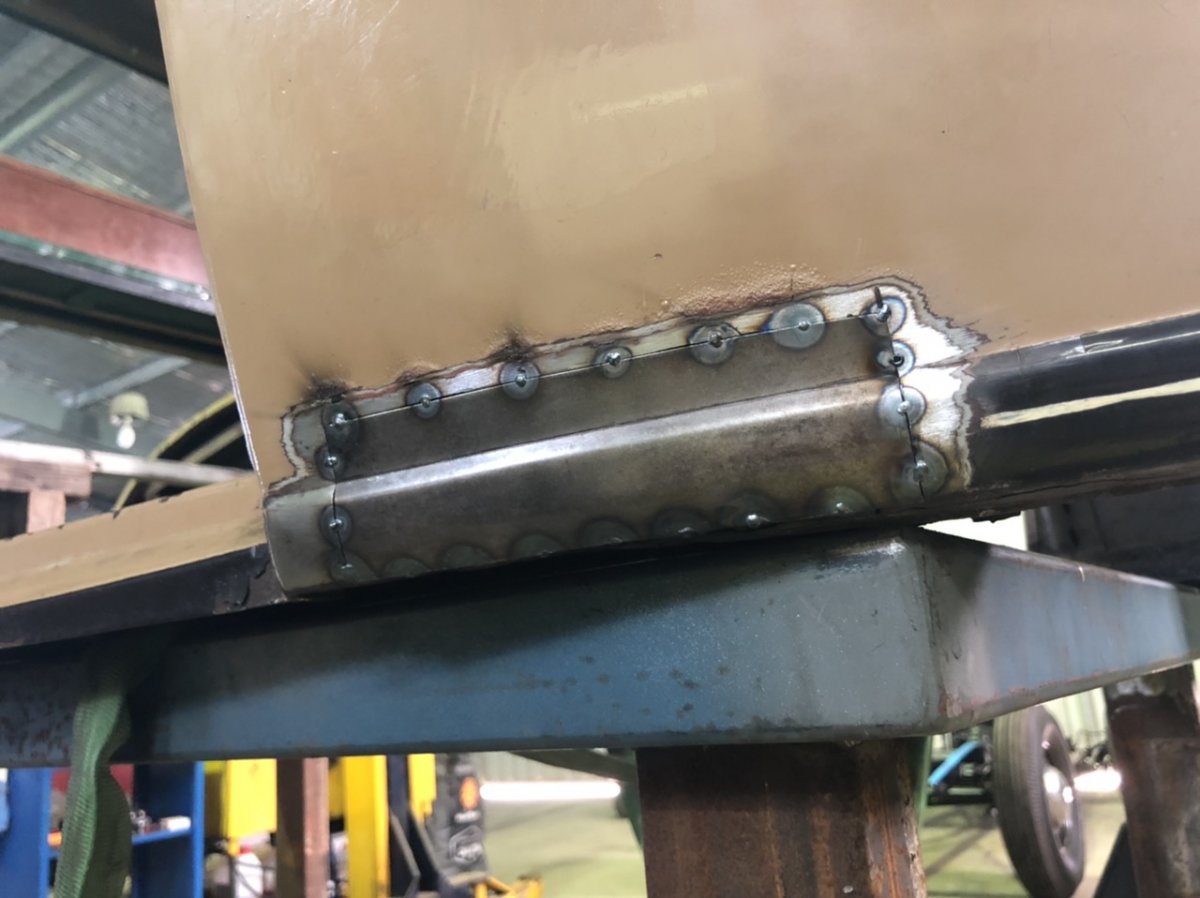

    Talking with a friend yesterday about patch panels we came to the conclusion at the moment I’d be paying premium because of the Aussie dollar and waiting because of international shipping for parts that would need work any way.
    So I stopped doubting myself and started seeing what I could produce. I think I’ll use this one.

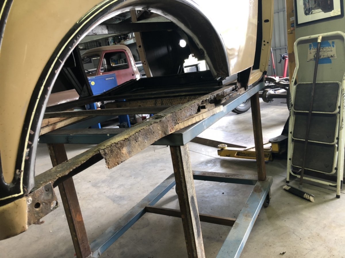

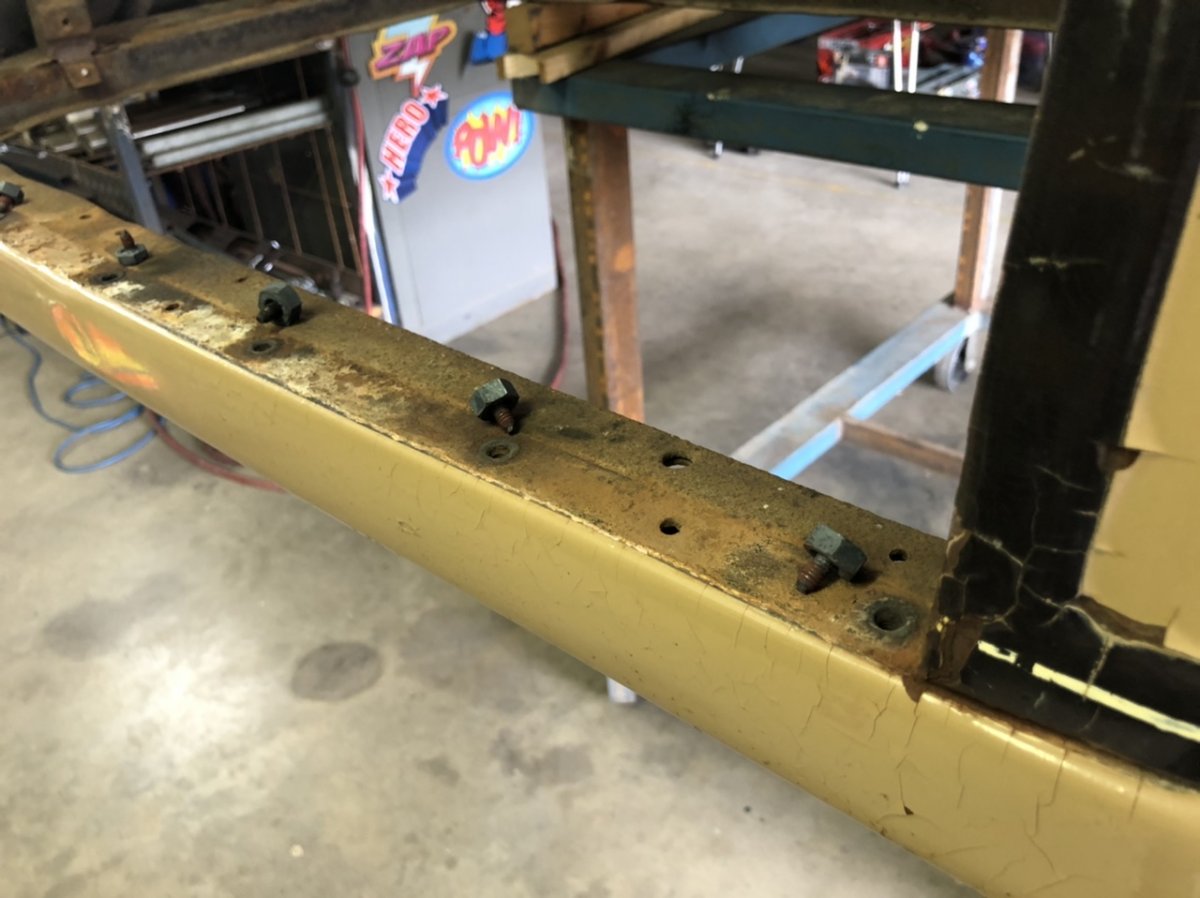

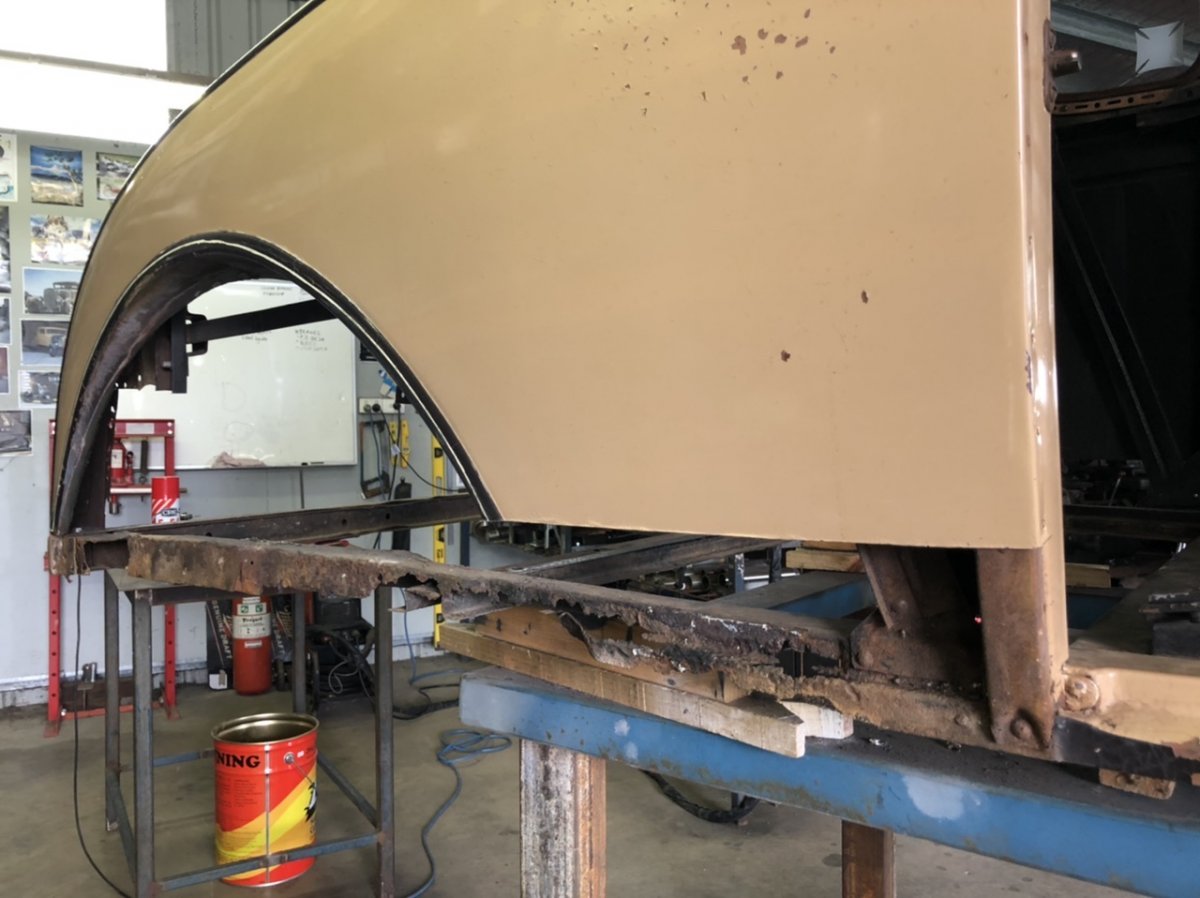

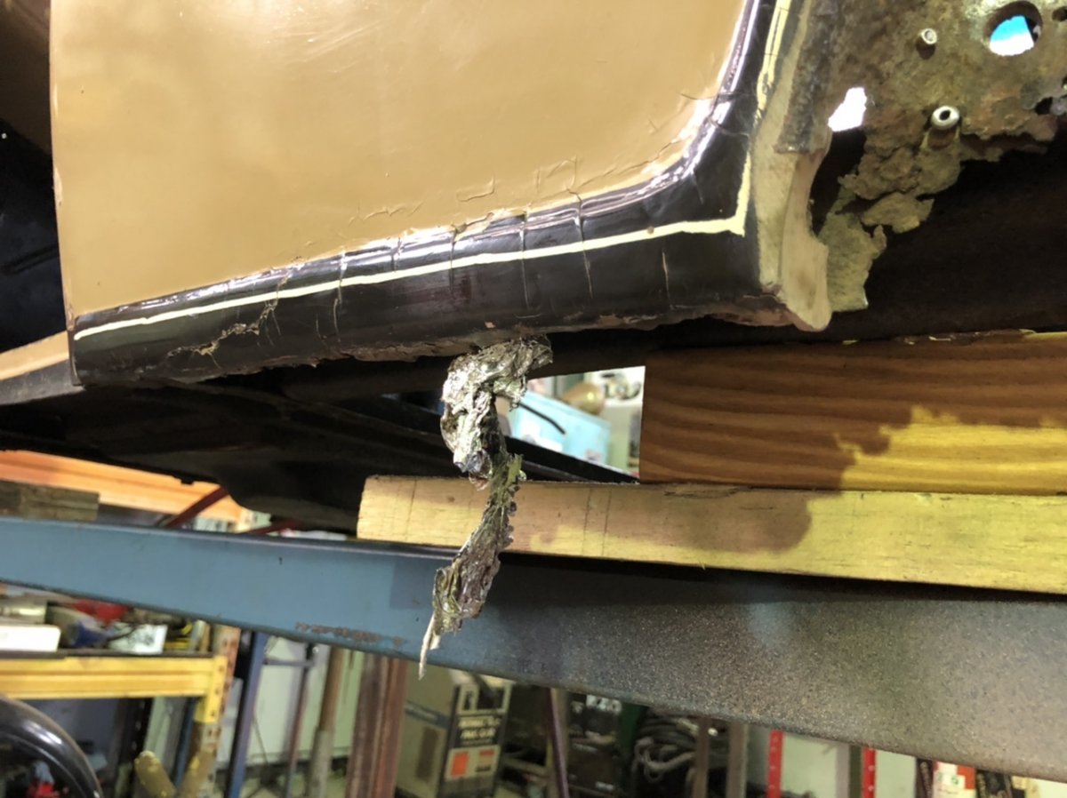

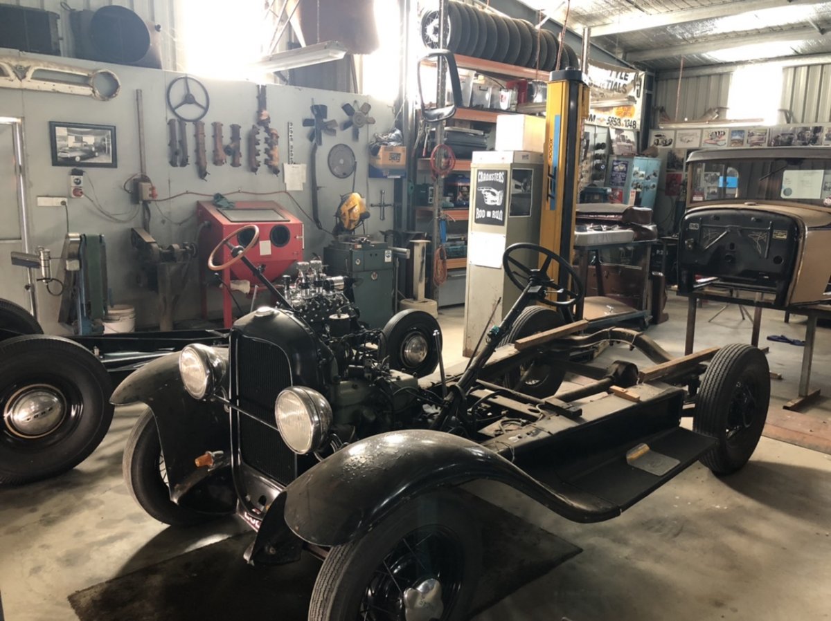

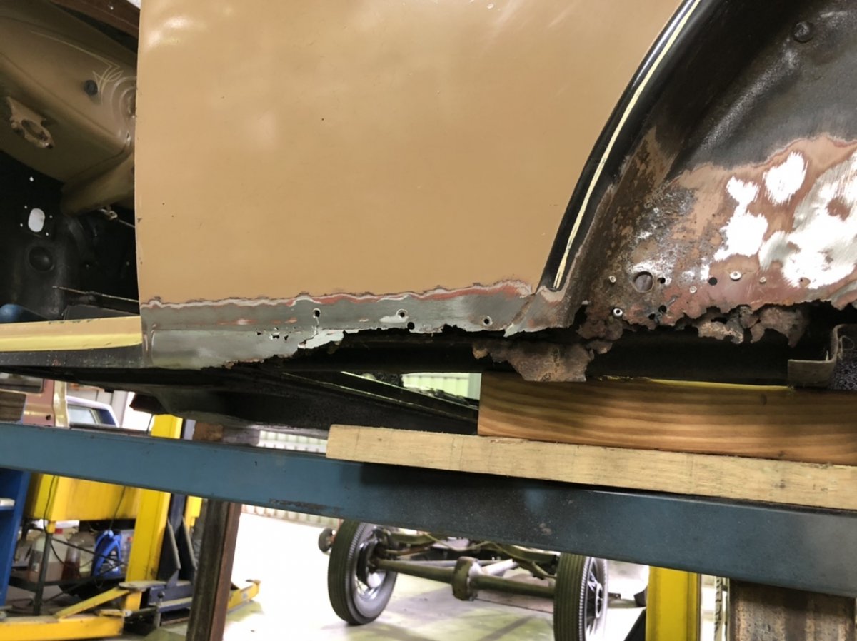

    I decided to buy subrails rather than make them. I remembered a set for sale locally a while ago. The kit was bought as part of a project that changed hands but never used. A couple of text messages and a week later I had a Steadfast sub rail kit for it.
    I had to cut the bolt heads off to remove the rear panel since they were all rusted tight.
    To remove the rest I welded nuts to the left over studs. The heat brakes the rust seal then I used an 18 volt impact driver to reverse them out with a socket.
    B5747999-0B0C-4364-AC64-9E14967496F2.jpeg 34DF7DCC-DFB0-413A-B194-109BA18A2469.jpeg

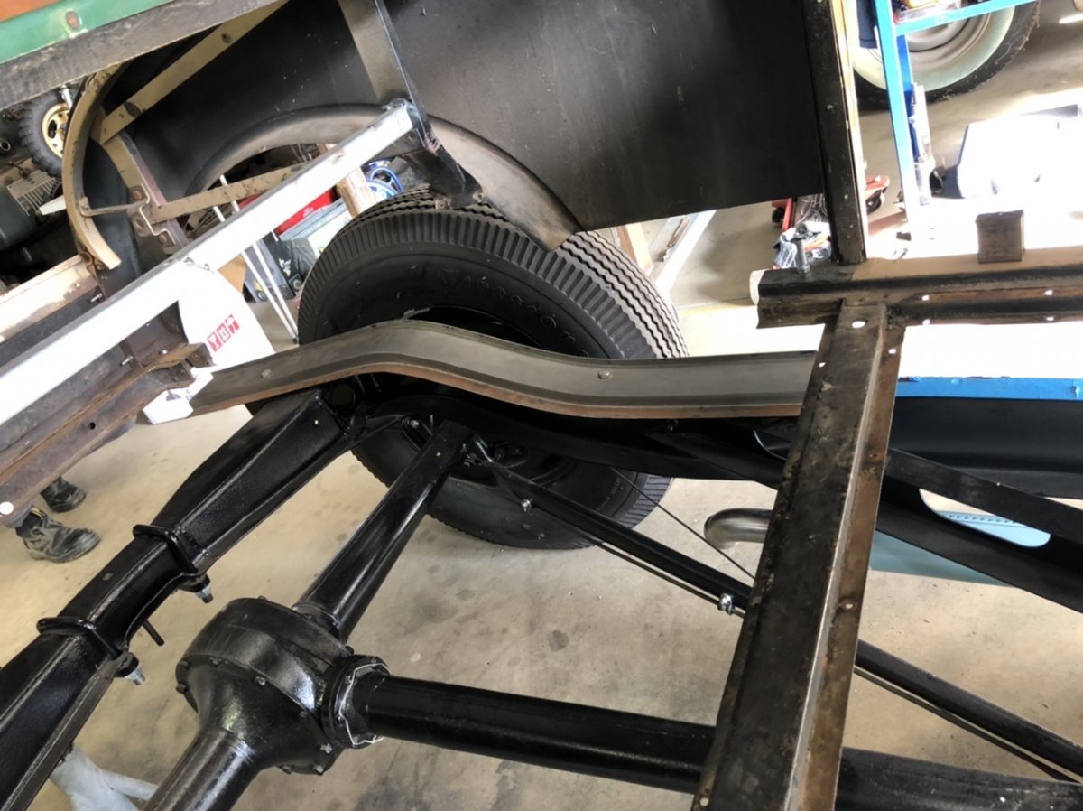

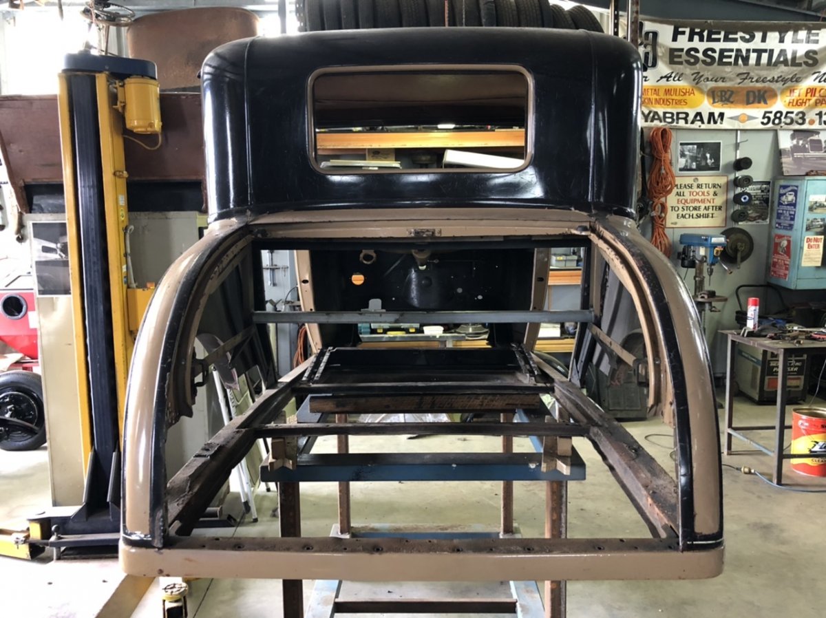

    It’s almost like this coupe was meant to go on a deuce frame. The sub rails from the B Pillar forward are in pretty good shape but the rears are toast.

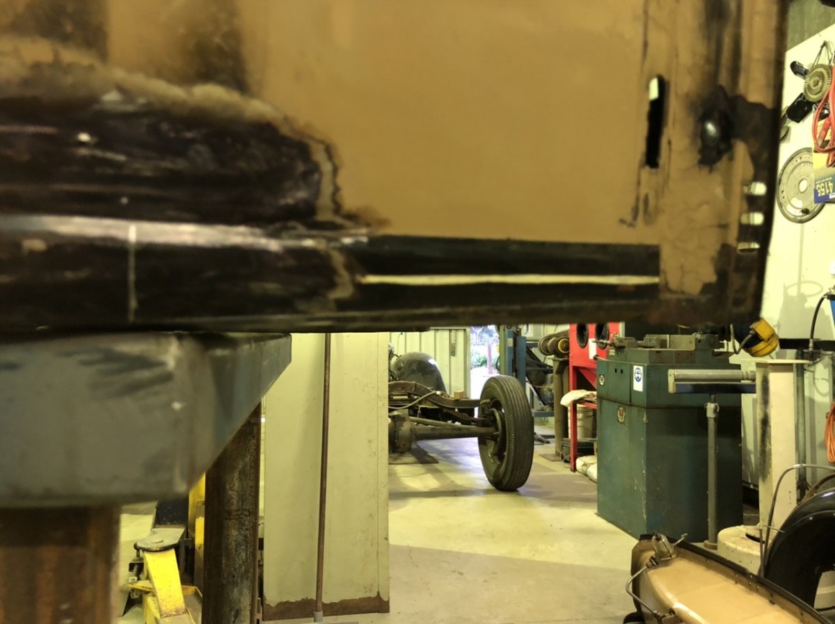

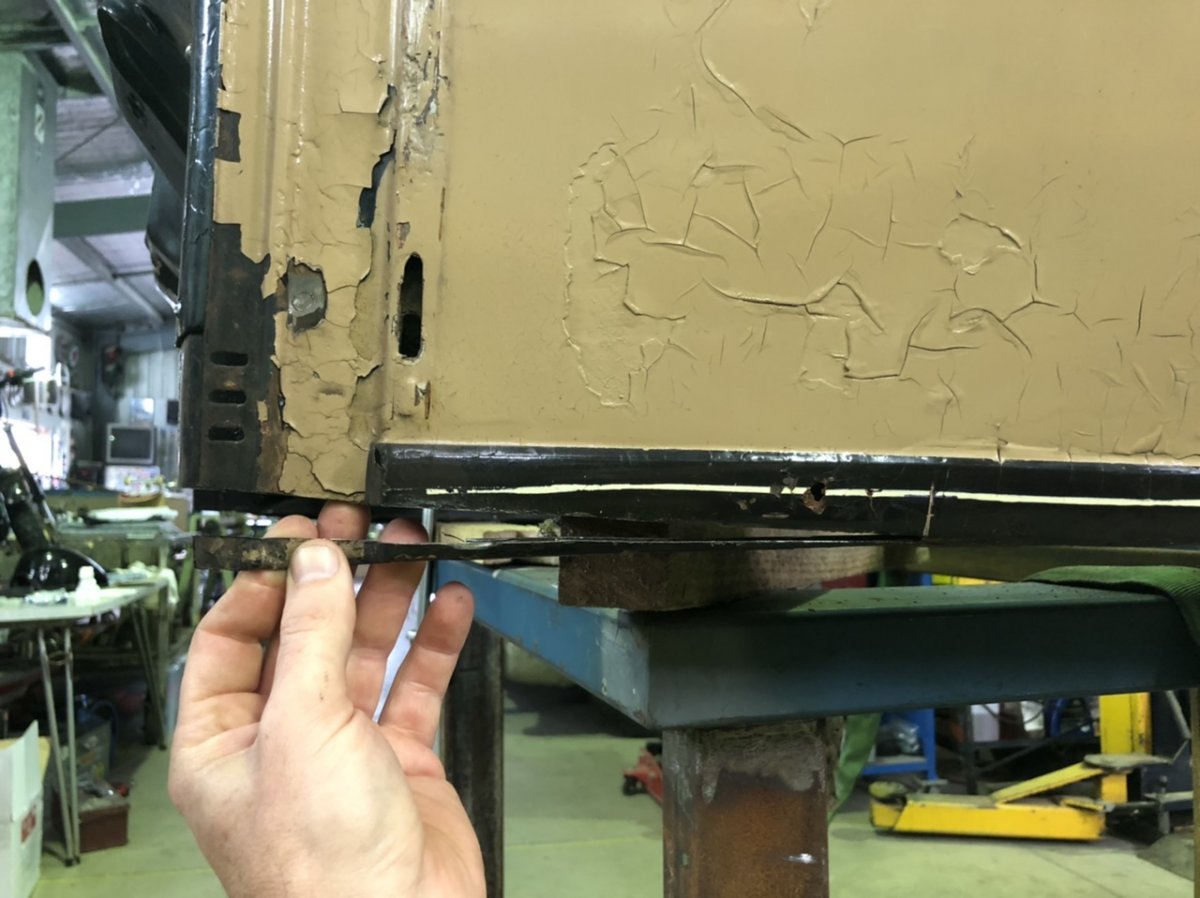

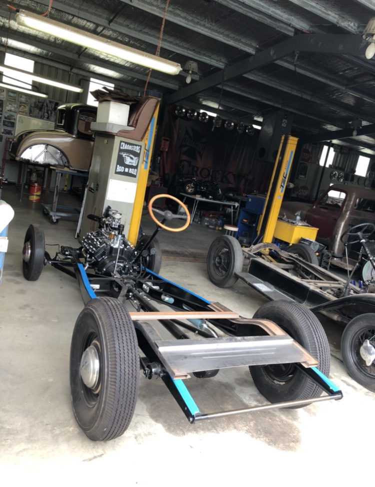

    I got the rear sub rails cut out yesterday and the body sitting on the frame.
    3290854B-1223-4E0E-93A4-0CA2BD472792.jpeg D270B245-C0C6-4252-A0A5-BFFAF433B73C.jpeg 6DA2CB77-4F95-4999-B2D8-61CF91477C62.jpeg FA7B6774-FC60-4A6F-90FF-2A96645560EC.jpeg

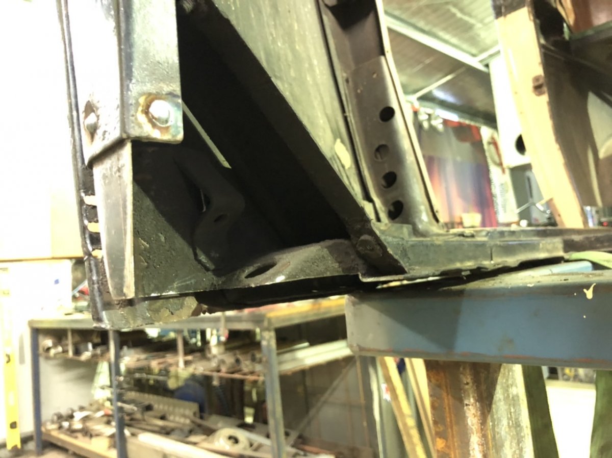

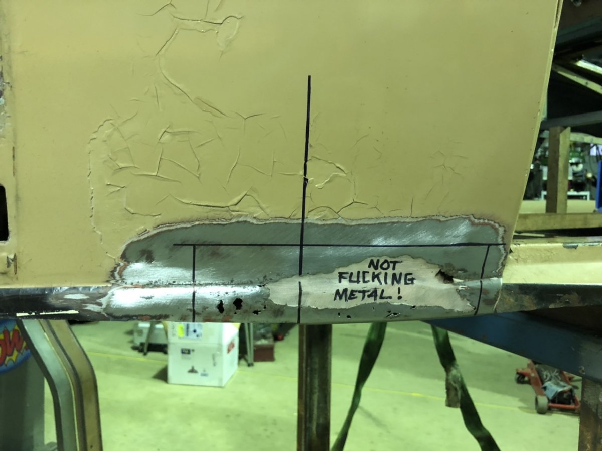

    Body back off. A little patch on the lower cowl.

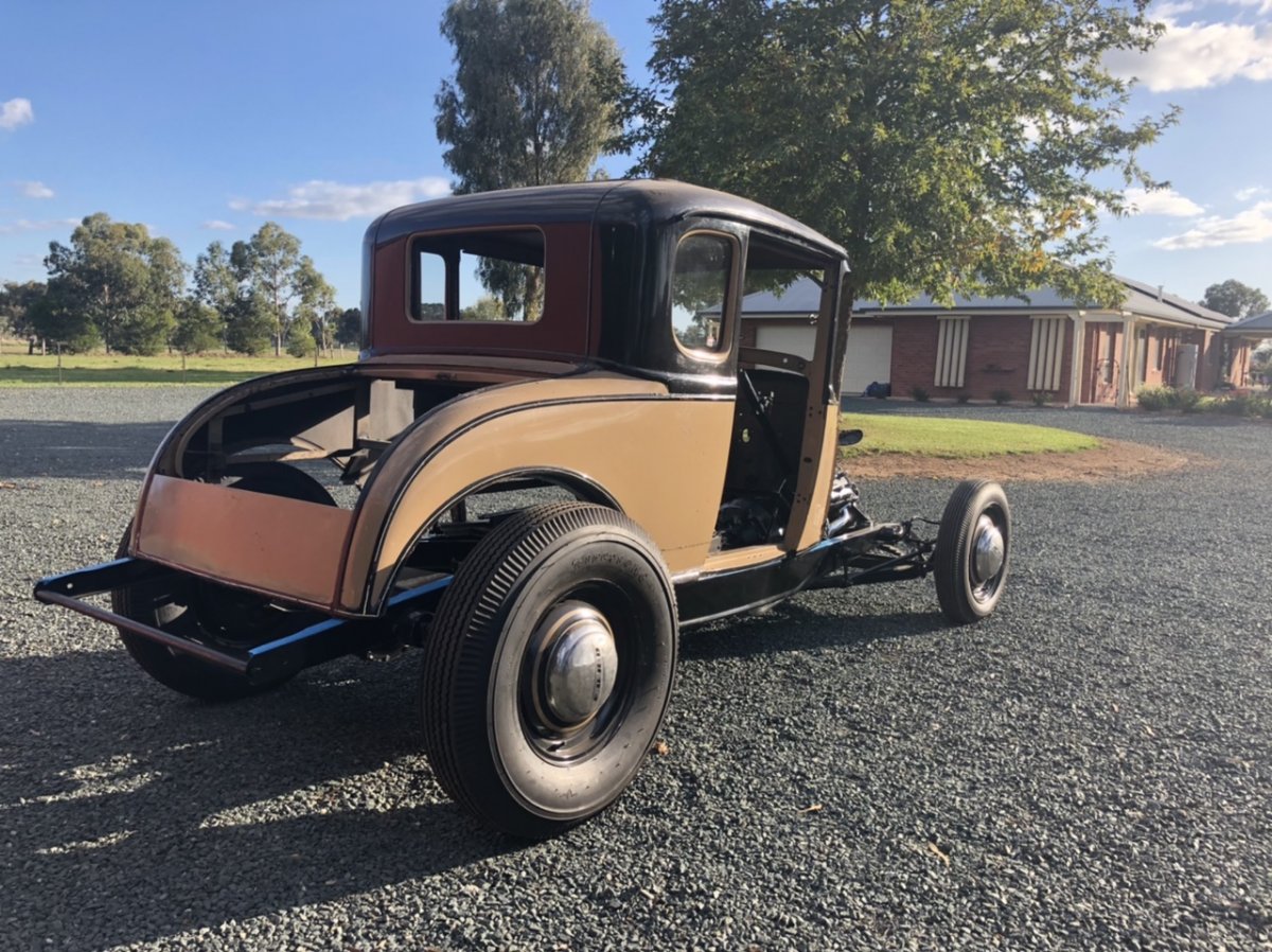

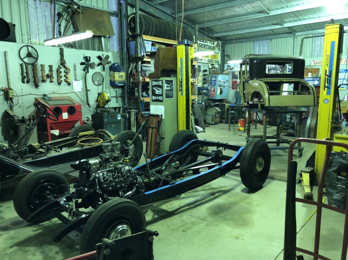

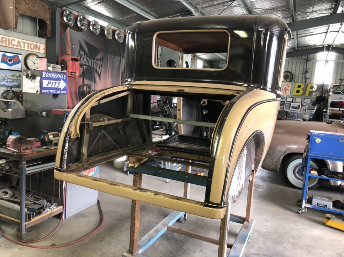

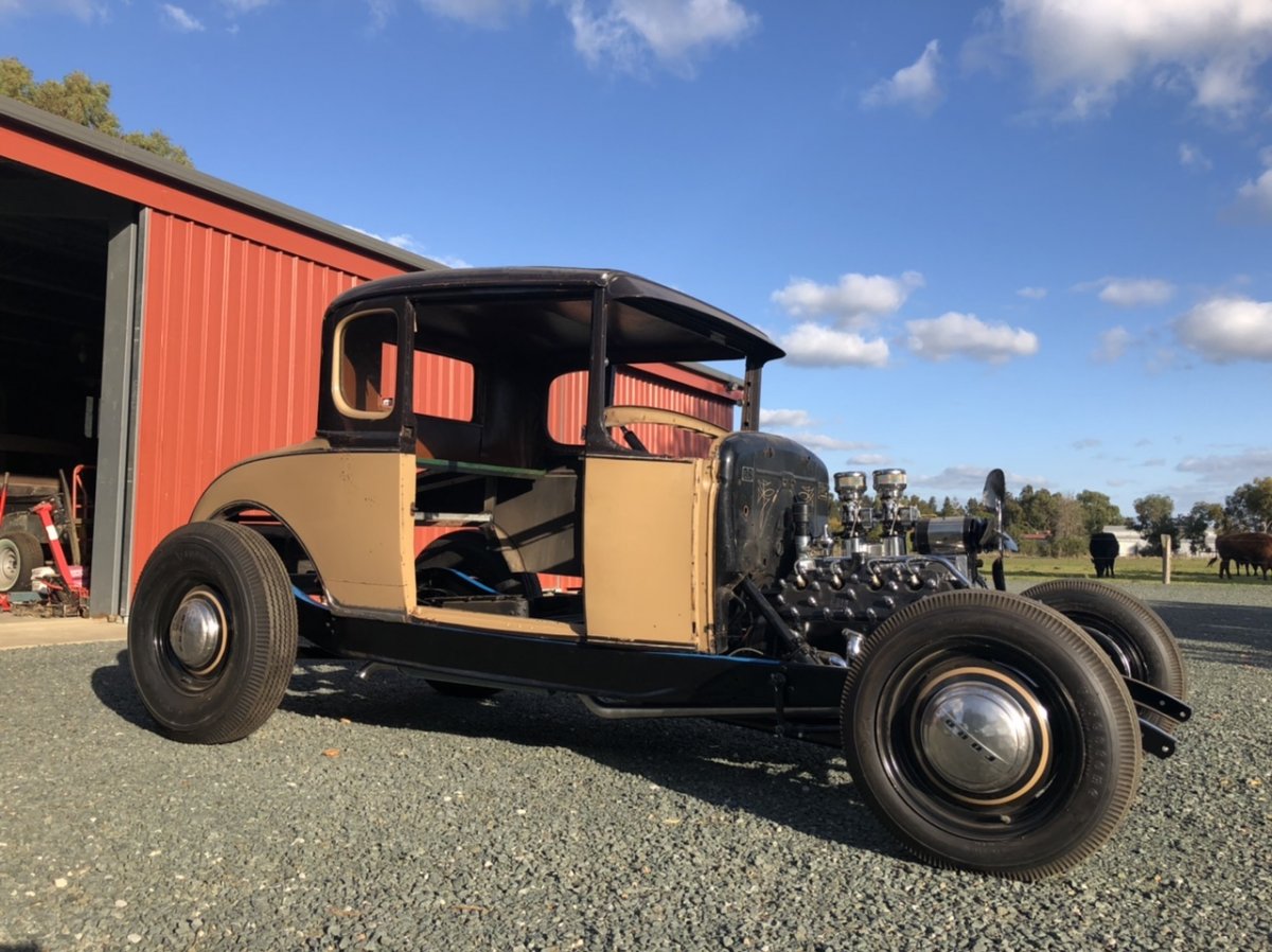

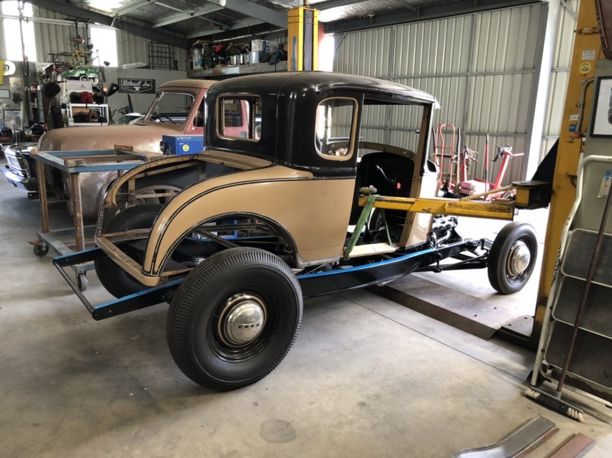

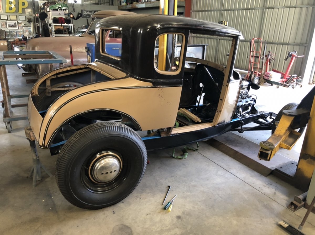

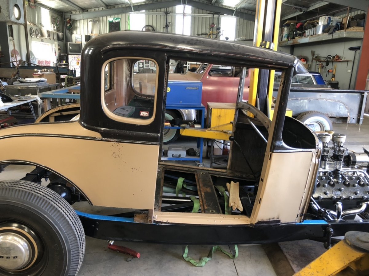

    My workshop has terrible light for taking photos. So what’s happened in the last week. I trimmed the firewall feet to fit the frame. I pie cut the cowl to fit the sweep in the 32 frame. I bolted the body down and started on the sub rails. The second last photo is not great but shows the rake and at***ude that is taking shape.
    E218FBFA-BF58-45B6-8727-791BE4372E6B.jpeg 77A24827-D146-4BD6-B55A-630E615E478C.jpeg F91C5855-8F18-401C-945F-96A2947062E7.jpeg F9270022-47D6-439E-B559-AAFC32E5359B.jpeg 78EDAD3C-07F5-4FBE-BD73-262D4D56F387.jpeg CB5FDFA6-BD48-4A5E-AC2E-D2358F1E7A33.jpeg

    I've done several 30/31 A's for customers with the pie cut cowl although I did mine above the bead and made my own rear sub rail pieces. (pre Steadfast) I ended up using a 2 inch shortened deuce radiator on them. Personally I think the pie cut cowl looks better than a channel. IMO

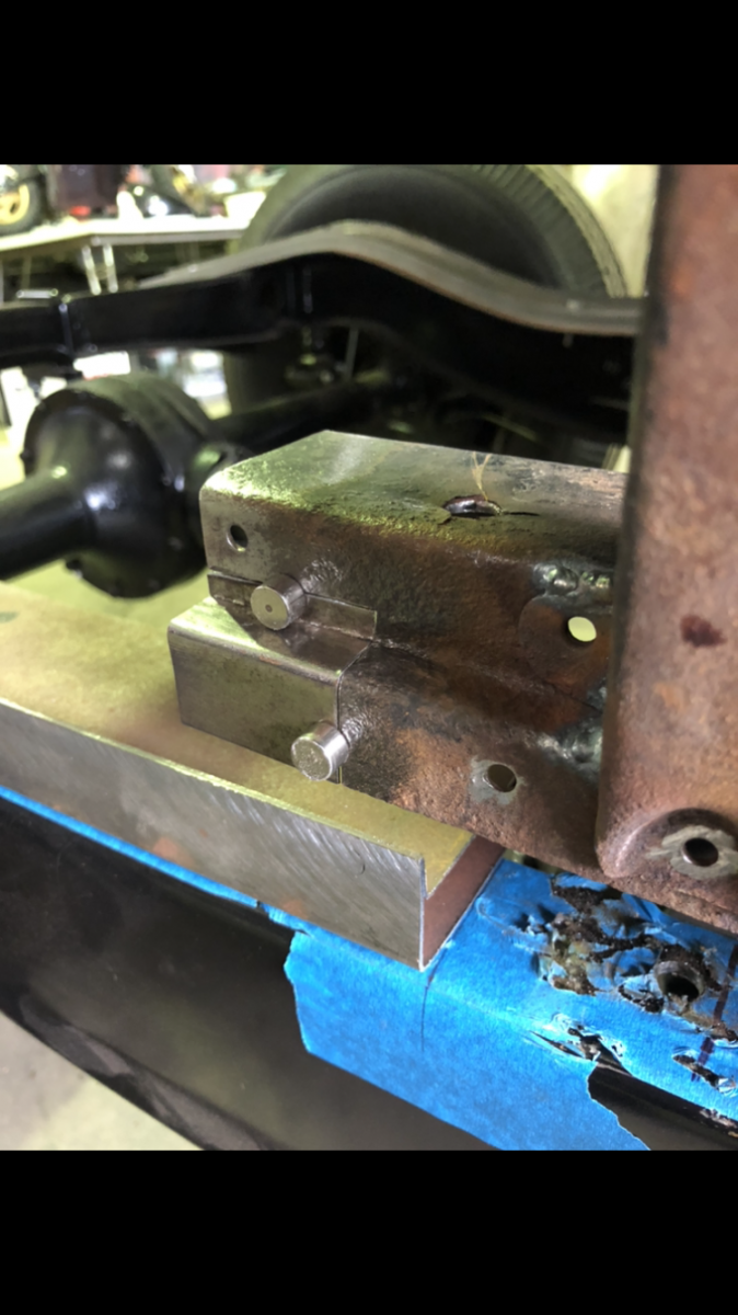

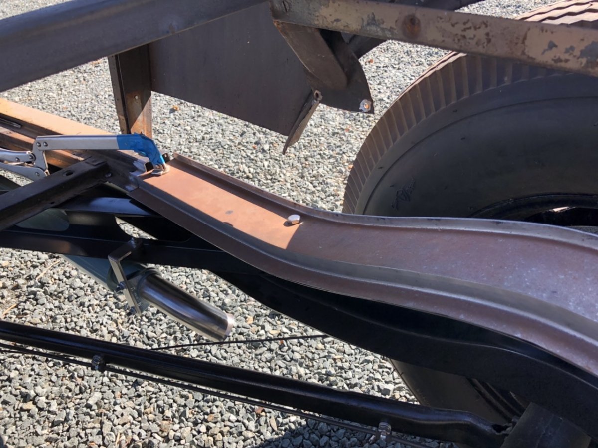

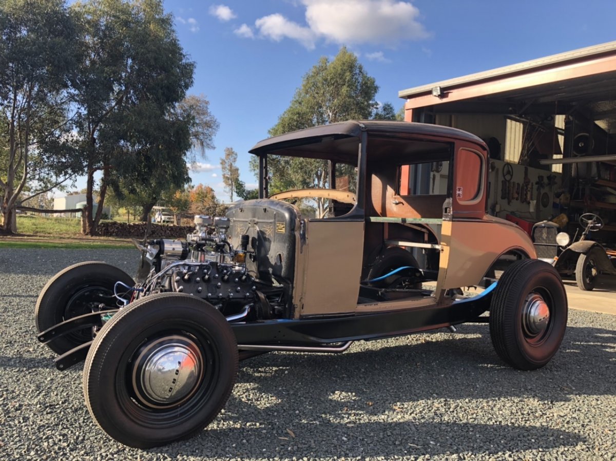

    I cut the ends off the floor brace inside the sub rails at the B pillar. It has allowed the body to sit down properly to meet flush with the Steadfast rails. These photos show the sub rails in position. I also mocked up the grille, looks like I need to drop it a touch.
    CFDF070D-17ED-468F-888E-7BC27E274820.jpeg 369868C3-B395-48FA-88D2-D9DE5AE57C86.jpeg

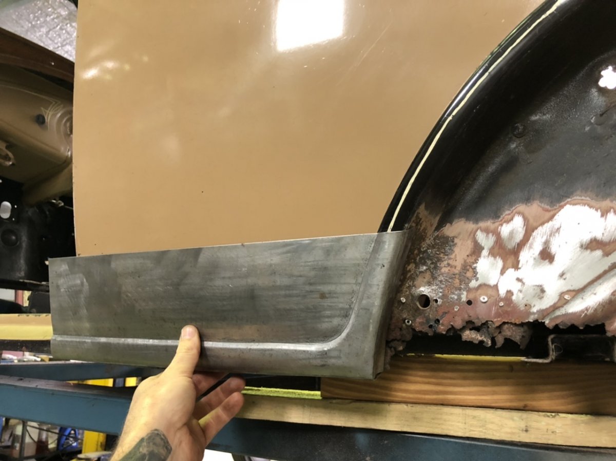

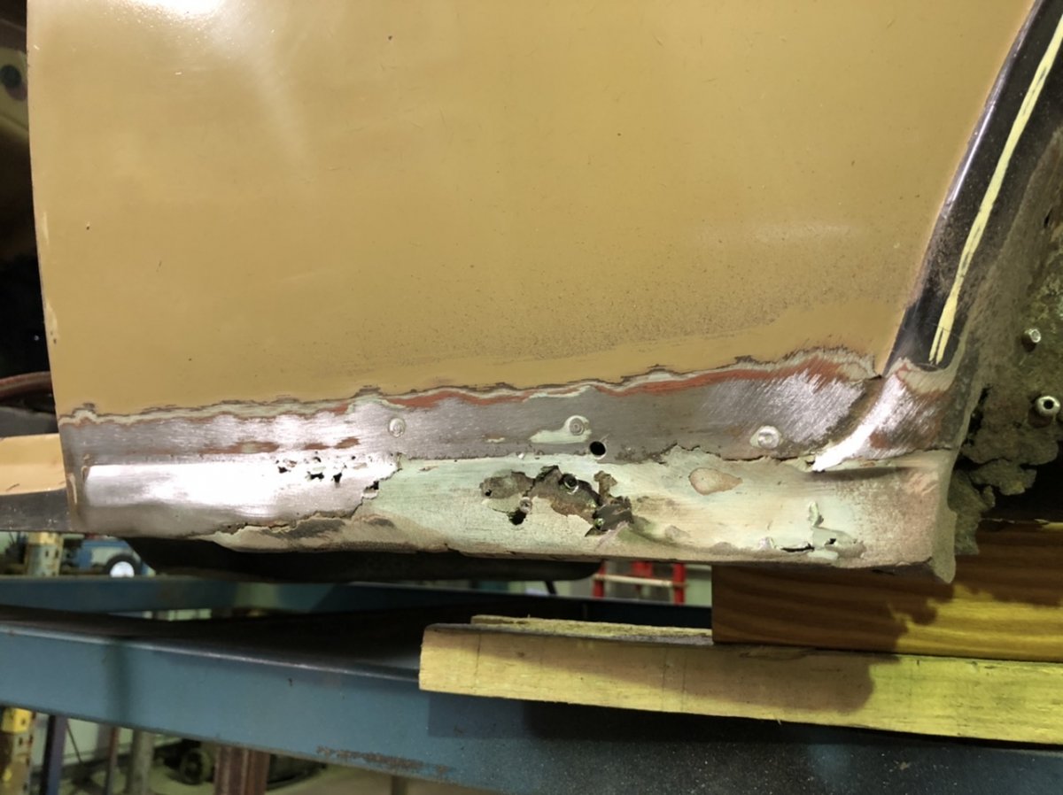

    Ive been working on some tedious jobs like preparing the sub rails so they are in good condition when I splice in the new sections. And repairing cracks and splits in the quarters.
