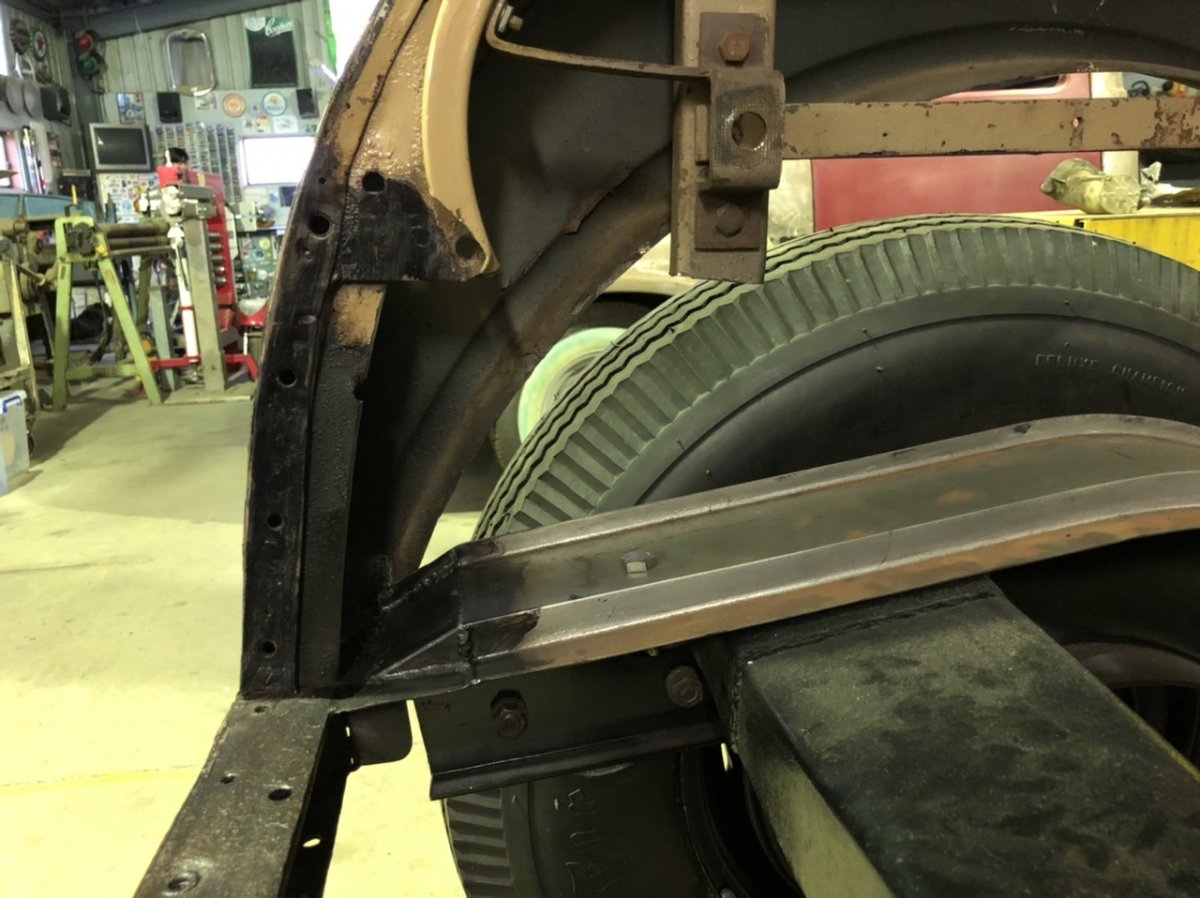

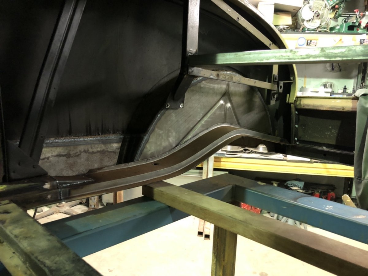

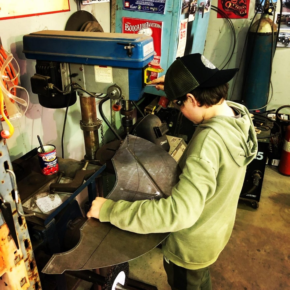

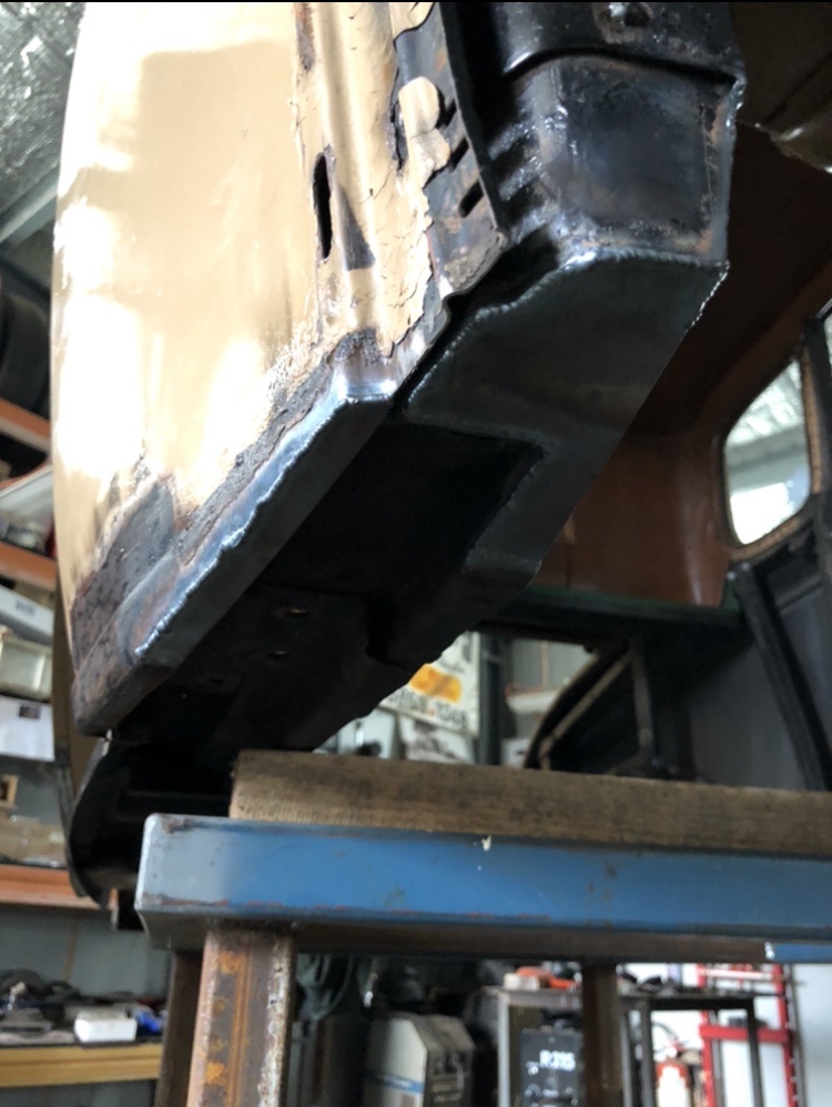

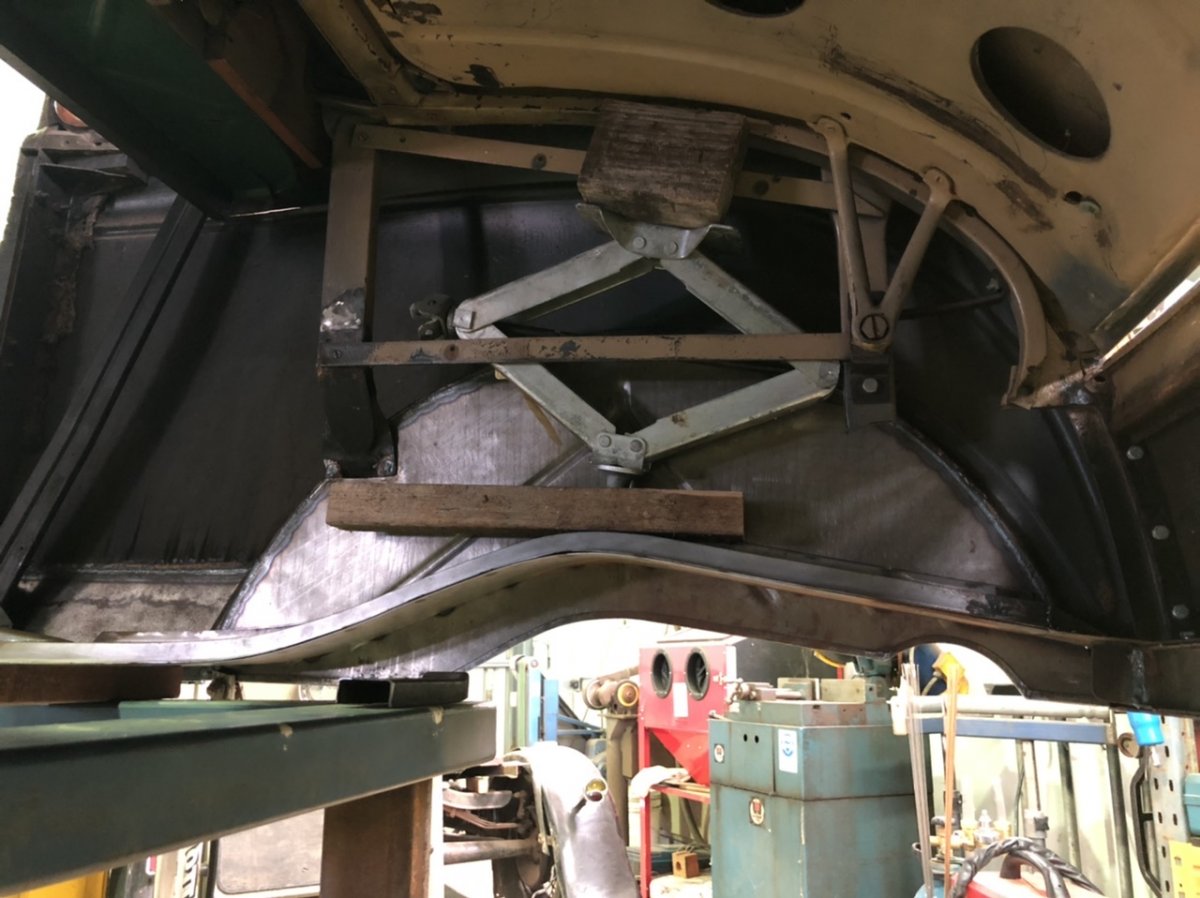

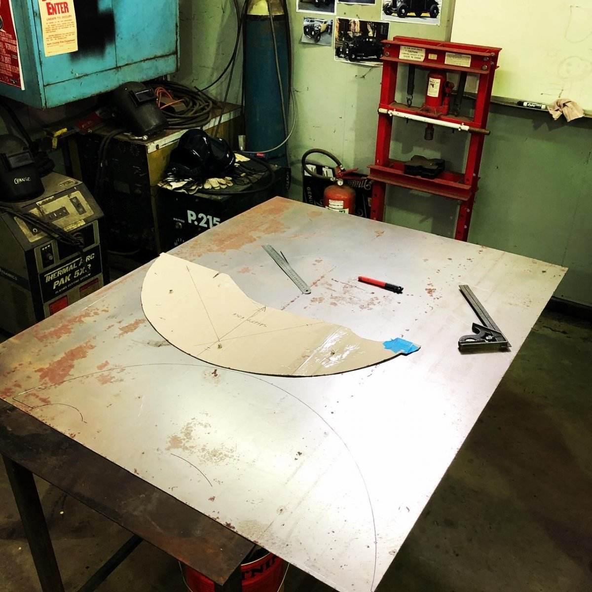

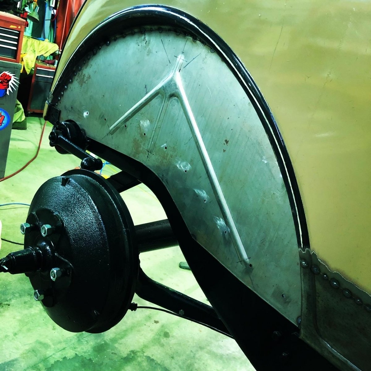

    Not a lot of progress lately.
    My son and I have finished off his motorcycle build and I’ve been working on some yard projects for my wife.
    I’ve also been working a lot of different shifts in my work’s busy season

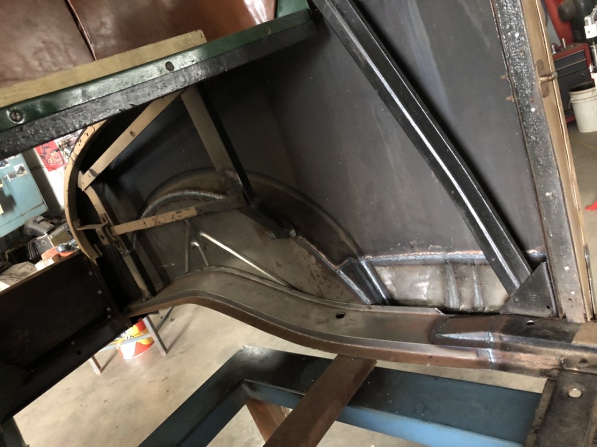

    In saying that I have welded in the sub rails and am making some templates for the wheel wells.
    A7D0C462-C490-4C88-977E-2AC11FA1CA0F.jpeg 3DC64C3E-70EB-40F6-81CD-313C3B3B44B5.jpeg 622A2719-76E9-4DA8-8DB3-DF606B8F264C.jpeg 31BD76E8-75E8-4623-A58F-2B10BDBAFA7B.jpeg

  11. The37Kid
    Joined: Apr 30, 2004
    Posts: 32,786
    The37Kid
    Is that piece that mates the Steadfast rail to the rear crossmember part of the "Kit" or something you had to fab yourself? it all looks nice. Bob [​IMG]
    Stogy likes this.
  12. Wardog

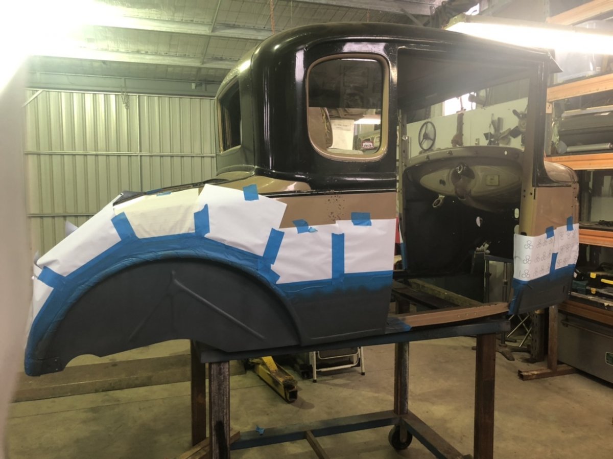

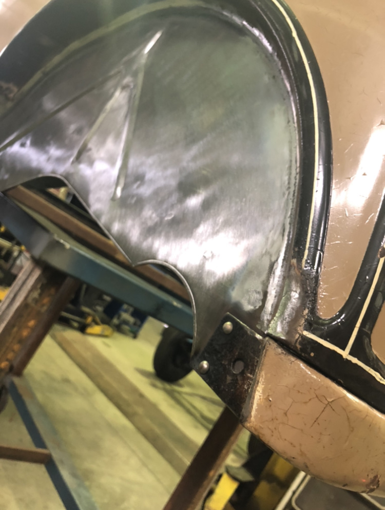

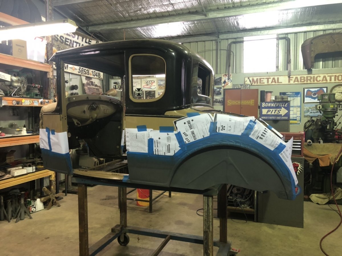

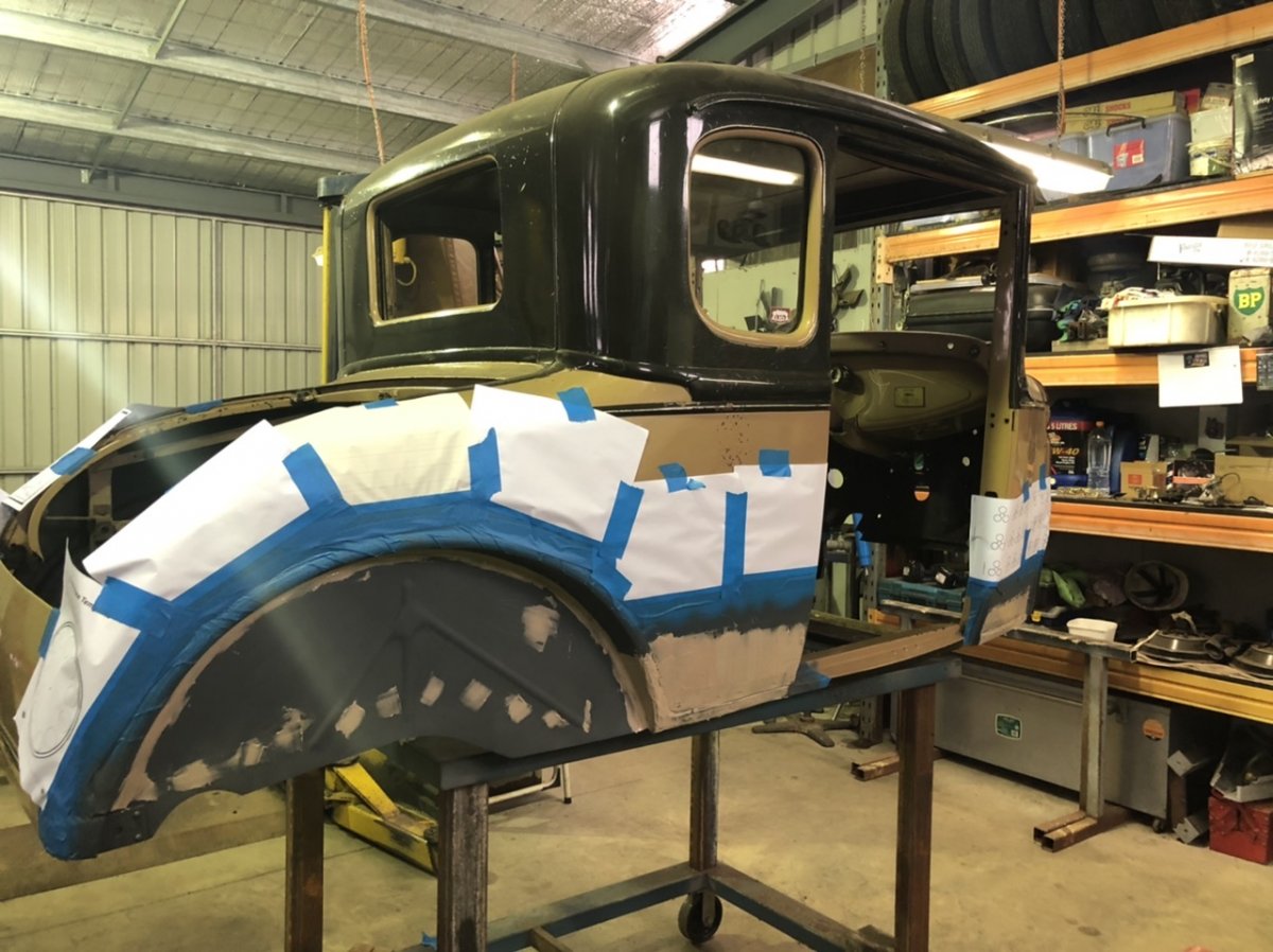

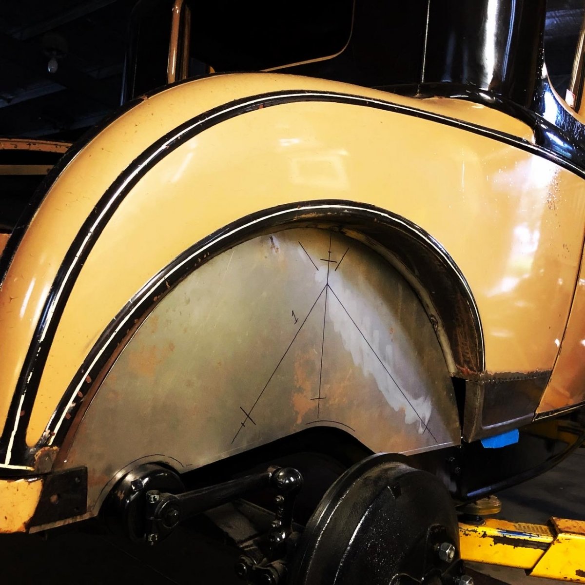

    I made a start on the quarters on Friday. It felt good to be putting some metal back in.
    51BDF665-9C6C-44EF-AE24-906786384E40.jpeg FF156F60-A01F-4A5F-A22D-0545580CB288.jpeg 07E63DAD-9EA0-4219-BE32-B38EA454A6F4.jpeg

  16. The37Kid
    Posts: 32,786
    The37Kid
    Like the bead work on the wheel wells! Bob
    Stogy, Wardog and sloppy jalopies like this.

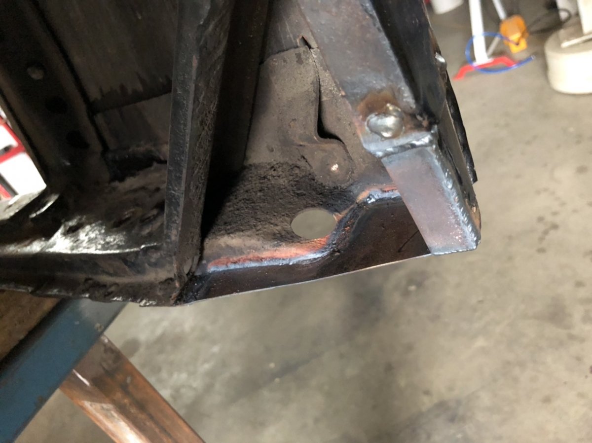

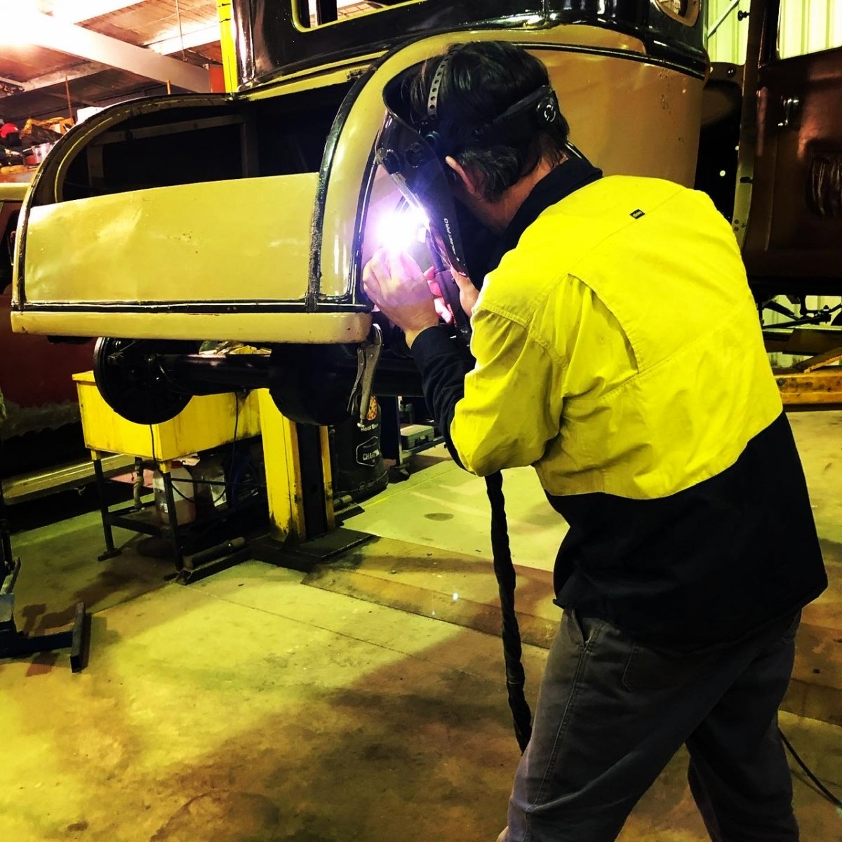

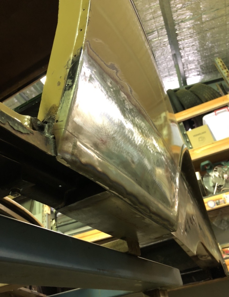

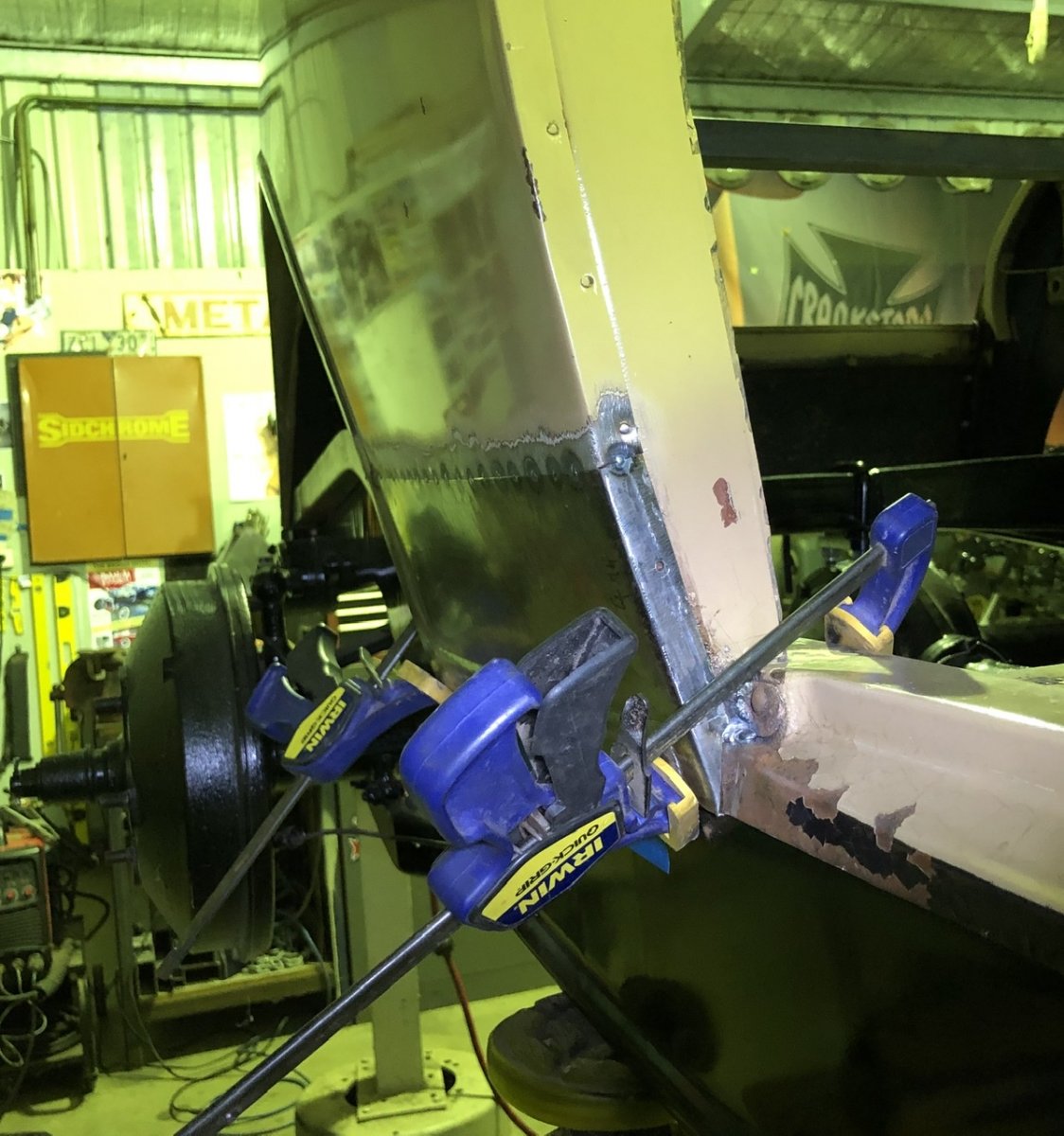

    I’ve just about got all the welding done now. Just the fire wall to go. 97867AD9-1919-40E4-9AEB-55747701AE59.jpeg 752AE205-98F1-4835-B944-04F45AB78BAE.jpeg 610CB539-4CE3-4592-B665-C2D3BCE644BF.jpeg 3AB7F969-D69A-4EA3-90C2-1D24095B82DC.jpeg 2F80D6F7-E153-4282-930F-FDDD6489FF29.jpeg

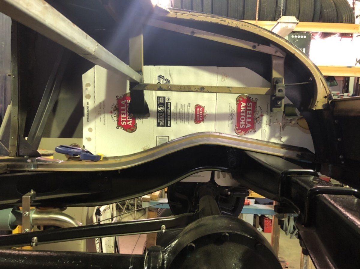

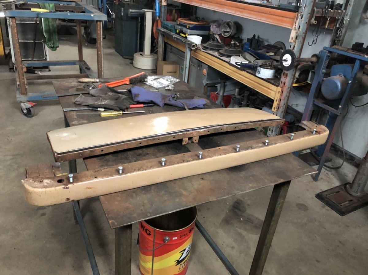

    Talking with a friend he told me to check if the tops of the quarters had rolled in before welding the rear braces. Putting the deck lid on showed the right hand side had and was touching. So a little (hand) pressure with a scissor jack moved it back to where it needed to be.
    CD63B38B-4360-4497-B365-480BEFEBE873.jpeg 6322027B-CA8E-45DC-AAEC-E10B43BBBCDA.jpeg 3EDE3D5F-2BB3-4193-AF5A-4FA835EF5990.jpeg
  22. alchemy
    Joined: Sep 27, 2002
    Posts: 23,073
    alchemy
    Every time I see guys doing all this welding on subrails, I get nervous about decklid fit. A current project I'm working on had been cracked and welded at the corners of the decklid many times by previous owners. Then a total floor and subrail replacement by us. As you can imagine, the decklid wouldn't fit anymore. I actually cut a sliver from the top of the quarter and pushed the trough and bead outward to make room. It was way beyond just pushing it up with a jack.
    I think checking/fitting doors and decklids at all parts of the fab process is very important.

  24. Wardog
    Joined: Jan 12, 2010
    Posts: 2,463
    Wardog
    Checking with the opening panels is definitely important. One thing to remember while doing this is how well or not those panels fitted up in the first place. My doors always sat high at the rear if checking at the belt line. That’s something else I’ll fix while I’m at it.

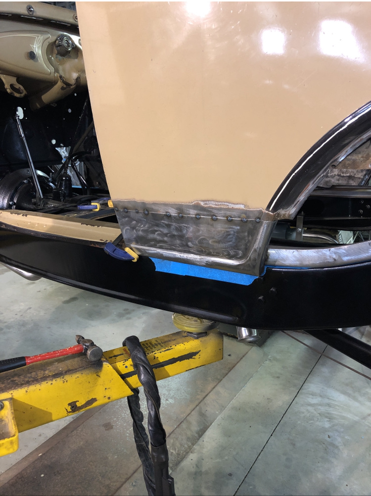

    I spent Friday afternoon finishing off my patches and sanding back welds.
    567C8780-2002-4ACA-B8D4-533D53F01ED3.jpeg E9264103-AB2A-418E-82BC-251670AF57BB.jpeg 0D8B791C-5E6C-4F34-8EB5-4926C22901D8.jpeg

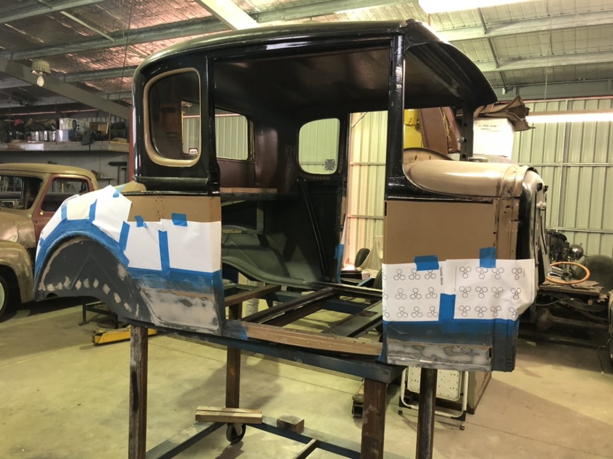

    Saturday I installed the rivets in the rear of the body and got some primer on everything. After lunch I put some filler on the repairs.
    B005A8F9-8B44-411C-B823-35D463E9967F.jpeg D1505B4D-6505-4D2A-80F8-C9A162CE592E.jpeg 87A93287-8D65-4809-AA93-AB1026E8800C.jpeg 4DC77496-45FC-4A8E-B91C-6FA044771D95.jpeg 527692E9-52EA-42D5-81A6-98C3B06A4668.jpeg

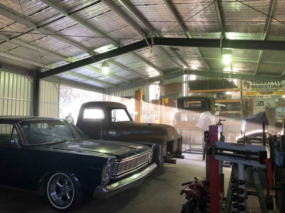

    Today I sanded the filler back on the 4 main patch panels.
    7CDDF95B-D7A8-4636-B99B-D8D4139CF736.jpeg DF846B73-6C40-4C12-854A-B27A5CF578A5.jpeg
    My wife took this photo as I was sweeping up and trying to blow the rest of the dust outside.
