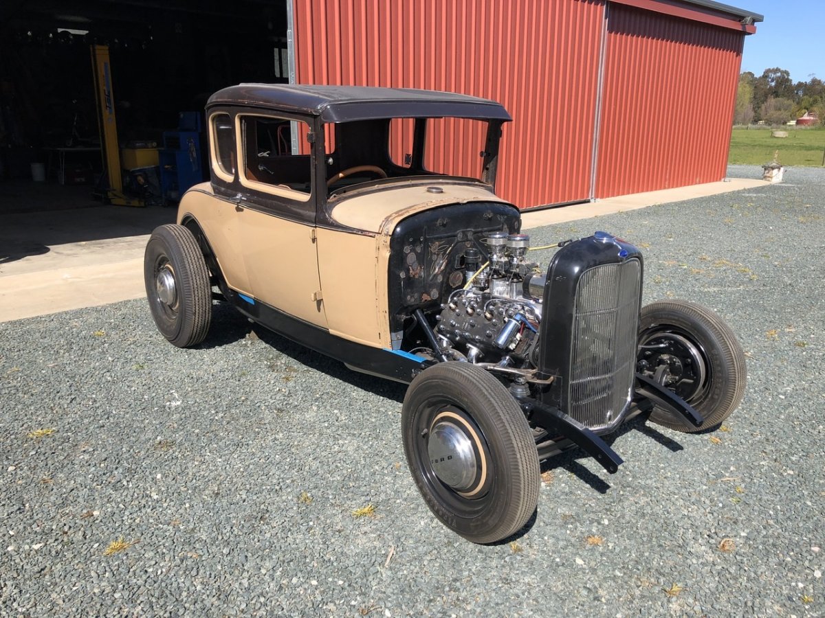

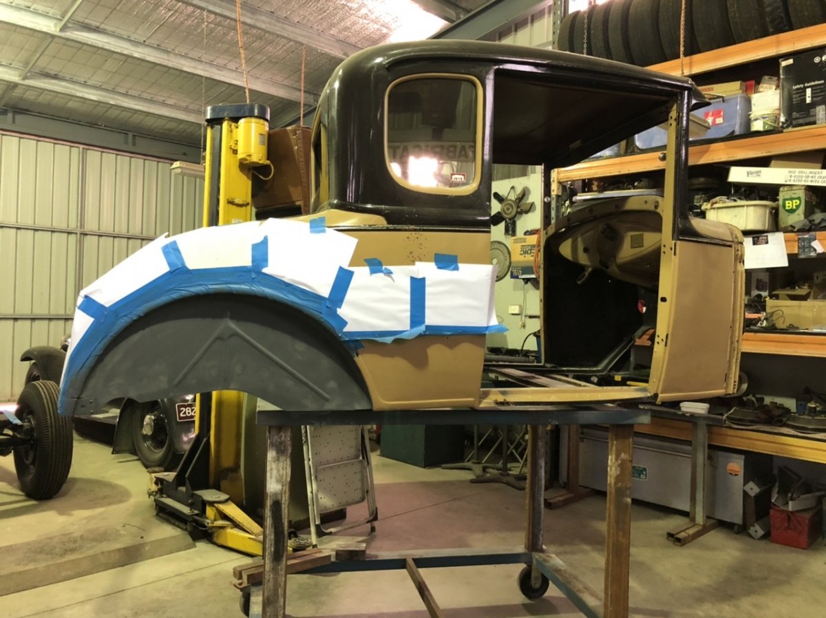

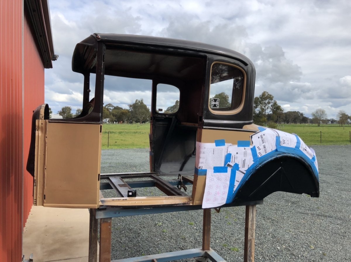

    Yesterday I sanded the wheel wells and painted the body patches.

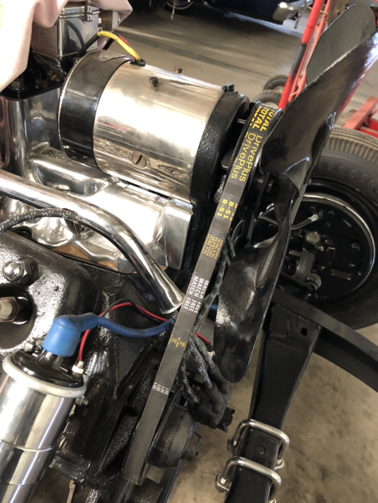

    This week at work I noticed a pile of old v belts that we no longer had a use for. I took one home thinking I could cut it to length and take it to the shop as a guide to buy what I needed. It fitted perfectly, so I also bought home the other 2 as spares.

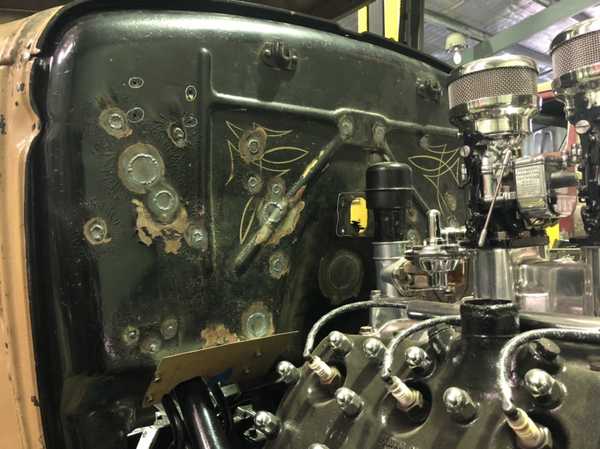

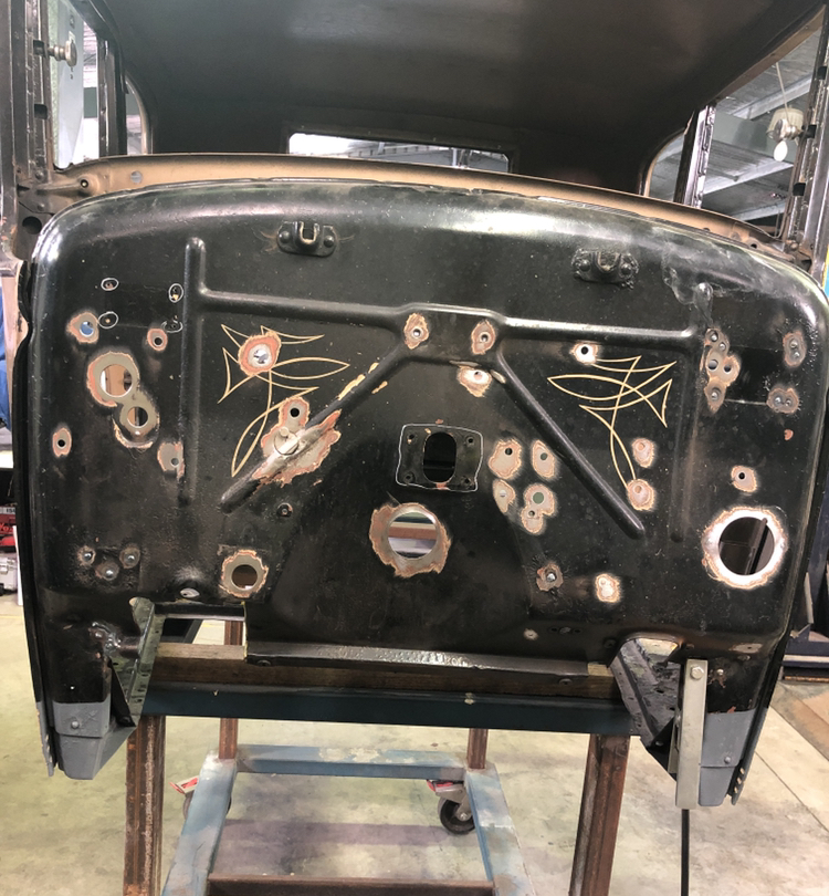

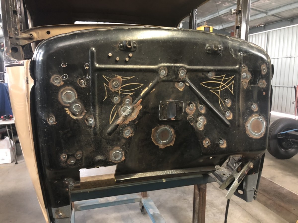

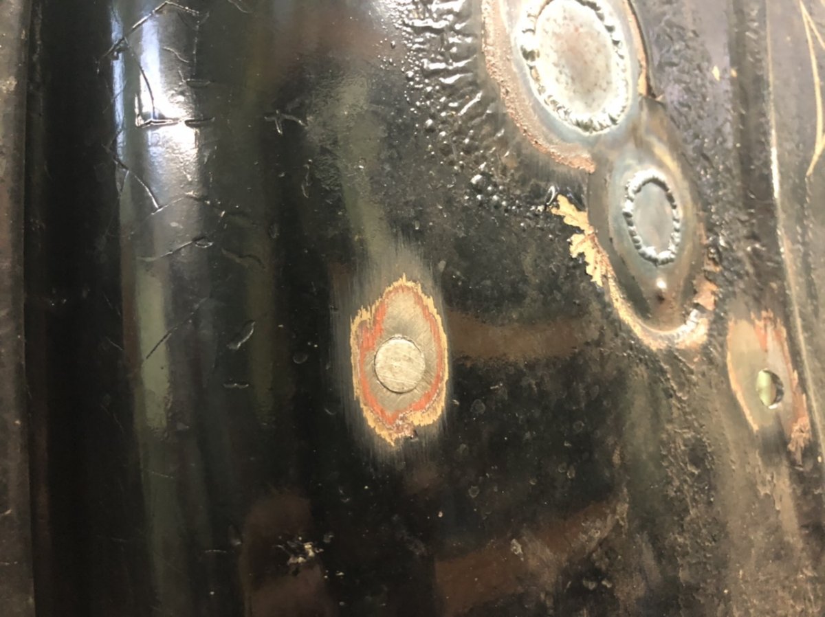

    Whoever used to own my coupe needs their drill and body filler confi****ed...
    I found more after I took this photo...
    Deutscher, Jet96, mgtstumpy and 3 others like this.

    I painted the wheel wells satin black today.

    Every one of those holes were drilled with Hotrod Love...or is it better than Bullet holes...probably neither...making it right then pinstripes...;)
  13. Wardog
    Joined: Jan 12, 2010
    Posts: 2,463
    Wardog
    So much better than bullet holes. If I had to beat everyone of those holes back out that fire wall would be all over the place.
    Stogy likes this.

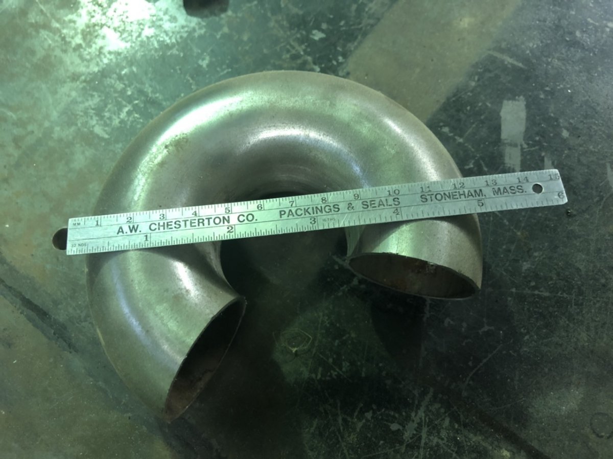

    Where do the tight bends in tubing come from? Someone had a 2" 'donut' some years back, grabbed some, used them. Haven't seen them lately.

    I bought a 5” OD donut in 1.75”
    tube for the headers. I ordered it on line but can’t remember where. It wasn’t hard to find.

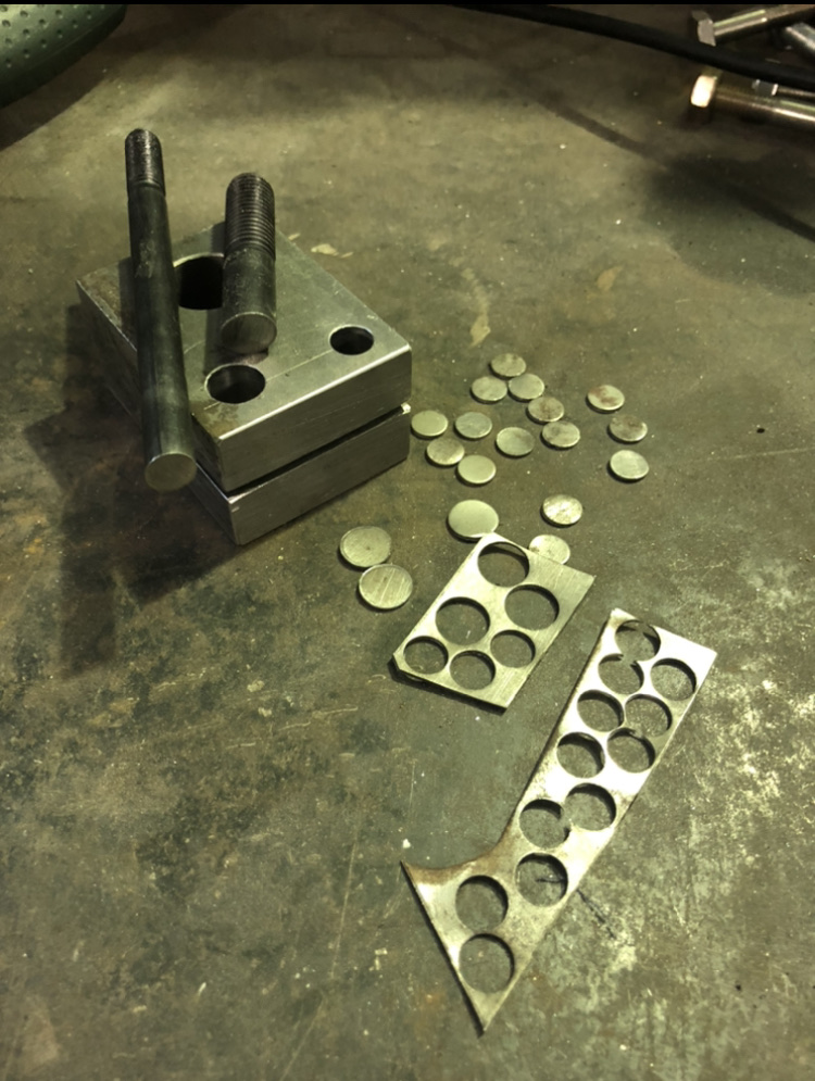

    When filling holes I try to stay away from welding with a br*** block behind.
    If possible I make a filler piece and weld it in. I have a punch that can pop out discs up to 1/4” but a lot of the holes in my firewall were larger.
    So I made a disc punch to pop out larger slugs. It makes 3/8” and 12mm. Then I drill the holes out to the closest size and fill it with a punched disc.
    This is a hole I drilled out to 3/8” and tapped a disc into. It will make for a neater job with less heat distortion from the weld.

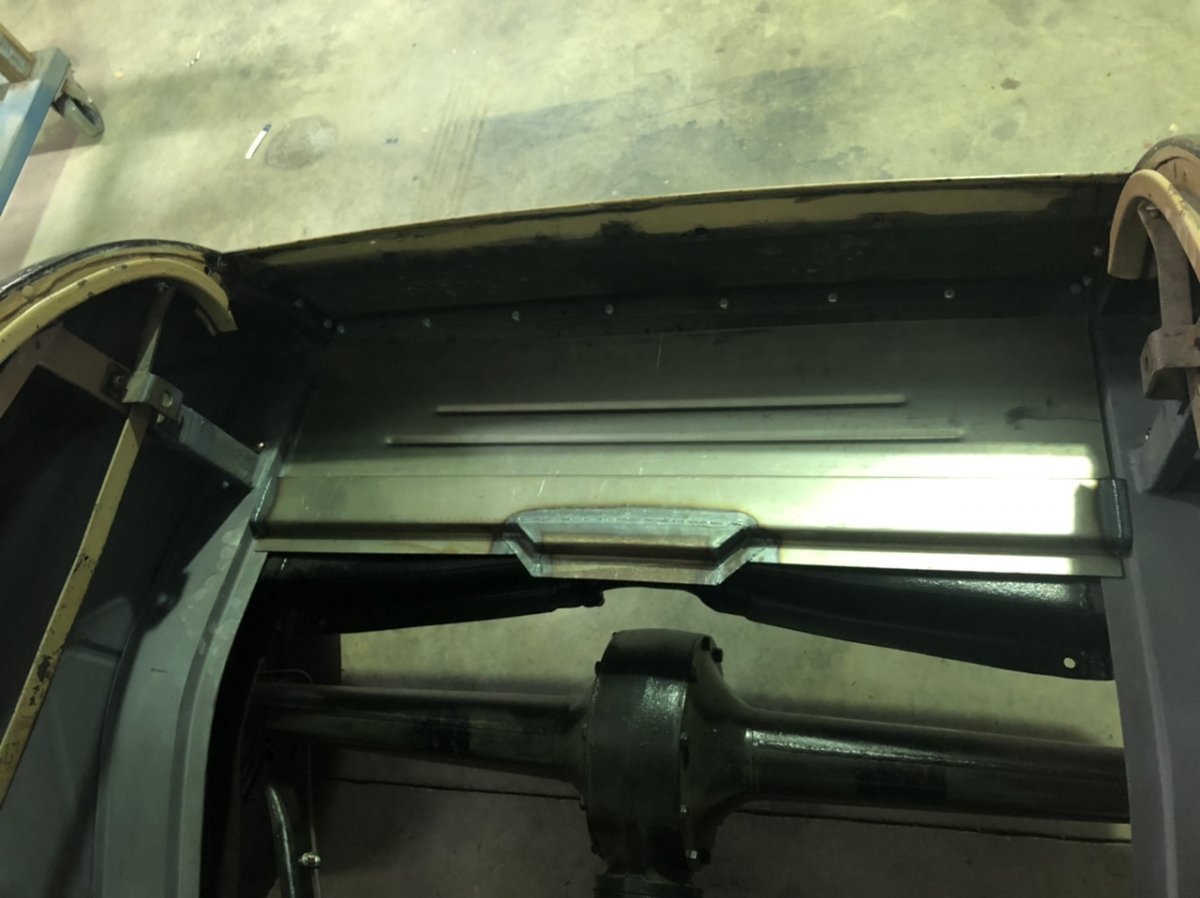

    Then I turned my attention to the rear floor. This panel comes in the Steadfast kit. I had to modify it to clear the rear u bolts.

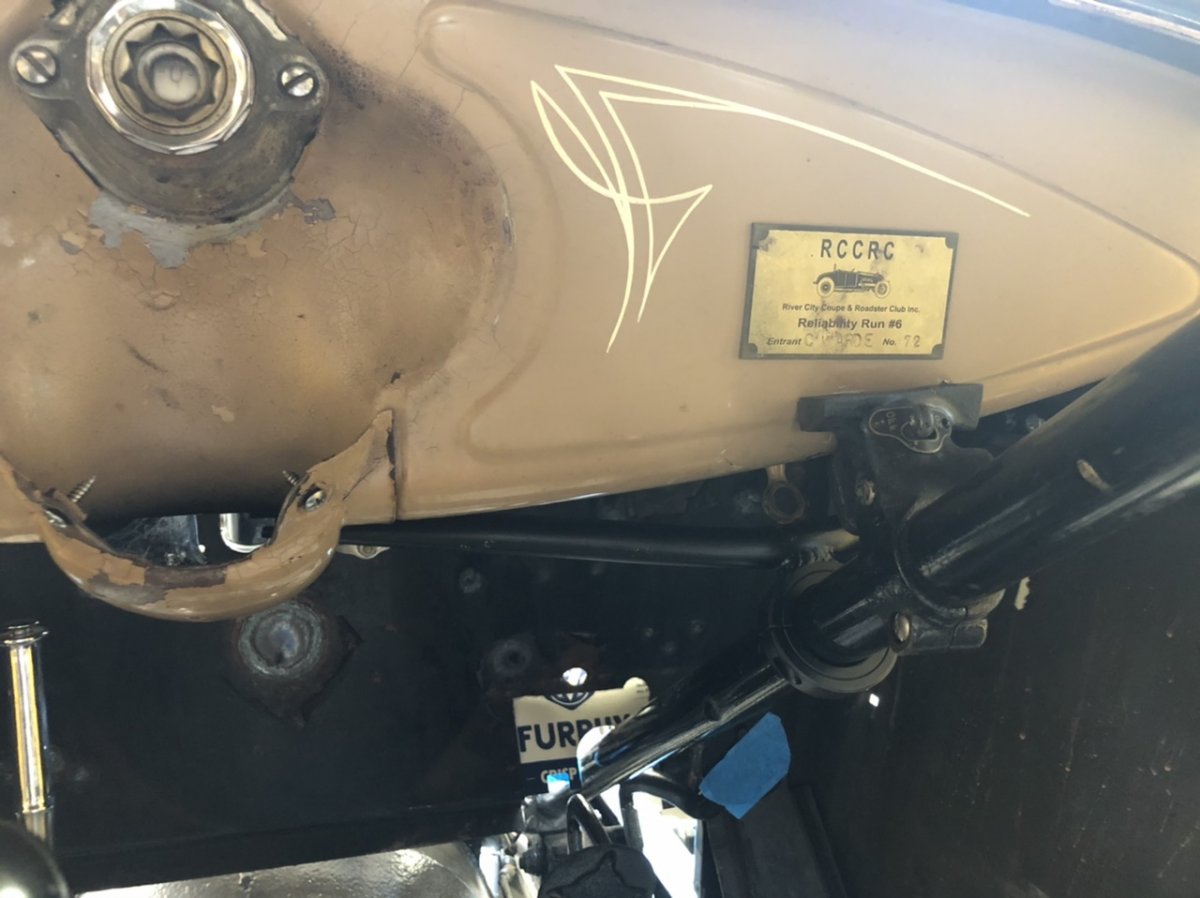

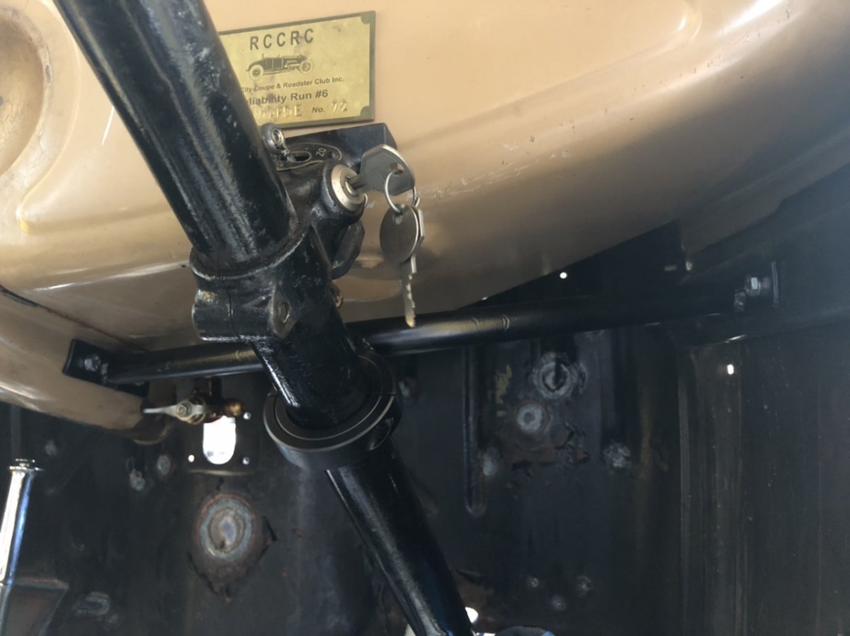

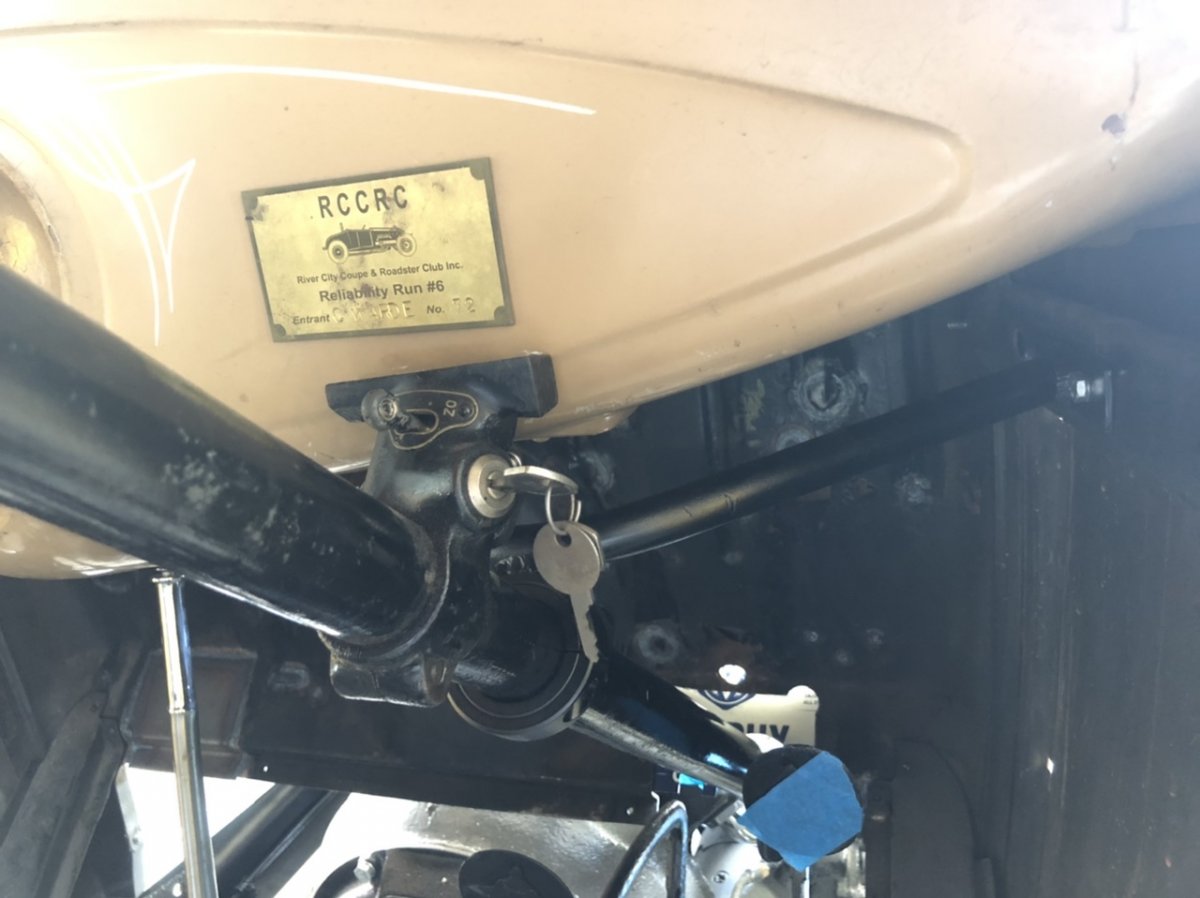

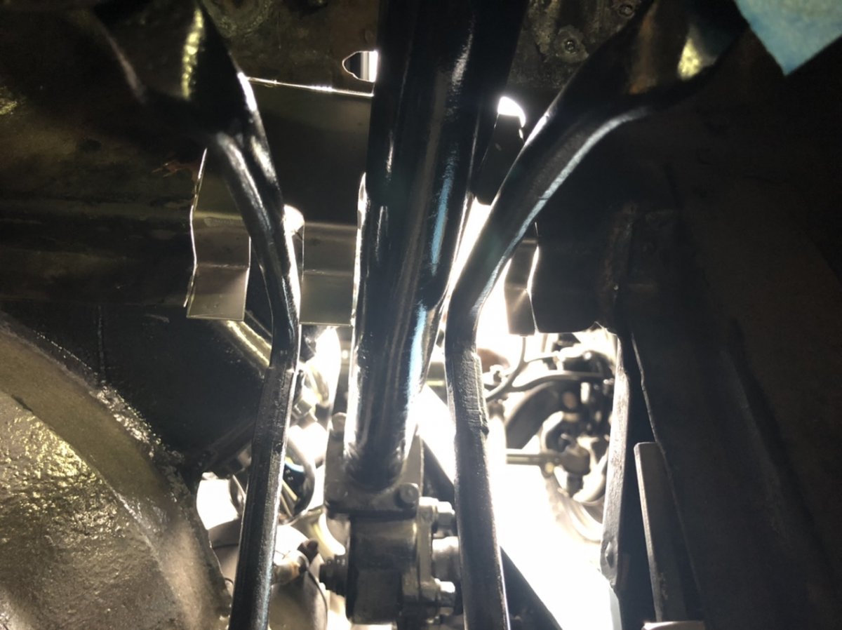

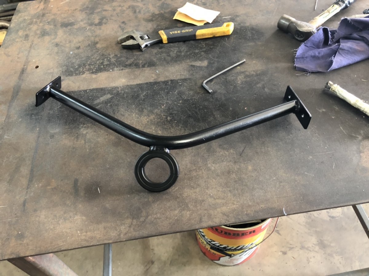

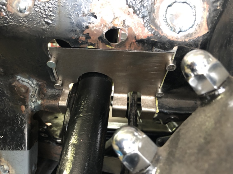

    This weekend I made a bracket to support the steering column at the dash. It’s rock solid and hides well under the the fuel tank.
    6F6473F4-6175-4E52-B976-48A8BA861BF3.jpeg E15B29CE-D73E-479B-B967-C3F830C8705E.jpeg 6B602923-DC9F-4B74-AD28-8DCC7CB34B69.jpeg B93D4626-BFC4-44D7-A7BF-30140F857EEF.jpeg
    Then I made the patch for the fire wall that goes around the steering column and pedals.

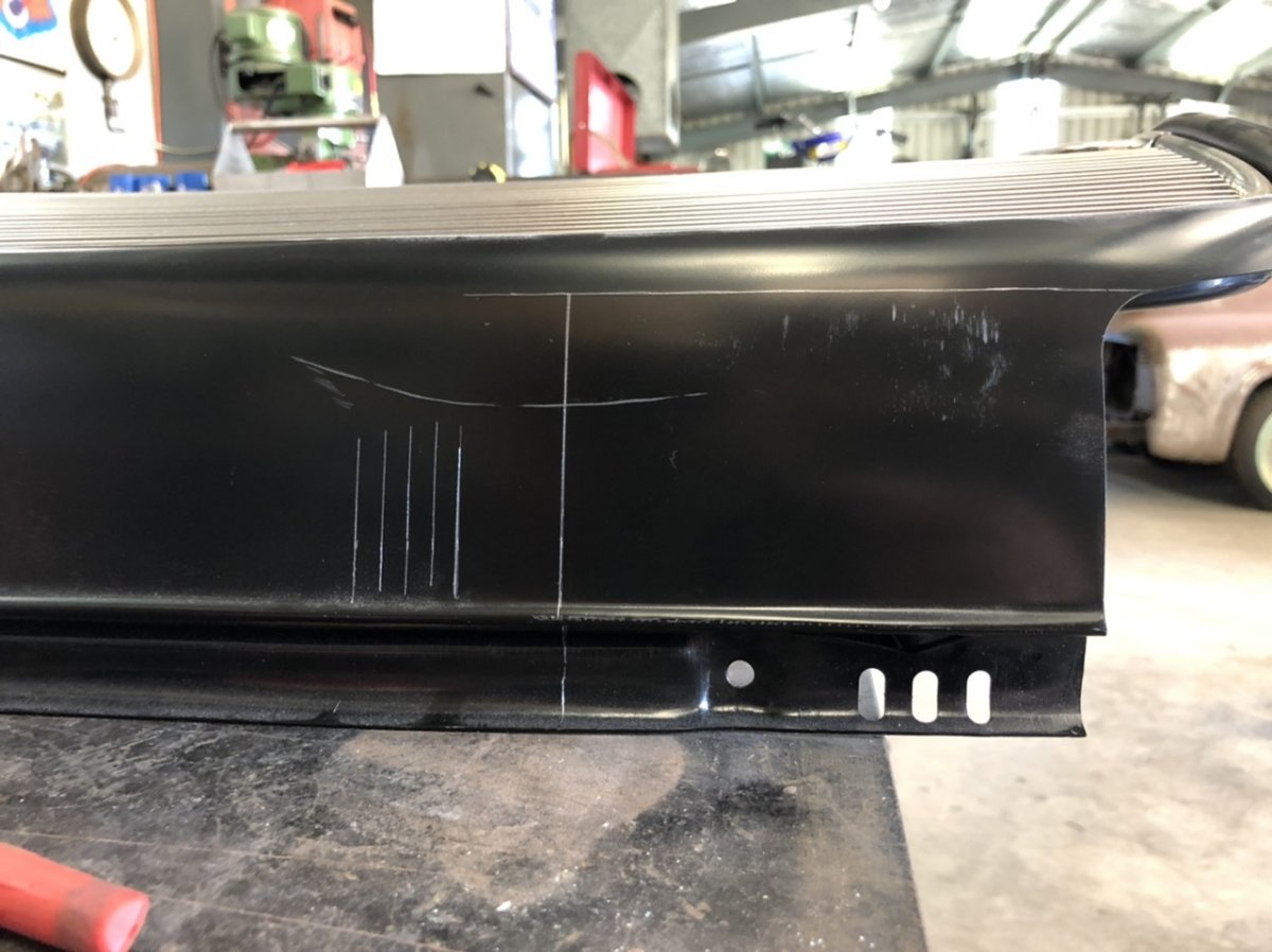

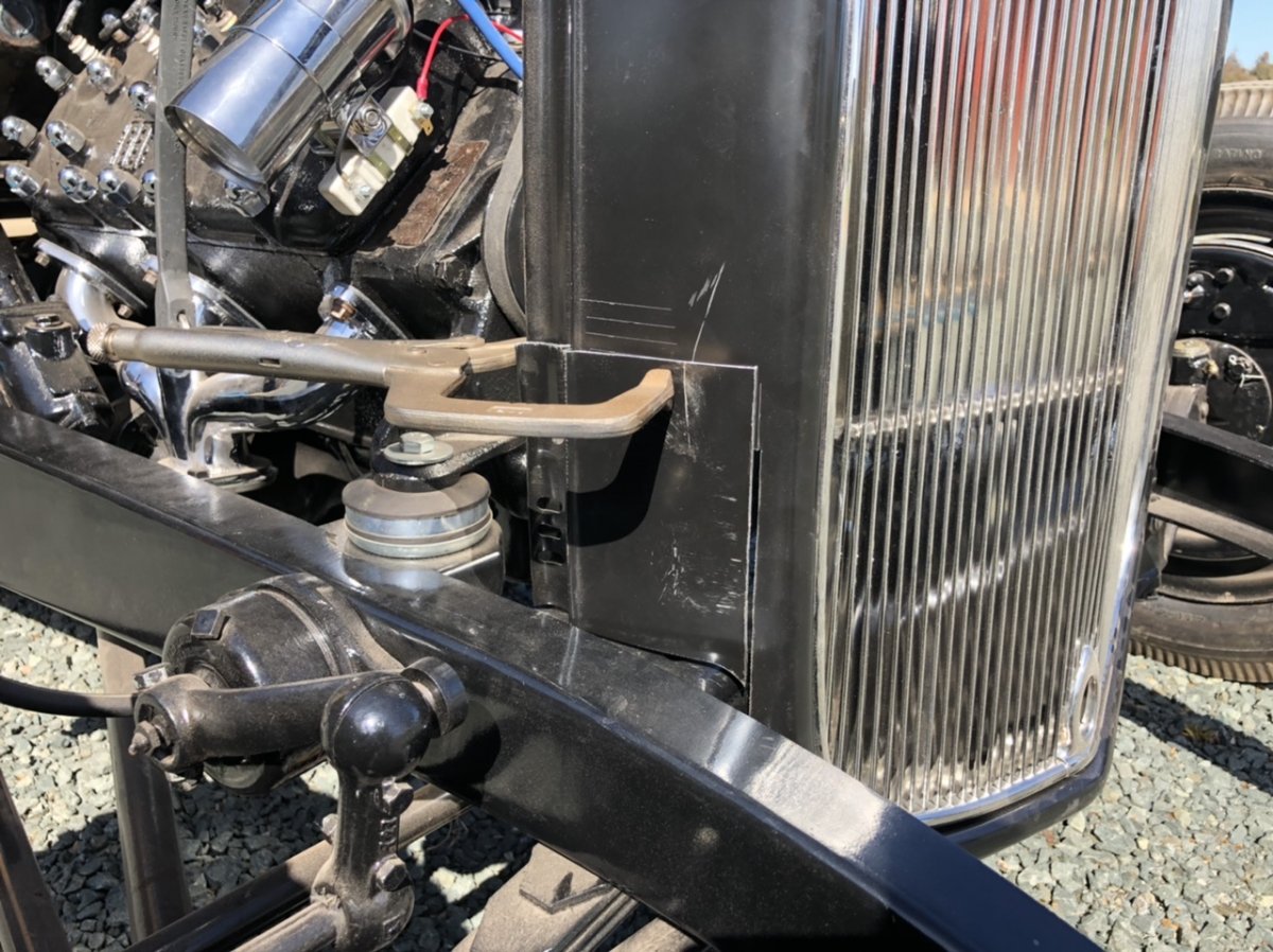

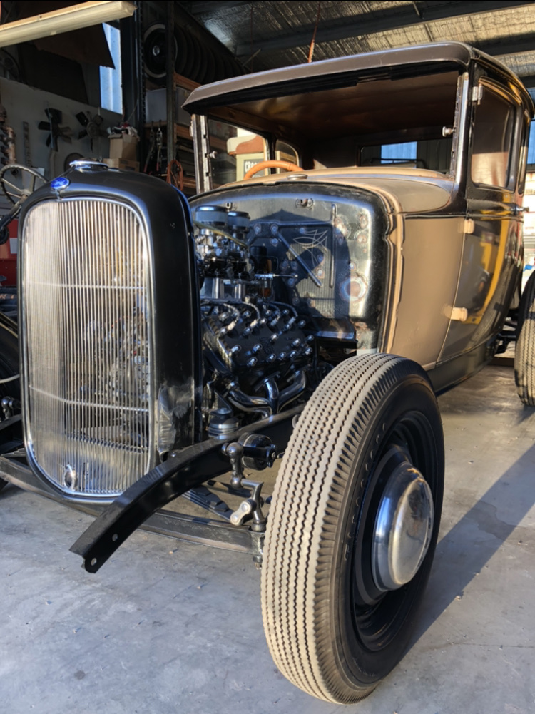

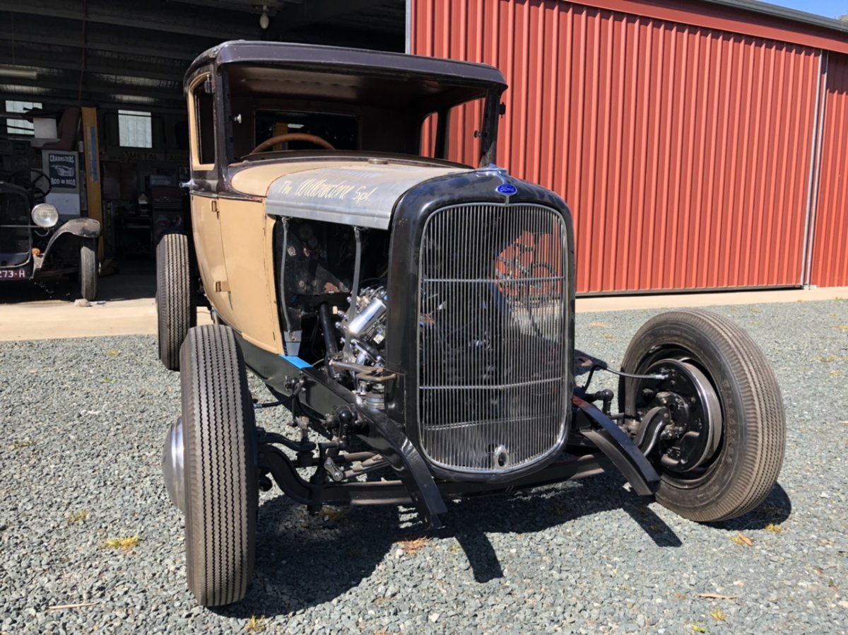

    This weekend I worked on my grille. I relieved the sides to drop it down so it lined up with the cowl but still run a full size insert.
    I cut up a little bit so I wasn’t messing around with the mounting points on the shell. I marked 1” then 1/4” intervals.
    I used the hood top I used to have on the car to set the height by lining up the belt line of the body and hood.
    I ended up taking out 1 1/4”.

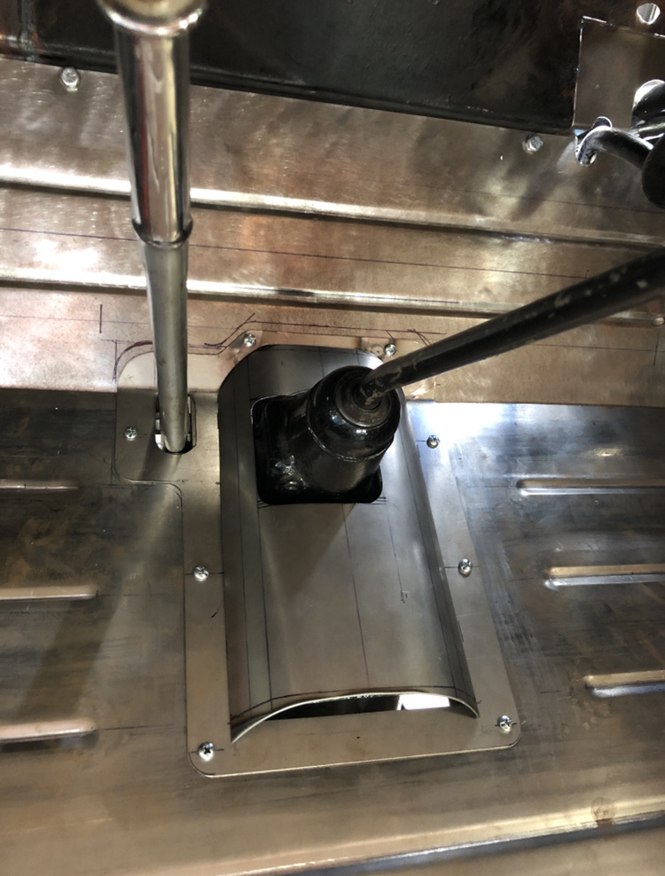

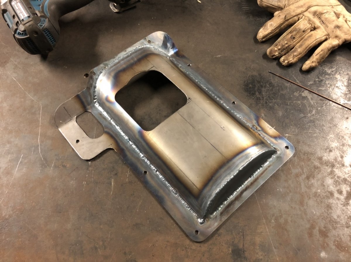

    I made a start on the floors.
    I had to make a trans hump. So I tried to make it as small as possible and styled it like a 32 trans cover.
