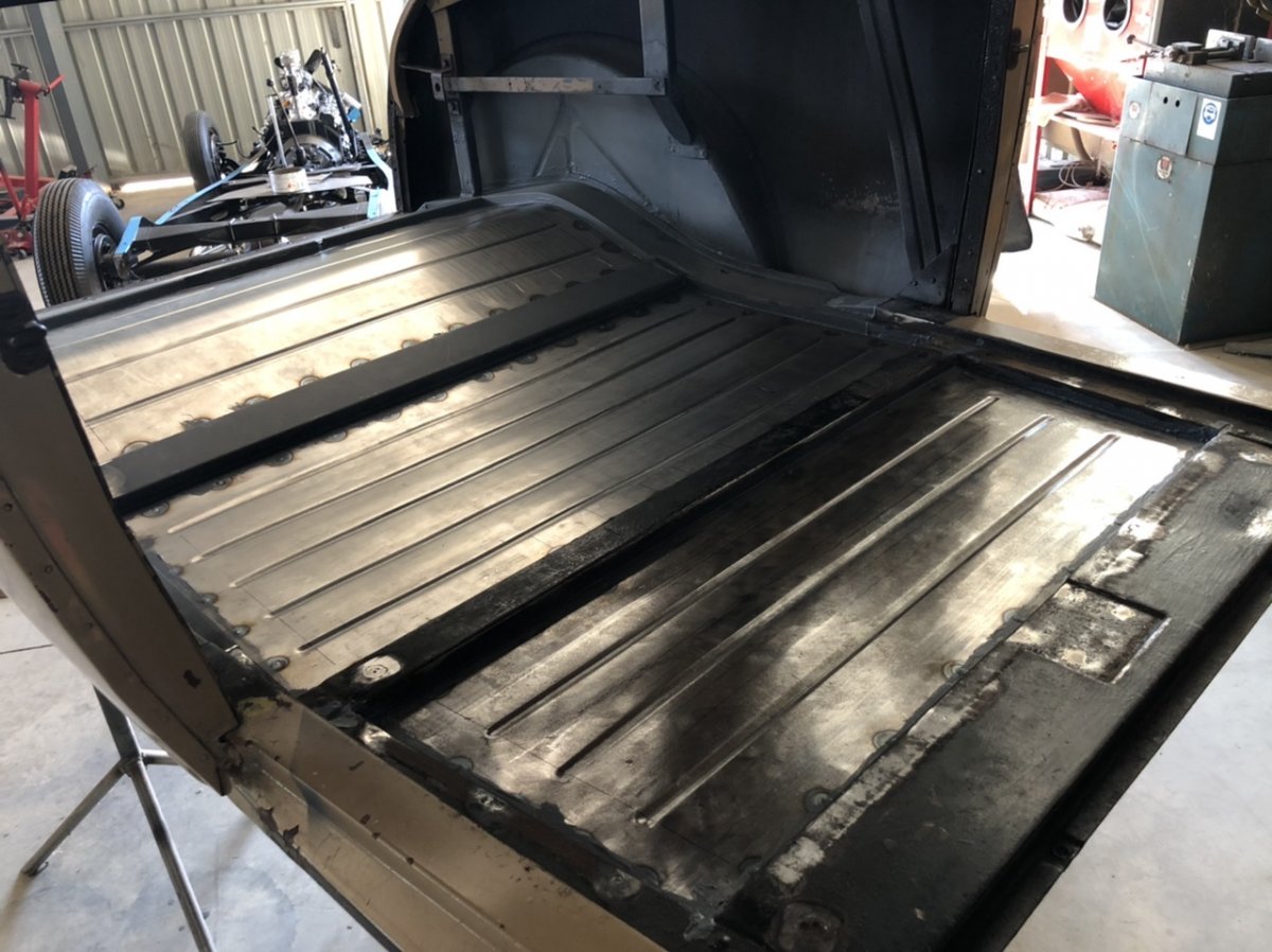

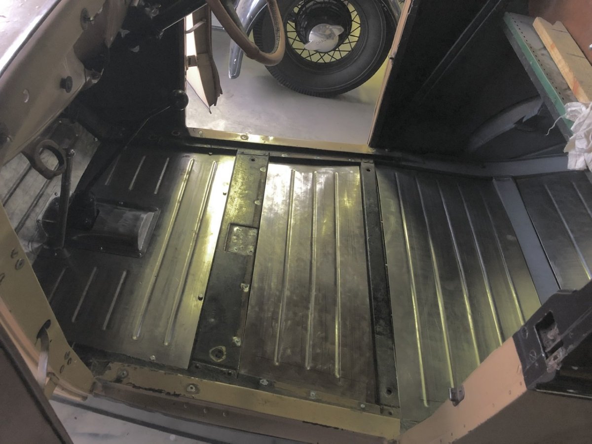

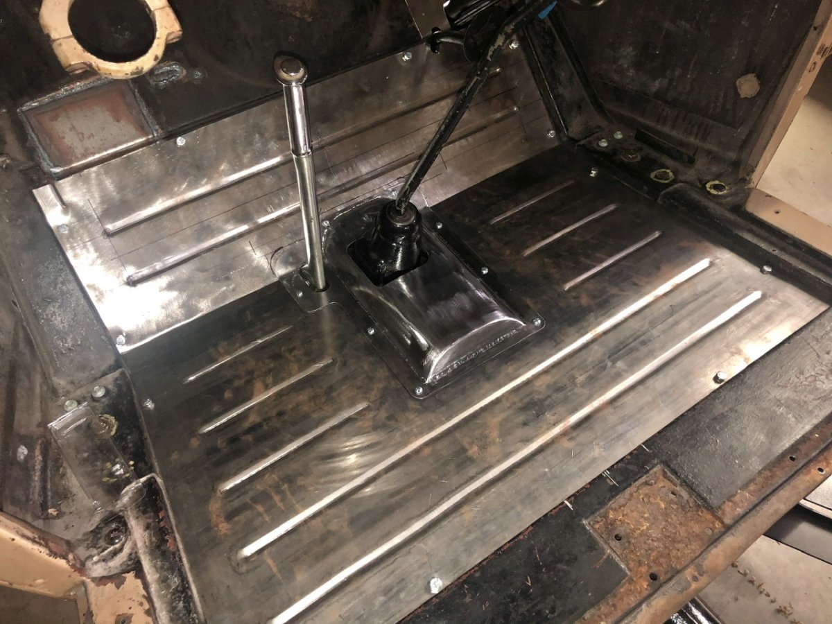

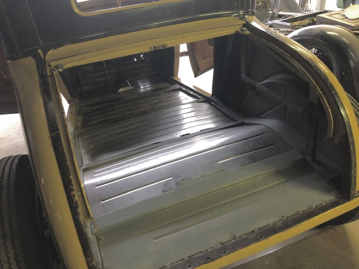

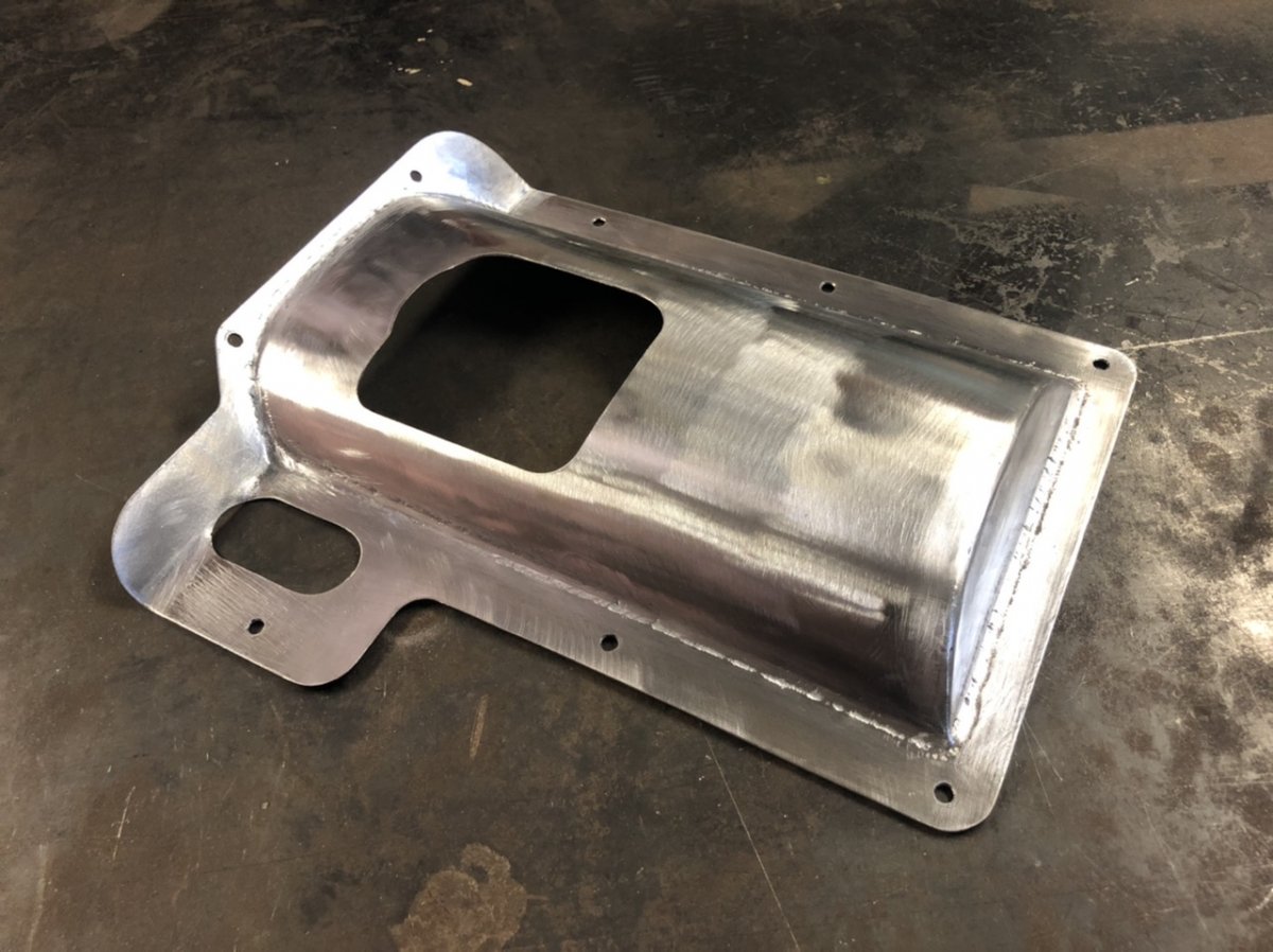

    I finished off the trans cover.
    That finished up the bolt in section of the floors.
    C99B884C-7BB8-4DA8-A64B-A770D5C65D34.jpeg C9E4DB5E-2EE9-4EF6-A8BA-31107250B72F.jpeg 6CAED71E-69C4-418C-93CE-BB156E7CF0E1.jpeg 75A9B5E5-AE99-40DB-A57D-95061E42A45E.jpeg
    With a little help. I made all the floor sections. I have just finished lifting the body off again to weld these all in.

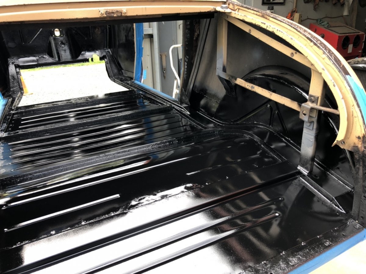

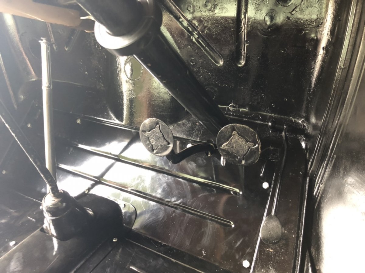

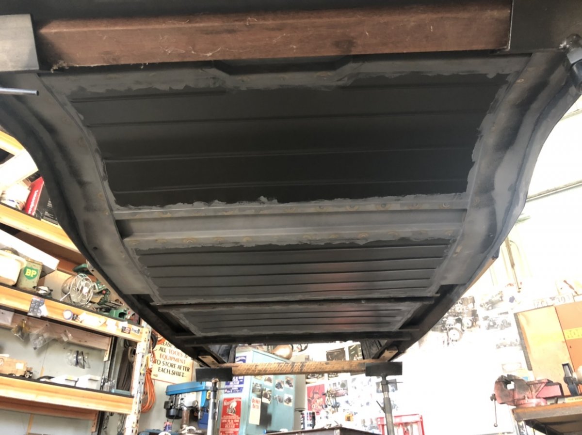

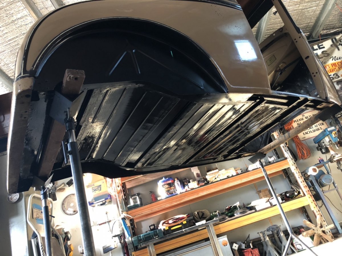

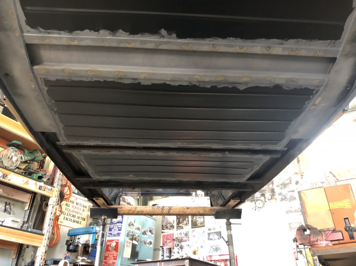

    Last week I welded in the floor pans.
    I painted the under side first so there was paint between the mating surfaces. Then I sealed the top and bottom with a brush on seam sealer.
    18267E0C-125C-4EE1-B2AB-12088DA0CFFA.jpeg A20094FC-8C7B-4044-BC27-3A18FD0F156D.jpeg 230351F9-A62A-45DA-B002-A43757CBDC51.jpeg
    Underneath I brushed on a bitumen based undercarriage paint.
    I finished welding the fire wall then cleaned up the welds.
    Then I put some paint on everything.
    F4217F1C-6100-444A-B4EE-780FC50796DE.jpeg 1127816C-C623-450B-894B-A0571C0BF279.jpeg

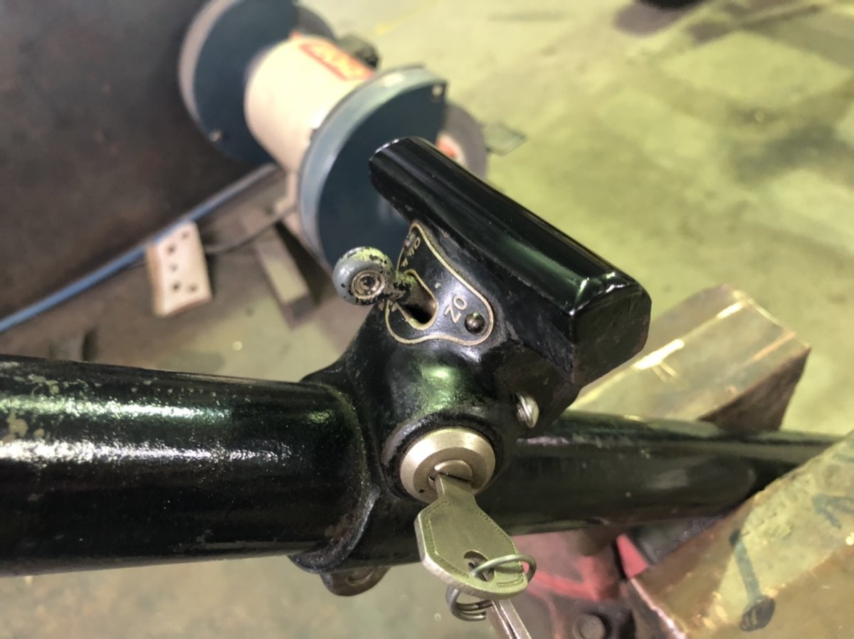

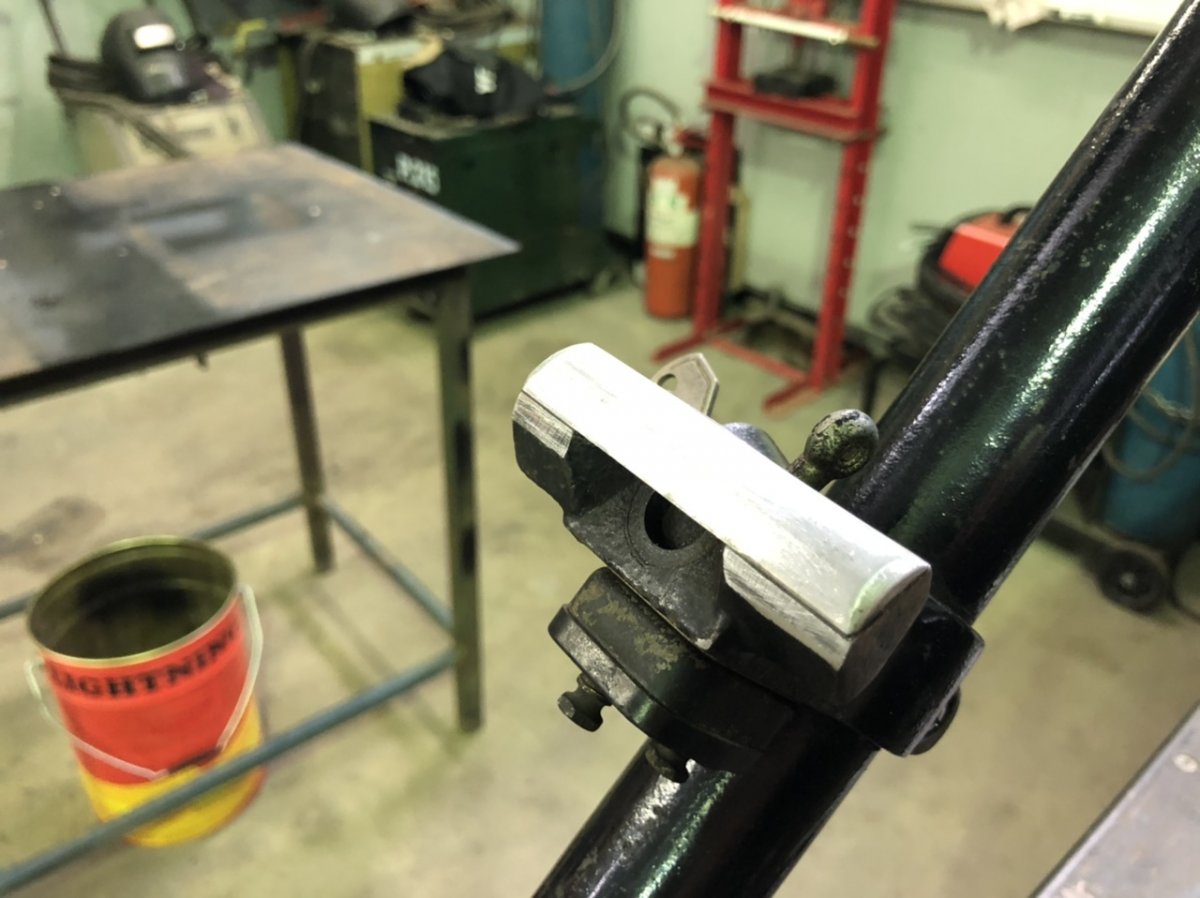

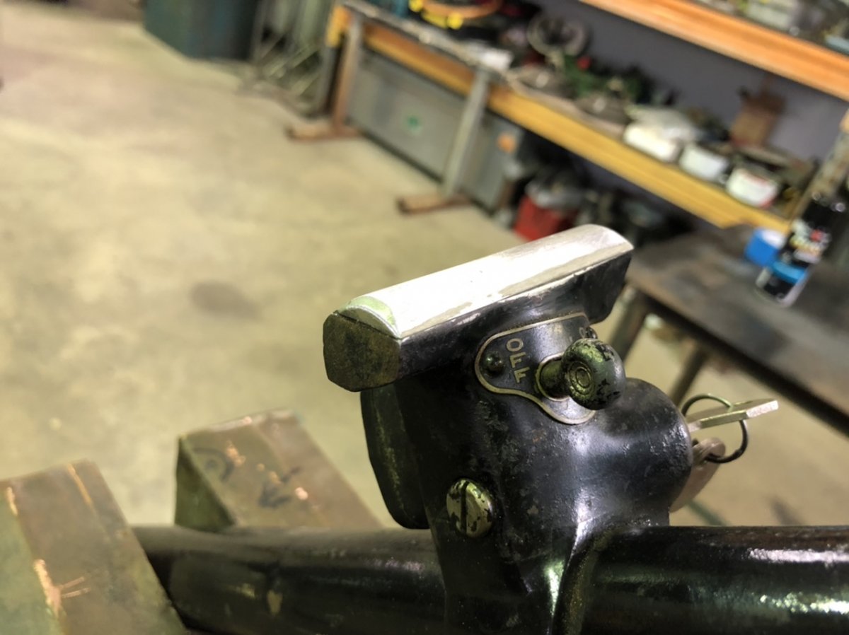

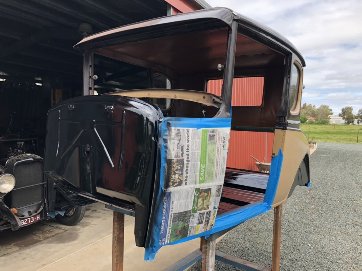

    With the 32 column drop sitting in front of the dash I decided to finish it off a bit nicer. I cut and shaped some aluminium D moulding and glued it on with a 2 part epoxy.
    DA5B1FFE-A153-4B8F-8798-96327C88E5B5.jpeg 227DE054-380A-4A0D-BA98-2DC2347238B6.jpeg CF71FFA4-0C79-4794-8852-BA66EDC79CC9.jpeg

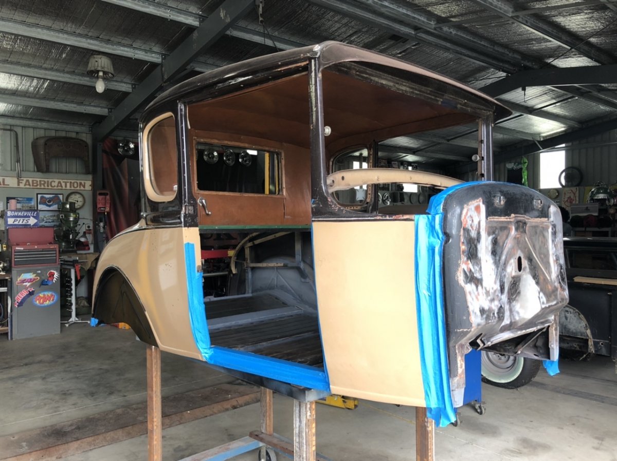

    I fitted the body again after finishing the floors and firewall.

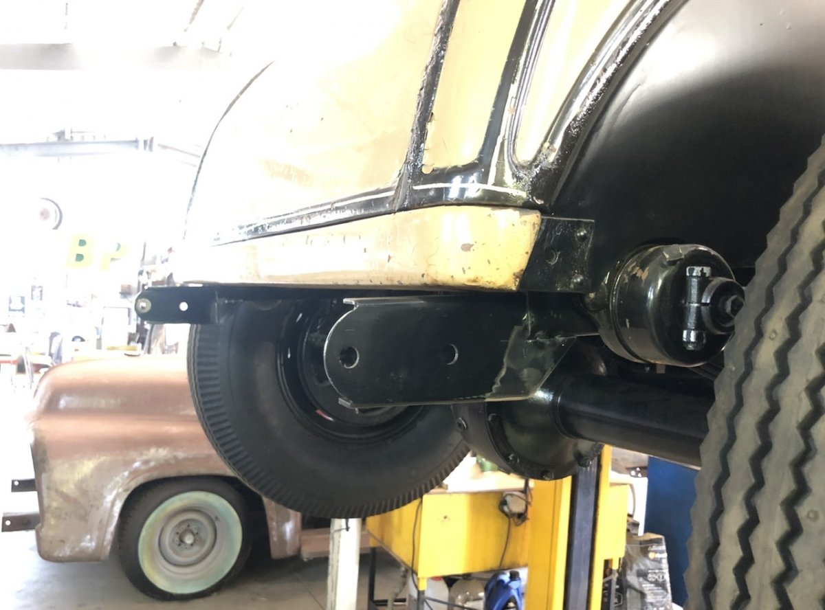

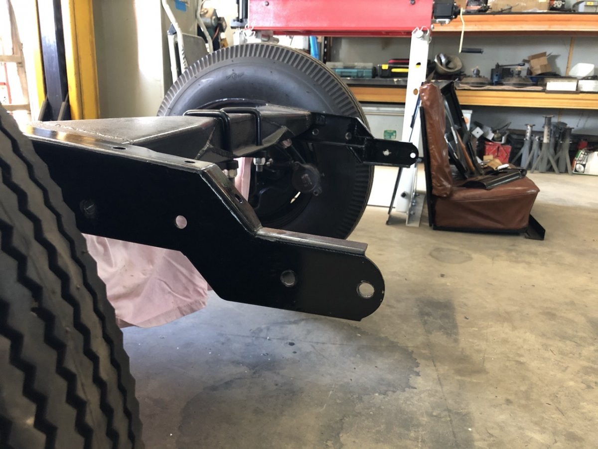

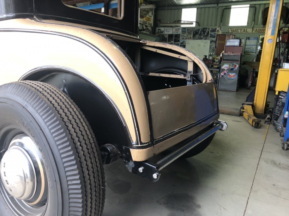

    I decided I want to run a rear spreader bar tucked up nice and tight to the body. So I shortened the sections of ch***is rail I had already cut off. Now they are tacked up I guess it’s time to remove the body again to weld them and touch up the frames paint.

  19. Wardog
    Joined: Jan 12, 2010
    Posts: 2,463
    Wardog

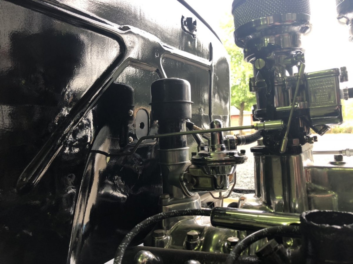

    I’ve had a lot of small jobs I’ve been working on at once lately. Today I finished the accelerator pedal and linkage. I used a right hand drive 32 pedal, I shortened the rod 2” and mounted it inside the firewall then made a linkage to the rear carb out of stainless rod.
    4DB5698D-E17A-41BB-A51C-FB9483FAF788.jpeg 60805AE5-0E06-4D75-8872-9A97F0BA9A2A.jpeg 0CE6A42A-C45F-4352-BDD0-4D226A5330F7.jpeg

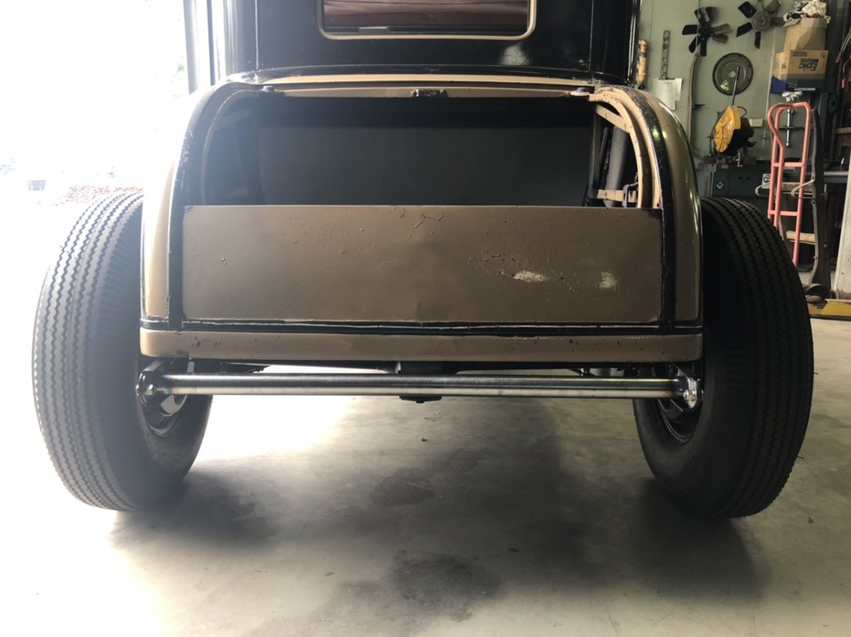

    The other job I finished today was the rear spreader bar. I messed around for a long time with placement but I’m happy to have it up close just to fill the void Model A’s seem to have at the rear of the body.
    F4E1FB4E-34E0-4078-95FD-D8A4E6DD16F6.jpeg F6F1F2A0-6C2F-4FE1-BCC1-4BEB5E3B3A0B.jpeg

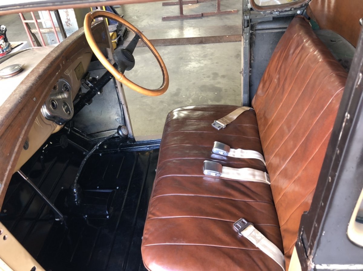

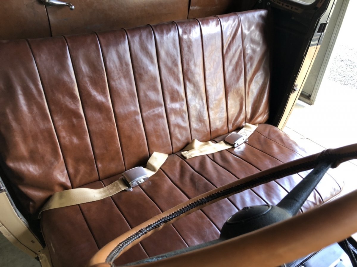

    I set up the seat using the stock seat base on a hinged flat mount. The back rest is the same hinged mount and some 2” medium density foam. I unpicked the trim from the stock backrest and covered the foam with it.
    I set up some safety belts. I bent my shifter to clear the dash and installed my Lucky Burton shift knob.
    So I pulled the body off and finished the step down at the rear of the ch***is.
    I’ll touch up the paint on the frame and get the body back on.

  24. brEad
    Joined: Dec 23, 2016
    Posts: 2,039
    brEad
    I really like your spreader bar mounting solution. Did you consider putting just a tiny bit of curve in the bar to follow the body?
    Stogy likes this.
  25. Wardog
    Posts: 2,463
    Wardog
    @brEad i did consider it for a bit. But every time I go to do something like that I tell myself that wouldn’t of happened in the 40’s. I had the same thoughts with the floors. Had I not been trying to keep an early style I would of bead rolled stepped panels in the floor panels.
    brEad and Outback like this.

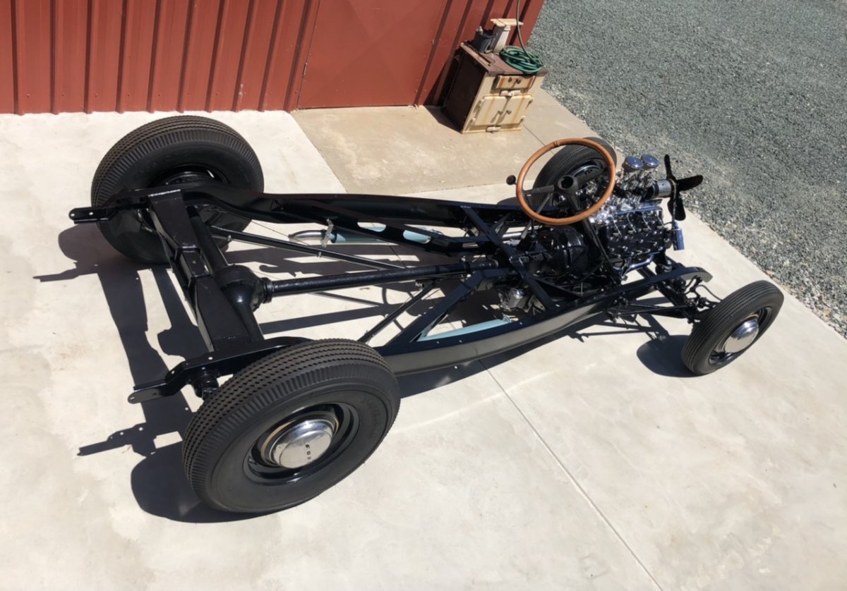

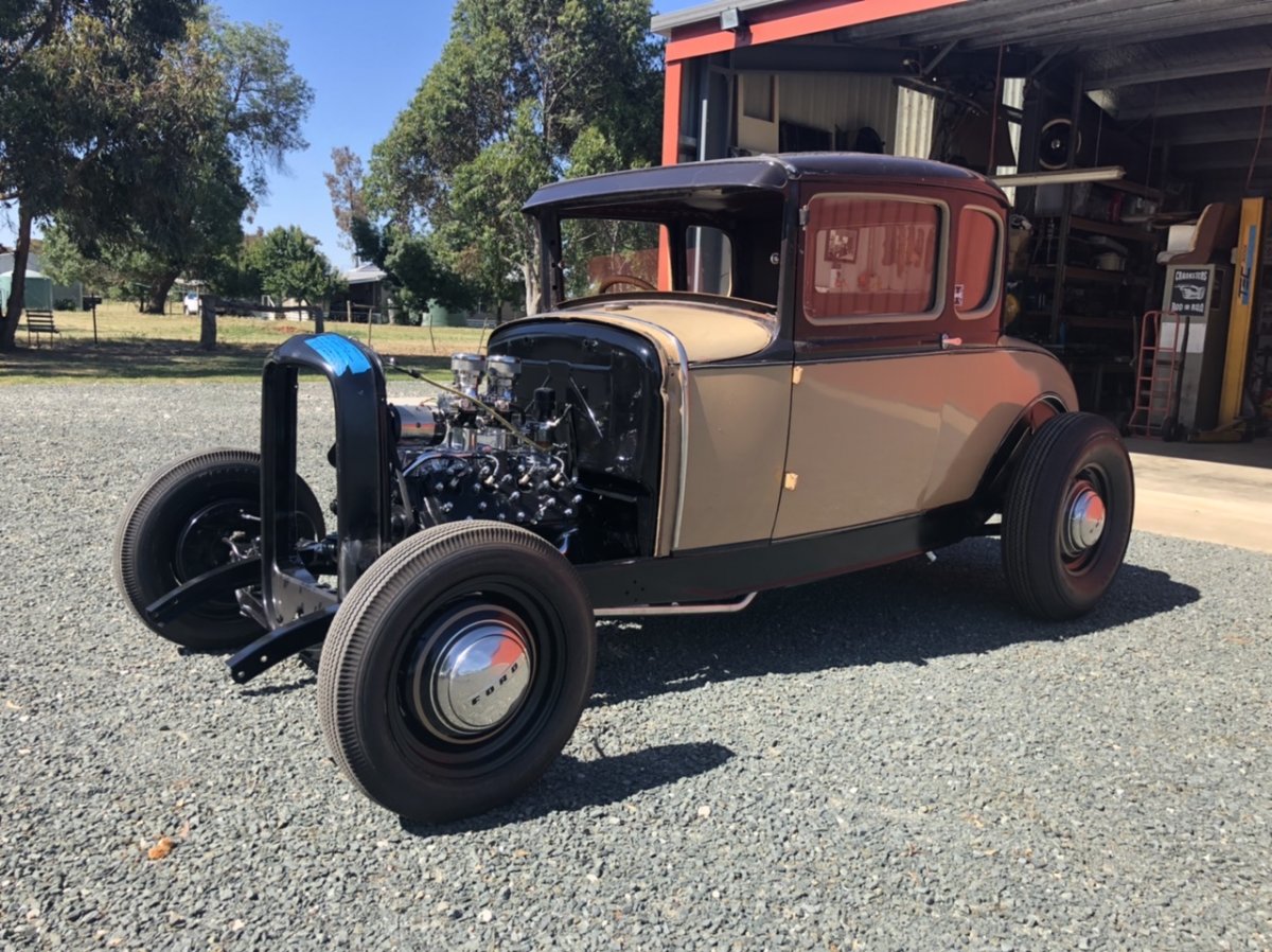

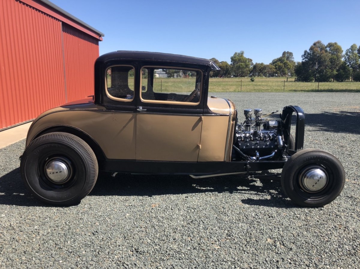

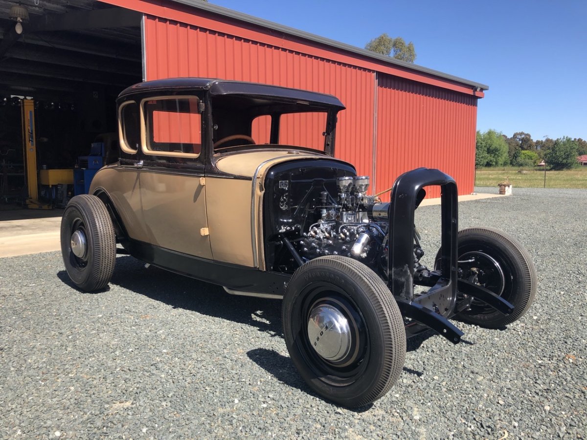

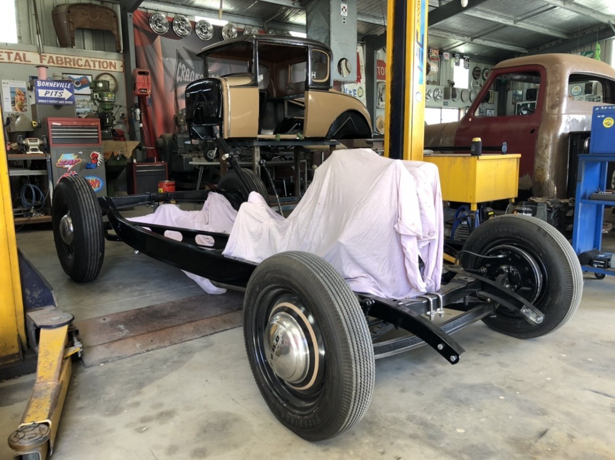

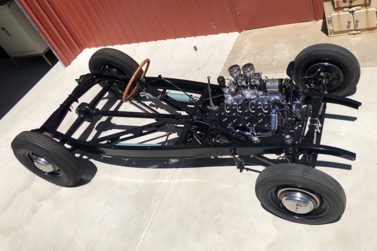

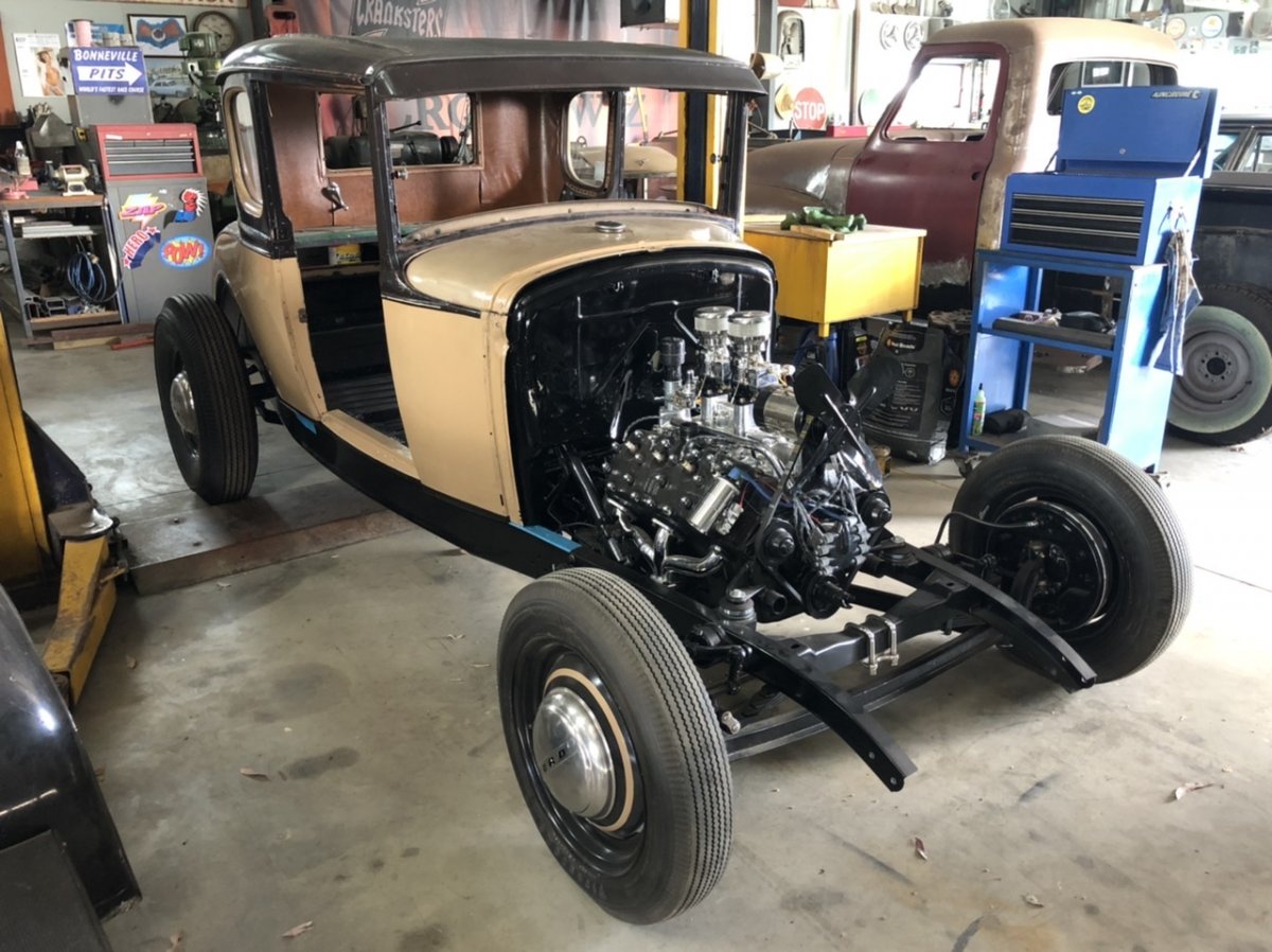

    I didn’t realise but it’s just over a year since I painted the frame. During the week I touched up some paint and on the weekend I gave it a wash. I took the opportunity to get some photos before installing the body for hopefully the last time. After putting the body on I took a few more photos.
    61E17668-0789-4D2B-AF80-5EA42D48A2F6.jpeg 2987427E-C662-4F30-9F9F-364E84B727B3.jpeg A420EB7C-0530-483D-8EB0-63A7068358FF.jpeg 10680E2E-2493-4BD9-A48C-9D78D514145B.jpeg 34ADB5BB-BDFF-4630-BF02-9DA5271FF312.jpeg

    It sure is mate. I’m getting a radiator made now and i’m just trying to keep moving forward.
  30. Aaron D.
    Joined: Oct 27, 2015
    Posts: 1,038
    Aaron D.
    What a shame to cover up that great looking frame, but then again it sure looks great with the body on:cool:
