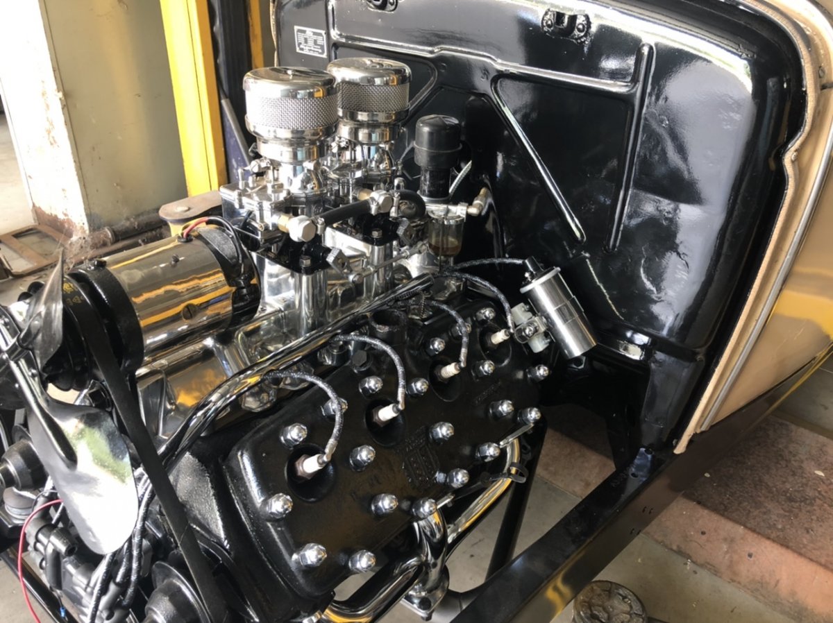

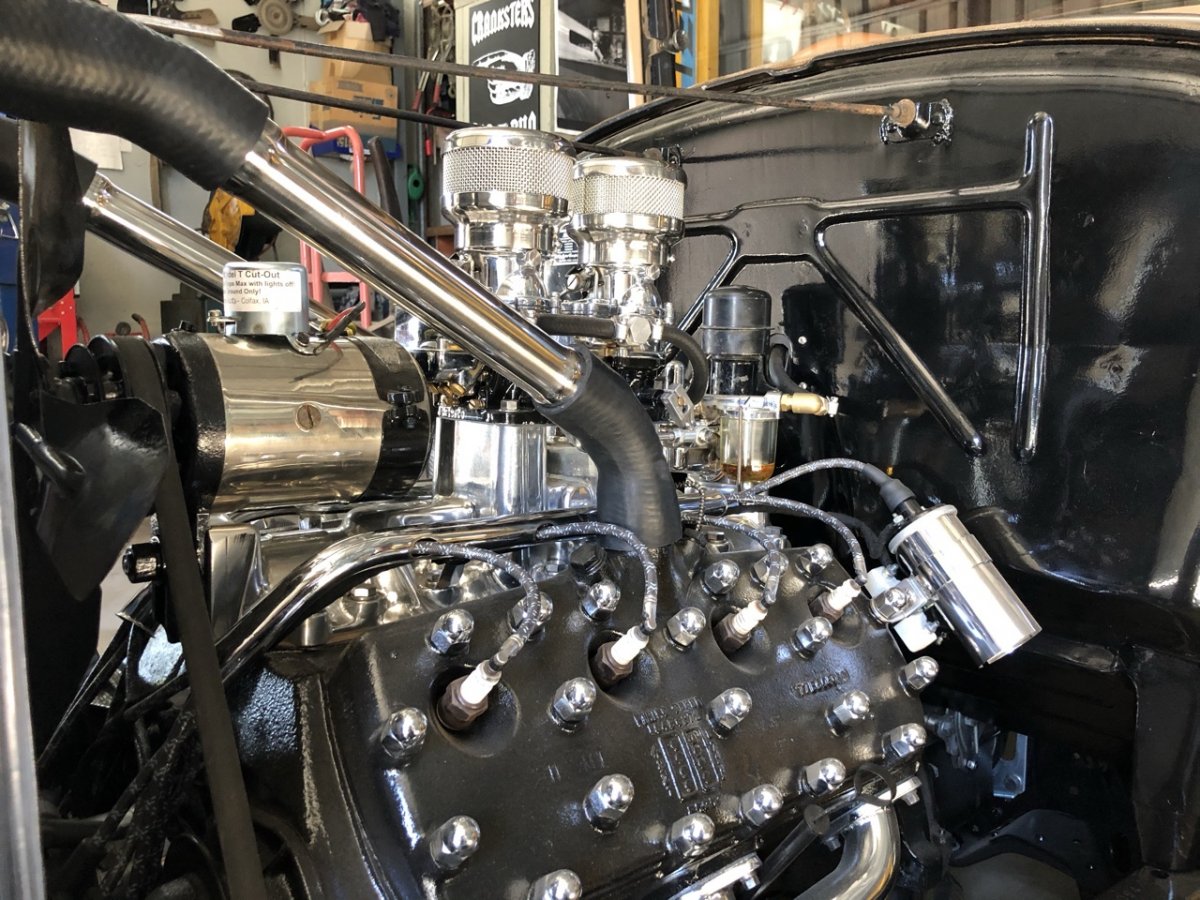

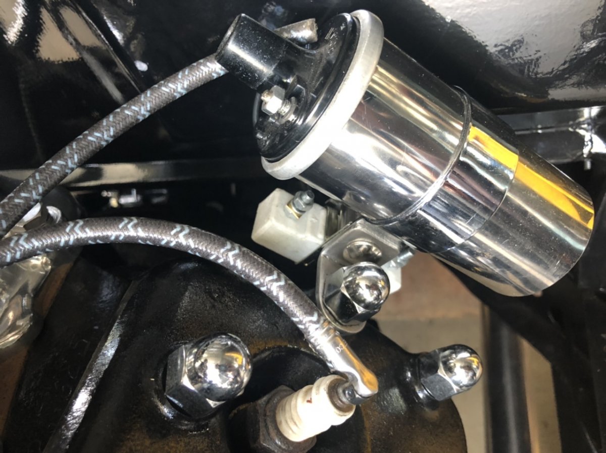

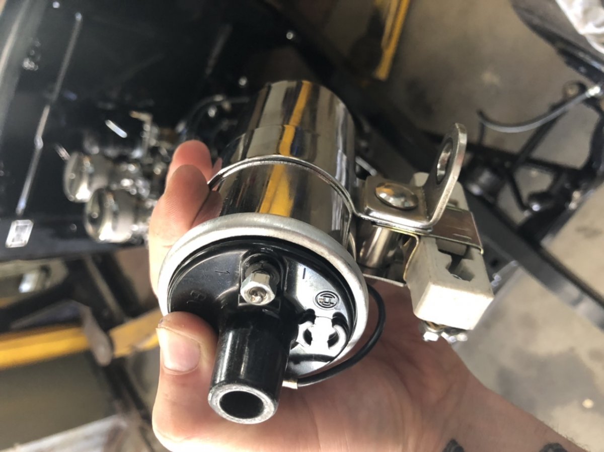

    Question, Wardog: How is your coil mount fixed to the engine block?
  7. Wardog
    Joined: Jan 12, 2010
    Posts: 2,463
    Wardog
    It’s a 90 degree angle bracket that picks up a head stud. I’m actually about to move it to the rear of the other head. I’ll get a photo for you.

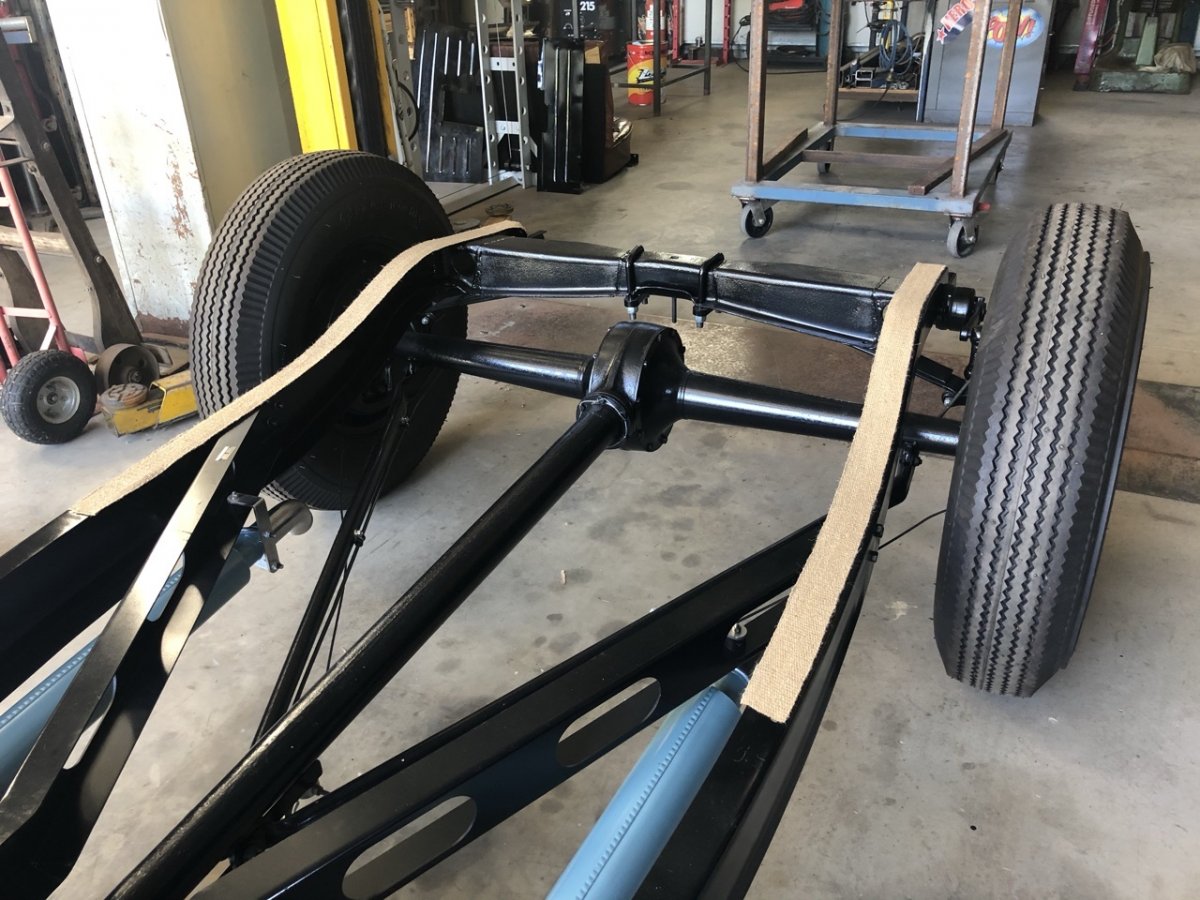

    Great looking hot rod, and you are doing an amazing job. You used the Steadfast sub rails I see. Do those rails sit right on the ch***is in the rear with perhaps some welting between? Or are they spaced up to allow a wood block between the rails and frame?
  9. Wardog
    Posts: 2,463
    Wardog
    Thanks. The sub rails sit directly on the frame rails. For welting I stole some hessian my wife uses to tie young trees to their stakes. I put some double sided tape between the rails and the hessian to keep in place during ***embly. 5E0787DC-1745-4EA1-9878-EA4C65D6289D.jpeg 8F1FAAF1-4647-45E0-BF07-8D0C1FC76677.jpeg

    CB17D5D6-C210-4E42-888D-D8570ED52722.jpeg A08729A3-0989-4CA1-B9C5-F48210C16B15.jpeg DDA1F99A-CD41-42C2-B72E-7E7B09788350.jpeg @rpu28 I moved my coil today and took some photos for you. The chrome coil bracket has a piece of stainless tube in it as a crush tube. Then it’s just a 1/8” stainless 90 degree bracket to the head stud.

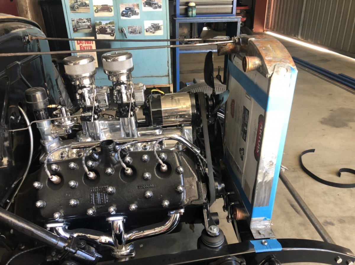

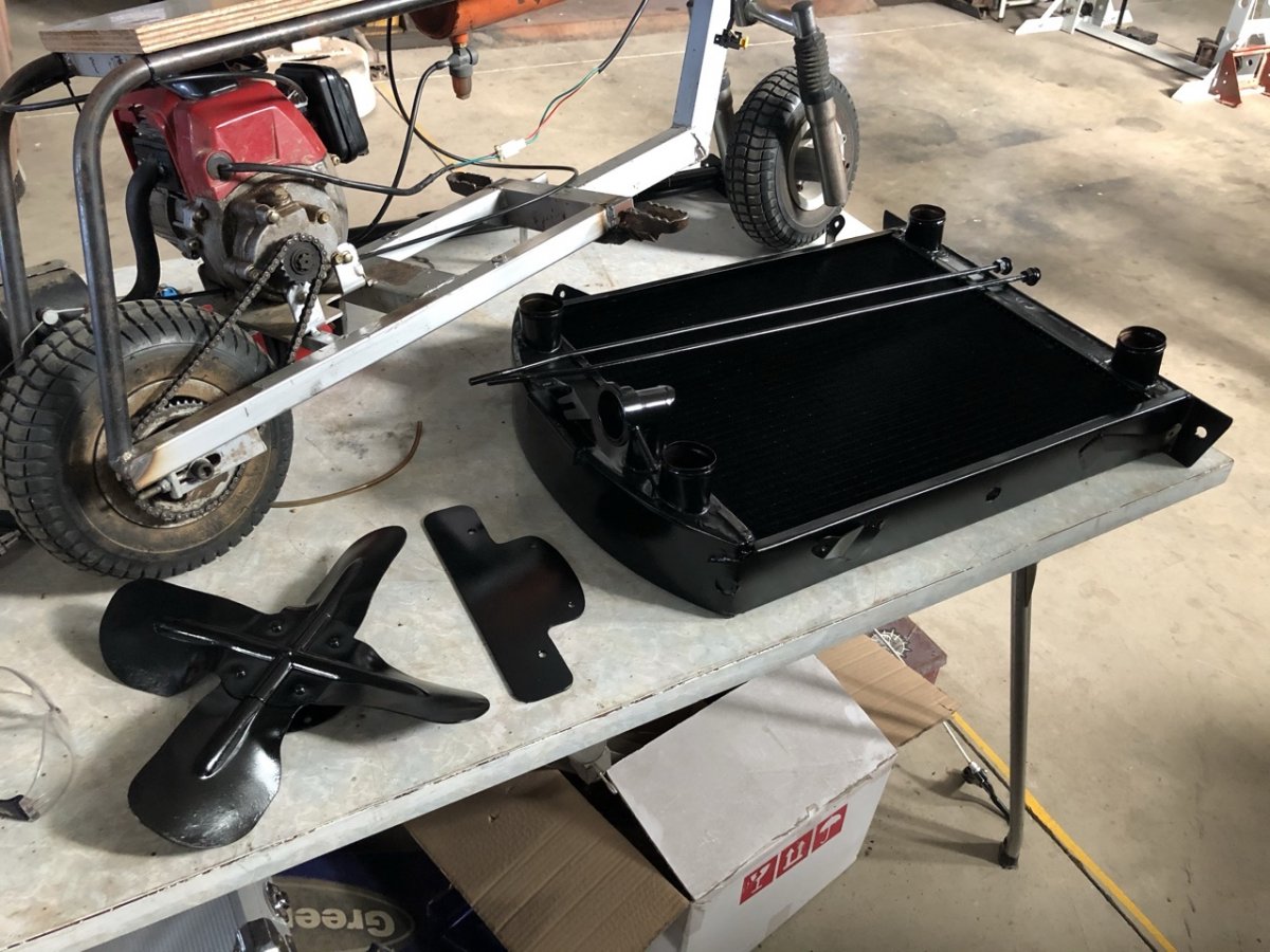

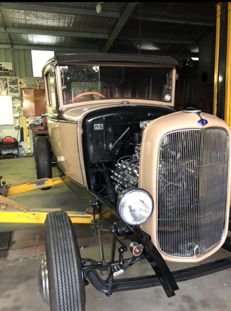

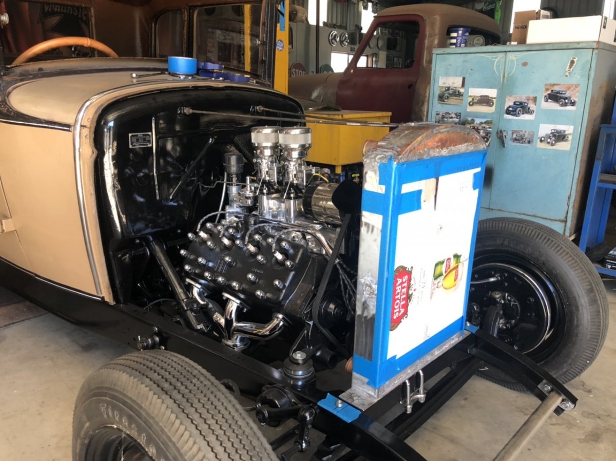

    In the week leading up to Christmas a few parts arrived. One thing I wanted was my radiator. My mate Norm was really busy but squeezed me in and finished this up on December 23rd for me. My son and I picked it up on Christmas Eve. I extended the original radiator braces from the firewall to meet the radiator. Now to mount the grille shell.
    03D04C10-FC16-47A1-B825-4DF166514613.jpeg C36A2980-E757-4DB5-8CFA-DCABB98D4A52.jpeg 145B9EDB-B289-4882-87DD-D39D09589C67.jpeg

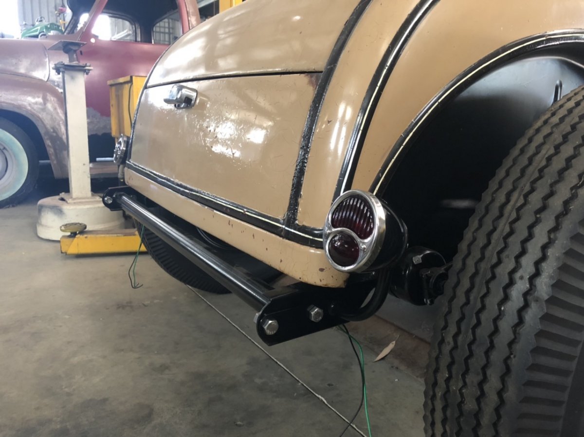

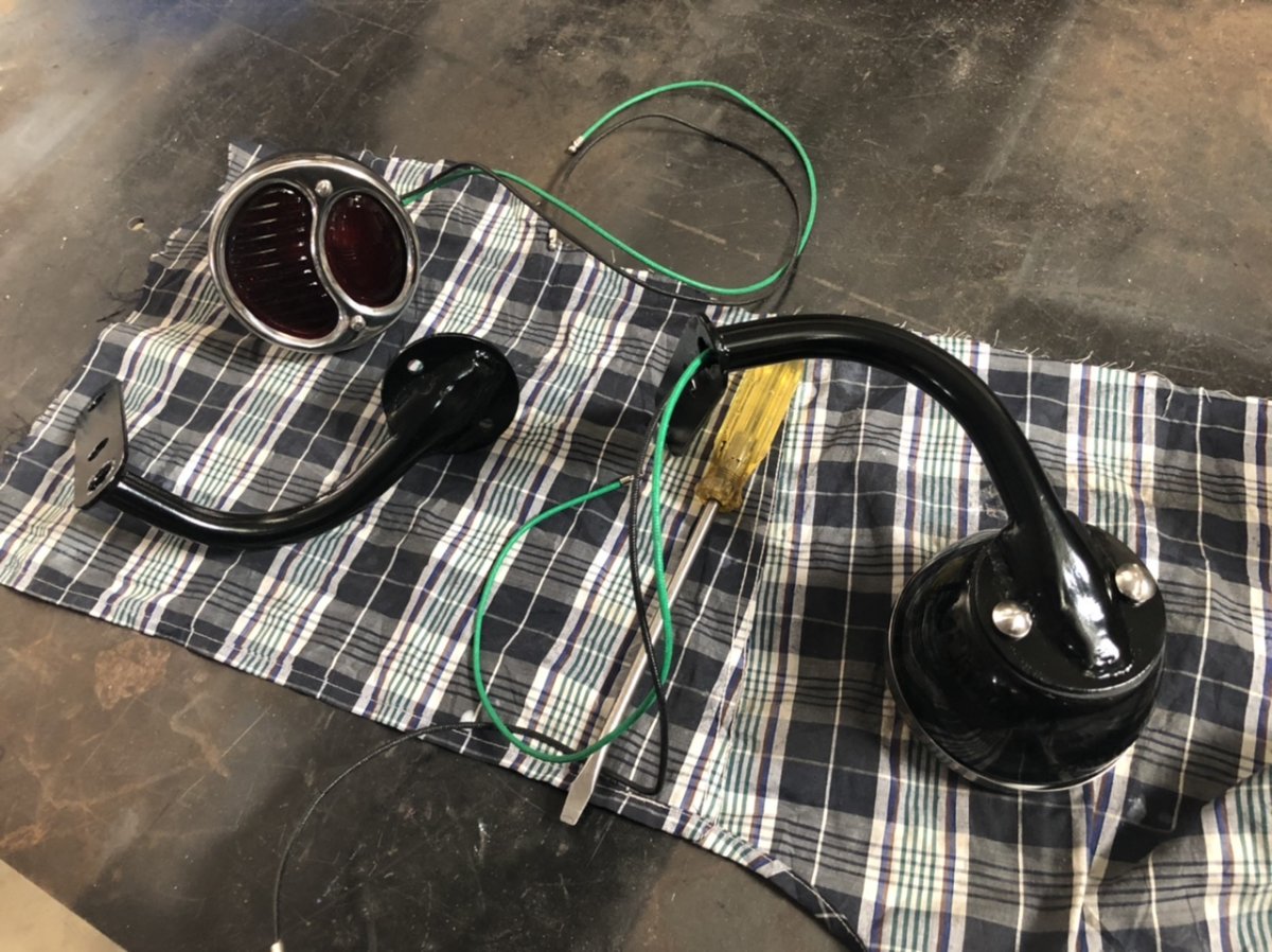

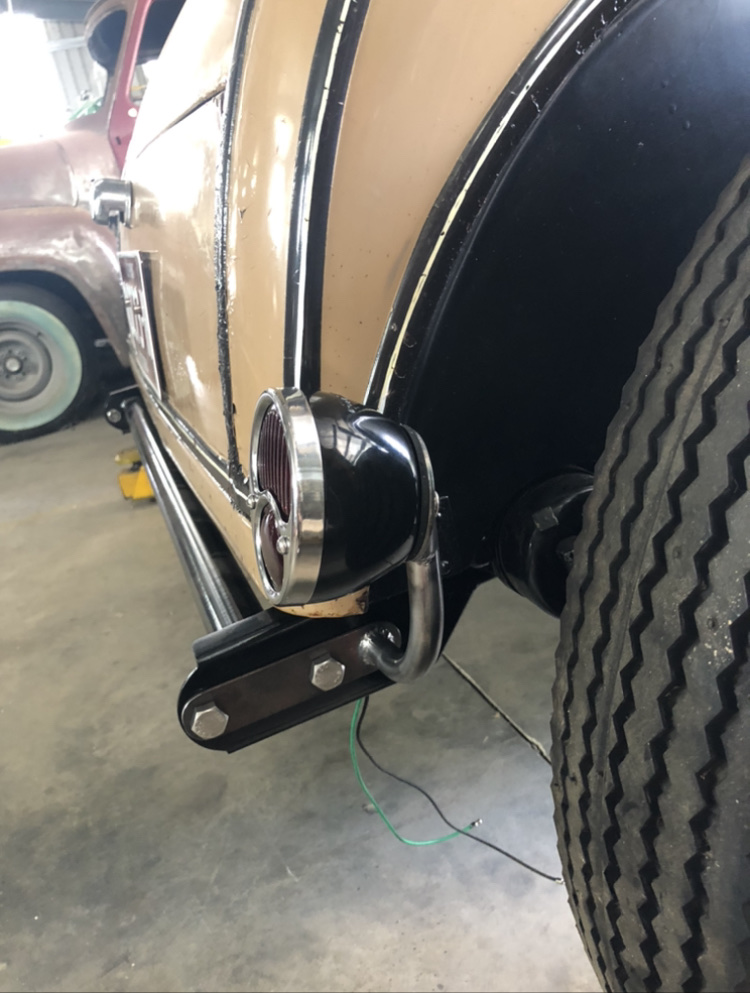

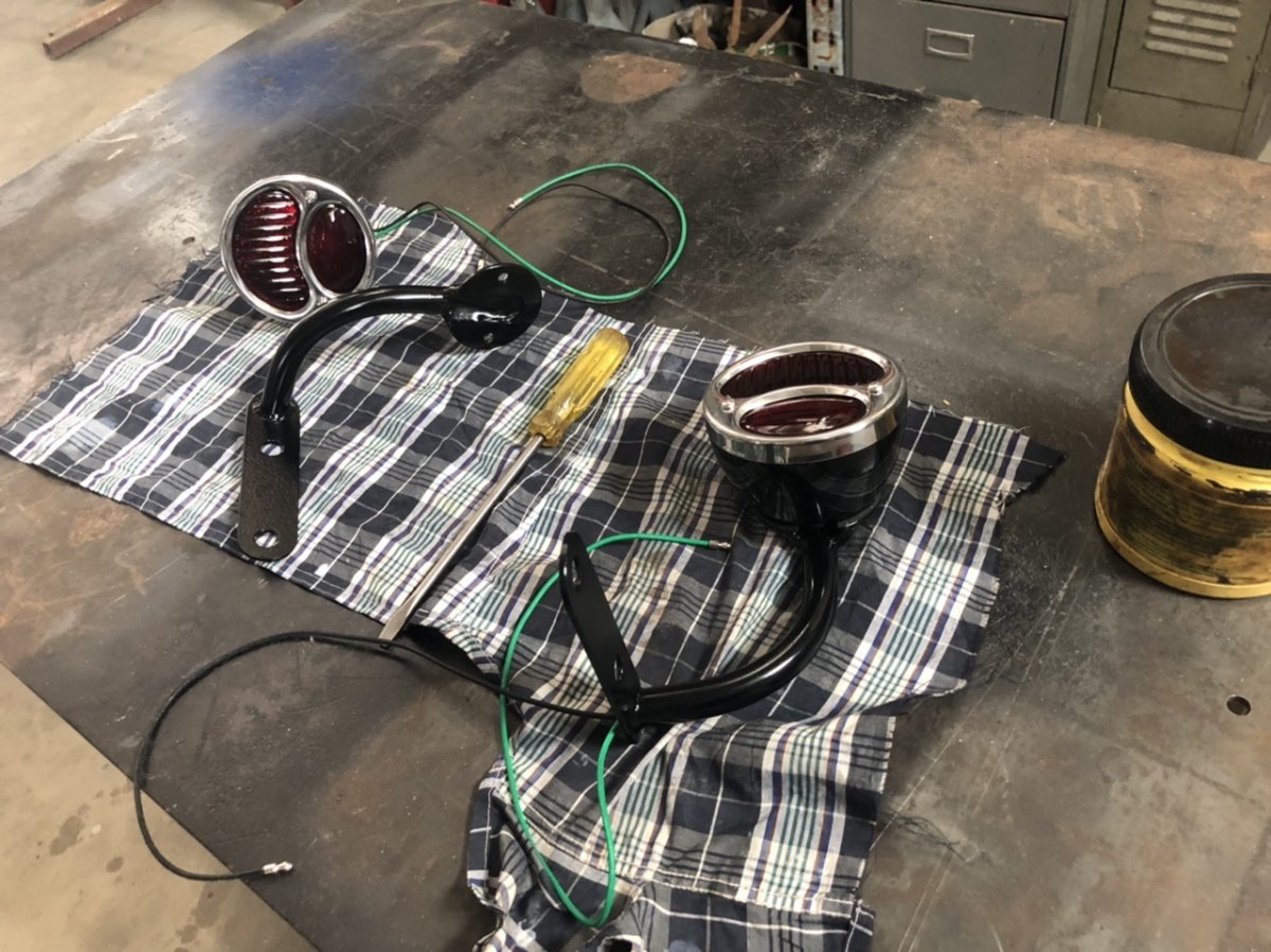

    Last weekend I made my own version of 32 taillight brackets. These tuck the lights up nice and close to the body. Today I ***embled and mounted them.
    2487C414-372D-4900-B754-34090599521B.jpeg 2047604B-5DB0-4C0F-9531-9BEFBA71C922.jpeg 040CA7E5-C8DE-474A-88EE-84D7AFA797C9.jpeg 53C68020-80DB-4848-B66C-253FDE02ACD9.jpeg 2917122B-B363-4E52-8D14-7F2DC9657B5A.jpeg FE411DA6-E0B5-4090-A4B9-17F2292FB1D8.jpeg

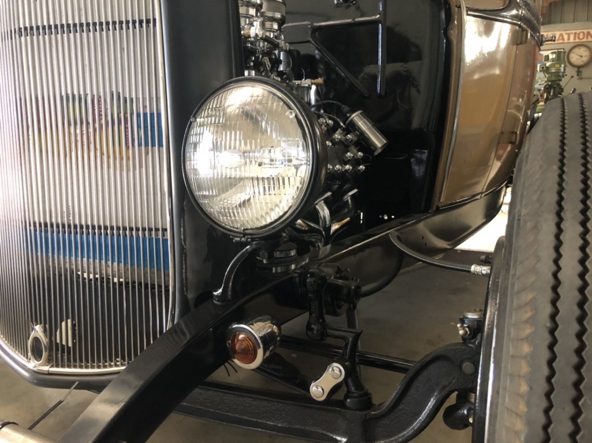

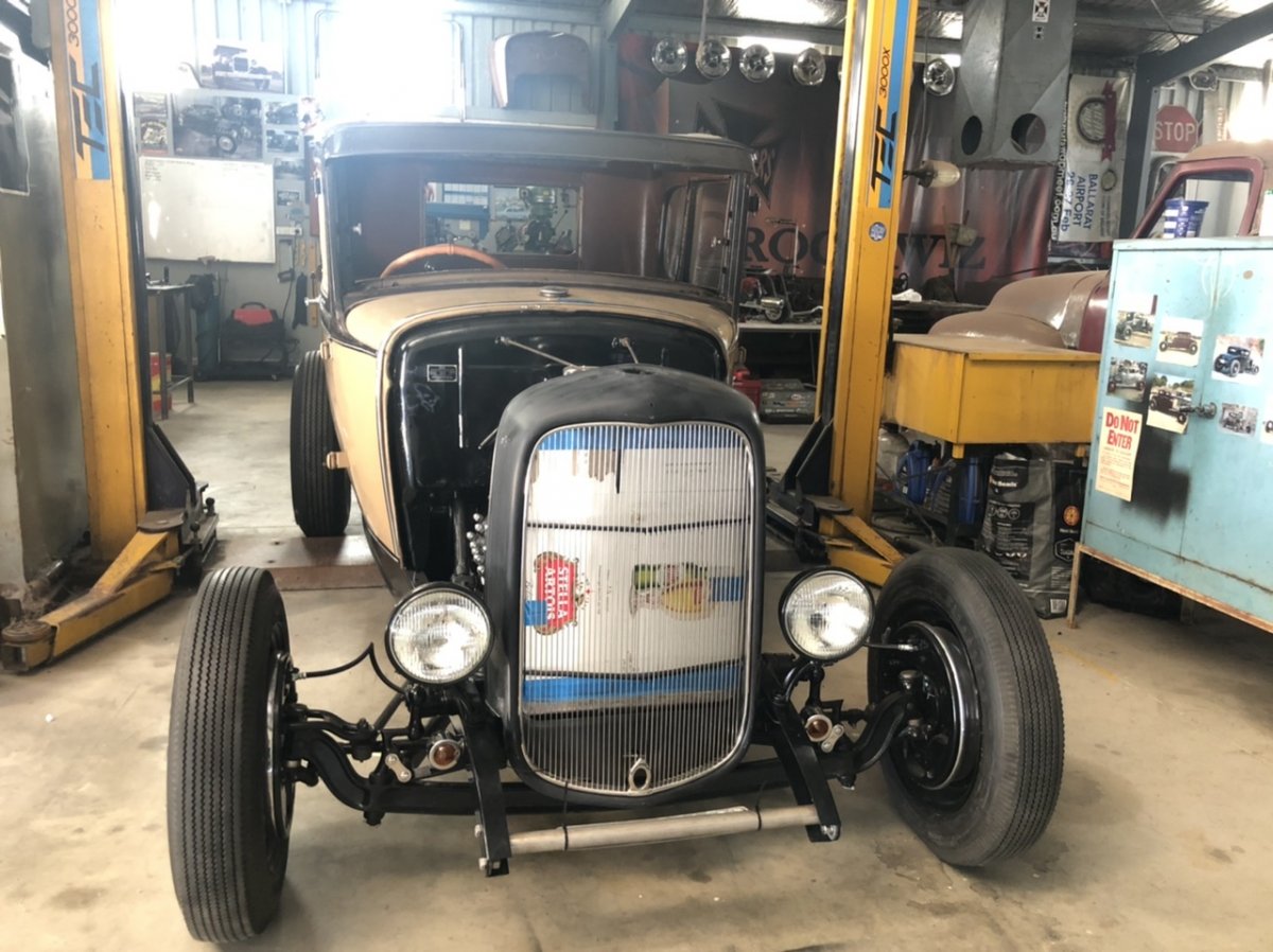

    The head lights and front indicators are mounted. Again I tried to tuck everything in nice and close.
    When I bought the head lights they came with these cast iron mounts. I’m pretty sure they are the top half of some bumper mounts for fog lights. Anyway they were perfect.
    2F00345B-2CD1-4438-8DD4-DDDE11107504.jpeg C3E94C4E-2A23-41E5-BB33-8E03CAA3682F.jpeg
    This is one of my favourite views of the car. It’s the first time it’s looked so right with all the lights mounted up.

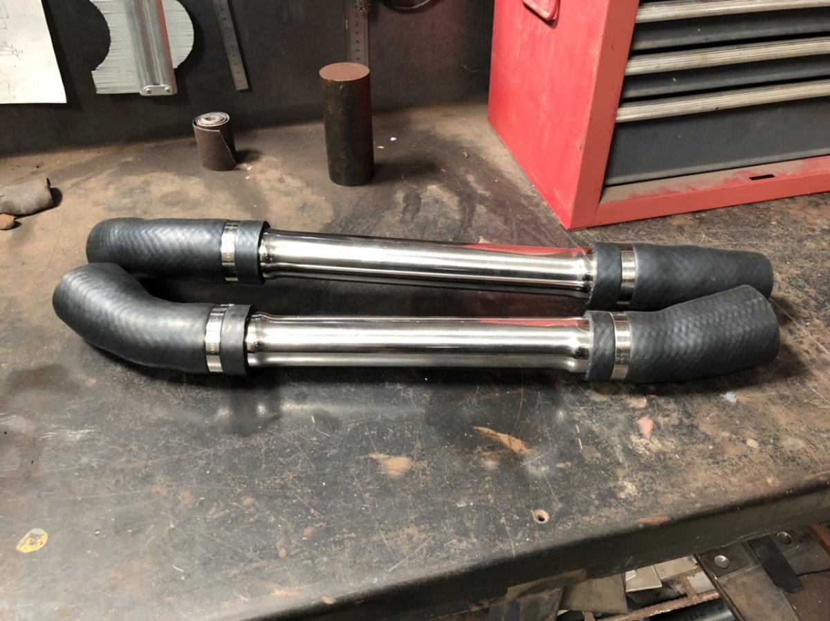

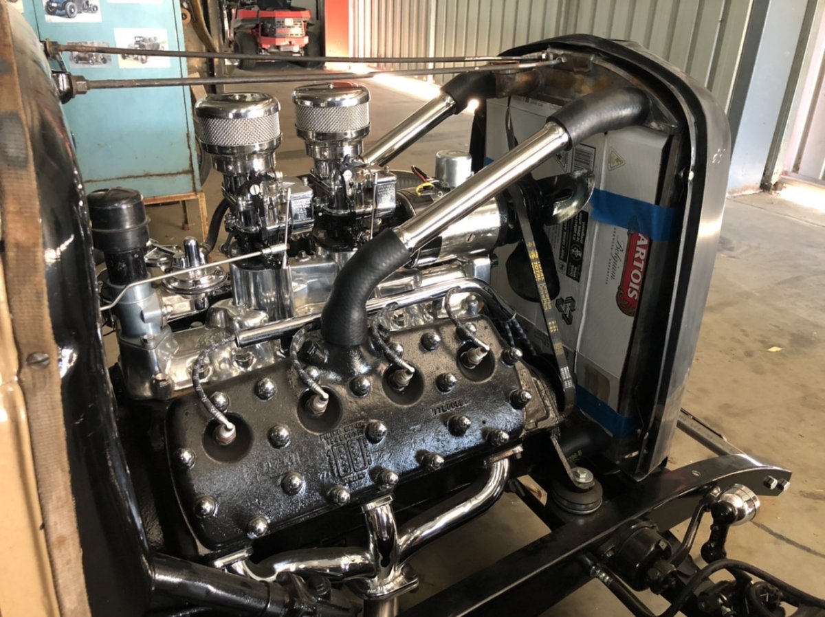

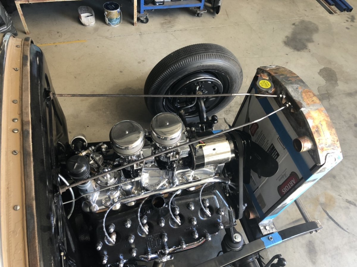

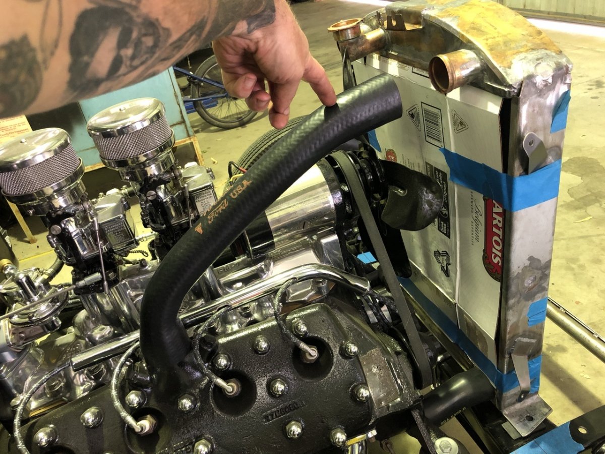

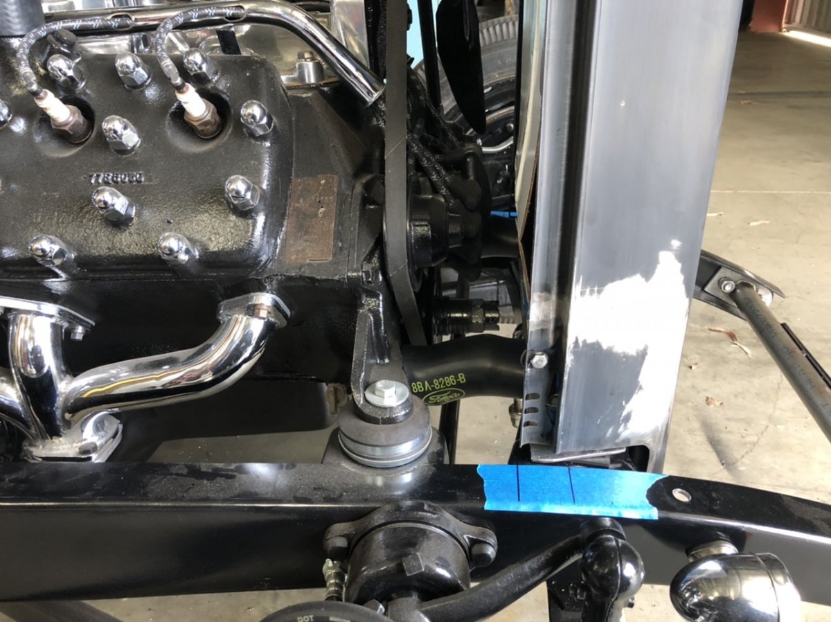

    I had some parts turn up in the mail. First thing to do was sort out the radiators hoses. I bought some 8BA lower hoses and some 39 top hoses hoping they would work.
    I pushed the radiator back about 1 1/4” and shortened the lower hoses to suit. I cut the centre out of the top hoses and added some 1 1/2” stainless tube . This helped get the extra length needed. My son and I machined a die and flared the ends then polished them up.

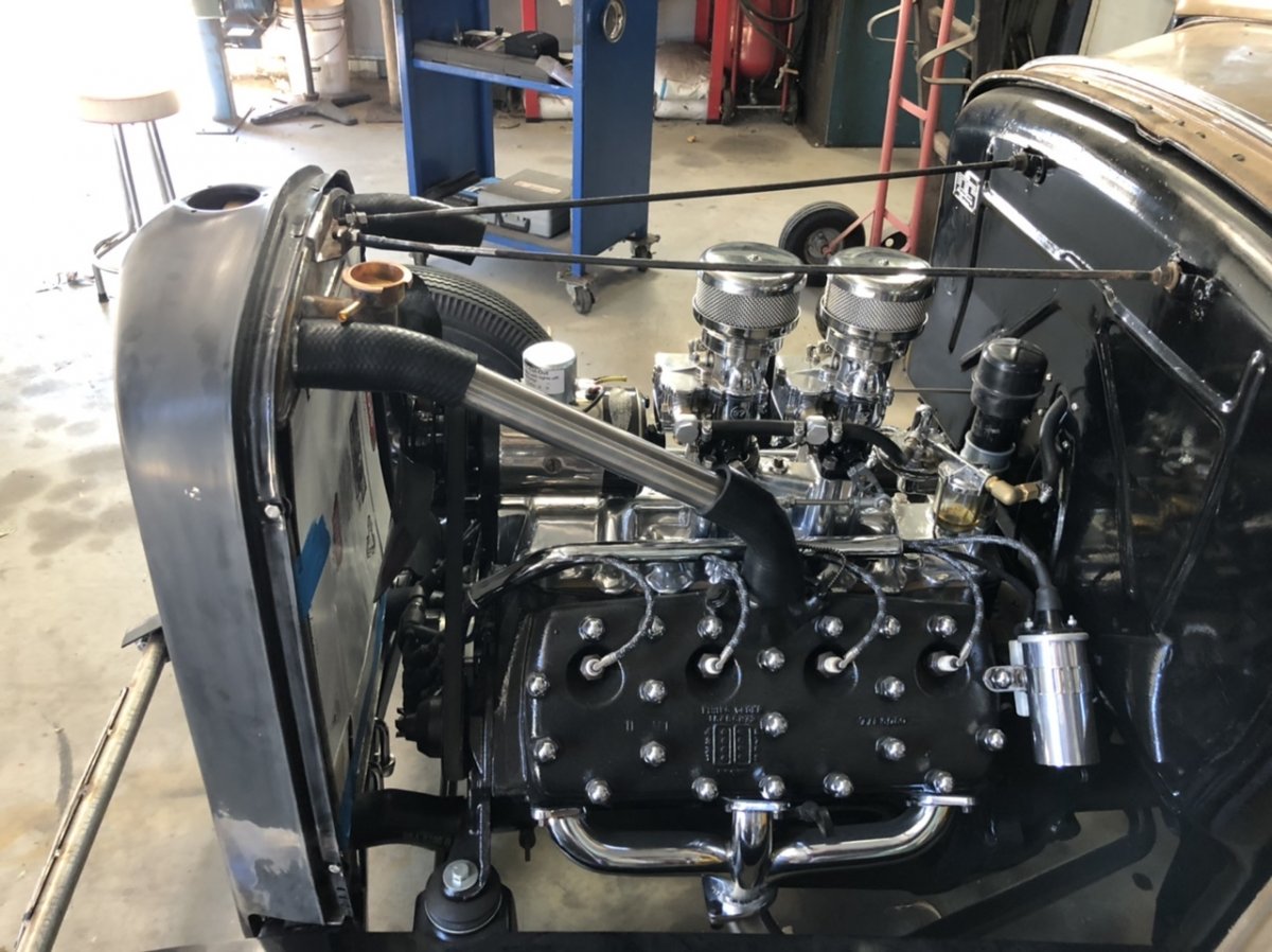

    With the radiator position sorted I made a couple of permanent clamps on the top radiator tubes. Then painted everything. The fan needed painting again as I shortened the blades a bit for clearance.

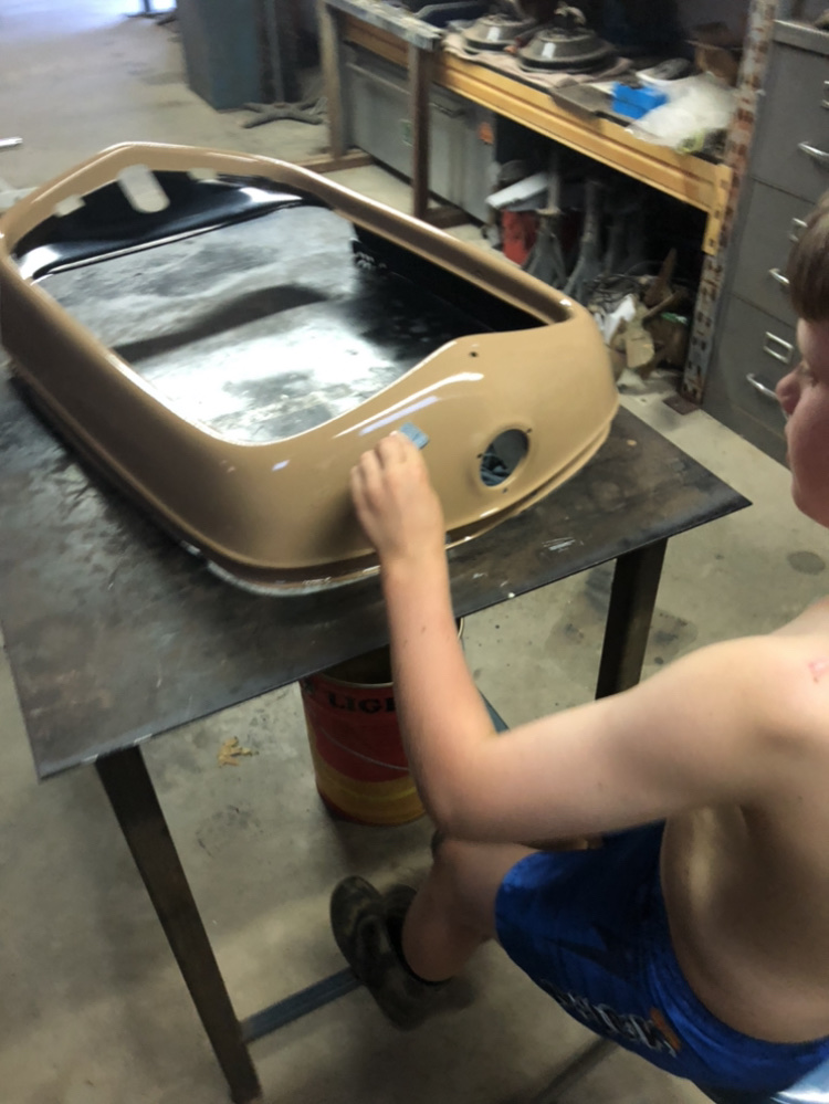

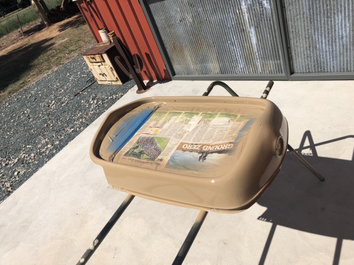

    I painted my grille shell in the body colour. Then that afternoon I gave my son some 40 grit paper and he “aged” it a bit for me.
    5F3570FB-8A12-41AE-96CF-209A4D1FFA0B.jpeg 475FE45A-D37C-468E-BE0B-AA24AC373B1A.jpeg 2FC3753A-CE65-4826-B153-5C27DF7AF3F1.jpeg

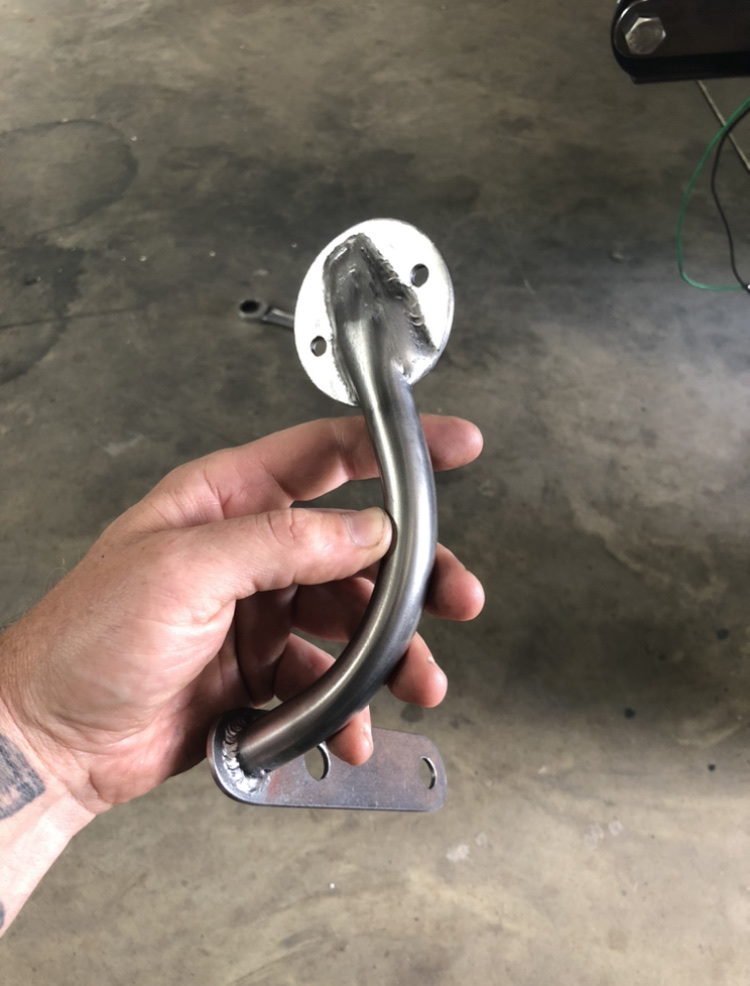

    Can you share how you made your hose clamps?
