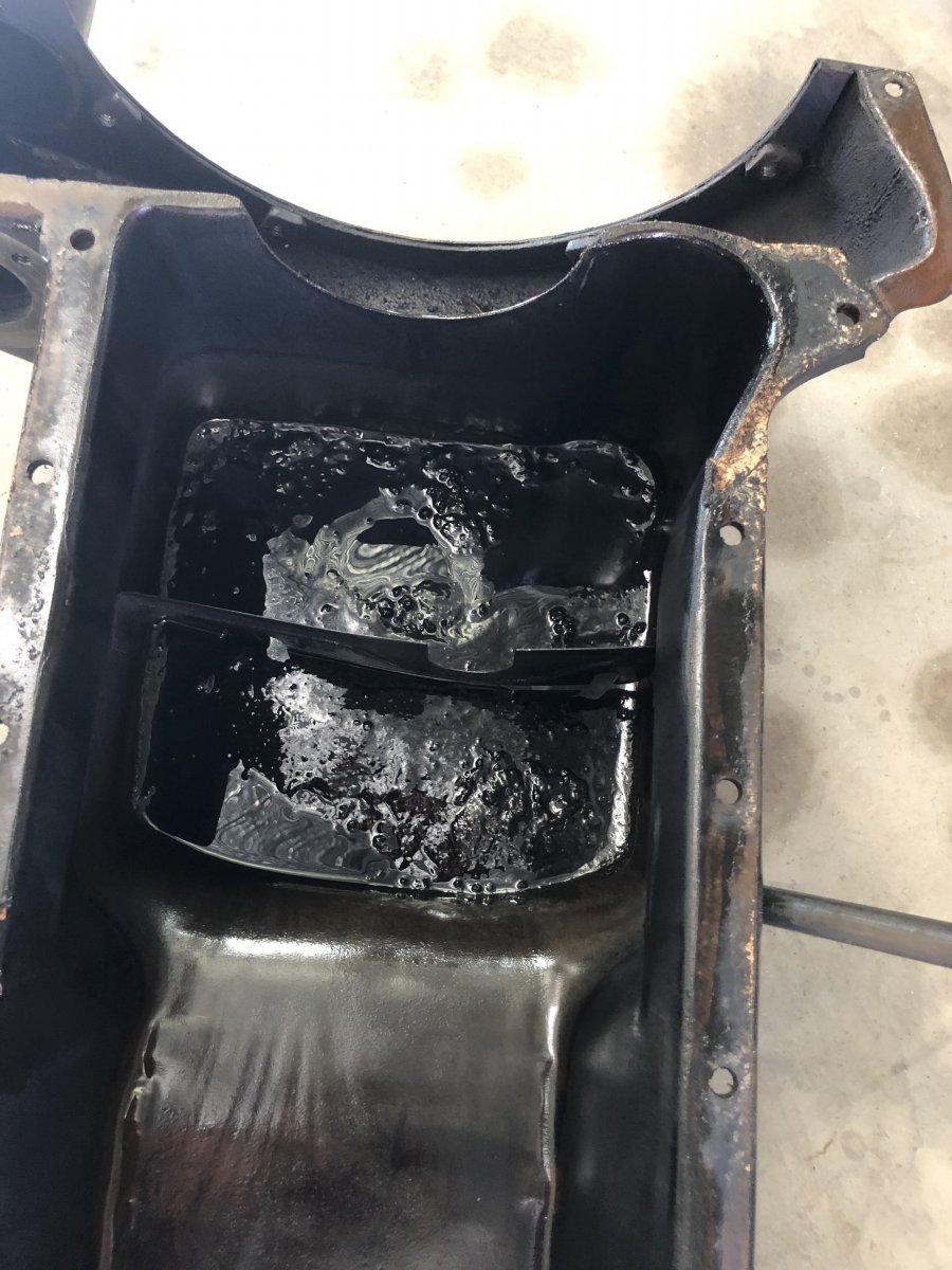

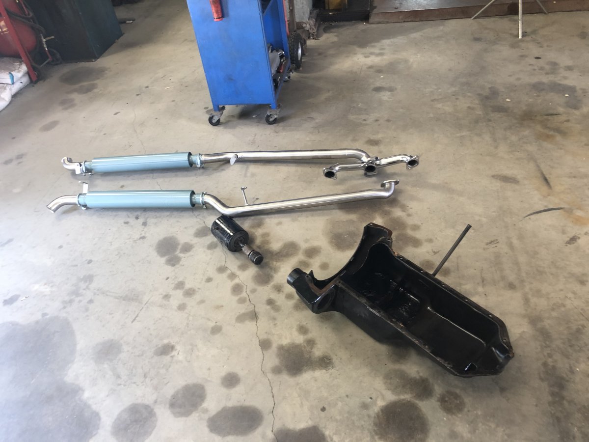

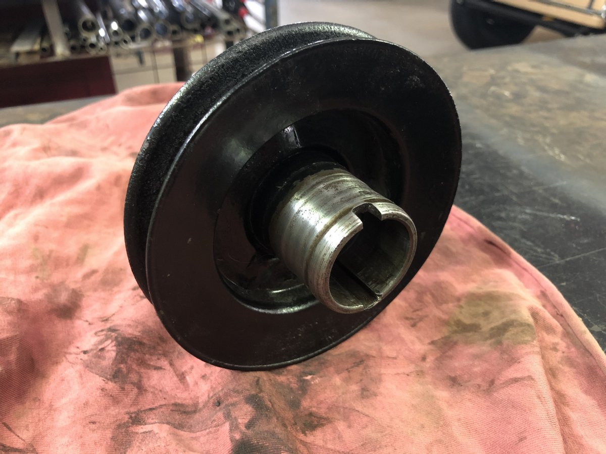

    Before I set my radiator and grille up for hopefully the last time I decided to put a front seal on the crank. I used a one piece rubber oil seal rather than a rope seal. It was a good time to clean the sump and have a look inside the engine.

    @Wardog is this the first time you have had the pan off this engine?...is that sludge due to the type of oil used as in non detergent?
    I use 10w30 but I also am running a 60s smallblock...I suspect Flattys are different...

    @Stogy Yes it’s the first time I’ve had the pan off. It could be the type of oil or long intervals between oil changes.
    I’ll be using a modern multi grade version of a 50 weight oil.

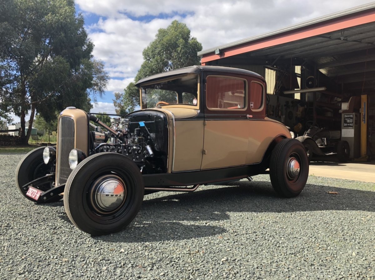

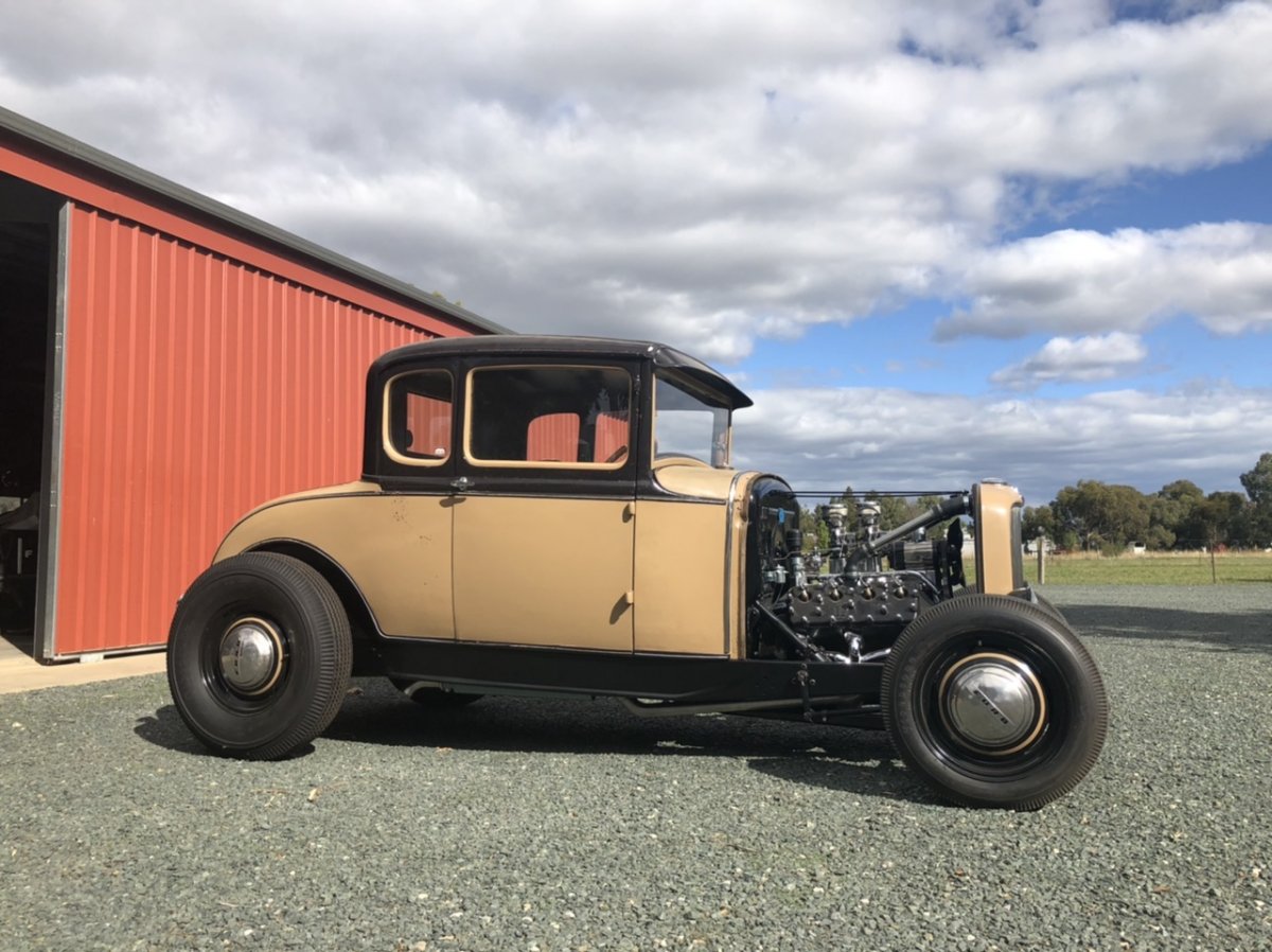

    BEB7D43F-5F65-452F-B6A3-19ADD790C430.jpeg 45BBEF18-B73B-4CE5-B4A0-6B984B5A6568.jpeg B29DA589-15B8-4BB6-AB7A-18DAE46BF70C.jpeg D8635DB7-AA22-440D-AE88-9BB22F0559C9.jpeg 9E597F83-43CC-4578-B23F-EE951302478C.jpeg 7B31454E-904C-45FF-96F7-6DEEDF7D47AF.jpeg

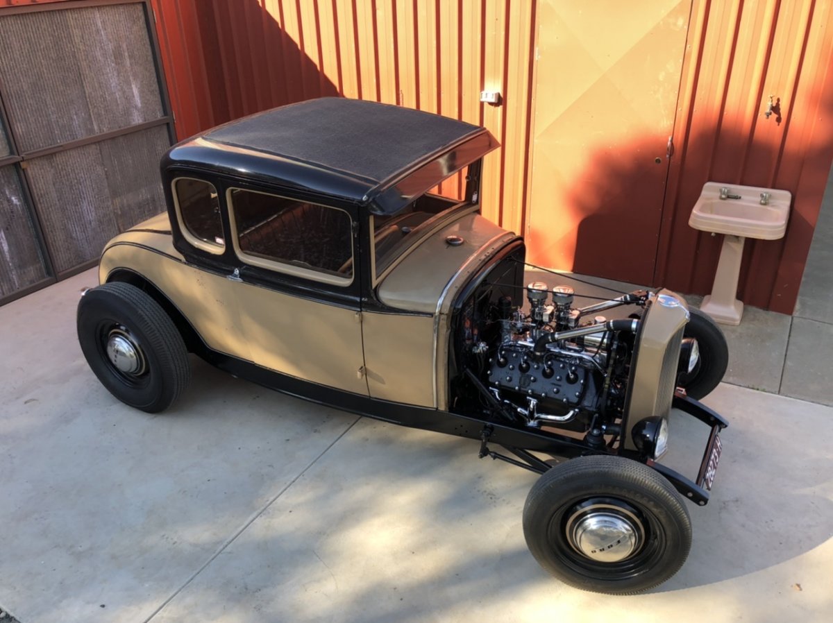

    Here are some recent photos. I’m still working on it. It’s getting close to being done now.

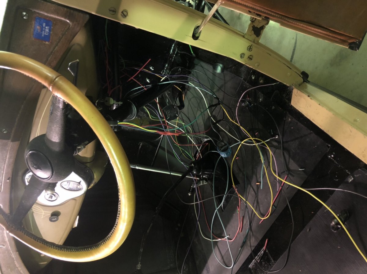

    We finished the wiring this weekend. I drove it for the first time. I’ve got a few things to finish of but man it feels great to get behind the wheel of this car.

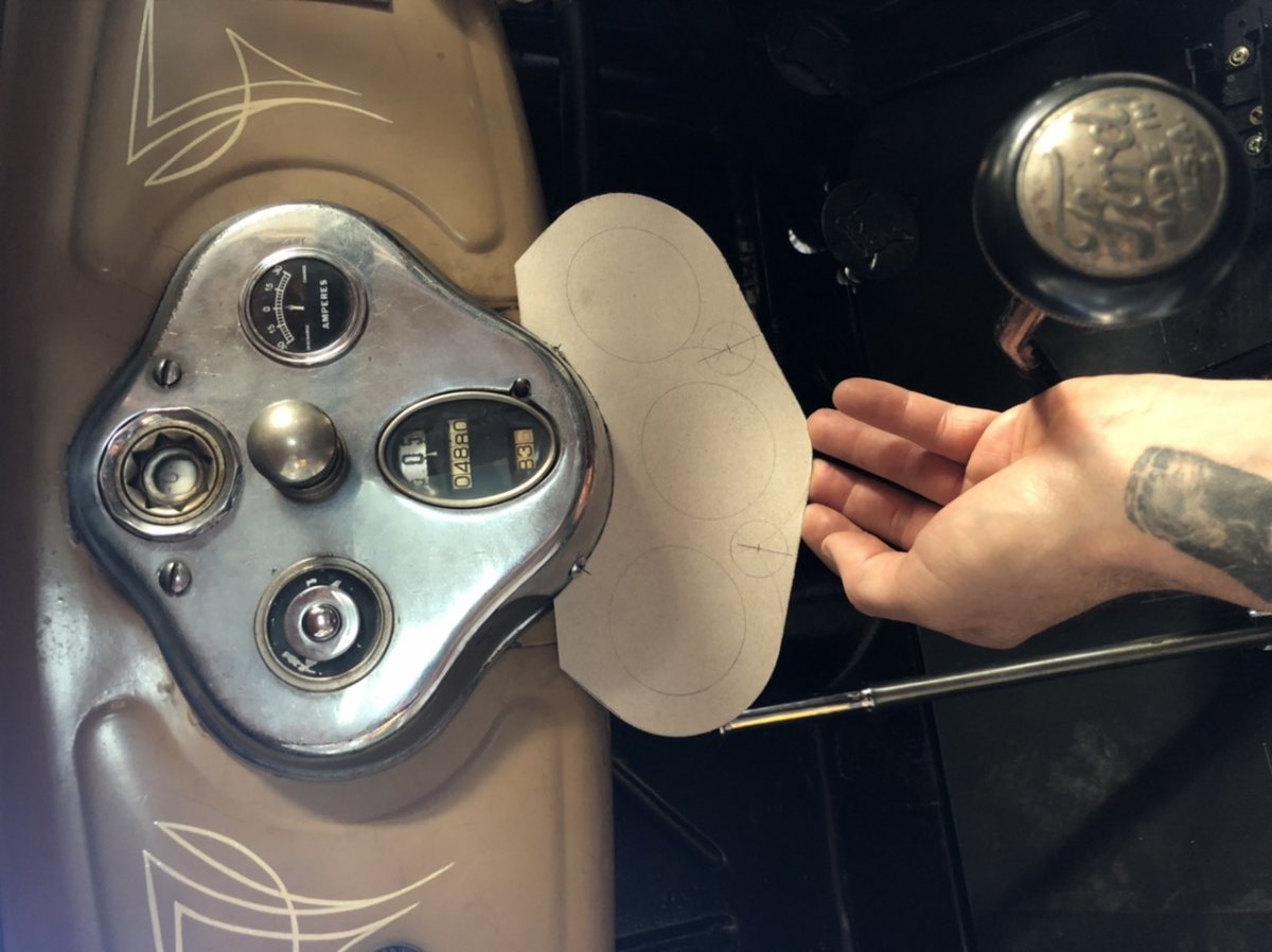

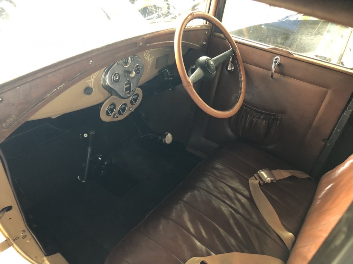

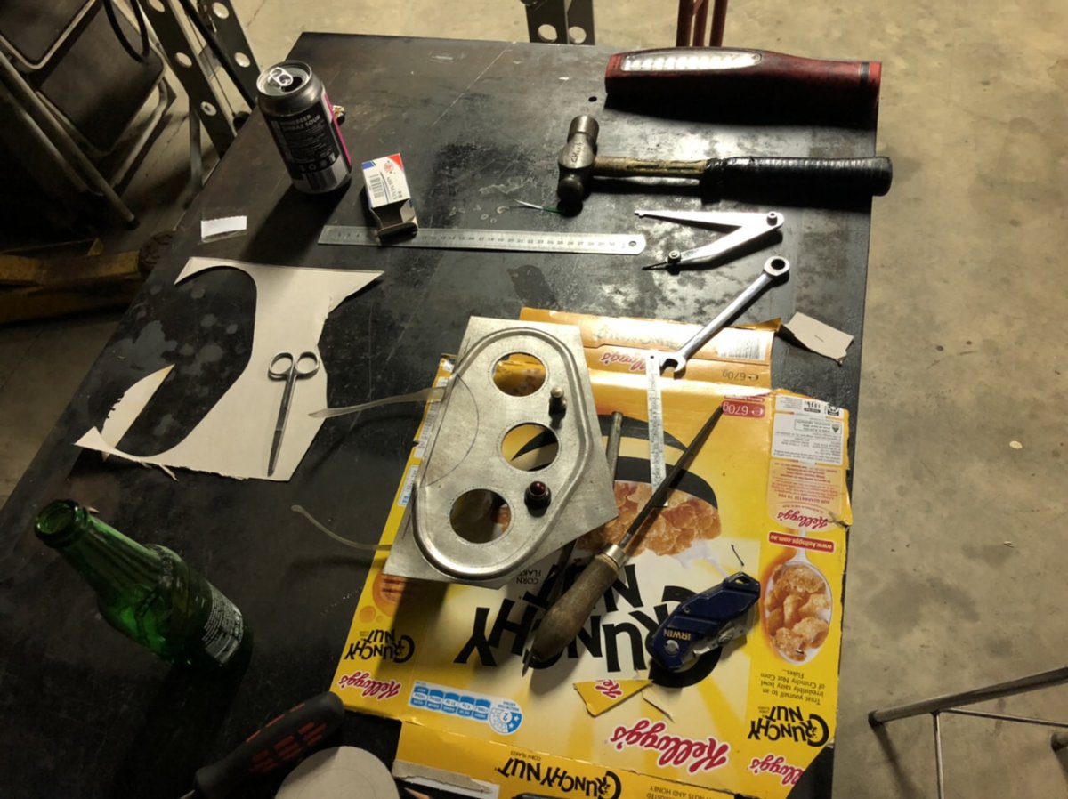

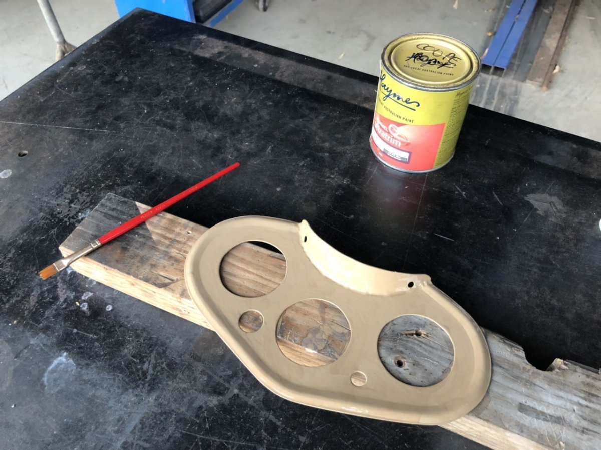

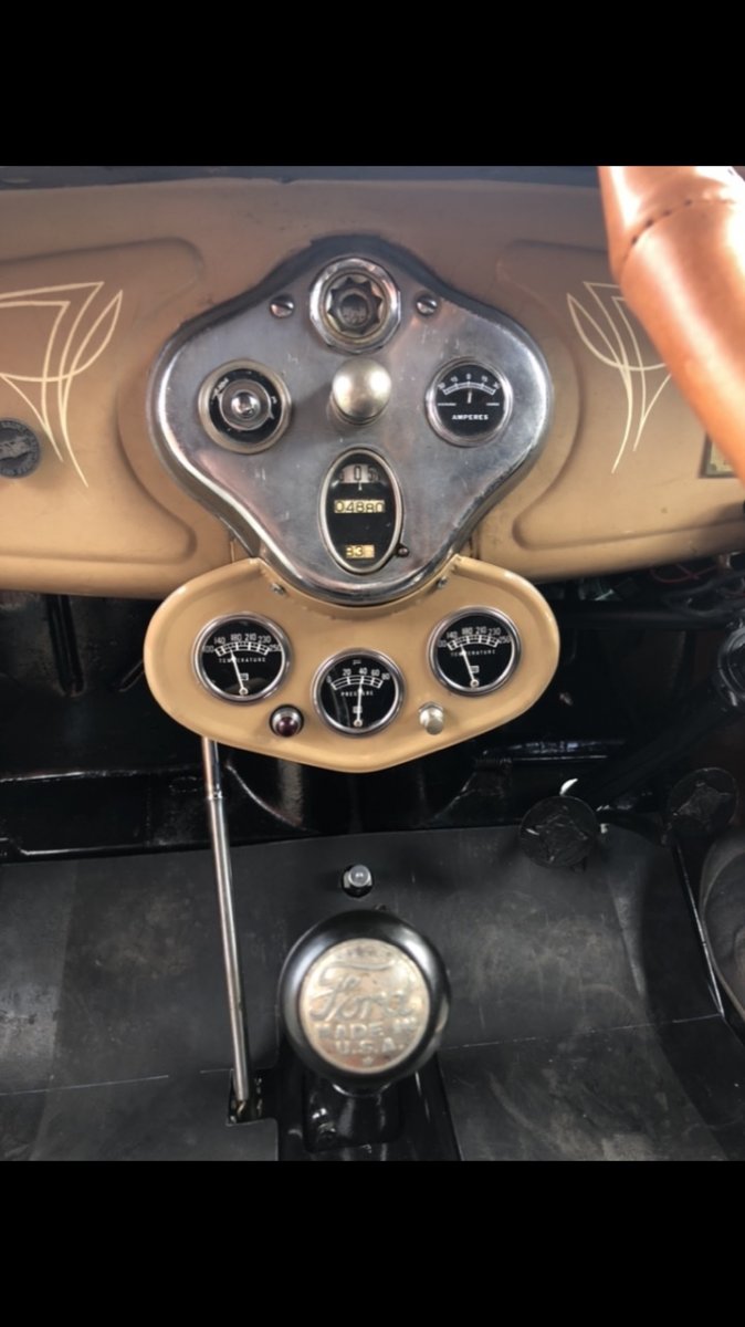

    I finished my accessory gauges today. Apart from refitting some B pillar trims the interior is done.

    Ole Screamer has a three gauge collar now...:D...Looks great Wardog, is that 2 temperature gauges, 1 per side? Sure would let you know how things are flowing...​

    Thanks. Yep, one temp per side. A friend of mine had one temp gauge in his flathead and boiled the side without. Because they have the two water pumps they can run as two separate systems.

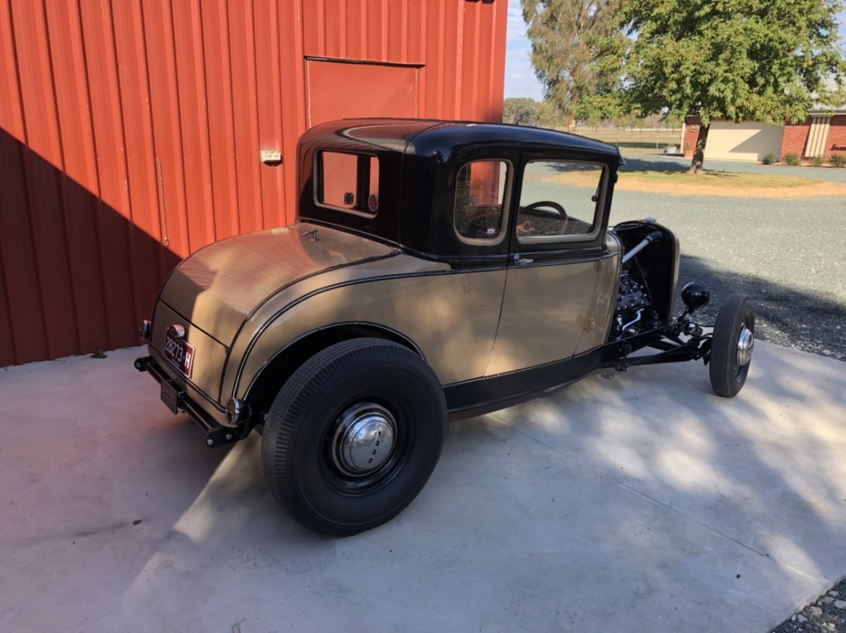

    My wife and I put a few miles on it this weekend.

    Nothing better than driving around fenderless with the wife next to you, I do it all the time. Great looking car.

    @55zephyr thanks. It was her first drive since the ch***is swap.

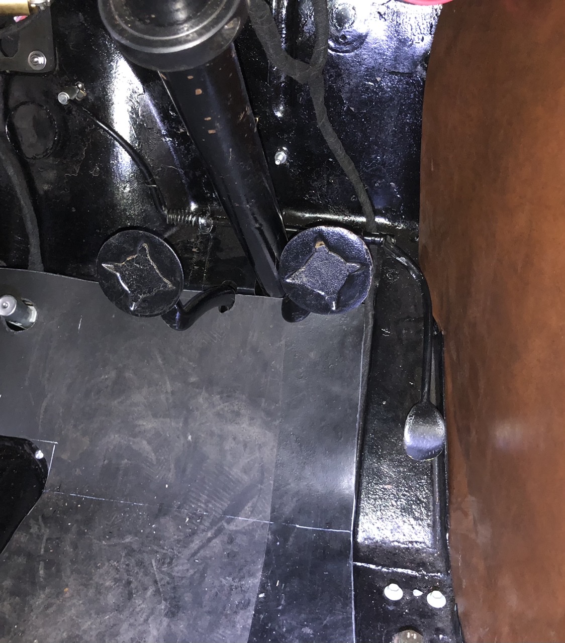

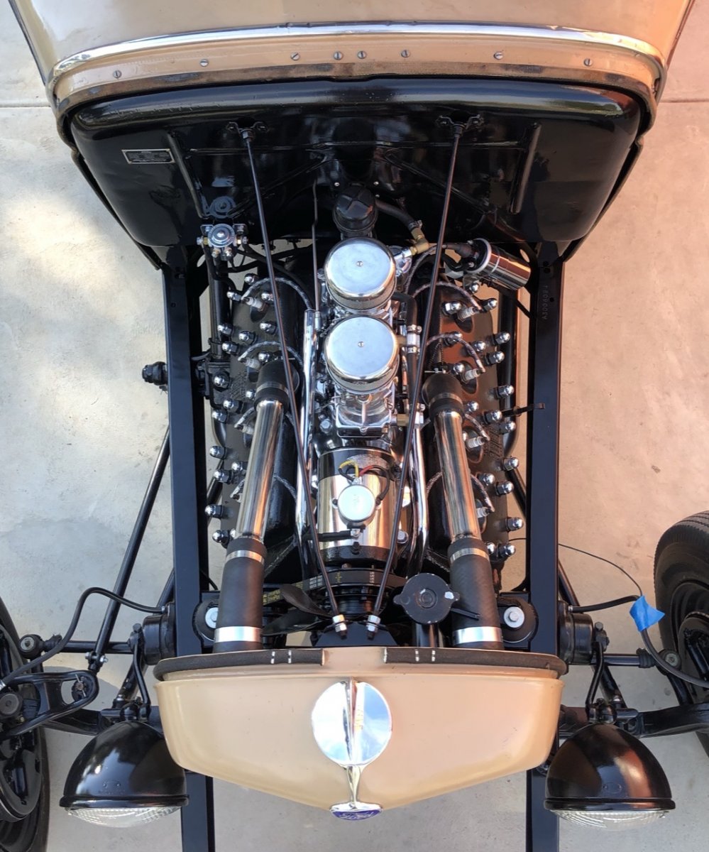

    Since hitting the road I’ve been refining it bit by bit. I’ve added leaves to the rear spring, synchronised the carbs and set the idle mixtures, pushed the top of the grille forward a bit, opened up the toe in and adjusted the headlights. The generator seems to be doing it’s thing but I haven’t been able to take it for a drive to check. One thing I was able to do was re shape the accelerator pedal for clearance when braking hard. B3398E8B-4232-4CCC-94E3-8973817ED755.jpeg E7077F05-14F4-4FD1-9CF2-273057A90F01.jpeg

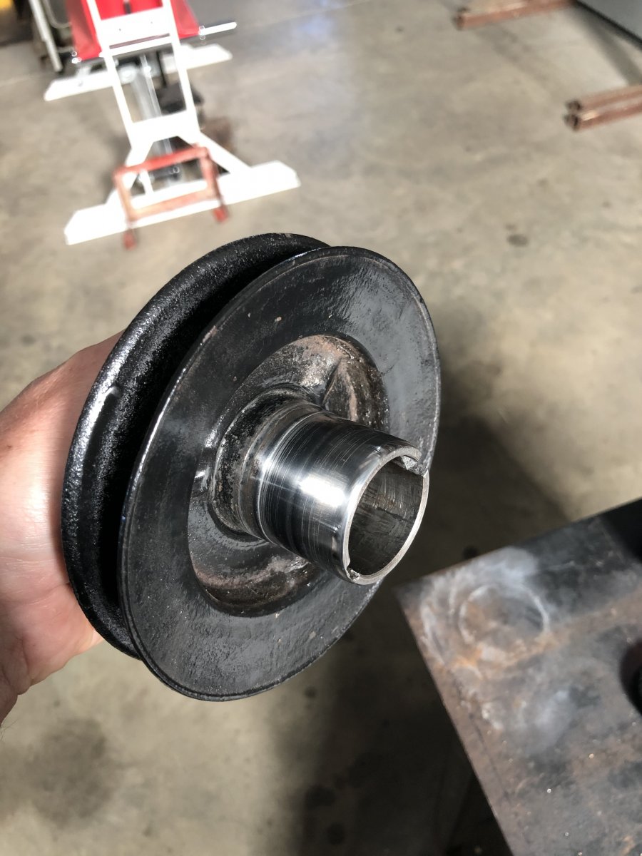

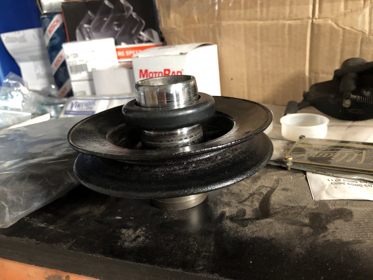

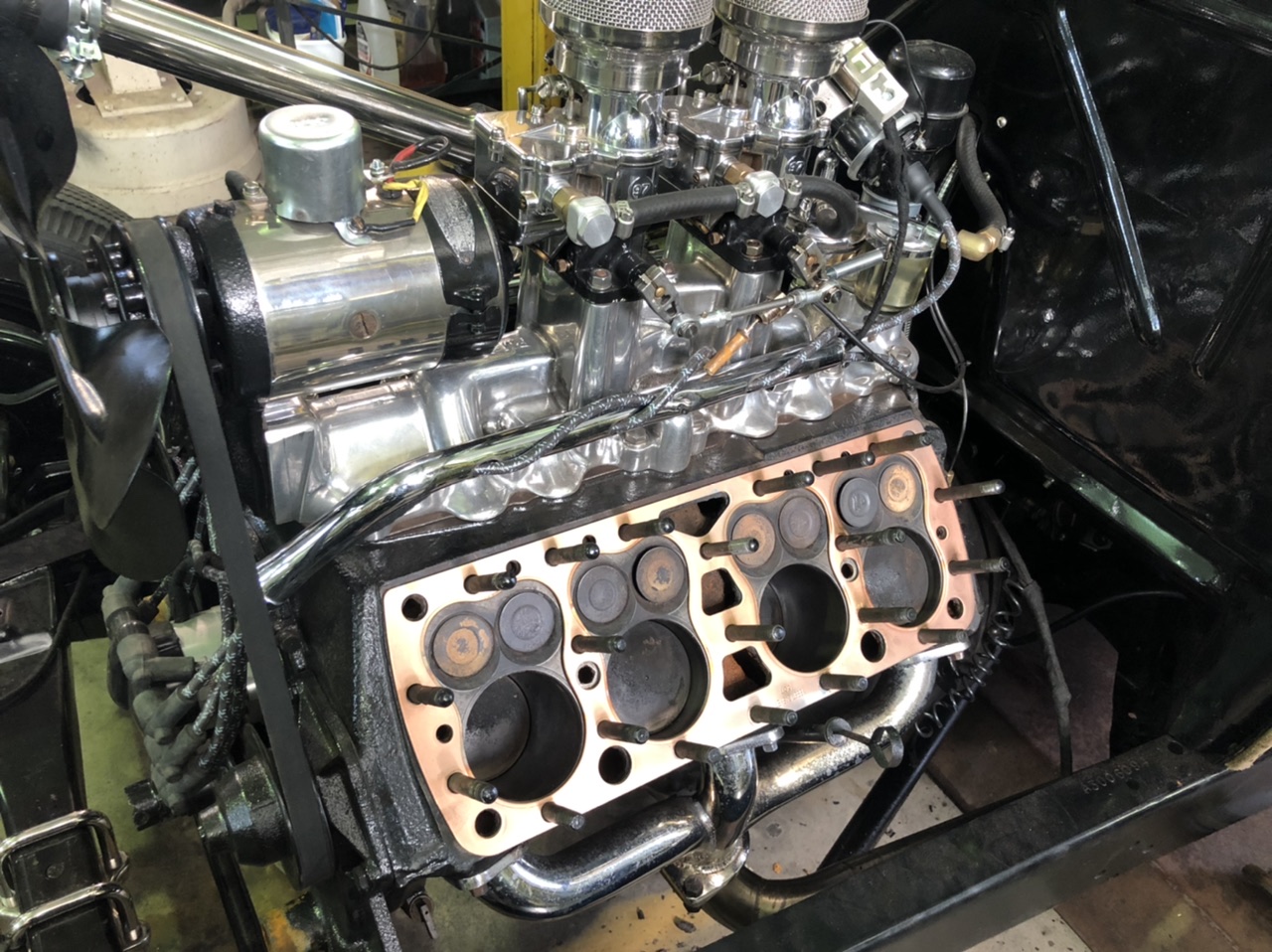

    I’ve been really busy lately. I’ve had time to change the head gaskets, more of a preventative measure than anything. I’ve also re done the front crank seal. I put in a one piece lip seal but didn’t use a sealant around the outer. It was leaking so I replaced it.
    I’ve driven it the last 4 days and it seems good.
