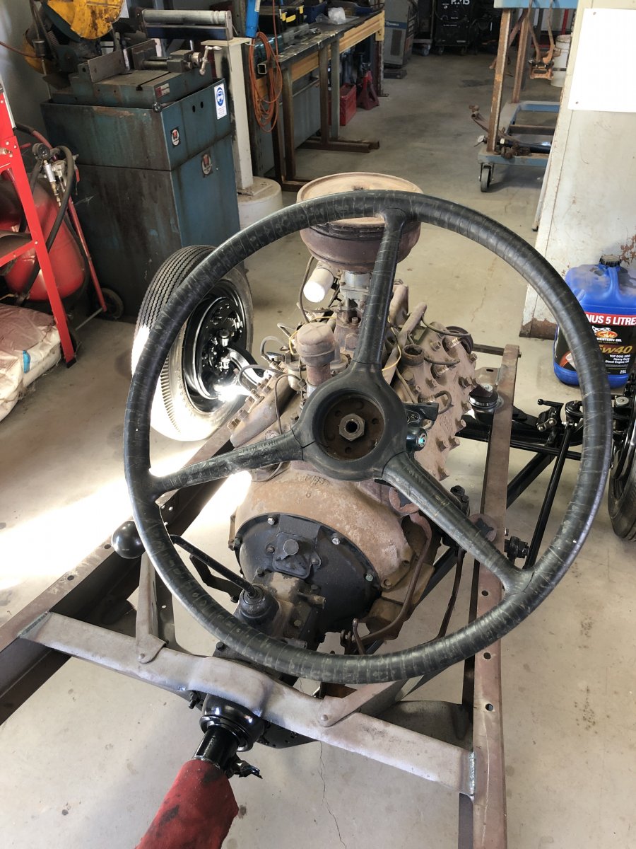

    I took the family to the Castlemaine swap meet on the weekend. I had already bought some rear brake drums and a clutch shaft lever to pick up there. I wanted to be able to move the frame around and not hit my head on the steering column. I saw this crusty wheel for free and grabbed it to use until I get my 40 wheel back from being leather bound.

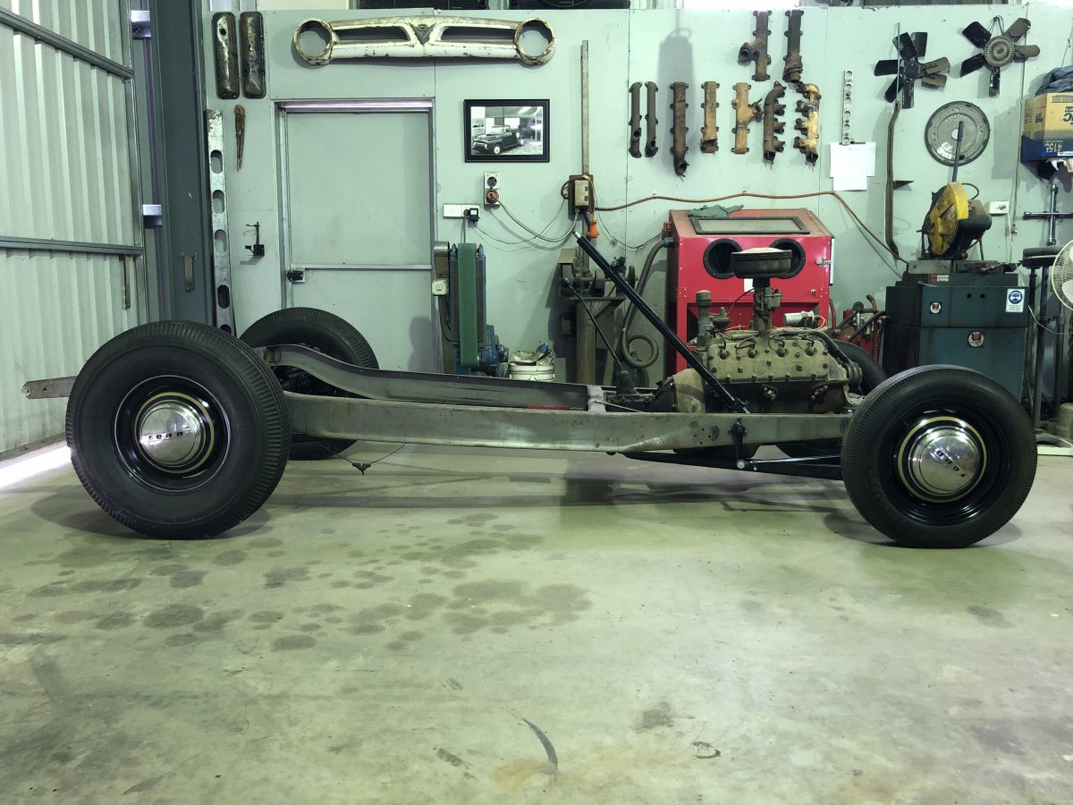

  10. Wardog
    Joined: Jan 12, 2010
    Posts: 2,463
    Wardog

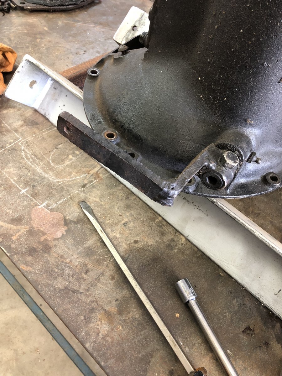

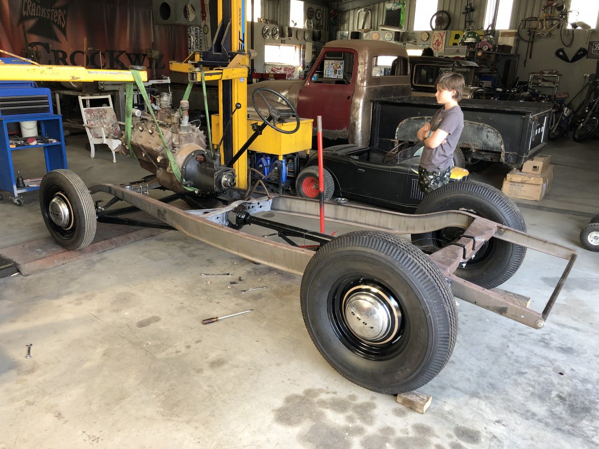

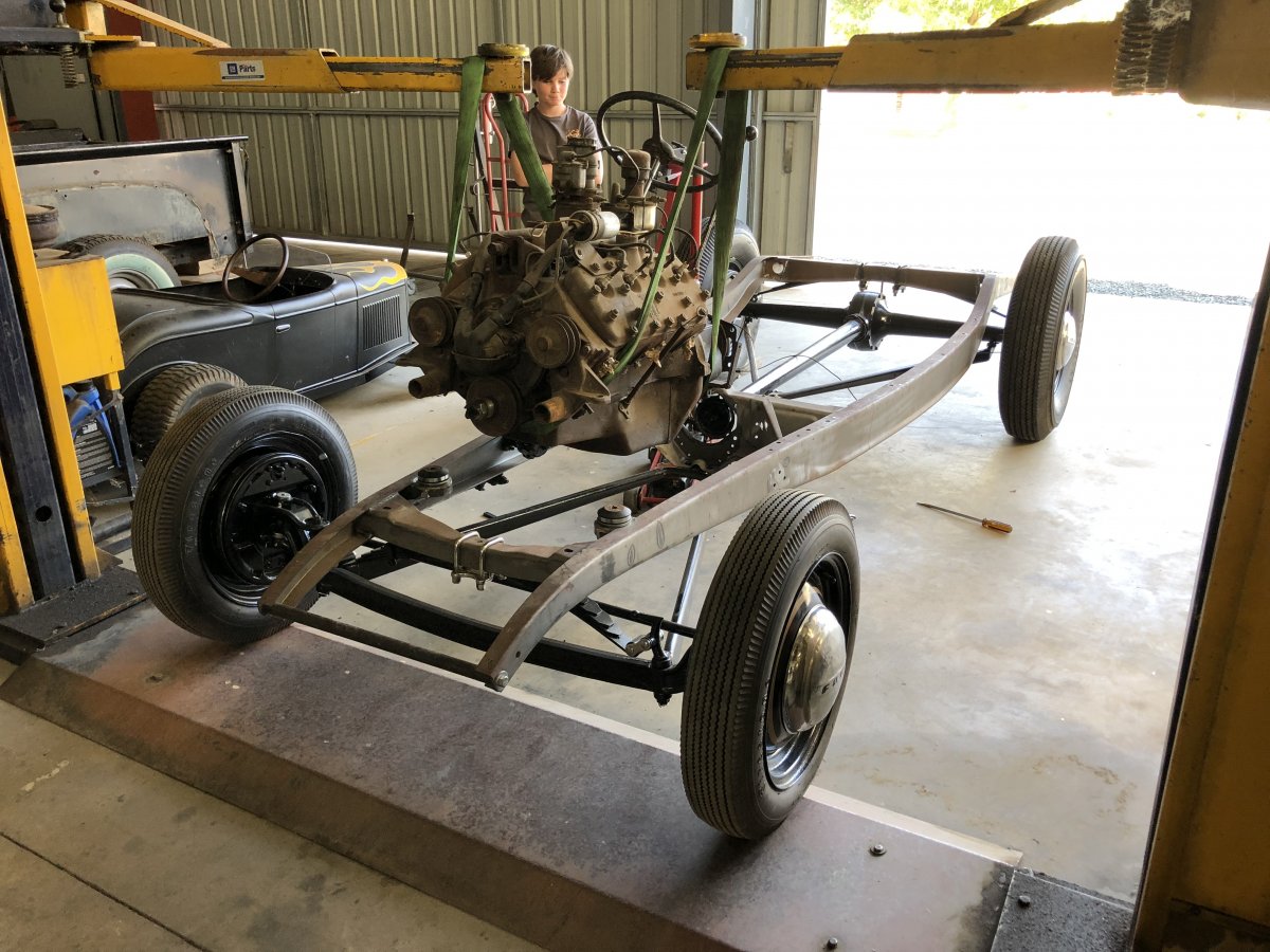

    Today Ace and I pulled the engine and trans. I’ve started on the trans, that way I can sort the pedals out and start on a master cylinder.

  11. AmishMike
    Joined: Mar 27, 2014
    Posts: 1,568
    AmishMike
    Love it. And raising the boys right. Wish I had that help growing up. See a mini bike & a 32 go kart type for play. What engine in mini 32? Be watch’en

    That clutch lever is on the wrong side
    clem and Wardog like this.
  13. Wardog
    Posts: 2,463
    Wardog
    Thank you. I wish I did too. The kids love it, Ace has he’s own tools and is a great help. The mini rod has a 5 hp Briggs and Stratton with a go cart clutch and sprocket set up. Motorcycles are a big part of our family, in fact we may sell the mini rod to fund another dirt bike for the kids.

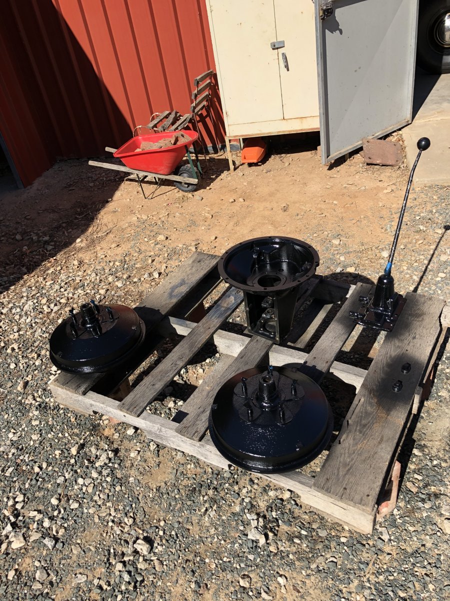

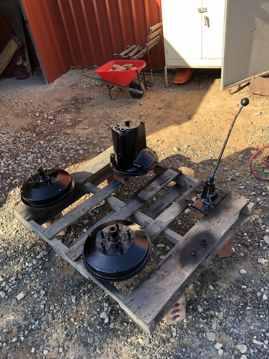

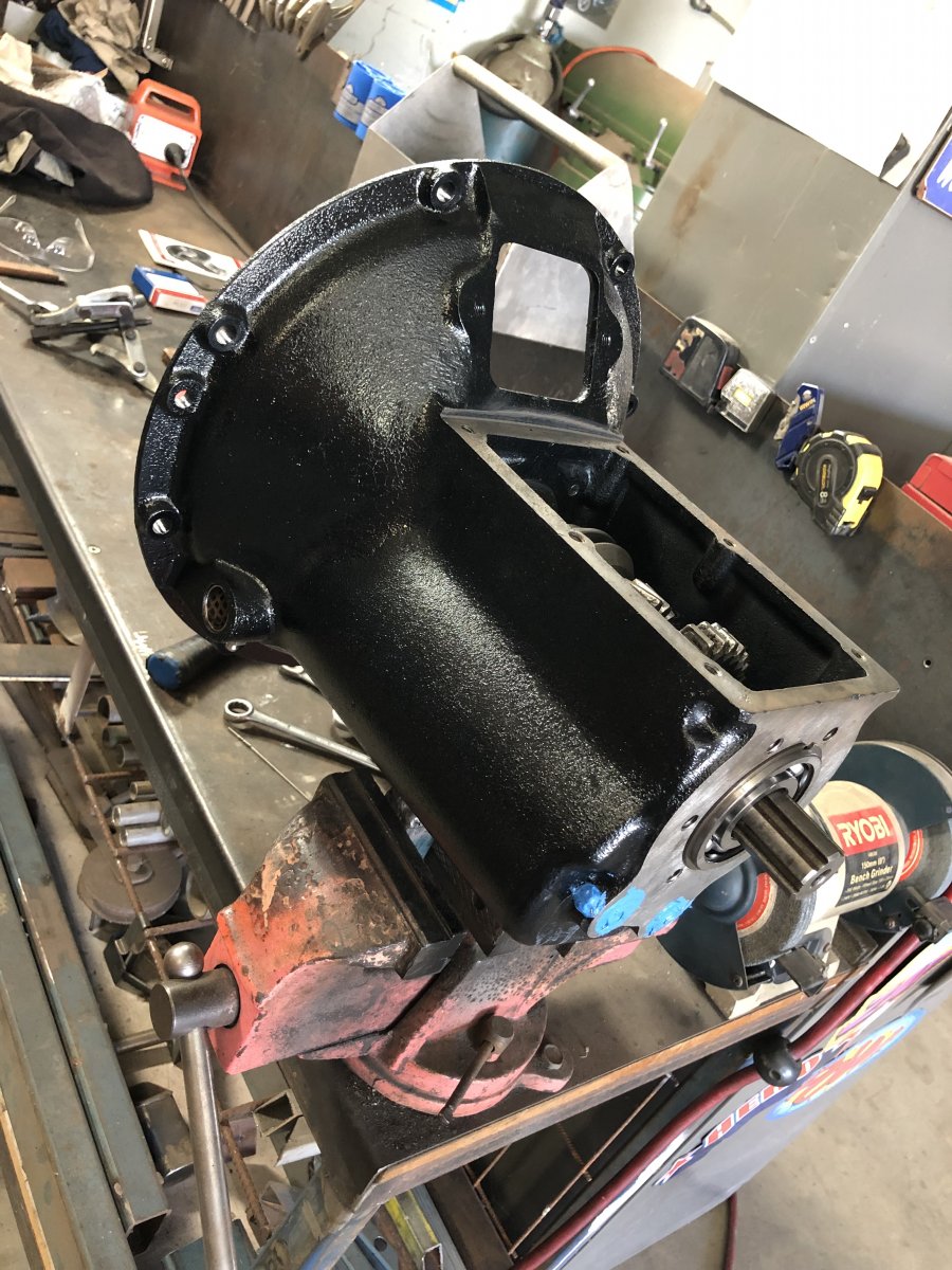

    I haven’t felt very productive lately, having worked 2 weeks of night shift. I’ve stripped the gearbox and found it to be in good condition, new bearings and minimal wear in the thrust washers. This morning I had a bit of time so i painted the case and some drums. The drums I picked up at the Castlemaine swap will replace the wire wheel drums and adapter rings I have on the rear.

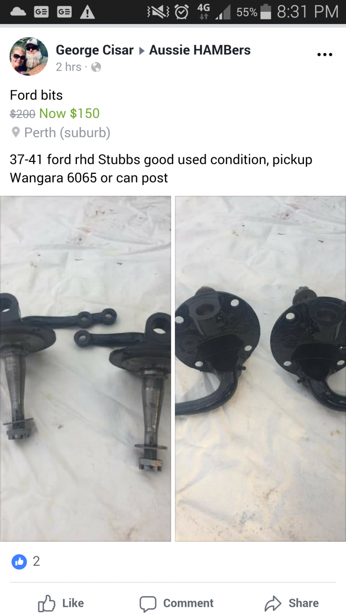

    have you got a link to the spindles I can't find them
  25. Wardog
    Posts: 2,463
    Wardog
    I can’t find the add anymore either. I’m guessing they have sold because they were in good condition for $150.
  26. Drylake
    Joined: Jul 17, 2016
    Posts: 780
    Drylake
    I happened to screen shot the add for the spindles, if that helps? Screenshot_2019-04-11-20-31-02.png

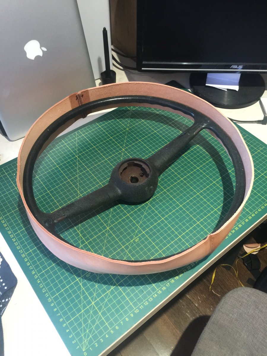

  27. Wardog
    Posts: 2,463
    Wardog
    upload_2019-4-23_20-12-28.jpeg I had a photo sent to me yesterday from my friend who does some leather work. A while ago we worked out a barter type deal. I gave him a wood turning lathe and in exchange he would wrap my steering wheel for me. I love the barter system I think it’s the best way for friends to trade. Leather has a softening and soulful appeal to me and will thicken up the rim of my wheel. I know this wheel is a bit rough but like a majority of the parts in this build it has its own special story. It was given to me by my father in law after I told him his tractor had an old ford steering wheel on it. So I really want to use it for what it is rather than what it could be.

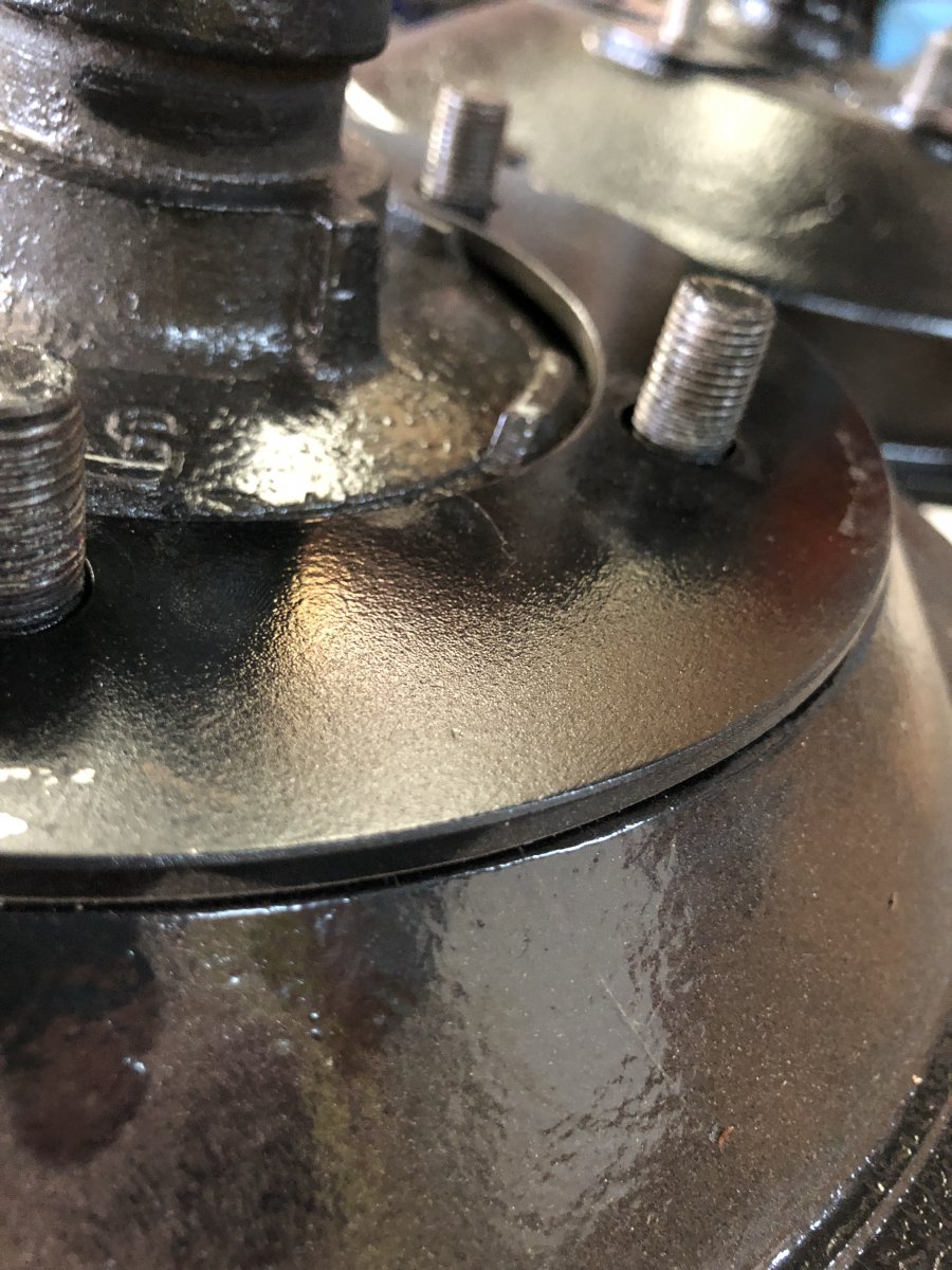

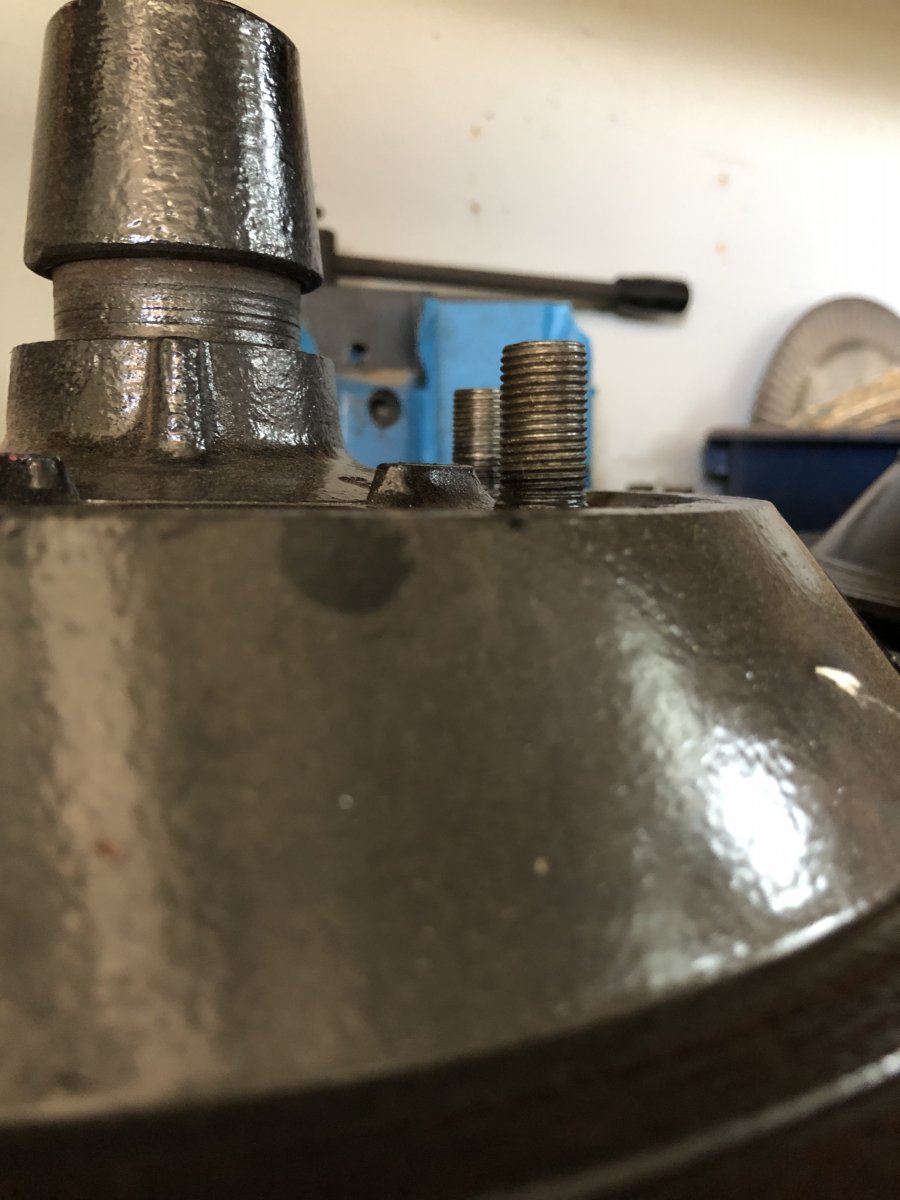

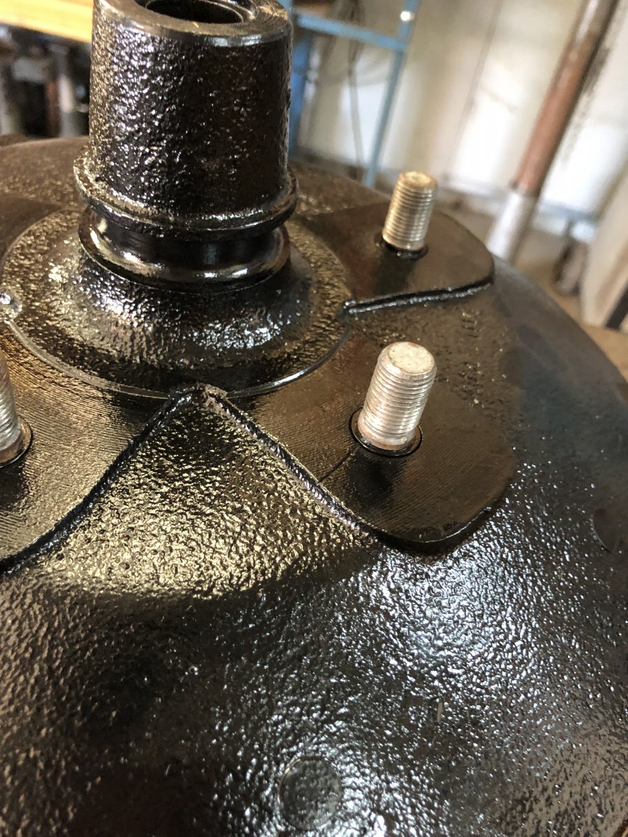

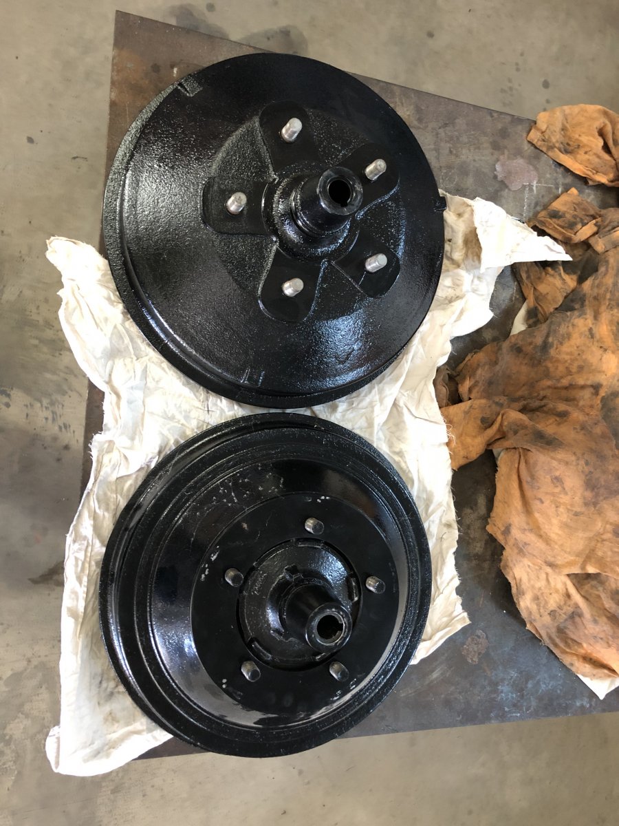

    Today I swapped out the 35/36 rear drums for the 40 drums. The 35/6 are a wire wheel drum and the 40 are a solid wheel drum. I was prepared to run the wire wheel drums with adapter rings until I noticed the pitting inside the hubs. But I feel a lot better knowing the wheels are mounting correctly on the flat surface they were designed to be on.

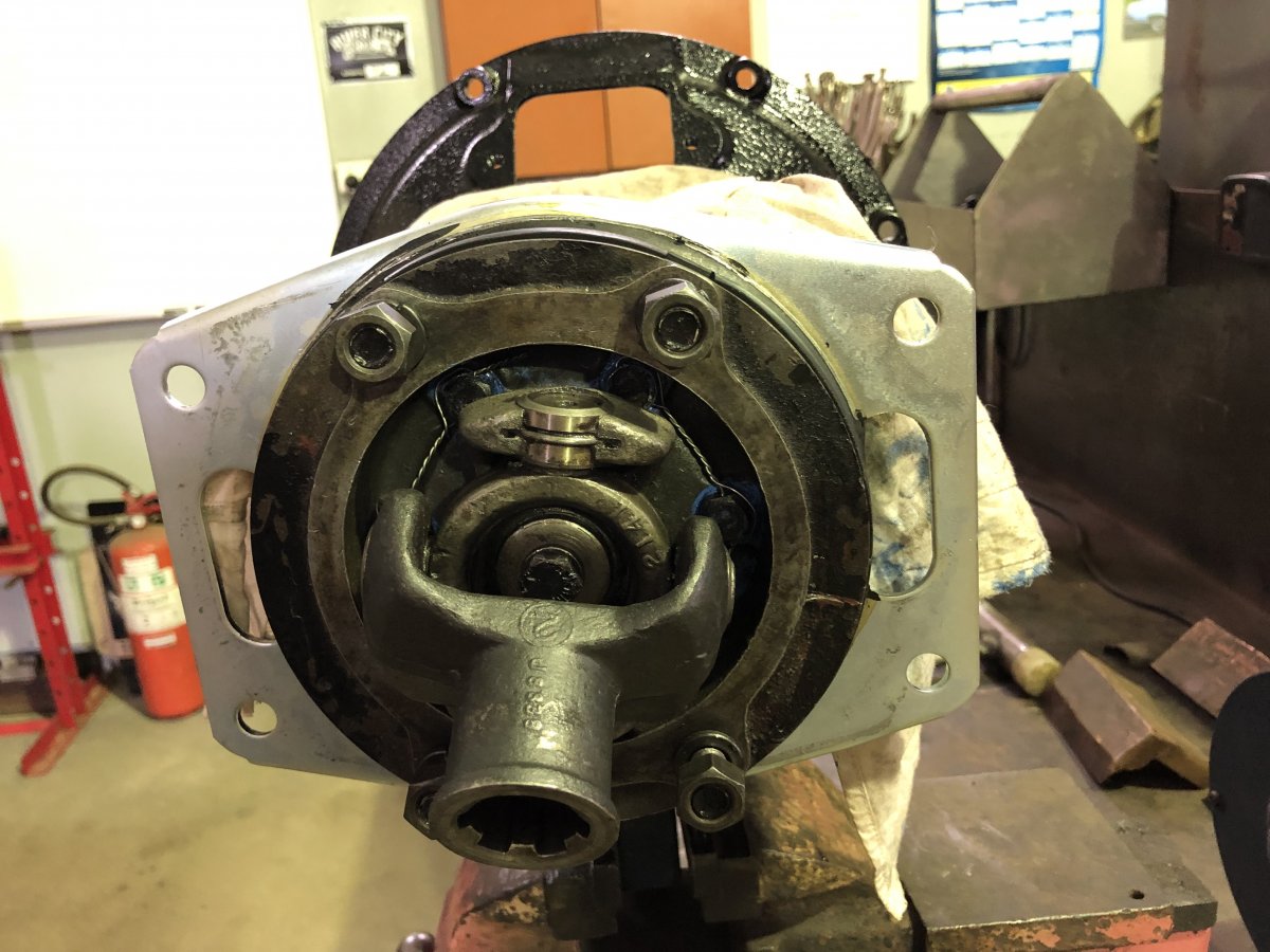

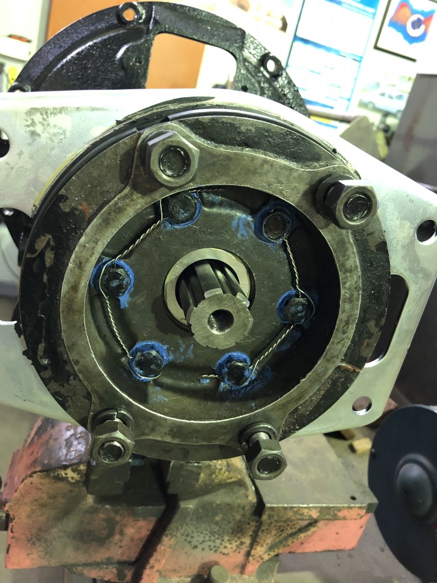

    I’ve been slowly working on the transmission. Nearly done.

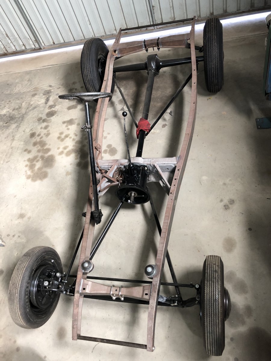

  30. Wardog
    Posts: 2,463
    Wardog
    I got the trans back in the frame. The clutch lever I picked up from my mate at the Castlemaine swap seems to work with the stock pedal and linkage.
