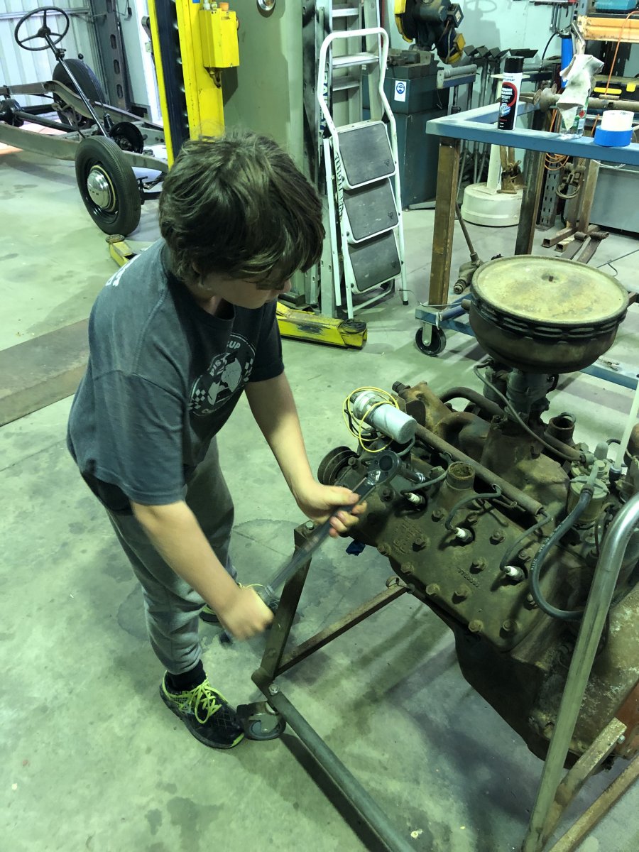

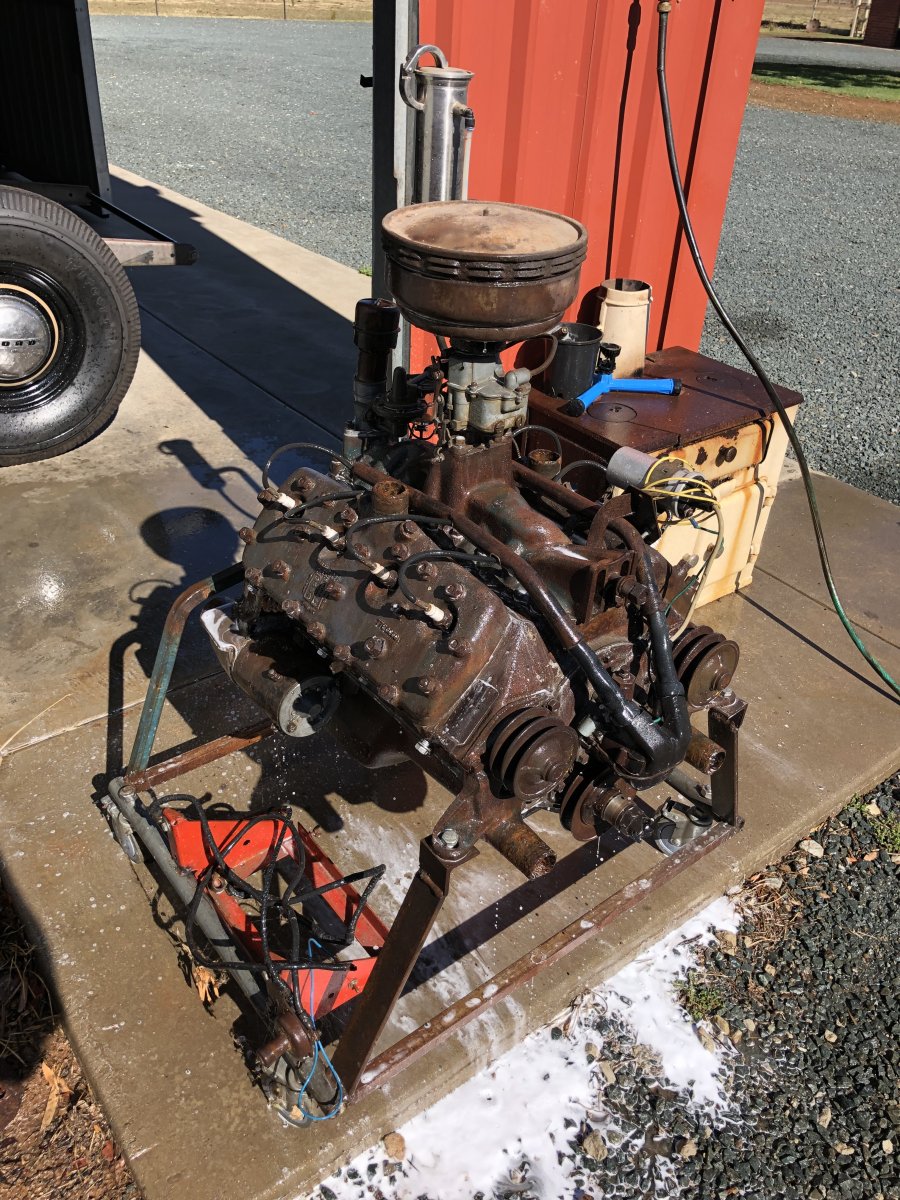

    I also started cleaning the engine up. Wash 1 of about 40.

    I washed the engine a few more times today. Then we removed the coil bracket, some washers and the end of an old braided earth strap from under the head nuts.

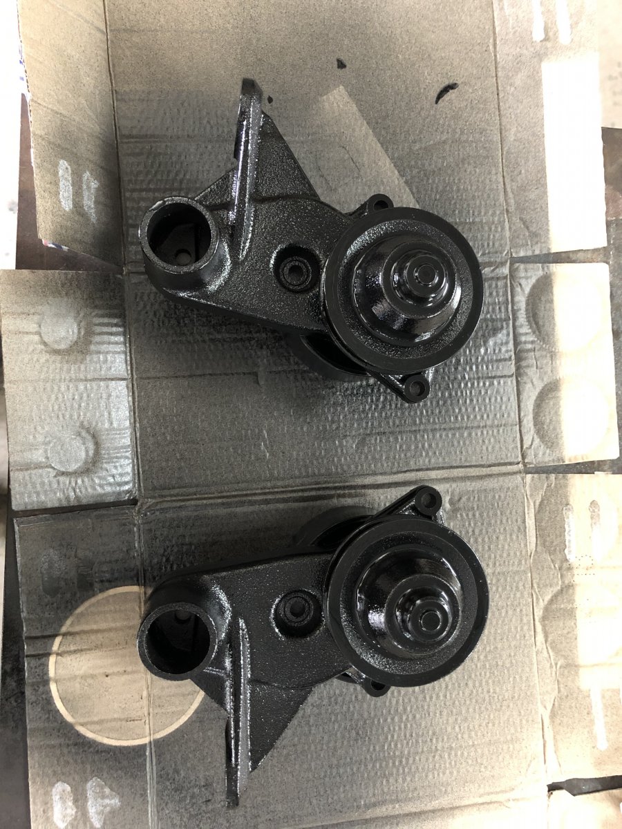

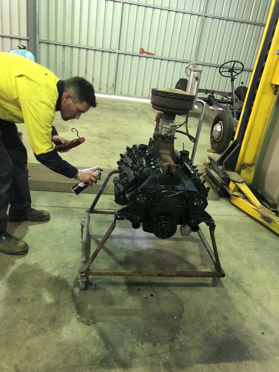

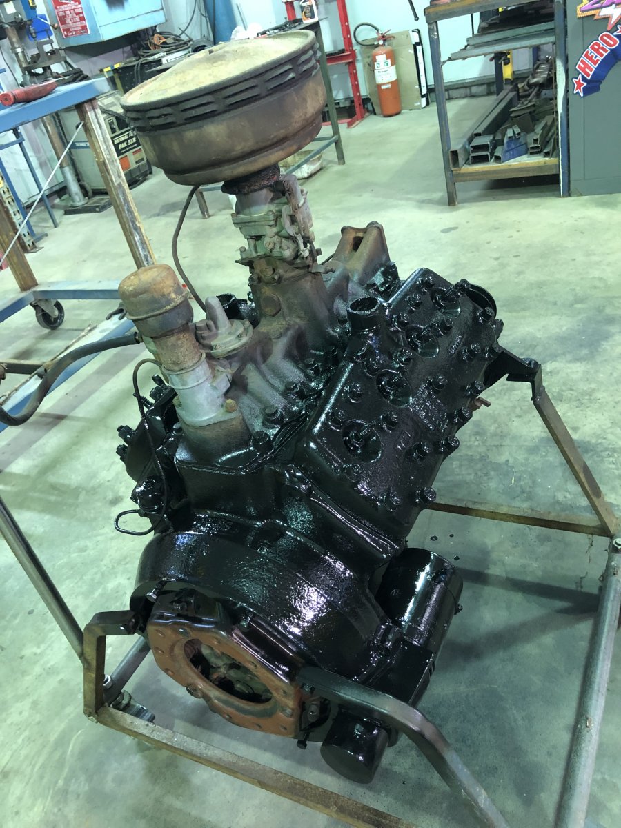

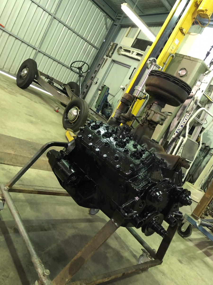

    The engine got some new water pumps and a paint job today.

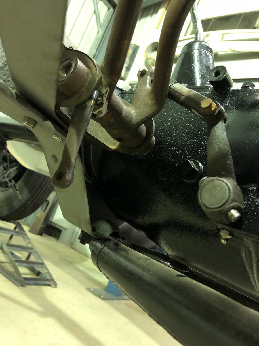

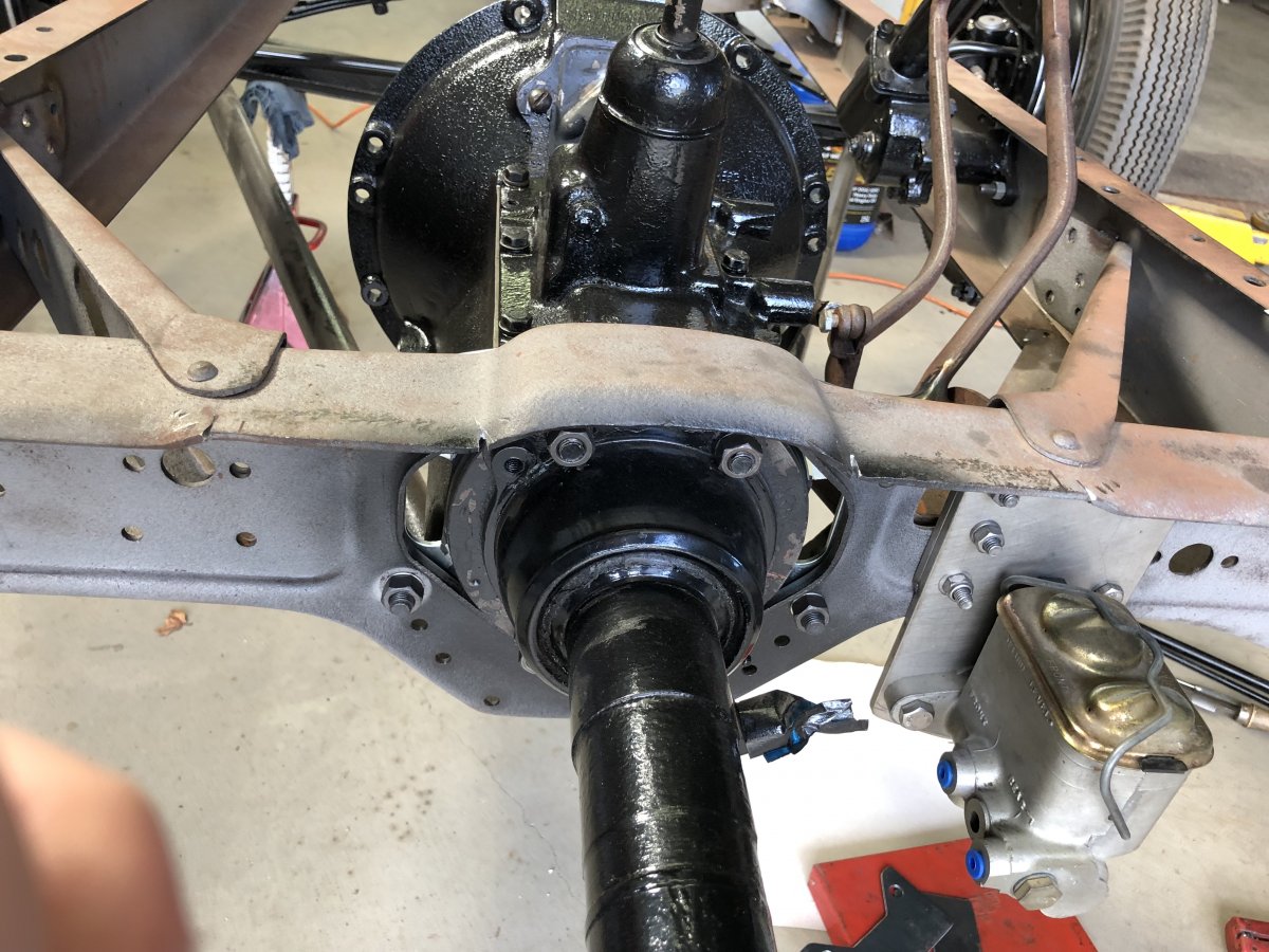

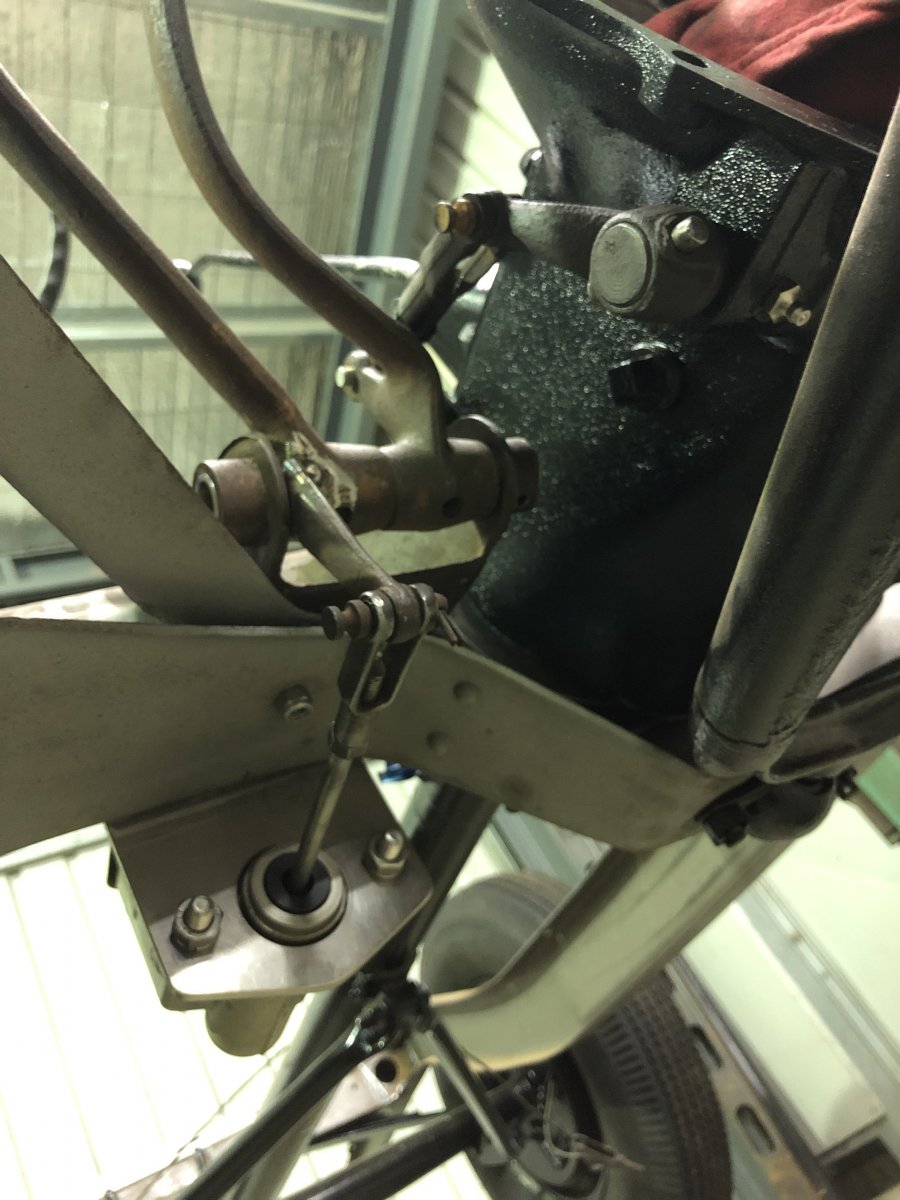

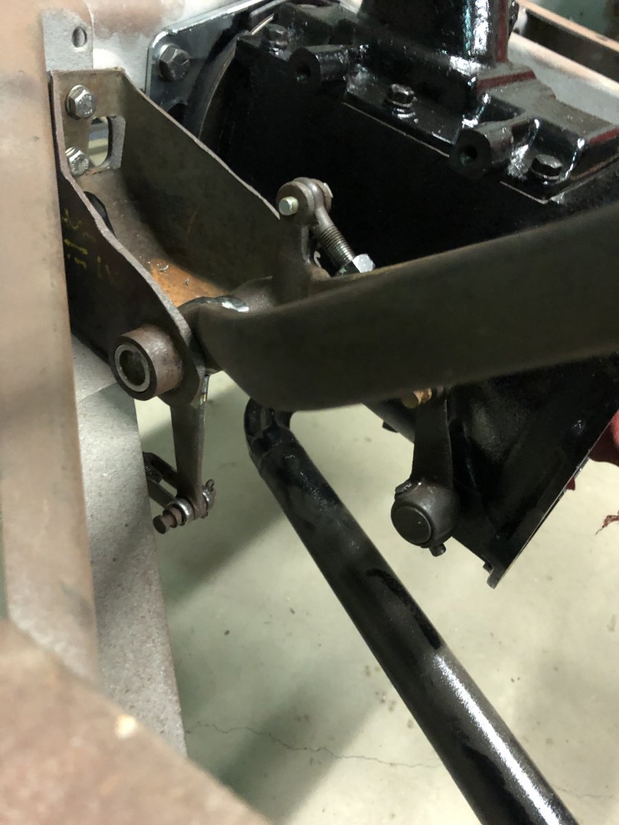

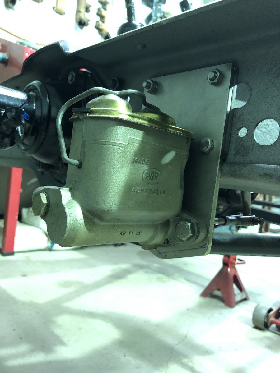

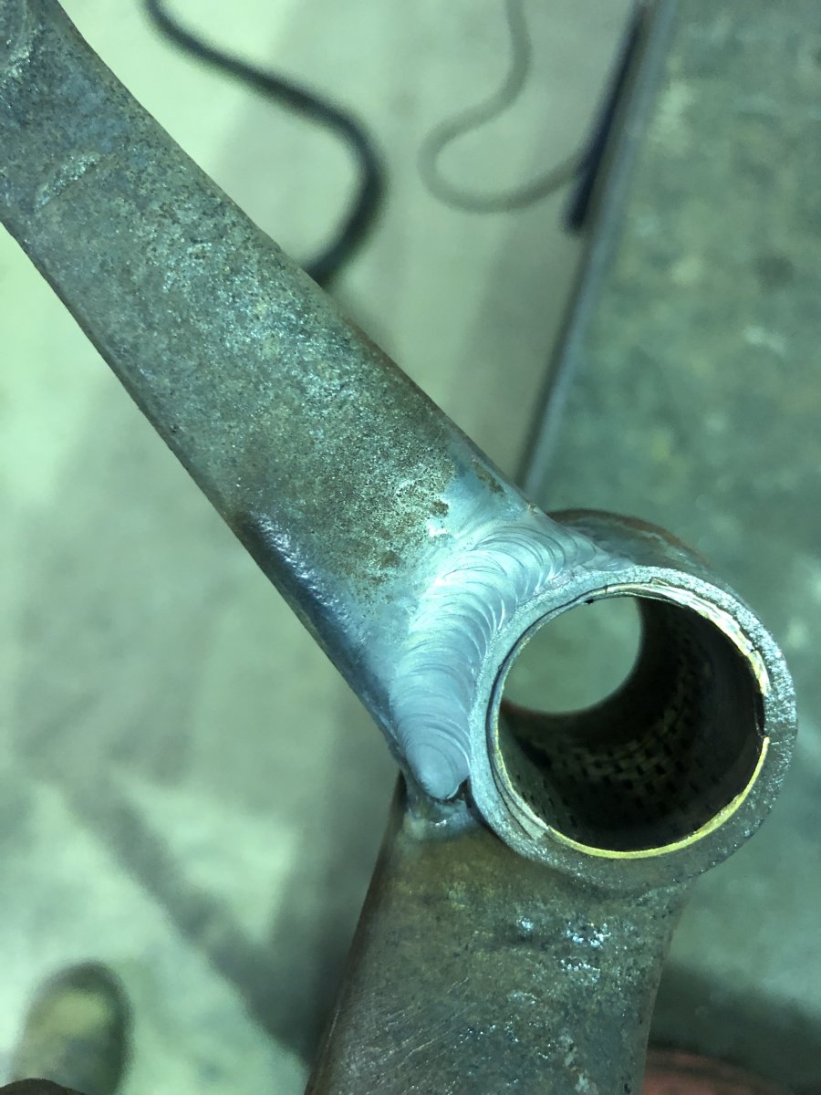

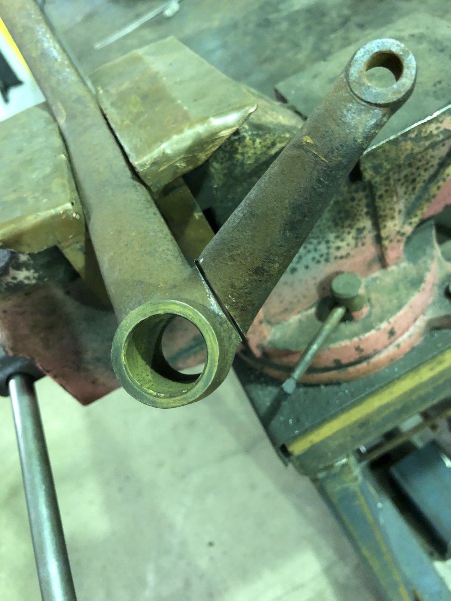

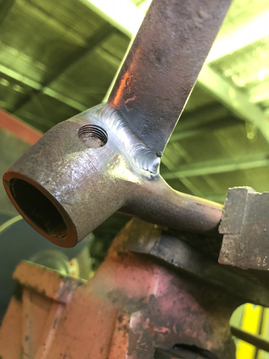

    Tonight I made a start on my brake pedal. I didn’t expect to procrastinate on this as much as I have. But when you have such a nice set of pedals that first cut is a hard one to make.
    I cut the mechanical brake lever off the pedal and straightened it in the press. Then after some t******* and scalloping with a file I tacked it back on the bottom of the pedal.
    I’ll turn my attention to the master cylinder mount before welding it completely.
    B90E6F33-EBD6-407B-8A44-8A22350510E4.jpeg D946F943-BDBE-41E7-AFF3-AE67B349620C.jpeg
  16. Wardog
    Joined: Jan 12, 2010
    Posts: 2,463
    Wardog

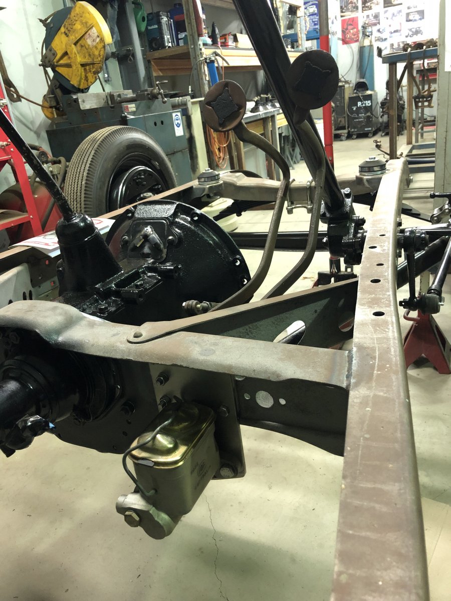

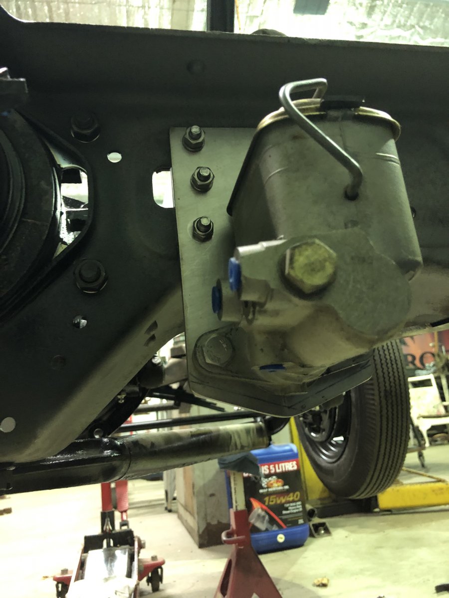

    I’ve been getting a bit done every night this week. Tonight I ***embled and checked it then welded the repositioned lever to the pedal. I’m happy with the position of the master cylinder, it’s a lot higher than the suspension and where the sump will be. The mismatched bolts will be replaced by some new unc hardware.

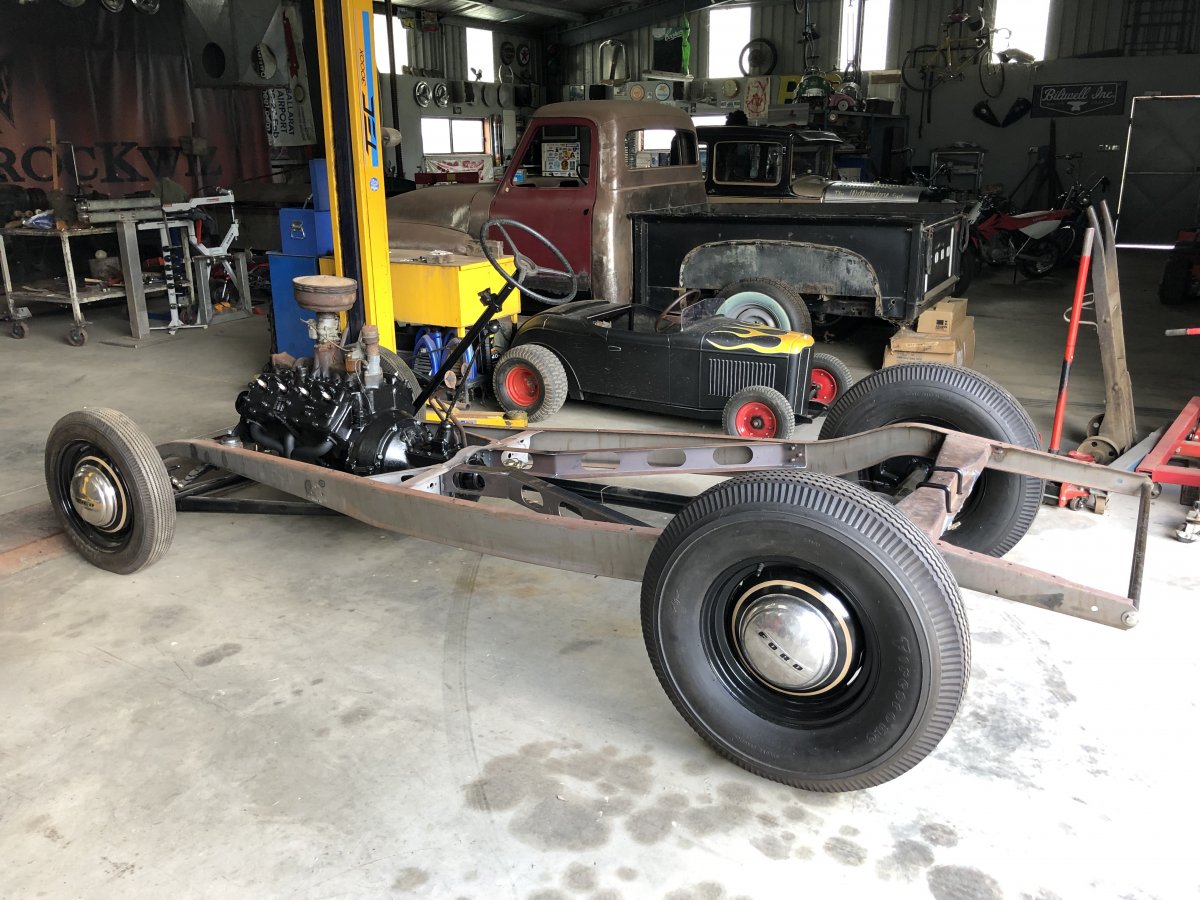

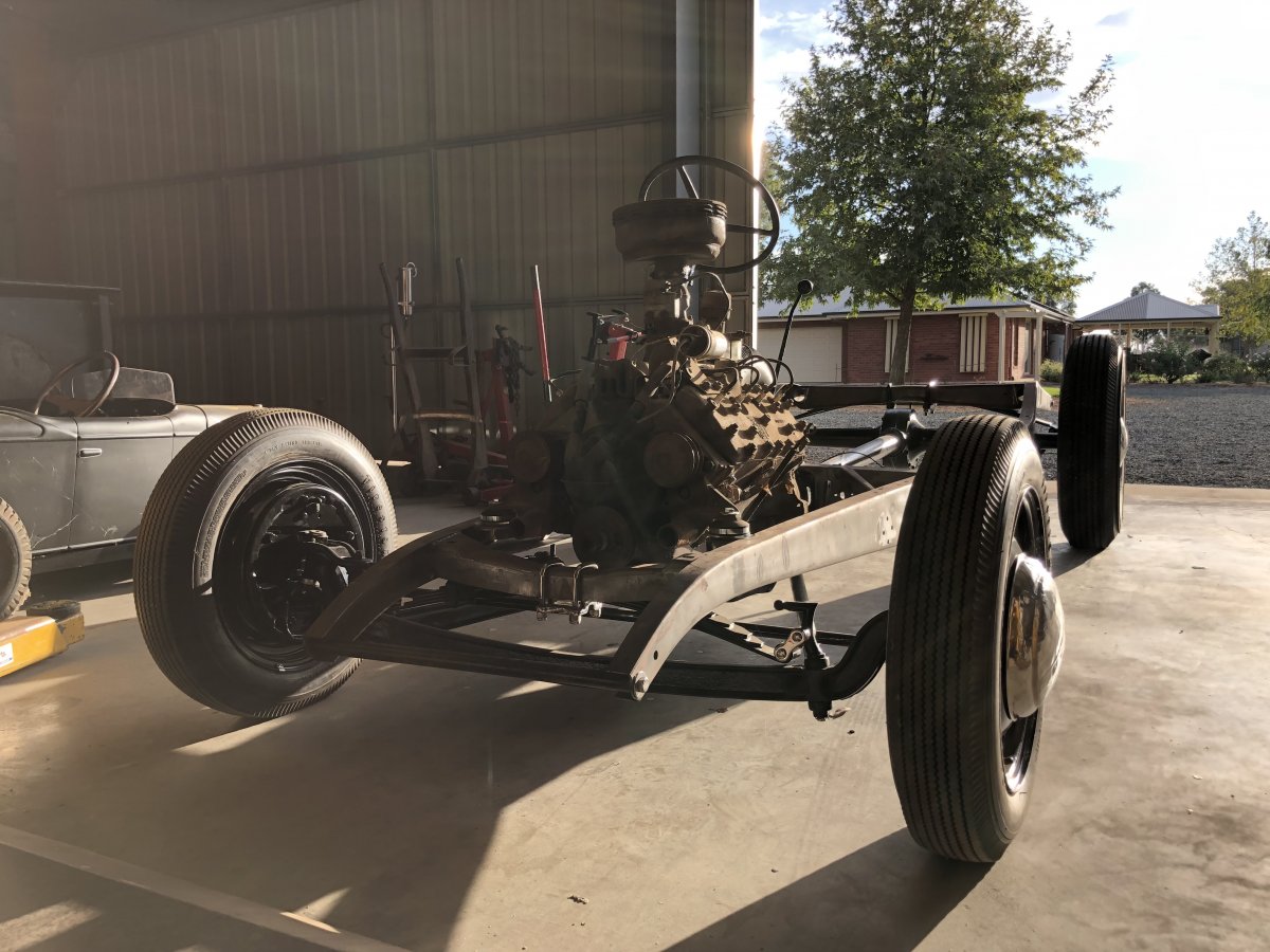

    The last couple of weekends I’ve been busy with the family and haven’t achieved much. What I have done has been during the week. Today I put bushes in the pedals but that wasn’t really worth a photo. So here is a photo from before I pulled the engine I had forgotten about.

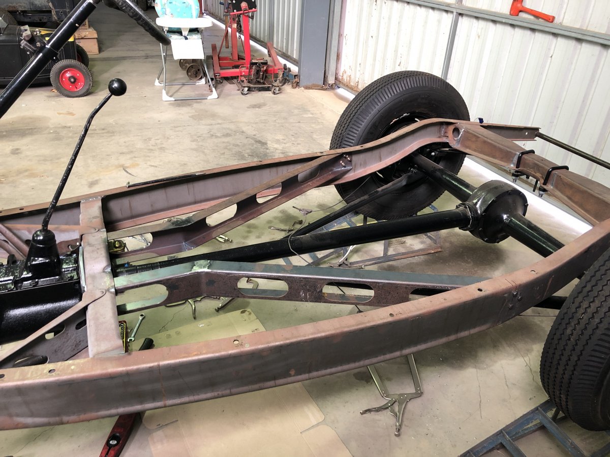

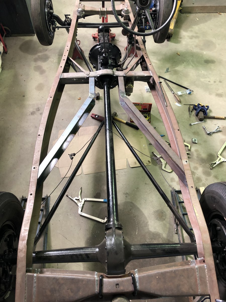

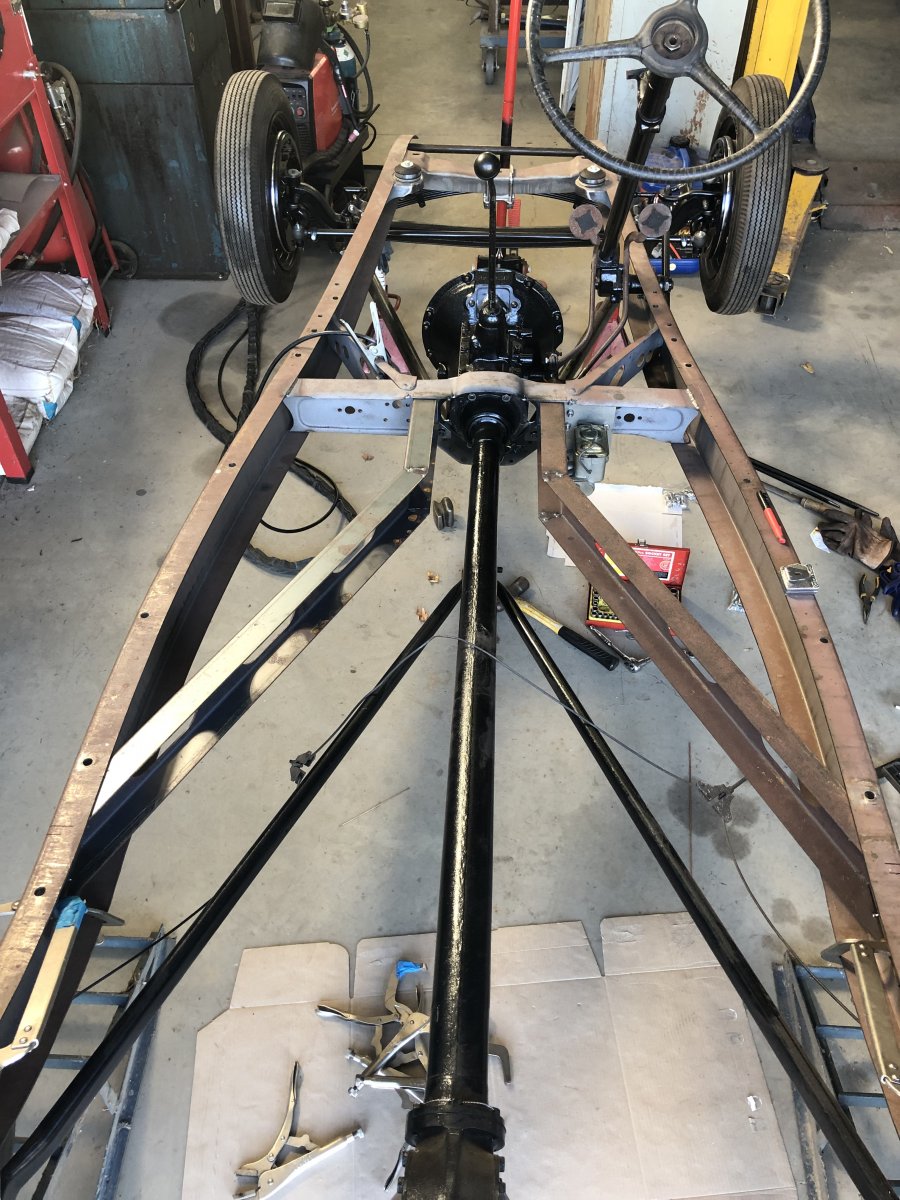

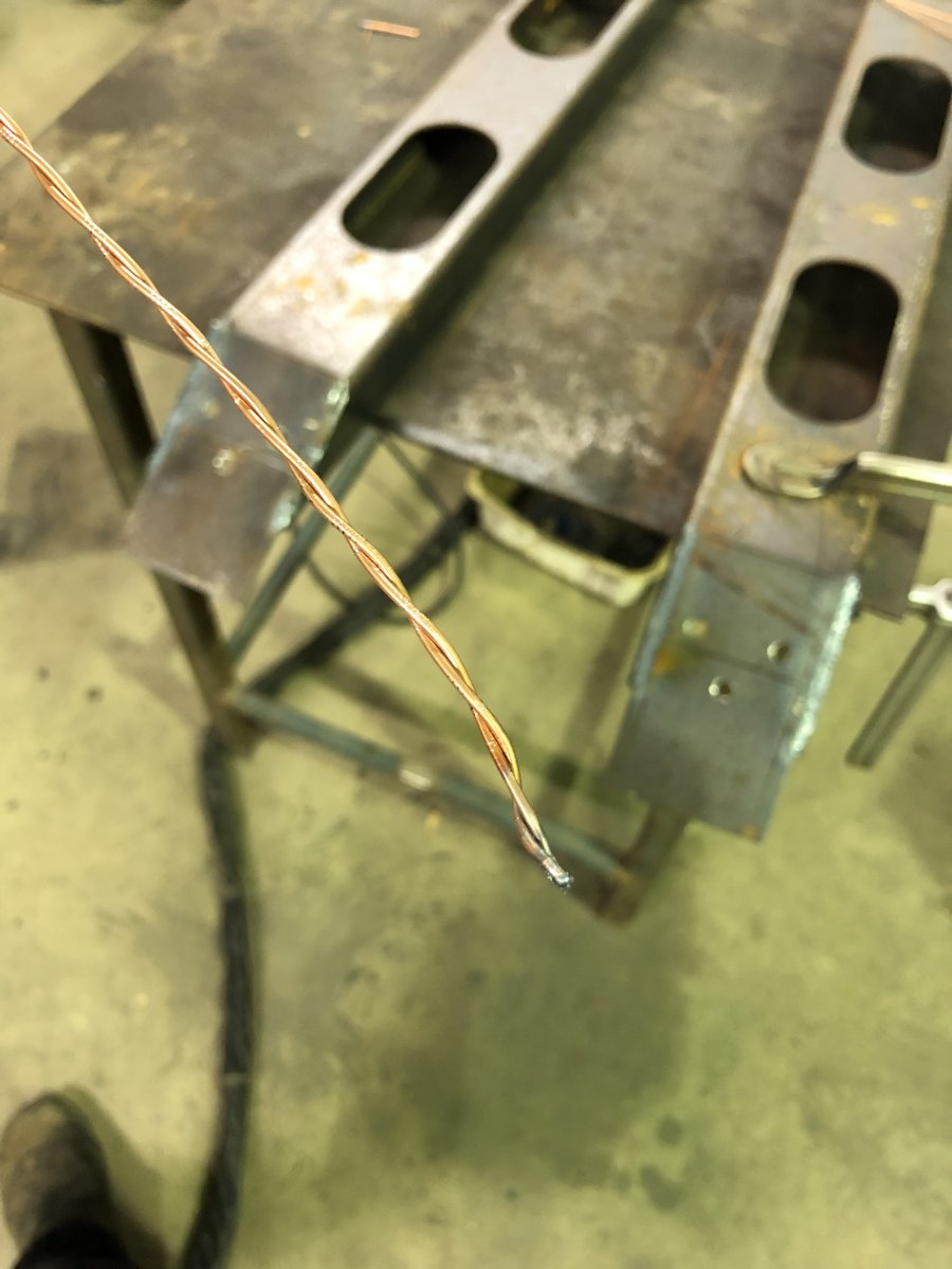

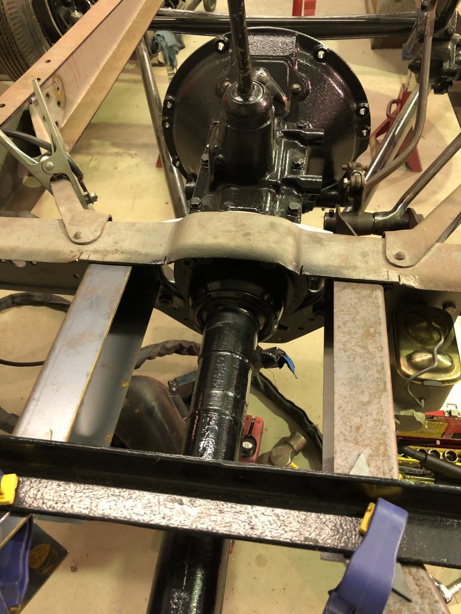

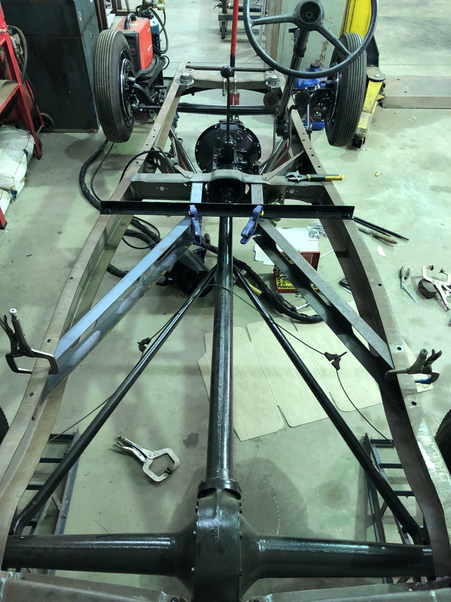

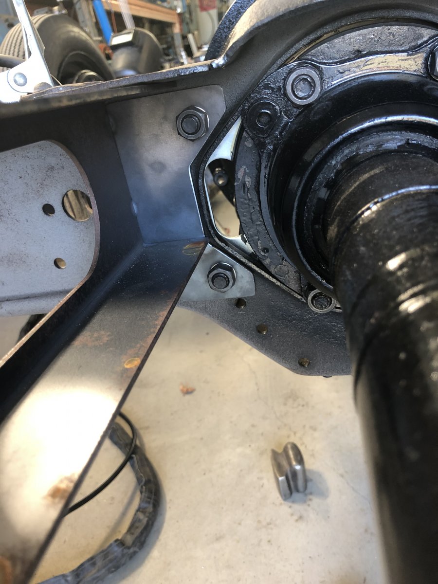

    I made some rear legs for the center crossmember this weekend. I used some laser cut channels a friend gave me. I started by flattening out sections of the lip on the back edge of the crossmember for the legs to fit flush.
    Nothing groundbreaking about them. They meet the rails at about the same place as some stock holes.
    799A0A57-38FB-4C20-97BC-63A570A7456C.jpeg 1BB79165-F3A5-445A-8A6B-C408B9BAE7BF.jpeg 078B7C75-6A28-4FCD-9B4D-7AF5ADD4FF45.jpeg

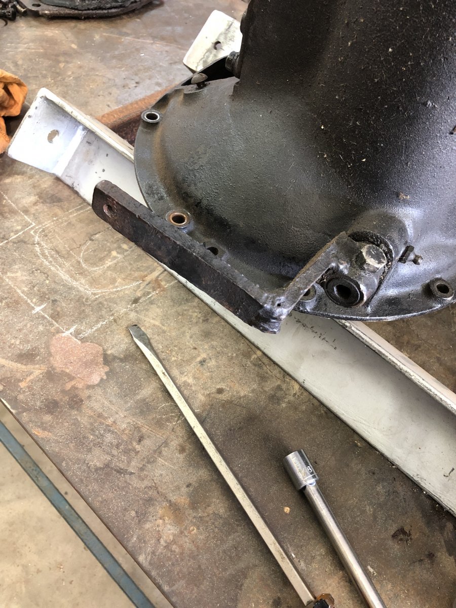

    I picked up on the transmission mount for the front brackets.
    Sometimes you need bigger filler than you have...
    1947knuck, treb11, deluxester and 6 others like this.
  21. Wardog
    Posts: 2,463
    Wardog
    Finished and bolted in.
    D9BC14A6-3A97-4CC7-882C-12CFDDD3F478.jpeg E832C0E1-7C26-4C60-AAA7-BBAEDEC7A77B.jpeg

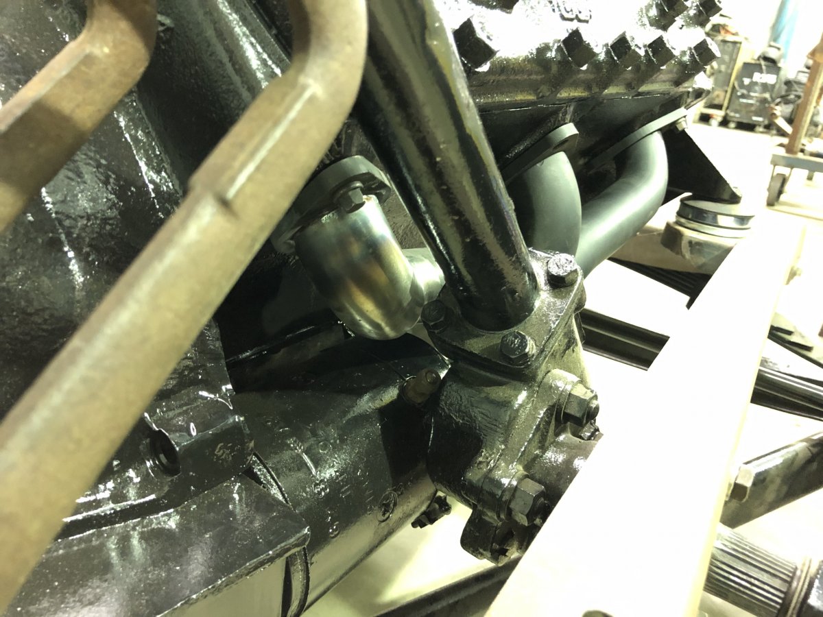

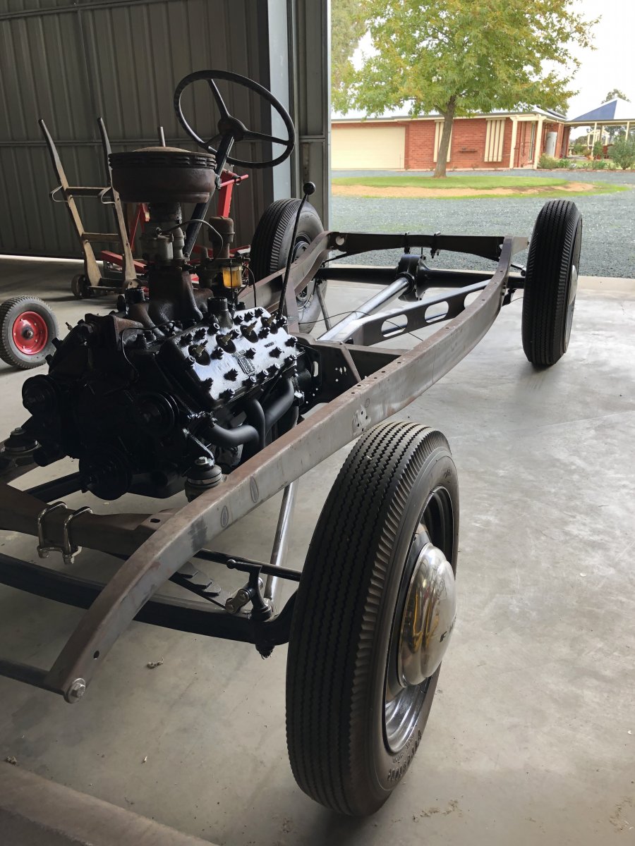

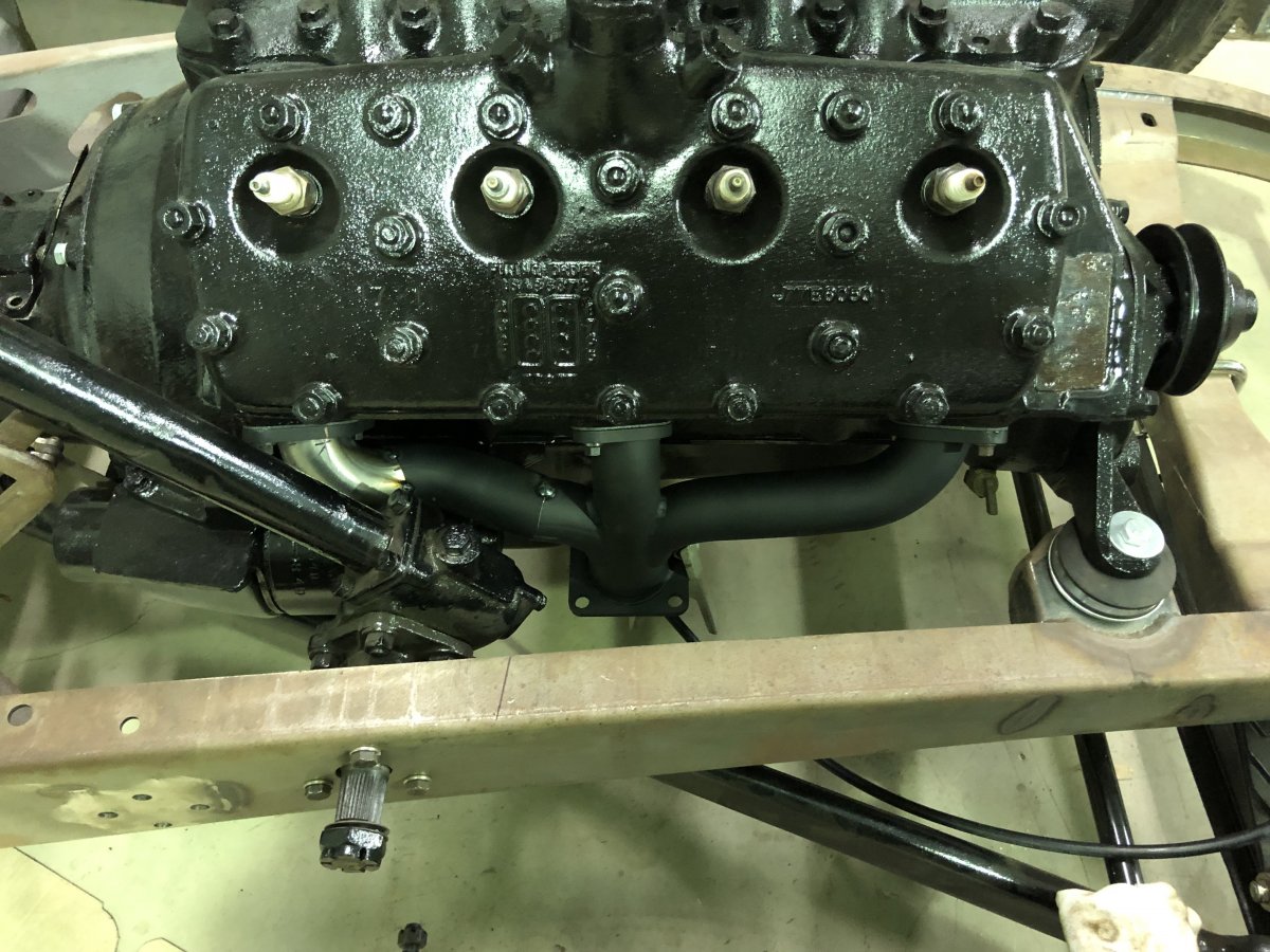

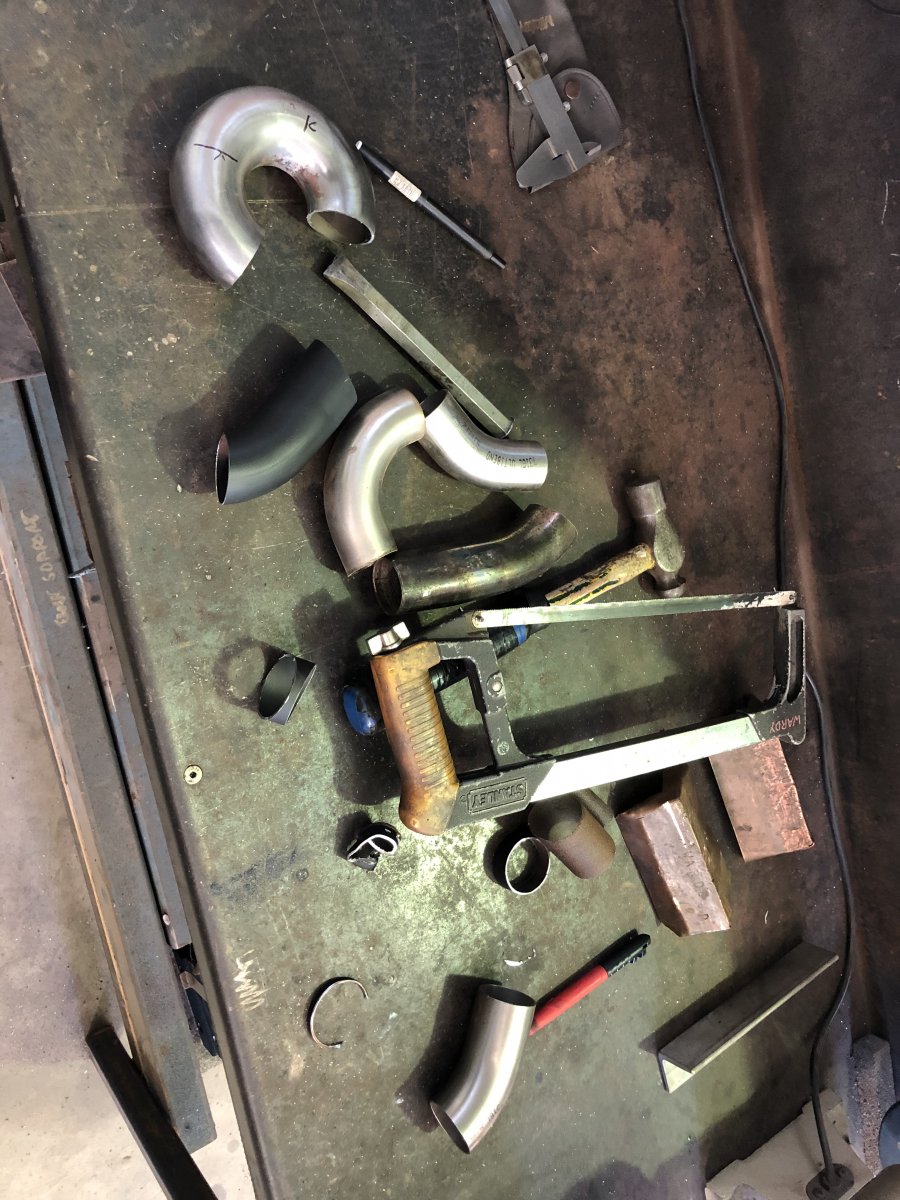

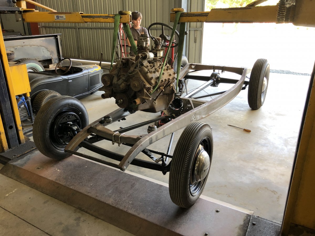

    I got engine back in this morning and started to look at how I will modify the headers.

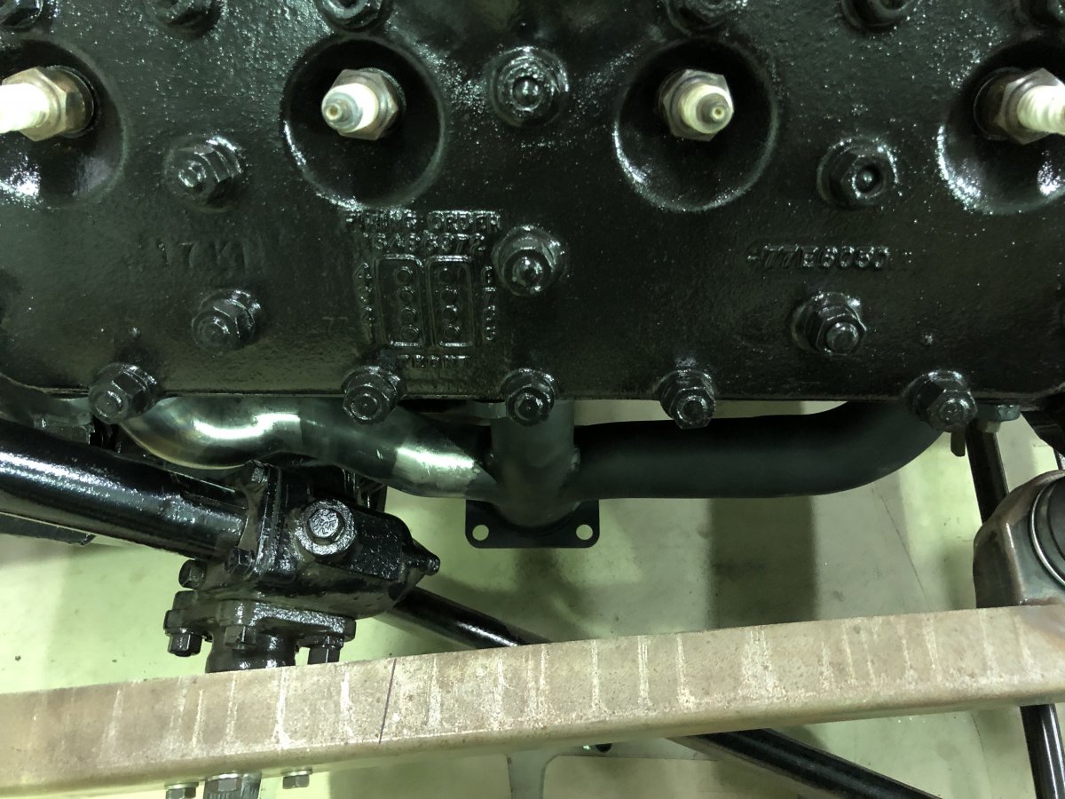

  25. Wardog
    Posts: 2,463
    Wardog

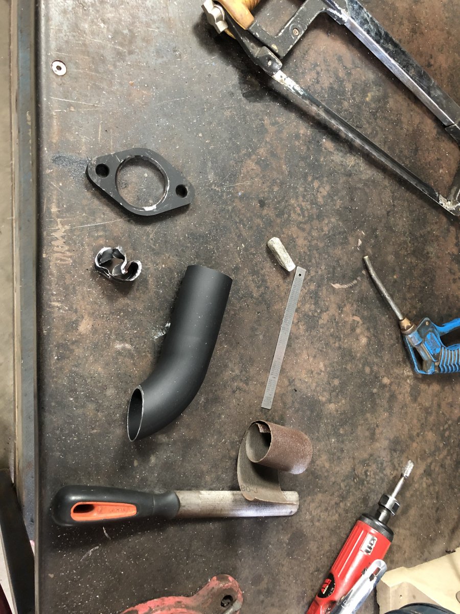

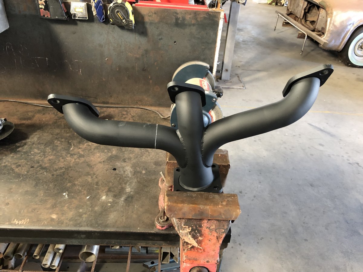

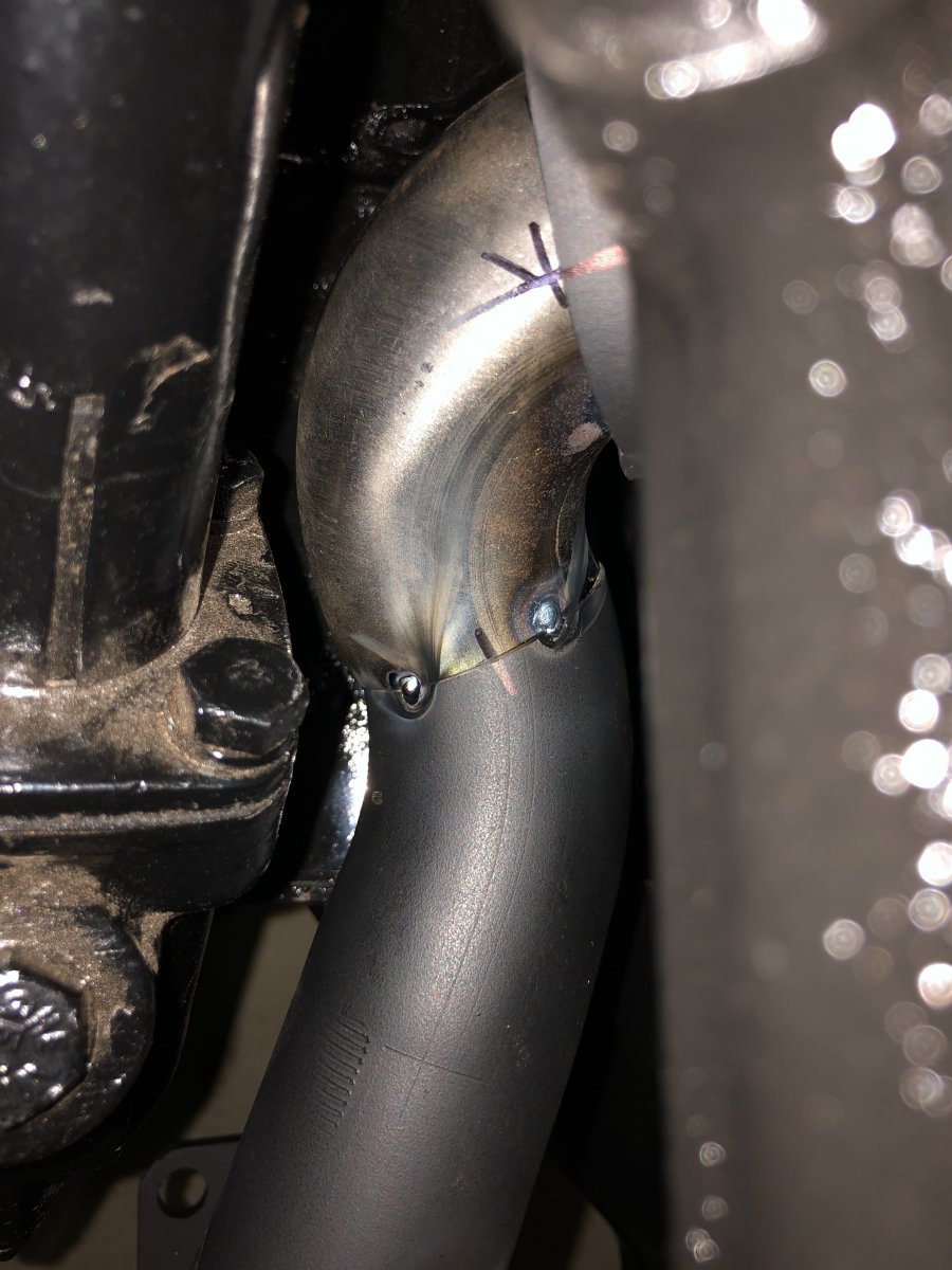

    I bought some headers knowing they wouldn’t clear the steering box. So I’ve been modifying them for clearance. I got that done tonight, now on to the rest of the exhaust.
