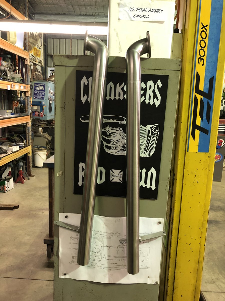

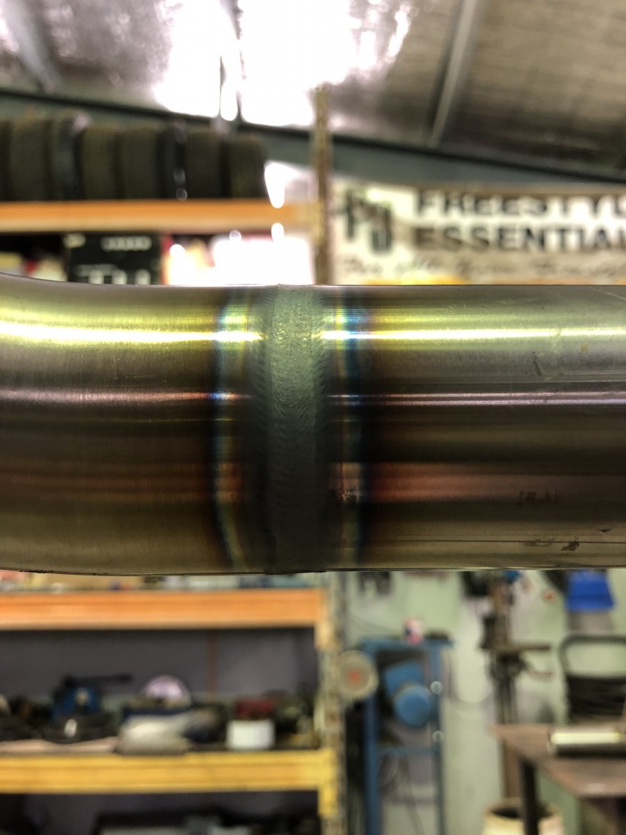

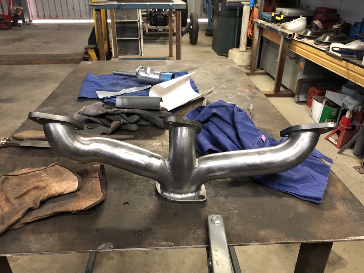

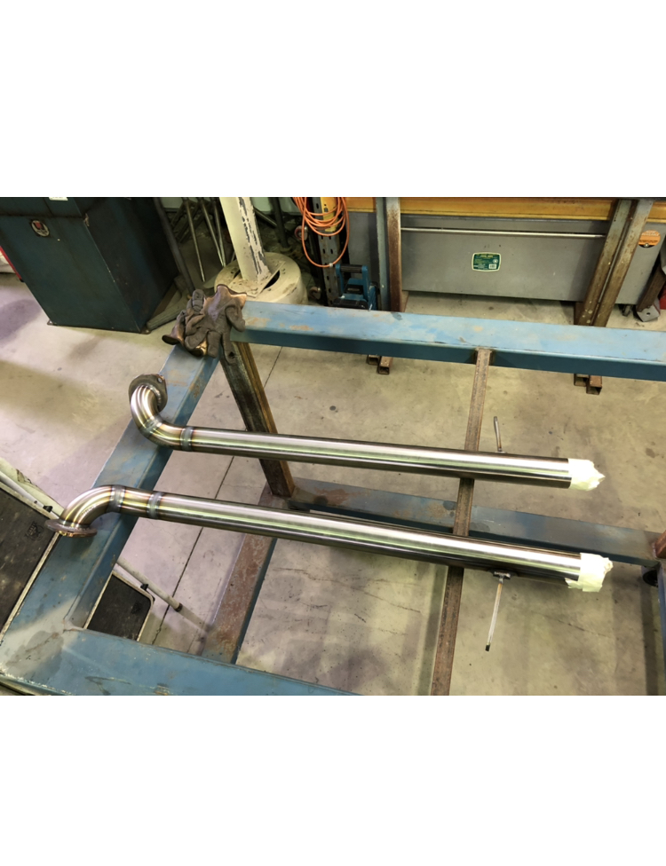

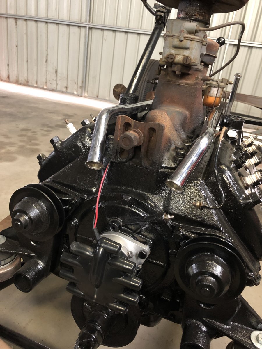

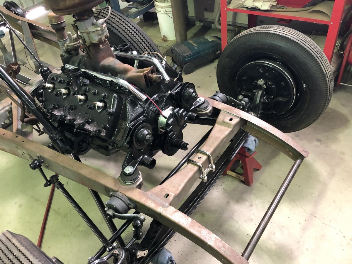

    Not a lot of progress lately. I’ve been working night shift again, the kids have been on school holidays and we had a bad storm come and knock a heap of trees down.

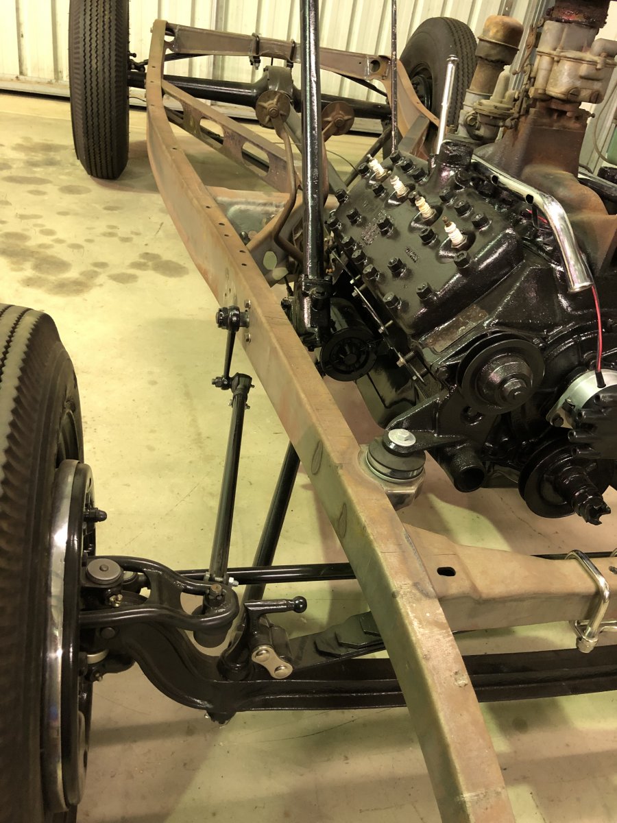

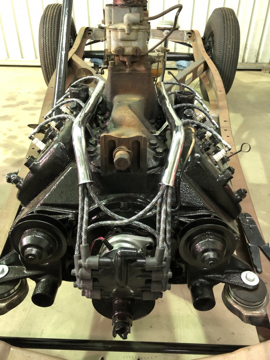

    I’ve got the whole exhaust welded up now. I’ve got some cleaning up to do before I coat the headers and polish the stainless pipes.
    I’ve also mounted my Stromberg e-fire distributor and plug wire conduits. I have also bought some 32 shock absorbers that I am still waiting on to be delivered.

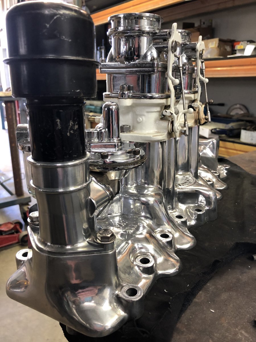

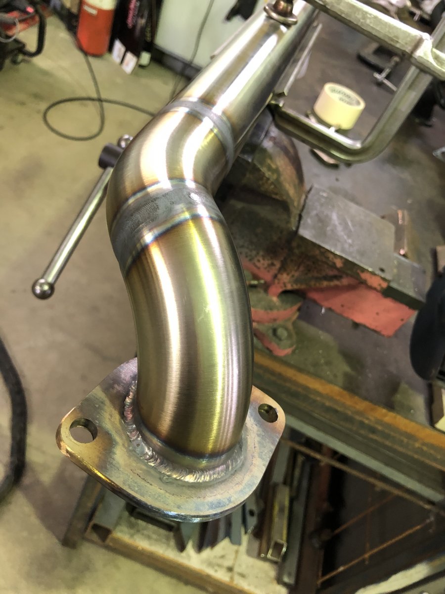

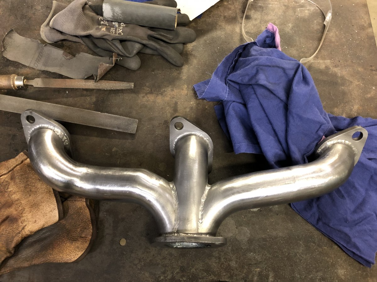

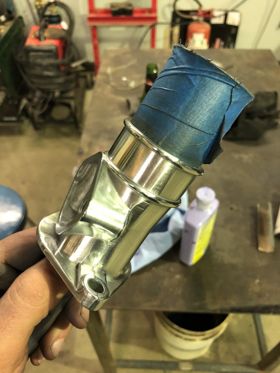

    A photo of the Stromberg e-fire distributor and the wire conduits.
    Today I worked on the modified header. I filled some pits with weld and filed them flat. I blasted it and gave it a sand. It’s nearly done.
    F8A40EDC-EFDA-449D-829B-465D124EDBB7.jpeg BAAA2EE7-9D1D-4012-8101-2C331C7A5120.jpeg
    I also started hand polishing the fuel pump stand.

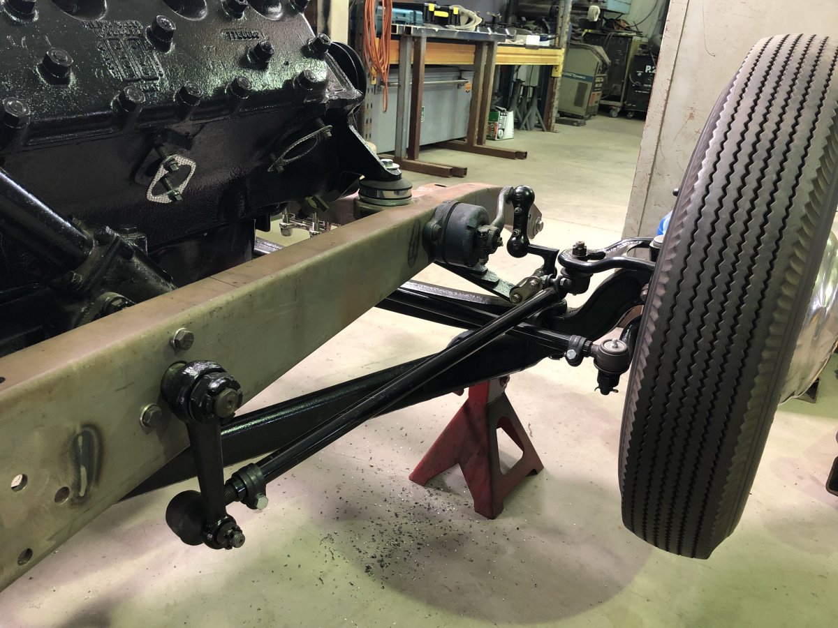

    I had the taper in the pitman arm reversed a while ago. Not a big visual change but it gave clearance between the drag link and tyre at full right lock.

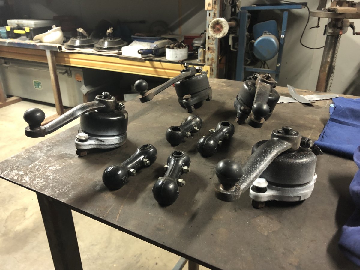

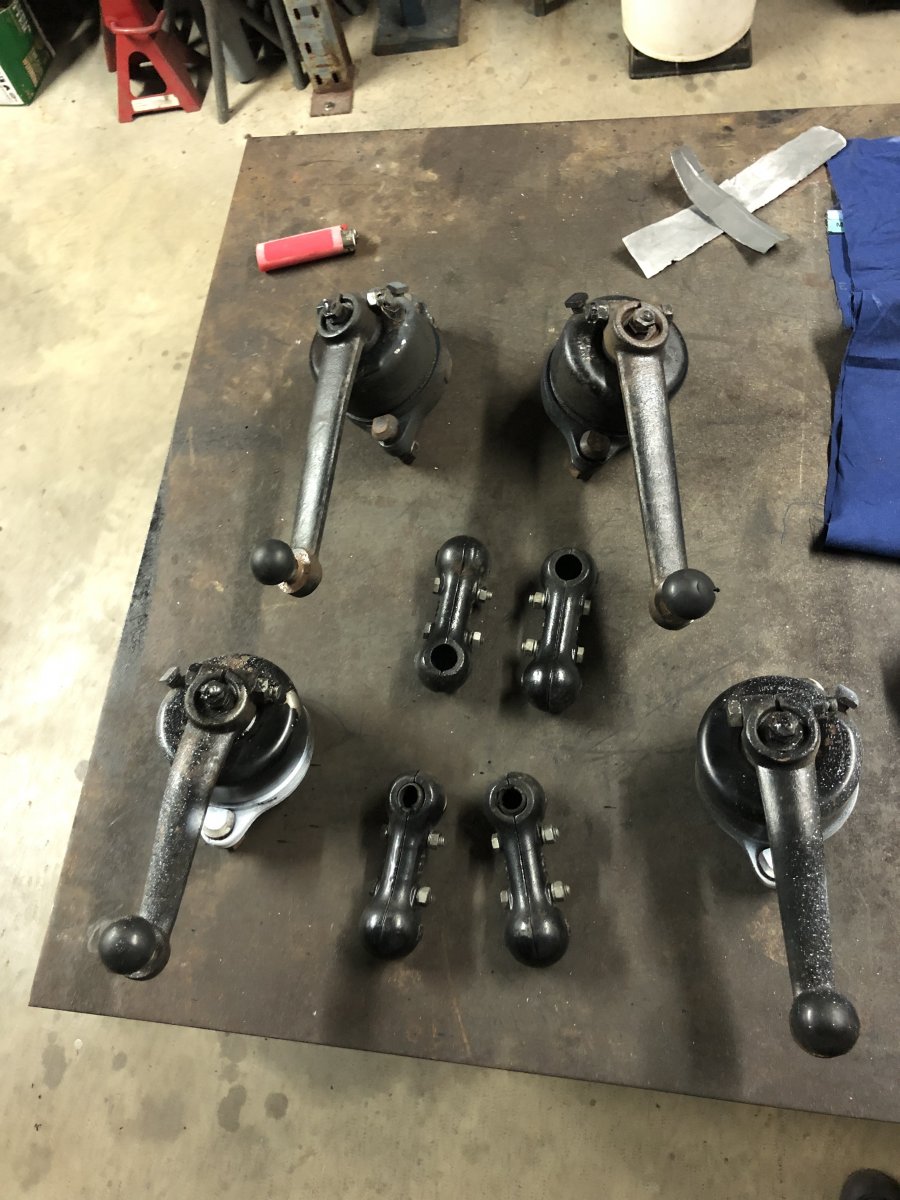

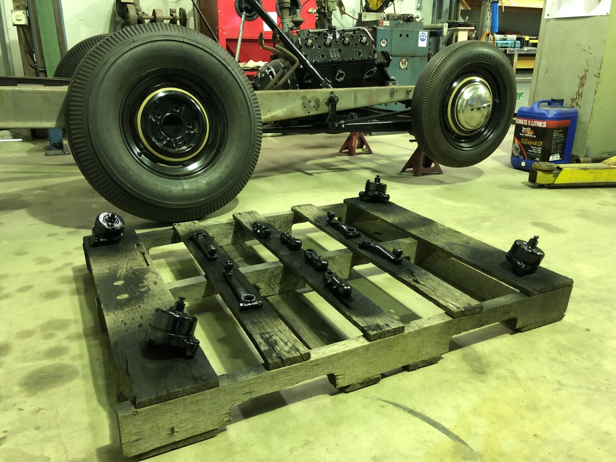

    Good mail day. My deuce shocks turned up today.

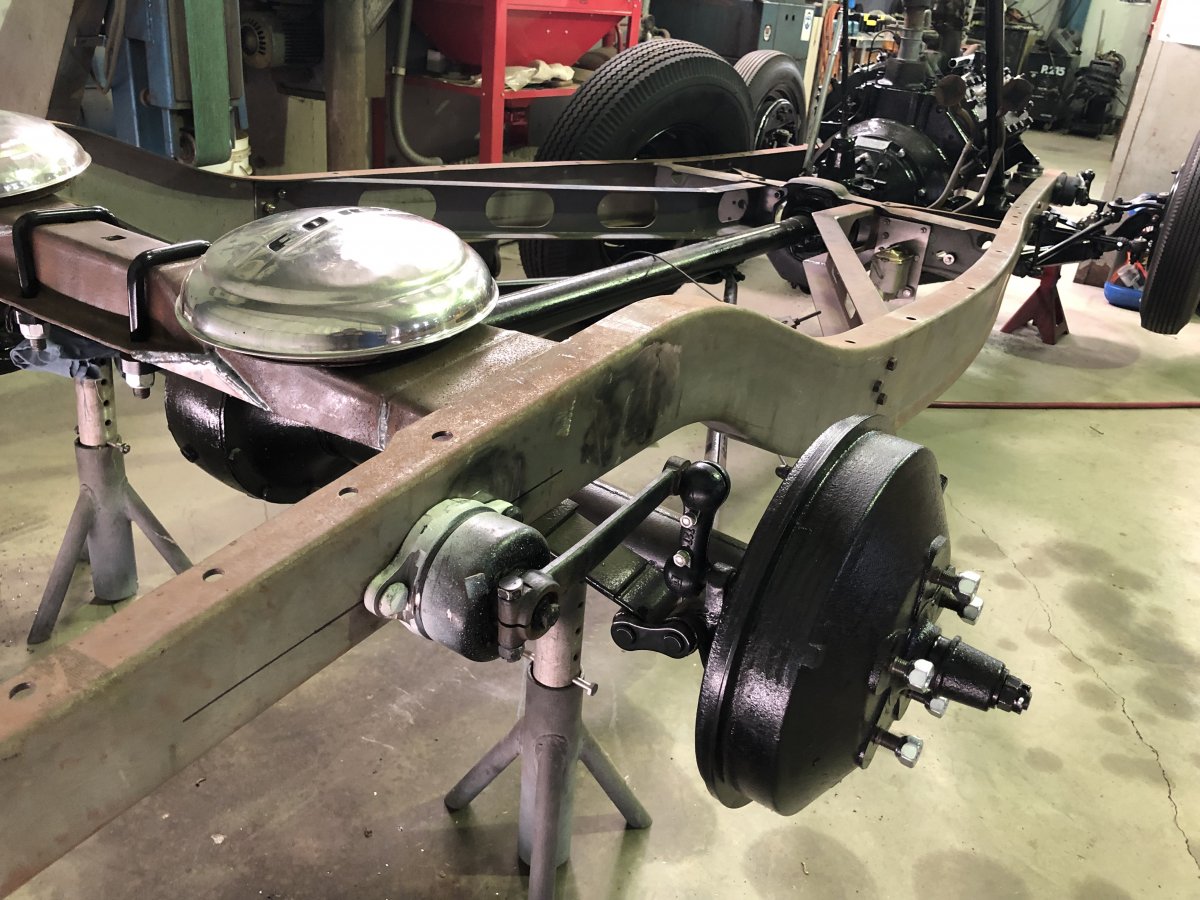

    I mounted my shocks today in the stock locations.
    410C2839-07FE-4C48-86B9-234BE9592283.jpeg 55B9A6C2-A303-4FEE-ACAB-3E4135ED7461.jpeg DB18F6A6-ABF9-4658-A860-8438C8400B84.jpeg
    Then painted them.
    And finished polishing my fuel pump stand to match in with my manifold.

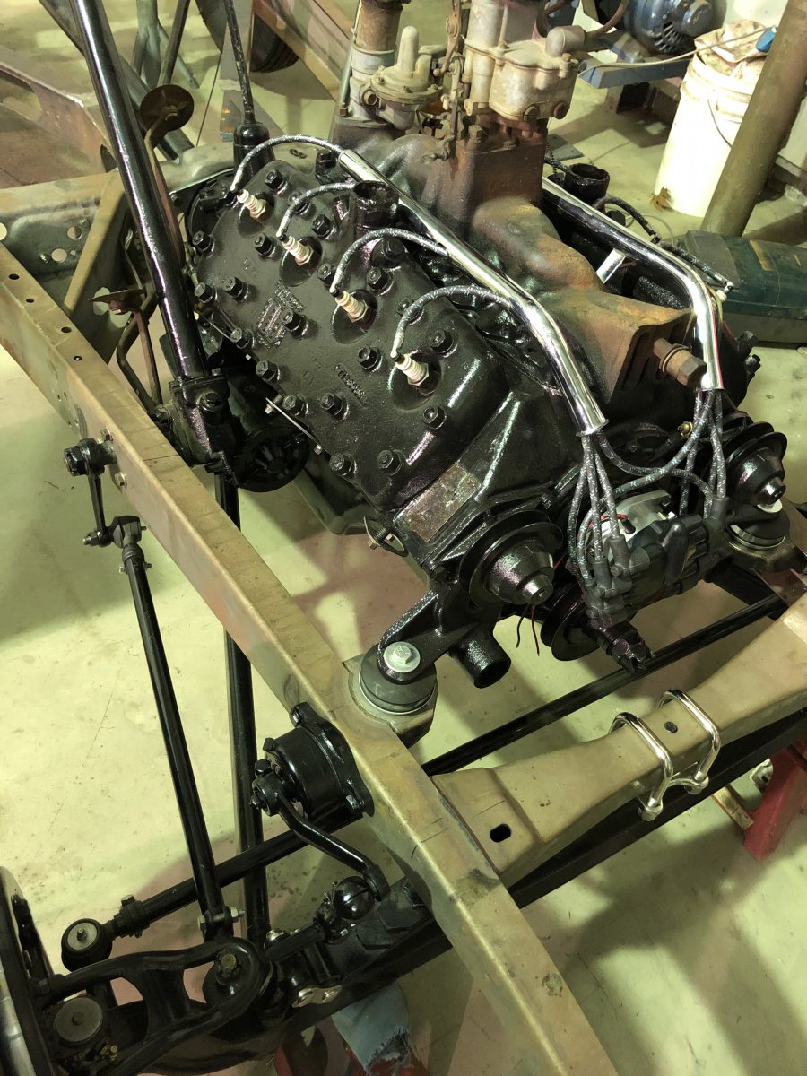

    I bought what I thought was all of the stuff I needed to make my brake lines yesterday. I ended up a few bits short so decided not to start on them.
    I bought a crimper during the week so I made my spark plug wires instead.

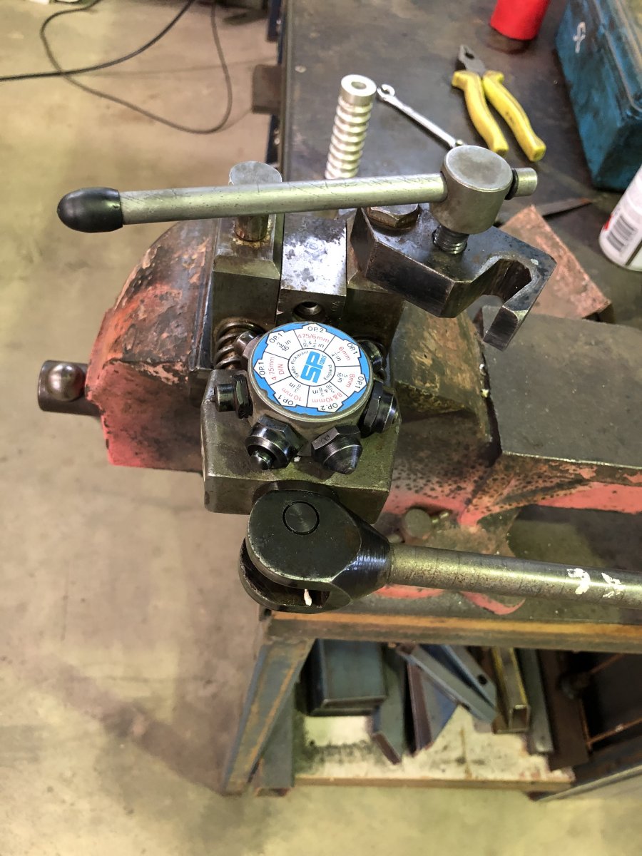

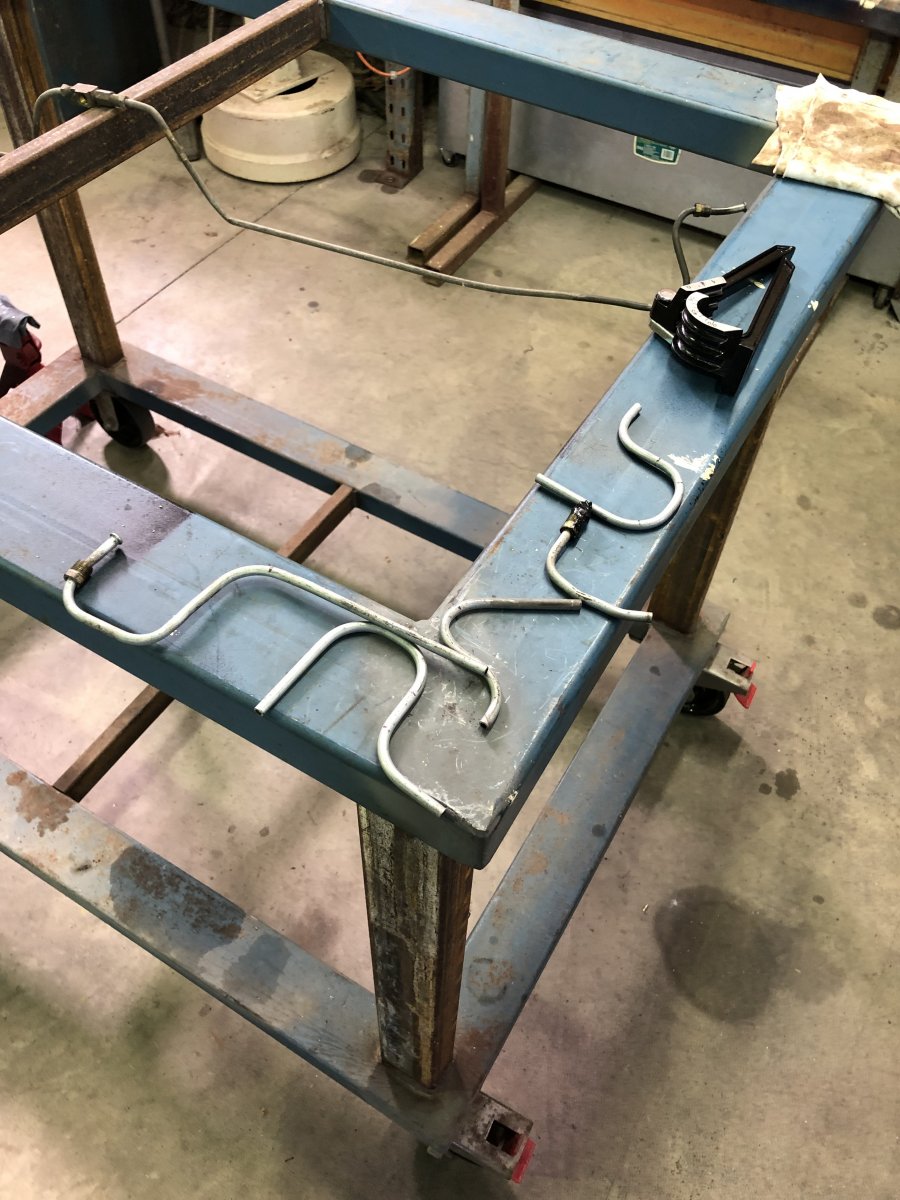

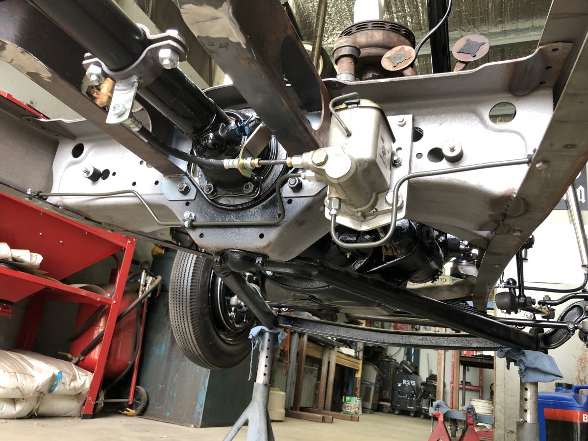

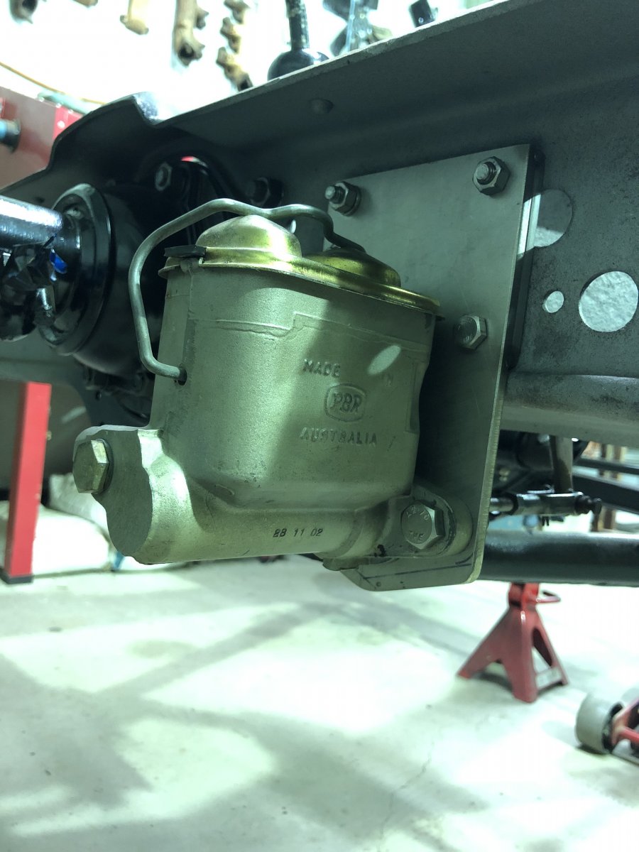

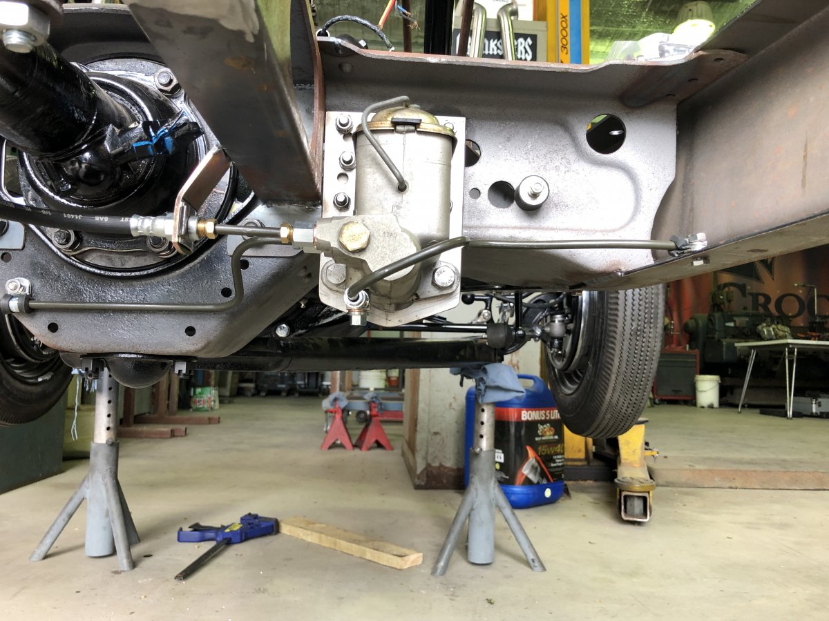

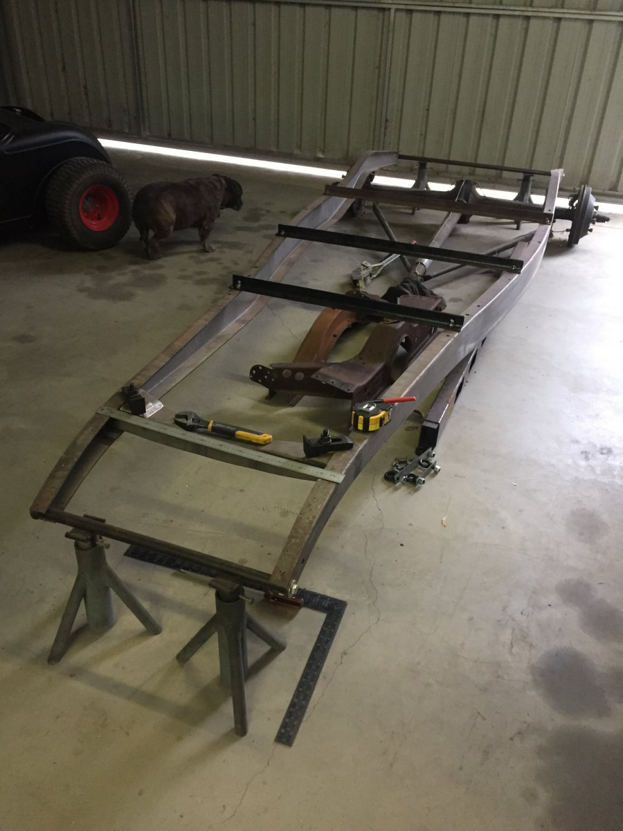

    I started on my brake lines this weekend.

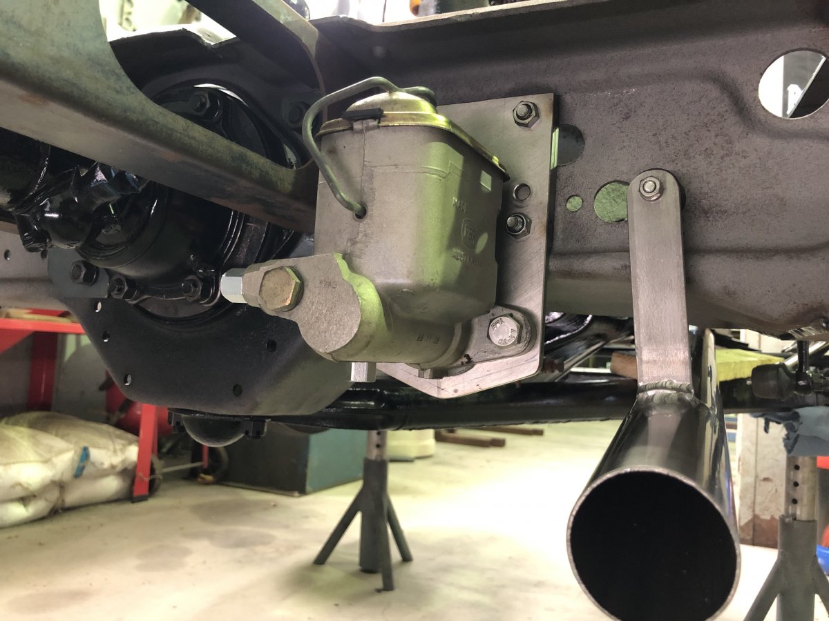

    I raised the master cylinder 3/4” because it has a port on the bottom.
    I did a heap of over thinking and test bends.
    A friend lent me his flare machine. Every flare comes out perfect, I love it.
    I got the front circuit done but didn’t take any photos. I also bought the studs and bolts I needed for my manifold.
    1947knuck, brEad, mgtstumpy and 6 others like this.
  24. Wardog
    Joined: Jan 12, 2010
    Posts: 2,463
    Wardog

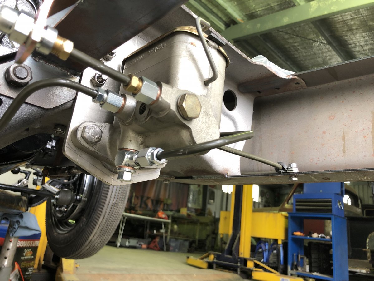

    This is where I’m up to. I need to make the rear circuit now.
    Having an unboxed frame I decided to run the front hoses through the rails. I tucked them up nice and close to the shocks to try to keep it neat and to not interfere with the engine mounts.

  25. alchemy
    Joined: Sep 27, 2002
    Posts: 23,467
    alchemy
    Can you find a banjo bolt for the bottom outlet of the master? Or at least a 90 degree fitting? It sure hangs down and seems like something will catch on it.
    Atwater Mike and rpm56 like this.
  26. Wardog
    Posts: 2,463
    Wardog
    With the combination of my bender and my buddies flaring machine that is as close as I can make the bend. You are 100 percent right though. I think I have gone back and looked at this 50 times in the last week wondering how to make it better. My solution was to keep productive elsewhere ( the rear circuit )and hope one day I have that light bulb moment where I figure out what to do.
    That’s it. Thank you, I’ll be shopping for a banjo now.
    1947knuck likes this.

    FYI, Alex Benica at Caloundra sheet metal (Q'ld) makes brushed S/S banjo bolts with tube nuts (45 degree flare, DOT approved and not AN 37 degree), I bought a couple for my 46 Olds. A quality product plus he's a car guy himself.
    www.caloundrasheetmetal.com.au

  28. Wardog
    Posts: 2,463
    Wardog
    Thanks for the reply’s and dm’s. I went back to the brake shop again today and now I’m all sorted.
    I didn’t even have to remake the line. Just a 15 degree bend and roll the tube 90 degrees.
    v8paul, Just Gary, 1947knuck and 9 others like this.

  30. Beanscoot
    Joined: May 14, 2008
    Posts: 3,864
    Beanscoot
    Pretty cool Australian aluminium master cylinder.
    But, gasp, do I see metric bolts here?:eek:
