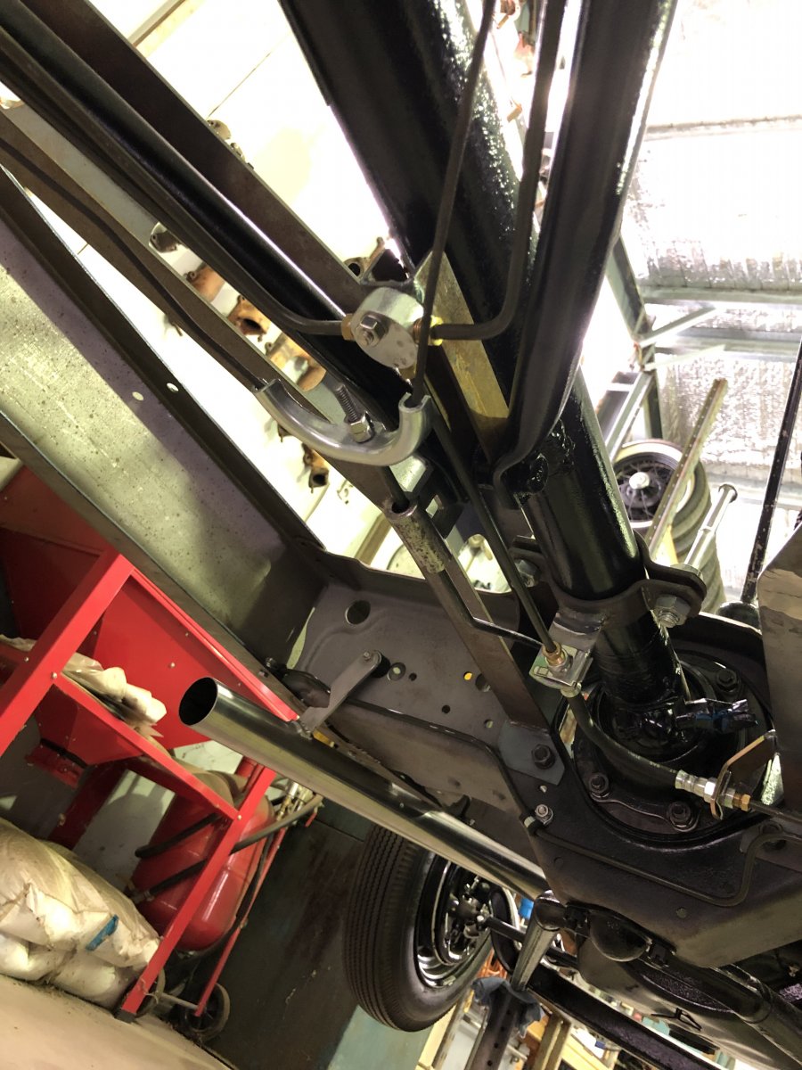

    Just a caution.... the exhaust hanger rubber bobbins need to be in compression and not shear.... they will tear apart otherwise... been there , done thatHope you don’t mind my interference.

    I had this in mind while mounting them. The exhaust is so short in reality they should be supported by the engine. These are more to stop the pipes flopping about. You are not interfering, I welcome opinions and different ideas.

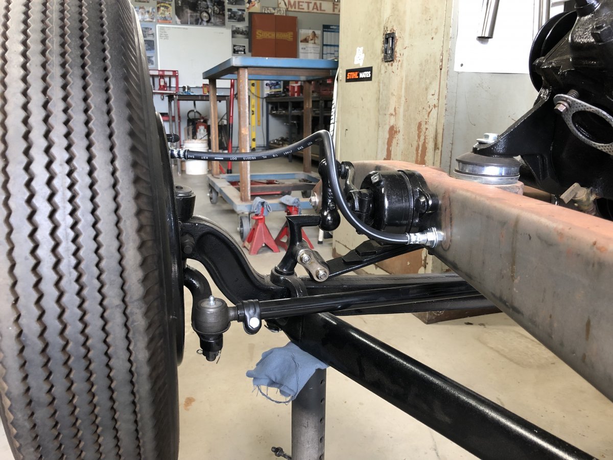

    I got a couple of hours to myself today and finished up the brake lines.
    9F0187A9-5EC7-4BFA-A4F1-34335B786E00.jpeg 5687A115-BB3B-44D8-9C26-F4CFFCBC64A7.jpeg 3923A46C-C119-4A16-8127-9A72FEF4E74C.jpeg 22AA455A-2EDD-4C24-84A9-61FE3C6602B3.jpeg

    I have slight concern about solid brake lines mounted to suspension arm that will have small movement. Over time metal fatigue will brake or can it even lead to loosen fitting at distribution block. Or maybe not seeing it properly?

    In his 3rd pic you will see the brake hose from the torque tube bracket to the frame.Ford in '39 introduced the hydraulic brakes and their factory set up is similar, a br*** distribution block was bolted to the torque tube and had a flexible hose to the frame .The other 2 lines went down the radius rods to the backing plate.

    Nice ideas for when I tackle the brake line job. However, I'm a little concerned that the front left line could catch on something. I suggest that you move the clamp over about an inch on the K member and then angle that left line up so it is protected by the K member, if you get my meaning.

    3rd pic is what bothered me saw frame to left looked like attached to “u” piece holding distribution block. but now closer look at 4th pic can see as u discribe & all attached to torque tube - ignore my concern

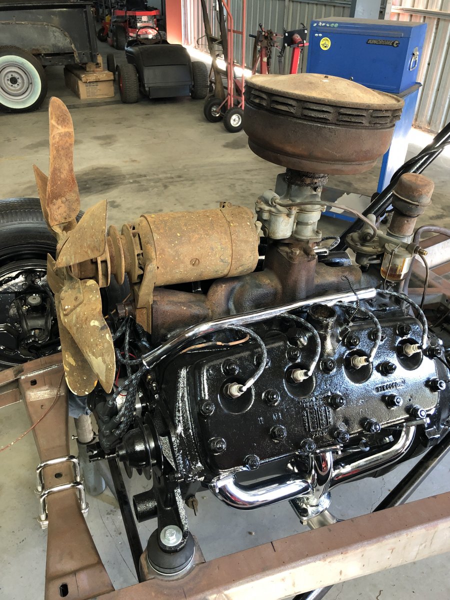

    I got my headers back today.
    AE814B8F-5EDB-40FA-A329-627655614DF7.jpeg 776150EE-29EE-4220-84AA-BBD2C844AD30.jpeg 955687CB-F7BE-4E88-A2F1-9E31FE656902.jpeg 716524ED-7FAA-4C4D-9D7B-2CF48B8FD2A7.jpeg

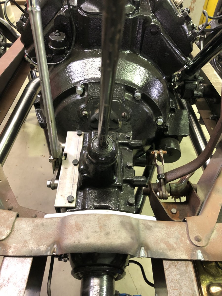

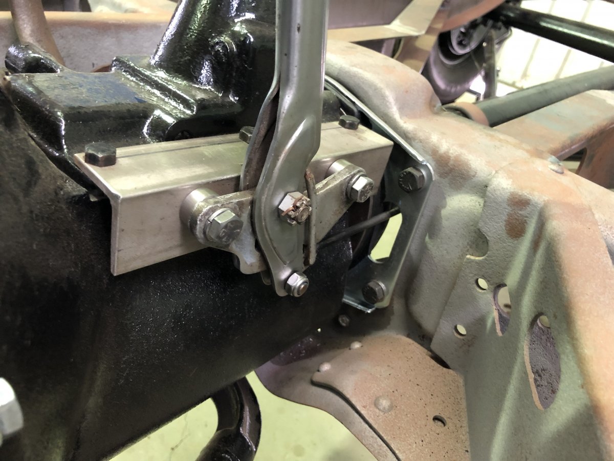

    I got the park brake working. I changed sides on the shift tower for right hand drive. I made a 1/4” rod linkage with a guide on the torque tube. I used a cable bracket from a 70’s falcon.
    A4816F19-60FD-4600-A947-A89A6E68D41F.jpeg CC06D146-61FA-43B1-8468-FE266ECDCFFD.jpeg FF7BE2A2-CDC4-4415-90F7-7FC7501C5E85.jpeg 3101487F-7400-44F8-91EA-DF45207F796B.jpeg

    Nice job with the emergency brake. I think that natural leather will age beautifully, too!

    The 1/4 rod will stretch [try to straiten out] after a few E brake applications may or may not take a set and stay with out any problems just be ready for early adjustments..

    It was trying to straighten. Until I added the guide at the torque tube. I put enough thread on it for some adjustment.

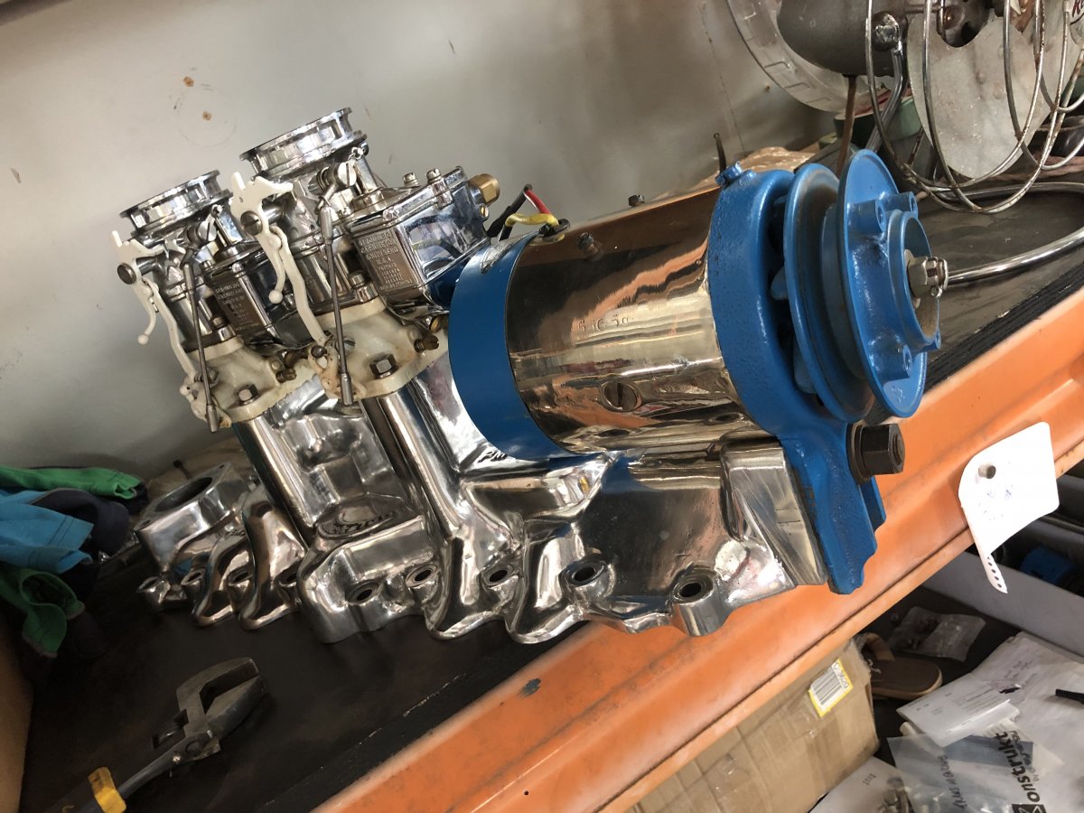

    One thing I’m happy I’ve sorted out is the generator. A couple of weeks ago a mate sent me the only generator he had with the mount that sits it central on the manifold. It ended up being a truck generator that was too long to work.
    So this weekend another mate of mine let this one go from he’s personal collection of old chrome. He is also the same guy that sold me the carburettors. It fits and has been rebuilt and converted to 12v. All the white and blue will be painted black.
