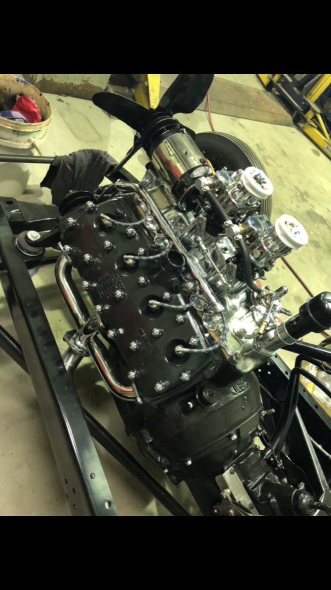

    So I fired my engine up this week. It’s the first time in the frame , with pipes and with the stromberg e fire ignition. My wife took a cool video on her phone but I can’t post it. I took this screen shot of the moment I hit the starter cable on the jumper cables.

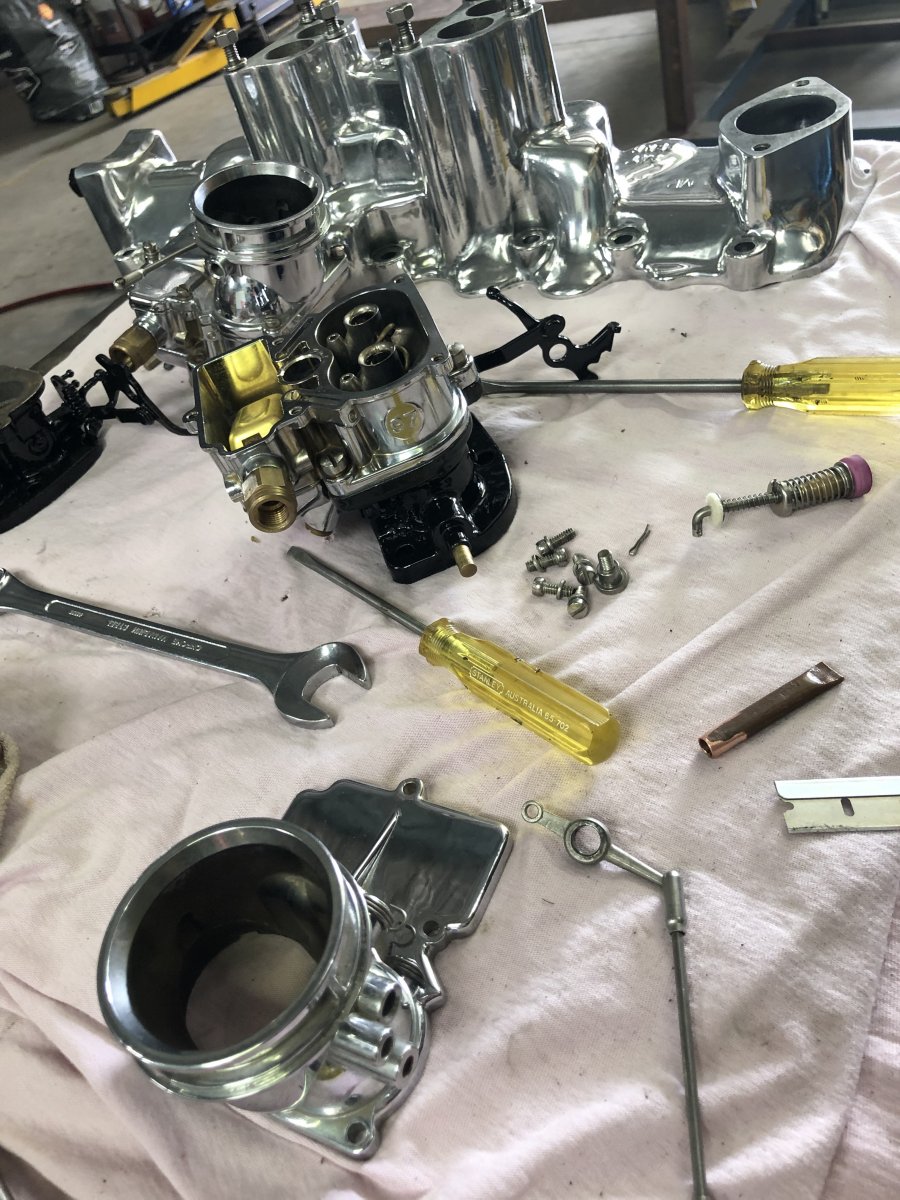

    Last weekend I painted the throttle body’s, generator and fan. Yesterday I had an afternoon to myself so I went through the carbs and ***embled it all. Now I need to sort a linkage and a fuel line from the pump to the carbs. FD01A822-0DFB-4EFC-951A-C6E2A3A6A81C.jpeg CEBEA876-494F-4FC9-9ACF-28422AE7C359.jpeg 10688003-4A63-4349-AD29-FBDF31216F1B.jpeg

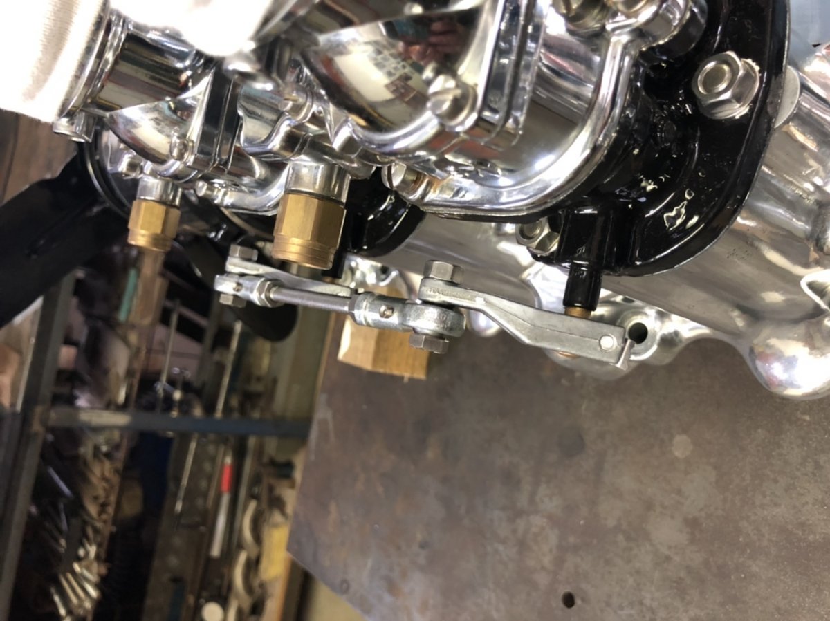

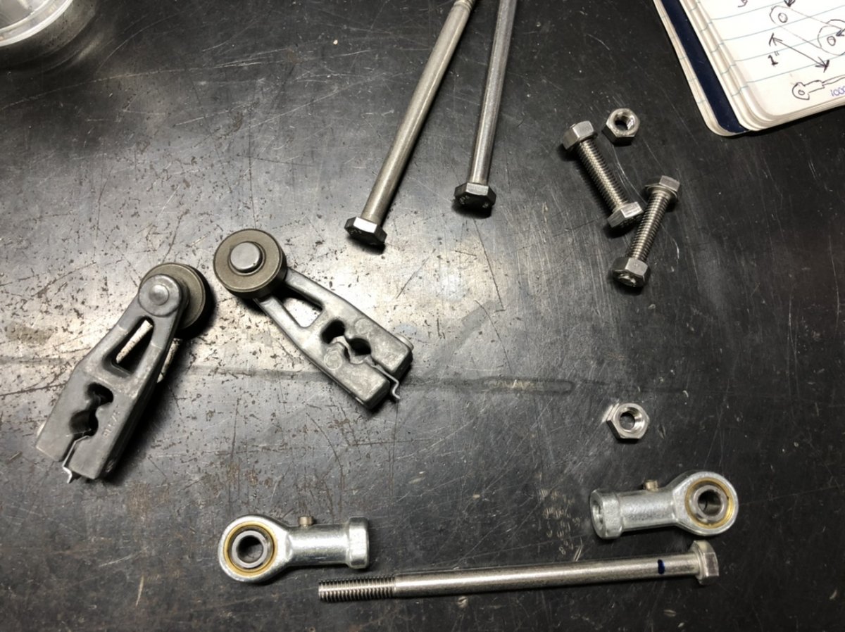

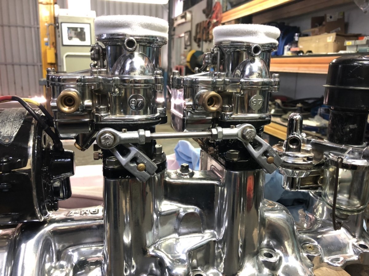

    I made a 2 carb linkage. The clamp on arms are from micro switches we use at work. They fit perfectly and seem to work well. I’m happy with the result.

    @Wardog it looks and sounds fantastic...as a Hotrod should...and nice balance of shiny here and there just sets the Tone and the Flavour...

    There's nothing that says hot rod more than a Stromberg...….except two of them......IN CHROME! Dang, man...

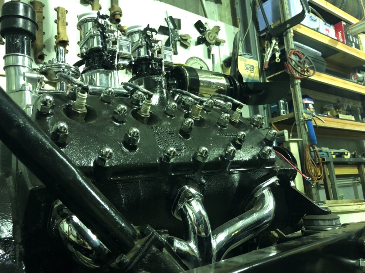

    Tonight I got my manifold and head nut covers on after setting up a fuel line and moving my carb linkage to clear it.

    What was your reasoning for removing the choke plates? I've read thoughts from Stromberg experts that say the air flows better through the carb with the plates in there. Even if they are never used as intended for chokes.

    I’ve read the same things. Although the carburettors are new I bought them second hand from a friend and they had no choke plates or shafts in them. I put 1/4” bolts through the bosses with fibre washers on the outsides so when I have air cleaners on I don’t have an unfiltered path below. If I have trouble I might put choke shafts and plates in but I’ll wait and see how they run first.

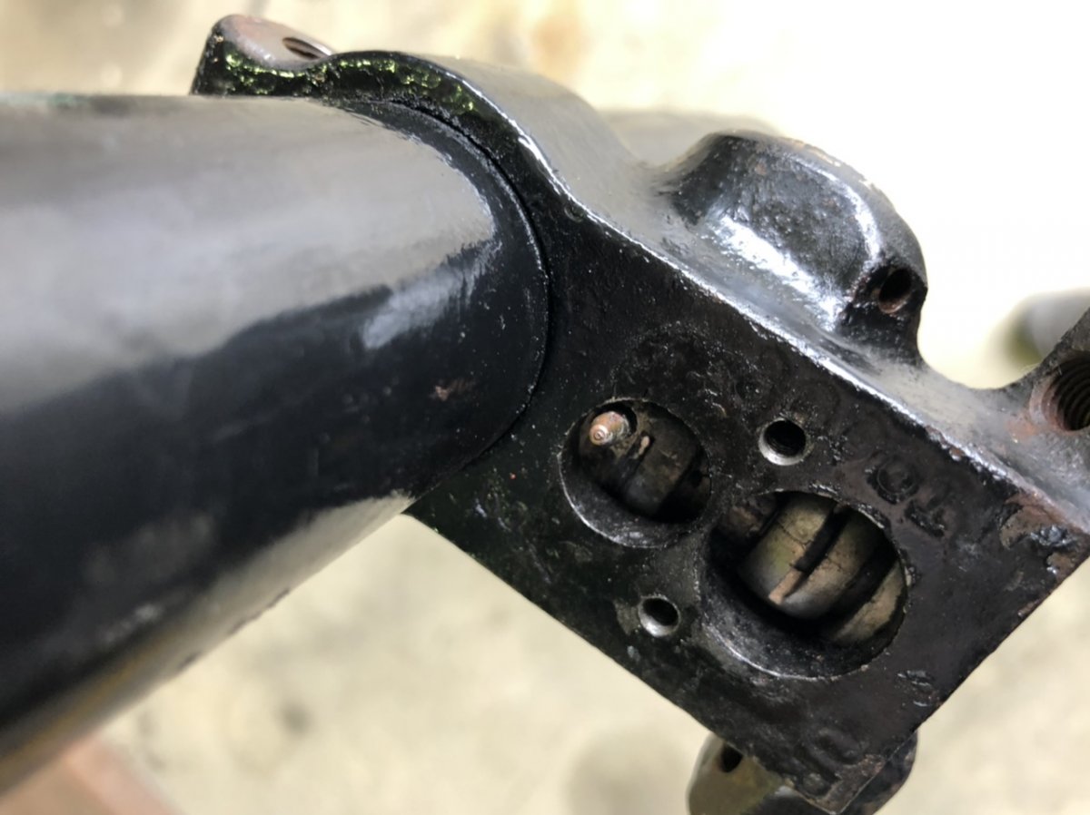

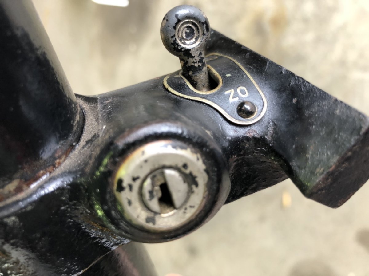

    Anyone who can help please do.
    The barrel in this ignition lock seems to be in great condition..... but I don’t have the key.
    I have some new Hurd key blanks but a locksmith I had look at it wants the barrel out to cut the keys for it. I hoped he could pick it but he didn’t even think he could. The ignition switch is in great condition as well but is locked by the barrel. I’d like to be able to use all of this the way it was intended. Has anyone got a tip for me?

  26. If i remember correctly Bruce Lancaster once wrote that the key number was inside on the barrel. I believe that little pinhole is the secret.

    Thanks @34 GAZ ill check it out.
    I ***umed that hole would be to remove the barrel if I ever got it to turn.

    I think you should try another locksmith. I am under the impression its a one sided key. My Buddys Dad was a Locksmith and used to pick locks with them on occasion. I can't imagine it being to difficult as it's quite primitive...I'd do it for free but it's a 20+hr plane ride...:D I take it you have sprayed lubricant in there to free all the pins and springs and if the lock is free in the hole as in can rotate you should be good
    Once the lock is out you can hand file the key to level the pins and Bobs your Uncle...:confused:...Maybe...:D

    Not sure what year your column is but heres a couple of threads that may help...
    sorry if this is incorrect to your application...
    https://www.fordbarn.com/forum/showthread.php?t=15585&highlight=Ford+ignition+lock
    :rolleyes:...a post in Fordbarn by the late **** Spadaro...If you Login using your Hamb Login the pics show up...there is a 1/4 in splined pin at least there is in this column...
    http://www.vanpeltsales.com/FH_web/1939ford-project-restoration-10.htm
    :rolleyes:...another tutorial...there is a 1/4 in splined pin at least there is in this column...this fella drilled it right out whereas Spadaro's method shown the pin is drilled tapped bolted and pried out...which is preferable.

    There's lots of cheap lock pick sets on ebay you could also try if you have no competent Locksmith handy.
