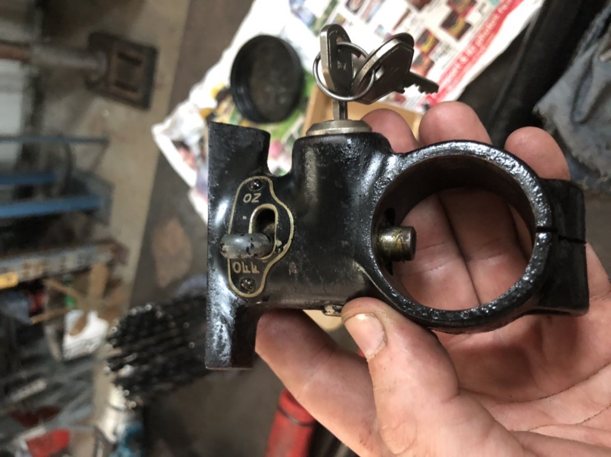

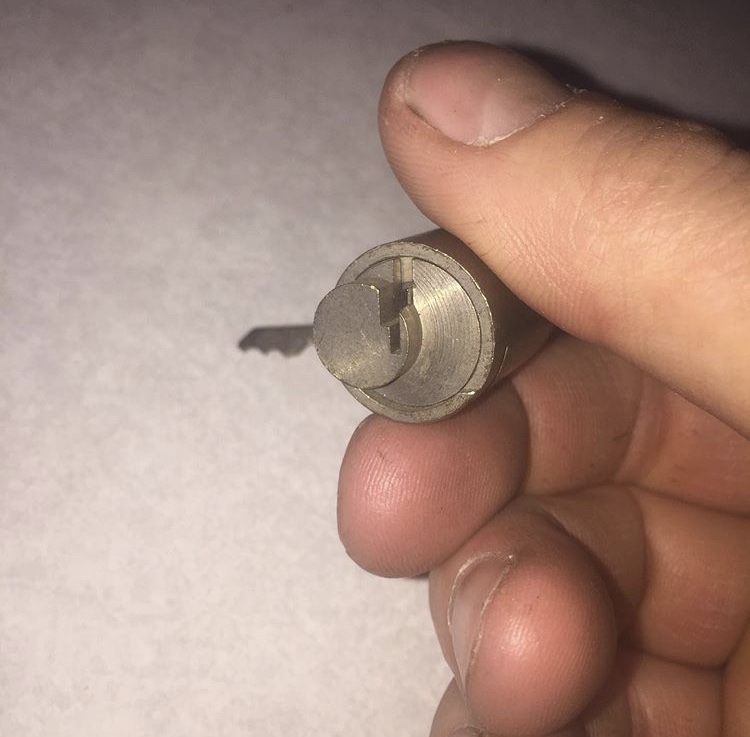

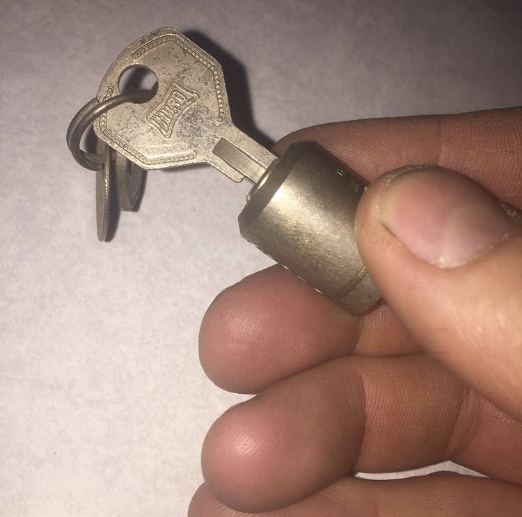

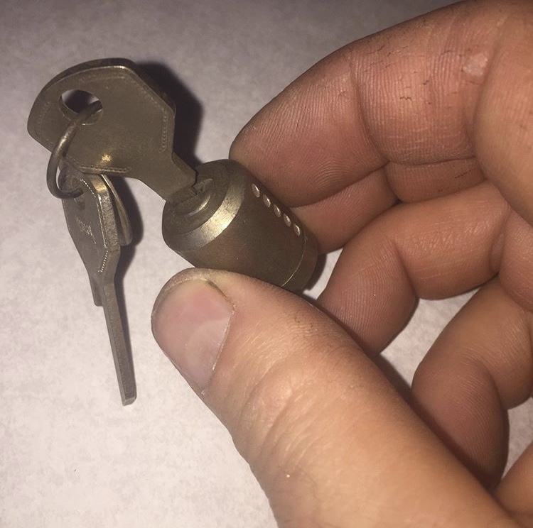

    Yesterday I stumbled upon this.
    New old stock 32 to 34 barrel with keys.
    Now I can drill the retaining pin out to remove the barrel with a bit less stress.

    @Stogy they are the sellers photos. I still have to wait for it to turn up. When it does that will be the first thing I try. If id doesn’t work then I’ll move on to removing the barrel the way it was done in the threads you posted links to.
    1947knuck, chryslerfan55 and Stogy like this.
  8. Wardog
    Joined: Jan 12, 2010
    Posts: 2,463
    Wardog

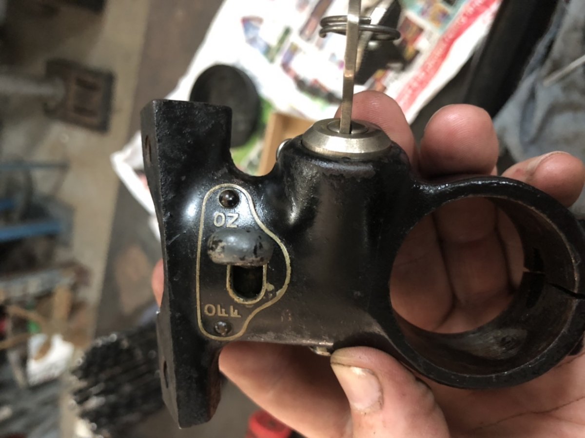

    So the keys didn’t work in the old barrel. But I swapped the locks over and it all works E854CA7F-0602-4B5E-9AF7-D76F817E466A.jpeg 8F91720F-3BB5-4264-AC28-D99FAA5F2F68.jpeg

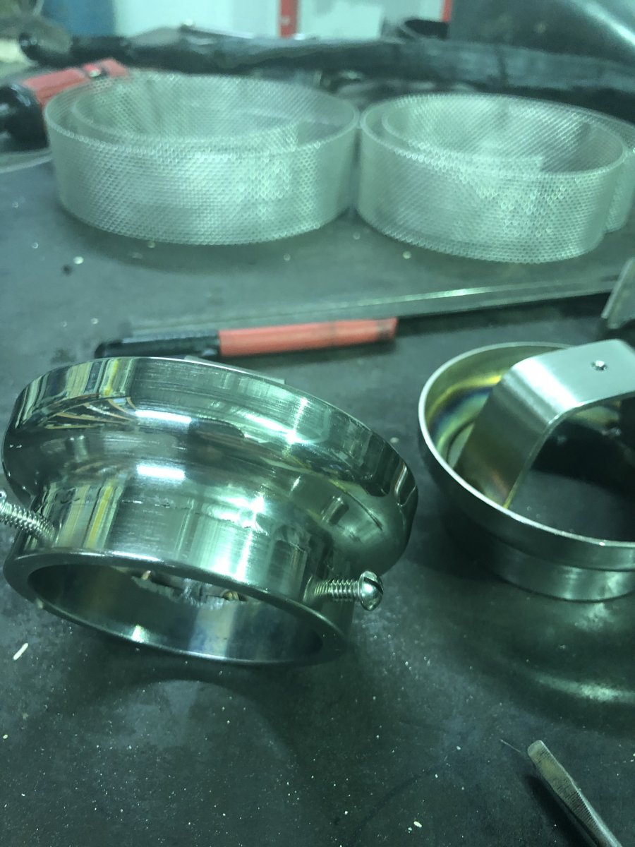

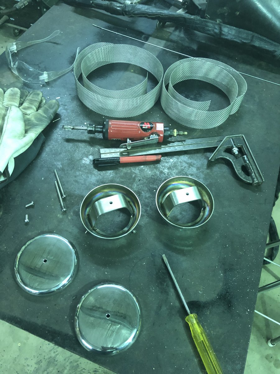

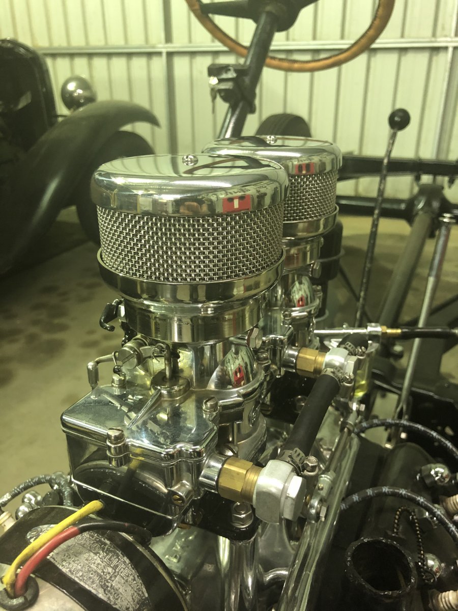

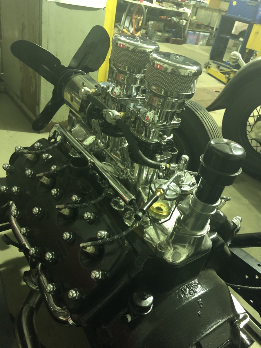

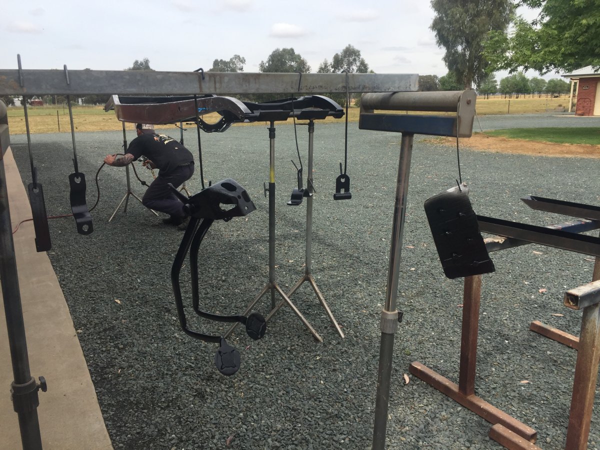

    Probably a distraction from what I should of been working on but a job done none the less. I have been obsessing over air cleaners for months. I got so confused over what I wanted and what would suit I decided to make my own. I’m pretty happy with the results.

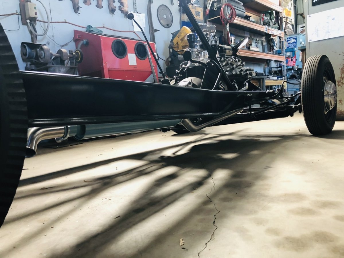

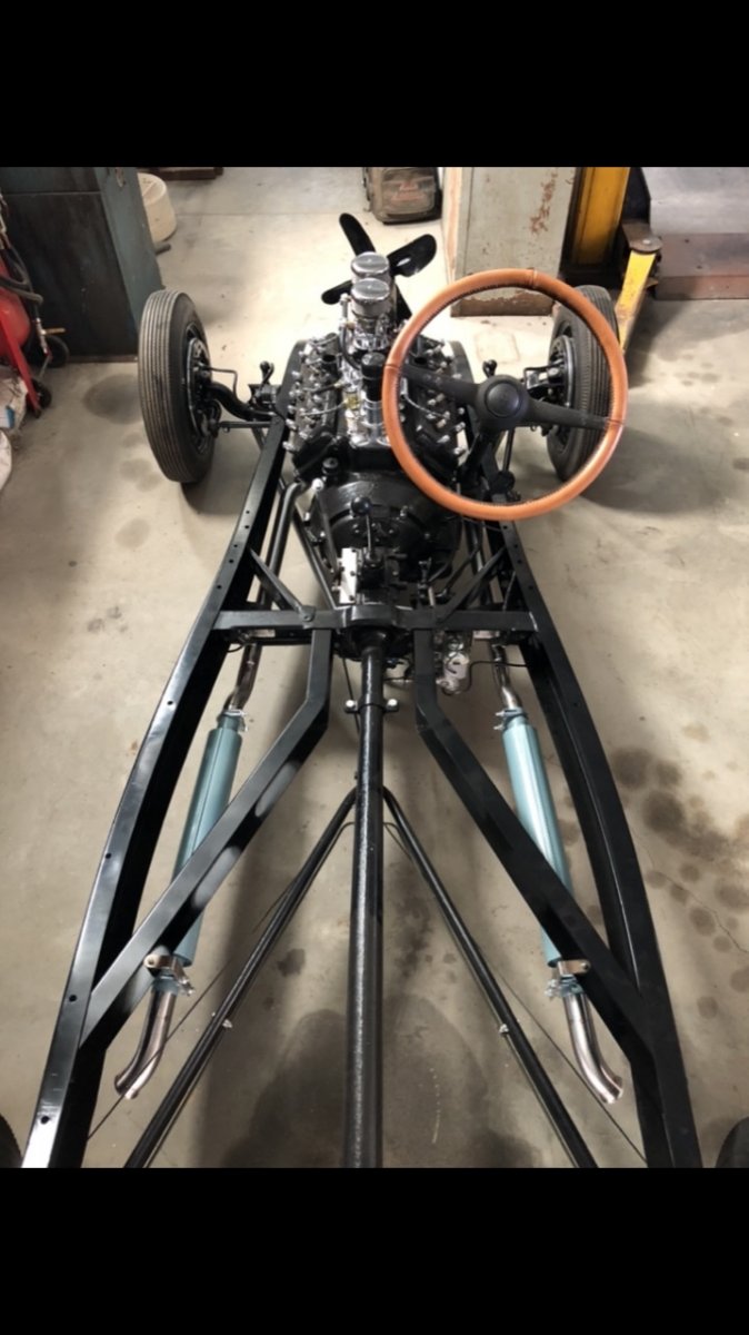

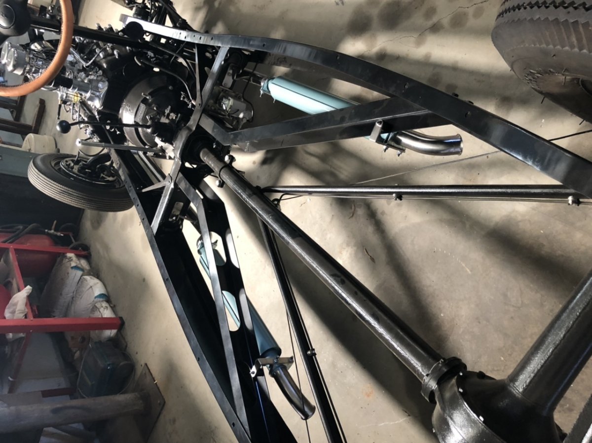

    Friday night I got the rest of the exhaust tacked up.
    D5C49B46-330B-4B44-97F9-756E033DD859.jpeg 484310E2-35D9-43C3-A955-8246ACB60752.jpeg 098F07D4-C1ED-44FD-83A0-9F04A0D7DA41.jpg

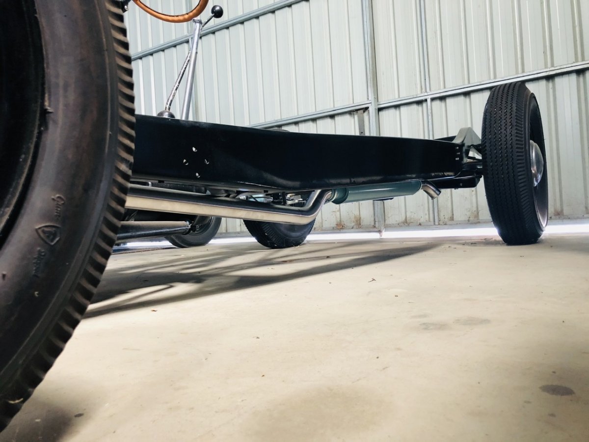

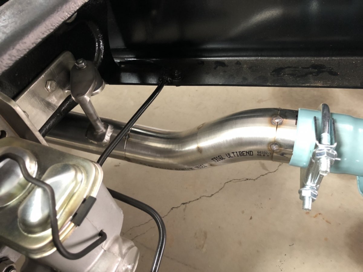

    Last week I lifted the rear of the mufflers 1” and welded everything out.
    I had a weekend away with the family visiting old friends.
    Today I finished polishing and installed everything. I ended up shortening the tailpipe sections 1” for clearance near the park brake cable.
    I’m a lot happier with how the mufflers sit now.
    DA4AE5D4-D352-4E0F-AE33-2327B6A4AB6A.jpeg 7B4A65E8-CF61-41C4-93F7-30ADC5313E28.jpeg 8D36E3EC-90FD-4780-A657-C2D305666469.jpeg

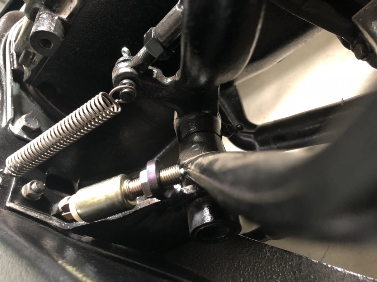

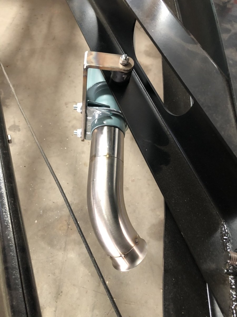

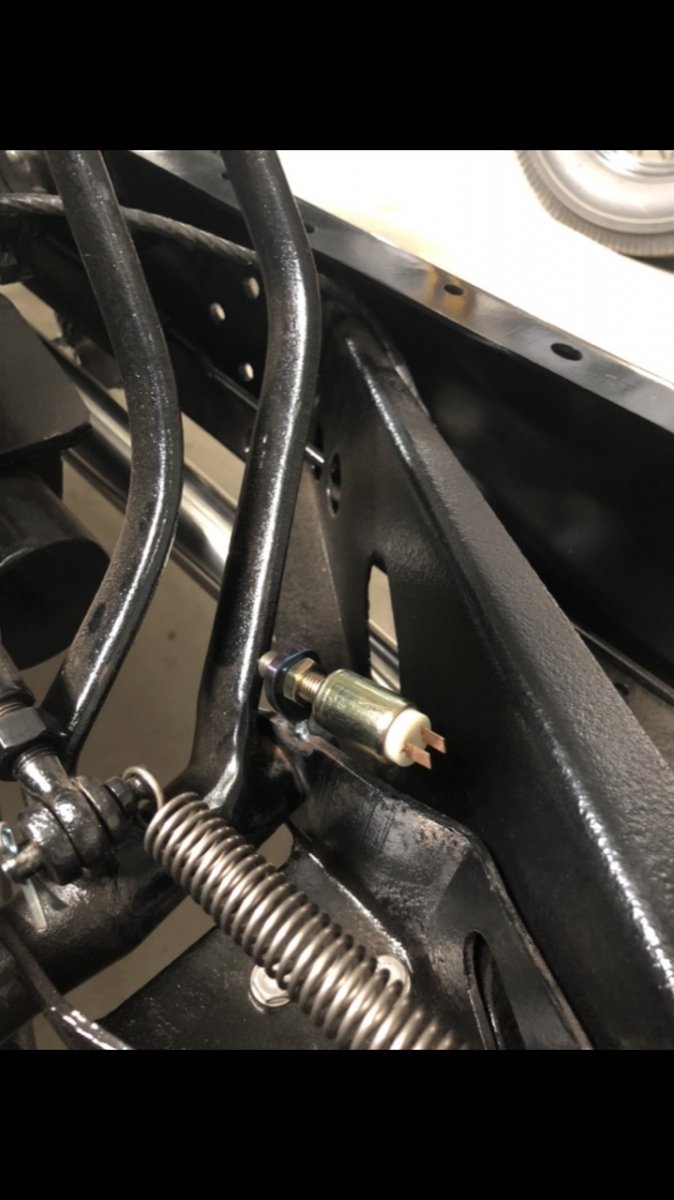

    Today I mounted a mechanical brake light switch directly to the pedal box that actuates off the pedal.
    6A39ADAE-C2FA-45F1-A1D6-103F07630C83.jpeg 91BD9060-EE57-49FB-BD46-F628F032A4D0.jpg

  24. Looking mint! Nice and tidy way of incorporating the brake switch.

    Josh the switch mount didn’t have to be anything more than what it is, it also doubles as a stopper until the floors are installed.

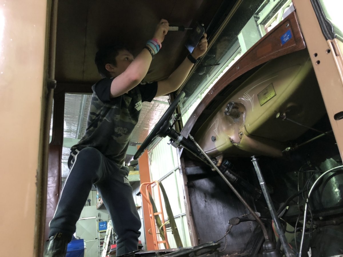

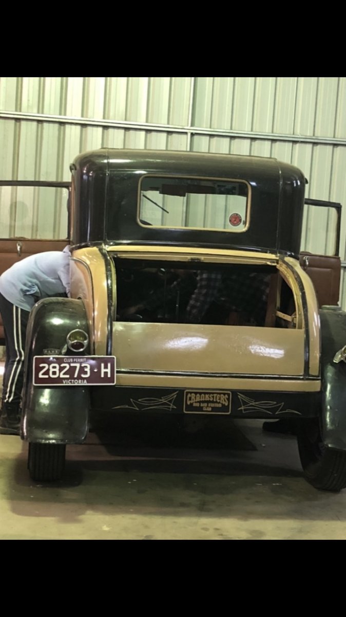

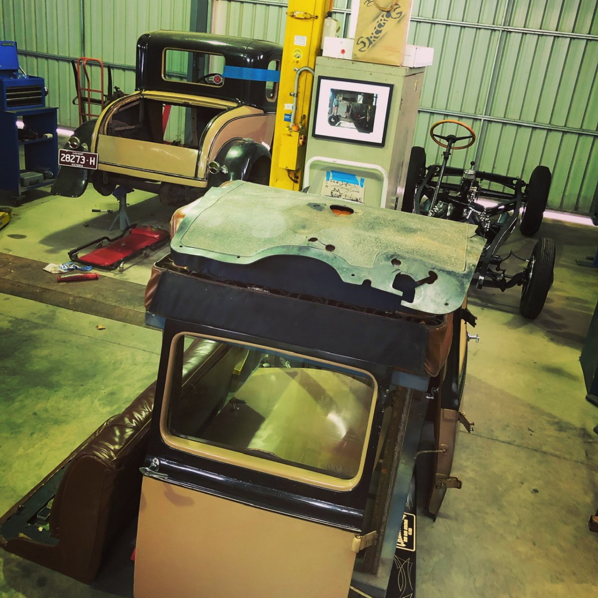

    This weekend I started to pull the coupe apart.
    508651DF-2E3F-4E7B-9C17-A9B4DA62AA84.jpeg 159CA157-78A5-40BD-85BB-14E04E55347A.jpeg F5B65A17-E174-4333-9D76-B24146319D95.jpg
