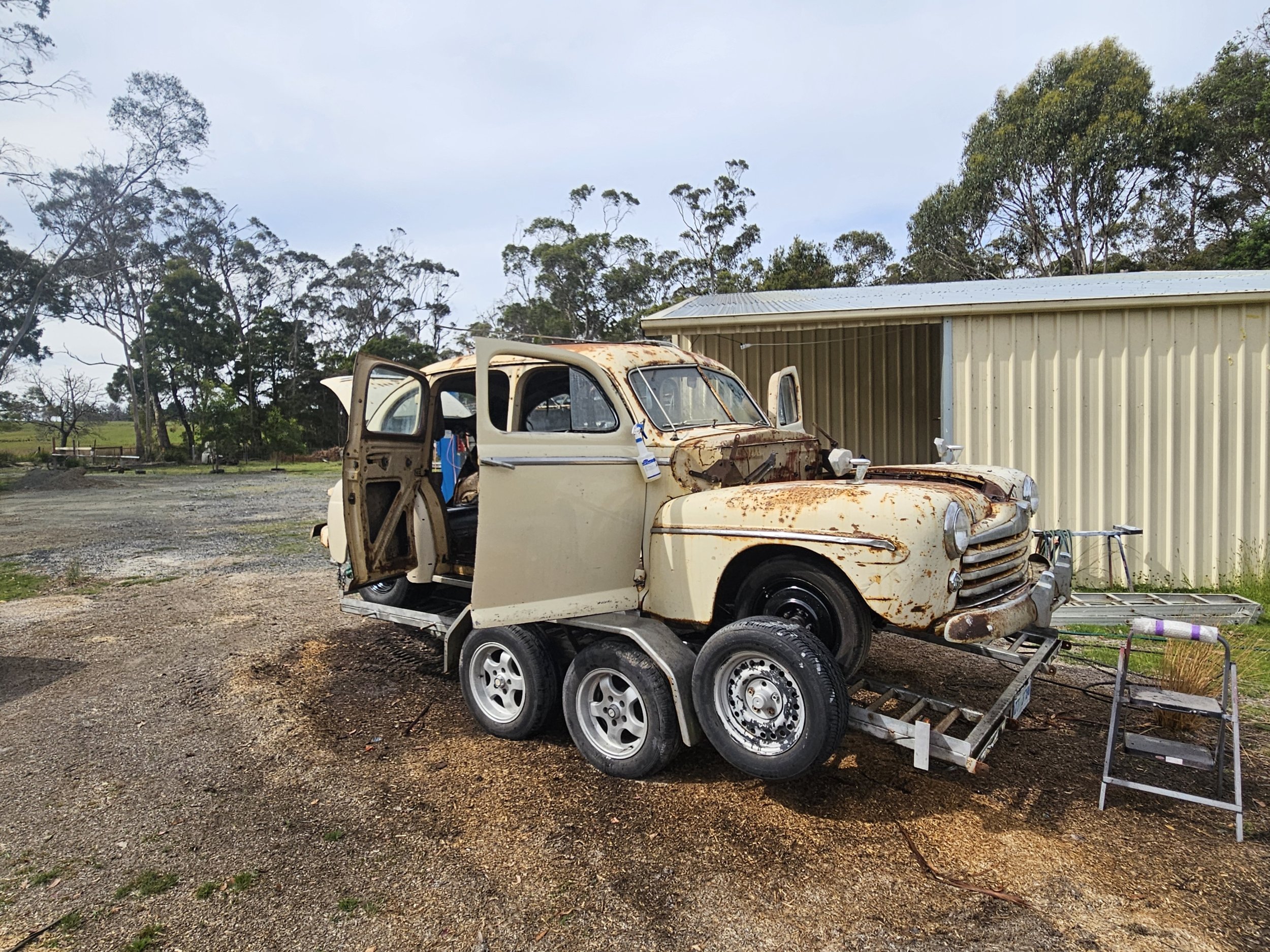

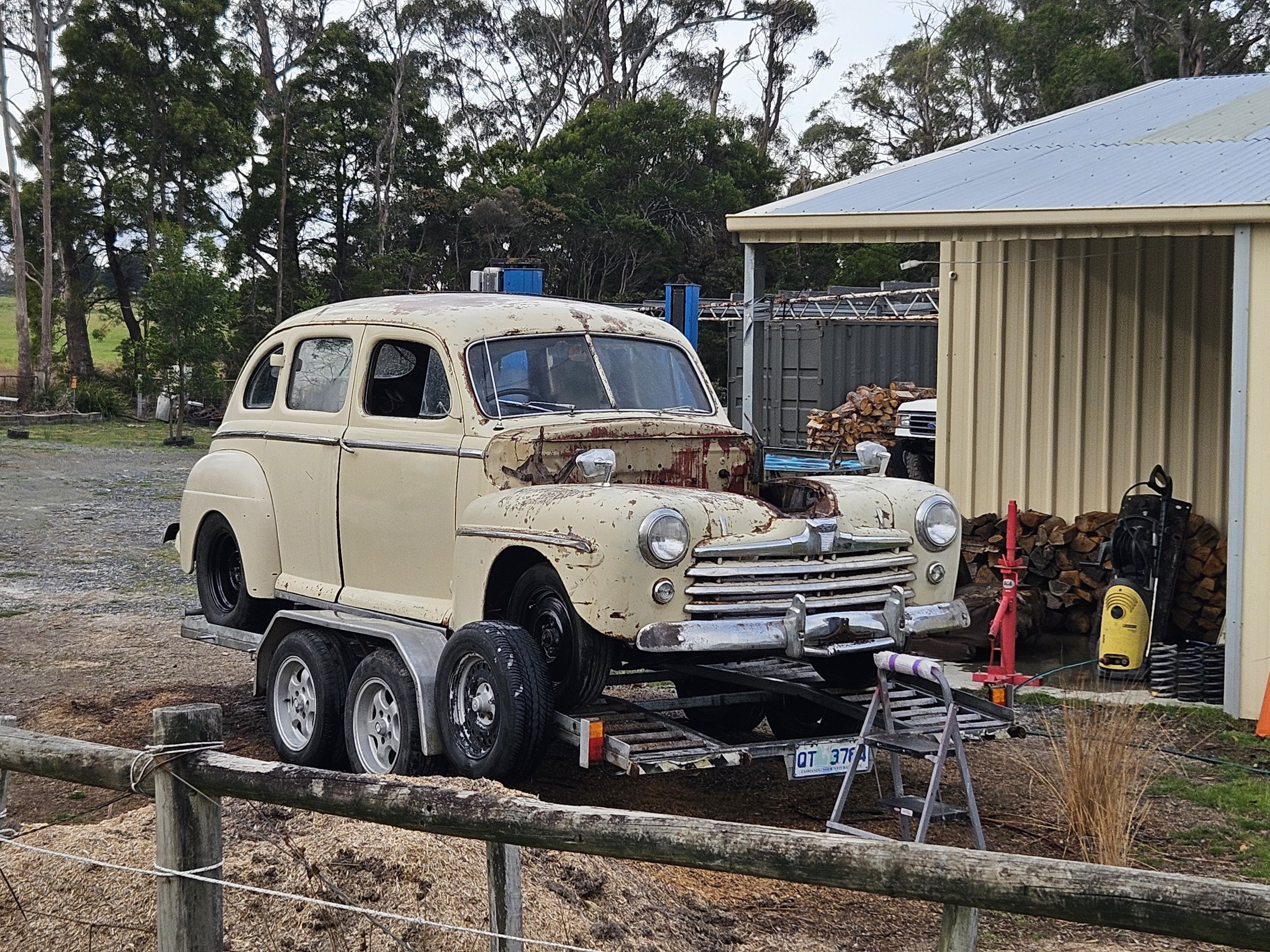

    Found this 48 ford sedan local to me on market place.
    Story went, it was used as a parts car, before the seller purchased it with the intention to restore it in 1981. It moved around various sheds, before he decided, around this time last year he wasn't going to get to it, so listed it for sale.
    20230825_112405.jpg I had a look, made an offer, and had myself a new project
    Hooked the trailer upto my trusty falcon ute, and hauled the 48 home
    Given the modifications, I believe it may have been used for some type of rally events sometime in the 50s,60s or 70s.
    Large Mud flaps, radiused rear fenders, evidence of a bullbar and extra front lighting, and an external on off switch/ kill switch.

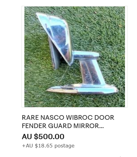

  11. Since your cleanup i just noticed those cool fender mirrors. They sure look like NASCO accessory mirrors that were available for the 1957 FC-FE Holden up to the 1967 HR Holden. I just did a quick search, i see pocket money :D
    Screenshot 2024-11-25 at 22-37-26 Original Nasco RH Side Mirror Suit Early Holden EH.png
    GTHOtrod and Outback like this.
