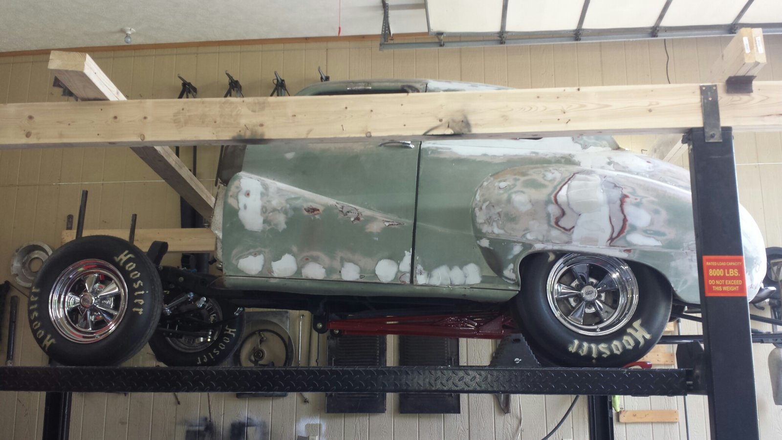

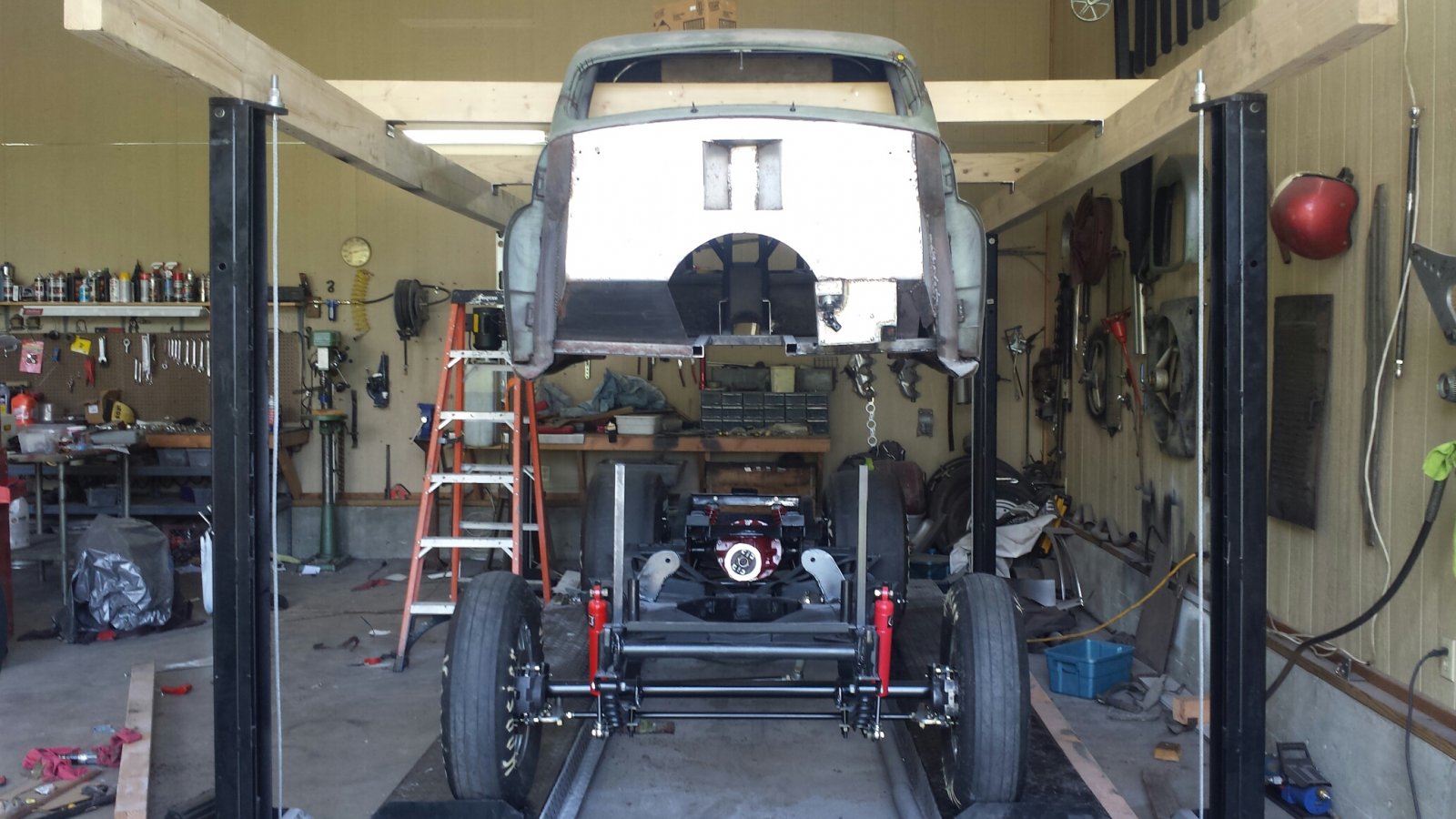

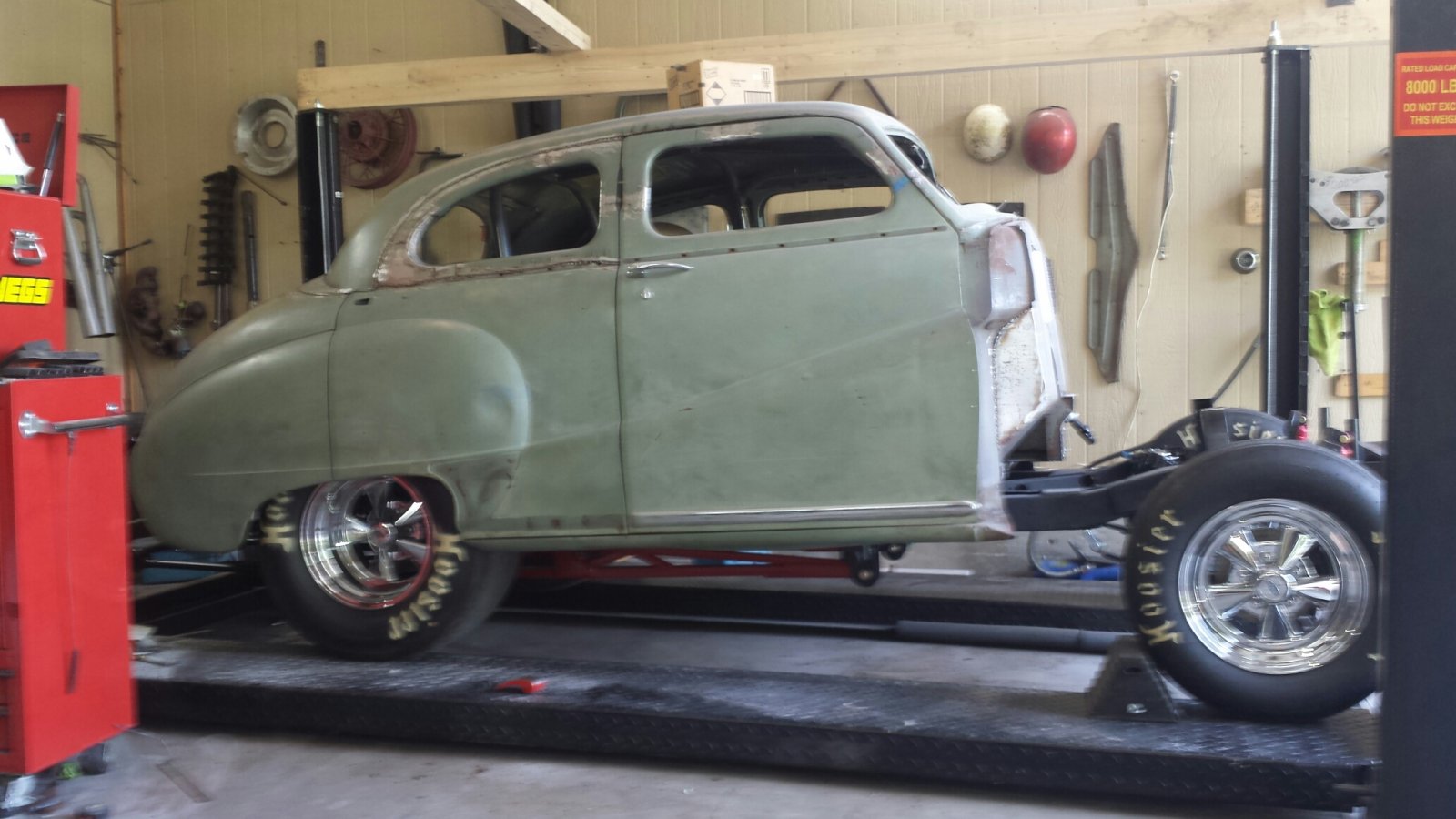

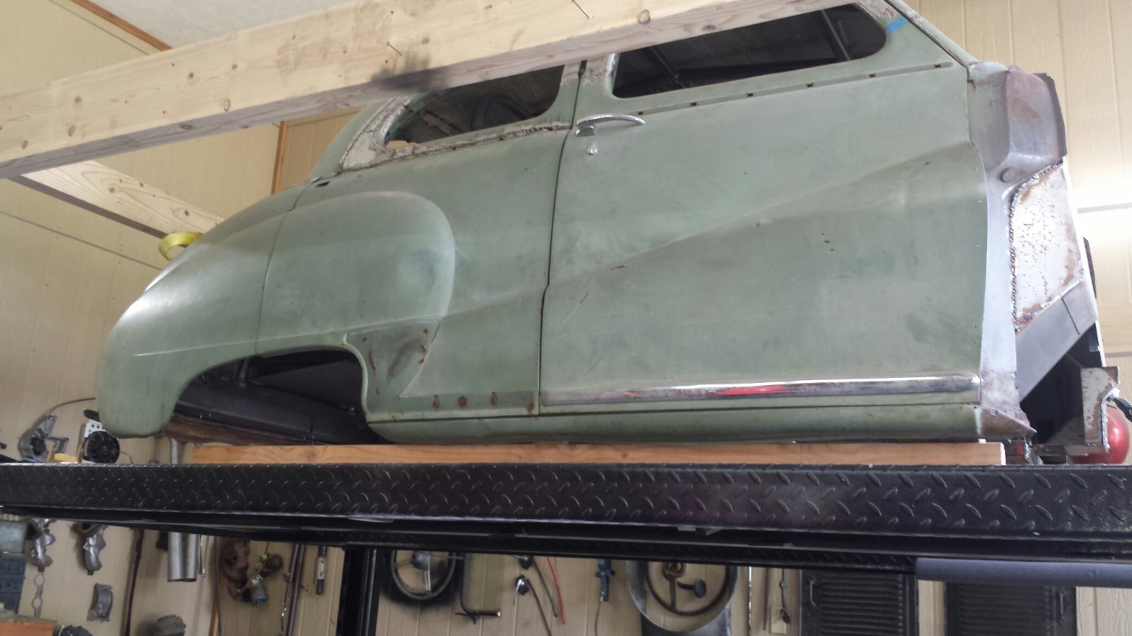

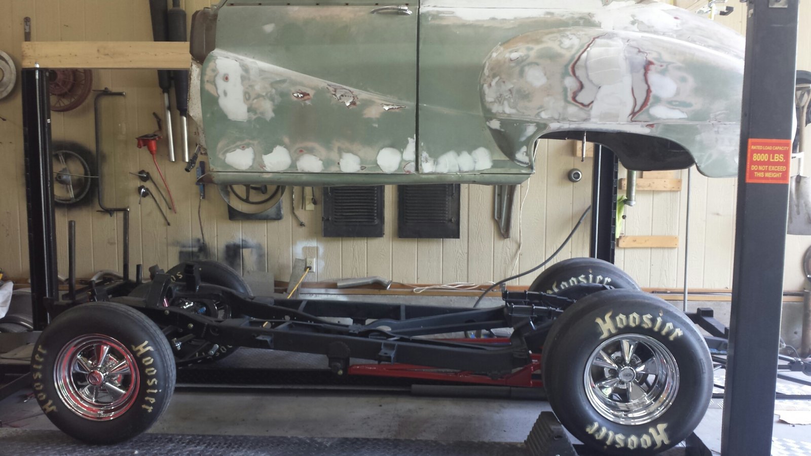

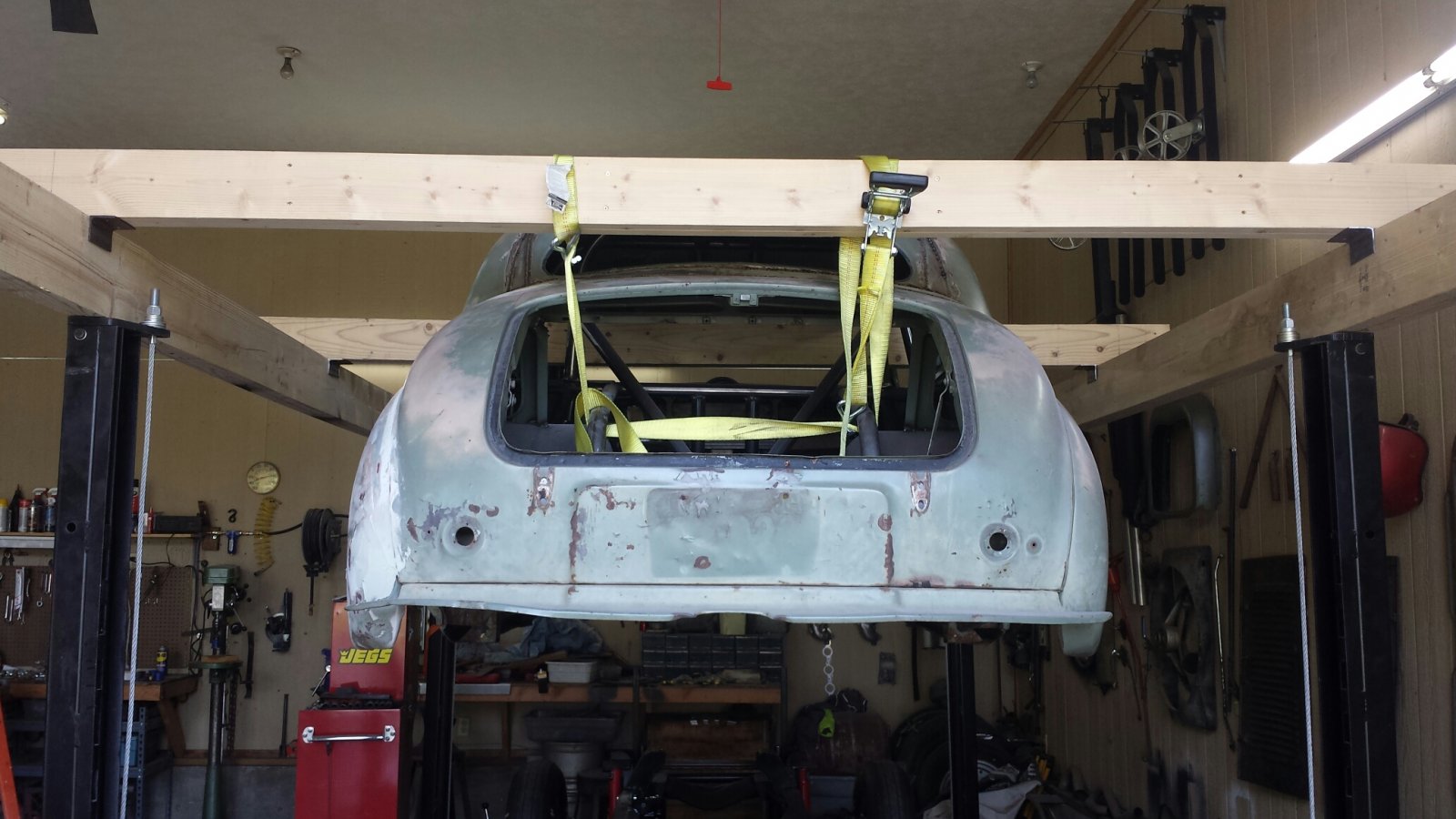

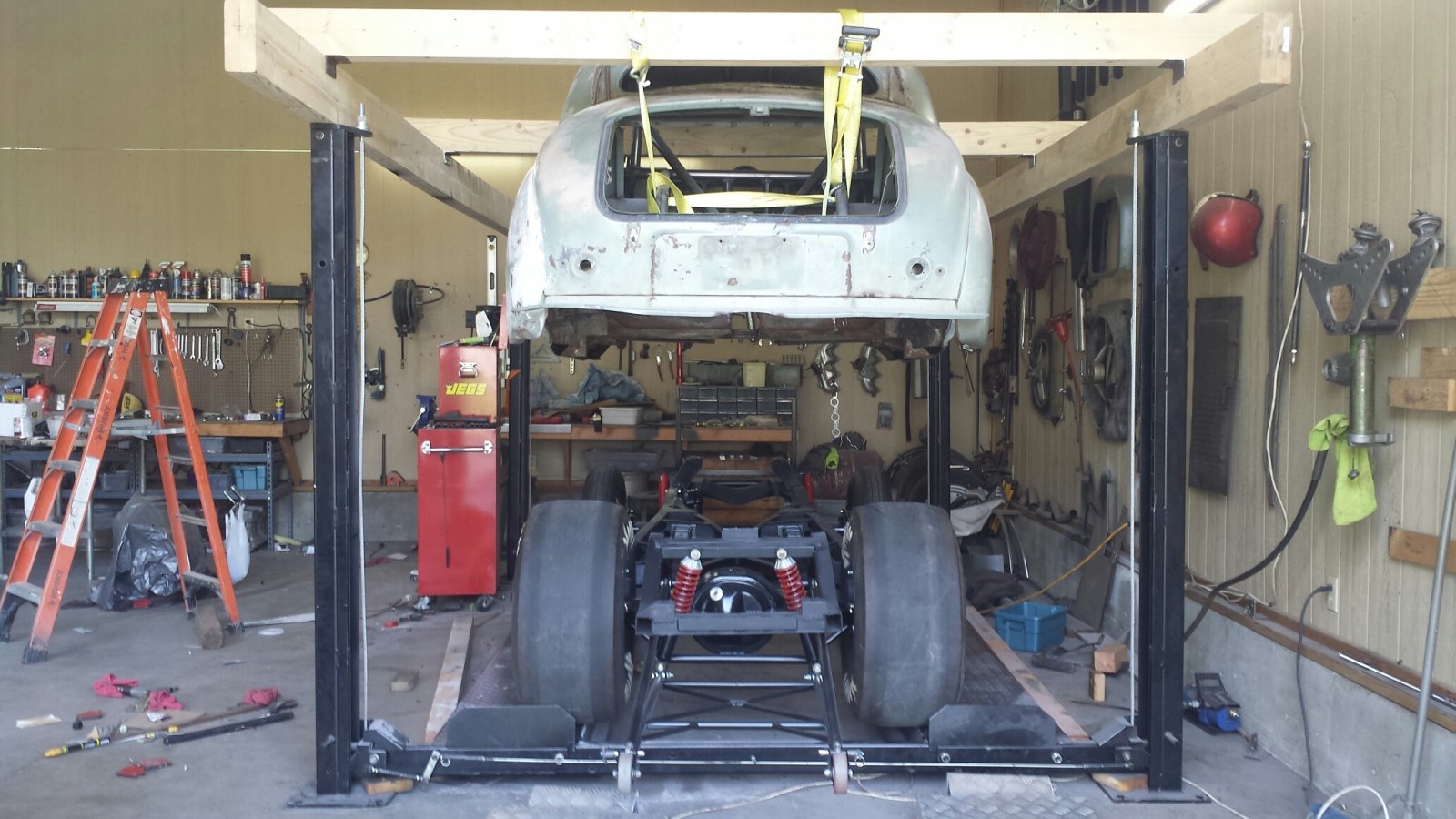

    It has been a week or two since we have had time to work on the Austin. With the biggest part of the initial body work done on the driver's side we decided to test out the contraption we built a few posts back for removing the body. We ran the lift with the body up high enough to run one of the cross members through the door windows and put a four by four on top of it for the roll cage to sit on.
    Then we set the rear cross member above the trunk area and attached straps to the rear roll cage bars. Then we slowly low lowered the lift out from under it leaving the body hanging.
    Then we simply rolled the ch***is on the lift.
    We lined up the ch***is and then ran the lift up until it touched body mounting points. Then by going up an inch or so higher we lifted the body off the crossmember supports. Now sitting back on the ch***is we removed both crossmember pieces and lowered the entire car back down.
    We rolled the car out, spun it around and then back on the lift backwards exposing the p***enger side for body work.
    Then right back up, cross members back in place and then we dropped the ch***is back down and rolled it off the lift.
    The we ran the lift back up and got the body. It worked like a charm. The whole exchange took maybe 30 minutes.
  5. Peanut 1959
    Joined: Oct 11, 2008
    Posts: 2,188
    Peanut 1959
    Ingenuity rules!
  6. Deuced Up!
    Joined: Feb 8, 2008
    Posts: 4,224
    Deuced Up!
    My Grandad always said work smart, not hard!

  8. Mike Colemire
    Joined: May 18, 2013
    Posts: 1,431
    Mike Colemire
  9. Mike Colemire
    Posts: 1,431
    Mike Colemire
    What did you bait that trap with?!! Seriously that was pretty smart. This is a sweet build.
  10. Deuced Up!
    Joined: Feb 8, 2008
    Posts: 4,224
    Deuced Up!
    That is funny, now that you mention it, it does kind of look like some sort of big trap! We reset it this afternoon, maybe we will catch an A/FX car tonight! LOL

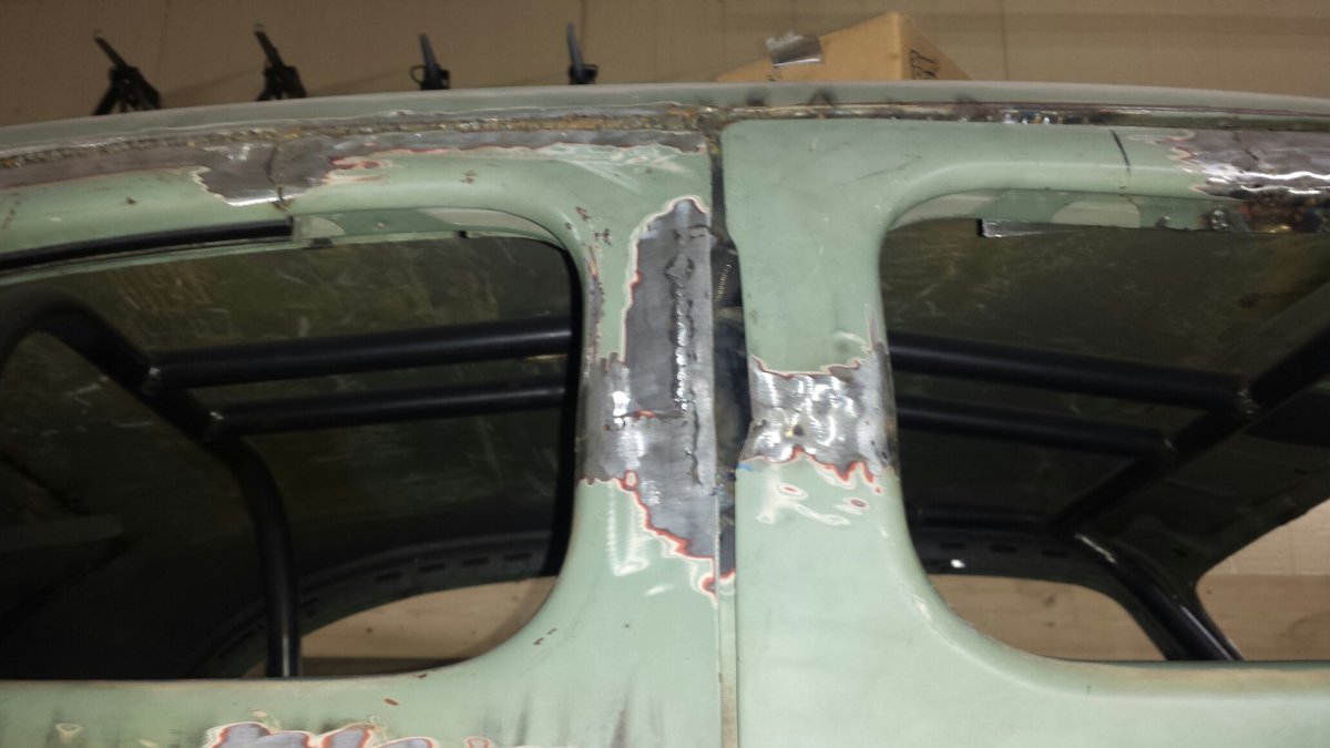

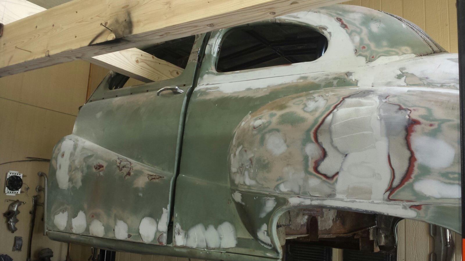

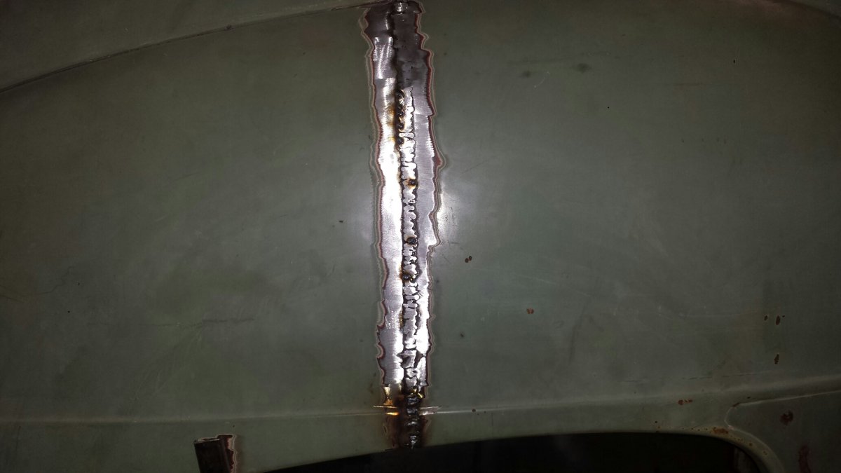

    Did a little body work today on the p***enger side. Welded up the rear door opening and did some initial grinding.
    While I was waiting for the fender to cool between tack runs, I also created a pattern and then cut out sheet metal to fill the rear inner door area that will be visible when the p***enger door is open. As you can see, with out this panel the hinges would be a dead give away that this little g***er used to be a four door.
    Originally between the doors there was a flip out signal light. However we lost most of that area when we chopped the top. But we still have an odd looking body line (or gap) in that area.
    So I drew some nice straight lines (basically making a rectangle around the area) and carefully cut it out with the plasma cutter. Then we took sheet metal and folded it over to make a rolled matching edge. After some grinding and fit work, we tacked it in place and then did some initial grinding. This work will obviously get duplicated on the door to make a nice straight gap. Then back to the driver's side.

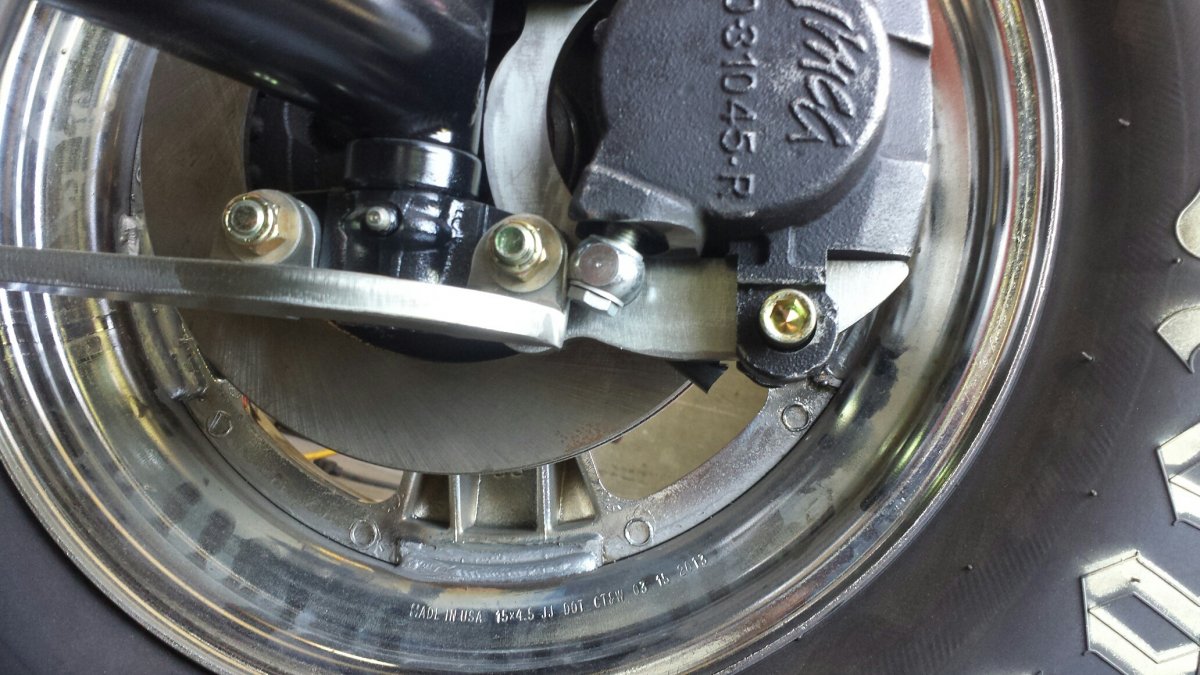

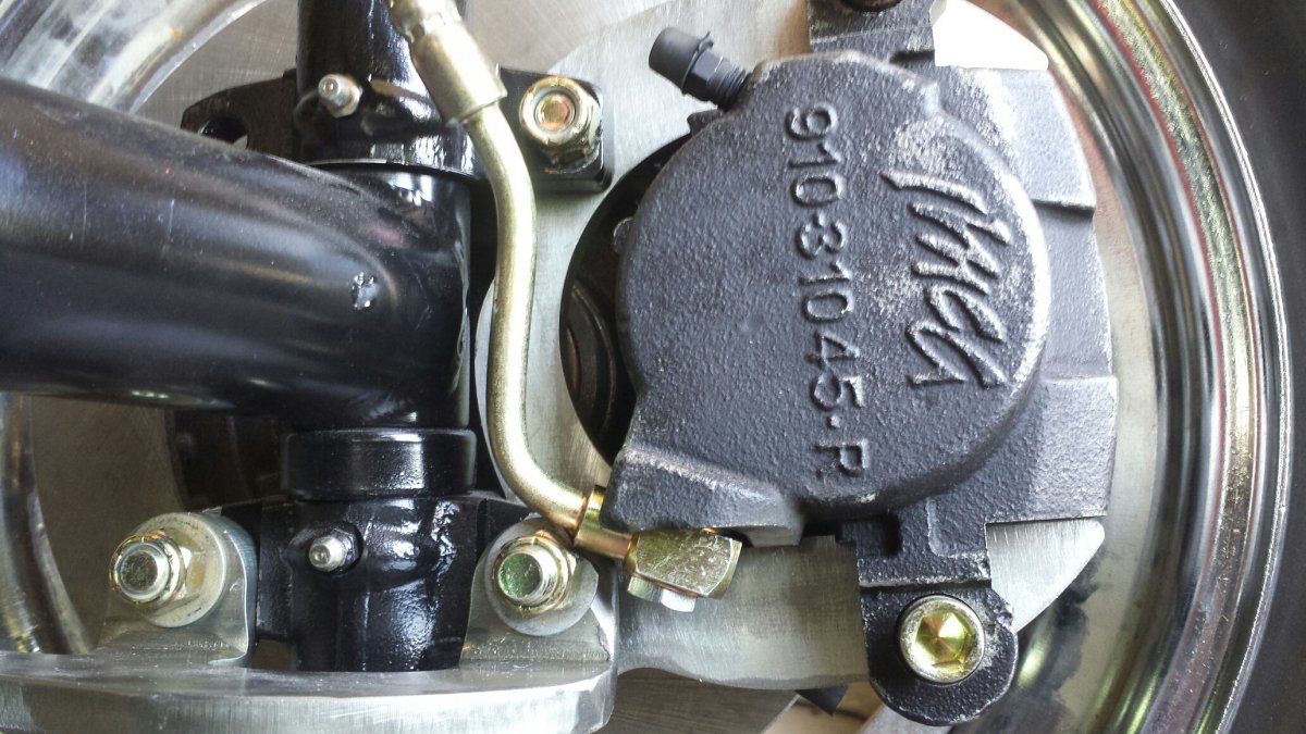

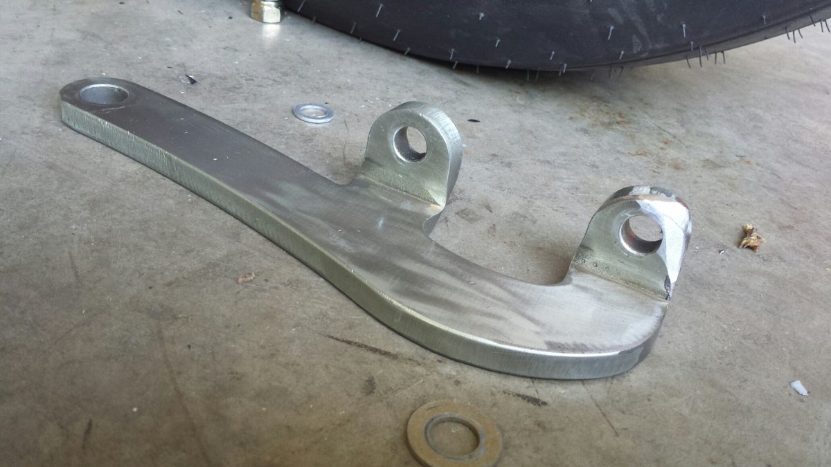

    BRAKES! We have spent a lot of time talking about go fast goodies but none of that is worth anything if you can't stop and then go fast again! I decided this morning to start ***embling the brake lines. But there were a couple of issues. One, I must have spent an hour looking for the front brake lines from Speedway which I did not find. And two, take a look at the photo below. Just before heading to O'Reilly to try and figure it out what to use, I decided to take the bolt and banjo fitting out to take with me (always a good idea). But that is as far as it would back out. The Steering arm was in the way.
    So I took the arm off and removed the fitting and headed off. However, after staring at the brake line they handed me at the counter for a bit, I decided there was no way it was going to work. So my first thought (with a caliper with IMCA forged on the side) was Metric Chevrolet. So I asked for a 1985 Monte Carlo line .....and bing....perfect. That thing fit like a glove. Well almost.
    The Monte Carlo line is below on the left and the Speedway Banjo fitting is on the right. Same basic idea but the Monte Carlo banjo end had a 3/8" hole (or metric equivalent) and the Caliper needed 7/16 (or metric equivalent). But the Chevy line fit so perfect and looked so clean. - Sooooo... I drilled it out. I first took some very careful measurements to insure the hole in the Speedway banjo bolt would align itself with the hole in the line (accounting for the copper washer etc). After I was sure it would work, I drilled the Monte Carlo line out and installed it with the Speedway banjo bolt! I was also very careful to make sure there were no shavings in the fitting hole or line etc.
    When the line was in place I found the steering arm would not go back on because the new brake hose fitting was in the way. Not much, but just enough to keep the front bolt hole from aligning. So I did just enough grinding on the flange to clear the fitting and then put it back in place.
    I even had to notch the washer but the lock nut went back on with at least 1/16" clearance (or its metric equivalent)!
    Now I am off to duplicate the task on the other side and then start placing the hardlines.
