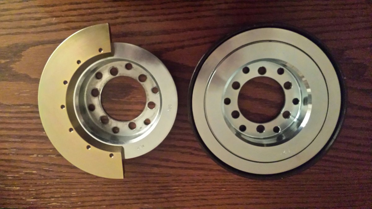

    ALSO...Last Friday at 12:37 p.m. I got a call from ATI Super Dampners saying they had received my dampner and checking to see what needed to be done. I told them to convert it from an externally balanced unit to Neutral. He said no problem. He ask for my credit card and after taking the number he said I was good to go. Then Friday at 2:05 p.m. I received an email from Fed-X with a tracking number indicating it was on the way home. Now that was one quick turn around!

    I really like the guys from ATI Super Dampners. Not only did they turn my dampner change out from externally balanced to neutral super quick but they sent me all the pieces back. Not that I will ever have any use for them but I was thinking that was pretty cool. I paid for them so they sent them back. They could have easily kept the weight and the internal hub but they didn't. Straight up guys if you ask me.

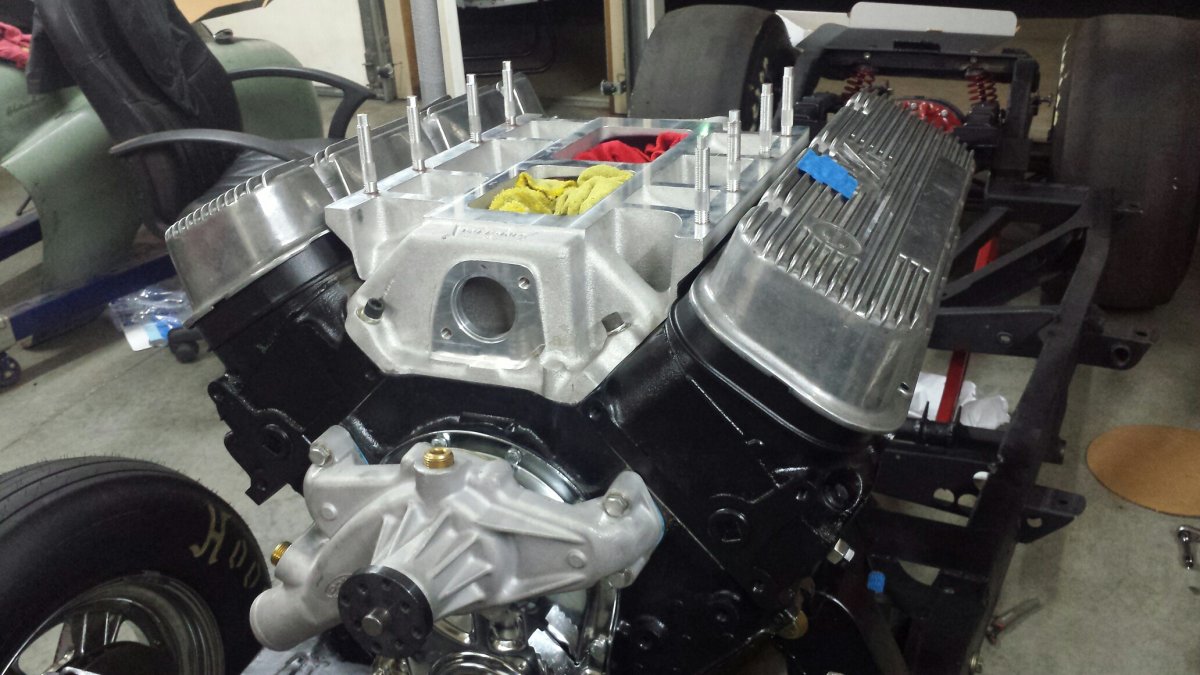

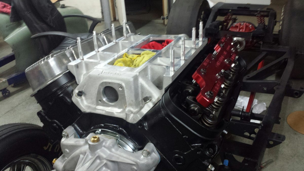

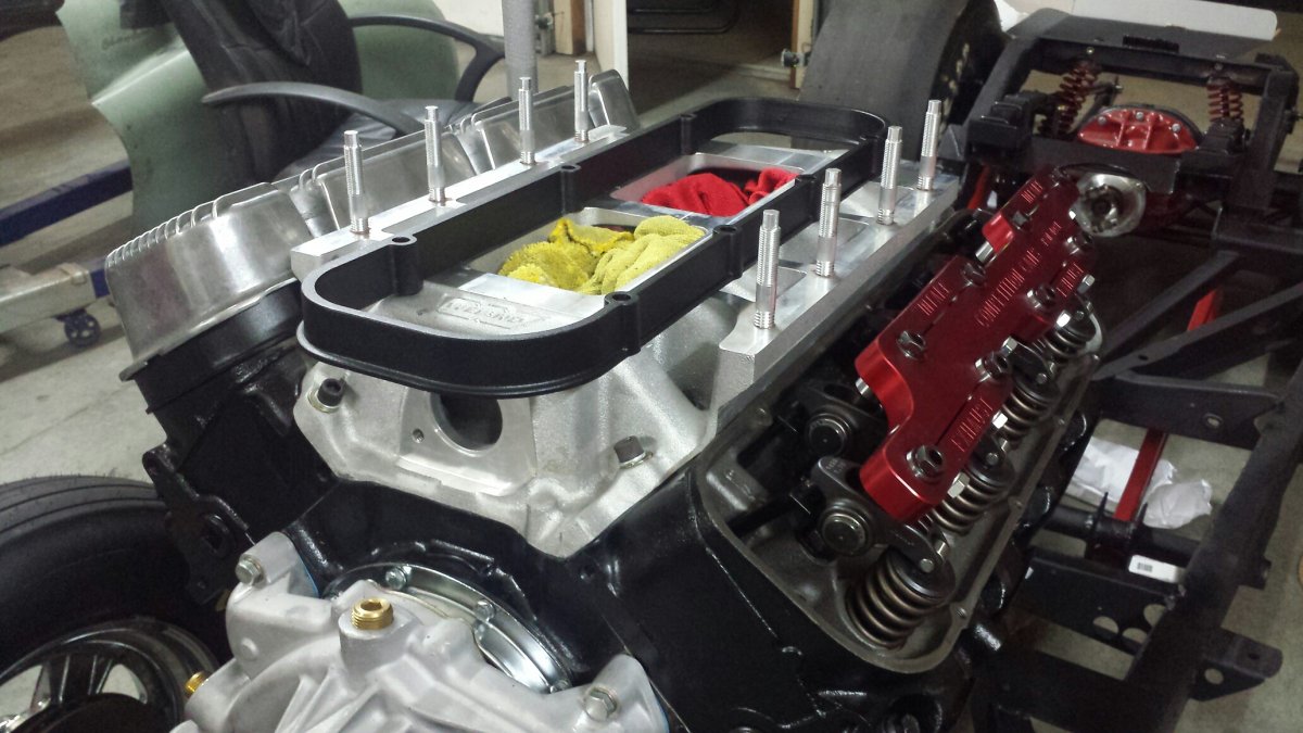

    Man I am stoked tonight! After installing the new high performance valve train, my vintage MT finned valve covers would not fit. I looked around the internet and found the thickest valve cover spacer available which was an 1 1/8". Since the heads were black, I ordered black ones. They came today and fit perfect. Below one of the spacers is just sitting on the blower intake before installing! When everything is said and done, most people will not even notice!

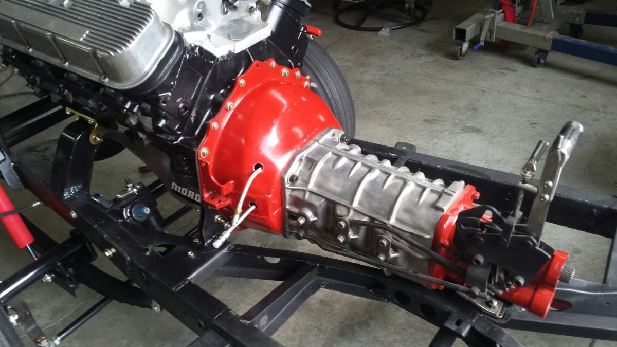

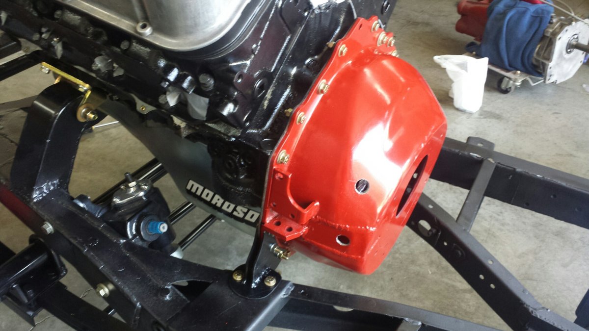

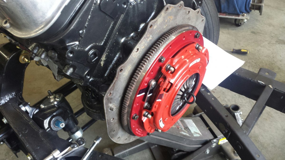

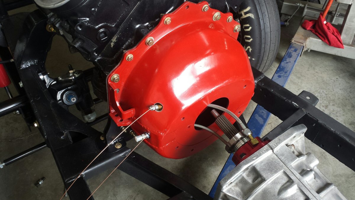

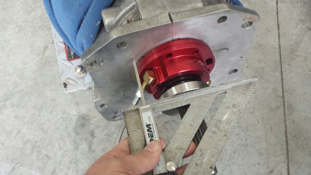

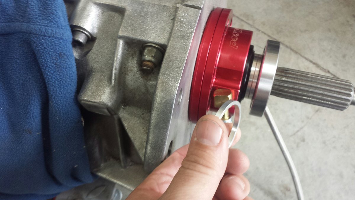

    It has been our goal for a while now to get the engine off the stand and back in the chassis. There is a big question with the transmission and we can not answer it until we have everything together. That is the goal today. So we installed the McLeod flywheel and dual RXT clutch per the instructions and put the heavy duty scatter shield bell housing in place as well.

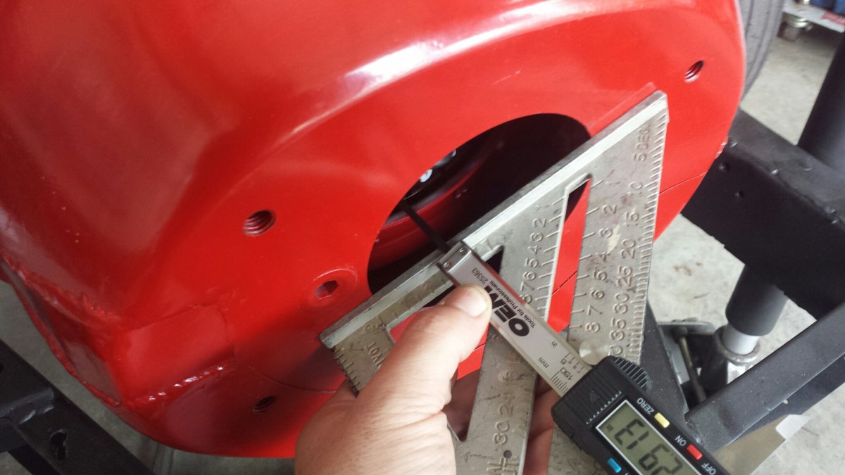

    Here is the question. Will the bolt on McLeod hydraulic throwout bearing work or will we have to send it back to get a different piston length installed. McLeod actually suggests not even ordering the throwout until you take this measurement, information JEGS didn't pass on when I purchased this stuff a year or so ago. So above here is what we are measuring: distance from the mounting surface to the clutch fingers.
    Then according to McLeod specs, we added .200 and the transposed the measurements from the face of the throwout bearing to the mounting surface of the transmission. We are looking for .200 to .150 of space between the fingers and the bearing at rest. According to all the official McLeod videos online, with the bolt on unit we have here, if we don't have the .200 we have to send the unit back to Mcleod to get a different piston. No cost for the service but still time consuming.
    However, I noticed something about my unit. It had rings, each about .150 in width and what I would call removable. It was obvious to me that this was an upgrade from the original units that were in the videos. I finally found a confirmation "of sorts" on the McLeod website that my hunch was correct. It didn't come right out and say it but it is so obvious to me that between the limited info on their site and my common sense, we removed one ring and our measurement was perfect!

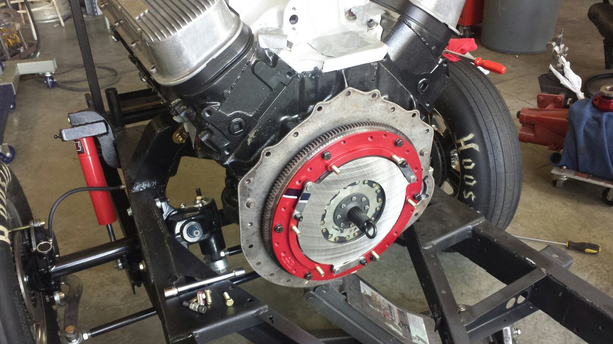

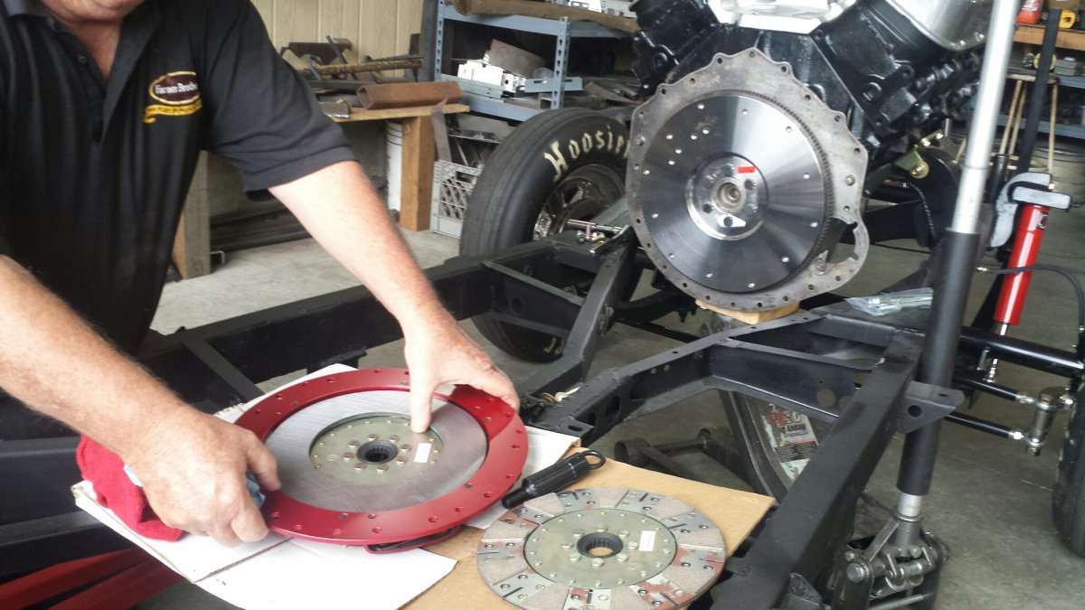

    So, satisfied we had answered our trans questions and the proper adjustments had been made we set about removing the clutch again to clean all the surfaces and get it ready for final assembly. While Dad starting working on the clutch, I grabbed the high torque MSD Dyna Force starter and got it mounted. No shimming needed today, it was a perfect fit right out of the box.
    We very carefully cleaned all the clutch surfaces with MEK (nasty stuff but very effective for removing oils etc).
    We installed the inner clutch disk, aligned it and install the McLeod outer ring to the flywheel.
    Then the outer clutch disk goes on and is aligned with the inner (note you need to rotate these clutches a few times before the pressure plate goes on. Also be careful the outer clutch does not sag a bit while slowly torquing the pressure plate.
    When we were happy with clutch install we popped the bell housing back on, including the mid mounting brackets we built several pages back. We went ahead and bolted it all solid (as you can see) there are a total of 22 grade 8 bolts, washer and nuts involved in this process. Note: You can see where I welded up the area that originally was open for the manual throwout bearing fork. I also drilled the holes for both the bleeder and hydraulic line for the new throw out system.

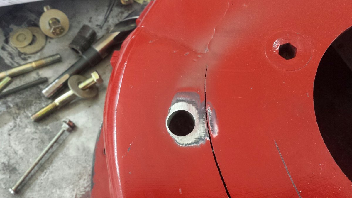

    Time to install the transmission. We took some copper wire to help guide the hydraulic lines from the throw out bearing through the holes. The bleeder line has to be on top. Then just slide it in right....? Riiiigghhhhtt. So you remember back a few paragraphs, I mentioned to make sure the alignment tool does not allow the outer clutch disk to slip down a bit. Well here is the experience that gave us the valuable knowledge to type that advice. We did not realize that was possible the first time around which "YOU GUESSED IT" means we had to take it all back apart.
    The rear disk had slipped down just enough to get everything out of line. And with the pressure plate in place and torqued down, there was no moving anything. You know I vaguely remember thinking to myself as I tightened the 22 bolts on the bell housing that if something was not right this was going to be major pain in the ass (and it was)!
    20150829_155408.jpeg It is just as well though as after we got the clutch all figured out and back in place, we decided since the tolerances were so tight getting the trans into the bell housing that it might be easier to mate them up before installing. That is when we discovered one of the bolt holes that mounts the trans had its threads nearly destroyed. Up until now, we had never had a bolt in the hole as it was very hard to get to anyway. We tried to clean them with a tap but they were to far gone. So we just drilled it out and put grade 8 bolt through from the inside with a lock nut on the outside.
    Then it really did slide right into place (cough, cough). Okay maybe just a soft love tap at the end but... Finally we installed the 22 bell housing bolts and nuts etc. a second time and poof there it is...

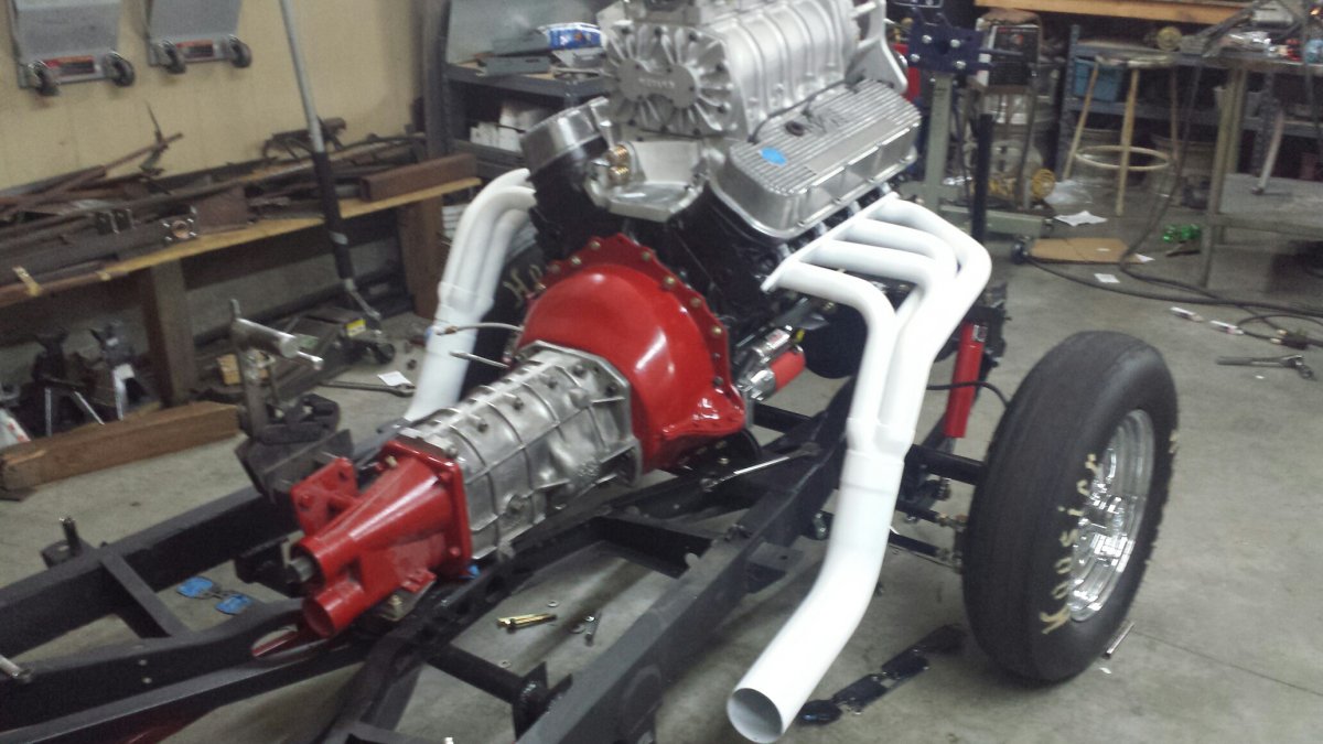

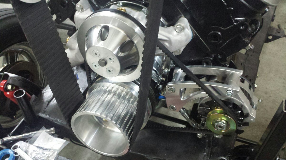

    Catching our second wind after the near all day transmission install we torqued down the intake and installed the blower for real this time. (Well lets be honest. We didn't really start until around 11 a.m. and the near all day estimate most certainly include a long lunch at Heady's BBQ!) Our favorite Saturday lunch time haunts....

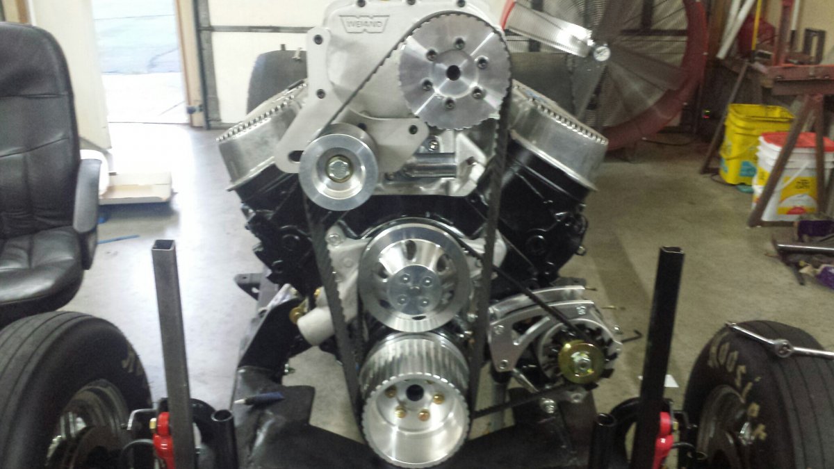

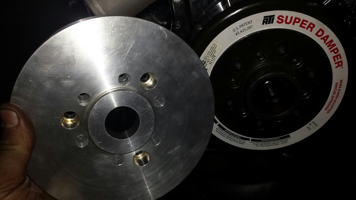

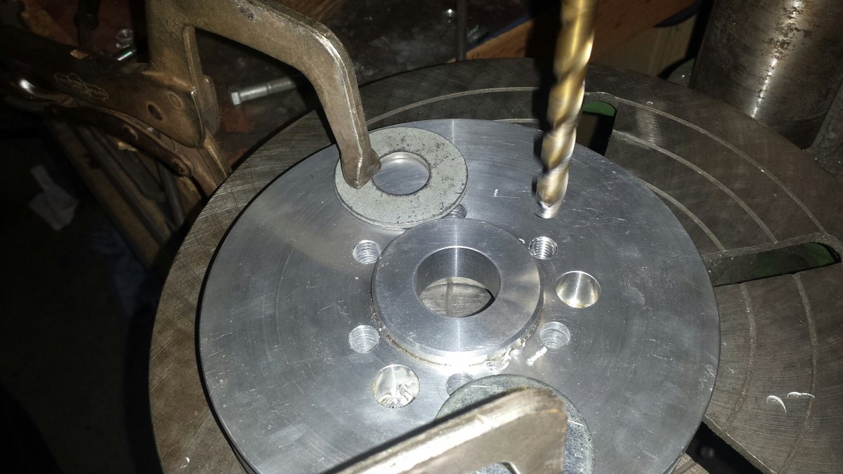

    After pressing on the newly converted ATI Super Dampner we decided to install the accessory drive and lower blower drive pulleys. Check out the photo below.
    The high end Billet accessory pulley "HAD" 6 bolt holes which perfectly corresponded to the six mounting holes on the dampner. That is always good! However, both the holes in the pulley and the damper were threaded. Of course this is not going to work anyway but to ad insult to injury, while they were the same bolt size, the dampner was fine thread and the pulley course....crazy!
    Notice I said "HAD" course threads above. Of course it would not have mattered if they both had matching threads as you could not have installed one on the other, both threaded. It was obvious we needed to drill the threads out the pulley so the bolts could simply go through and secure it to the dampner. So that is what we did (very carefully).

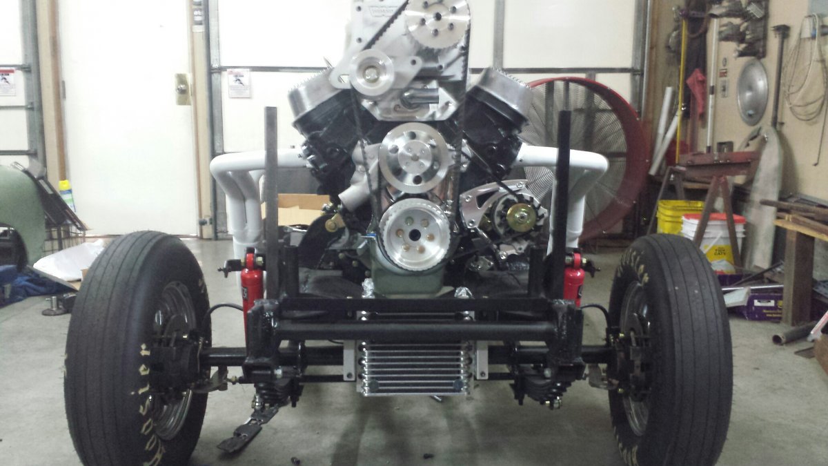

    So at the end of very long day...this is what we have. A few more days like this and we will either be ready to fire this beast or possibly be institutionalized.

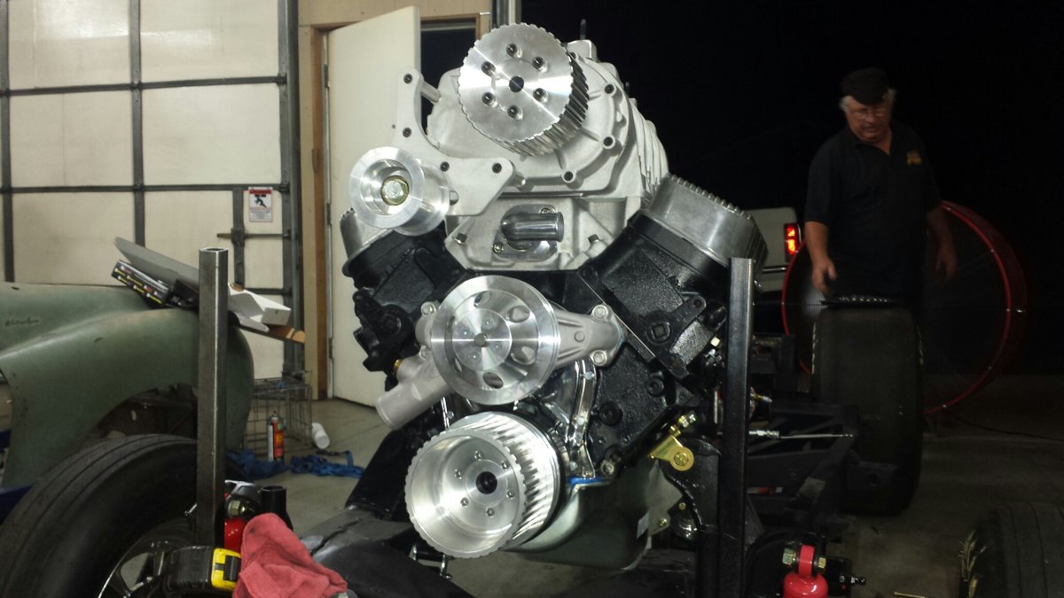

    Fairly laid back afternoon today in the shop. Our little machining foray last night with the front accessory drive pulley left us in need of longer bolts. So today started as usual with an all but fruitless Sunday search for specials bolts. Today it was 6, grade eight, three inch long 3/8 - 24 to secure both the accessory and blower drive pulleys.
    Obviously we were successful. We also reinstalled the special low mount alternator bracket and the 120 amp GM style mini alternator. We took a quick belt measurement 45" and then off to the parts store for a new Gates "V" belt.
    We popped the blower drive belt on as well just to see how everything fits etc.

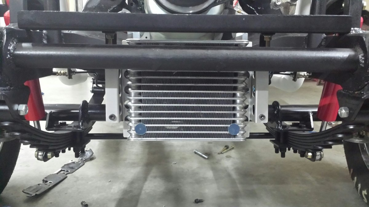

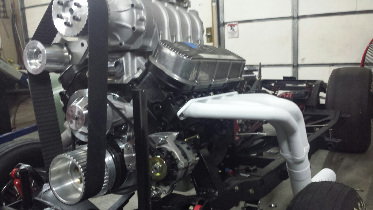

    I ordered the Holly #90 Jets today from my local performance shop they should be here tomorrow. He also said the Moroso oil filter adapter plate would be in tomorrow as well. It has an inlet and outlet to allow you to plumb in an oil cooler. So when I got home tonight, I decided we better figure out where to put the cooler. I must have laid under and walked around that chassis for an hour trying to find the perfect spot with Dad giving the official critique of every potential placement. It is always good to have a second pair of eyes. Here is where it ended up.
    That is mounted to the bottom of the radiator tray and drops down into very clean air. While in clean air, it will still have a bit of protection from the lower front valance etc. This is a pretty cool Derale unit that I have had hanging of the wall for a while just looking for a home. It has its own fan unit (probably over kill like everything else). All I need is a couple of elbow fittings and it is ready to plumb.
    After figuring out where to put it. We simply made some "L" bracket and basically hung it from the radiator support tray. It is a very tidy fit and Dad and I were both happy with it.
    We also mounted the headers and installed the spark plugs.

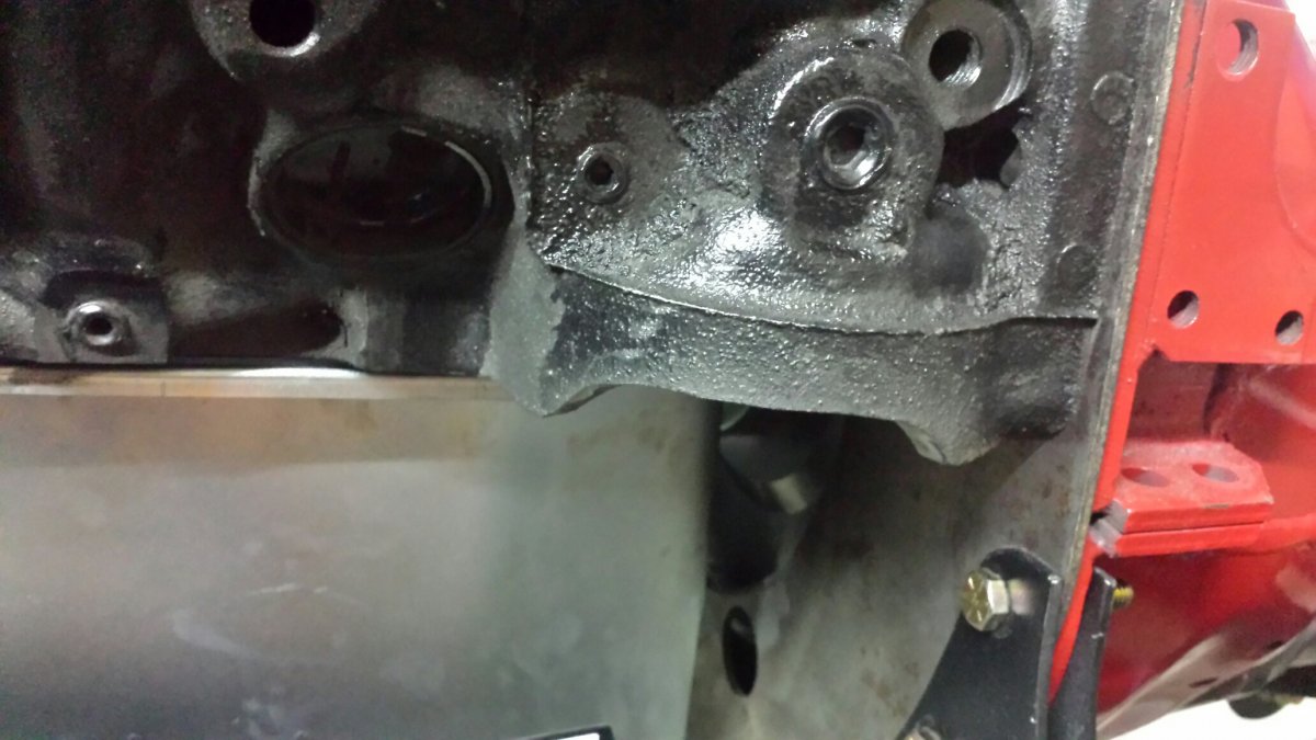

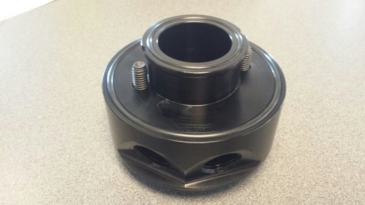

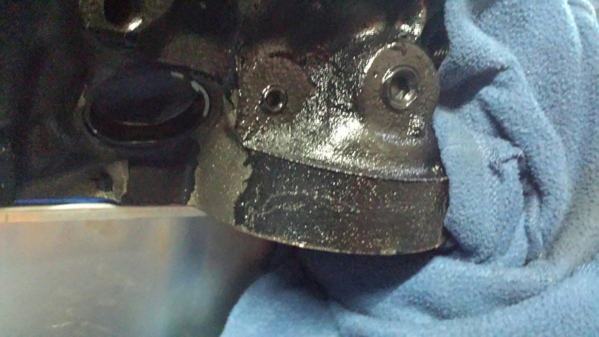

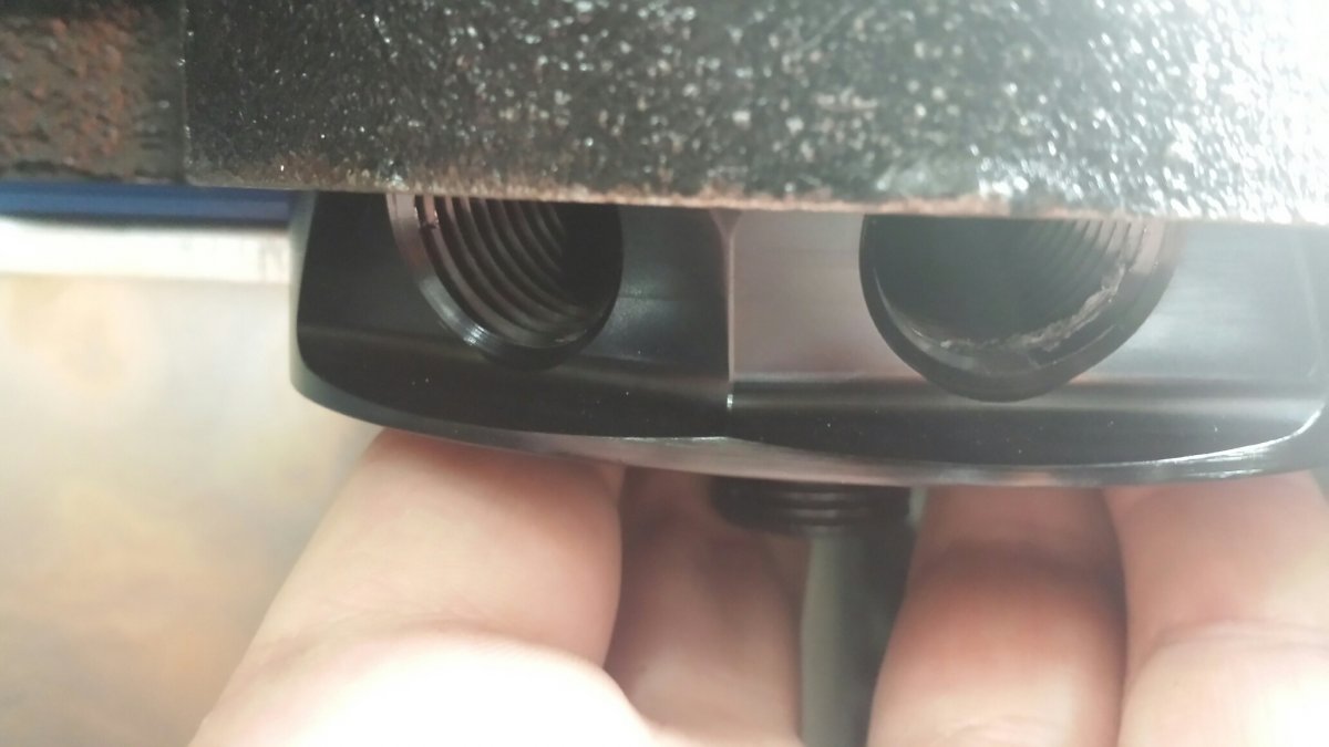

    Well things didn't go quite as planned. Par for the course fabricating a one off project from the seat of your pants. So I slipped the Moroso Oil Filter adapter in place tonight to have a look and this is what I see:
    When it is fully engaged in the oil filter boss, you can only see 2/3rds of the ports. I got back online thinking I got the wrong pieces or something but what I had in my hand is what Moroso showed for my application. I downloaded the instructions and found in the small print...for BBC you have to grind the filter boss for clearance!
    Thanks Moroso...(hey here's an idea) - how about just make one for a BBC!
    So we covered everything we could and got out the old grinder...
    ...and POOF! I adapted my BBC for the Moroso BBC Adapter. LOL

    So here is where I am this morning: Searching Springfield, MO for a "BBC remote oil filter kit"...
    It should be obvious by that statement that things didn't get any better last night. After grinding the filter boss and installing the adapter and fittings (which fit absolutely perfect, thank you very much) we hit another small snag. It appears the fittings and ensuing hose work is going to interfere with the steering rod.
    I tell you when you are working on a car this small and putting such large pieces in place, there is simply no room for error. Originally I was going to go the remote oil filter route as there are several things all fighting for space right there including the steering rod, clutch and brake master cylinders and mid engine mount etc. There was no reason to try and squeeze an oil filter and cooler lines in there when there was an alternative. I should have went with my first instinct. Oh well....easy fix.

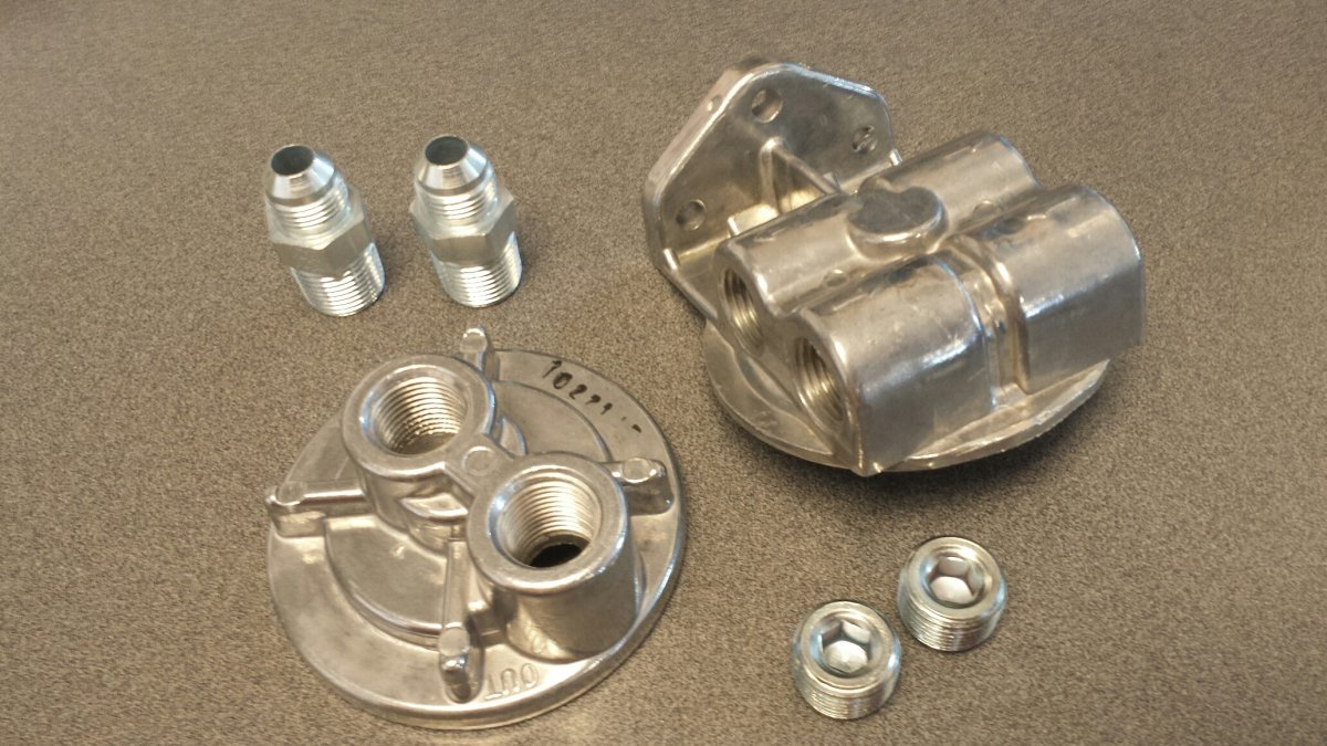

    So...to all of the above, add this stuff (all made in the USA)...
    And what you have is the makings of a remote oil filter system with cooler. Basically I am going to plug the outlets in the stupid Moroso adapter that I worked so hard last night to install and screw the filter adapter from this Wix Kit on the bottom of it. Then we just have to mount the filter boss somewhere close by and plumb it up. If I remember correctly that is fairly close to what I said here yesterday before heading home...
