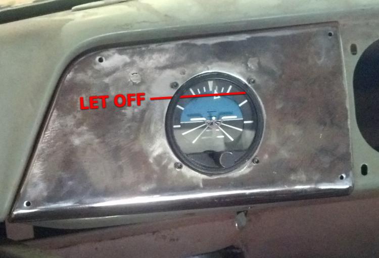

    ...And don't forget I already have Cessna artificial horizon gauge in the driver's glove box door. If I had went with a solid dash insert I would have to remount it.

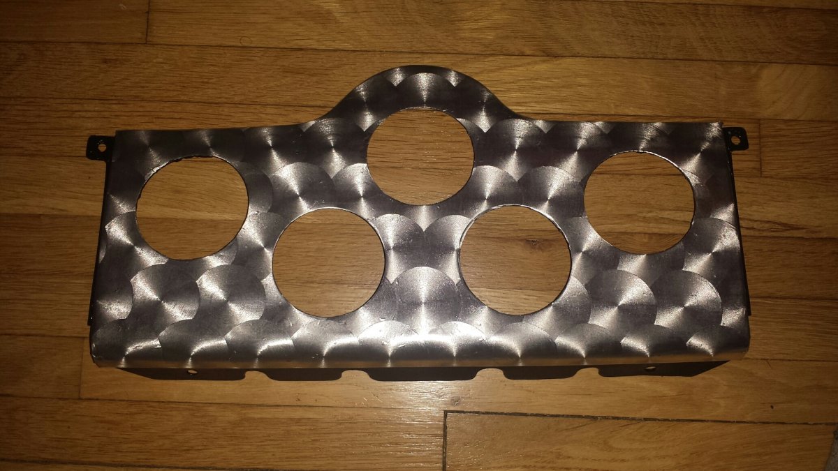

    Final finish on the main dash from earlier post...see I told you it was going to be cool. Both glove compartment doors are going to get the same Engine Turn Silver treatment. I am pretty excited about how it "turned" out...pun intended.
    While we were sitting around waiting for the paint to dry night before last, Dad had a really good idea. Since we still have the passenger side glove compartment, why not mount the fuse box inside it. That will make it stupid easy to access the fuses etc. Going back with the original dash etc is going to be a win, win!
