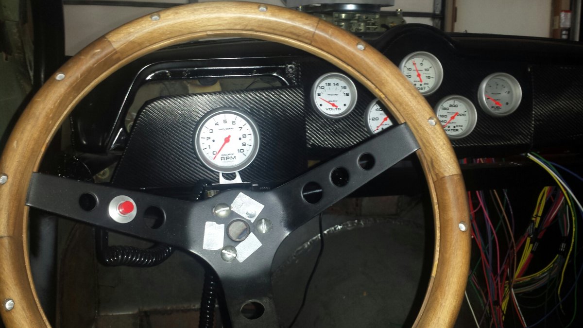

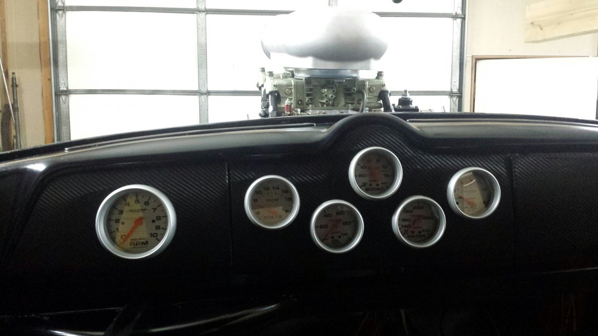

    New tach in place...very tidy. I am pleased.

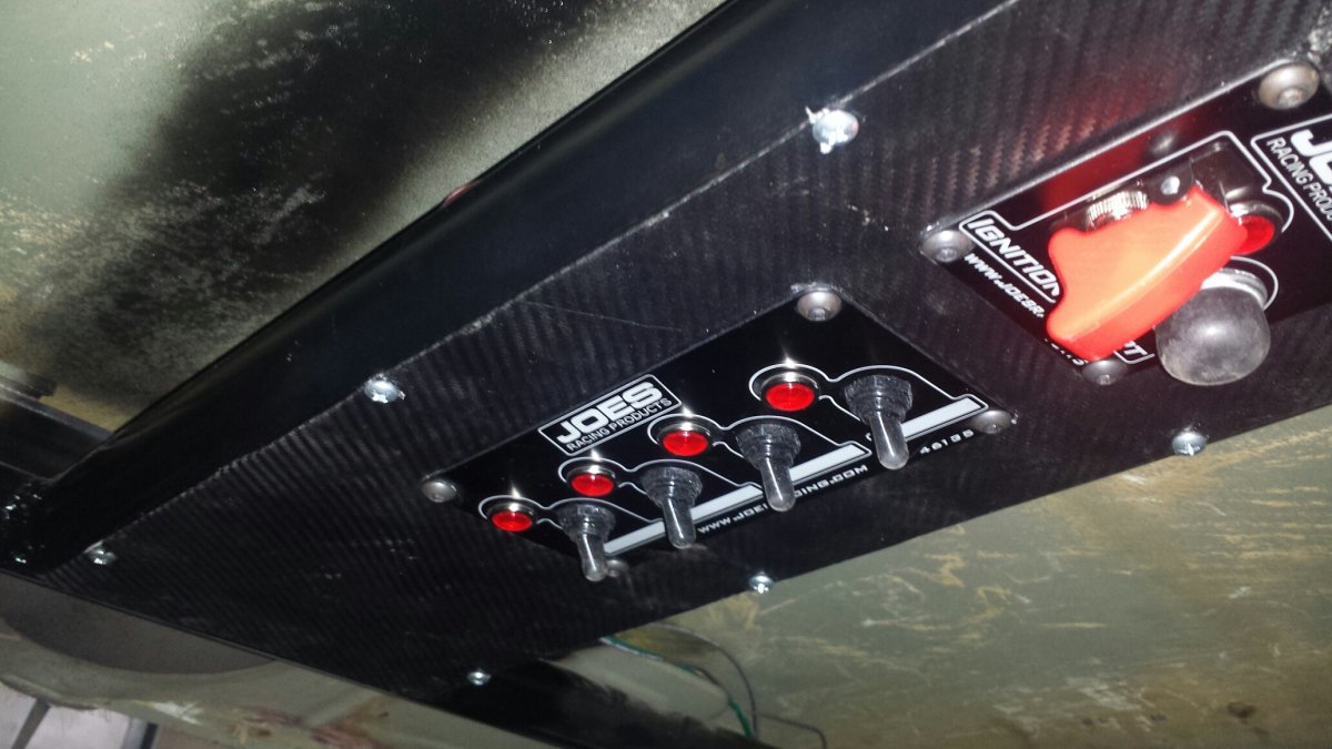

    So to begin with I will not even tell you why I had the supercharger back off this morning but by 10 a.m. everything was back in place again and we were back to the original plan for the day...wiring.
    While sitting in the car this morning, I put the little burnout helper button in place. Actually what I was really doing was hanging out in the driving position trying to figure the most handy place for the Joe's Racing switch panels. The dash board is too far away, especially when you are wearing the safety harness. We considered the sheet metal console between the seats and while it provided nice access, unless we built a special box on top of it, we would expose the switches to the elements etc.
    The obvious place was over head. I played around with building a header box attached to the front roll bar cross piece which would have put all the switches right in front of me but then had a bit of a brain storm while staring at the upper cage. This is what we decided:
    I cut a piece of .040 aluminum to fit right between the two upper center support bars in the cage system. They run from the back loop to the center loop and then to the front loop above the windshield area. This is the absolute perfect spot.
    The main ignition switch is wired to the MSD box, so one quick swipe at the safety switch and she is dead. As for the other four toggle switches, 3 of them are simply for relays: One is for the fuel pump relay, one is for the main cooling fan relay and the third is for the oil cooling fan relay. At this point the fourth one is open but will likely be for cockpit lighting.

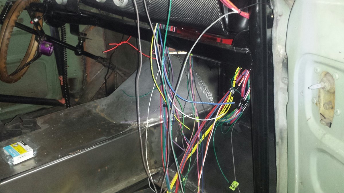

    I know it appears a bit discombobulated at the moment, but it is not a bad as it looks. We managed to get all the wire groups sorted, firewall holes drilled, grommets in place and wires pulled. Below represents three sections: Headlights and Front signal lights plus both cooling fan harnesses, Taillights, rear signals, brakeslights, etc. and finally engine compartment. All of the wires will drop right down together where the front frame X-member starts. Then they will be split up and sent in the correct directions etc.
    At this point however, the cockpit is still a bit out of control but tomorrow we install the headlight switch and a few other pieces that will quickly find homes for all these loose ends!

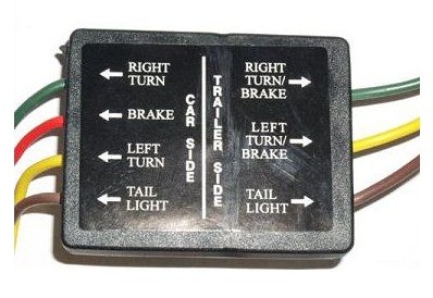

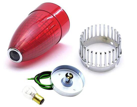

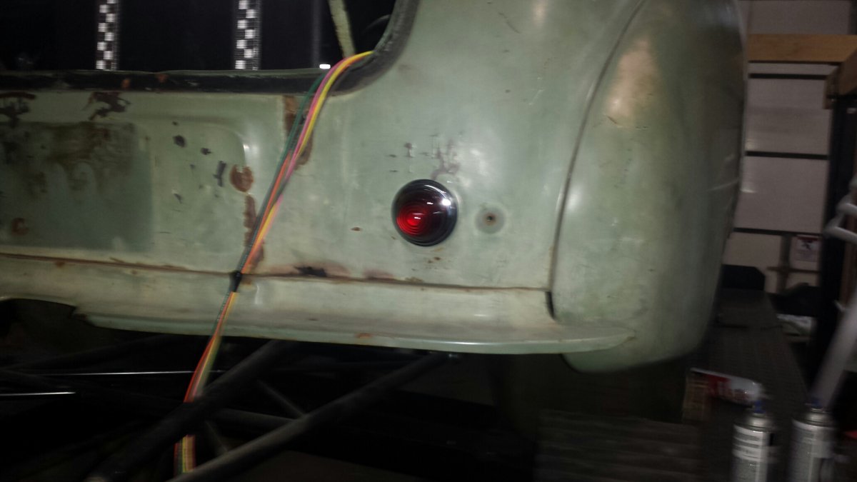

    As you know we are deep into wiring the car but I am still missing a big component...tail lights. The original tail lights, that I really loved were simple, round and unassuming. Their diameter was only 2.75" and their are two small plateaus hammered into the bulbous back side by the factory just for them. However by the time the little Austin came into my hands, both lenses were broken. So with that being said, I have been searching quite a while for suitable replacements.
    Here is what I came up with:
    I know, there is nothing unassuming about Caddy lights! LOL. But they are the perfect diameter for the mounting area and what's more, these have the killer "blue dot" circumcision! But here is the crux, if you will. I only have one mounting point per side. That means only one 1157 bulb per side with two filaments to execute three potential functions. When faced with the same situation on the Model "A" a couple of years ago I simply added a second set of '39 Ford lights. In the end, it was a very cool look. It totally appeared to be a design intention instead of a lack of knowledge as to how to wire up one light to do three jobs!
    Well since then I have learned a little secret and I thought I would share it with you. Just in case you have a similar situation on your rod etc. As the design of production cars began to get more and more sleek in the 1960s (meaning a move towards single tail lights) the factories were faced with the same question. How can we keep the chosen signal light flashing when the brake is applied. Their answer was to build a special signal switch that automatically cancels out the brake light on the side that a signal is in action. Now I don't want to know how much the initial investment in these switches was nor do I want to try and build one myself. But I will tell you this little secret, I spent $20 at the auto parts and I am ready to go!
    This is a tail light wiring converter for trailers. No further instructions needed here as the decal on the back of the unit says everything. Just wire this little, easy to hide jewel in and you are done!

    Nooooo, not '59 Caddy lights, again!!!

    You can buy new Austin tail lights....check ebay UK , or just google UK classic car spares.
  9. gonmad
    Joined: May 17, 2007
    Posts: 1,760
    gonmad
    Or 58 Chevy, or mid year corvette lights frenched in. Just a different thought.

    Sorry guys I was just messing with you, I don't have any Caddy lights...I just thought the blue dot circumcision was funny. I really just wanted to share the trailer light switch information. About six months ago I snagged a set of Austin Healey original glass lense Lucas lights from a restoration place in Kent, England.

    Their diameter is too big...4" ...The original style lights I got from England look just like them but half the size.

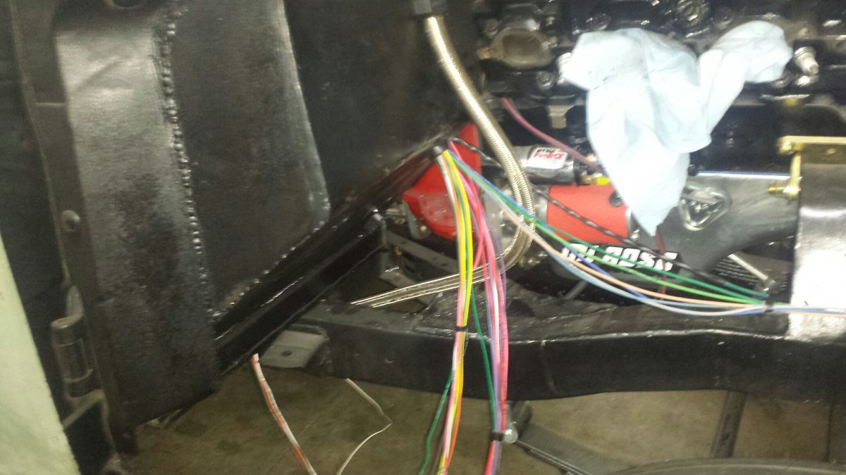

    Remember one safety precaution. Holes through the fire wall are all blow holes. All my wiring goes through the floor. I try to keep all holes through the fire wall at an absolute minimum.

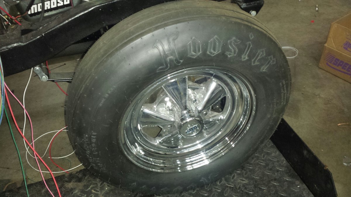

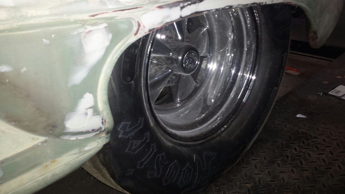

    Dad worked all day Friday removing the white letters from the Hoosier slicks and front runners. Something that has to be done before we run the Meltdown Drags. They really look good....a tooth brush, CRC Nonchlorinated Brakleen and more patience than I have...!
