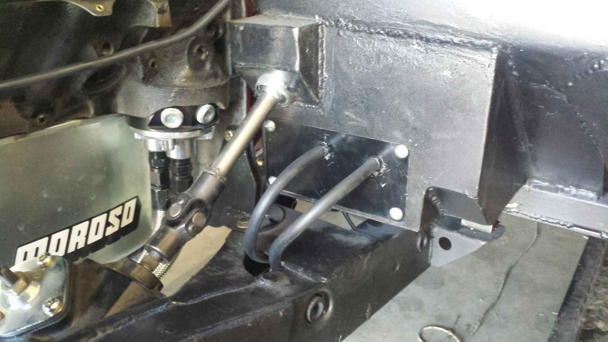

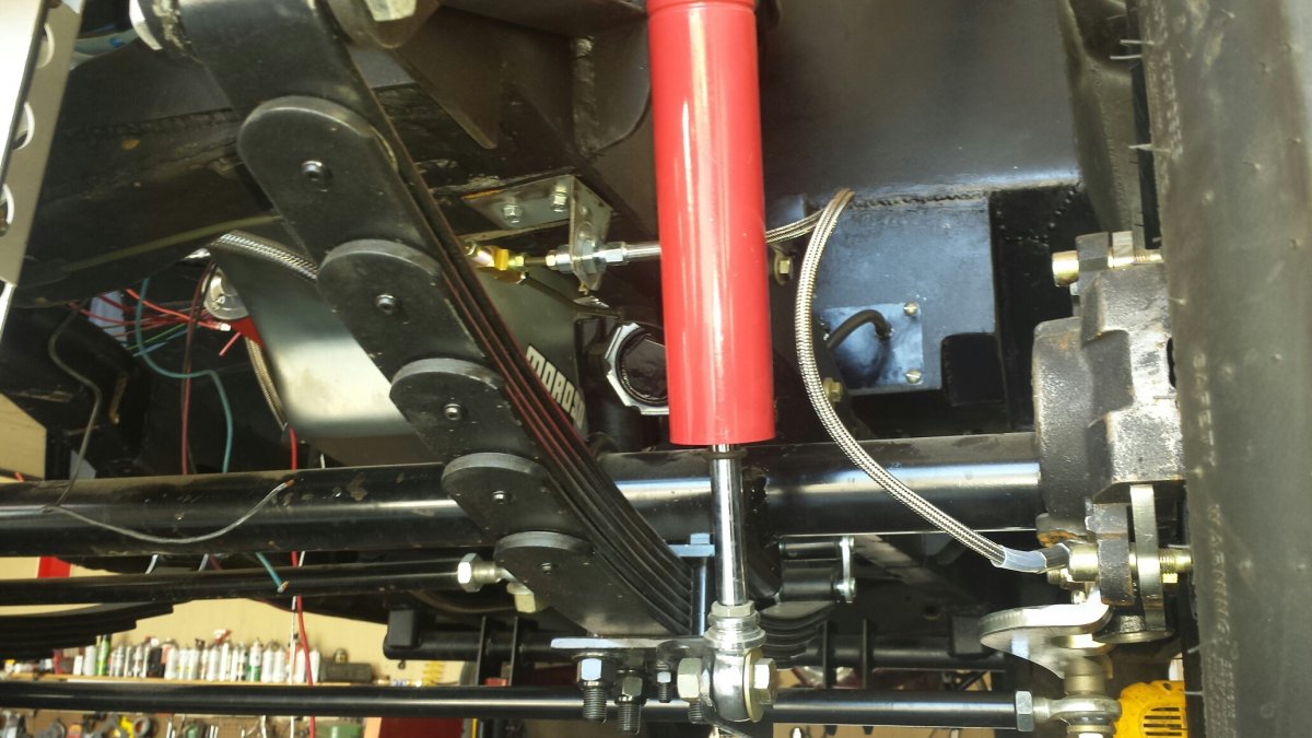

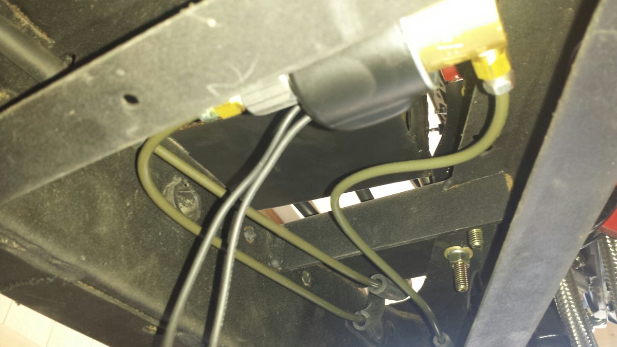

    The Austin will stop. We spent most of the day running hard brake lines and getting all the correct fittings in place etc. But we started by installing the pedal platform for good this time.
    The quick access door in the firewall that has been screwed shut for nearly a year worked perfectly. We just had to drill exit holes for the 3/16 hard lines. As you can see they are wearing split rubber hoses to protect them. After they exit the firewall, they drop straight down into the frame area where the front "X" member begins.
    Right after dropping through the frame, the rear line heads straight to the back down the inside of the frame and the front line makes a quick detour through the line lock.

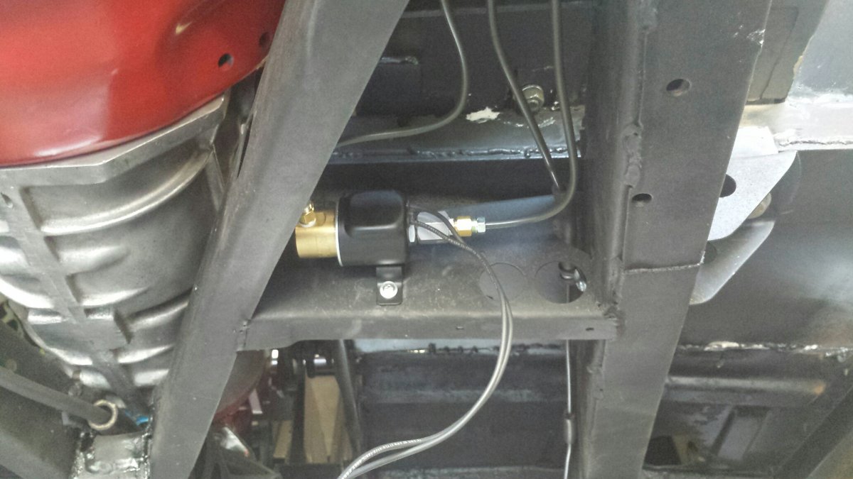

    20160409_111324.jpeg It is a very nice place for the line lock solenoid as it is completely tucked away and out of sight but very easy to access when needed.
    One quick change or upgrade are the brake hoses. Originally we had a factory style fitting and rubber hose but recently I opted to change them out for braided lines at all four corners. After all the fittings were double checked we bled both systems. Then after tightening two fitting we missed when we double checked all the fittings, we finished the job. She will stop!

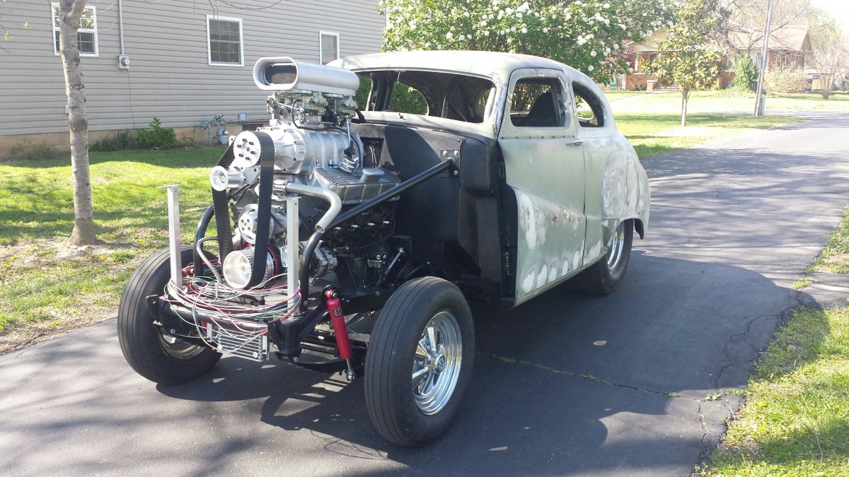

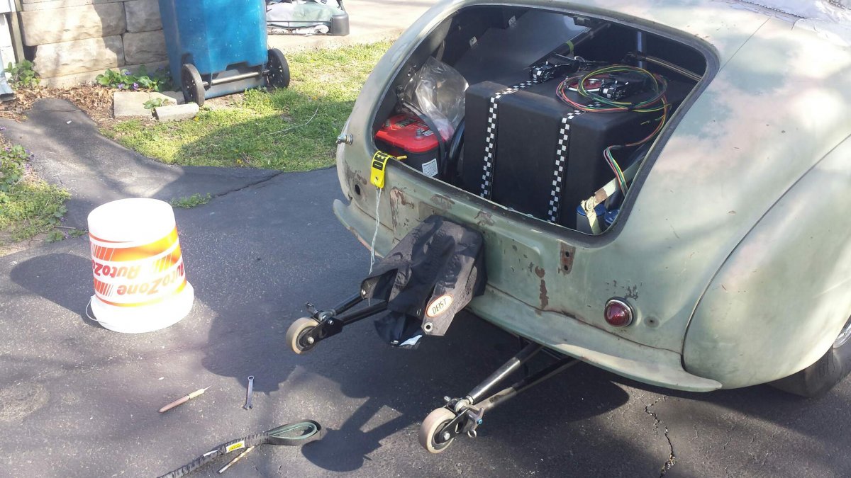

    We rolled the car off the lift and out into the sunshine for the first time in quite a while. We towed it up the driveway and double checked the brakes. Then we sat in lawn chairs and smiled for a while.
    My neighbor said, there appears to be a very large motor in my driveway with some sheet metal attached to it. LOL!

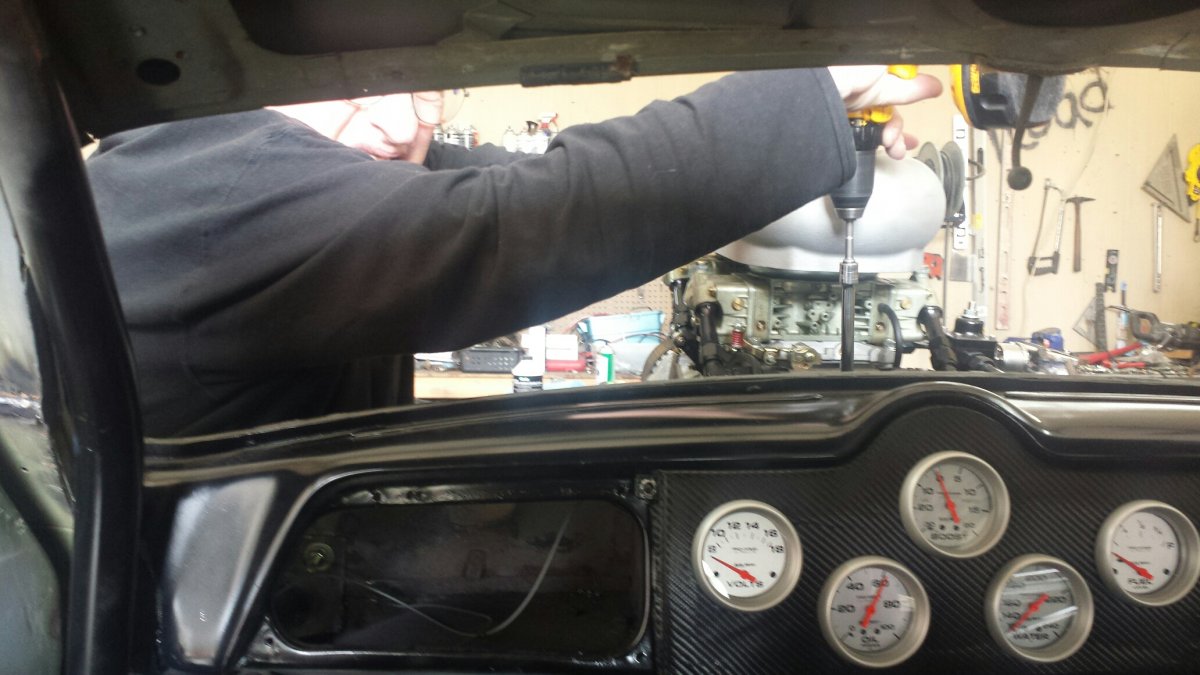

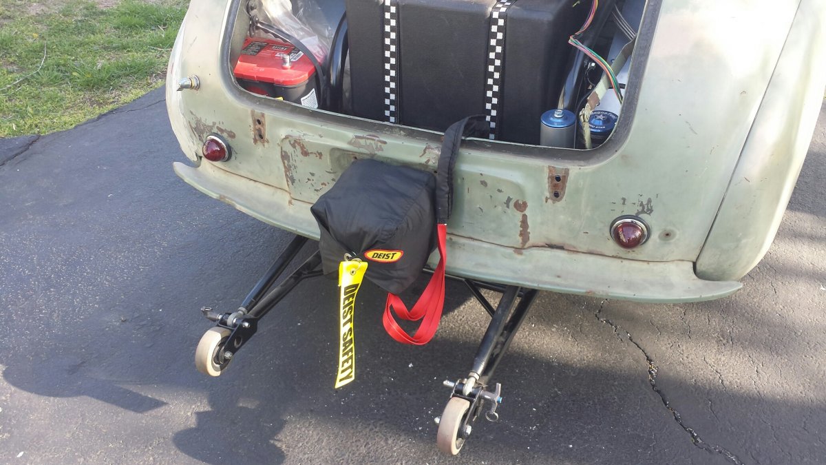

    While it sat in the shade we decided to go ahead and install the tail lights for real as that one on the p***enger side is just stuck in the hole. We soldered our home made pigtails to the sockets and got them ready to put in place but then got distracted by the parachute.

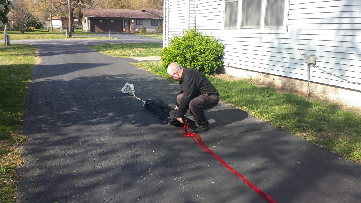

    Of course we had to take the chute out to mount the bag...kind of a pandora's box if you ask me!
    There is Dad getting ready for attempt one to put it back in the bag. At least I think this is attempt one...I sort of lost count! LOL.
    But somehow before the sun went down, both tail lights were in and the chute was packed!

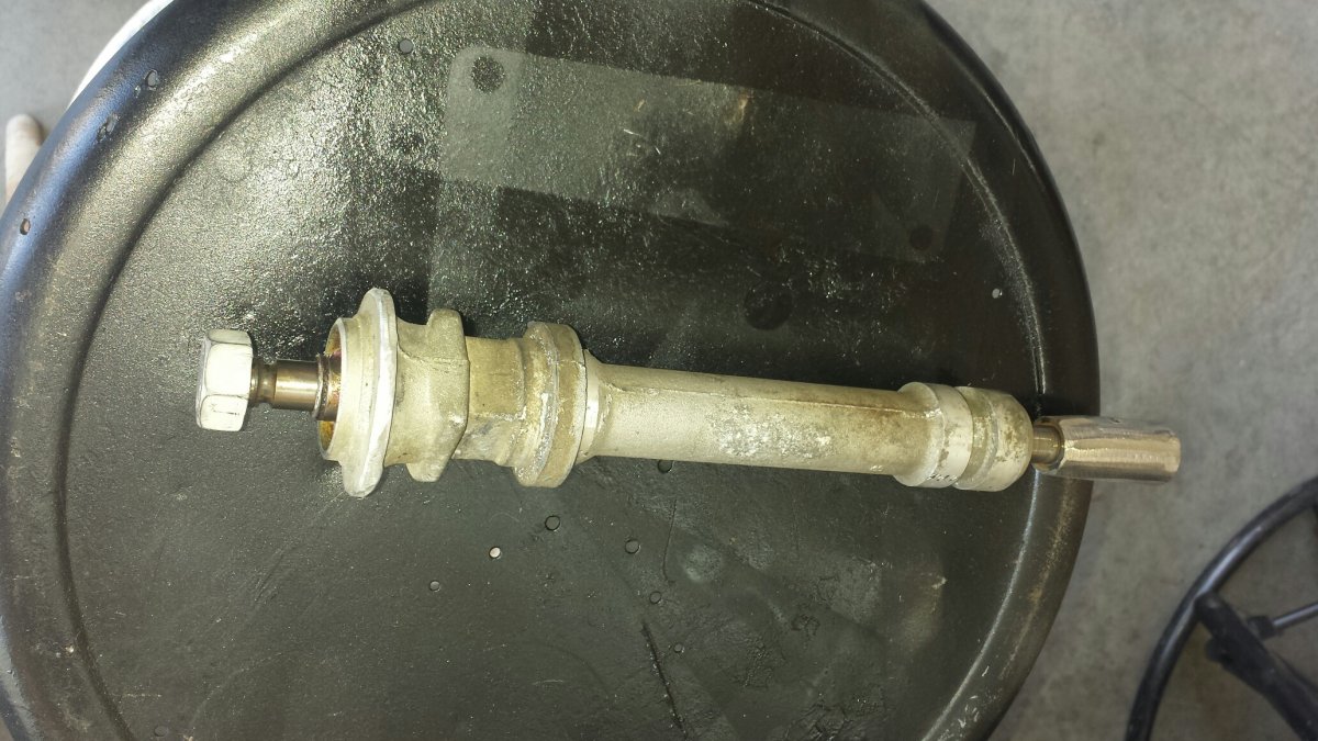

    AND....We created the little toy below from the original GM distributor that has been riding around in the back of my truck for a good year now. Looks like we are about to prime the motor...it won't be long now before we get ran out of the neighborhood with noise abatement procedures maybe even the County! :D:D:D

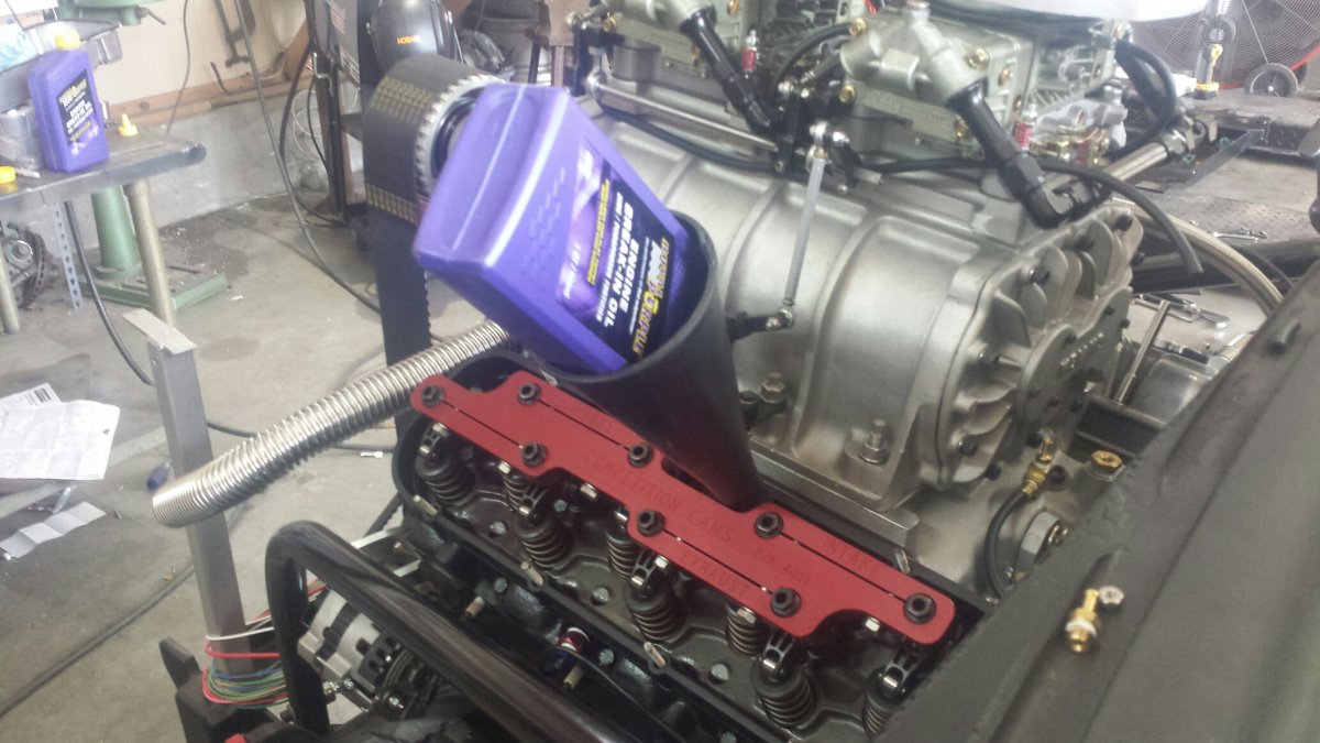

    More of the purple stuff up top today, breaking in oil. We are figuring 7 quarts with the cooler and lines etc.

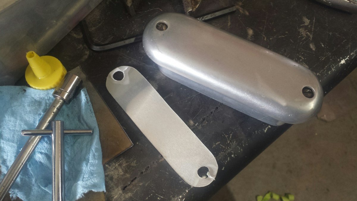

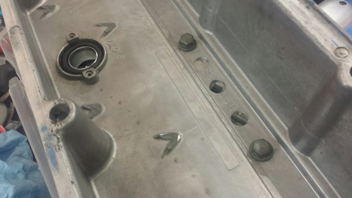

    We also had to address the valve cover vent issue (That I created!)...as usual. If you have been following along you probably remember the cool vintage valve cover vents I installed a while back.
    As you can see looking in side the cover, they were a pretty easy bolt on addition and of course, I drilled a few extra holes to make them functionals. THEN I decided to go with the crank case header evac. system. So before we wrap the top end up, I needed to block the holes in vents.
    The quickest way to do with what we had on hand this afternoon was just cut an aluminum plate the same size as the vent mounting area. Then just bolt the vents back on with the aluminum plate between it the valve cover. Easy breezy.
    After it was all back together, we took our new little tool and primed the engine. It seems to have gone really well.
    It held 60 plus pounds on the drill for quite a while with no leaks. We spent the rest of the afternoon and into the evening working on wiring which is a serious pain in the backside. Our plan is to fire it this coming weekend.

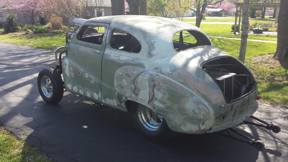

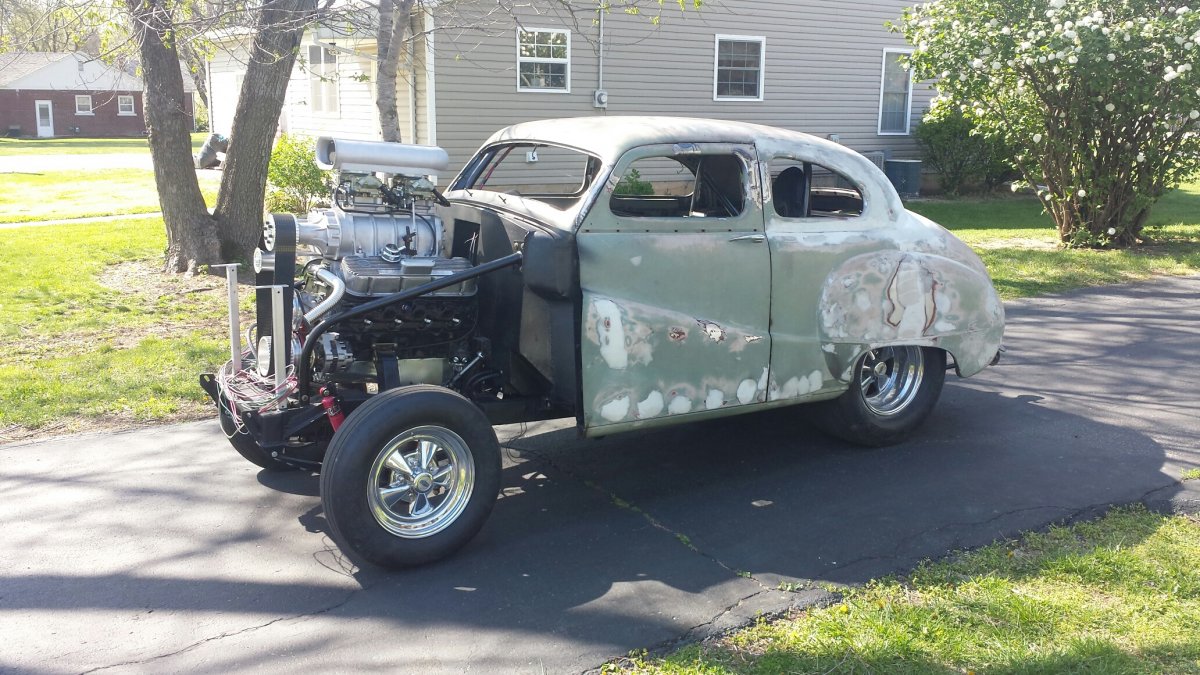

    Well at long last, today was the day. We fired the Austin for the first time. It sort of turned into a party and several friends popped over for the occasion (or at least for the Steak)! Saturday, Dad and I went to breakfast at 7 a.m. and put together a punch out list to fire the Austin the next day that took us all of 12 hours to complete. This morning all I had left on the list was check all the fuel fittings, wire up the tach, and fill it with water before the scheduled 1 p.m. start up.
    Like I said it was a normal day for us in the shop and in like fashion I started filling the radiator with the drain **** completely removed. My favorite song was blasting on the radio or I might of actually heard my error before I washed the garage floor down good. I checked and double checked all the fuel fittings (and there are a bunch of them)! All of them except two small plugs:
    I never really thought about them until we tested the fuel pump and they came to life as two large E85 geysers. Actually it would not have been so bad if the fuel regulator was not adjusted backwards. Instead of turning it down to nearly nothing, we allowed that huge fuel pump back there free range!
    After all the fuel was cleaned up on the outside we decided we better pull the plugs just incase we dumped a bunch inside as well...no sense in hydraulic-ing this thing right here in front of God and guests etc. Good call too...after doing some starter spin air drying and a bit of gentle "re-lubing" we put everything back and prepared ourselves to fire it. Dad hit the ****on and it backfired twice! Something was obviously not right.
    We pulled the plugs again along with the cap. We ran it back to top dead center and the rotor told the story, it was exactly, 180 degrees off from the original mark we had made on the intake. Way back when we set that thing originally, I was having to crank it by hand and Dad was making the call at the plug hole. Some how we got it set on exhaust...but no issue. For the moment and to prove myself right, we just put the cap back on and adjusted the plug wire placement to our new found TDC. A few minutes later and this is what we got!
