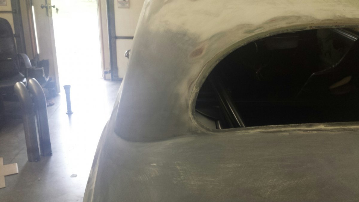

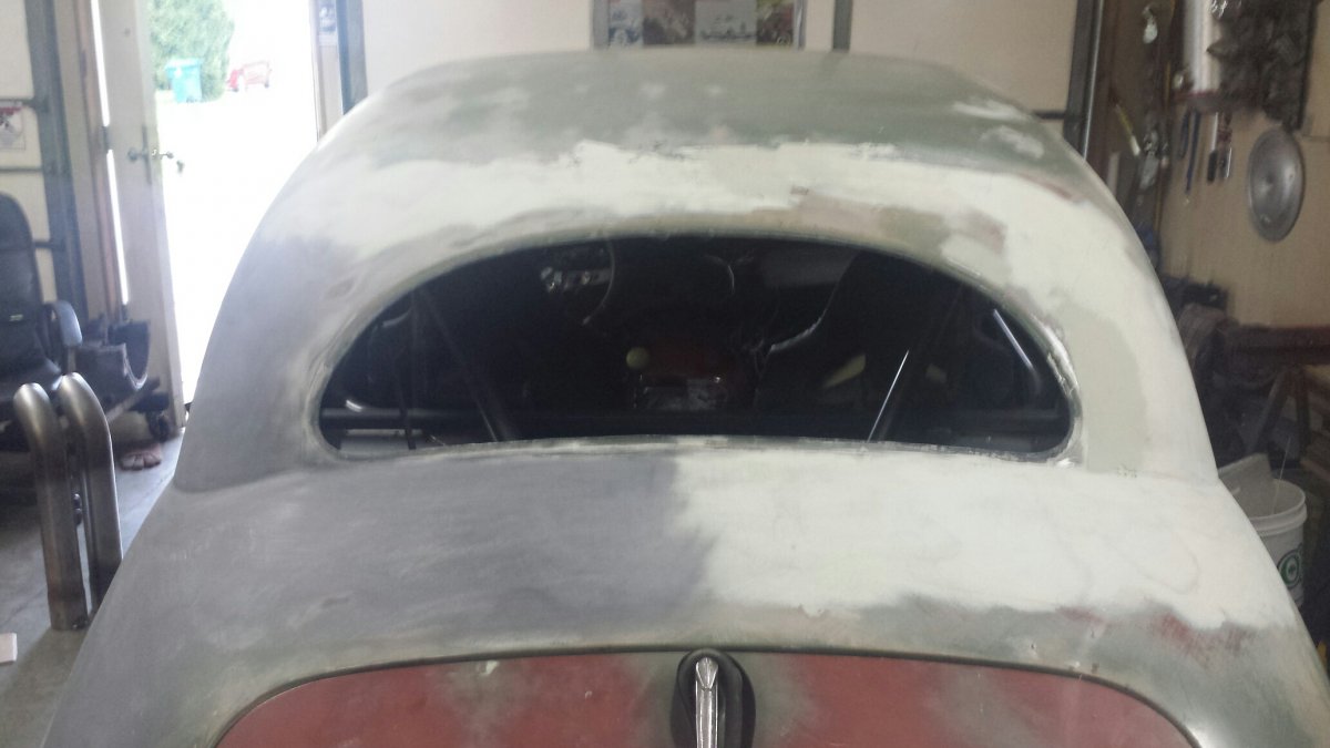

    Well it has been a while since I had a moment to catch the thread up, my apologies guys. So the next few posts here are going to be the Reader's Digest version of the last month. To begin with I have really been going hard at the bodywork (something I really hate). I finished up all of the minor bodywork related welding that I have been procrastination upon (one of the big ones is all the bright work mounting holes top and bottom).
    The biggest challenge is the rear of the roof where the extra body area was added to catch up with the chopped top. I want this to look like it came from the factory so I have been fairly meticulous (to say the least) in this area.
    I think it has paid off. The lines look really good and even though I don't have a shot of it from the rear looking across the deck, it is all but perfect. It makes me smile every time I look at it.

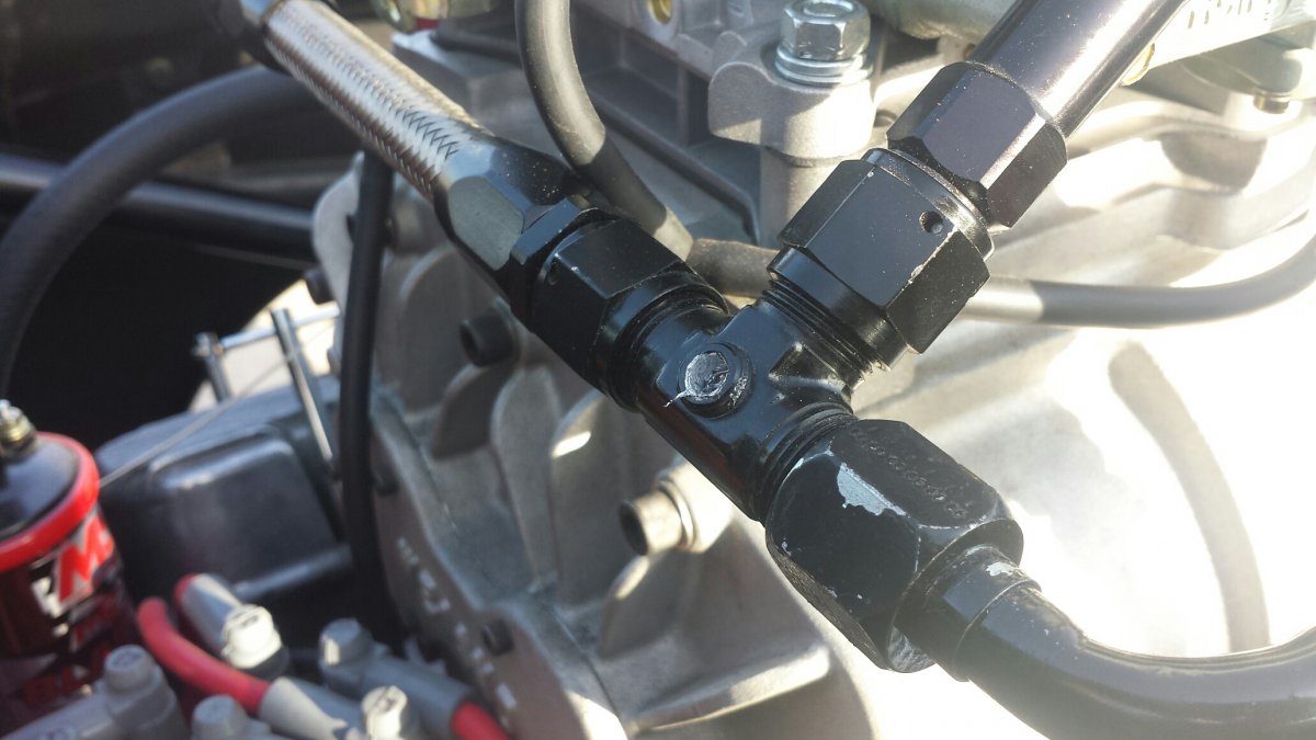

    So early Monday morning we loaded the Austin up and headed to the big parking lot where I work in Springfield. It is not as large as the High School lot but large enough to finish breaking in the clutch AND then I have free range to STEP on it here when we are done. Something the school board would have deeply frowned upon.:p

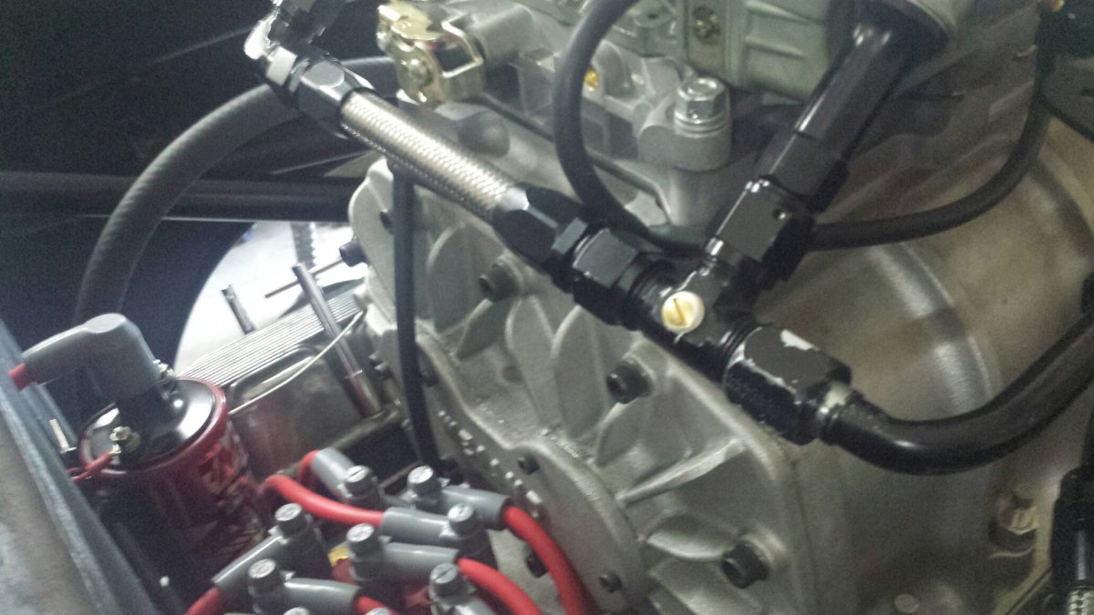

    So right out of the box, as she is sitting there warming up, I notice a small drip from the fuel rail elbow. We shut it off and sure enough, there is factory installed plug in the elbow and it is leaking a bit. We decided it would be a quick fix with a bit teflon tape. But of course you know how things go for me (so much for an early start while it was cool).
    I put the appropriate T-handled allen wrench in but it would not turn. The aluminum plug had somehow galled up in the fitting. Even with the up most finesse, all I managed to do was mangle the plug. So we took the fitting off, carefully drilled it out, re-tapped it and installed a new br*** plug from the auto parts store across the street (another advantage to this location)!

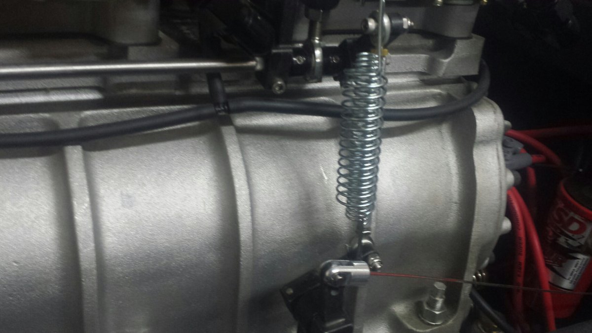

    Of course this time I installed a bit of teflon tape and soon we were back together. However while I was playing machinist with the fitting, Dad installed the double throttle spring set up. I mean if things go well this morning with the final clutch break-in session, we might want to get wacky with it. AND nothing ruins a fun day of wackiness like a throttle sticking open etc. :eek:
    Actually there is a back up spring to the backup spring we just installed. Better safe than sorry!

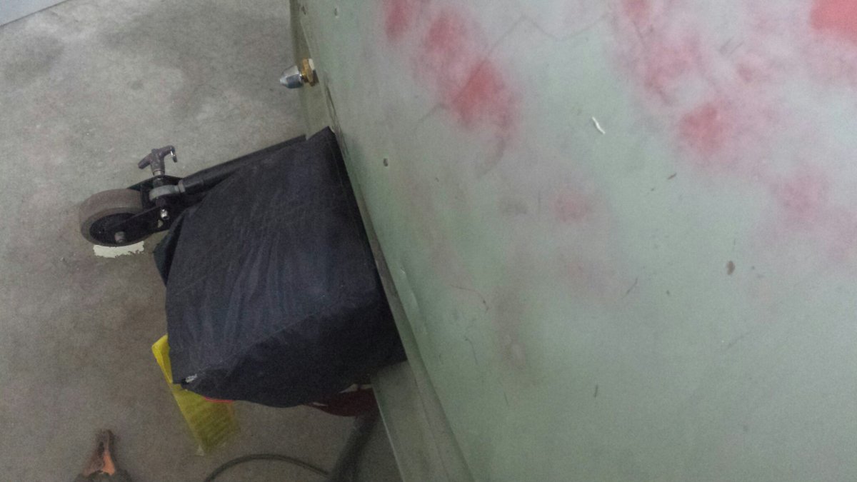

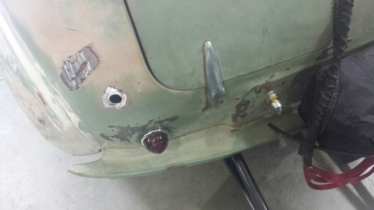

    Speaking of better safe than sorry, another issue I found that would have to be resolved before we went too hard was the power switch on the rear. First off we discovered something I hadn't thought about a couple of weeks earlier at a cruise-in with the Austin on a trailer (I know it is my pet peeve as well seeing a car on a trailer at a cruise in but I did it anyway). So we fire it up for the folks in attendance. After a few impressive revs it is just sitting there idling and I start walking to the back of the trailer. I reach up and hit the kill switch but nothing happens. I didn't let on like anything was wrong, just reached back in the car and flipped the power switch off.
    After the crowd finally dispensed a bit I walked over to Dad and said did you see that...He shook his head in the affirmative but with a puzzled look on his face. Everything ran through that switch, nothing had any power when it was off but there she sat still running anyway.
    After we got it home and thought about it a bit, it was the alternator. It is a single wire alternator and just like every other alternator on the planet runs down to the starter (which is of course is well after the shut off switch). When the car was running, it was of course spinning the alternator which was suppling the electricity. When we shut the switch off, the alternator was still suppling power (aft of the safety switch). After removing the alternator wire from the starter we tested the theory and sure enough it was dead when the main switch was off.
    I then beefed up the wire size a bit and ran it from the alternator all the way back to the battery side of the safety switch. But that is not what I started to say here. What I noticed after installing the battery was one of the poles on the switch was extremely close to the battery. In fact so close that with battery not being tied down it had actually bumped it a bit and put a scare on the side of the battery case.
    Not that I needed anymore bodywork on this crazy project but it was clear the switch had to be moved.
    As you can see we simply moved it over to the flat area (that used to serve as the British License plate holder) near the parachute. You might also notice the chute cable coming out right there as well as this past weekend, I installed the cable systems from JEGS.

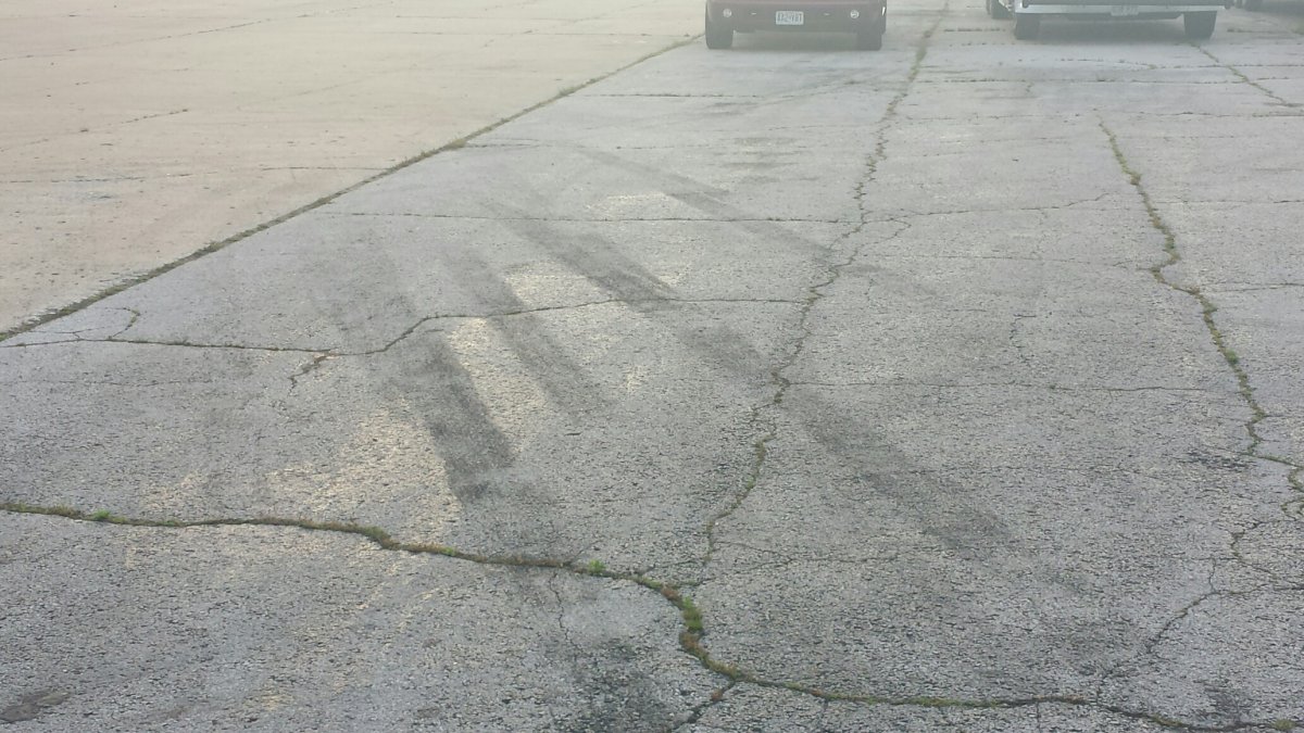

    Just so you know, the old parking lot was pretty much a disaster as far as surface. There was absolutely zero traction not to mention we had the slicks pumped up with 25 pounds to simply drive it and break in the clutch. But it still felt awesome. I did several of those 2500 rpm mini launches and did not rev it past 5,000 after dropping the clutch. It went straight as a string every single time.
    I am very happy with its performance and can not wait to get it to the track to really start feeling it out. Which might even be this Friday night at the weekly Test-n-tune. Nothing too crazy, just a few burnouts to make sure the line lock is working and then a few 60 foot launches to see how she hooks etc. You have to take stuff like this crazy slow with any project, but especially with a supercharged 92" wheel base, straight axle missile! :eek:

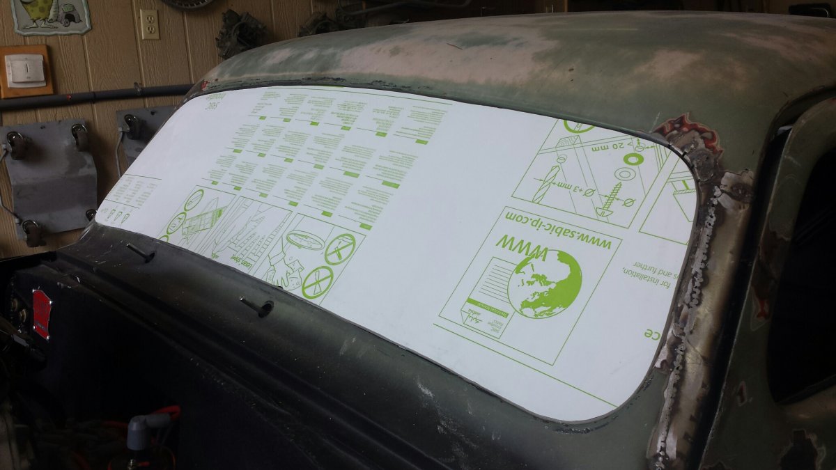

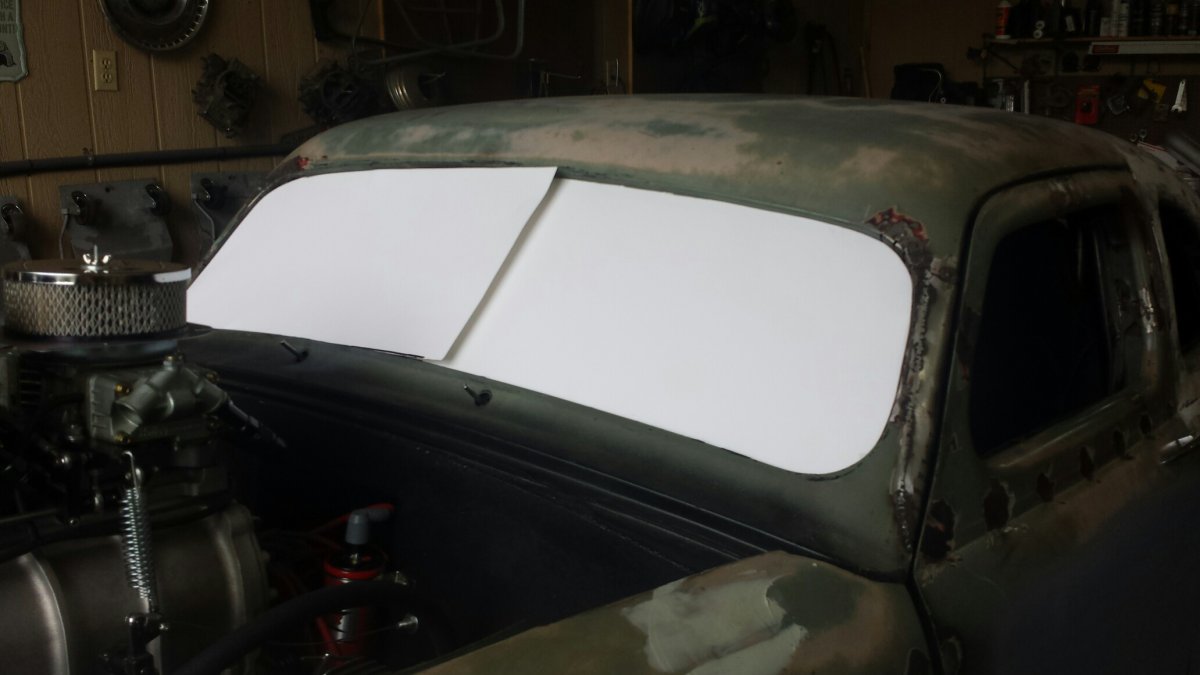

    Saturday morning I got out the poster board and mocked up the windshield. It took a few edits but after a bit I was happy with the fit.
    Afterwards we laid the pattern on a piece of .25" Scratch resistance Lexan, traced the pattern and then cut it out. Even though the protective covering said not to cut it with a jig saw, that is all I had. We did however pick up a very thin fine tooth blade meant for cutting thin metal. It worked like a charm. We carefully fine tuned it with a hand grinder with a sanding disk on it until it fit like a glove.
    We did same on the rear window.

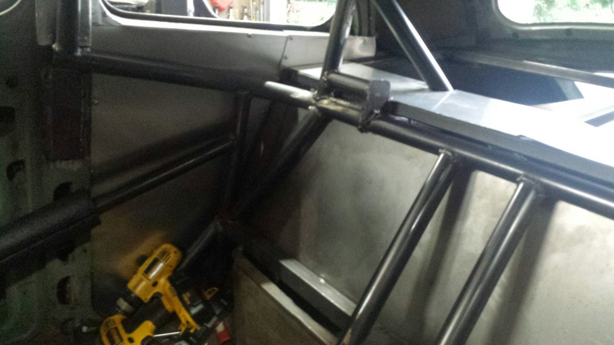

    We also started the interior tin work (or aluminum work if you will). I am so sore today I can barely move. You nearly have to be a contortionist to work on these areas inside this little car, especially with the cage in place, ....AND I AM NO CONTORTIONIST! :eek: I spent the entire afternoon bumping, bruising and cursing about every 10 seconds, I can hardly imagine what the neighbors thought was going on in the shop!

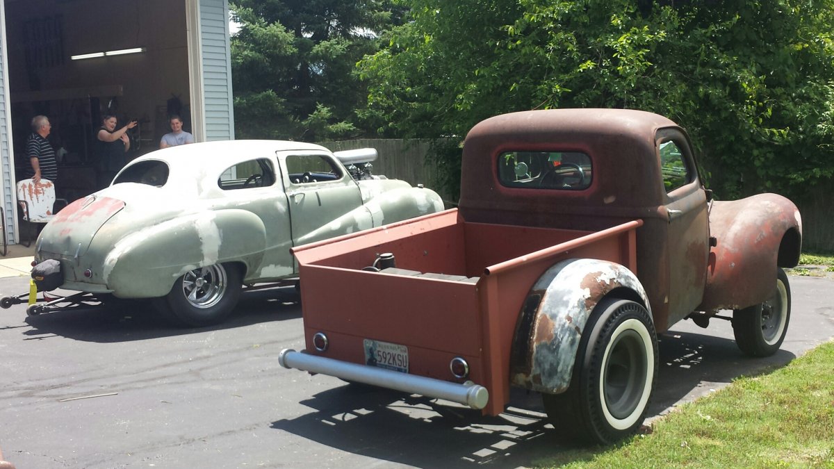

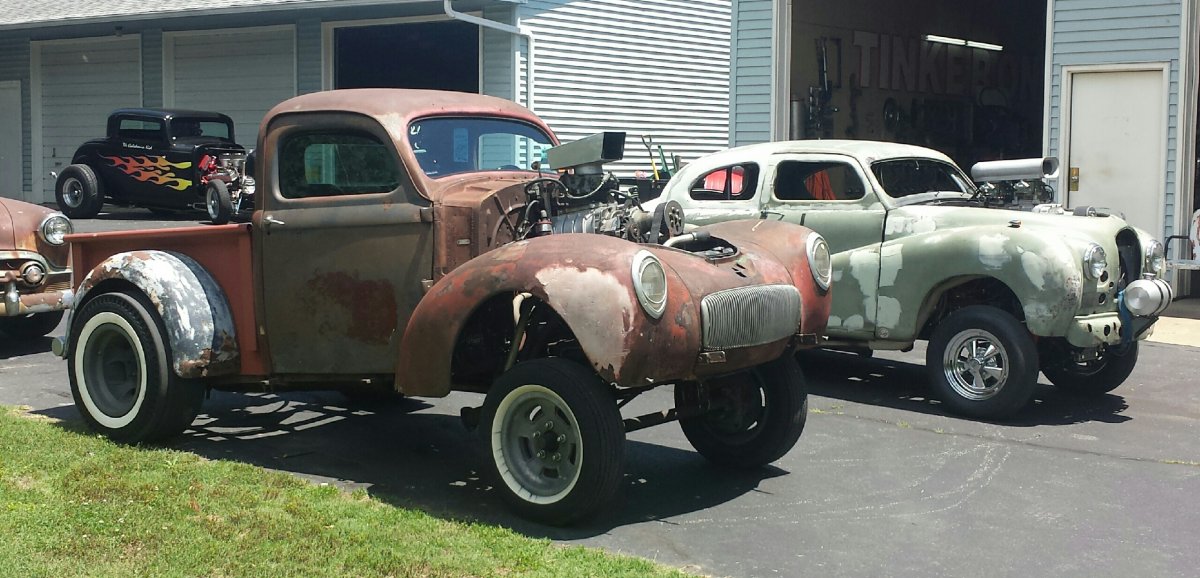

    Fellow H.A.M.B. Member WRENCHBENDER dropped by Sunday with his killer Willy's Truck and we had a little impromptu G***er show in the driveway. Nice to visit with you Jackson!
    Check out the exaggerated stance on the Willys....LOVE IT! If you remember way back, when we first sat the Austin body back on the ch***is it had that same crazy nose up g***er from hell look. But because I sat so far back in the car, I couldn't see anything. Jackson however sitting much closer to the dash etc. can probably still see better than I can in the Austin even after we made the adjustments.
    Holy cow that was a LONG TIME ago (above photo from page 1 of this build thread)....

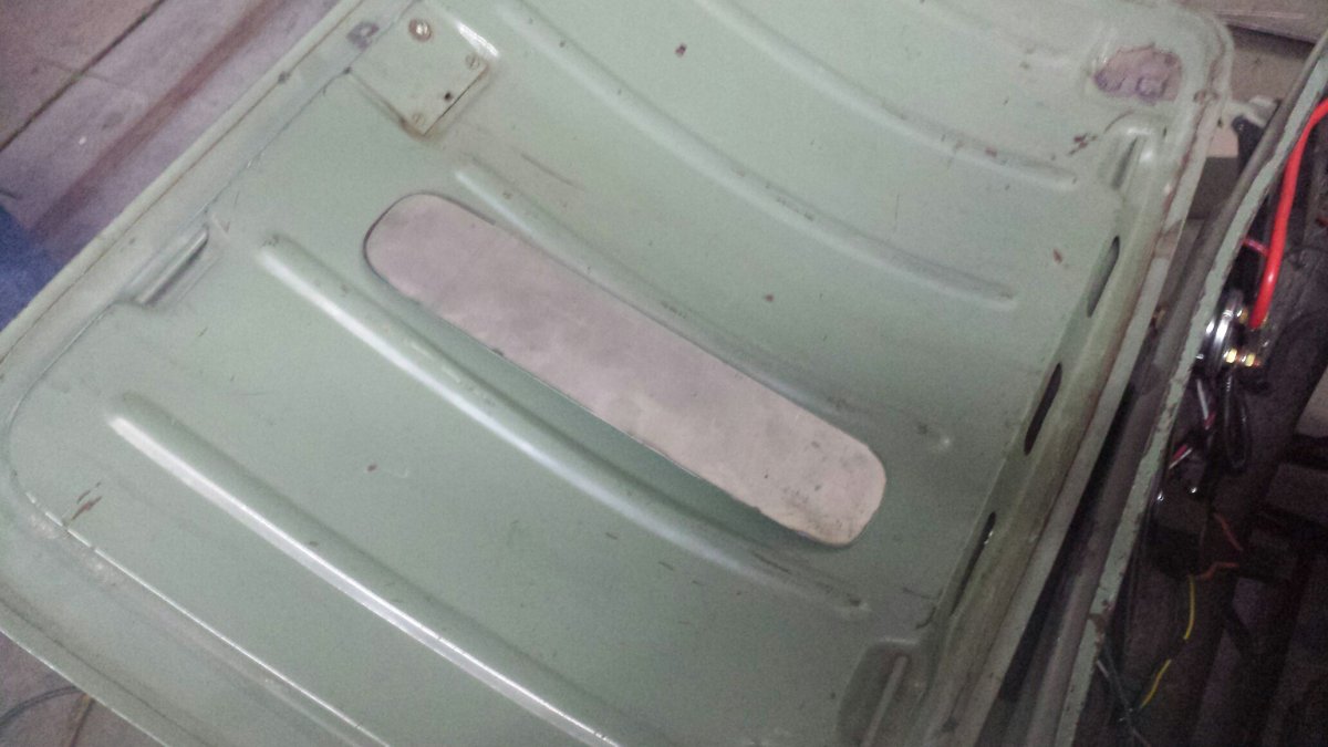

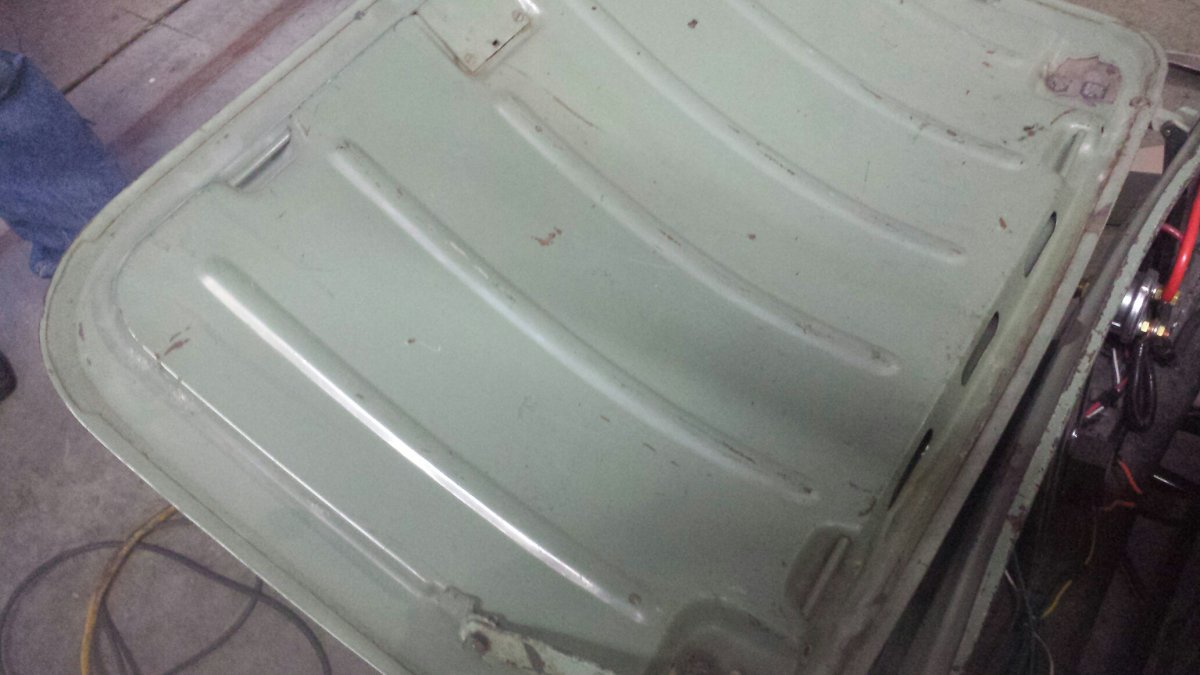

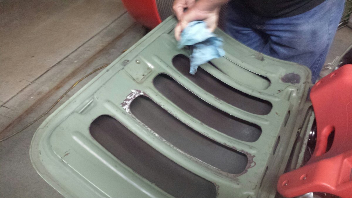

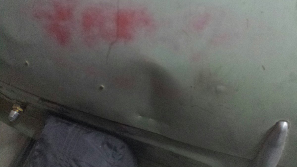

    Hanging in the shop tonight and decided to tackle the big dent in the deck lid (or boot to be British Correct...LOL)
    Anyway the big issue for even getting to the dent from the inside is the full inner skin.
    We decided to cut a few holes in the inner skin (basically make it look like we are lightening up the body)...
    I took the plasma cutter and made a sheet metal pattern to follow and cut out the inner skin area in sections that match.
    After cutting the patterns out we were able to get to the dent and work it out. Not to mention we did lighten the trunk lid by two pounds. Which, if I have done the math right should shave at least .0002 of a second off my ET! :p
