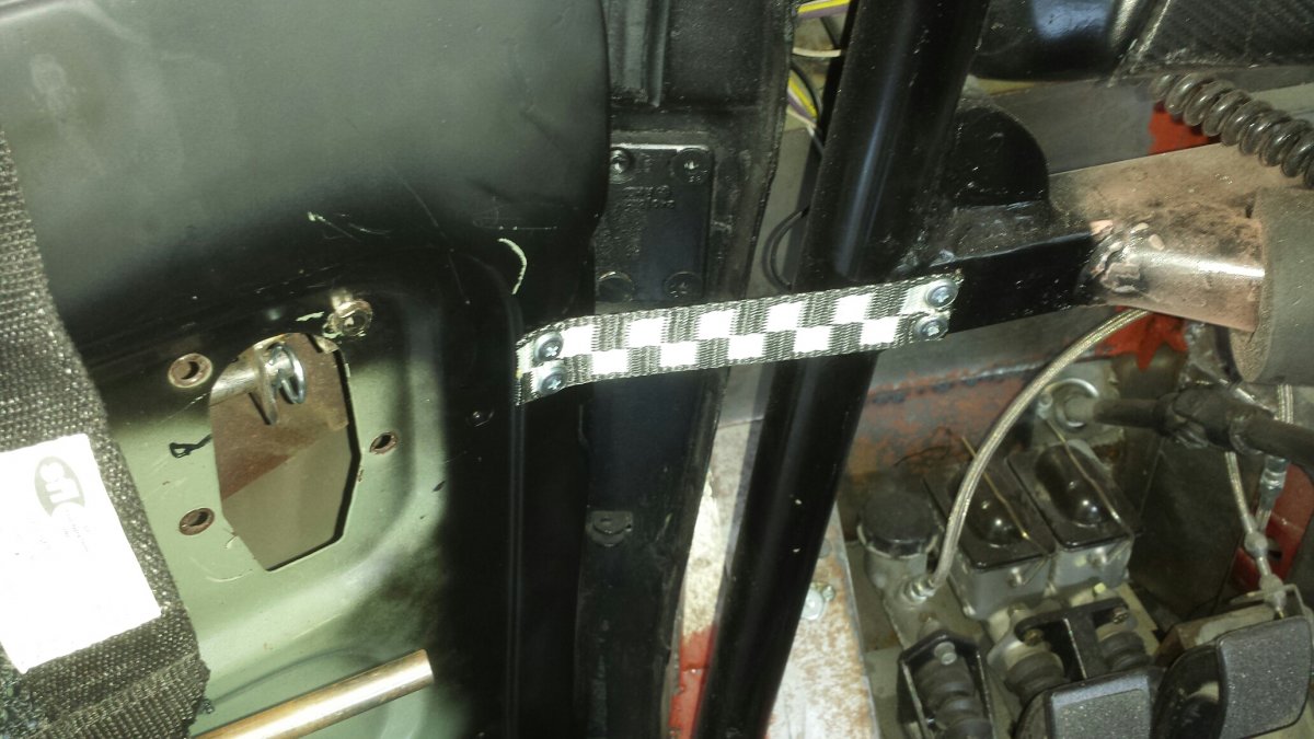

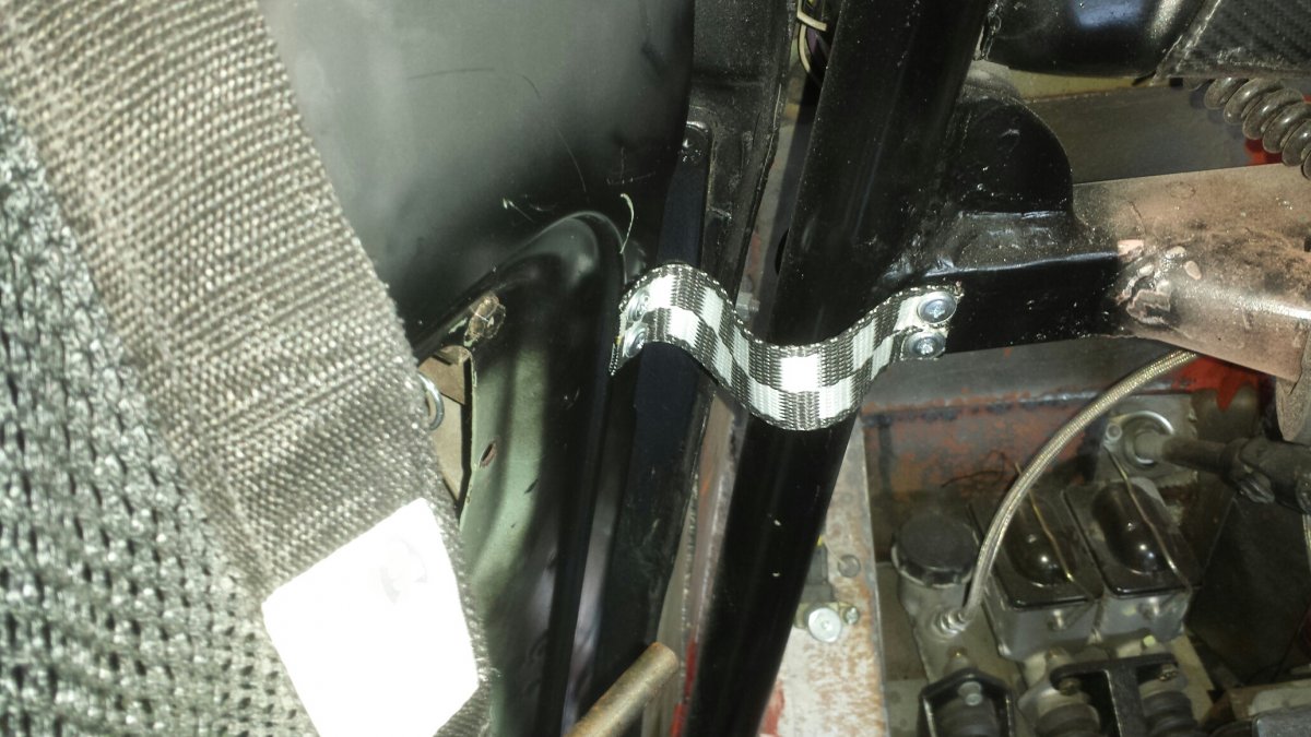

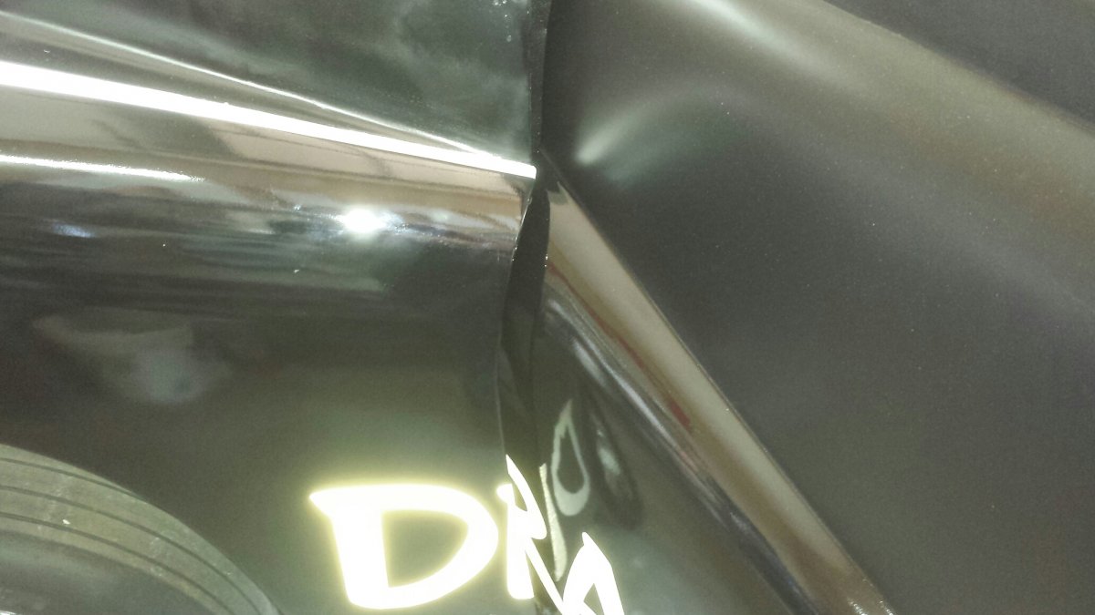

    It is crazy hot in the shop today but we piddled around a bit before heading to the AC and watching the NHRA broadcast. One issue we have had is the doors, that sort of open into the front fenders, have swung open too far and creased the door skins. To eliminate that (now that we have a nice finish on both) we added a strap.
    Pretty simple fix using some of the strap material left over from locking the battery down out back.
    But they will prevent the doors from taking a shot from the fenders and vice versa.

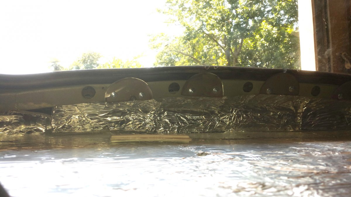

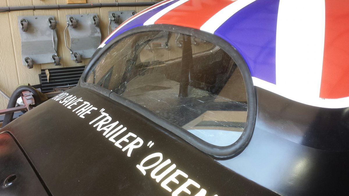

    We also got the rear window installed. Remember, that opening was not touched. While we chopped the top, we installed the rear window section with no changes. So that meant we could use the original style rubber etc. which I got from a parts place in Kent, England. After cutting the window out of the same .25" Lexan as the windshield and side gl***, we installed the rubber around it and then old school installed it with a "soaped up" string.
    That was way too easy was the thought running through my head as we stood back admiring it. It proved me right a few seconds later when the Lexan with very little pomp or cir***stance it popped out of the rubber and landed on the newly installed interior deck area. Apparently bending the .25" Lexan to fit the contour of the original gl*** was too much for the rubber to hold.
    So we quick created these little steel half moon plates. We removed the rubber and reinstalled it on the Lexan piece. Then we reinstalled the rear window again (not as easy as the first round but we got it back in place). Then we installed the plates on the lower window frame to put pressure on the rubber seal and help keep it and the Lexan conformed to the shape. Easy breezy.

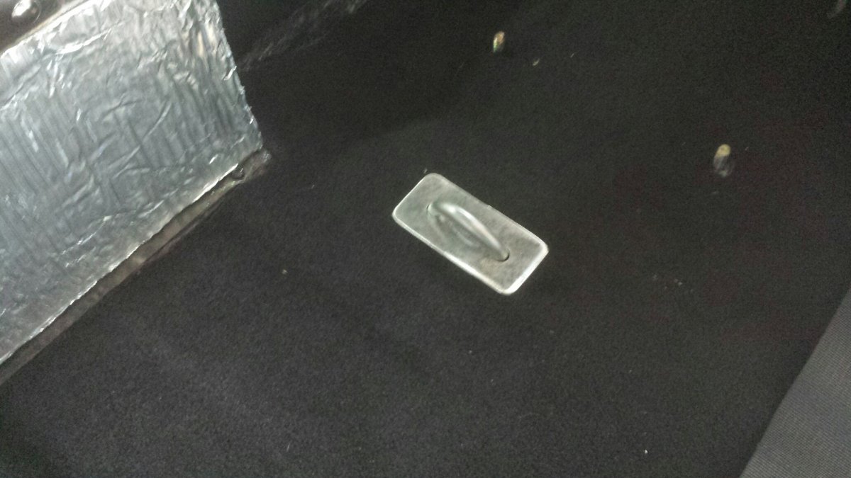

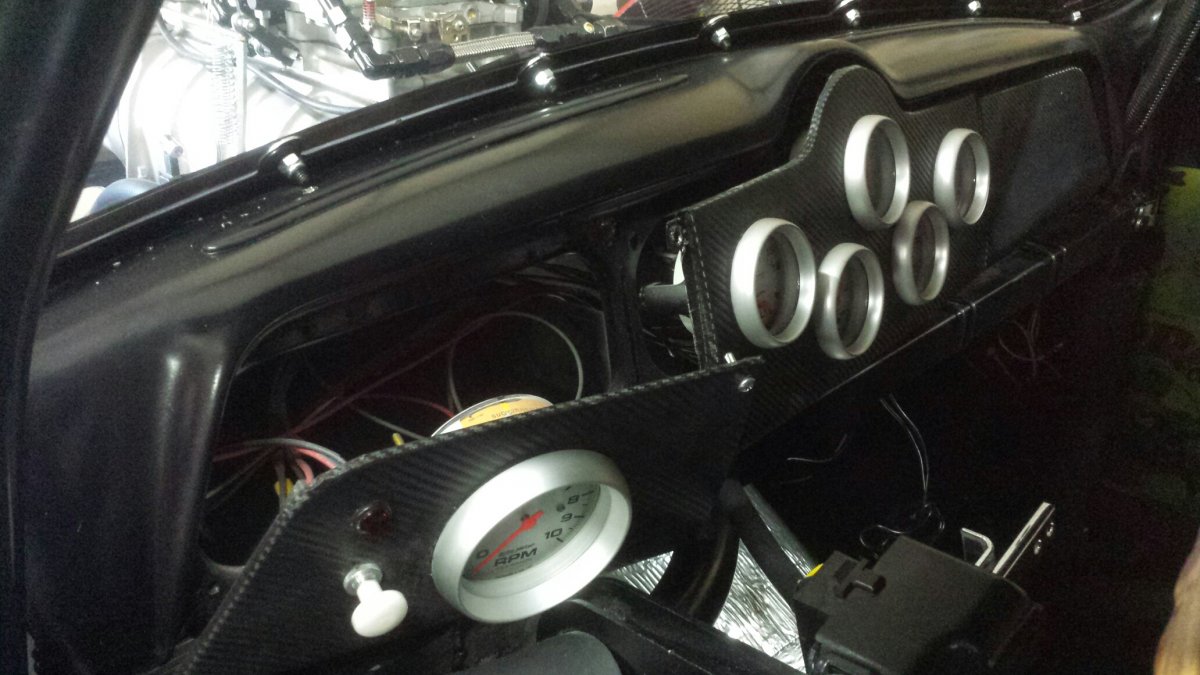

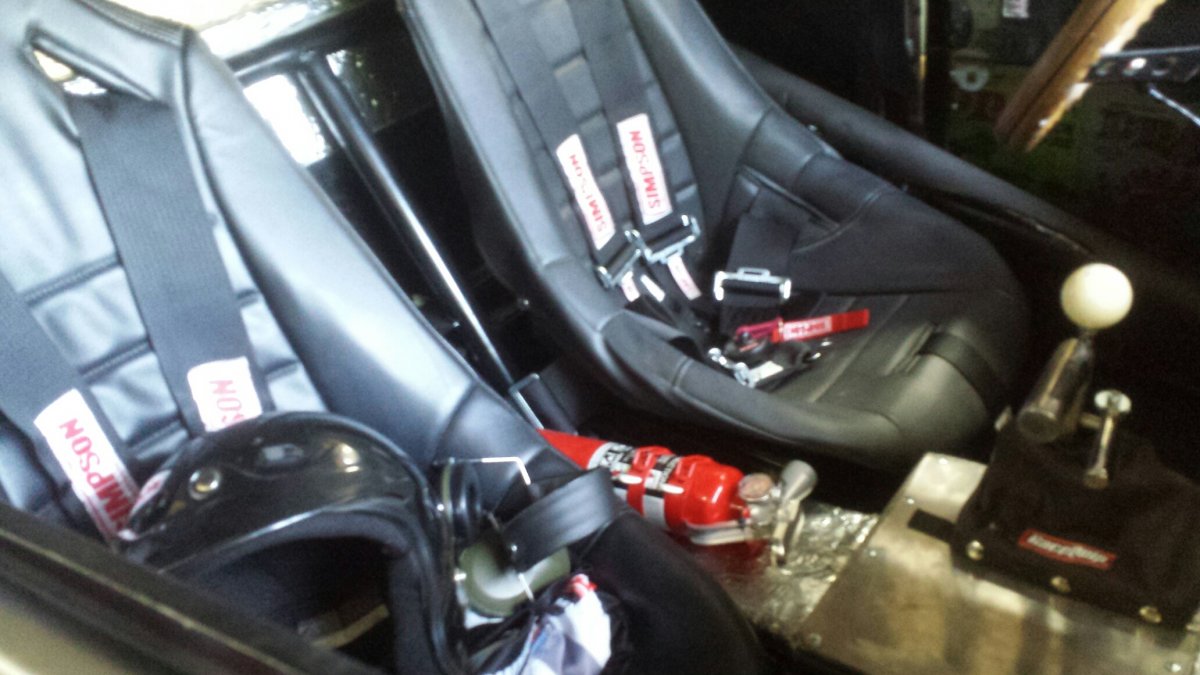

    So with majority of the exterior basically complete (not perfect) but complete. We finally headed in doors. Originally we planned to drill holes through the floor pan and mount the seats. However between the original ch***is and "X" member plus our additional strengthening measures, not to mention the ladder bars etc. it was virtually impossible to find four mounting holes that could be accessed from underneath. So we took .25" steel plate and drilled it for the mounting hole pattern. We inserted grade 8 bolts and welded them in place. Then we welded the plate inside the cabin.

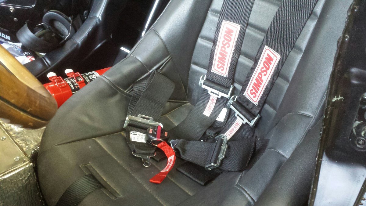

    Up front of the plate we also drilled holes for a heavy duty 5/8" U-bolt to mount the lower crotch belt from the Simpson 5 point harness. Above you see the down bars from the cage where the lap belts mount.
    Above is the floor just before mounting the seats. The U-bolt has one .25" steel plate up top and another under the floor, sandwiching the floor pan between them and pulling the U-bolt tight. And yes that is carpet. We had just enough left from Dad's coupe interior to cover both driver's and p***enger compartments on either side of the console.
    Seats finally in for the last time (for a while anyway). The Simpson quick release belts are in place and adjusted to fit (which was a serious pain in these tight quarters).

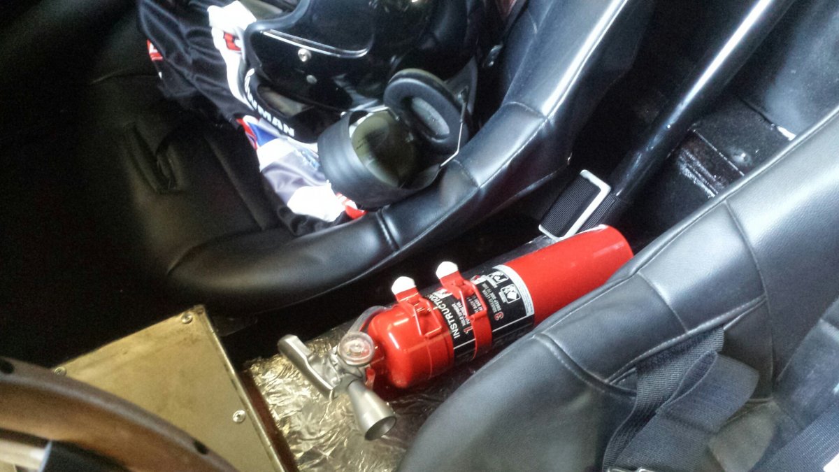

    Fire Extinguisher is installed with easy access between the seats.

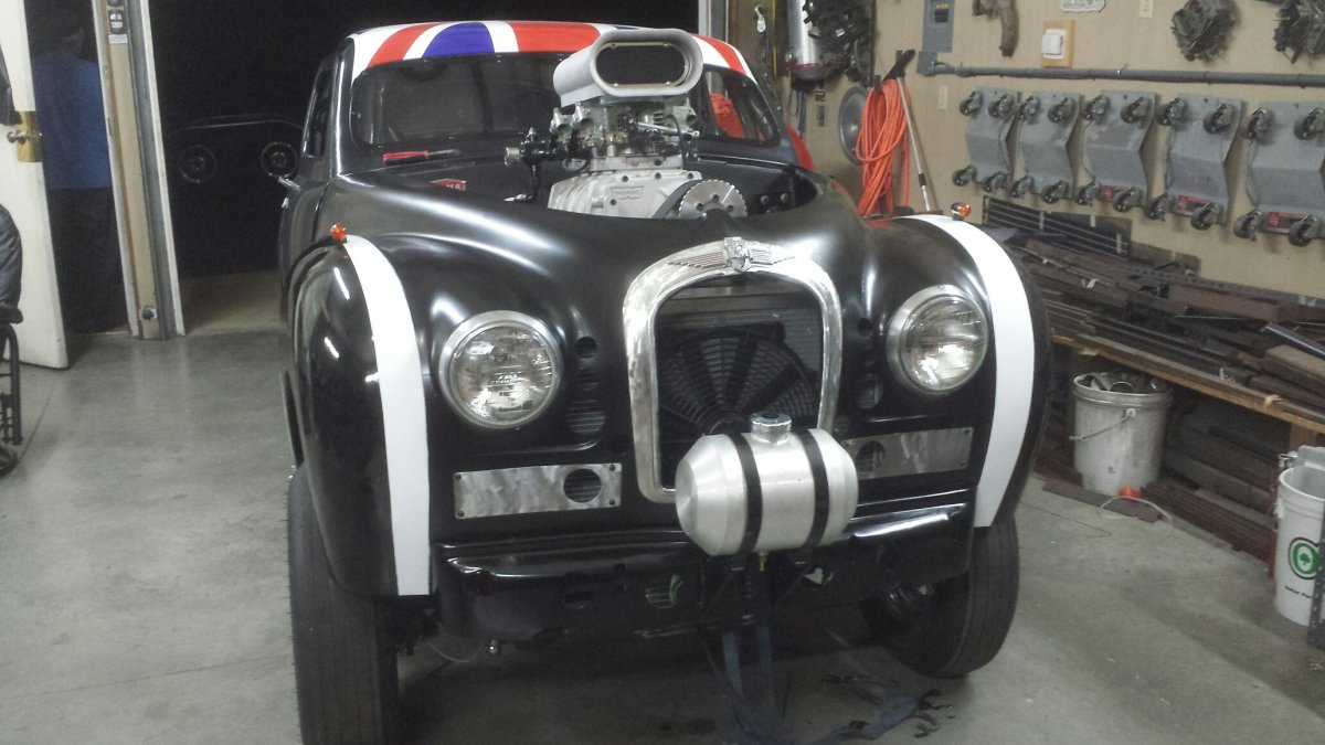

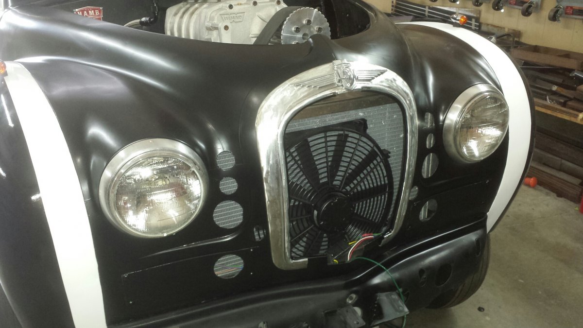

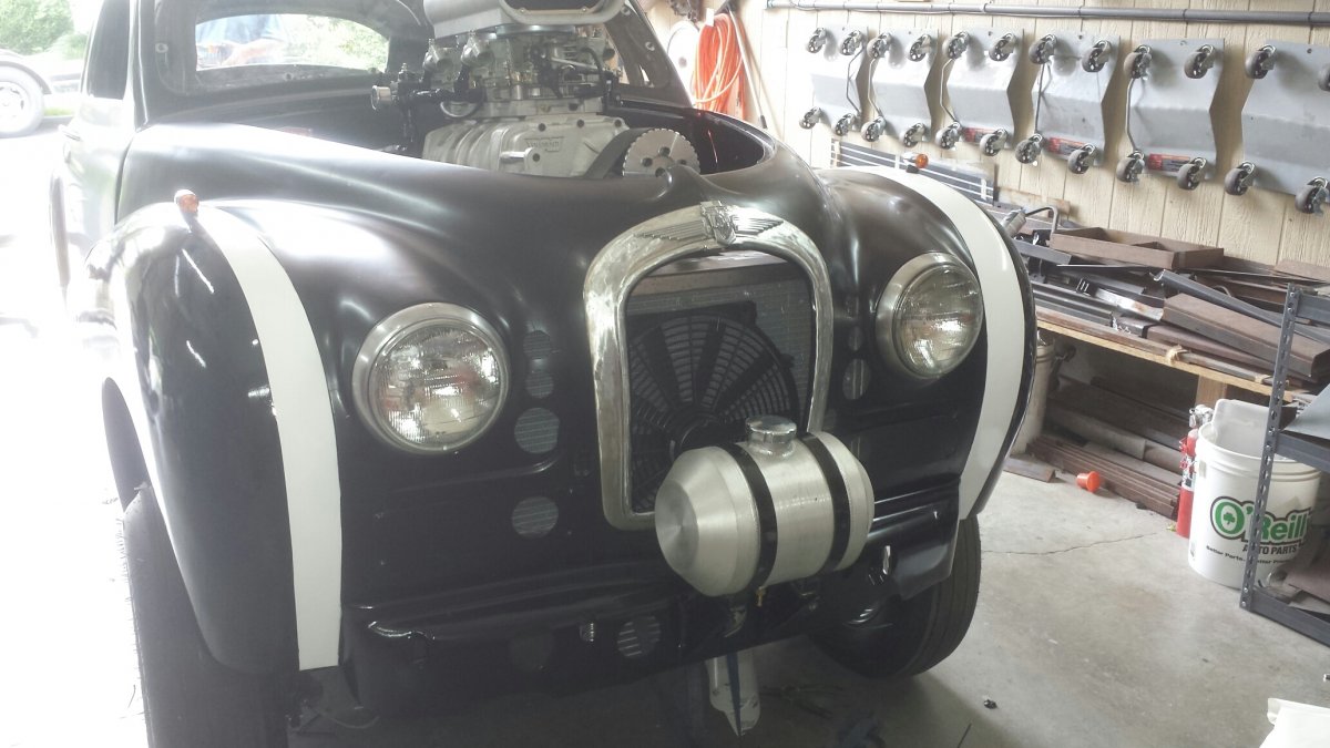

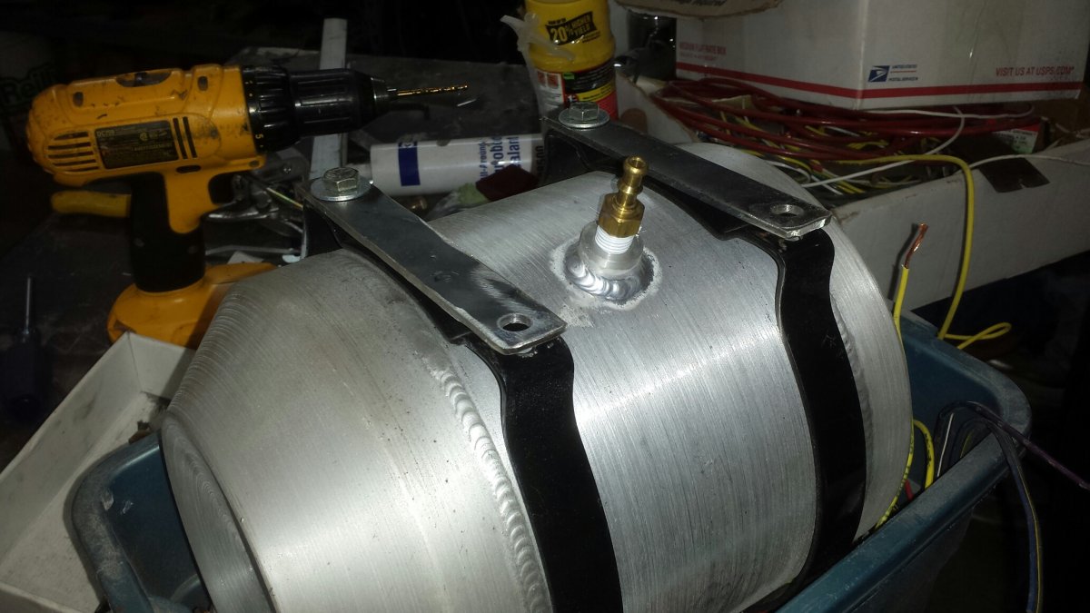

    Back outside and up front, we got the headlights reinstalled and the modified factory grill (minus the grates) back in place.
    20160714_165516.jpeg We had few other minor projects up front as things were going back together. One was installing a 3/8" hose barb in the bottom of the spun aluminum tank. It will not be a fuel tank for the little g***er but at least it will be more than ornamental. We will use it as an radiator over flow tank.
    With the tank back in place we finally get a look at a nearly finished nose. It seemed very dark up there, especially since we had decided to black out aluminum vent slot covers.
    We removed them and the black paint. After they were reinstalled we were very happy with the end result.

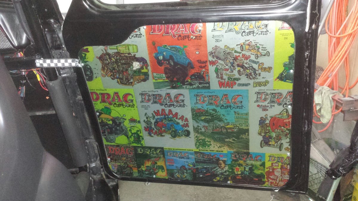

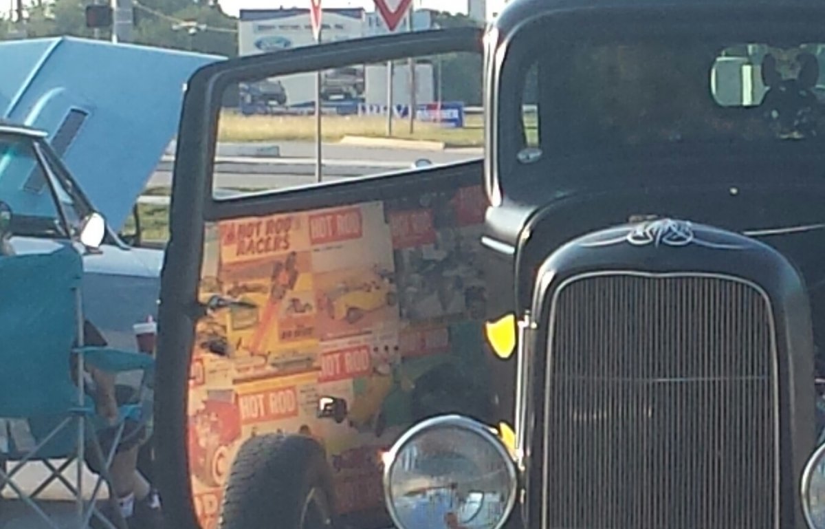

    Check out the door panels. On Dad's original RPU that he totaled I had created him door panels with vintage Hot Rod Magazine covers printed on Aluminum. It was a very popular attribute to the car. As we were working on the 3 window coupe I made him another set using many of the original art pieces from the RPU...(by the way that is what I do for a living, large format printing).
    I wanted to do something similar for the Austin but didn't want simply duplicate the Deuce Coupe doors. I started looking for G***er photos to put together a montage etc. But then I happened to discover some covers for Pete Miller's DRAG Cartoon magazine. I couldn't help myself!
