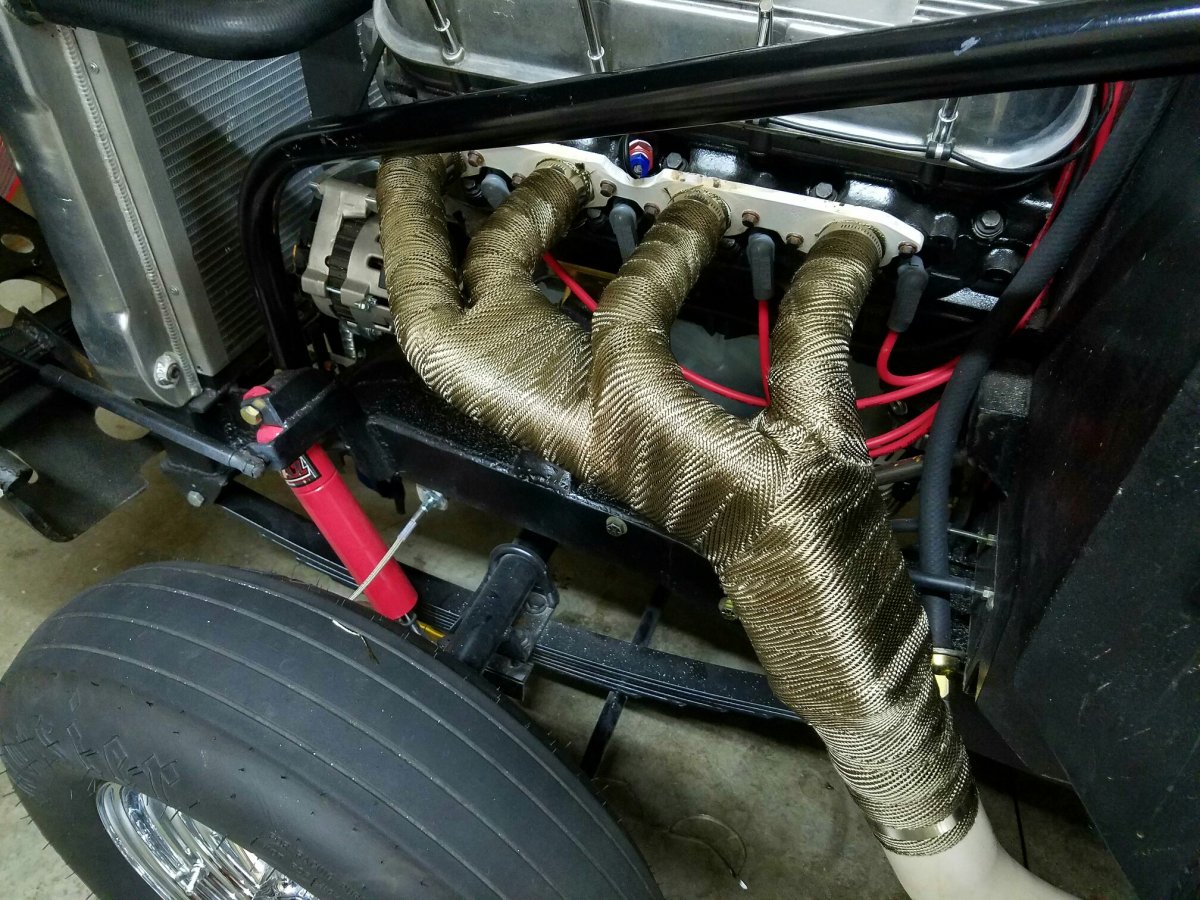

    So a couple of things planned for this week. One (not necessarily a water cooling issue) we are going to wrap the headers. Two things here. First off it will cover up the disasterous finish but more importantly it will cut out at least 50% of the heat in the engine compartment and that would be huge. While it was running and I had the heat gun, it was amazing how much convection was going on in there. So here is what I got to address some of it.
    Two rolls of DEI ***anium wrap. This stuff is supposed to be pretty cool (no pun intended). The fibers are infused with lava rock dust...we shall see. Meanwhile, back to the water temp issue. I am going to wrap that sensor with some of the header wrap as well to make sure none of the heat soaking is coming from the outside. With all that in the works, I am still not happy with the pusher fan. If you remember, the "Blower Audible" caused us to hang a killer set of Derale dual fans on the wall. They were around 2,250 cfm each but NOT reversible etc. I searched for the most powerful pusher I could find and settled on a Flex-o-lite 16" fan boasting 2500 cfm. However I knew the first time I hit the switch there was no way it was pushing that much air. Last night I pulled it off and bench tested it right beside one of the 2250 cfm Derales (off the wall)....no comparison. I spoke with JEGS about it and they agreed to take the Flex-O-Light back and I have two nearly 13" Derale 2,000 cfm pusher fans on the way.

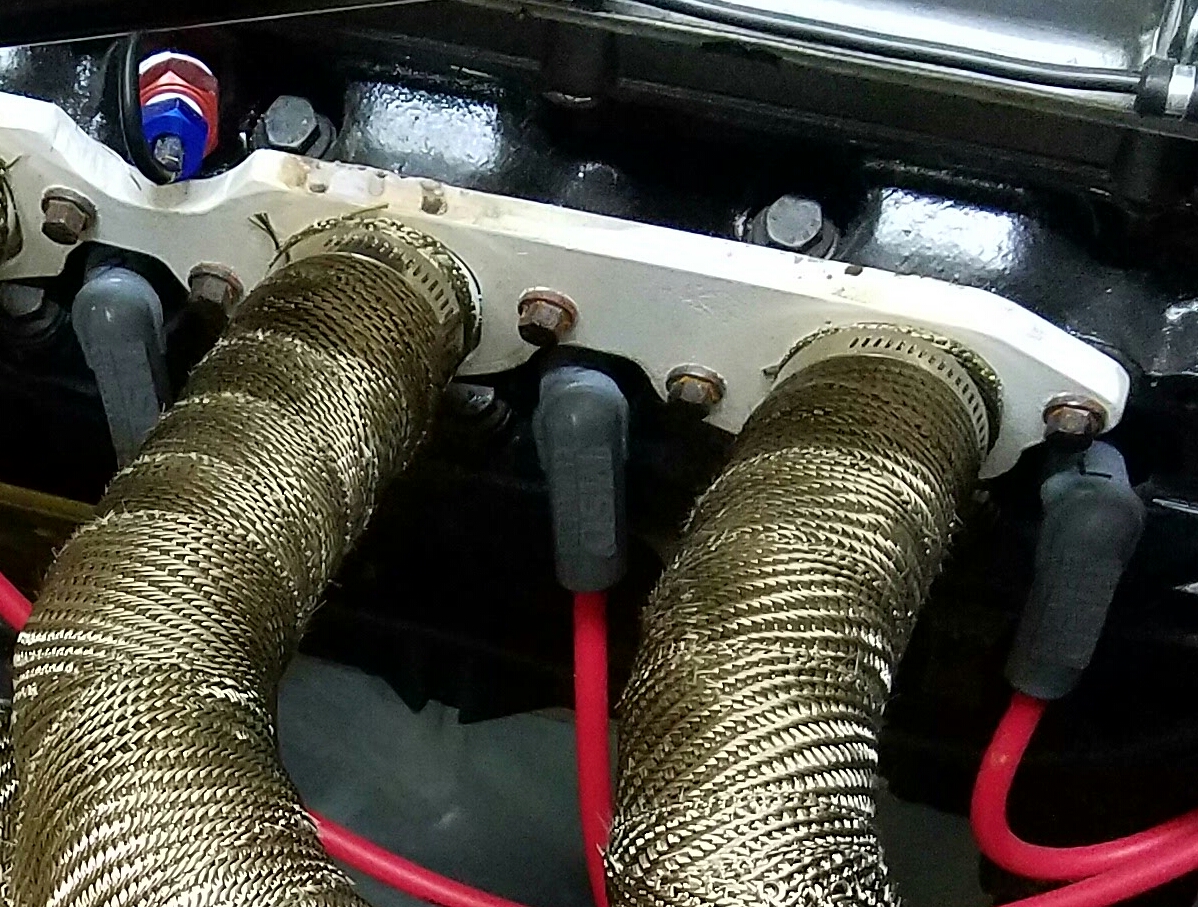

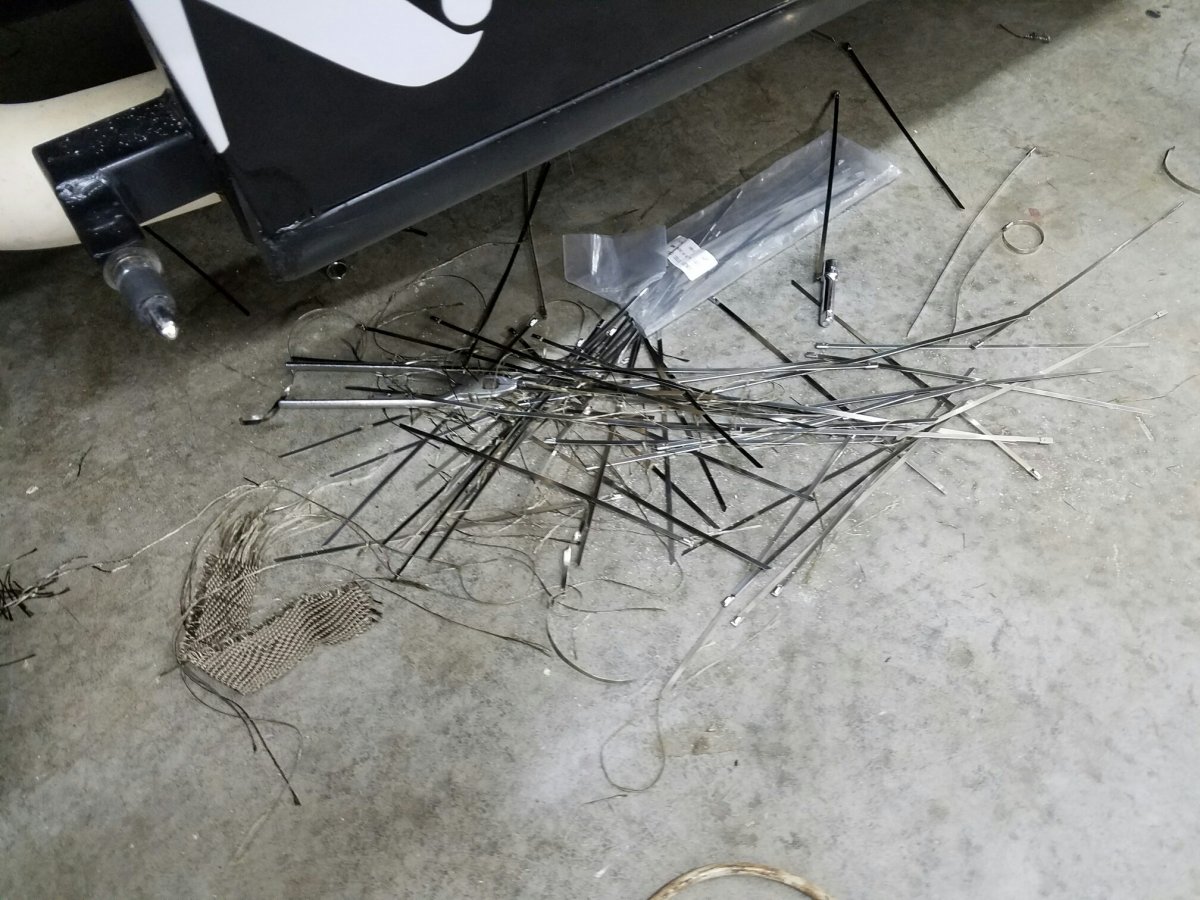

    So last night I decided to take on the header wrap. You know I hate to say it but I am a bit of a perfectionist and nothing will cause flying tools in my shop quicker than something seemingly simple that I can not seem to get right. First off this high dollar **** will unravel like a cheap shirt at the drop of a hat. AND secondly, these little pieces of garbage are completely useless!
    You can not tighten them. I must of spent half the night trying to figure out a way to actually pull them tight with out destroying them. I finally gave up and much to my chagrin put simple worm gear hose clamps at the beginning of the runners and a big one down on the collector. Honestly it does not look as bad as I thought it was going to.
    But I went my own way when it came to the install. I figure if these idiots can't make a stainless zip tie that works they got no business writing the installation instructions! :D On the back three tubes I started at the head and worked to a point where they came in contact with another runner. Then I started at the collector and worked up securely embedding the loose ends from the individual runners. When I finally got to the point where the front runner broke away I simply finished wrapping it to the head. In the end, I really like the way it came out. It is very close to what I was hoping for... NOW lets hope they do your job as advertised!

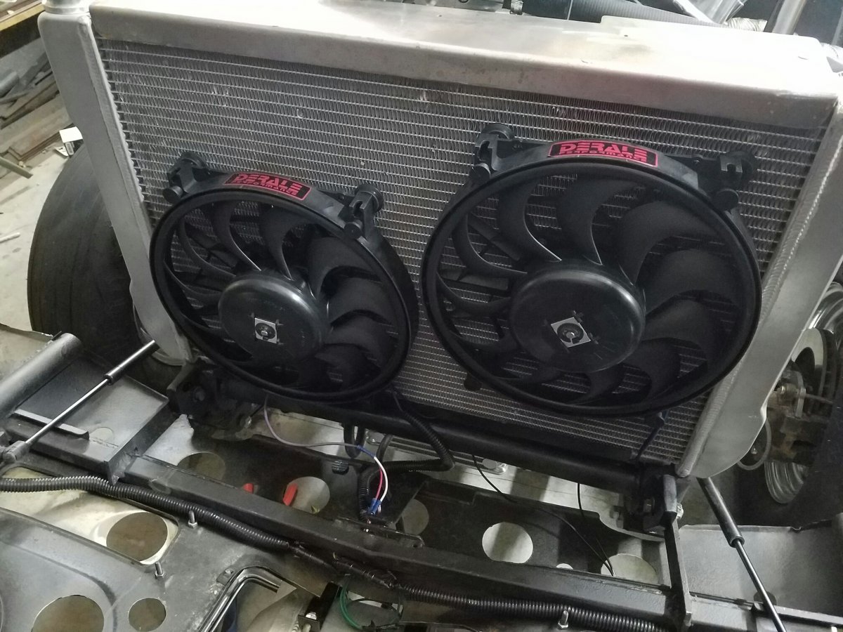

    We drained the royal purple break in oil last night so ready for real stuff. It was really clean so good news on that front. The fans are supposed to be here today so we have our plate full tonight. We are going pull the carbs down real quick just to double check the jet size (peace of mind). We are going to install the fans and wire them up. Change the plugs, Oil filter and Oil plus bump the timing a bit to around 34 or 35 total. I bought a Nomax wire loom heat shield so I am going to run the water sensor line through it all the way down to include the adapters in the head to ensure we have no external heat soaking. If we still get messed up gauge readings compared to watching the head with a heat gun, we may move it to the intake. If we do, I am going to put it in one of the rear cross over holes and then plumb the other hole back up front to water pump. I have heard that can relieve a bit of heat as well.

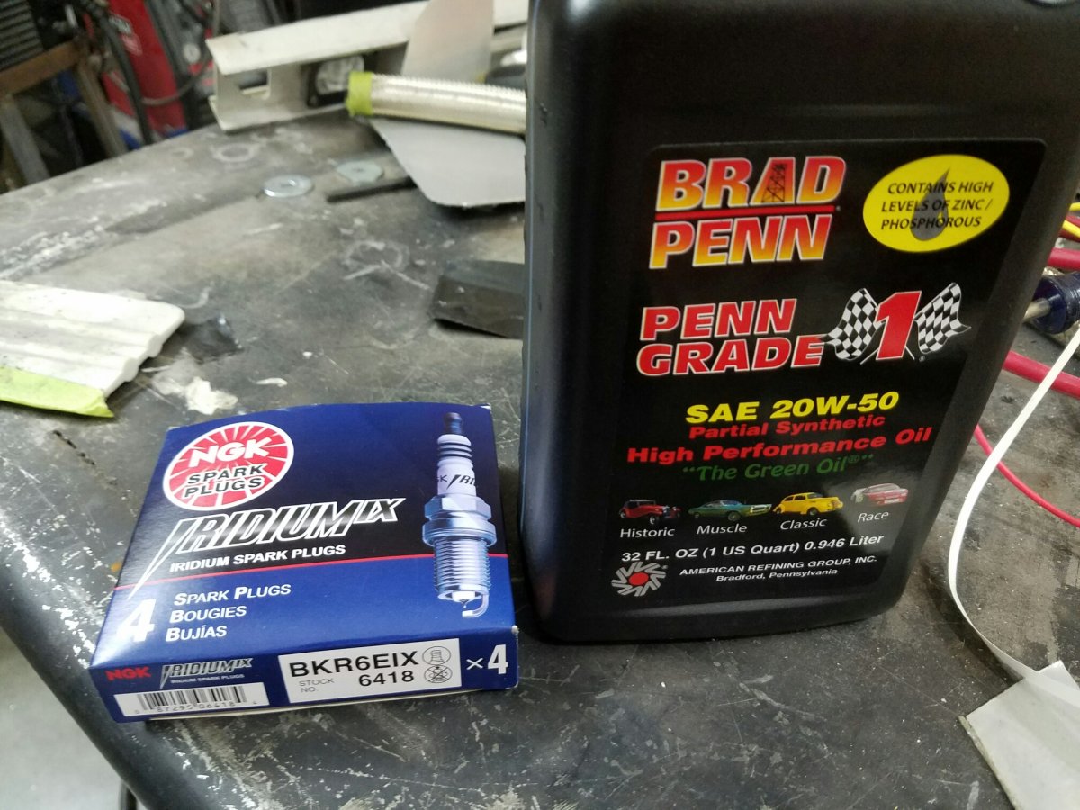

    Well we got a lot done last night including oil and filter changed. After looking at lots of racing oil on the market I decided to go with a Brad Penn. So from Royal Purple break-in to the "green oil." I am kind of laughing at the fact that according to my color mix chart with the residual break-in still in there mixed with the new stuff, I should now have a rather normal colored oil.:p
    I really debated hard on the plugs, probably way too much more than warranted. But I finally decided to go with the NGK expert's direction. I mean what is the point of asking an expert and then trying to second guess him. I nearly went with a step colder and a copper core etc. But anyway there they are...we shall see.
    The new fans are on and tested. I would say conservatively we have more than doubled our cfm. That is the good news...here is the bad...at least for testing tomorrow tonight.
    To error on the safe side, we decided to the take the secondaries off, remove the power valve, plug the hole and bump the jets ten steps. So boost referenced power valves on the primary with 86 jets and no power valve in the secondaries with 97s. I mean it starts and idles so good I figure why mess with primary side of things. At least not until if and when the O2 Sensors says we need it. Besides it will do its share of street cruising and boost referenced power valves will make that much smoother.
    So I am off this morning (good luck) to try and run down 4 number 97 jets and two of the thin power valve block off plugs.
