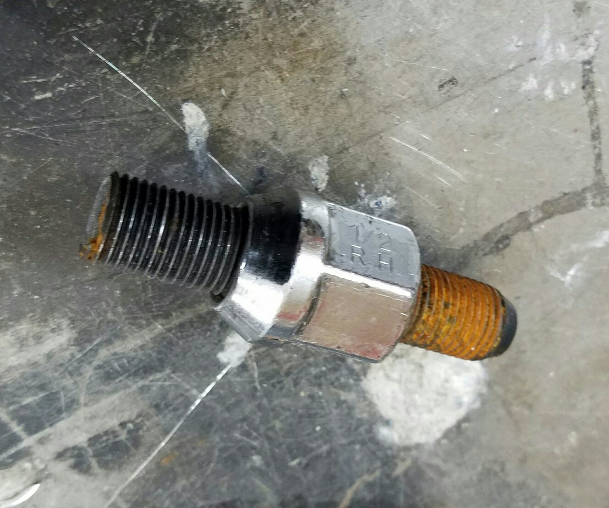

    Not exactly what I thought I would doing this evening!
    But while mowing the yard this afternoon, Dad found this:
    Yep that is one my wheel studs from the driver's side. Looks like we did not have the rear lugs torqued down. It was checked off my knock out list from a month ago but obviously not. Broke the one and bent two more on the same side. What a pain in the back side to deal with...and you don't have to say it...YES...I am contemplating how nice a radius wheel well would have been!:rolleyes:
    Fortunately we did not damage the rims etc. Just have to replace the studs and put it all back together.

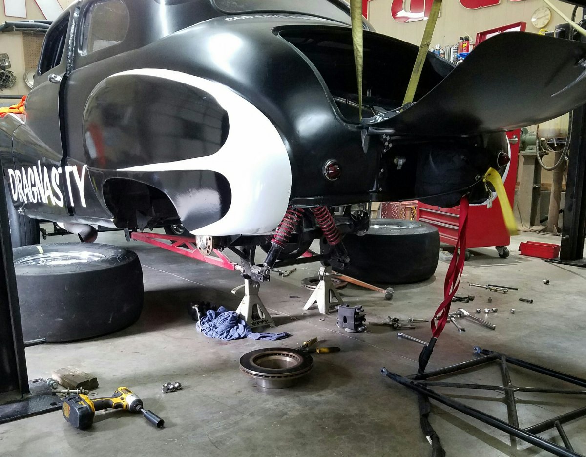

    Well she is about 85 percent back together this morning after a late night session in the shop.
    So...studs are replaced, axles reinstalled, rotors and calipers back in place, wheels and tires back up and under, quarter elliptic leaf springs and upper wheelie bar down tubes bolted back on, upper mounting points for coil over shocks bolted back in place, Parachute strap mount put back on and rear mounts for fuel cell reinstalled. All we have left to do tonight is install the fuel cell including all the fuel lines etc., install new stainless steel rear break lines (since I destroyed both sides when I forgot to unhook them before raising the body) and then bleed the brakes.
    Sounds like a lot of steps doesn't it. Well consider this: Nearly all of that would have to be done for a simple flat tire! :eek: Note to self..."if you don't sell this car (like you always do) radius the rear wheel wells this winter!" :p

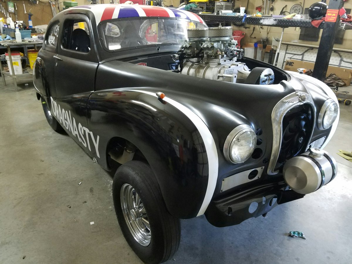

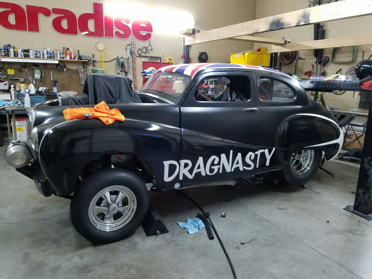

    The Austin is back on her feet again after another late night session.
    All we have left to do is bleed the brakes and put some fresh e85 back in and we are ready to test and tune at MOKAN Friday night! (hoping the weather cooperates)...:rolleyes:
    And by the way...we took this opportunity while she was hanging in the air to nut and bolt check everything...front to back.
