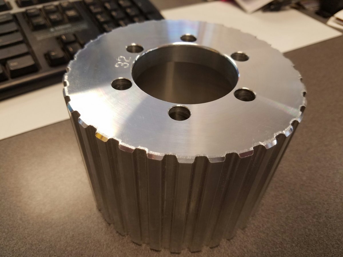

    If the seat of my pants out here goofing around on Elm Street is any indication I think we are in for one wild ride. Believe it or not it does not even sound the same. I mean it sounded awesome before but now it sounds completely pissed off! Trying to get a dyno session set up this week...

    AFR at idle went from 11.5 to 1 with 35 pulley to almost 16 to 1 on the 32!

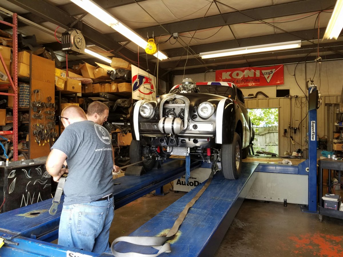

    We are pretty excited. I have squeezed out some chassis dyno time for the Austin tomorrow morning. Now we are going get down to making this run! Nothing like a mad scramble less than 3 days from the HAMB Drags....but we are all in! :cool:

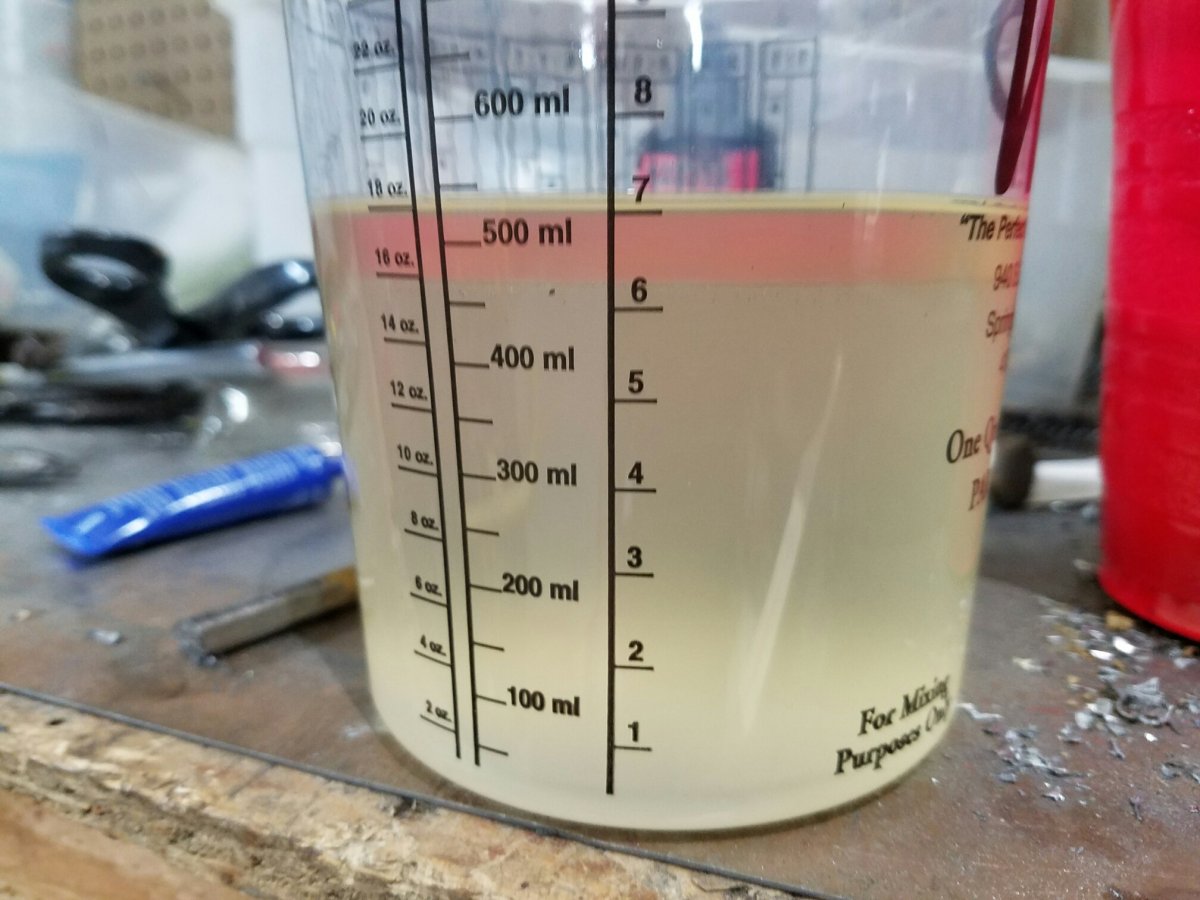

    Off to the chassis-dyno this morning. But first, my tuner needs to know what fuel we are running. I have always****umed from all the e85 rhetoric that it would be impossible to get true e85 this far south. So I have always figured we would be tuning on the winter blend of e70 or what ever is in the pump. But to know for sure, I decided to test it last night. After doing a bit of research I found it was extremely easy to test. Here is how you do it. First off, you need something that will hold and measure liquid in a graduating scale. I chose a paint mixing cup which I got for free at the paint shop yesterday when I inquired. :D
    If you want to make it really easy, pick something with 11 lines. I chose the ml scale on the cup, counted 10 units which was the 500 ml mark. I filled the cup with my fuel to this line. Then I carefully added one more unit of water over the 500 ml mark. I stirred it up really well and let it set. It took less than a minute for the gasoline in the e85 mixture to start separating from the alcohol and water mix. Within 2 to 3 minutes, as you can see, there was a solid line between the two. Since I used a graduated scale with 10 places, I can read that as a percentage with the 500 ml line being 100% and the line below it 90% etc. etc. As you can see the line clearly falls around what I would call the 93 to 94 percent area. Since we added another unit or 10% water to our 100% fuel, we have to subtract 10 from that percentage. Meaning the fuel in this cup is around 83-84% alcohol. Pretty darn close to true e85!

    Awesome a nice science lesson right here on the HAMB.

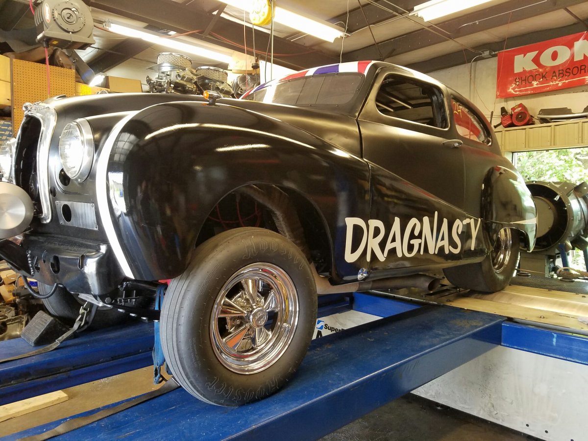

    Well we are off the dyno and pretty darn happy! On the first full pull I went from 2750 RPM to 6,000 in fourth gear. Our AFR ratio at WOT was 10.5. That is just a touch fat on e85 but my carb guy said leave it alone. We made almost 600 hp at the rear wheels on a max 9 lbs. of boost during that run. We played around with the timing a bit, a degree north and a degree south of 35 but it didn't really like either so we just left it alone.

    There were another couple of numbers that I got a kick out of. After we had the car strapped down we started talking about the up coming run. I ask what gear we would run in. He said usually third. He added high gear gives the most accurate reading of hp (driveline in the 1 to 1 ratio). I said well that wouldn't be third in this car, this is a five speed. Oh he replied, what rear gear are you running? 3.50 I replied. He raised his eyebrows a bit, how fast will it go he asked with some trepidation? I said who knows...that is why we are here. I could see him doing quick calculations in head and then said, well just try 4th... :p:p:p
    During the pulls in fourth we went from 2750 rpm which was 60 mph to 6,000 rpm which was a 127 mph in about 4 seconds! Eat your heart out Enzo!:eek:
