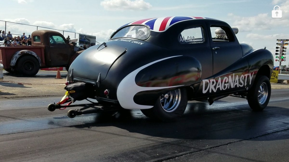

    Holy Hell did we have a blast at the HAMB Drags. With our boost issues resolved we now have heaping baskets full of horsepower and torque and to be honest, no idea what to do with it all! :eek: The car put on quite show, not exactly what I had in mind, but a show none-the-less. You know me, round one, now with no fear of lean issues etc. (thanks to the dyno work) I am just going to step on it. This is what that looked like!
    Even after riding out the crazy launch and 600 plus feet of jack rabbit wackiness, I peddled it twice, short shifted it and still ran a mid 12 second quarter at 116 mph. A guy taking photos came over to our pit and showed me a photo he took of it with all four wheels off the ground! He is supposed to send it to me!

    So here is the deal. We scratched our heads pretty hard all afternoon (and several pit buddy's as well) but I basically took the same crazy ride four straight times. The second run we adjusted the air pressure in the slicks. We had 20 pounds in them for the dyno session and with all the excitement and fun in the pits sort of forgot about them. That is what I thought happened the first round. So we dropped the air pressure to around 12 pounds. Take a look at this crazy shot:
    This run it hooked so hard that it slammed the rigid wheelie bars in to the track and literally spring boarded the rear end up in the air. It happens stupid fast...we really didn't see it happen until we were watching it in slow motion. Basically what ensued was a near instant replay of round one, only this time I decided to see if I could get it to recover with horsepower instead of short shifting. That just continued the high speed game of leap frog to nearly half track. Dad cut the video off early, guess he figured there was nothing to see hear...:D
  16. gonmad

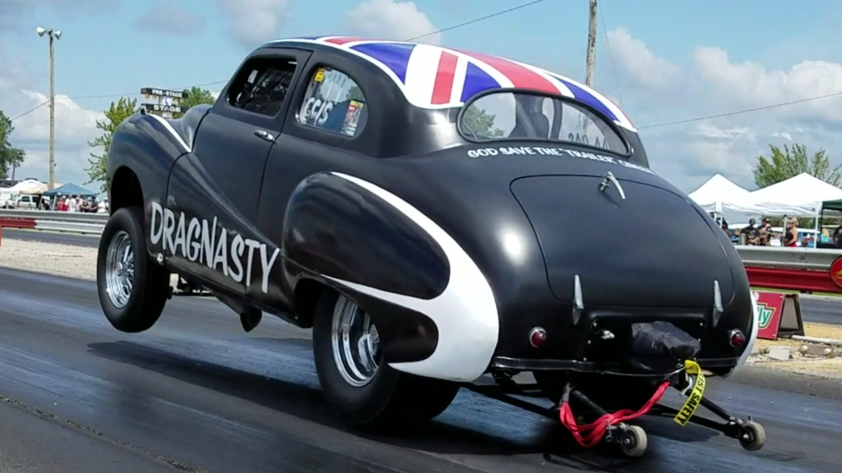

    Here is a photo I snagged off one of our videos. It was hard to get the stupid thing to stop on the perfect frame. I settled on this one after several tries. The slicks are off the ground but they are already on the way down here...they were higher at one point. :eek:

    So what's up with our little toy? Well after getting home and downloading all the videos this is what we learned. The car is a tire torturing launching machine. It is doing exactly what it was designed to do, transferring the weight to the rear and planting the holy hell out of the rear tires. But it was the sound track that was the most telling.
    In fact our friend James (saltflats here on the HAMB) mentioned it after looking over the suspension. He said he had not been able to see it launch from the side but it sounded like I might be off the throttle at launch. He was correct. If you listen to the videos above you can hear it. I am on the throttle until I pop the clutch and then off. The launch is pulling my foot off the accelerator pedal, it unloads the ch***is and the change in force puts me back on etc. etc. The pedal is a bit odd in both its placement (small car issues) and the way it rotates (vanity issues to make it look right):rolleyes:.
    Our next step is lose the wheelie bars and adjust the loud pedal. Sure looked cool though!

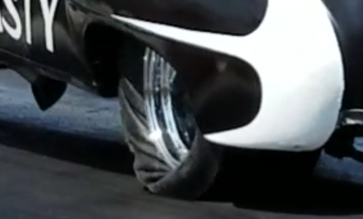

    It really was a hoot! I met so many HAMBERs I totally lost track of most your names and avatars etc. It was great to see and meet all of you. Dad and I had an absolute blast! OH and by the way, we did finally figure out how to stop the Austin from bouncing on the last p***...run it out of gas! :eek::p I drain the fuel cell dry at the 1000 foot mark with 10 gallons of e85 sitting in the back of the truck!:rolleyes: LOL
  24. rooman
    Joined: Sep 20, 2006
    Posts: 4,045
    rooman
    Apart from the gas pedal issue you need to get the tire pressure high enough that the wheels will spin a little at the hit. The tire is wound up way too much in the wrinkle photo so it needs more air. With the high center of gravity, the short wheelbase and the long ladder bars you are really planting the tires. You need to remember that all of those factors in the period g***ers were necessary because the tire technology was not as far down the development road and the tracks were not prepared the way that they are now.

    Good point on the period tires Roo. I have all the period suspension technology in play (and it is obviously working) but I never really thought exactly what prompted it. Very cool thanks.
  26. loudbang
    Posts: 40,346
    Note during your burn out there is no hopping I agree with rooman up the tire pressure and let them spin a little and the will stop "wrapping themselves up" and loads and unloading the suspension when you can stay on the throttle that is. :rolleyes:
    Deuced Up! likes this.

    I also agree. You have got to eliminate the sever hopping, or you may brake parts. Congrats on the outing with the car, I am sure you will get it sorted out. Just takes time. And no track is the same, its always a process of finding what works.

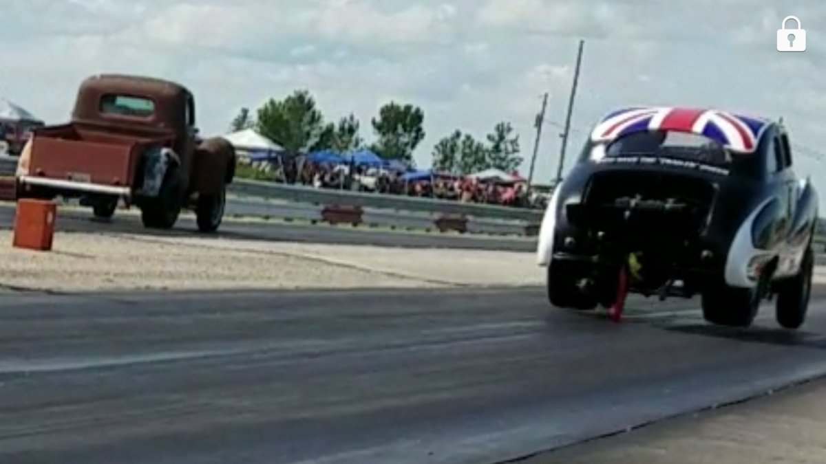

    As I sort of had my hands full trying to run that awesome little truck of yours down under difficult cir***stance. Take good look at the photo above, that is me somewhere between 600 feet and half track with all four wheels off the ground!:eek:
