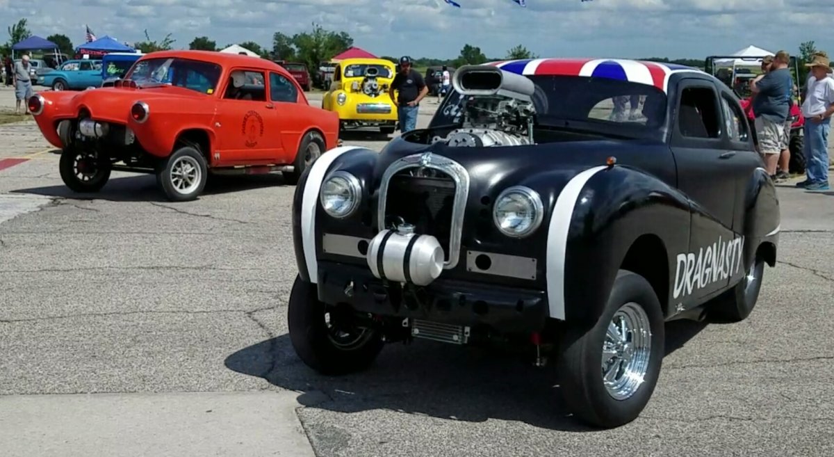

    Hey it was a awesome day for sure and that will probly be the only time I ever get to outrun your car but it sure felt good lol once you get that thing sorted out it will be unstoppable The two passes I made in the Willys I won both times but they were bittersweet victories as both people I put on the trailer were good friends and great guys then the motor in the Willys let go on the last run so back to the drawing board

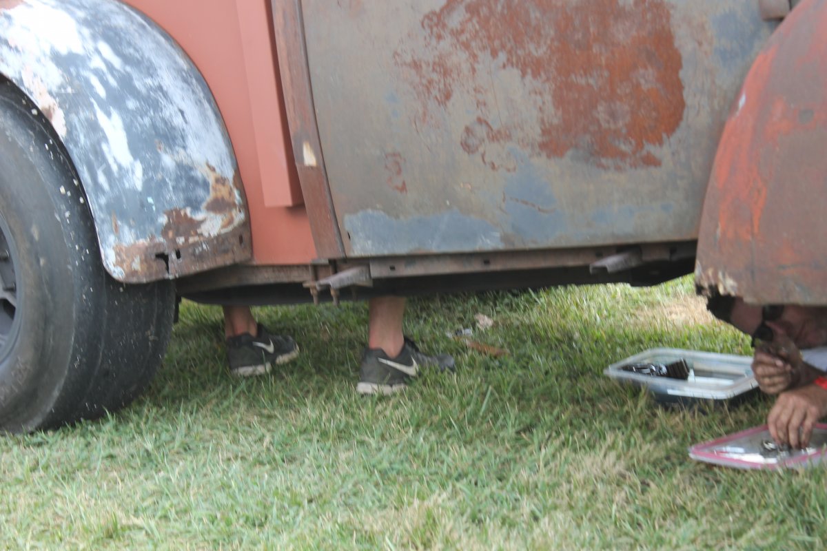

    WAIT A MINUTE! WAIT JUST A MINUTE! I just found this photo (evidence) from another HAMB DRAGS thread! I call foul! No wonder you were so fast...You had Fred Flintstone on board AND he had on his NIKE running shoes!
    LMAO!!!:p:p:p

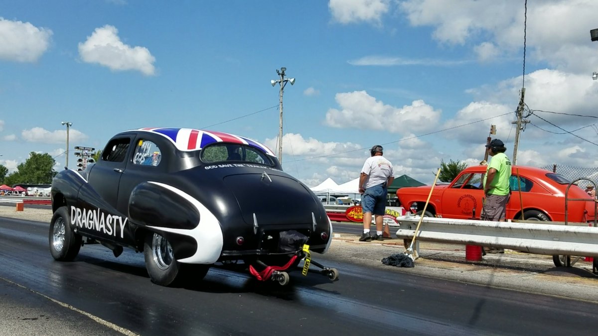

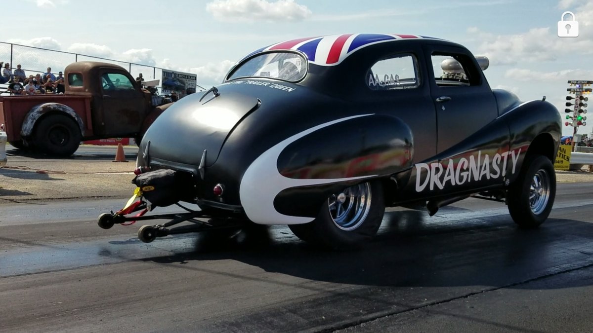

    Man, the way that thing hits, I would think long and hard about removing the bars!! You might end up wadding up the lower quarters and then taco'ing the front axle when it comes back down!!:eek: Maybe raise them a little bit, but completely off might be a recipe for disaster.
    SR100 and loudbang like this.
  10. Deuced Up!
    Joined: Feb 8, 2008
    Posts: 4,224
    Deuced Up!
    Probably a good call...we rolled it off the trailer and onto the rack when we got home. We are going to get under it this week and have a good look around. I bounced the crazy thing pretty hard a whole bunch of times. If everything is intact after this weekend's poundings, I would call it all nearly bulletproof.
    At the very least we have to redesign the bars with some flex etc. The issue we have is the same at every corner of this car...room! :eek: I looked around Saturday at several guys wheelie bars set ups and I have a few ideas.

    You might check out the wheelie bars that the southeast gasser guys use they work real good and are Fairly easy to make

    I thought the rear suspension looked pretty stiff when I saw it run at the track, but this clip almost looks like it's not stiff enough (shock wise). My 2 cents and no help at all. It was nice to see the car in real life!

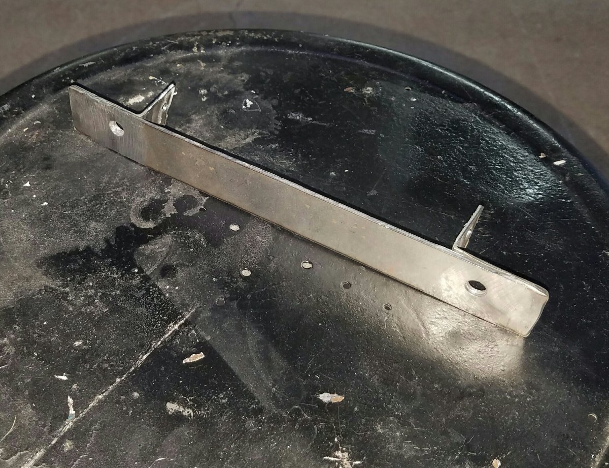

    Oh baby! I had a surprise waiting for me when I got home from work today. I went out to the shop and bent up this cool little bracket...any idea what it is for?!o_O
    CHECK THIS OUT! :cool::cool::cool:

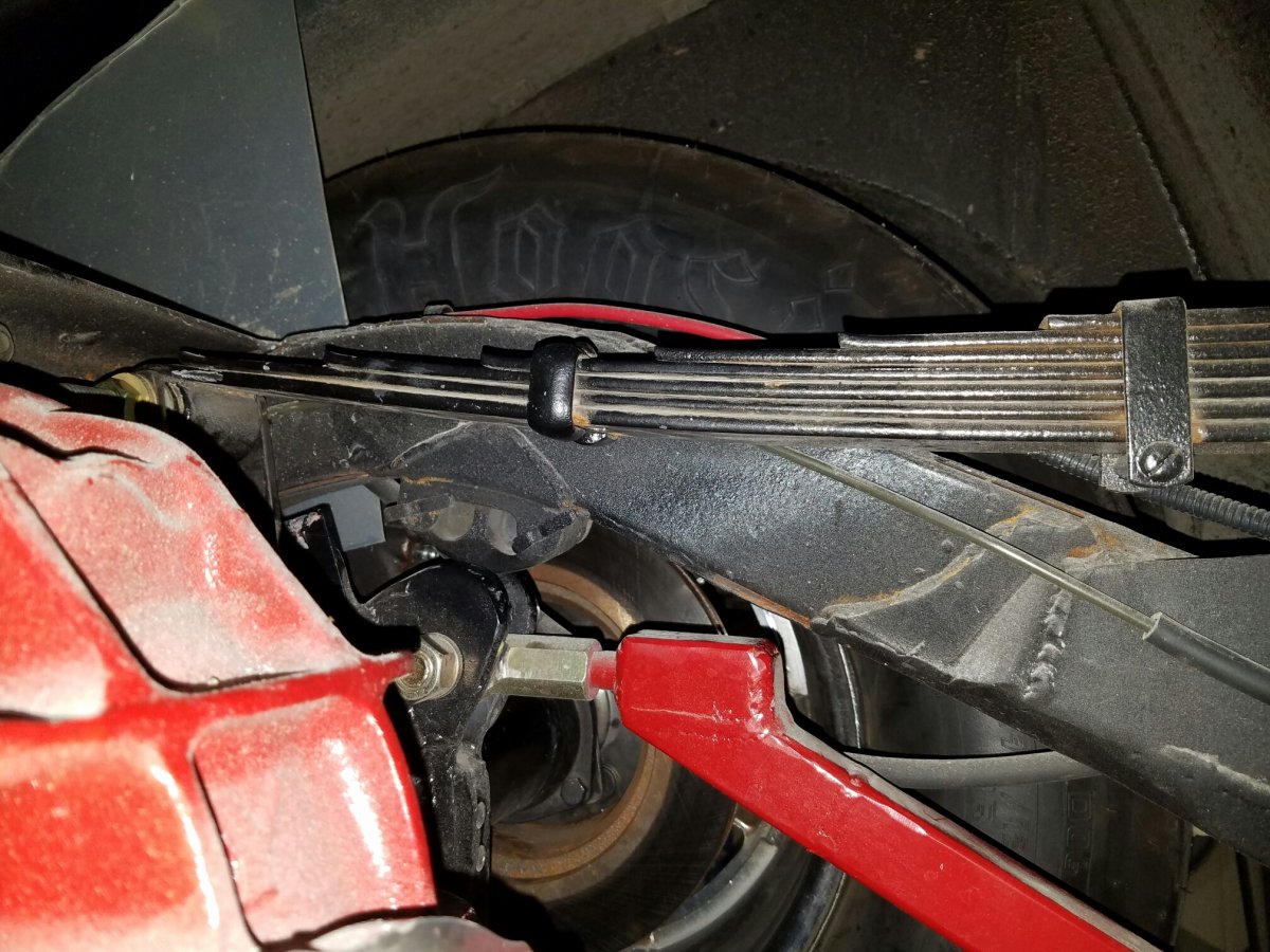

    Alright...well there is good news and bad news this weekend with Dragnasty. The good news is we figured out our rear suspension issues. The bad news is....we figured out our rear suspension issues. :D This morning we got an early start. The Austin has been on the lift, untouched, since we got home from the HAMB Drags Saturday night. The big issue I saw this morning was there are so many potential issues! So to begin with we decided to start eliminating them one at time.
    If you remember way back, the coil shocks we have on there are really overload shocks. They were no where near stout enough to support the car on their own, which is what spawned the whole quarter elliptic system. After we installed the leafs, cut down from the factory Austin rear springs, they were so strong we decided to try those shocks to simply dampen the suspension travel a bit. It had a great stance and was very firm when we finally got weight on it so we left everything alone.
    So here is the deal. Dad and I disagreed about the mounting points on the rear axel for the quarter elliptic springs. Dad thought maybe the springs might be binding up and not letting the suspension travel. He thinks we need shackles on them. On the other hand, I didn't think they were really working like leaf springs. I felt like they were just pushing down on the rear end from the direction of the suspension rotation. So just to prove him wrong we started right there. I unbolted the shocks and let them hang. So now with only the springs hooked up, I tried to carefully activate the suspension a bit while Dad watch the travel. There was none.
    If I was right, we should have been able to jack up the rear end, into the springs and depending upon their strength they should move a bit before they lifted the entire chassis and body etc. However there was no movement there at all. The second we started to jack it up, the whole car went up. As usual, Dad was right, the whole thing was bound up. So I sat about building some heavy duty shackles with about 2 inches between the holes. After finally getting them installed we lowered the chassis back down and sure enough we finally got movement...that is until the chassis arch above the axle bottomed out on my new shackles.
    After staring at it for a while in disbelief I finally came up with an idea. The spring eyelet ends and the shackles had to make it up between the frame rails back there but the head of the shackle bolt simply would not clear the frame rails. Remember this whole crazy little car has been a story of tight tolerances. After finally cutting the head off the bolt and welding it solid in the upper shackle mount point we cleared the chassis.
    So finally, with uninhibited suspension travel we put the old girl back on her own feet. The car traveled all the way down until the chassis bottomed out. After looking at the springs now, they are worthless. They bent right past the max spring arch and back the other way. The were still bending in the wrong direction when the factory bump stop still attached to the under side of the frame sat on the ladder bar mount.
    As usual, Dad was correct. From day one, because of absolute crazy dumb luck with spring length and placement etc. we mistook spring strength with chassis binding which made for some exciting driving after we finally put some serious torque to it. So what now?
    Well I have quite a bit of time in this quarter elliptic system plus with it in place I don't need a pan hard bar etc. With that in mind, I think I am going to find me some proper springs tomorrow and start again. I am thinking of starting with trailer springs which I can easily get my hands on. Tune them by removing leaves etc until we have a nice stance (ride height) and rotating suspension. Then we will determine if the shocks we have will work or if we need to a standard shock (probably a 50/50 proportion).
    If we can not make it work, I will just bite the bullet and drop a pair of coil overs on it with a panhard bar. But at this point I am not ready to give up on the old school approach we started with...:D
