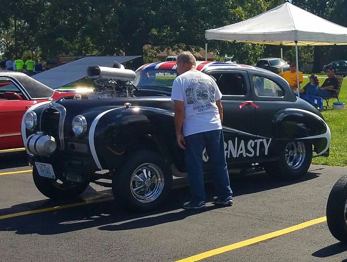

    We hit a nice little car show today in Nixa, MO. It was an absolute beautiful day for it here in the Ozarks. They even had a Pro-Street/Racing cl*** for the Austin.
    The Austin was a big hit and we got to chat with a ton of great folks. In the end DRAGNASTY took first place. You know it's hard to be humble with a killer machine like this... I mean there were some great looking cars there today but to be honest, there was simply nothing in the same cl*** with the Austin!
    Of course when I say that, I mean Dragnasty was the only car in the Pro-Street Racing Cl***....LMAO!!!:eek::p:p:p
