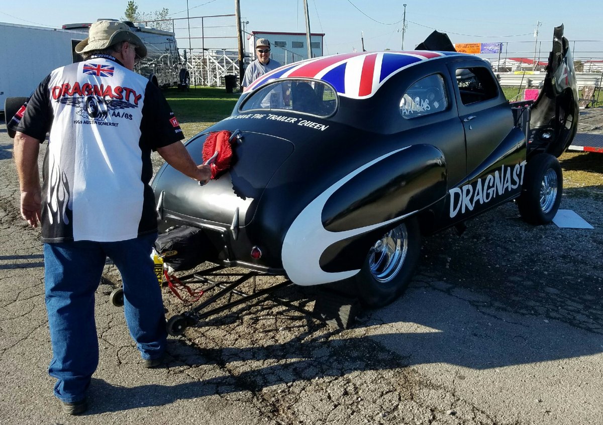

    Check this out. We are working on some wheelie show stands. Coming up in a month or so here in Springfield MO is the Hot Rod Holidays Indoor Car Show. The Austin is going to be on display next to a killer altered wheel base Falcon Wagon (you might have seen it at the Hotel the night before the HAMB Drags). We are setting them up to look like they just launched.
    The crazy part of this post is originally we set the stands at the front ladder bar mounts (hoping to keep them back out of site a bit more for the effect). Dad is letting the jack down up front. When the car is on the stands he drops the jack altogether. While I stopped breathing for a bit, the rear slowly lifted off the floor and the crazy car just balanced itself right there in the shop.:eek: Apparently the nose is a bit heavier than I anticipated! LOL

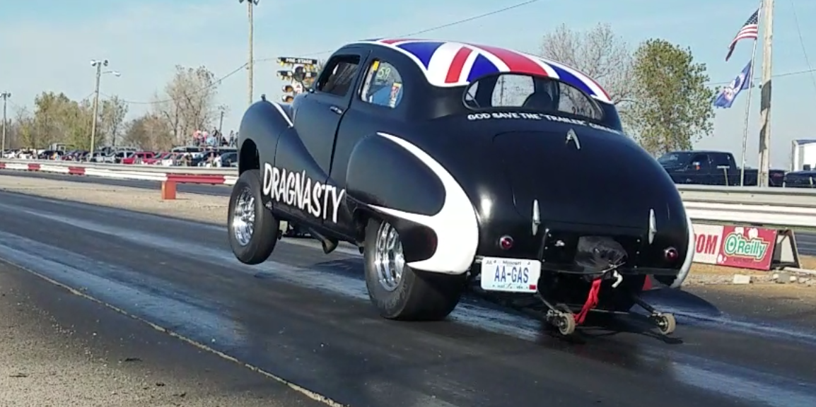

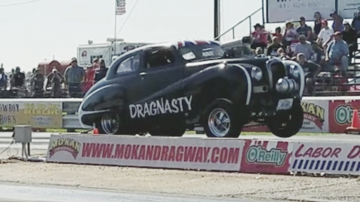

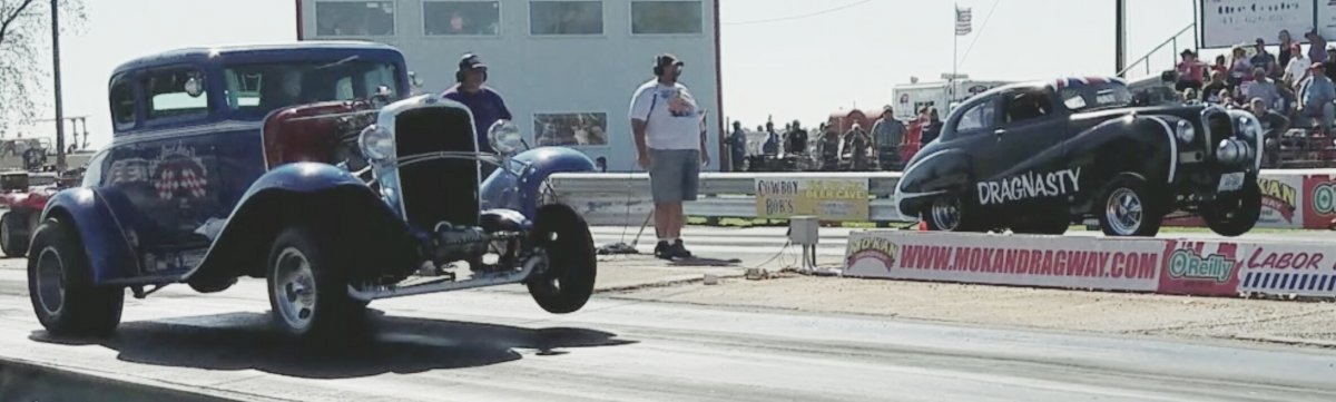

    1. At the Launch...
    2. Past the tree still in first but with Supercharger coming on...
    3. Second gear shift...
