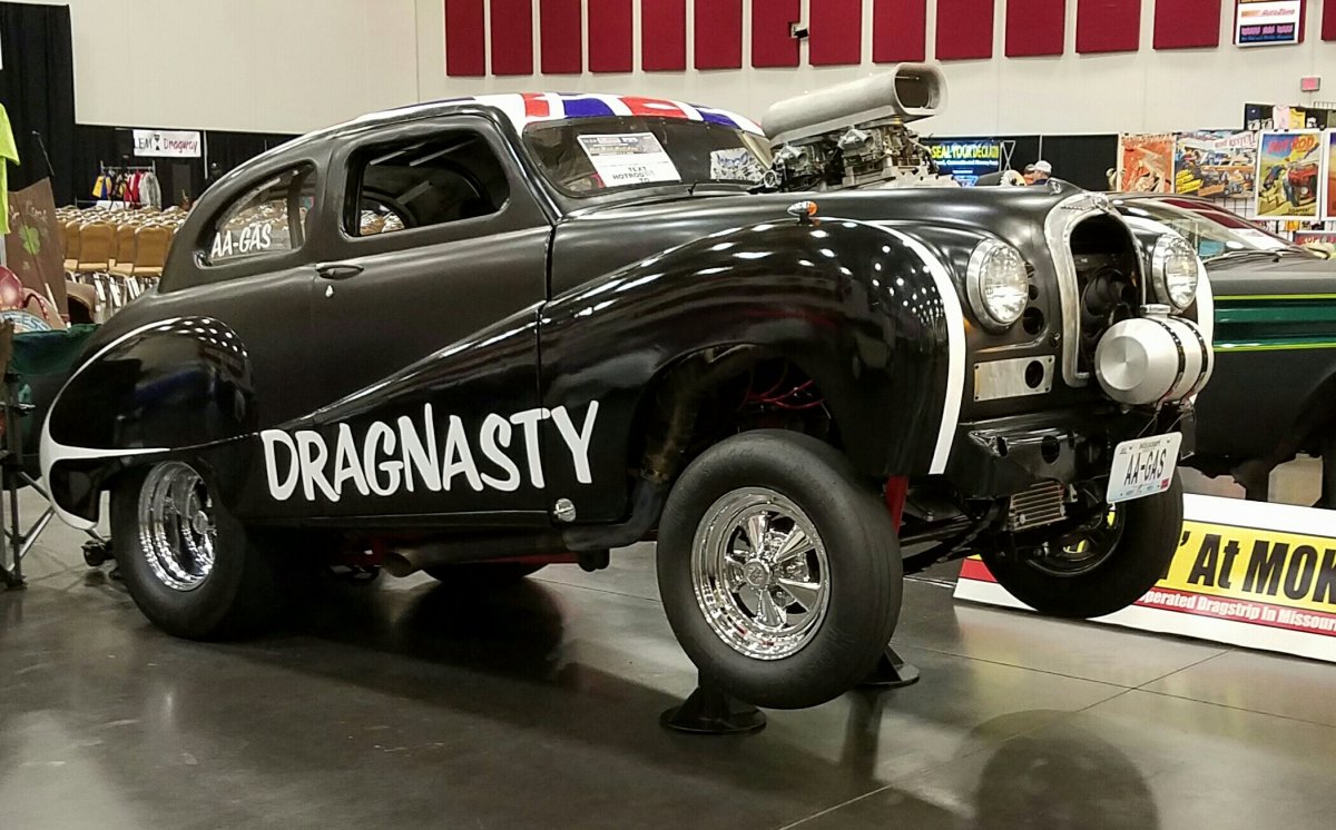

    HOT ROD HOLIDAY SHOTS!
    We had an absolute blast at the Hot Rod Holidays Car Show in Springfield, MO. There is another thread here on the HAMB for full coverage of the HAMB Friendly Rides in attendance.....including "wrenchbenders" Digger.

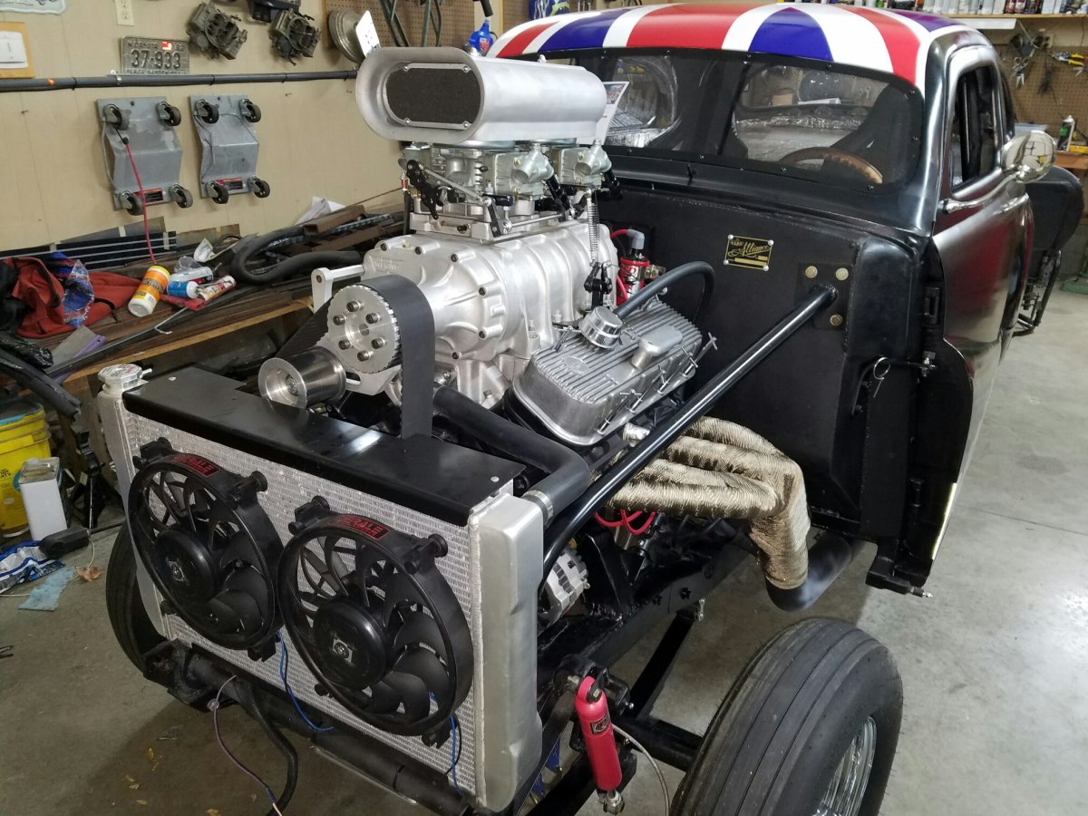

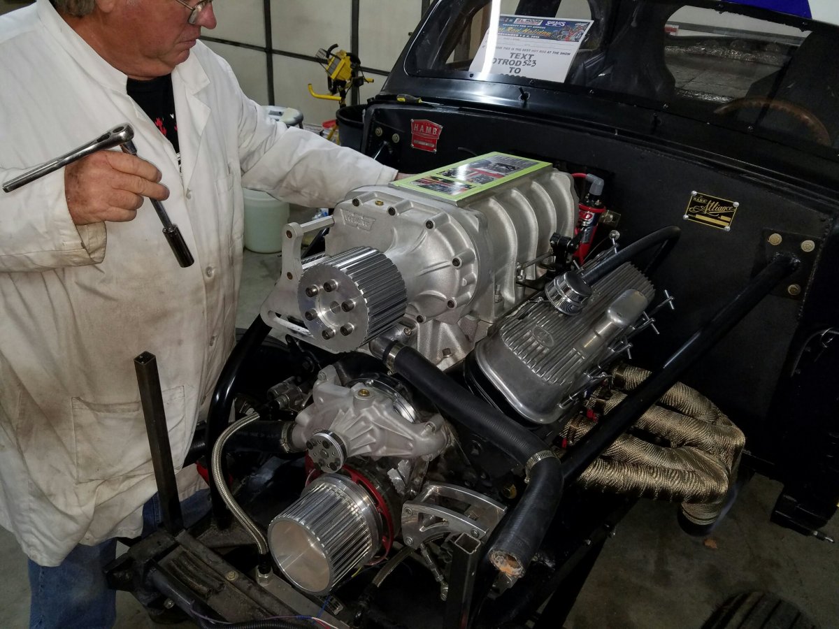

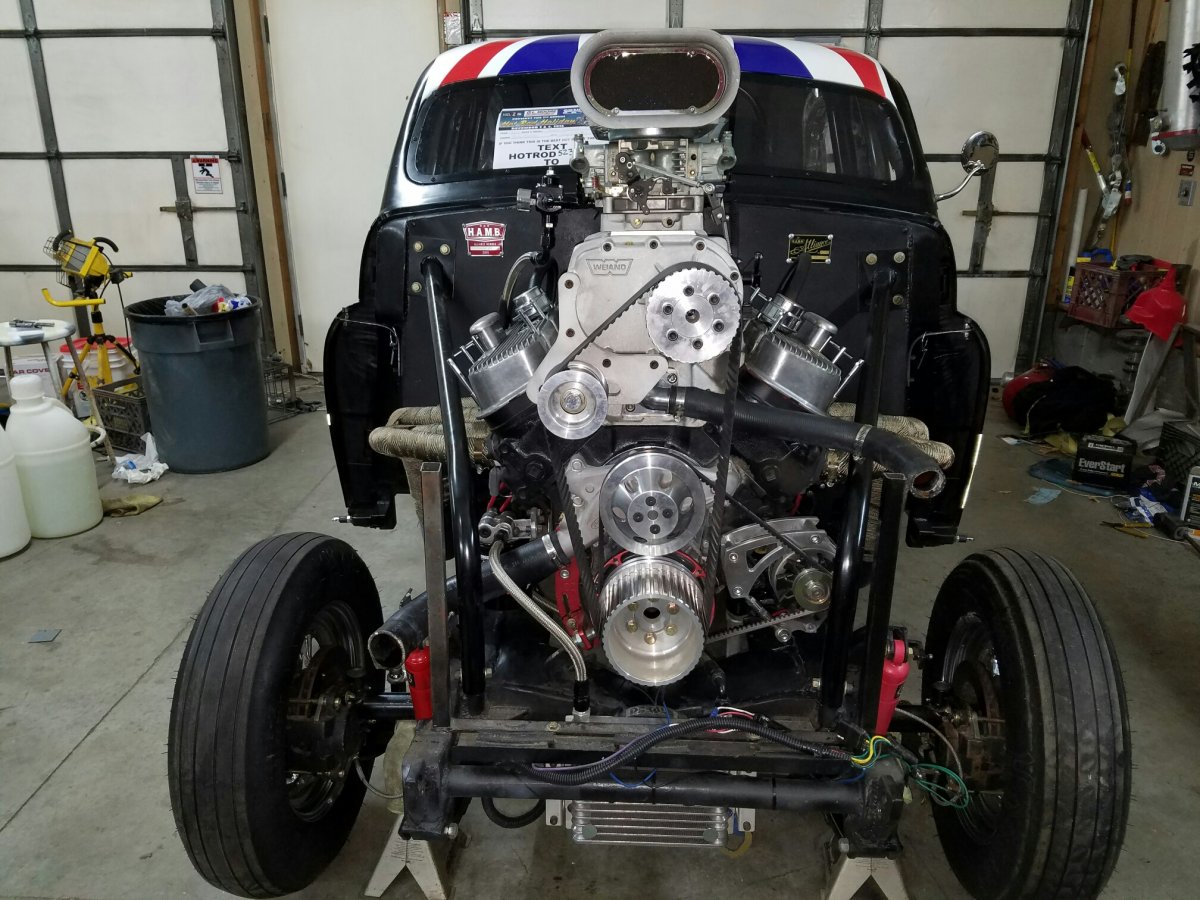

    Well yesterday morning we hit the shop to tear into the Austin a bit. And yes "flathead_10" we are going to put an EFI Hilborn unit on for next season. I am pretty excited about that but we have some work to do first. If you remember a while back, we did a leak down test. I had told Dad the car just didn't sound right, I couldn't really describe it other than it just didn't sound as crisp to me. So we tested it and all the numbers were good except for number 7 exhaust. It's number was higher than the rest and I actually had some leak down sound in the header. I turned the valve a bit and it got better. It was something we decided to keep an eye on but not something in my opinion worth ripping the whole car apart at that point.
    However, with the new injection system coming and needing to replace the blower intake gasket anyway, we decided now was the time to address the valve issue and have a general look see inside.

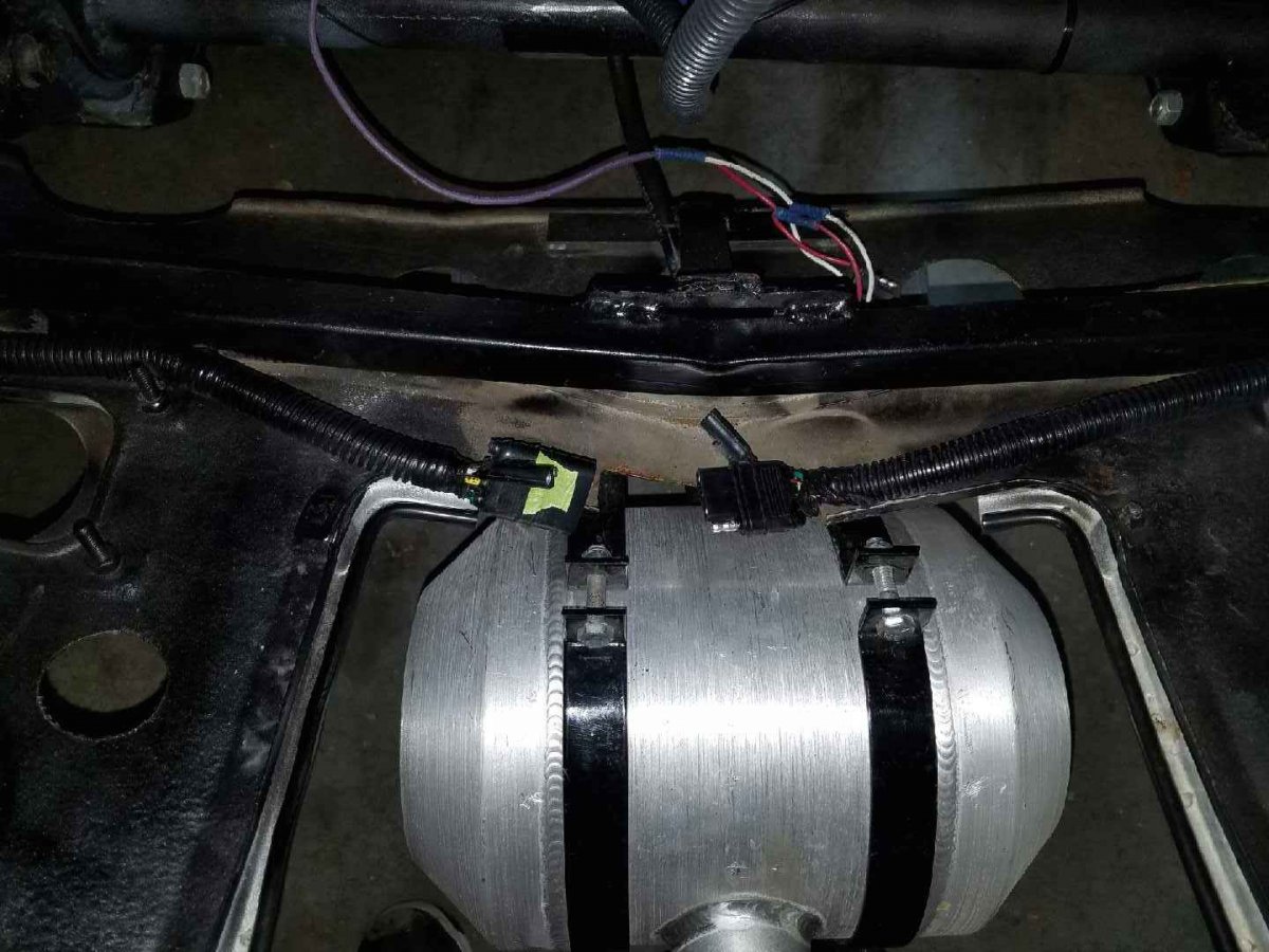

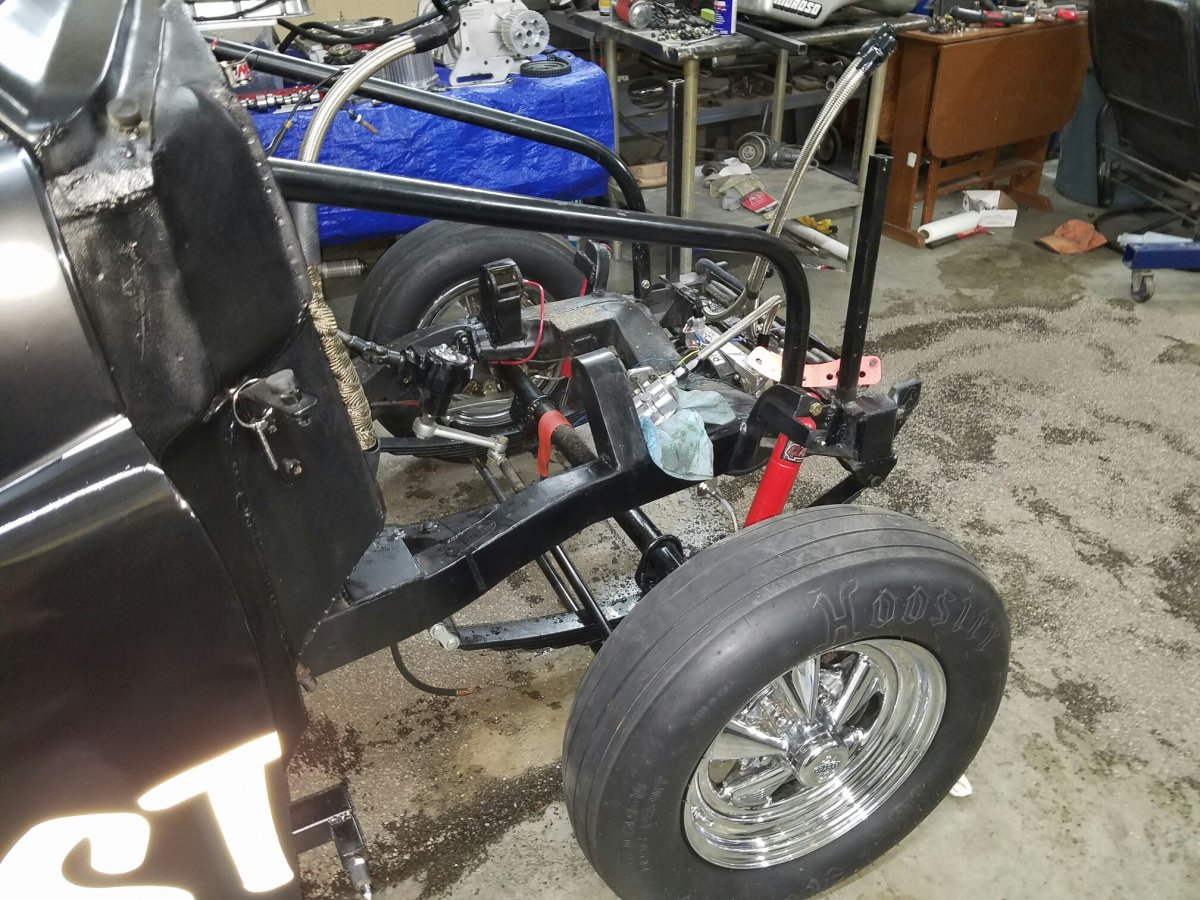

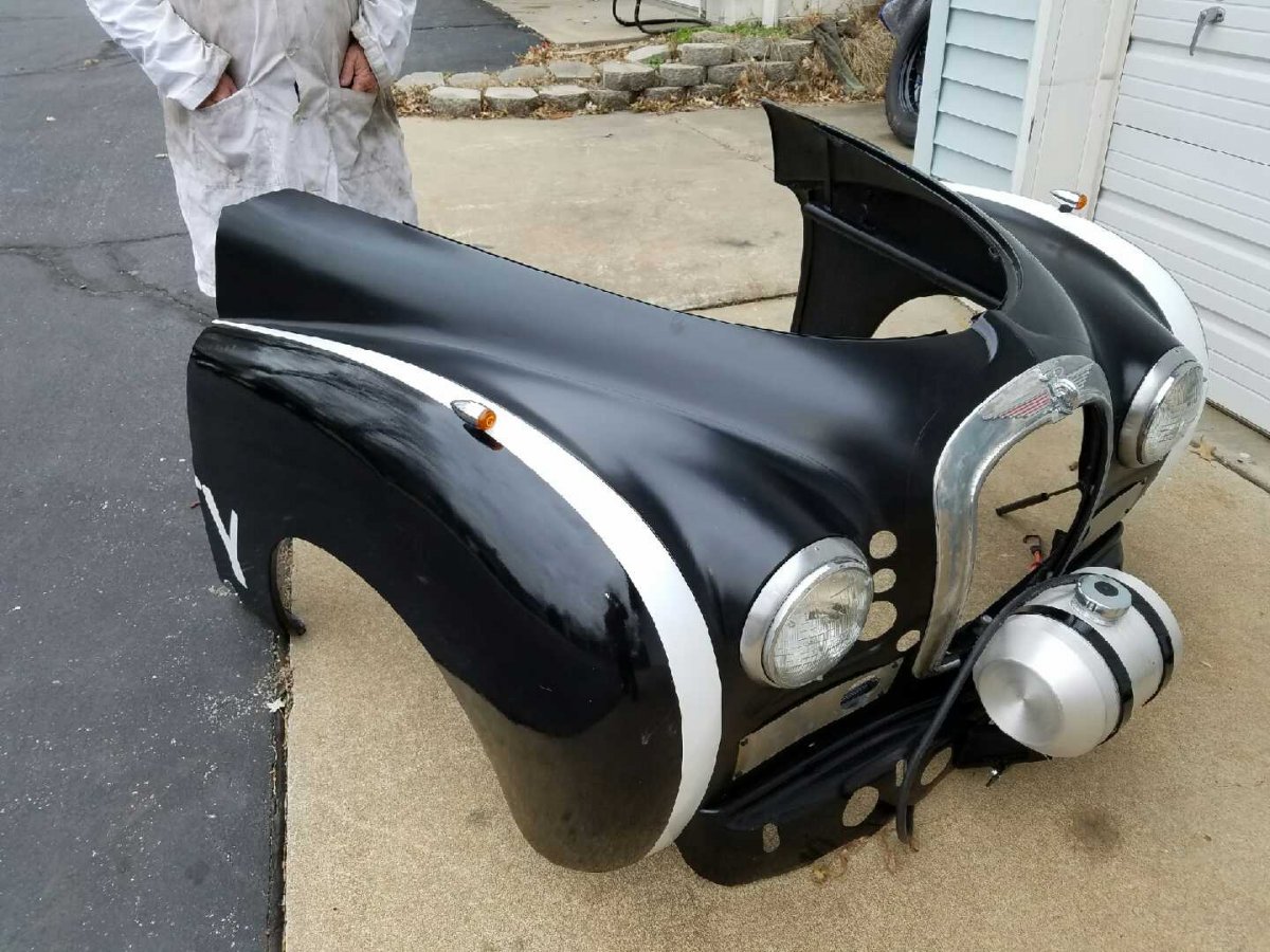

    Looking down into the flip front hood, the extra time we took wiring the front end with quick plug adapters made quick work of unhooking all the wiring up there. And within a few minutes the front end was off.
    With the front end off it was time to drain the radiator and while we were patting ourselves on the back for the fancy plugs up front, noticed it would have been nice to have done that on the radiator fans too:rolleyes:...We will fix that when we put it back together.
    So we removed the radiator and then flipped the car around and put all four corners up on jack stands. It is going to be here for a while and we don't want to flat spot the tires etc.
    Then we just started carefully tearing her down. How about Dad in his traditional Doctors Coat...:p

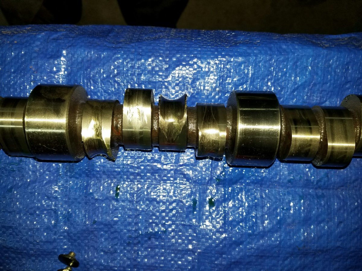

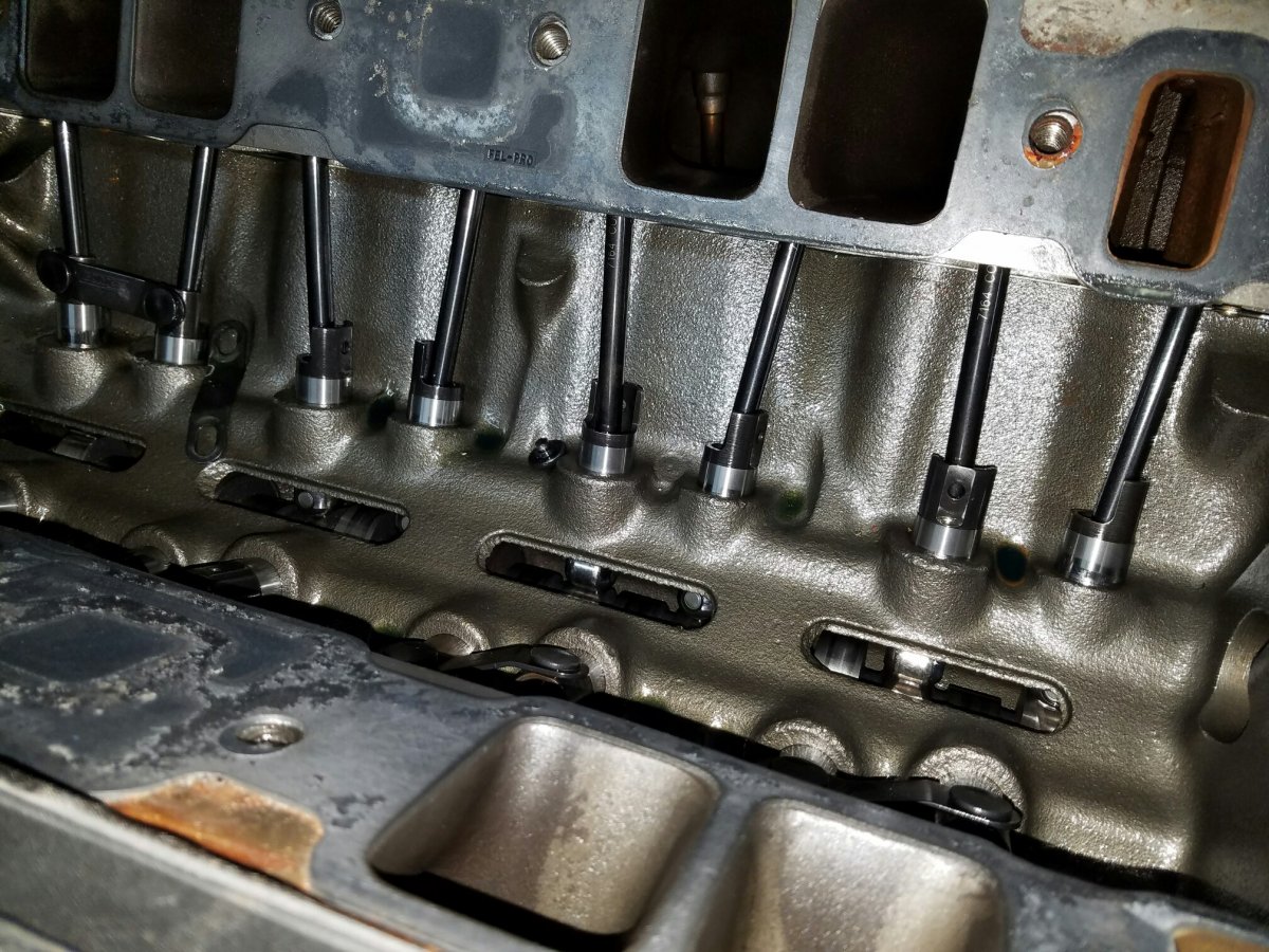

    So we get all the way down to the intake and carefully pop it up. Basically that is the end of our care free day of happily preparing for Hilborn Injection etc. etc. etc.....o_O

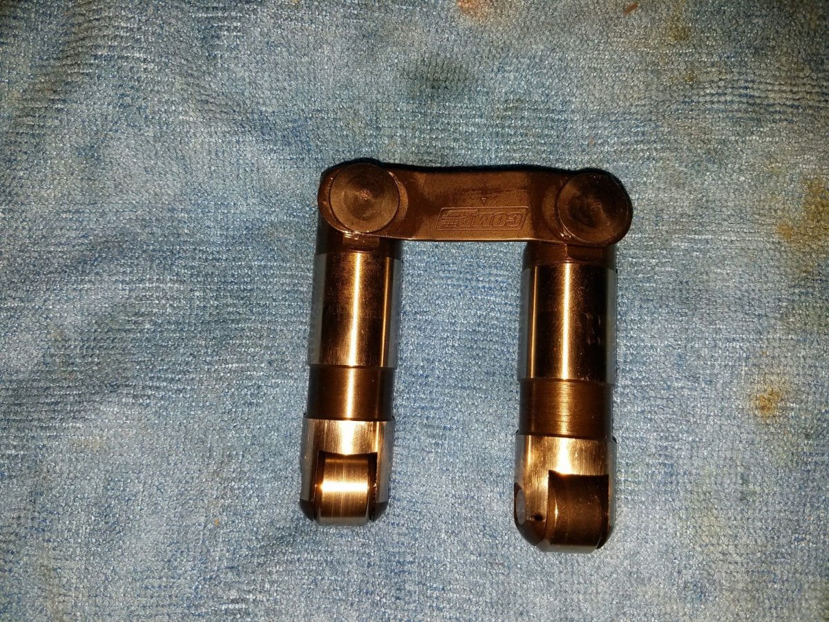

    Three of the lifter sets on this side and one set on the other have lost their cross alignment bars. If that is not bad enough, there is only one bar and two large rivet heads in the valley. The other three bars and 6 rivet are gone!
    Without the alignment bars, the lifters have rotated around an instead of efficiently rolling on the lobes are simply digging in and giving the cam their own version of a "re-grind"....
    So we are scratching our head a bit here. To be honest, at first look it almost appears like we installed the failed lifters upside down. It can be done. You have to be very careful to look at the arrow on the cross bar and make sure it is pointing up. Furthermore, just in case the factory goofed up, I always take a look at the orientation of the roller as it is going into the hole to make sure it is parallel with the cam.
    In case anyone is wondering how this is possible take a look

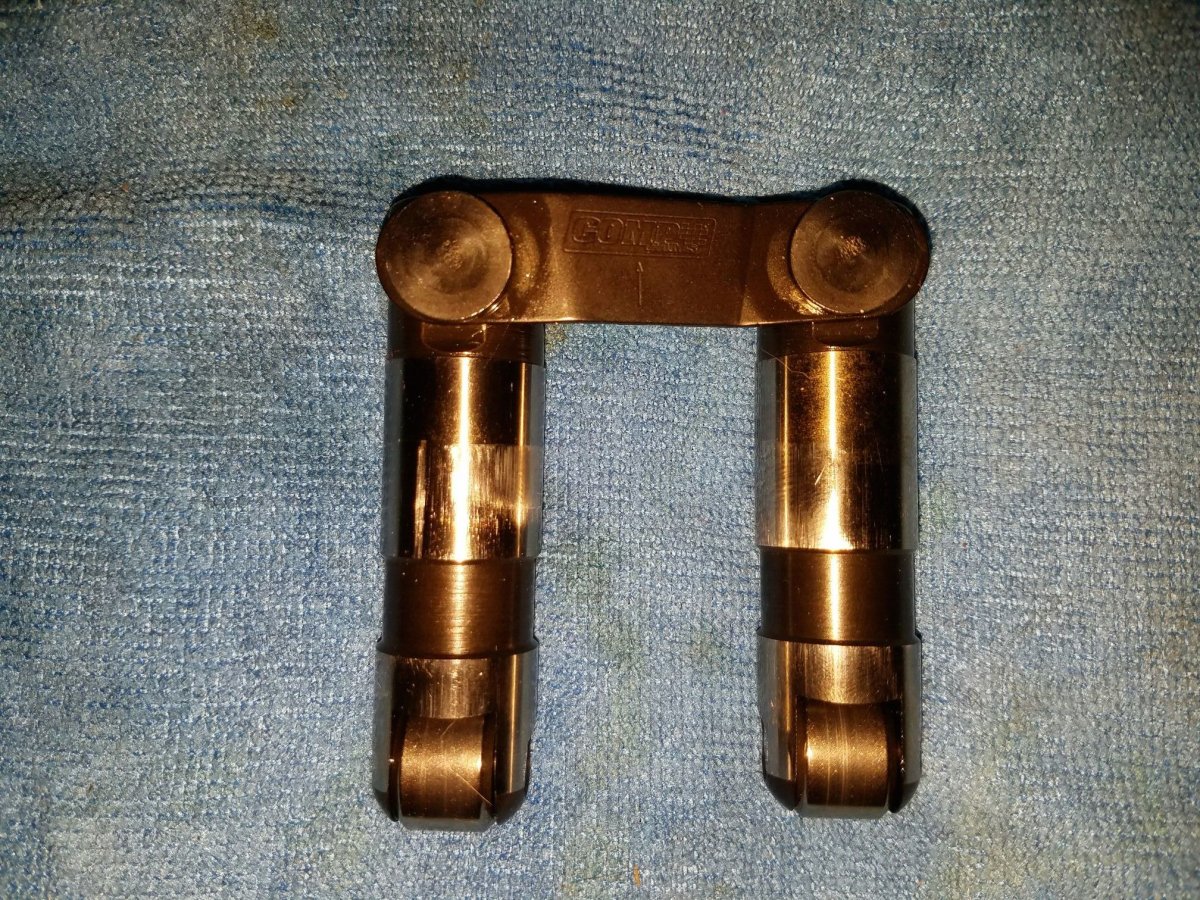

    Here is a lifter set ready to install. If you look closely, there is a COMP text logo on the cross bar with an arrow pointing up.
    However, if you rotate the lifter on the cross bar pin access like above...
    After both are rotated you have a very similar looking lifter set...
    Turn it right side up in that position and it looks nearly the same minus the text and arrow being upside down. And the set will slide right in. However if you notice laying flat, the above lifters are turned a bit sideway (meaning the roller would not be perfectly parallel with the lobe. This is an issue that will produce side pressure on these lifters, eventually breaking the cross bar connections and spinning the lifter sideways creating the exact situation we appear to have.
    When I spoke to Comp Cams yesterday that is what they told me had happened. And I will admit, it certainly looks the part. Not to mention I will be the first to admit I am as capable as anyone at any moment to pull a big blunder. However, as you have seen through out this build I am also pretty good about do***enting with photographs...
    Here is a photo from way back...you probably will not be able to see the actual text and arrows in the scaled down HAMB Thread photo here but when I zoomed in on this original photo, you could clearly see the text and arrows. So in our case, something else caused the kind of side pressure to pop the cross bars off. And or these lifter sets were defective in some way.
    BUT it really doesn't matter at this point because COMP CAM will only warranty these units from year of the purchase date. Although the car has only been operational for 6 months, I purchased all this stuff over a year and a half ago.

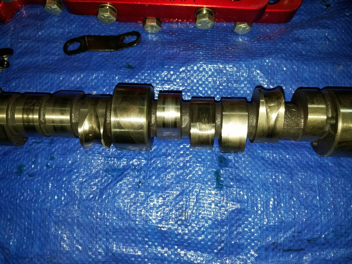

    So we pulled it on down and as expected when we inspected the Clevite cam bearings they were junk. What a pain in the backside too, because to pull the engine we basically have to removed the interior (or at least a large portion of it).
    By around 8 p.m. last night we had it out, the trans pulled and the block on an engine stand. We pulled a few rod ends off to have a look and the of course those Clevite bearings were junk as well. However, the journals look good so far so that is at least a bit of good news. Today we will finish pulling the pistons and crank and get the block in the morning to a machine shop to install new cam bearing and probably a quick cylinder wall clean up.
    The next step for us is taking the advice of Jackson "wrenchbender" and ordering a new custom ground cam and kit for the car from Crower. Just makes the most since at this point. Then we will slap her back together again.

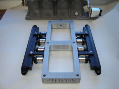

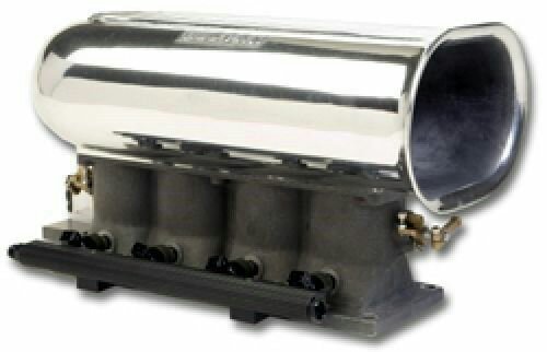

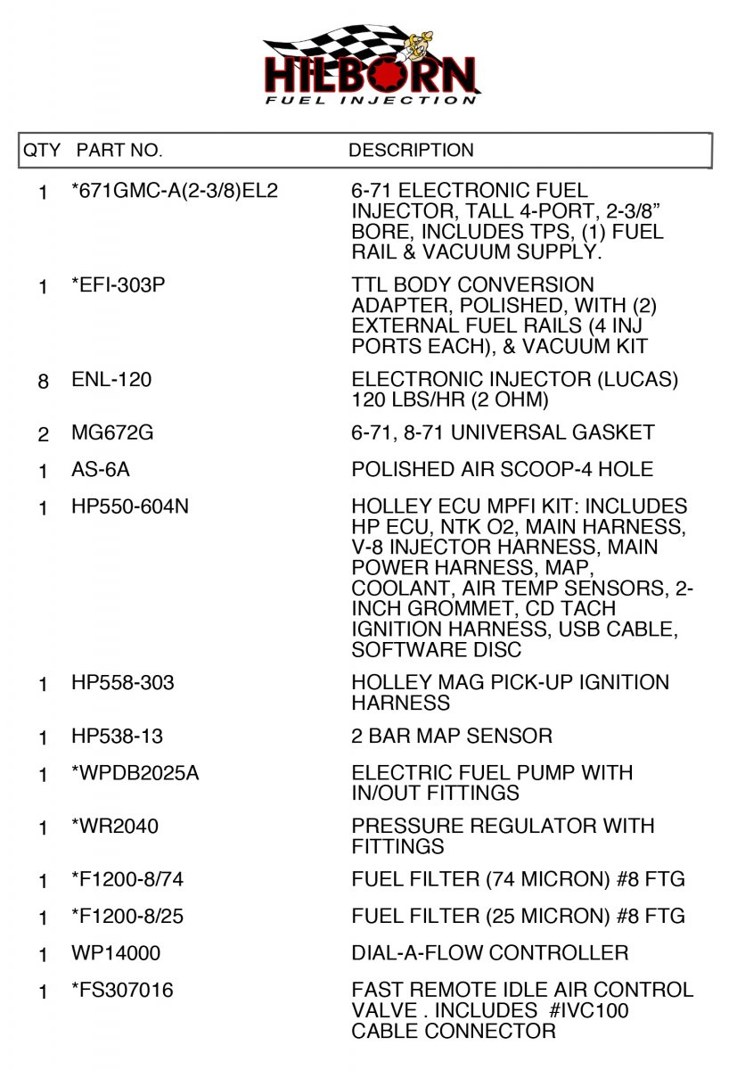

    So here is what is coming:
    The standard old school four port (tall) unit with polished Hilborn Scoop. However, because we are running e-85, we will need 8 very large injectors (120 lbs) we will run them through a base plate and plug the four injector holes shown above.
    There is a pretty cool plate that actually hides the injectors but it only holds a max number of 6 and a max size of 95 lbs. So we will have to go this direction with two rails, one on each side.

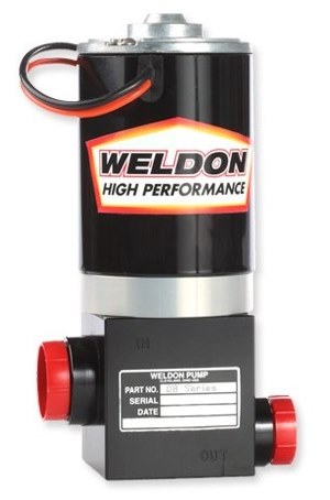

    It still takes a killer fuel pump not only for output etc. but to be rated for e-85 fuel. However even with this, we will be running a pretty trick Weldon Dial-A-Flow controller. It will allow us to run the pump in continuous duty if needed. The controller slows the pump down so it does not over tax the return system (helps to prevent over heated fuel and cavitation etc.). It is pretty cool, I am just learning about it myself but it will interrupt the electrical current to the pump 12,000 times per second reducing RMP.
    And then there is the heart of the kit. It is a self learning system but you can set manual inputs as well. It even comes with a cool little touch screen unit for tuning on the fly. Like when I see something in the other lane from "wrenchbender" I can dial it way down etc. :eek::p:p:p:p.
    Actually I probably better keep quiet, I may need his help installing all this ****! :D
    Not to mention I am already 0 and 1 against him!
    Never-the-less, there are plenty of parts, plugs, filters etc. Here is a full list of what the conversion is going to take (minus the new fuel lines).
    I am pretty excited about the change. I think it is the best of two worlds. It has the killer vintage Hilborn four port injected look but at the same time it is pretty much state of the art as far as tuning and controlling it. It will also allow us to continue the dual role of ripping up the drag strip and driving it home should that ever be the case.
