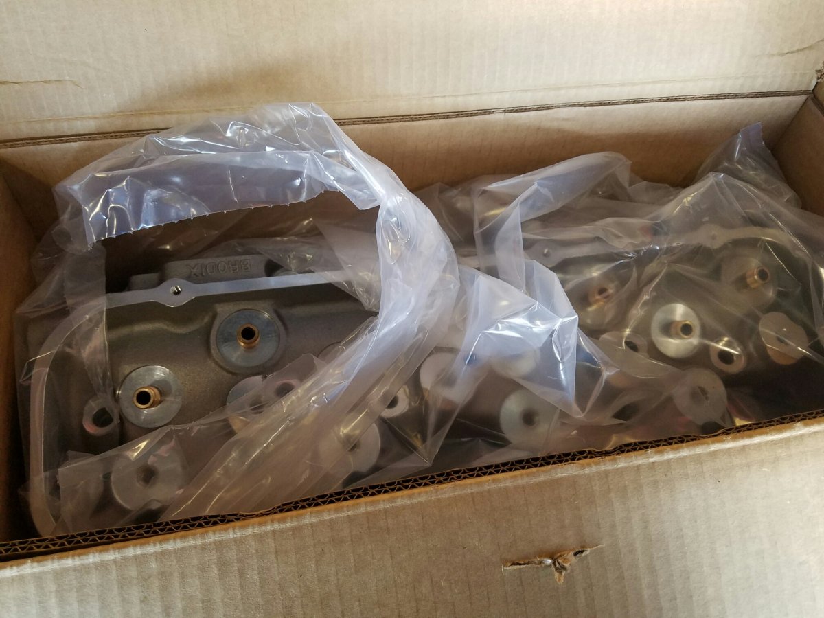

    As is par for the course for me, my Christmas present showed up two days late...but I am not complaining too much. They are Brodix Aluminum Race Rite 294 heads with 119cc chambers.

    WOW , what did you do, rob a bank? LOL. But anyway, I am really interested in the hilborn set up and how this will play out. I would like to go that rout on my blower. This is gettin CRAZY COOL NOW!!
