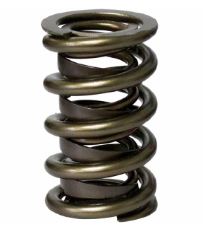

    They are Howard 98826 - "Pacaloy" Mechanical Roller Springs. They coil bind at 1.150. At our install height of 2" we could lift as high a .825 however our max lift intake is .793 and max lift exhaust is .800.
    Seat pressure is 275 at 2.00. with open pressure 805 at compression.

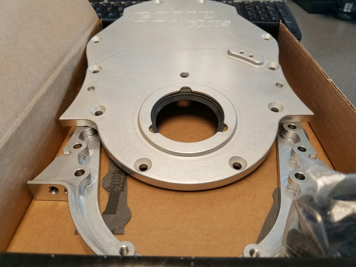

    So my timing chain cover came in today. It is a pretty cool piece from Comp Cams (guaranteed to keep dirt clods out):p. It came with its own cam button and shims to adjust it. The hole there in the middle is for a dial indicator to check cam end play. I am pretty excited to get this thing home and installed.

  9. With a blower and those spring pressures a timing chain wont last. You really need a gear drive at this point. I would up the springs to 340 lbs. Remember there is alot of air pressure on the back side of the intakes. Buying a on head spring tester can be a life saver. The springs get installed new with good pressure. After just a few runs can drop 40 lbs very easy. Over revving a burnout will destroy a set in seconds. A tester can help you stay on top of things. You will find the intakes will get rotated out more frequently. They also make on head removers. Look up good vibrations and lsm tools.

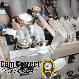

    Understood. Don't forget we are not running a ton of boost through this crazy thing, only 10 to 12 pounds. I do have a good on head spring tester and a pretty cool new valve lash tool from my cam designer, Roger Hurst (he invented it).
    I am also very interested to see how these new Howard Pacaloy springs hold up (they have some pretty tall performance predictions from Howards)...they say they won't wear out as fast as others! :eek: :p LOL.

  11. on our late model hemi the springs with a .015 shim came in at 350lbs new. after a few passes they dropped to 320 and held that for about six passes. they then dropped to 280lbs. we would remove the .015 shim and replace it with a .060 spring cup. this brought the pressure back up to 340lbs. they were good for another six passes. after that they went back down to 300. you should check to see if you have the room under the retainer to do the same thing. blown motors are very sensitive to spring pressure. once the springs drop their pressure and new ones go on it can actually be heard when the engine is running. it will sound nice and crisp again. you will probable find the exhaust springs can run for a whole season. I think you will find the chain to be a stretched out sloppy mess by the end of the season. I don't know of anyone with a blown race engine running a chain successfully. cloyes of course will say its alright because that's what they sell. a fixed idler gear drive will always be the gold standard. it could save you a lot of money down the road. its not just the boost but the spring pressure to. with that kind of spring pressure the engine can rotate by itself a little when turning it over by hand. there is a lot of stress on a chain trying to close the springs. chains just by their design stretch ask anyone running a chain on a motorcycle.

    Well we shall see. Thanks for the input though, I can never get enough of it. I did however speak with Weiand, The Blower Shop, and Good Vibrations today and all of them agreed with my Cloyes chain choice...you never know!;)
  13. technology is always changing. there may be something out there im not aware of. i hope it works out for you. can you keep us up to date on how its holding up? one more thing on the gear drive as a plus. if the engine should ever need a align bore the gear drive can be adjusted to make up for the crank moving up in the block. the chain cant do that.

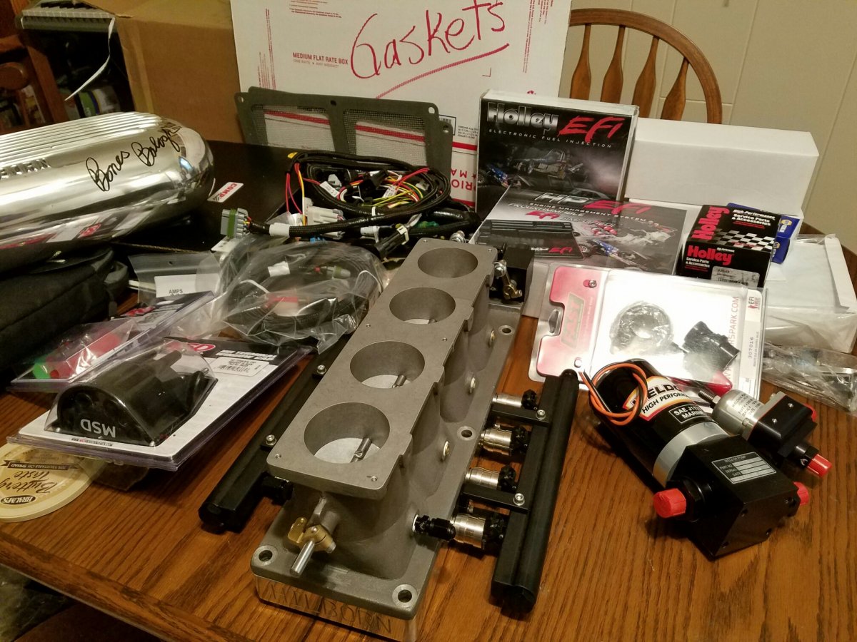

    Oh boy. Just got an email from UPS Tracking. The Hilborn EFI unit was just dropped off at the shop. I may have to slide out of here a bit early today to go play with it! Lol

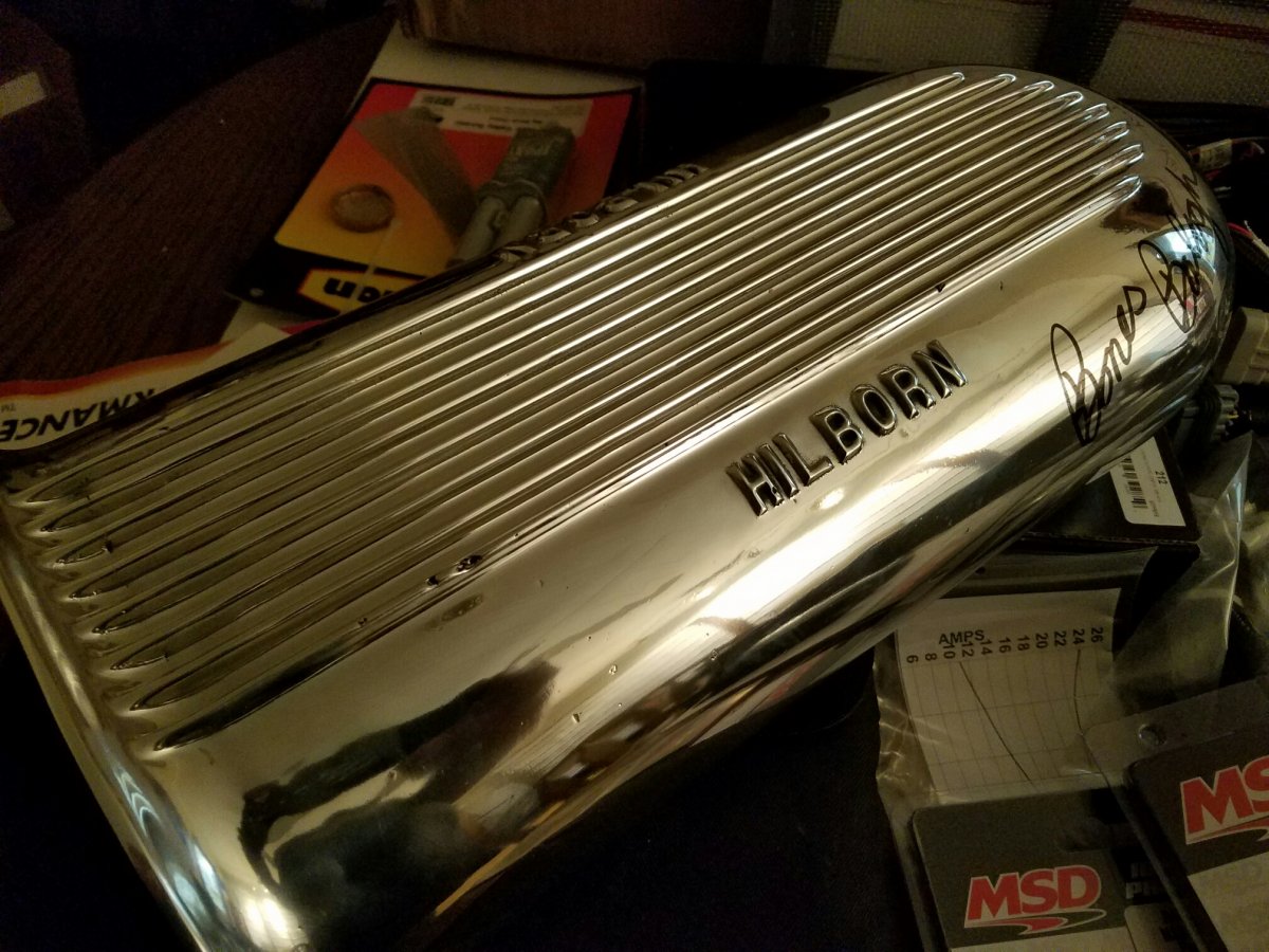

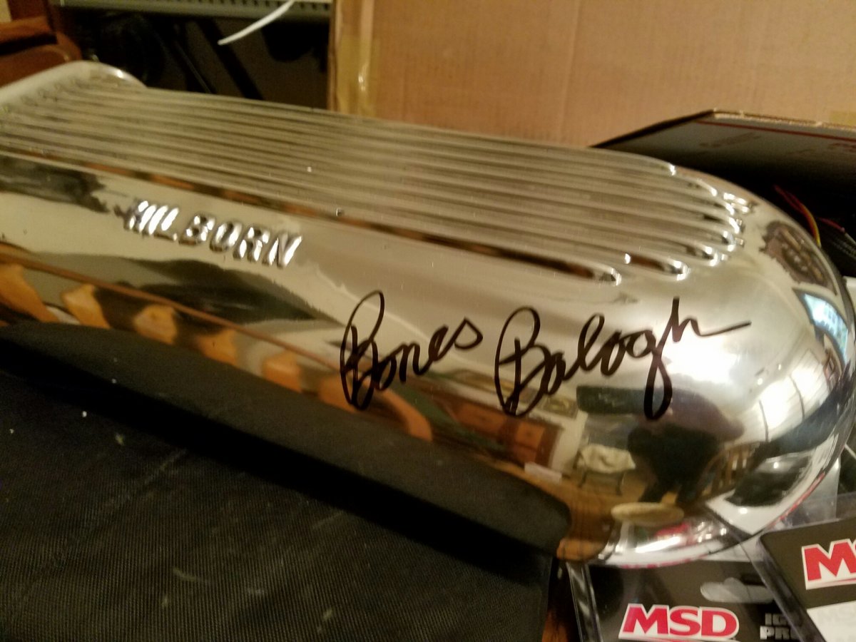

    What a cool pile a parts to play with... Holy cow we unpacked all the boxes tonight and lost the dinning room table almost immediately. Since it is all here now, I also unveiled my latest most favorite part, a vintage, autographed, Hilborn scoop I scored a while back...:cool:

    So here is the deal on the scoop. I have a good friend I met about 17 years ago. I was doing the Motorsport Marketing gig and the company I worked for was the title sponsor of the NHRA Event at the Texas Motorplex in Ennis. We had a big tent in the midway and a suite etc. I had a ton of area employee volunteers working in the tent and when the pro rounds started, I sent them all to watch and I hung out in the tent. Of course all the fans were crammed back in the stands anyway so the midway was quite (just a handful of folks scattered about).
    A few of them wander into the tent and were checking out the 1969 Camaro we were giving away that year. One of them was Raymond Beadle (a hero of mine from my childhood). After a bit he happened to glance over my direction and I said, "Sorry it isn't a Mustang II, even with all your amazing work to promote those little cars, they just never made it into the collectors market (yet)!" He just laughed and said you know who I am? I said of course I do. He said you know you are the first person to recognize me all day long. I said well let me see what I can do to remedy that for you.
    I took him and his two guests up to our suite and introduced him to some die hard drag racing fans. I also tipped off my NHRA Marketing Rep that Raymond was in our suite etc. etc. At the end of the day he thanked me and I invited him back Sunday and came (as did his friends). One of them was a huge vintage race fan and over the years, when ever we were in Texas (Houston or Ennis) at a NHRA Event, he came to visit. The first time he just stuck his head in the tent to say hello. I said you want to go up to the suite? He said oh don't worry about it, that is Raymond Beadle stuff and laughed. I took him back up there anyway and did so at every one of our races he attended over the next 3 or 4 years. When I started building the Austin I sent him some photos and he has been an avid fan throughout.
    A few months ago when I told him I was going to switch over to Hilborn Four Port Injection, he said he had something I needed. I said really what would that be. He said he had a Hilborn Scoop that reportedly once ran on a Mazmanian car (now you have my attention)! He acquired it as part of a trade deal a long time ago. Only after the deal was done, did the guy mention in passing, oh by the way that scoop came off one of Big John's cars. It had a few dings and chips in it but the guy had had it re-polished anyway and hung it on the wall. After my friend got it in 2005 he thought it would be cool to have Big John autograph it but he didn't get the chance. However a few years after John passed, he took it to Bakersfield with him. When he heard Bones was in the house that day he tracked him down and got it signed.
    Anyway, a week or so after our conversation about the scoop, it showed up on my door step. There was a note along with it that said you can have this scoop but for one condition...you make it go fast again. DONE!
