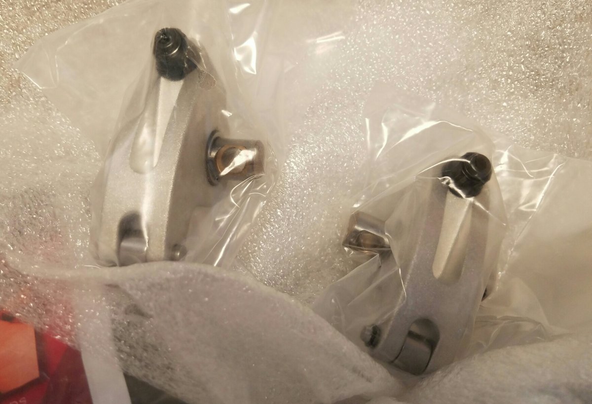

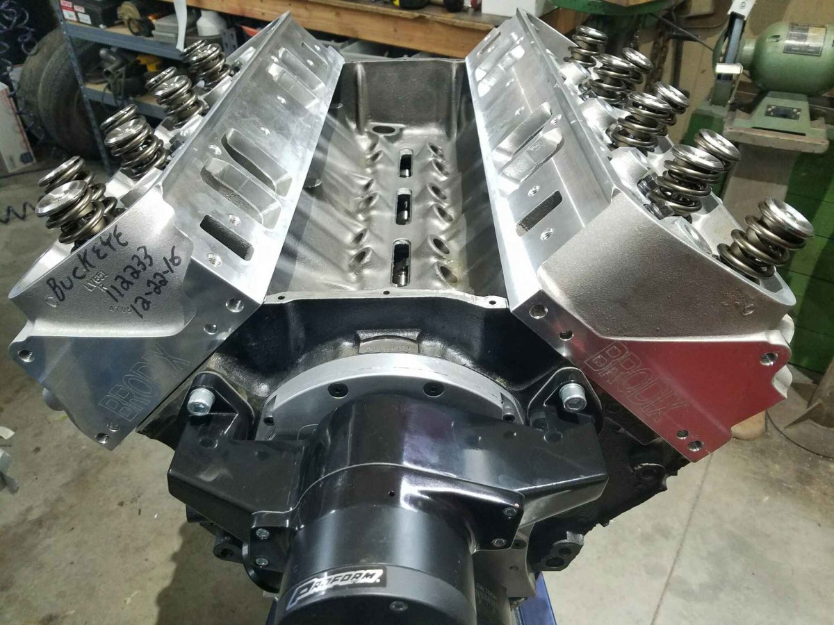

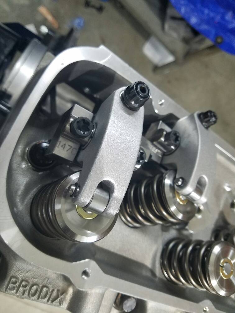

    Well Jesel pretty much shot my engine rebuilding weekend plans down this morning. When I called them about a set of rocker arms I was inquiring about the Sportsman Series. They didn't recommend them for a supercharged car. Their suggestion was to upgrade to the Pro Series with their solid rocker arm bodies. So I decided to pull the trigger. They arrived this morning but they are not the solid body style they are a lightened series.
    I called them and they said I should have requested the solid. I said you guys recommended the solid. So long story short, round two of rockers on the way but certainly not by this afternoon! :mad:

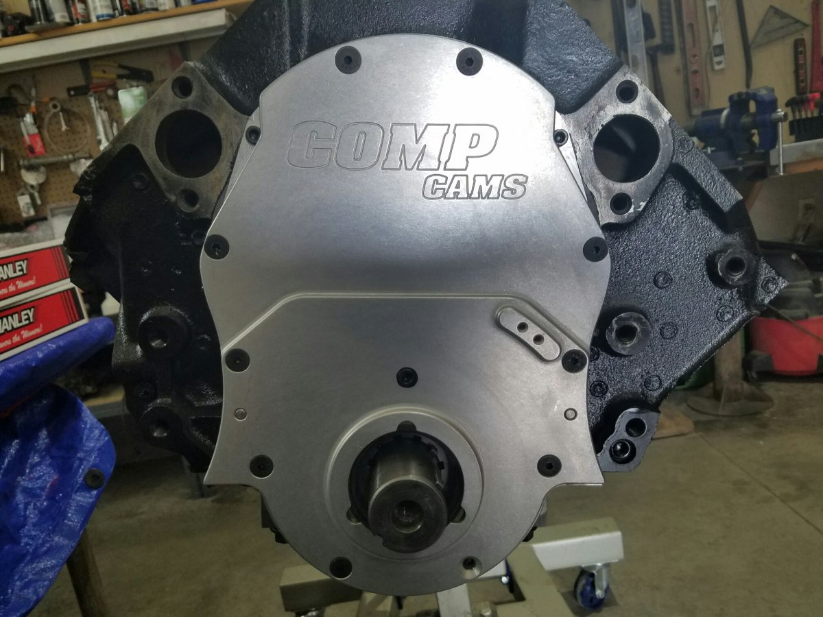

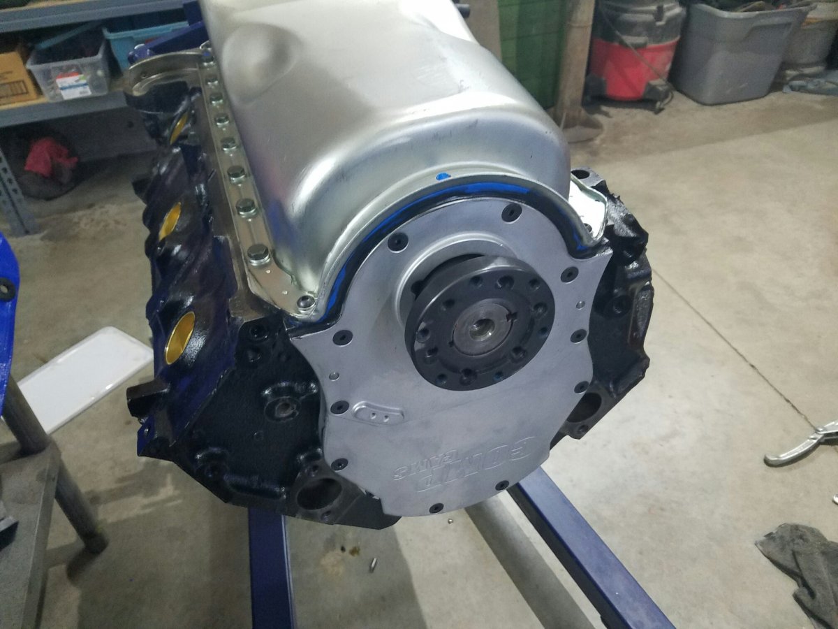

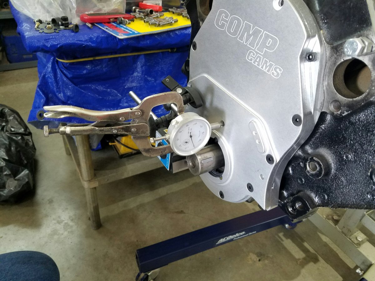

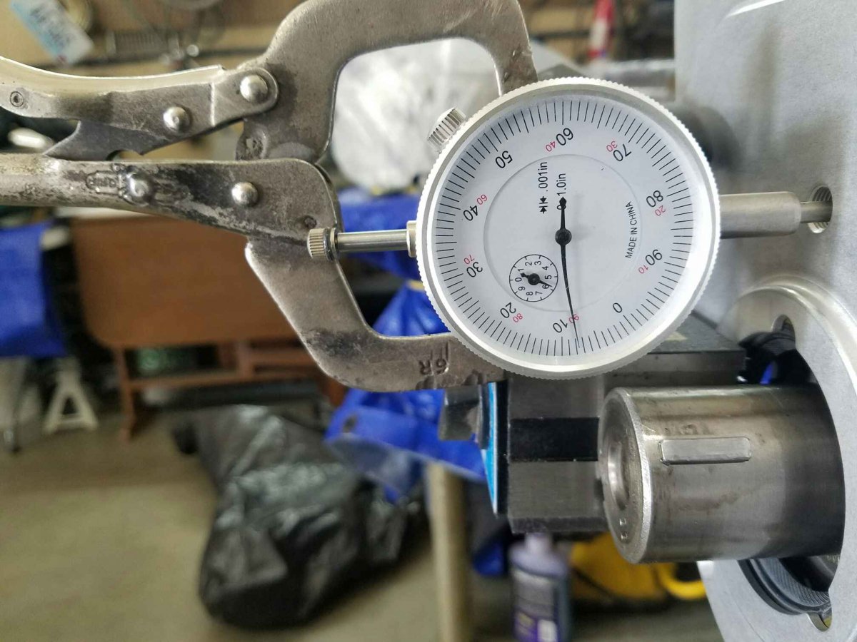

    Then in the afternoon be we got back to work, without the correct Jesel stuff we can not finish the top side, but we can certainly button up the bottom end. So we started by removing the timing chain, putting the gear back on (with the cam button installed) and then installed our new two piece timing chain cover. After it was on we then spent a while trying to contort the dial indicator holding device in a fashion that would allow us to hit the hole in the cover.:rolleyes:
    After we finally got it in place we check the cam end play and it was .057! :eek: We are looking for something between .005 and .010. So we un packed the shims that came with the cover, Dad took his calipers and measured the entire pile of shims (5) that came in the kit. He said they were about .049. So we took it all apart and put the whole stack in behind the cam button. Then reinstalled the cover and checked it again.
    I have to say looking for something between .005 and .010 ---- a touch over .007 is about perfect. So we greased the daylights out of the chain and gears, put them all back on including the shims, cam button and button hold down. Then we installed the front cover for good (I hope)o_O...

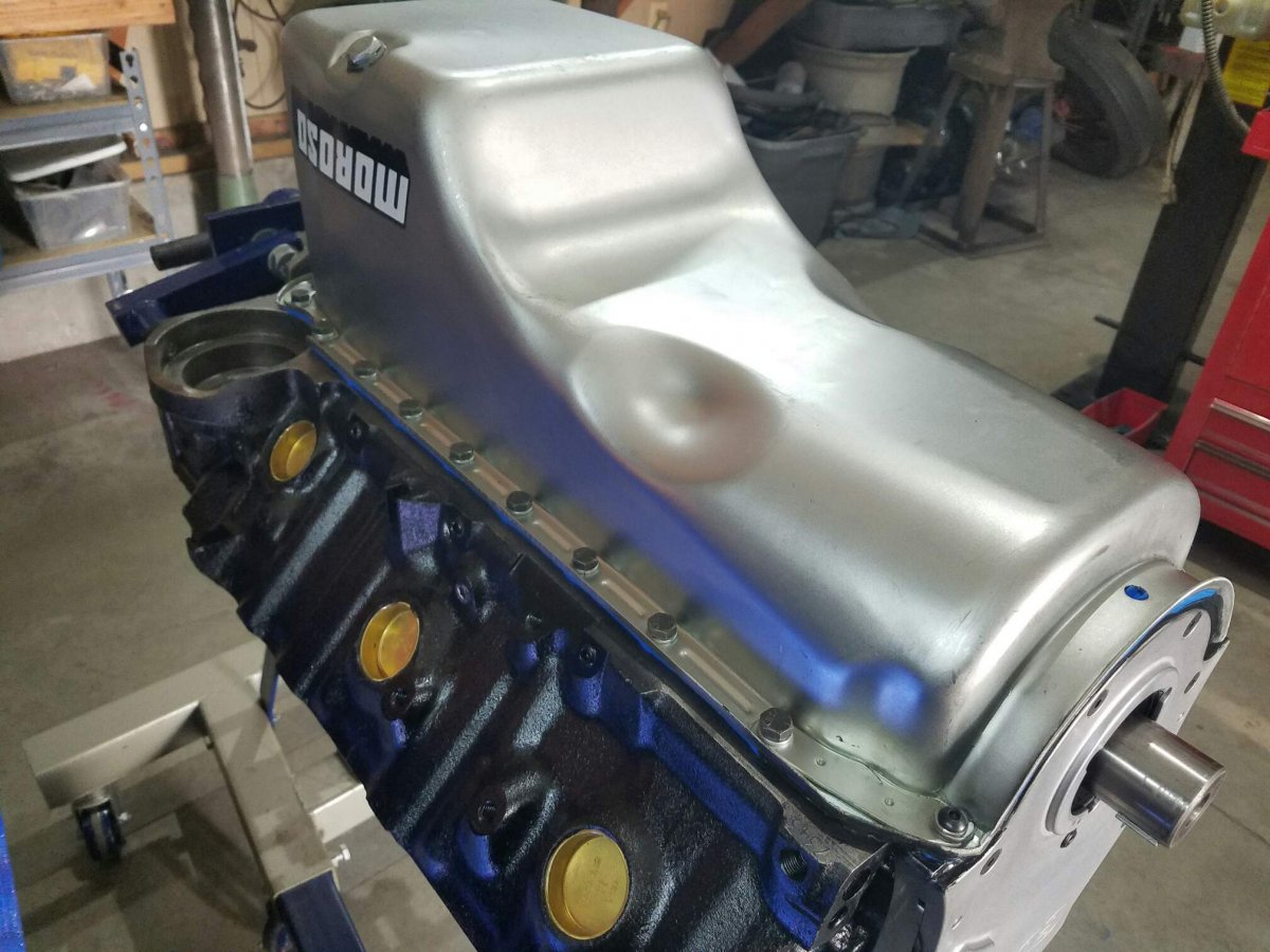

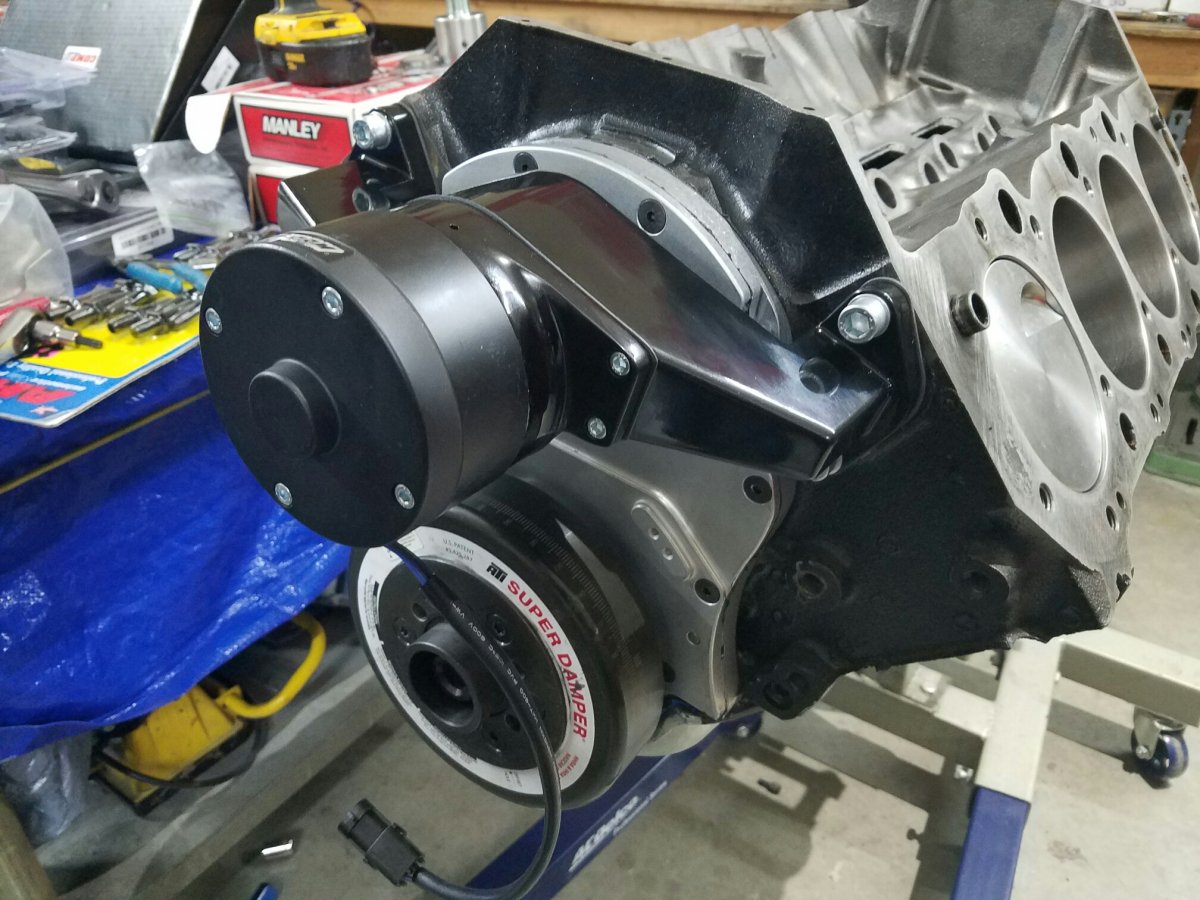

    We flipped it over and installed the oil pan. Which was not fun, are we sure this stupid thing came off this motor...LOL Ever have one of those days in the shop...:confused: But we finally got it back in place.

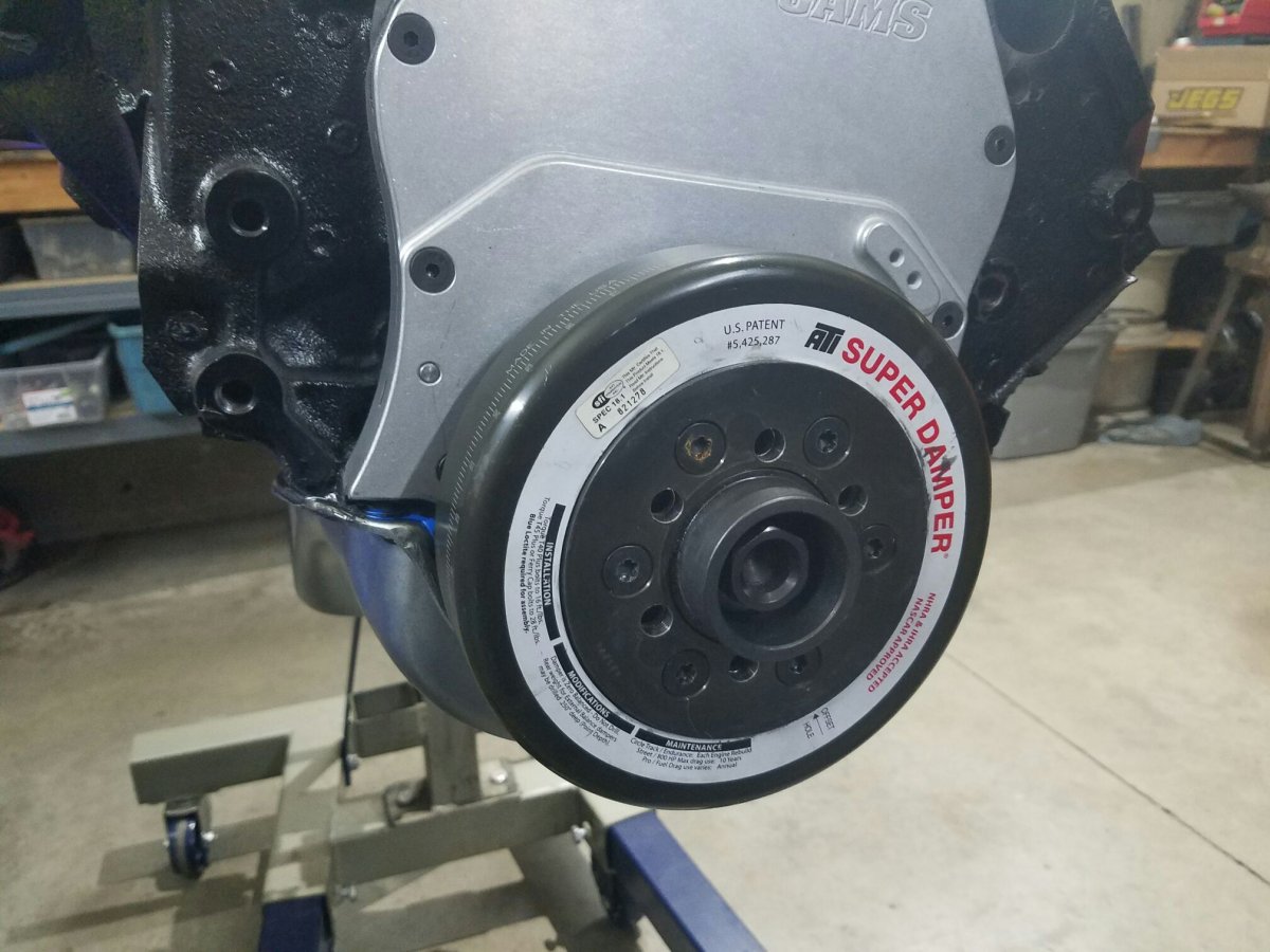

    We were on a roll so grabbed the inner hub from the ATI Super Dampner and pressed it back on the crank.
    Then we installed the rest of the dampner making sure to clock it for TDC (that will help later). :p
    Then just to ease our mind, we bolted on the new electric water pump to make sure it cleared everything.
    Like a glove a baby! :cool:

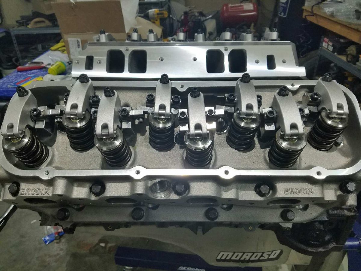

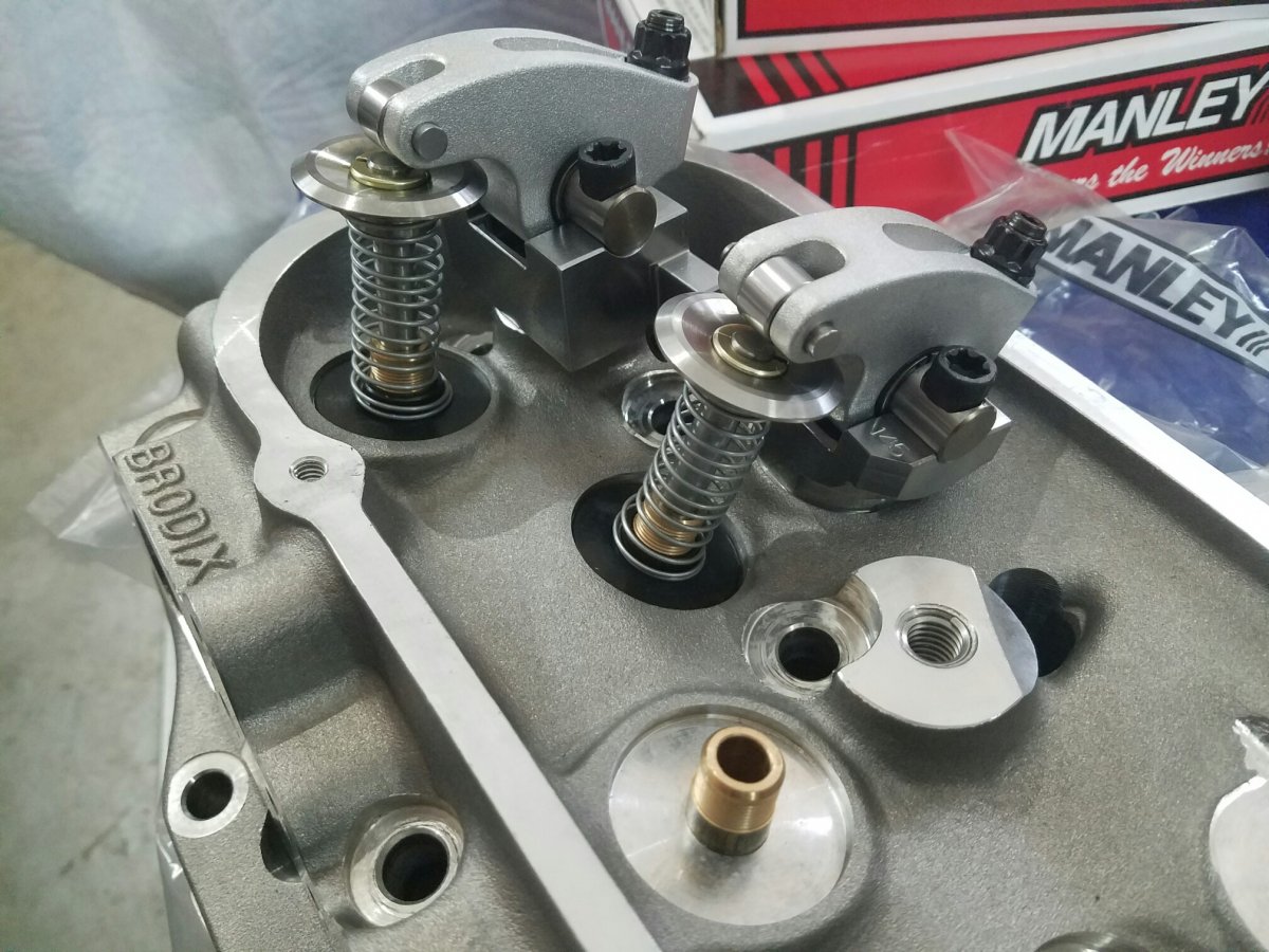

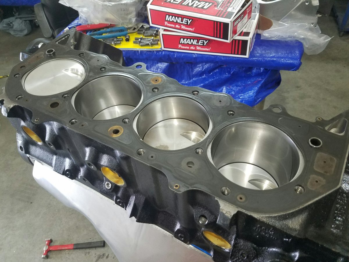

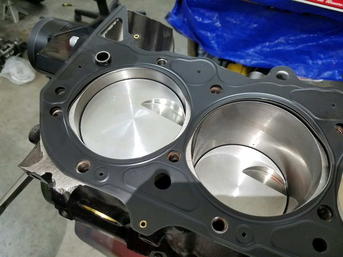

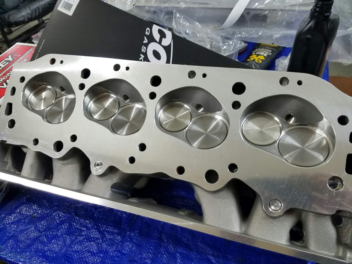

    So after confirming there was no difference other than weight, between the lightened rockers I was sent accidentally and the correct solid rockers that Jesel is scrambling to get me, I decided in the mean time to move on. So we dropped the used cometic gaskets in place, installed the valves and test springs in the head and popped the head on the block. The goal was to double check piston clearance and measure for push rods.
    We test fit the new Jesel rocker bases and carefully removed a couple of the shaft rocker arms from their plastic wrap. I was expecting to get the correct rockers later this week but just as I was temporarily installing these I got an email from UPS confirming an overnight delivery from Jesel for tomorrow. That is pretty impressive.
    Anyway we dropped a bit of play doh on the top of the pistons, installed the heads and torqued them down with the ARP head bolts from the original build. I got the old adjustable pushrod out and checked the exhaust first, it was around 9.250 (Dad wrote it down). Then the intake, it was just a bit longer than 8.250 (of course at this point I am just laying the rod on a tape measure. Dad started to write down the intake number and then said, wait a minute, that a stock BBC push rod set. He was right, and unfortunately, our original comp cam push rods were shorter than stock, so looks like a new set of push rods in our future.
    AND...by the way the Play Doh castings were perfect, plenty-o-clearance!

    And then just thinking I would not want a gasket making a step in my combustion chamber....But maybe I don't know everything?
  11. Deuced Up!
    Joined: Feb 8, 2008
    Posts: 4,224
    Deuced Up!
    That is the original set of Cometics, the new set from them are supposedly specialized for the Brodix Race Rite Head, I have not opened yet but I know they are the same thickness etc. When we do it for real I will shoot another photo to show whether or not Cometic designed a step in them etc...

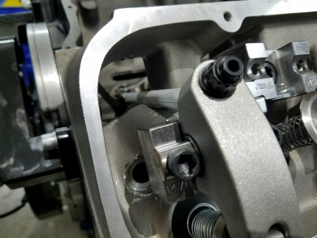

    So I ask you, where does it end? As you may have read, Saturday we measured for push rods. Of course it would be my luck, the custom Comp Cam Magnum Rods are too short and are essentially useless, toss them into a very expensive pile of slightly used parts from round one that for one reason or another did not make the cut.
    It was obvious to me while measuring them, that the new Jesel rockers seem to require the ball style ends. I decided since I was on the hunt for new push rods anyway, I would just call them to see if they had any specifications or at least recommendations in that area of the valve train.
    What I found out was at least a 3/8" if not 7/16" push rod (duh) however with a bit of a twist. They have to have 5/16" ball tips and the tip that encounters their rocker cup must be compatible with its H-13 Tool Steel composition. Not such an easy find, especially for the 7/16" rods (what I am basically saying is not an off the shelf item from JEGS).
    I talked to quite a few suppliers of said custom rods including Smith Bothers and others but I think I am going to go with Manton. We are going to double check for clearance tomorrow but the goal would be 7/16" at least on the exhaust. Believe it or not, Brodix couldn't tell me if that was possible, said I would just have to try one and see.:rolleyes:

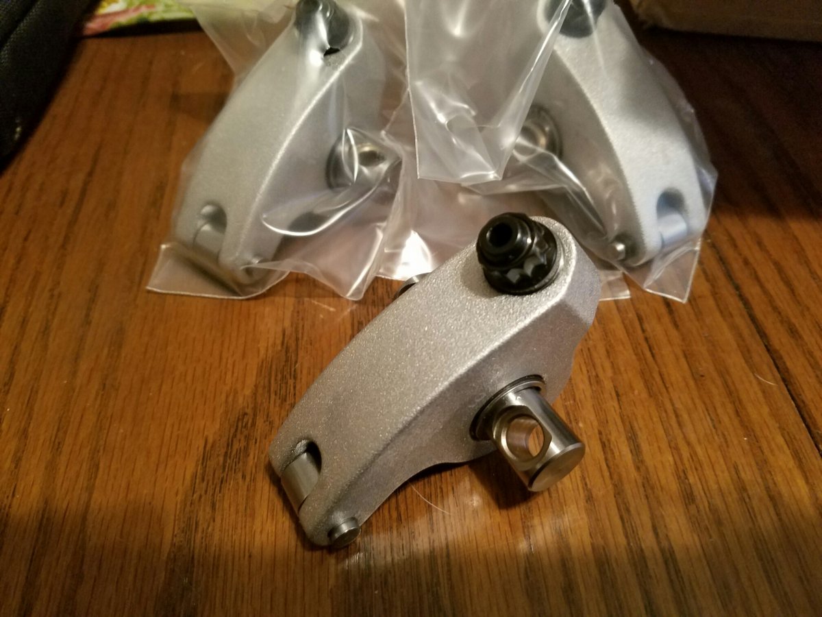

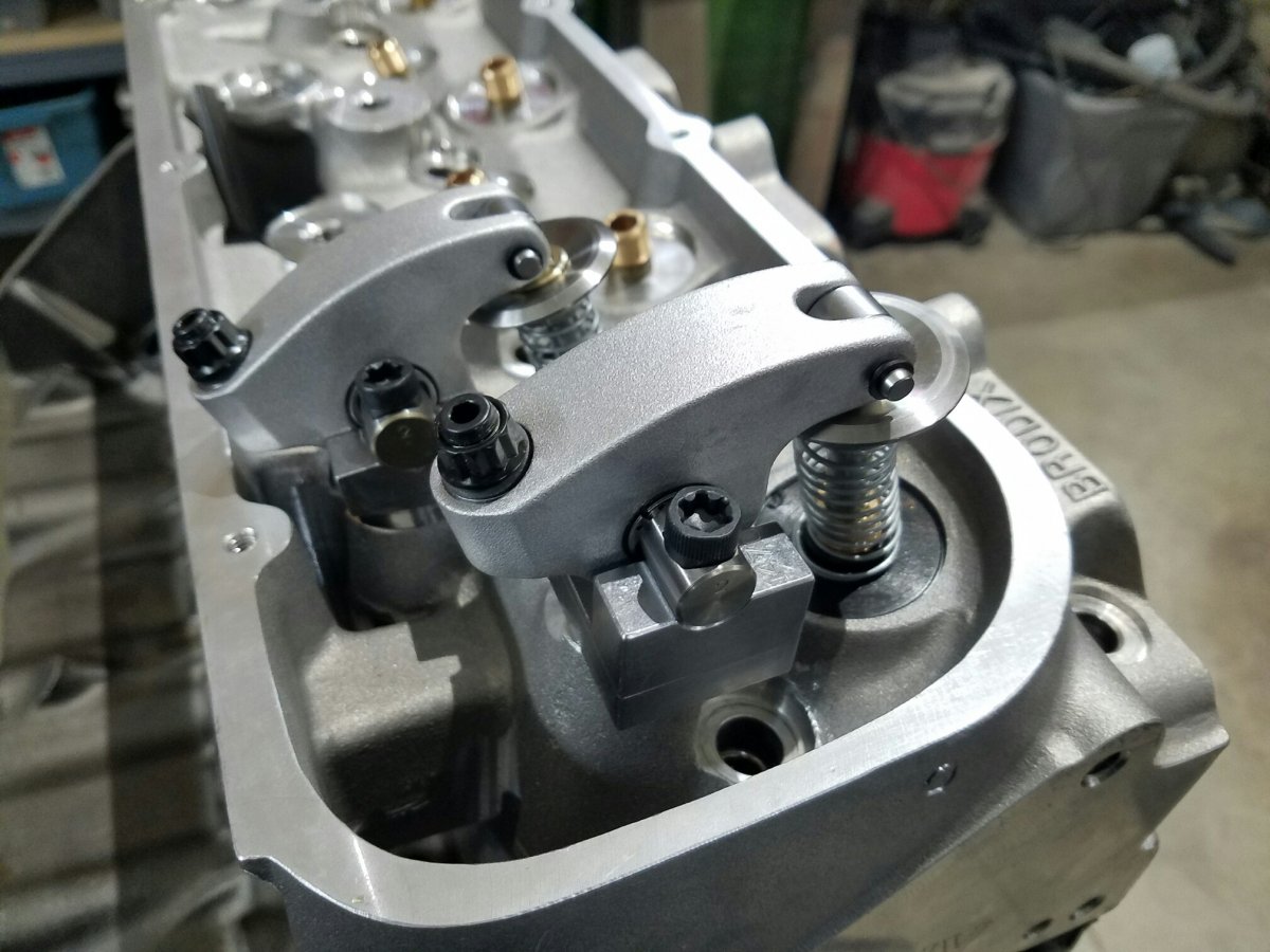

    But here is some good news. The corrected rocker arms (solid body) showed up today as promised.
    While that certainly falls in the realm of good news it not exactly what I was driving at. Take a look at this!

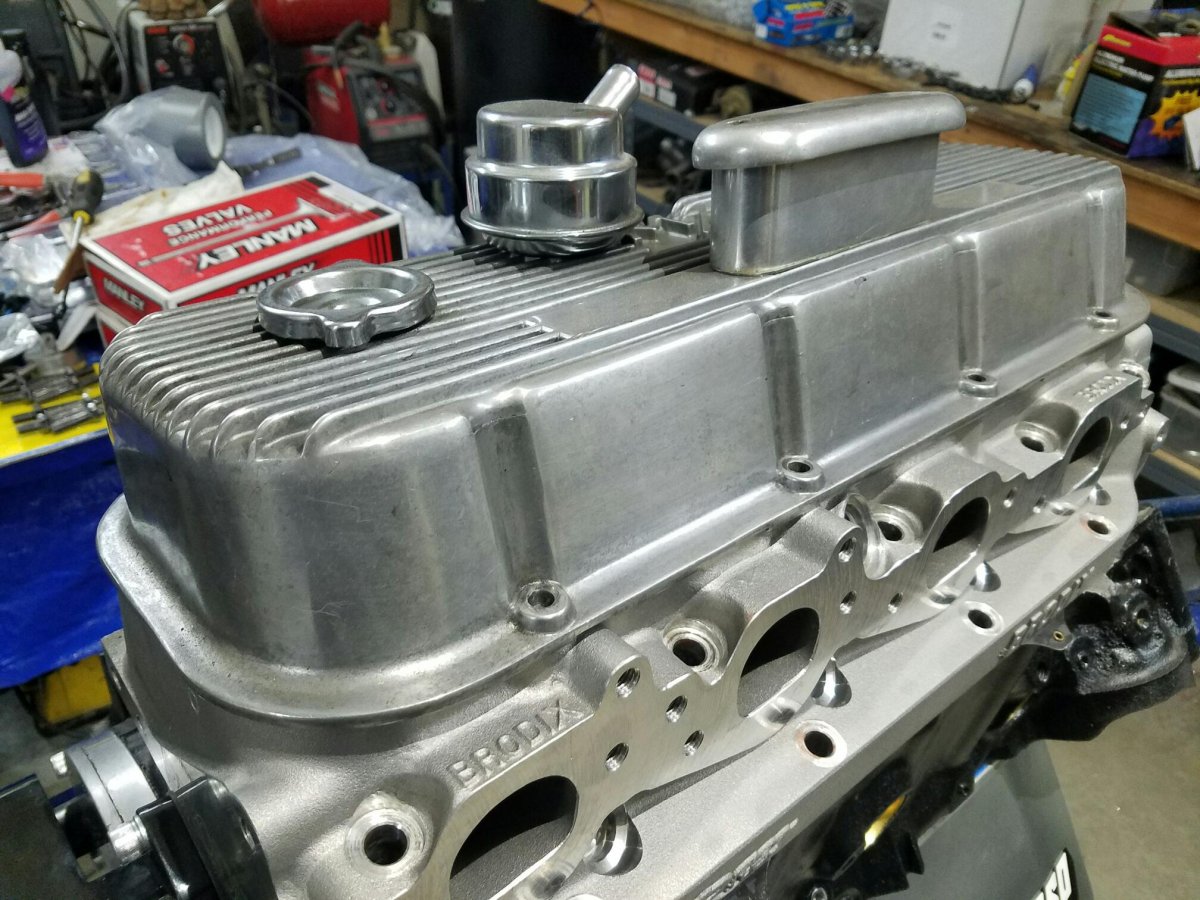

    I quickly popped them on my still bare test head and then for grins dropped my vintage M/T valve covers in place...
    And bing...again "like a glove baby!" Plenty of clearance and no more spacers thanks to loosing that crazy stud girdle!
    Very exciting!

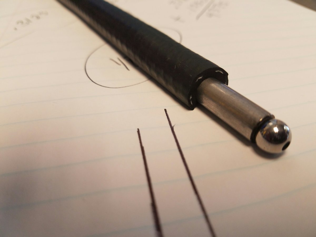

    Just to double check on the 7/16" push rod possibilities, I came up with this. Honestly there are two questions here, one, are the holes in the head big enough to facilitate the larger push rod through the full cycle. And two, with this rocker configuration, would they clear the cylinder walls in the valley.
    I took my stock 5/16 push rod (.3125) and added an 1/8" wall hose to it (.1250). The math says that equals 7/16" (.4375). But this little test is obviously skewed a bit as I have basically just added the entire 1/8" to one side of the rod. However I did that on purpose. There is only one side of the rod that is in any danger in any given hole. So if we put this rod in tonight (with the 1/8" towards the cylinder wall and it clears, I know I still have 1/16" in the bag. We shall see.
    mad mikey and loudbang like this.

    Well after moving that push rod around my desk several times Friday to insure I didn't do something stupid like walking out of the office with out it......... I walked out of the office with out it. :rolleyes: So we headed back to Springfield this morning to have breakfast and pick it up. After getting it home and testing it on cylinder one, it the touched head. You could still turn it but you could feel the drag. So we had to get a bit more precise to know for sure.
    So I took the rod and started wrapping it with strips of duct tape rolled longways on the rod. After several layers and checking with calipers, we ended up being .010 over the 7/16" goal. We installed it and if you look closely, you can see a tiny bit of daylight between the head the rod (plus my 0.10). We checked all the exhaust rods and now feel confident we can get away with larger rods.
    With that being said, our test fitting and measuring is complete, time to go ahead and build this head for real!

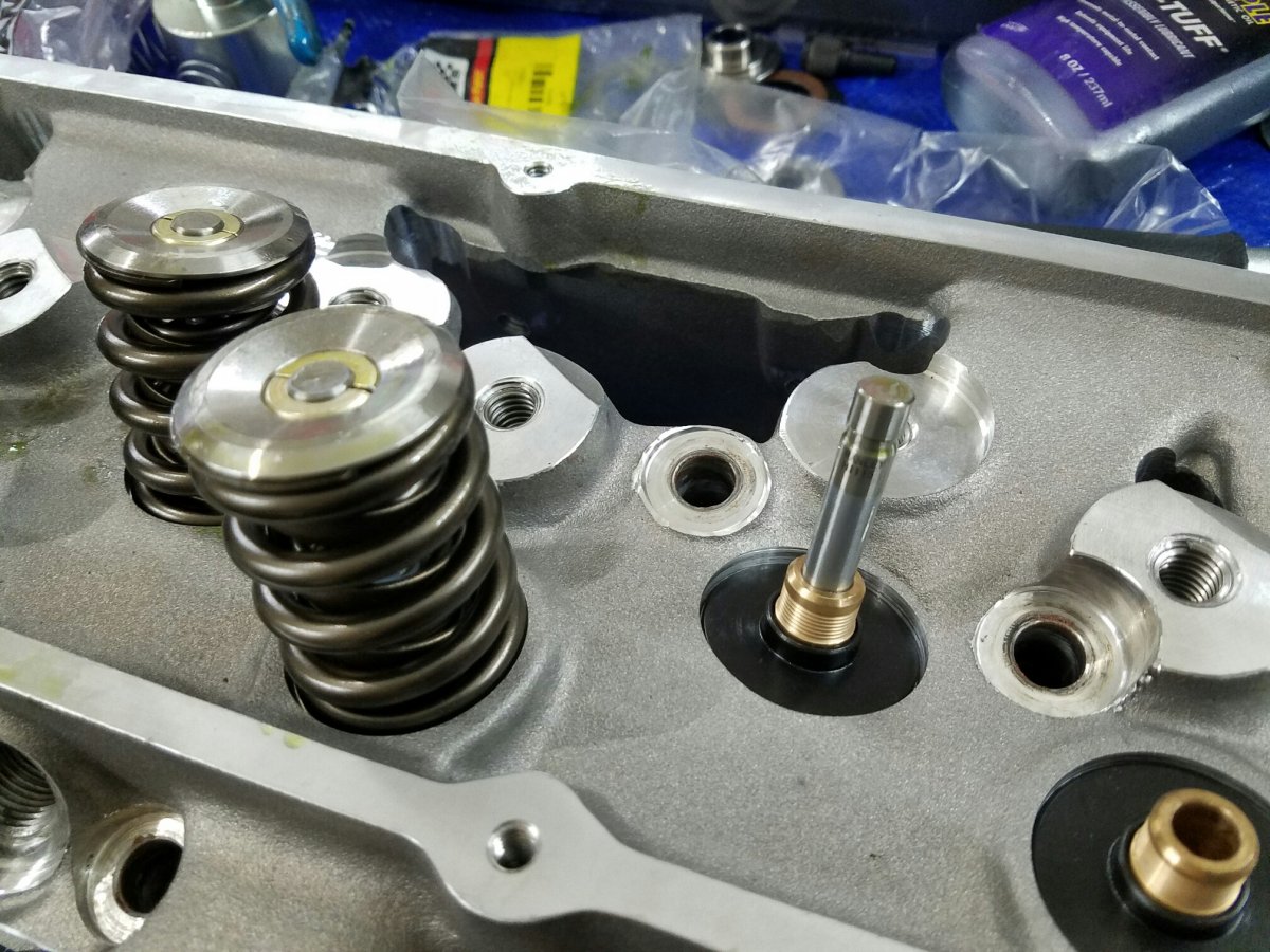

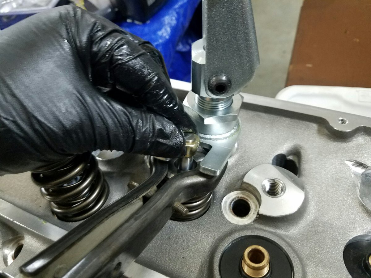

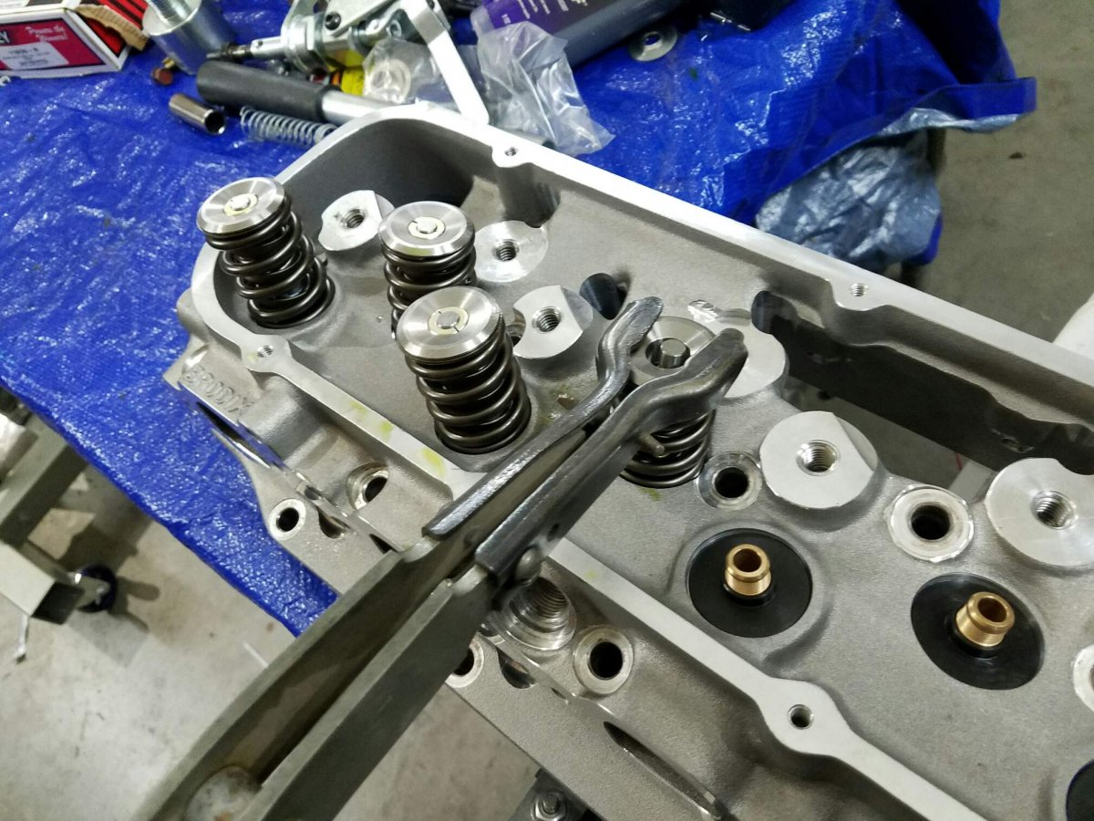

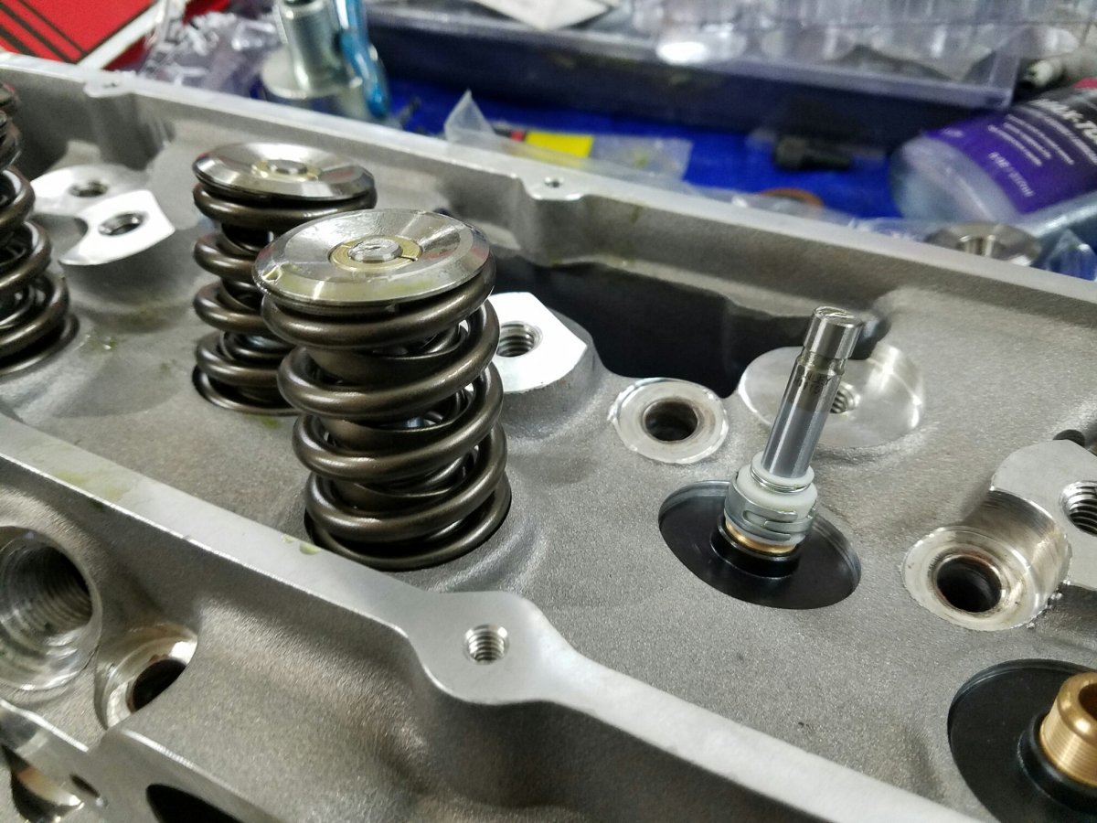

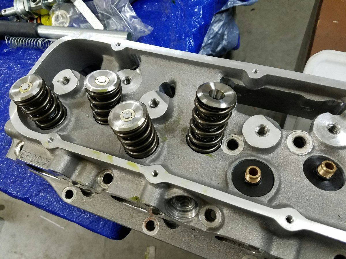

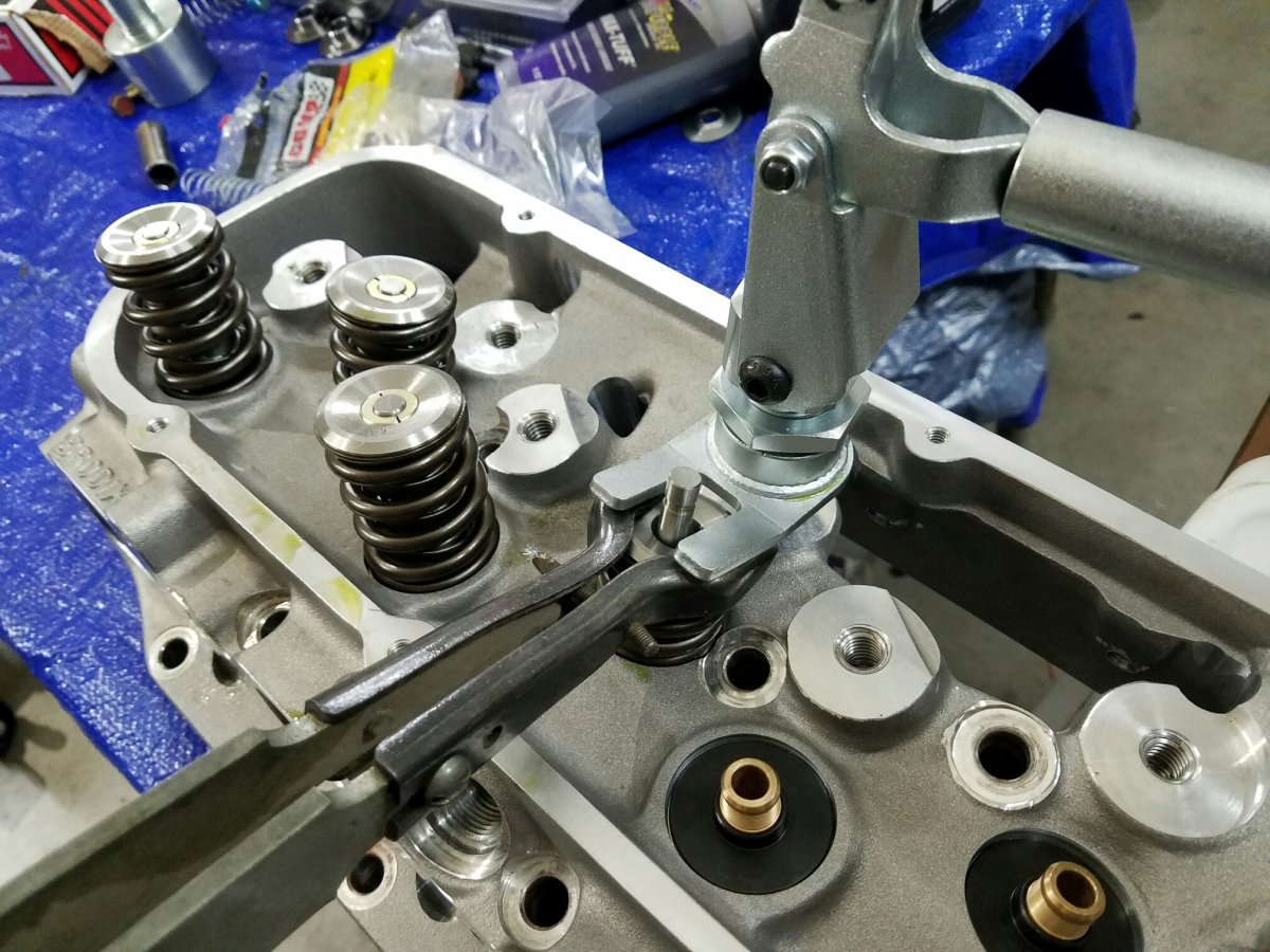

    So one at a time we dropped the locater rings in place, remember because of the larger springs (that basically took up the entire pocket) we had to go with this internal style locater instead of the cups.
    We greased up the valve stems and slid them in place. Then we carefully worked the spring loaded teflon guide seals over the stem and then down in place on the guides. I used one of the titanium retainers to help install the seal both on the stem and then carefully down over the guide.
    Then we dropped the spring with the retainers in place and grabbed the air powered spring compressor.
    That's all she had, same as before (even with turning up the pressure on my compressor) that is all we got.
    So same as before we installed the standard hand operated unit and finished the job. Actually I think this is about the perfect way to do it. The air unit has the spring, it is not going to go anywhere (kind of like an insurance policy). Then the hand held unit makes quick work of the last 1/2" or so to safely install the keepers.
    By the way anytime we have touched the springs or really any part of the valve train, it has been with the latex gloves on.

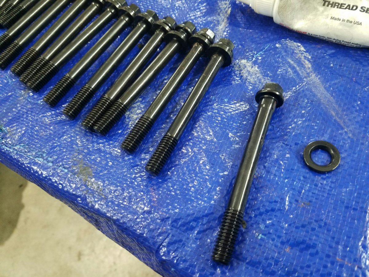

    Then we made sure our washers were all on correct (Chamfered side up). Before installing them we put ARP Thread Sealer on them and then the ARP Ultra-Torgue Assembly Lube (the blue tube) on the washers and head bolt shoulders.
    After hand tightening them we torqued them to 70ft.lbs. in three rounds of the general Chevrolet head torque pattern.

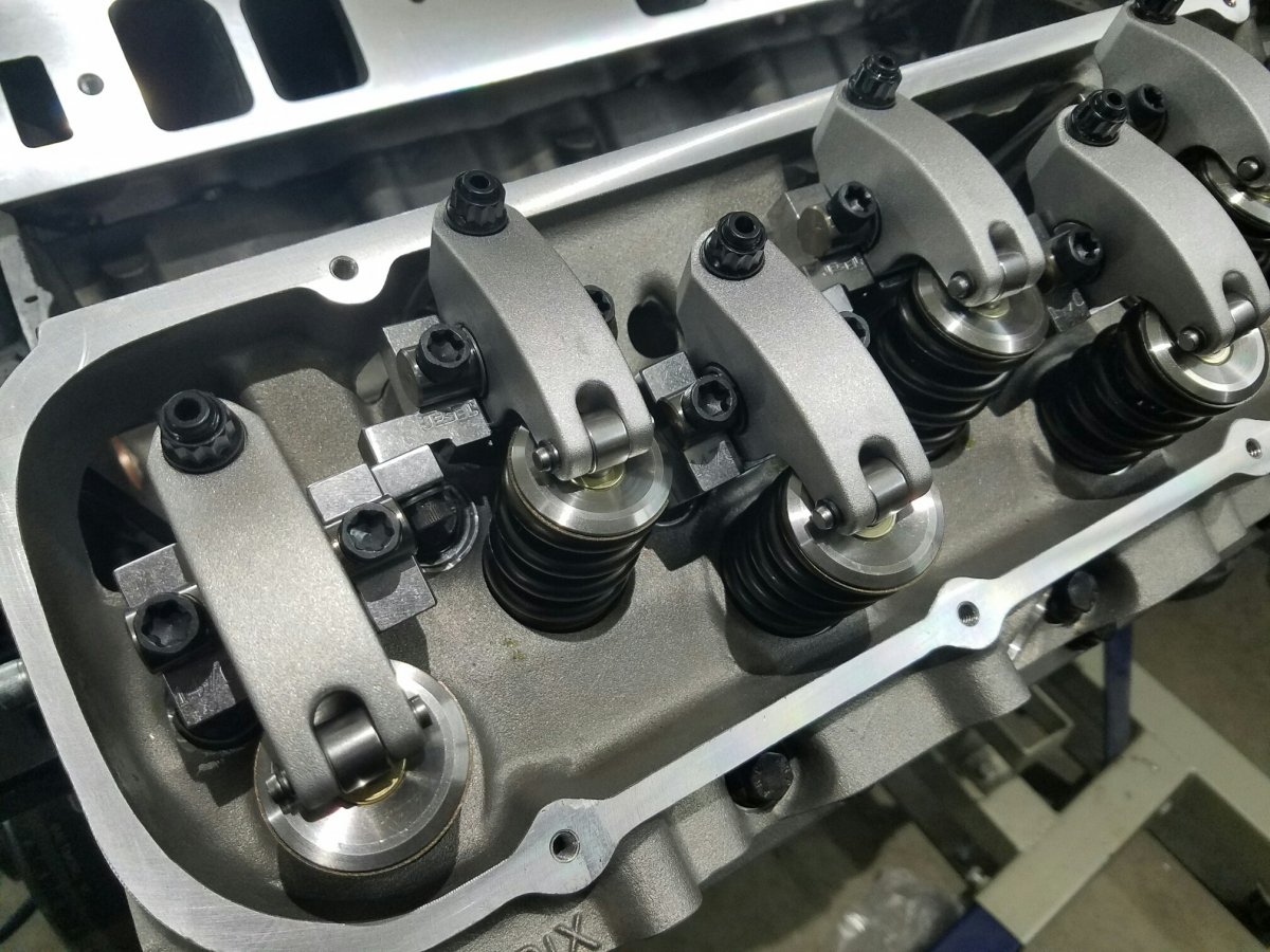

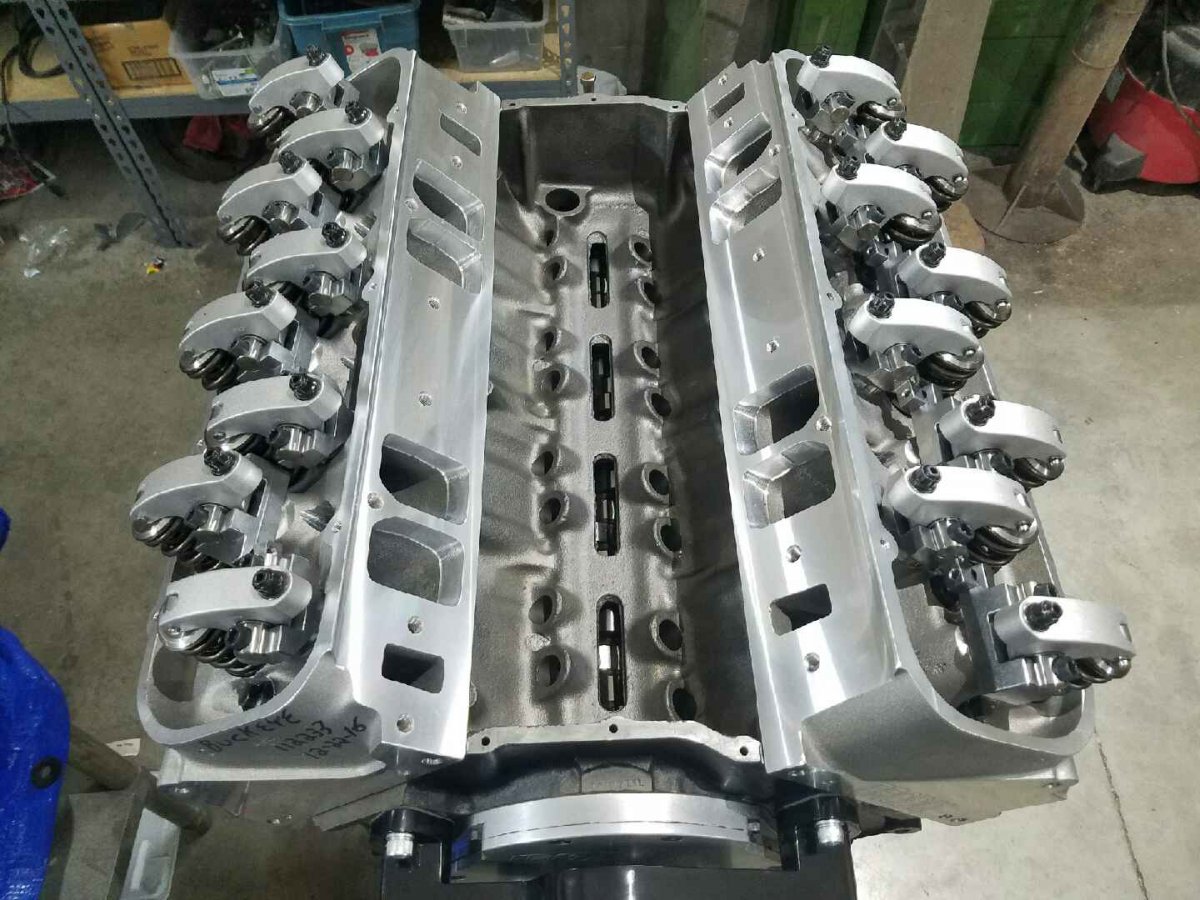

    After we had them both complete we installed the Jesel Pro Series shaft rocker system.

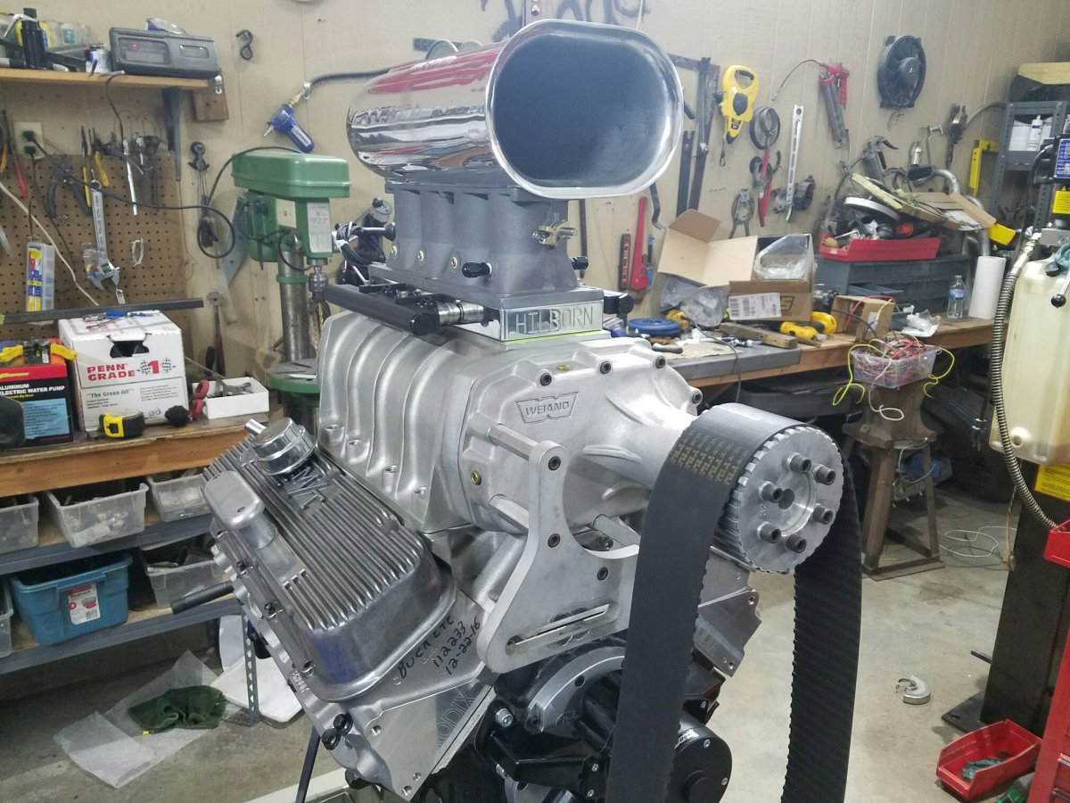

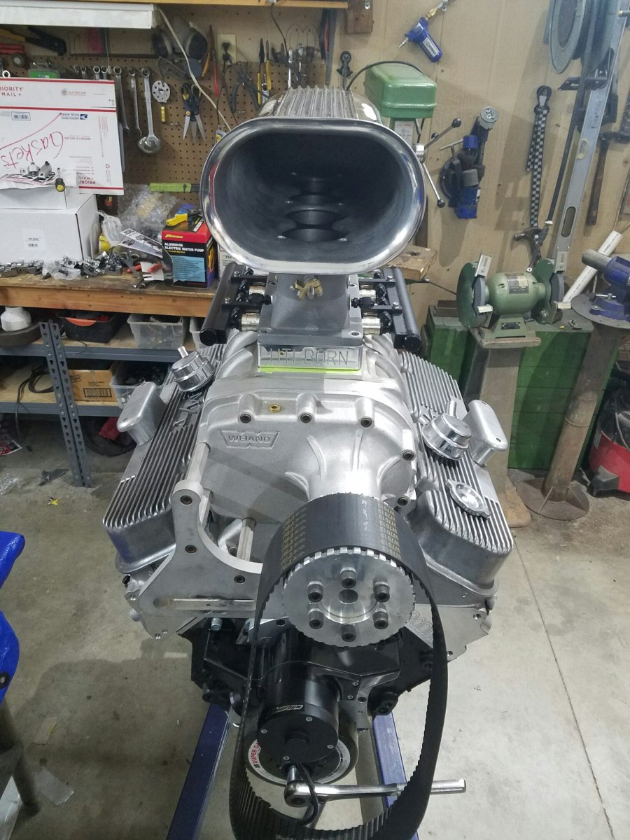

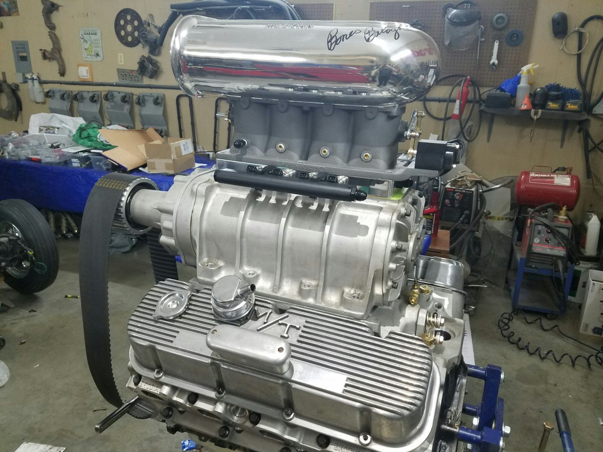

    After the heads were in place we did a quick test fit (double check) to make sure the supercharger intake fit properly. If you remember we had to do quite a bit of grinding on original 840 heads. But no issue at the all as the intake appears to fit like a glove. HOWEVER, you know Dad and I are like a couple of kids with model car, it is hard not to take sneak preview. In fact I don't think either of us said anything, we just started grabbing parts to set them in place. So here it is! :p
    Very little was accomplished in the shop after this outside of photo taking, walking circles around it, and smiling our backsides off!;)
    swade41, kiwijeff, loudbang and 4 others like this.

    No not just .010...the daylight you can see plus the .010 in the bag from my tape job being a bit larger than 7/16.
  29. Got it. My mistake!
    Deuced Up! likes this.
