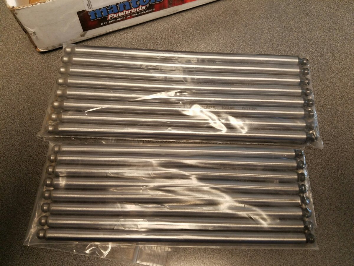

    Push rods came in today. They are Manton Series 5 - 4130/4135 Chromoly Tubing propriatory heat treated to create a tube that has straightness memory with a hardness of 42 to 46 Rockwell. Not sure what that means but I am ***uming they are good stuff! :D
    The package of eight 7/16" rods weighed just over 2.5 lbs.! They have H-13 tool steel balls on the rocker ends to be compatible with the Jesel shaft mount rockers.

    So it has certainly been a fun day. Short and sweet. The push rods are too long...
    I must be missing something. You know we spent forever before ***embling the heads playing with the light weight springs and adjustable pushrod to double and triple check the measurements. Then when we had the number we ***embled and installed the heads. Then when I was talking to Manton and gave him my measurements he did the prudent thing by asking how I ascertained the figures. I told him. He asked if I had adjusted the screws any on the Jesel shaft rockers. I said no, they are brand new and set by Jesel. He laughed and said he had never seen them shipped correct.
    So I came home, backed the adjuster screw all the way out and then back in 1.5 turns. With the lifters on the base circle (and stock push rods in place) I had found some new lash meaning to be perfect, I needed a bit longer rods than stock. So took I my feeler gauge and measured the lash. It was .030 on the intake and .032 on the exhaust, again using the stock pushrod. So we added those amounts to stock lengths and placed our order. That should have given us 1.5 turns on the adjuster (a ton enough from zero lash to the cam cards .018). However when we installed them they are a ton too long! Even with the adjusters backed all the way out we have a good bit of negative lash till in play. However, they are exactly what we ordered and exactly .030 and .032 longer than stock respectively. o_O
    I put the stock push rods back in and double checked and they are exactly what I measured above too short and the new ones are exactly the correct length but TOO LONG! :eek: ...Bottom line, I have 16 very expensive paper weights and still no push rods. I am wondering if there isn't some math in the rocker ratio that should have been in play with the extra lash I found making the needed length not exactly the same amount as the extra lash measurement. Anyone?

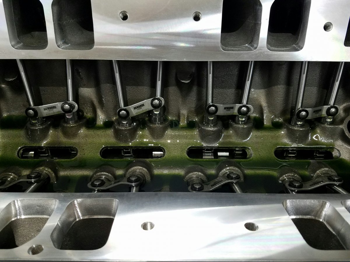

    I popped on the HAMB and typed my plight. Then I took up my pad and pen and started drawing things out. Little teeter totter scribbles and arcs trying to visually see the potential math. Then it hit me, there were lots of parts that came with the rocker arms as they potential fit several different styles of heads. There were two sets of bolts for the seats (two different lengths). There was also a package with a ton of shims, reportedly, none of which we needed for our application.
    So I figured if there really is some stupid math involved that I didn't understand (which I don't even know is true or not) I would just do the math I do know. I can't change the length of the push rods at least not today (hell they are "Series 5 - 4130/4135 Chromoly Tubing propriatory heat treated to create a tube that has straightness memory with a hardness of 42 to 46 Rockwell")! :eek::D But I most certainly could change the distance between the rocker and the lifter. So we went back out and did just that...
    I experimented quite a bit with the different shims, adjuster screw turns and a Sharpie blacked out valve stem to keep track of the contact patch. After an hour or so I found that .032 under the seat and half turn out on the adjuster made the push rods fit at zero lash and still kept us darn near the center of the valve stem. My new math says everything fits and works and I still have around .060 left for lash adjustment. I bribed a good friend and engine builder over late yesterday with the promise of a good steak. He looked it all over and said we are golden, no issue! He said he nearly always has to shim rockers for one reason or another, no worries.

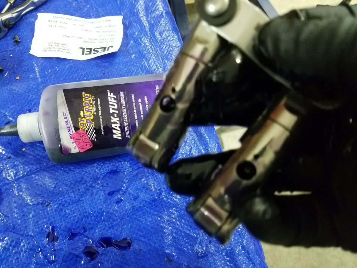

    So out came the rest of the Howard lifters...
    The lube...
    And ****...
    We are back in the engine building business.:cool:
