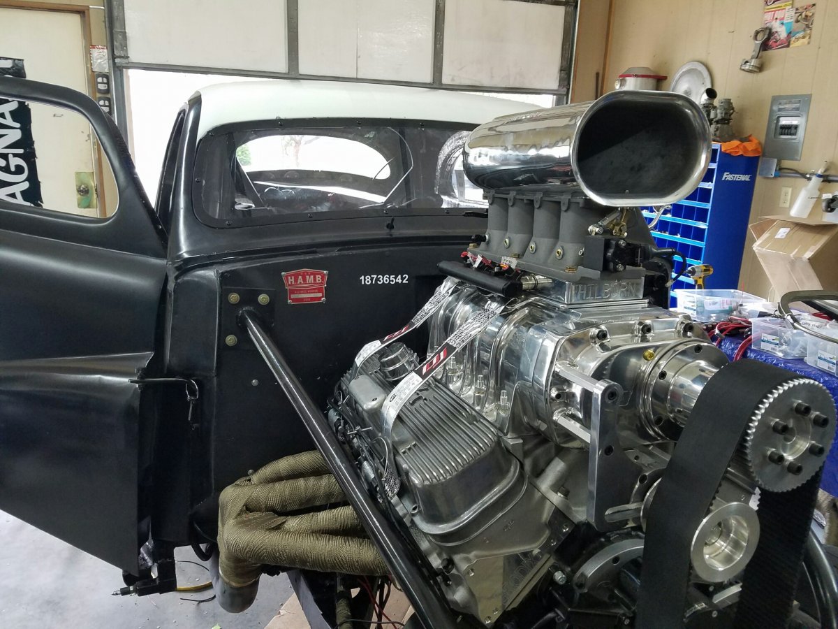

    Well there is a lot to catch up on from this weekend. First up Holley sent the replacement spacers as promised but they were natural instead of polished SOOoo....we just drilled the original ones out, tapped them and stepped the bolt up a size etc (what I should have done in the first place). So Idler Pulley Bracket is installed.
    Then we turned our attention to the Blower Restraint system which had problems all of its own. I just put it in place to make sure every thing lined up etc. (and it didn't). I was immediately bummed out a bit as there was no way for the plate to go on with the injector plugs pointing down as the restraint plate was in the way. (that would have been nice because the plugs and wiring would sort of be hidden by the fuel rails on both sides. But it is what it is....
    So I spun the injectors around with plugs pointing up and set the plate back in place on the restraint plate...No go!
    Even with the injector plugs up and out of the way, it would not sit flush. After inspecting it to see what was in the way now, we found this...
    The bracket that supports the fuel rails on both sides had this lip on them. (same on the top and the bottom) The bottom lip was sitting on the wider restraint plate preventing it from sitting flush so we had to carefully mark and grind the bottom brackets to make it fit, problem solved. (AND NO...that is not where I am putting the screen gasket...I just had it there while were messing around to keep anything from dropping into the supercharger)....
    After we figured it all out I decided the only way to make this all work was to put studs in the top. I mean there is a gasket, the restraint plate, a gasket, the injector block, a gasket and then the four port injector unit. Try keeping all that crap aligned while you insert six bolts.:eek: So we measured all the pieces and giving it 3/4" into the supercharger, decided a three inch stud would be perfect.

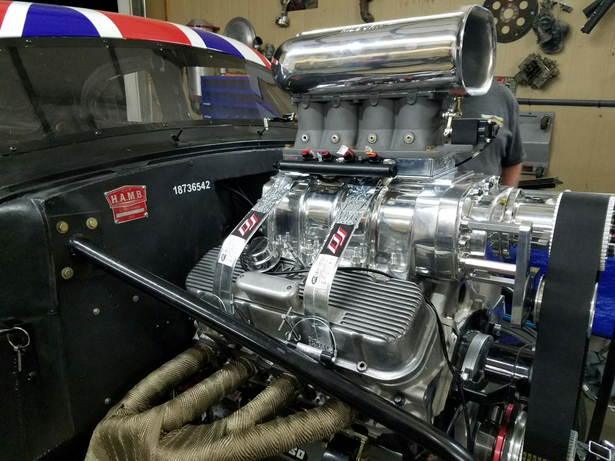

    We did finally get all in place (after drilling a set of middle holes in the restraint plate there were missing). We also tried to install the headers to make sure the blower restraint brackets fit properly etc. That was another issue (par for the course) as they hit the lower row of head bolts AGAIN. If you remember we had to grind on them the first round as well to make them fit. But finally we got them back on and I am pleased with the restraint system etc. Even though we had to do a bit of modifying on it as well....

    Notice anything missing from the above photo?

  6. i ran into a similar situation with the restraint. I just flipped it over so it cleared. the angle went up instead of down.
  7. ARP makes a low profile head bolt for the bottom bolts, I have yet to find a set of big block Hooker headers that clear the standard bolts. My engine builder let me know about them.
  8. i don't use bolts on the restraints. i use a stud thats long enough to hold both brackets. that might be a option if you have the room. nothing says the restraint has to attach at the headers. you have front strut bars passing the engine. its another option.
    mad mikey, loudbang and Deuced Up! like this.

    We tried it several ways. If we flipped it angled up, it hit the fuel rails. But I am pretty happy. Before we locked it all down, I did feed the individual plugs up from the bottom so its not too bad. We will cut off the ID tags and put the wires in the same black mesh covers as the rest of the wiring...it will look alright.

    I will remember that...I about had a fit the first time around (like 30 pages back) when I had to grind on a brand new set of Sandersons. But by now I am used to it. Seems just about everything that goes on the Austin gets a custom grind!:D In fact at this point, I would worry about it if it didn't need to be ground a bit! LOL

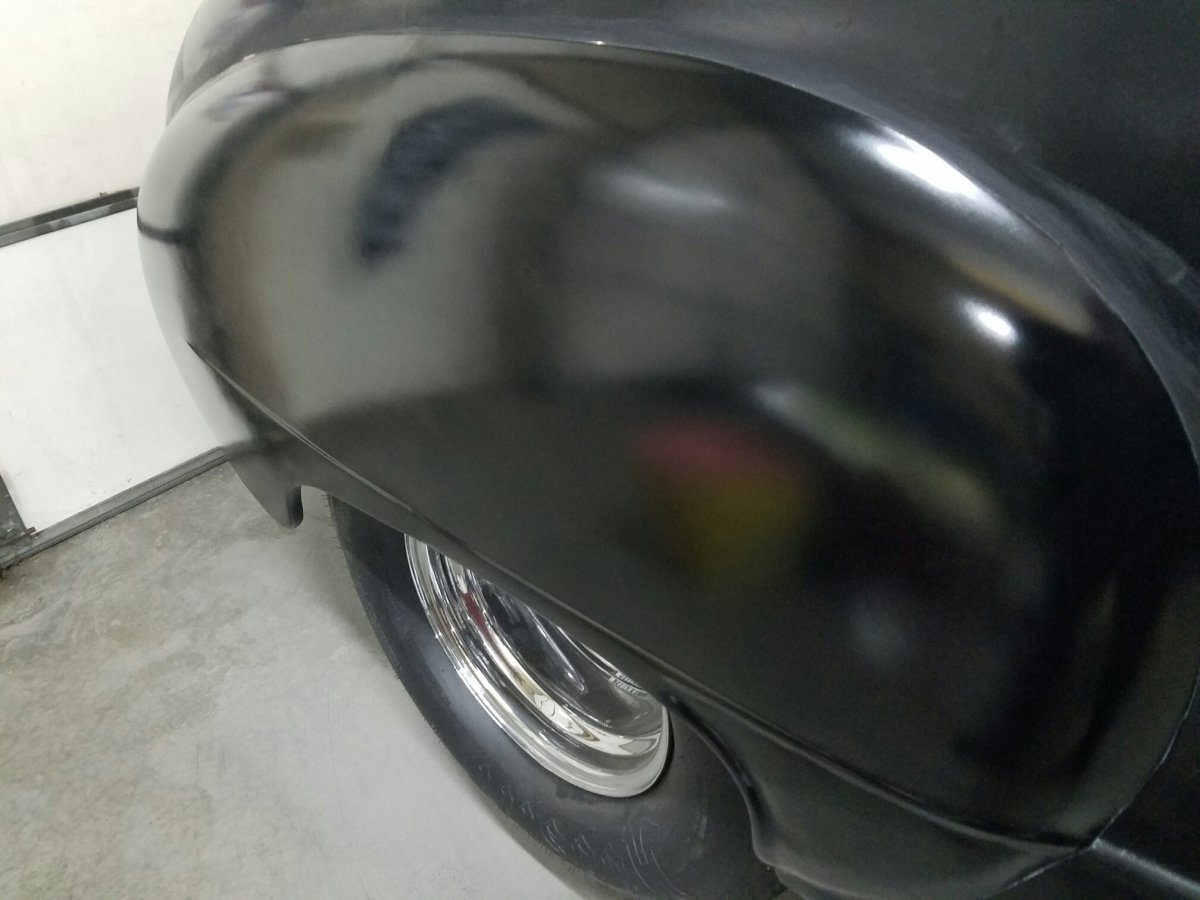

    When I got home last night I found Dad had been in the shop all day doing body work we missed in the flurry to wrap her the first time. It has been bothering him since we rolled it out of the shop last Summer. He is not as excited about the new look as he is the opportunity to clean up some of our body work from round 1.:cool:

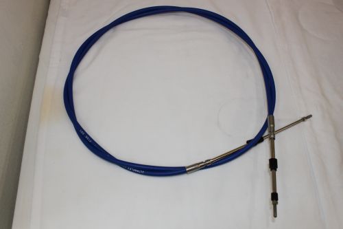

    The last few missing pieces rolled in today...hopefully with a weekend forecast of heavy rains we can hang in the shop and finish this crazy thing. First up the throttle cable from Alkydigger and the clip on/off burnout throttle stop made it. Dad was working on a home made removable throttle stop but things didn't work out. But he is still excited because he will still have to come to the car after the burnout to remove...AND get his Austin Coil on!!!:D
