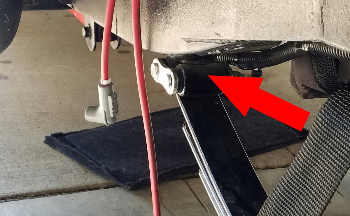

    Something I noticed while changing the oil was the front suspension. The old car pulled so hard on the dyno it got them all bound up.
    They strapped the front down from the axle. So when it pulled it tried to lift the front end. The axle was held down tight but the ch***is still lifted. It pulled the springs up with it and when they let off, both shackles were bound up in place.
    We jacked the ch***is as far up as we could with a floor jack but still had to get a four foot pry bar in there to force them to release. All good now.

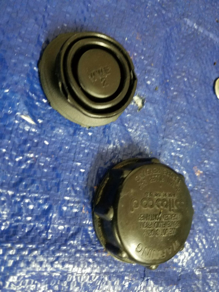

    So about six o'clock I decide to take her for a spin around the block. I hop in and fire it up. I tried to engage the clutch but had no pedal. I got out and checked the fluid level. It was low but there was also fluid all over the floor etc. I tried to pump it up a bit but noting. I took the cap out into the light and this is what I found.
    Not sure how it happened but the point is mute. But go try and replace that diaphragm and lid. I finally had to go straight to Wilwood: $10 and change plus expedited shipping was nearly $30. An entire new Master Cylinder is only $50. So I just decided to upgrade instead.
